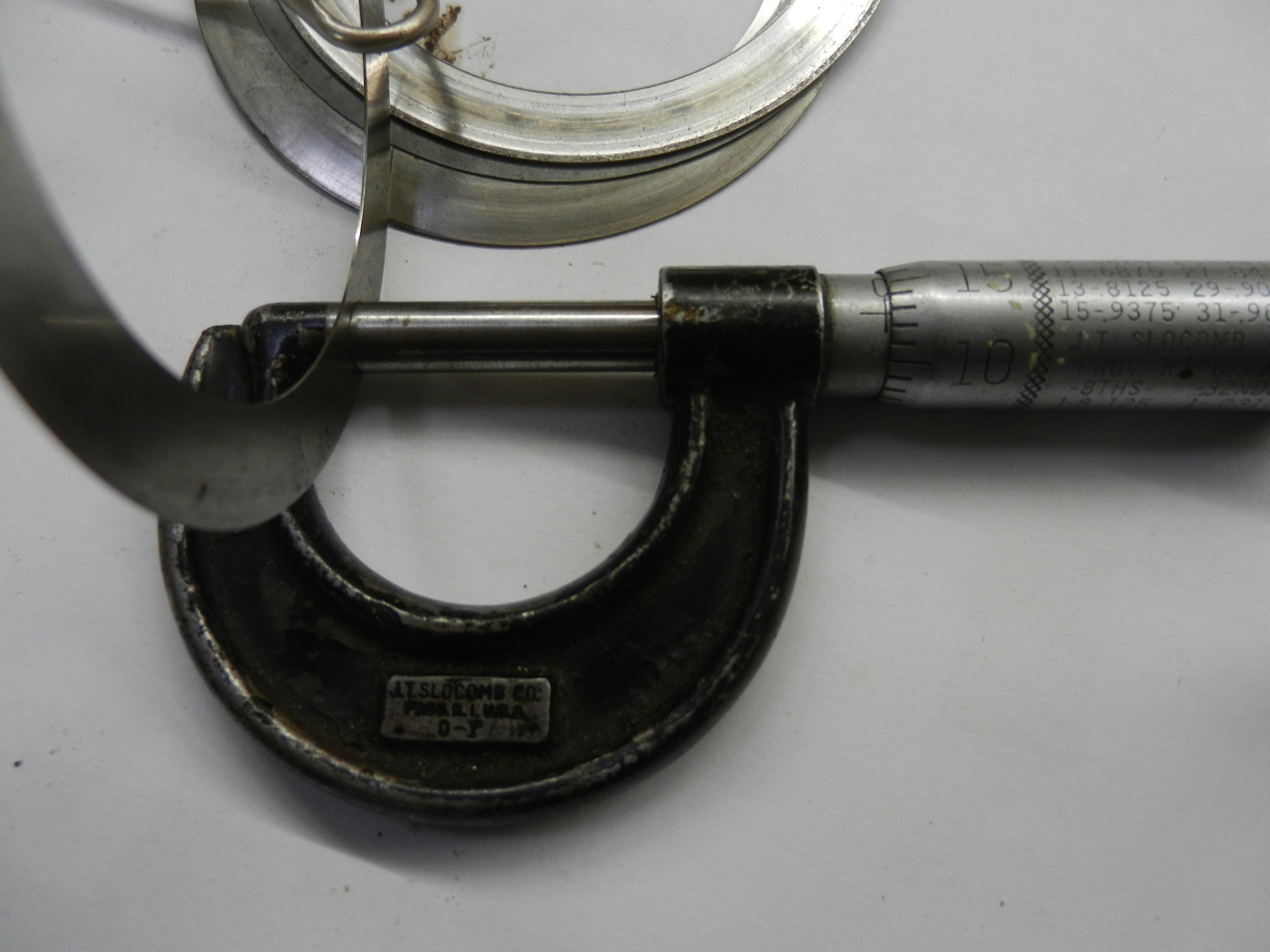

as mention prior, I pick 2 shims and measure them.
We'll call this one .013 (actually .0134)
This one .014 (actually .0142)
So, we have a 2 shim set of .027in

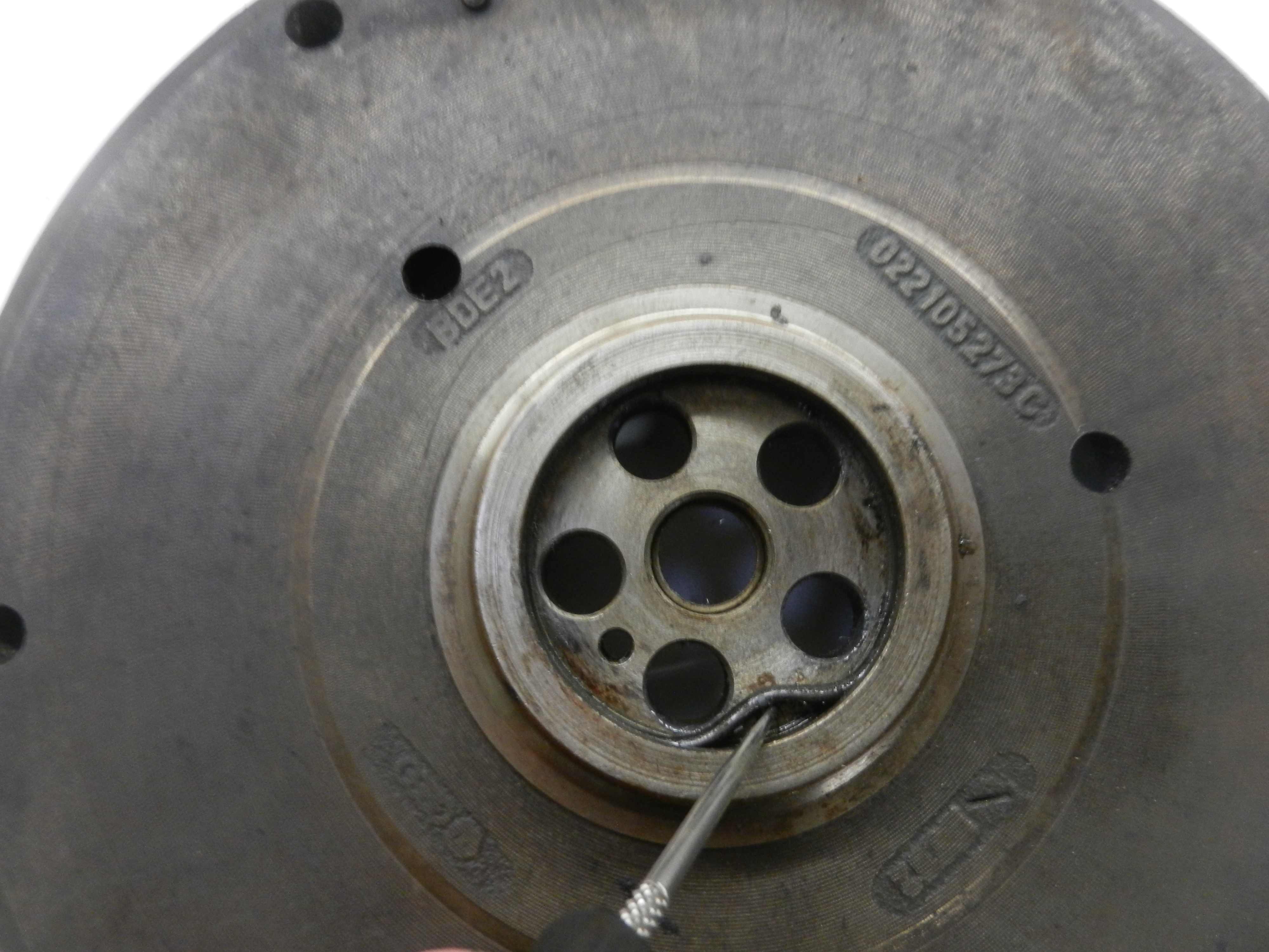

Before we install the flywheel, clean up the mating surfaces and remove the o ring if it is still there. ( don't forget to install the new o ring from the gasket set before final installation of the flywheel)
clean well, both mating surfaces.

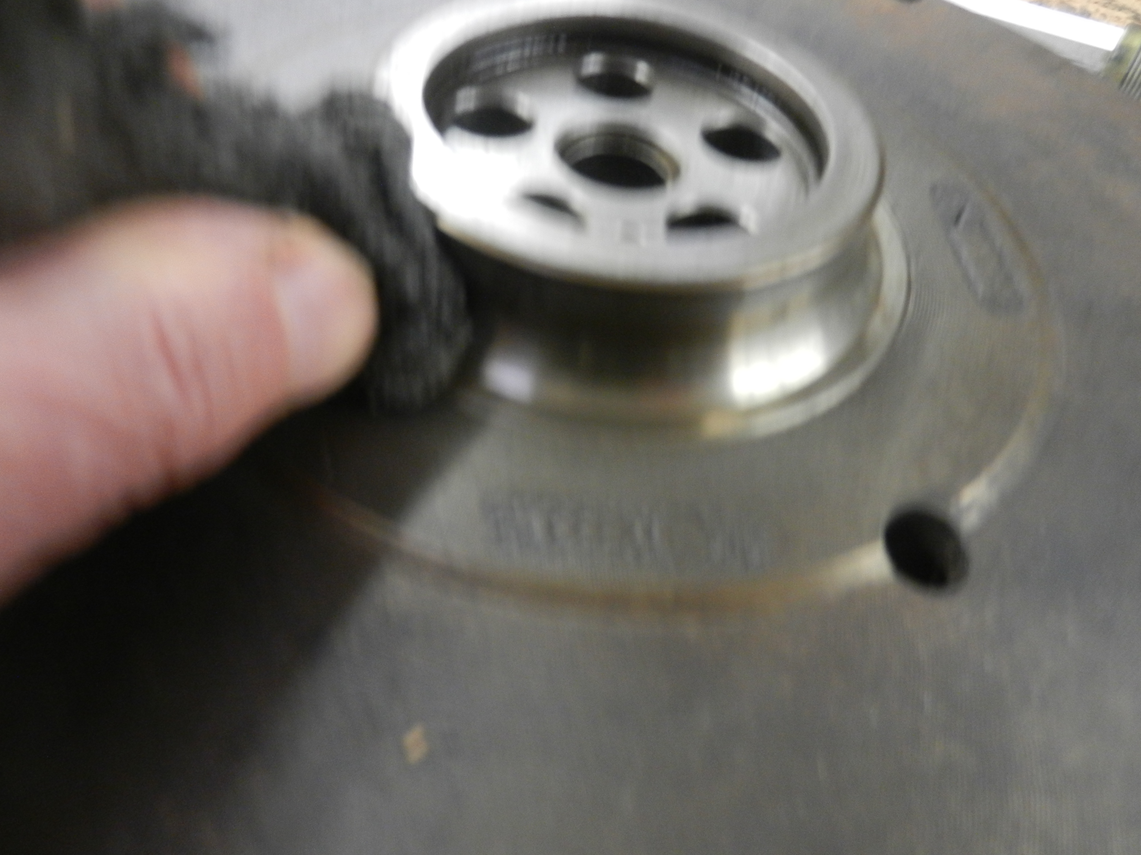

A good time to clean up and polish the nose that sits in the oil seal. Some fine steel wool works.
I like to polish this area. check for any grooves. Just make sure it's nice and smooth to avoid oil leaks.

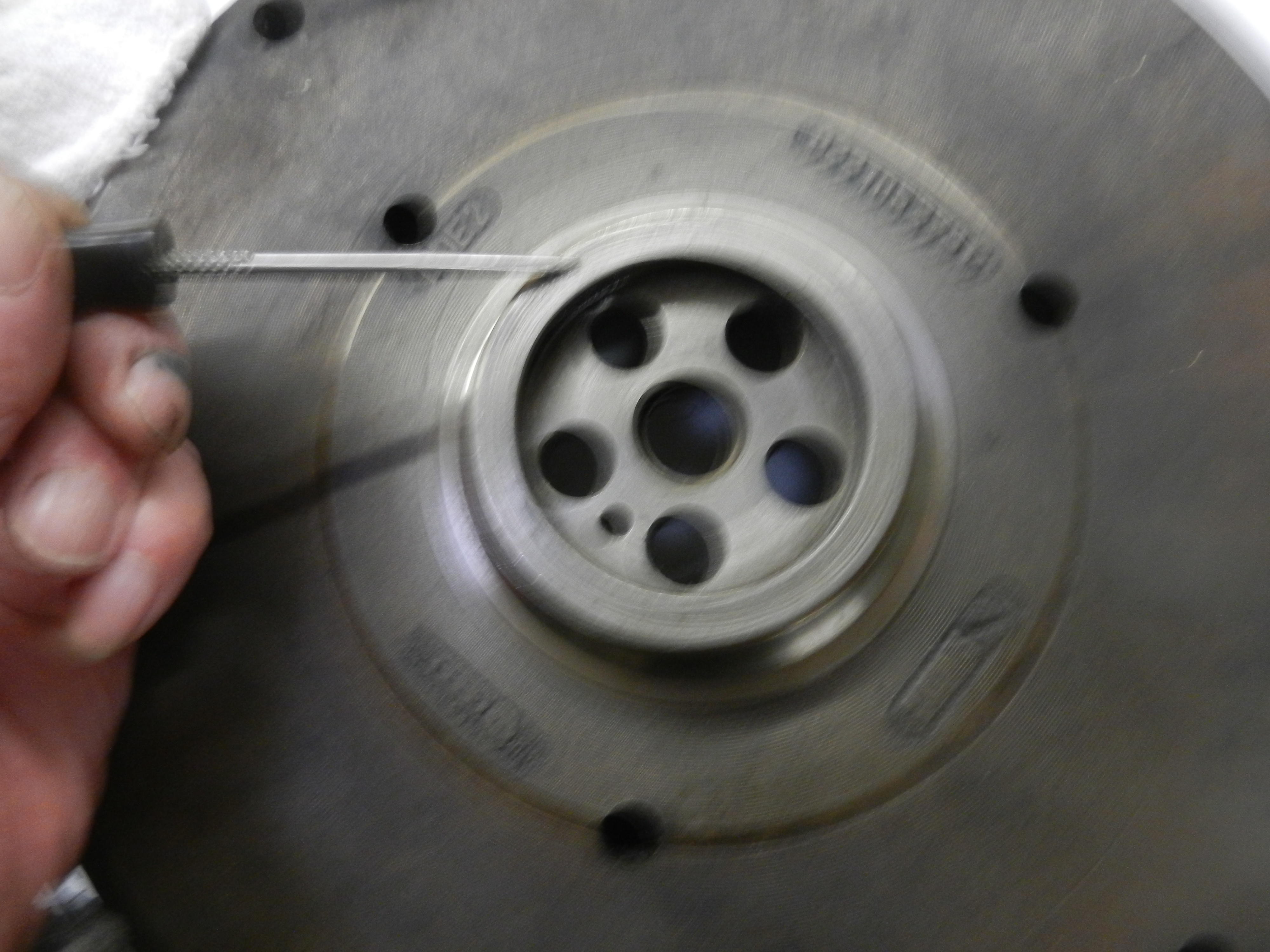

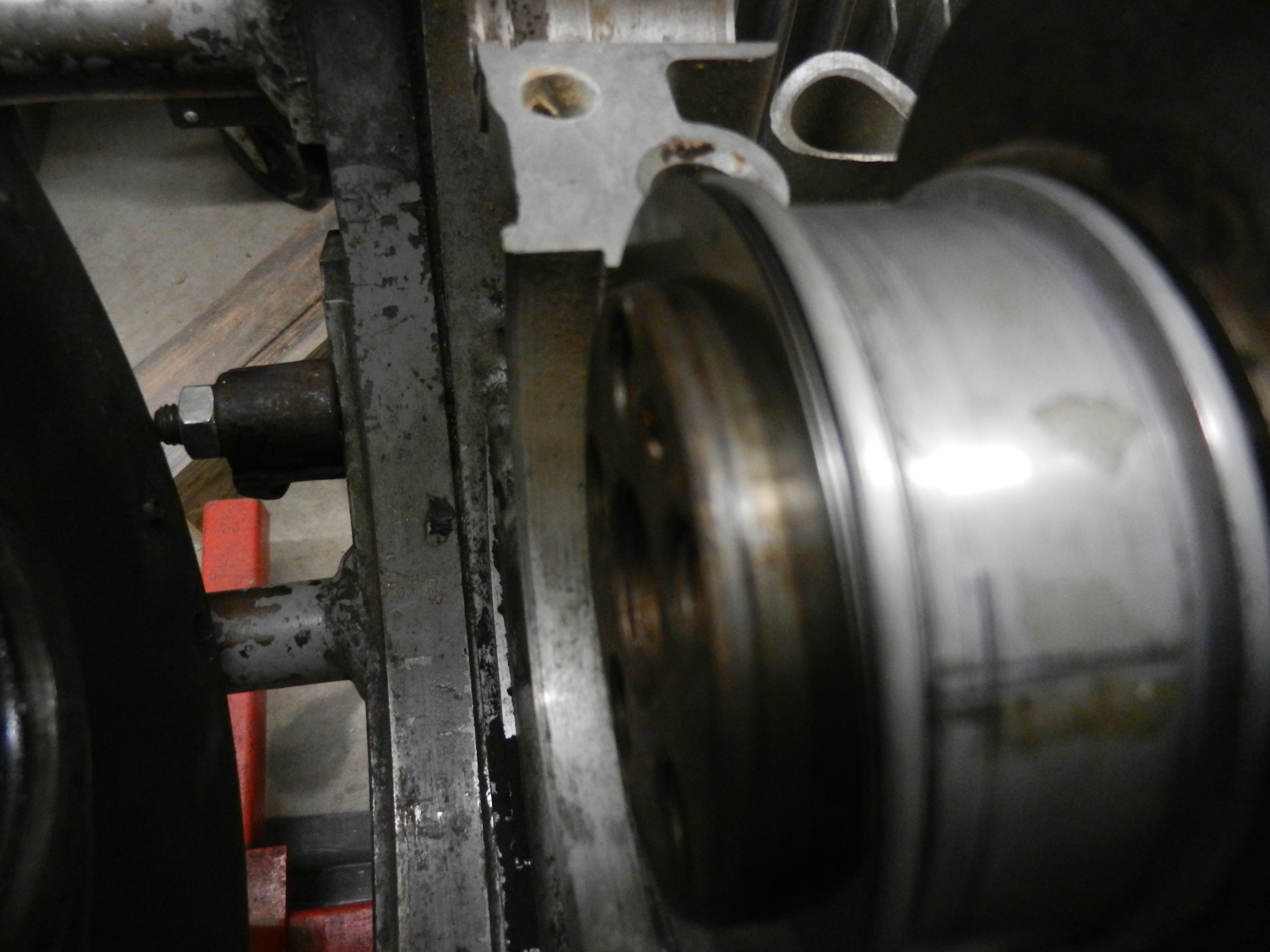

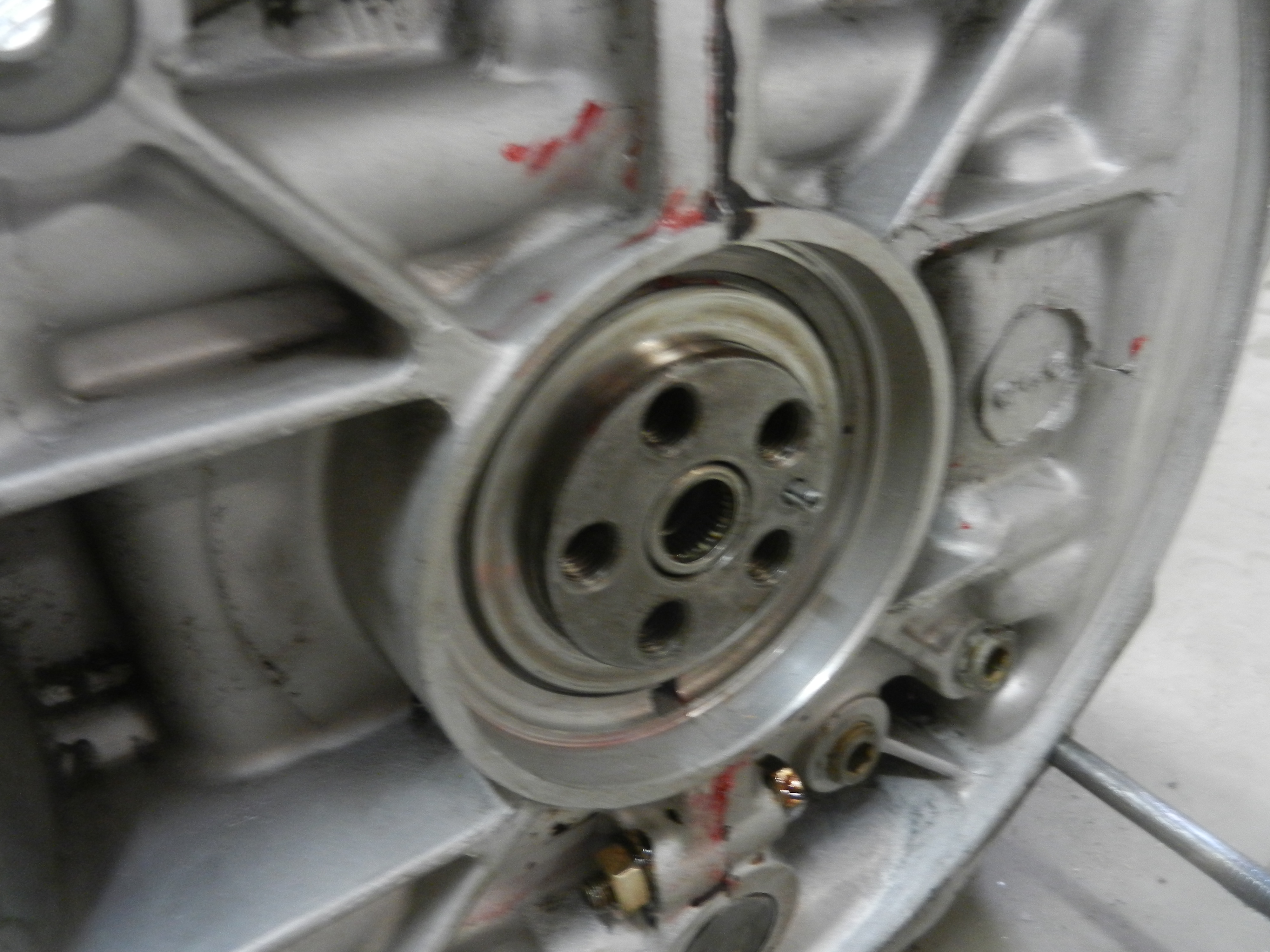

Install the flywheel and attempt to torque it. this can be difficult to get to 80 ft.lbs without a flywheel lock, A large flat blade screw driver in the flywheel teeth will work. Get the bolts as tight as you can. Even is more important than getting to actual torque spec. Getting a dial indicator mounted is also tricky when working with just the case half. So. we are going to use a feeler gauge here.
Here we have a nice tight .020in.
Now for some math.
we want to get to .004in (+- .001) to be at spec.
We have .027in in shims. .020in gap. deduct the .004 from the .020in. that we want for our desired end play = .016 shim needed for the 3rd shim. there is no .016 shim, so we use .015 and should end up with .005in for our end play.
You can work various combinations for this. But, in searching various suppliers, they cost between $8-$10 each.so use what you have and determine the shim you need before dropping $'s on a bunch of sizes.

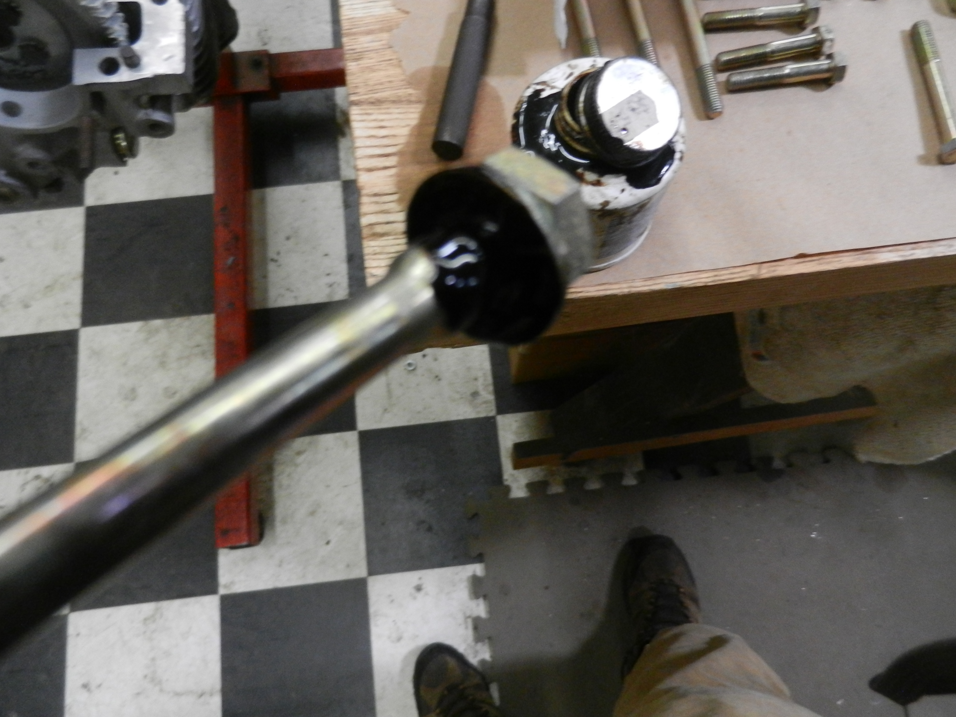

ALL the nuts and washers get a little Permatex to seal them up.

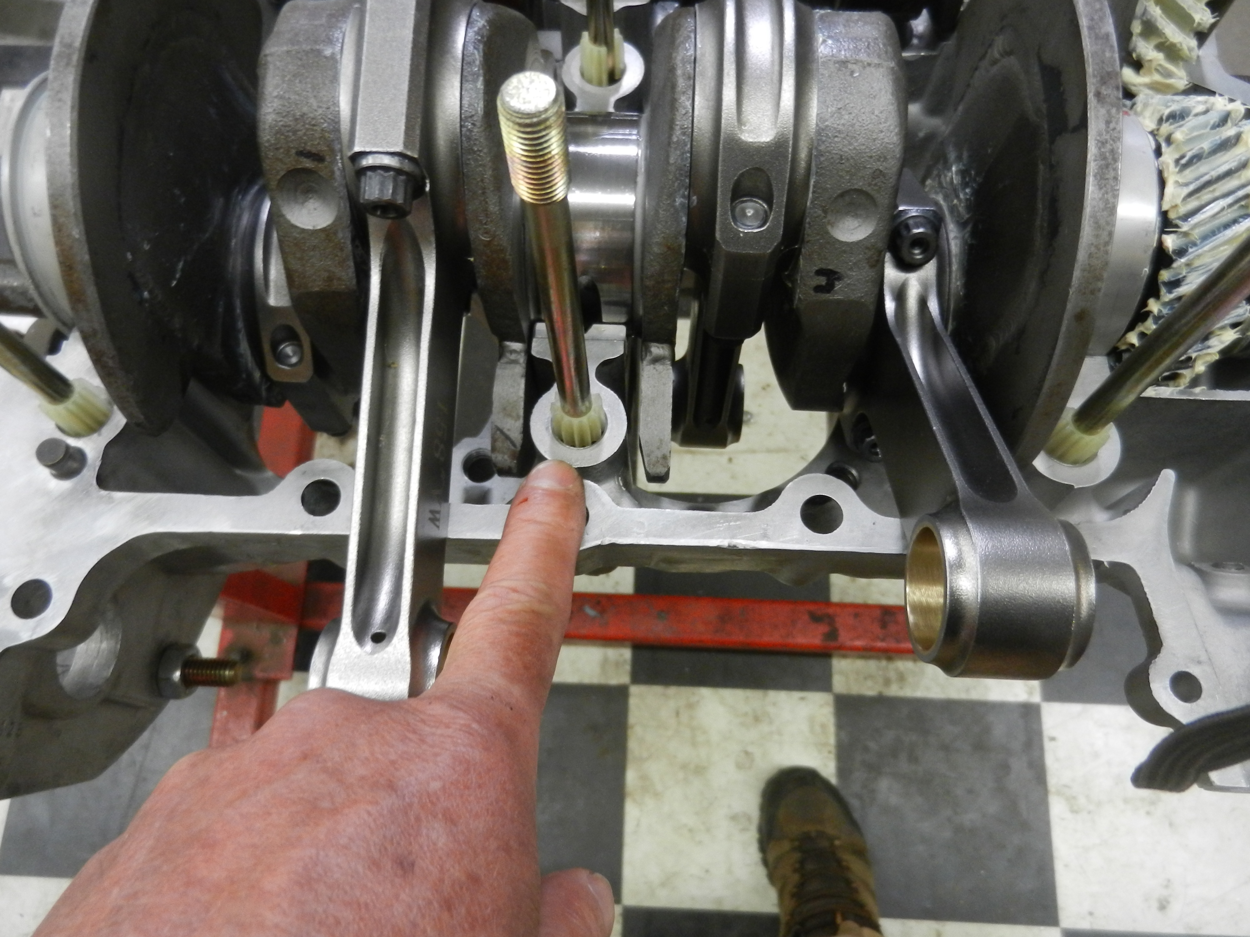

Type 4 main thru bolts get this to hold them in place,the bolts install from the case half that is now on it's side.

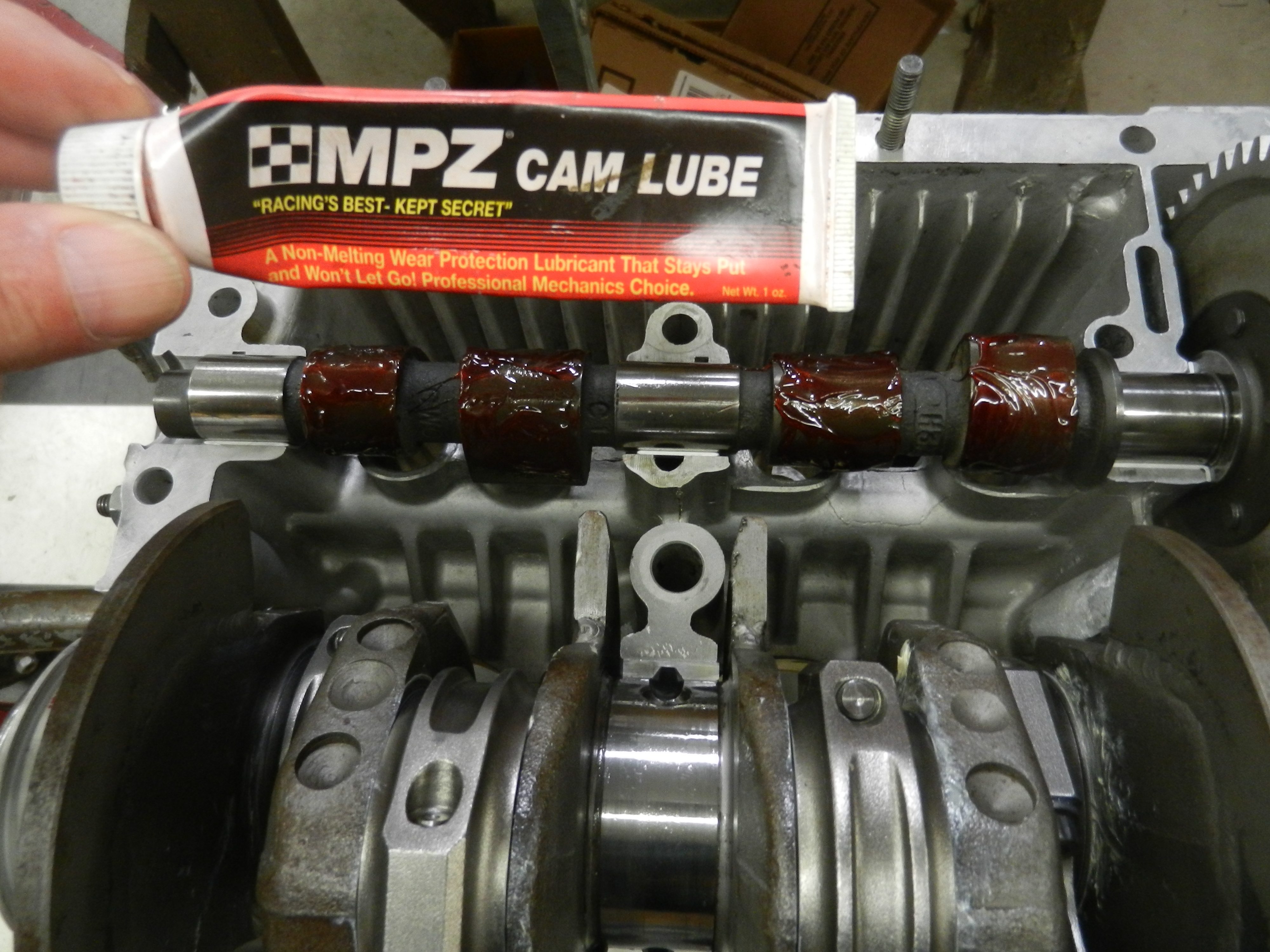

Some cam lube on the cam lobes. In the "old days" we used STP for this.

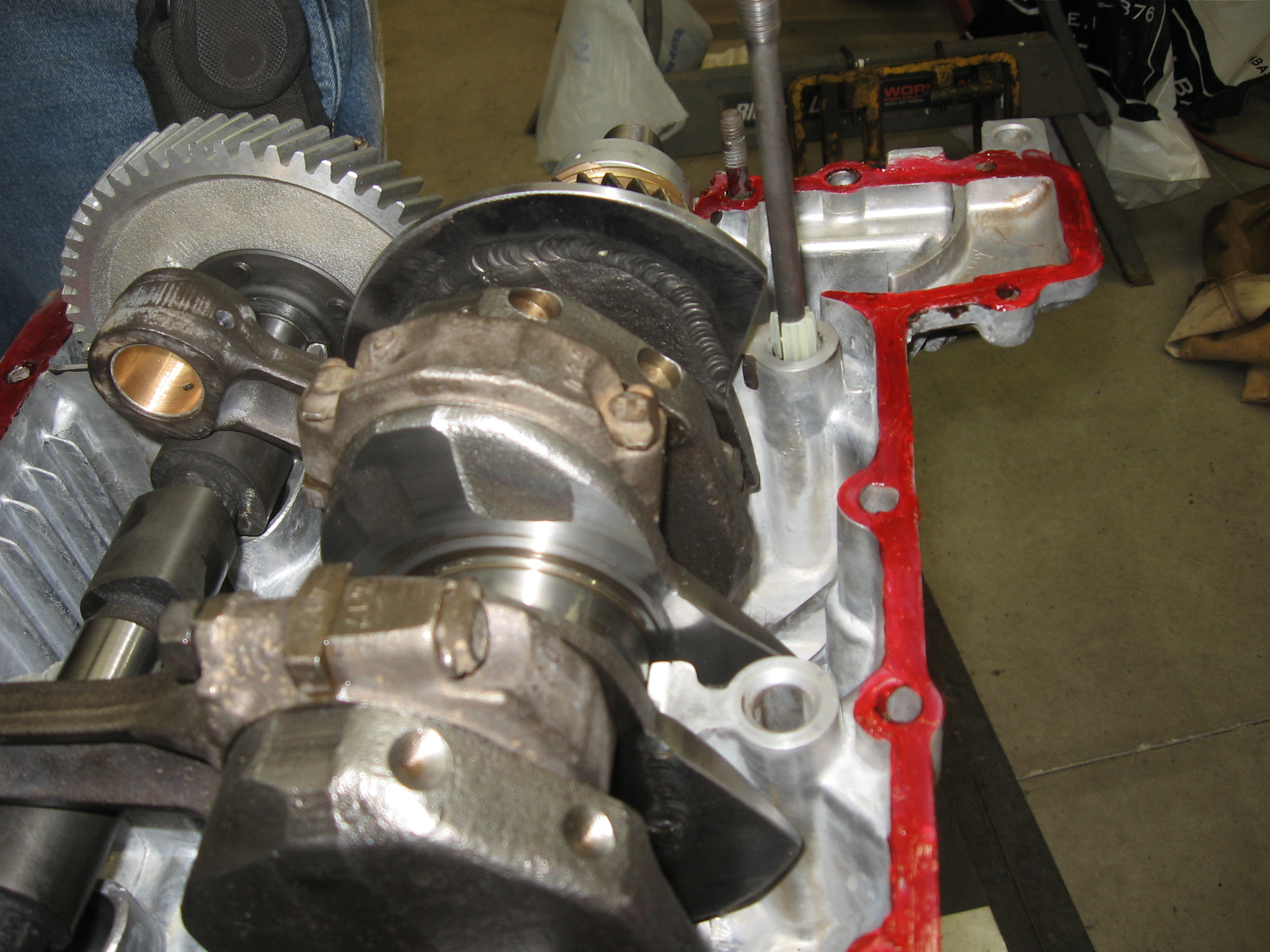

Now we can apply the case parting line sealer. As Bruce mentioned, there are many and they all work, except, NO RTV here. It builds too thick and does not allow for proper bearing crush. I have been using Locktite 518. One case half only.
You can smear it around.

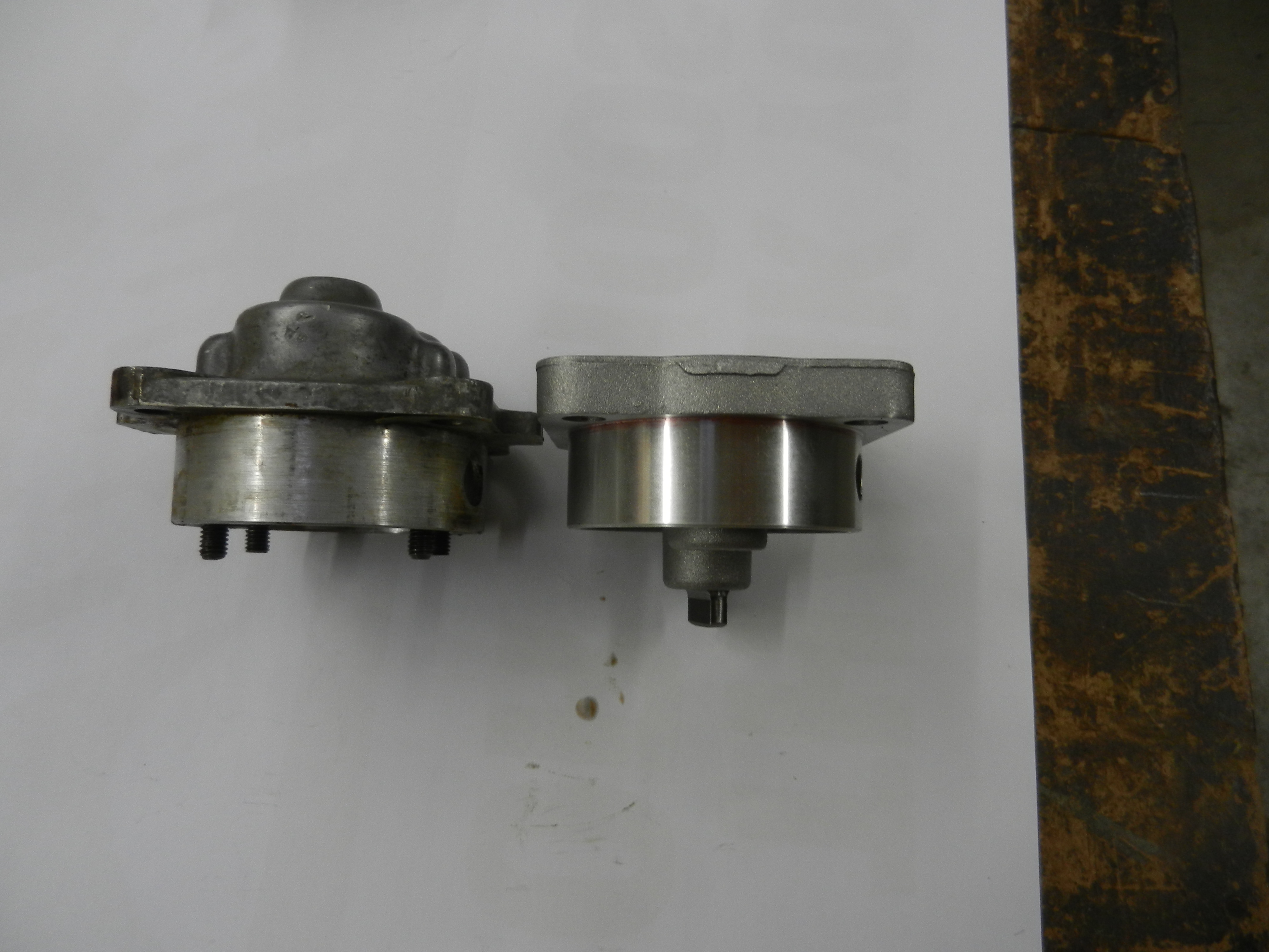

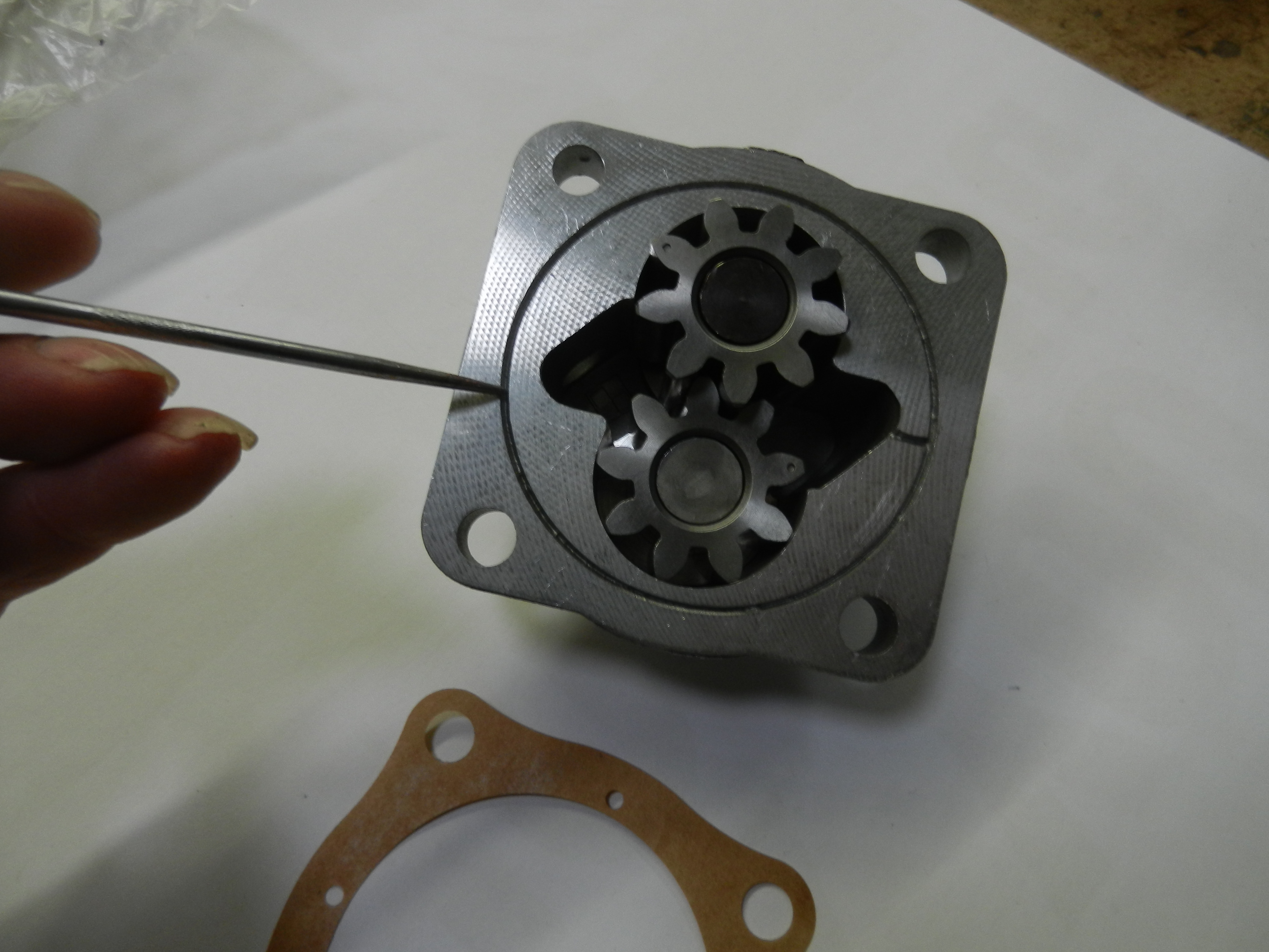

Jorge modifies the type 3 pump shaft to work with type 4 cam gear.
As you can see, the flange on the type 3 pump is considerably thicker than the stock type 4 pump. This requires installing longer studs.

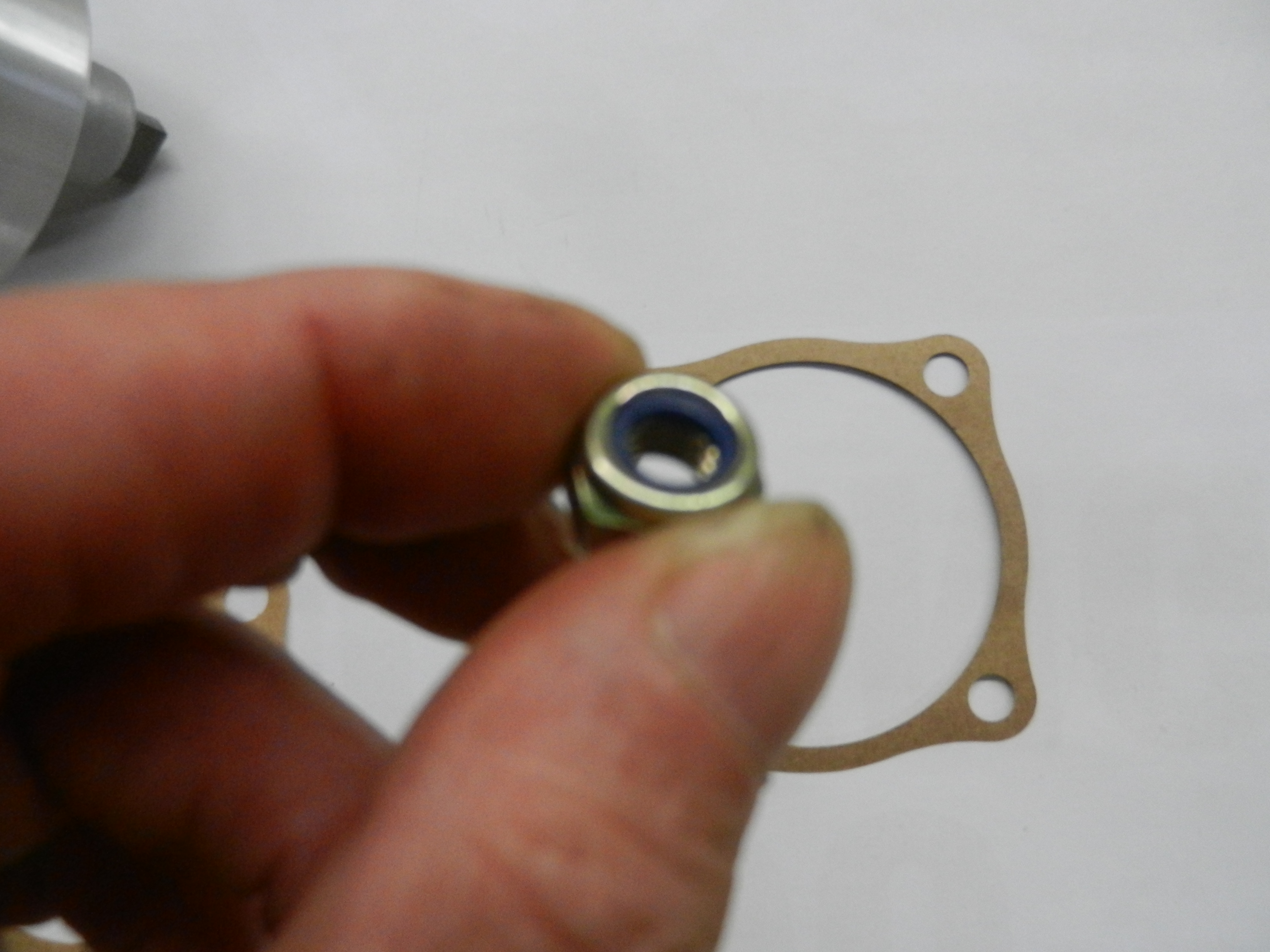

Installation is the same as type 1. A thin coat of permatex 3H on the gaskets, or if you choose,or hi tack, or gasket shellac. Just a thin coat. Be careful to not get sealer in the oil groove in the pump or the holes in the gasket.
Also, a thin bead of Yamabond around where the pump body to ensure no leaks.
Pack the gears and the pump body with white grease. This helps priming the pump to get oil pressure quickly. I also pump some oil down the oil pressure switch hole prior to initial turn over.
Install the cover gasket and cover and coat the stud threads with permatex. I also like to use a sealing nut.

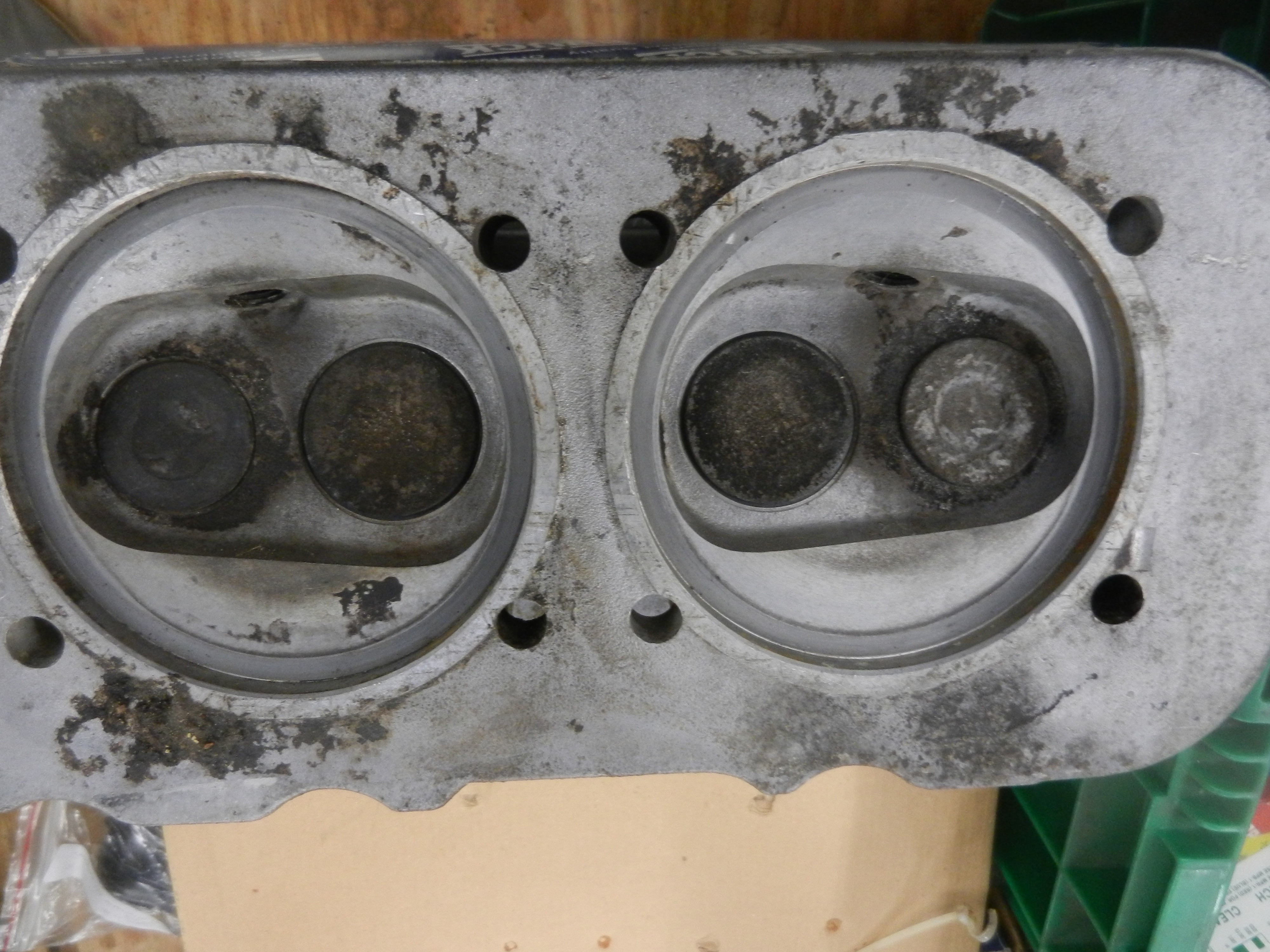

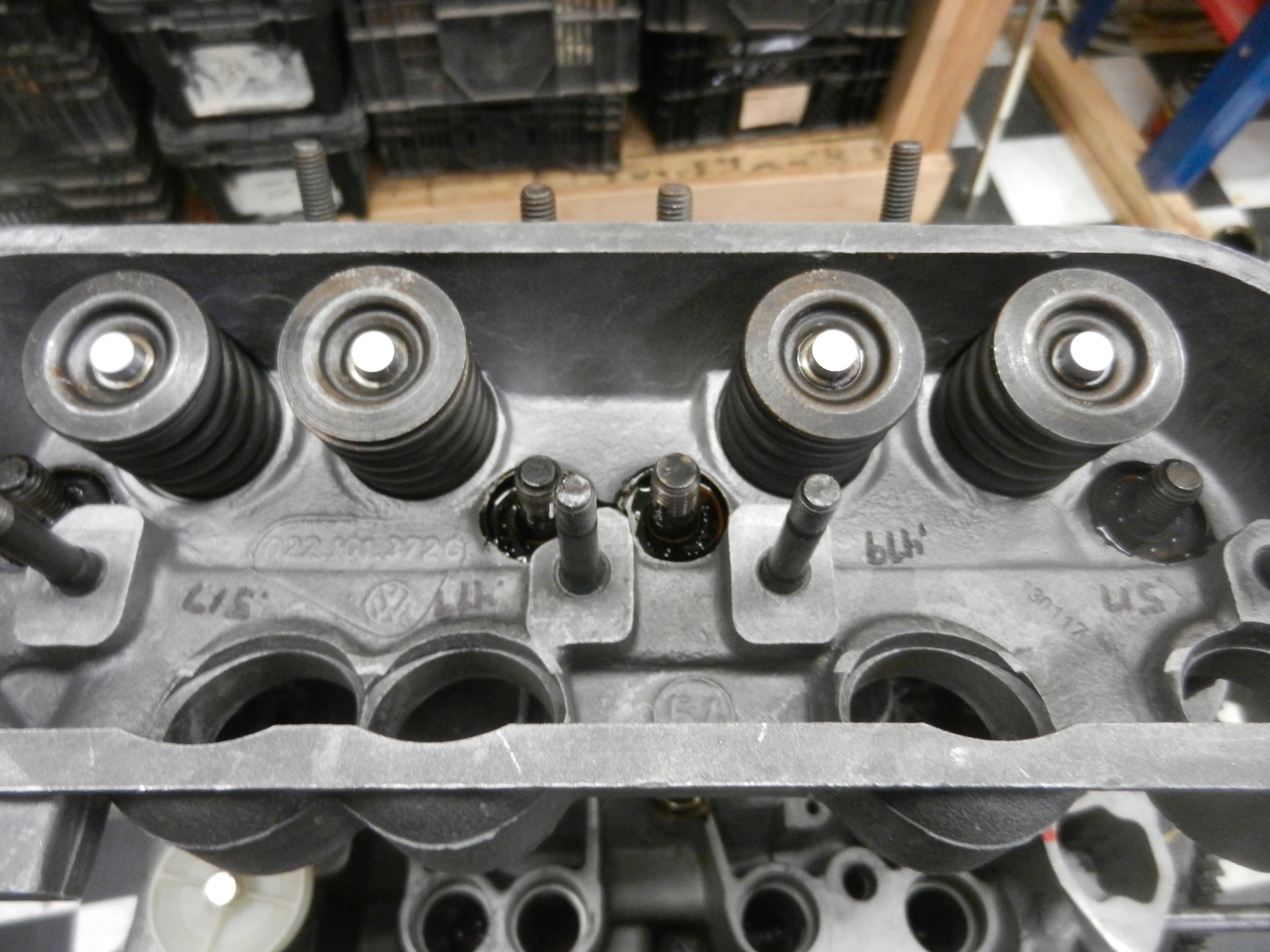

Moving on. I will spend a minute on the heads, which we will get back to later. I acquired these heads 15 or 20 years ago
and set the aside for this future build. Short story, they were part of a gift to me from a customer. They came from Mark Stephens High performance around the time they were closing the shop. the first thing I noticed, along with the port and polish work, was the chamber work AND, the head cc. 61cc as opposed to the stock of around 55cc.
Stock 2 liter head.
My head.

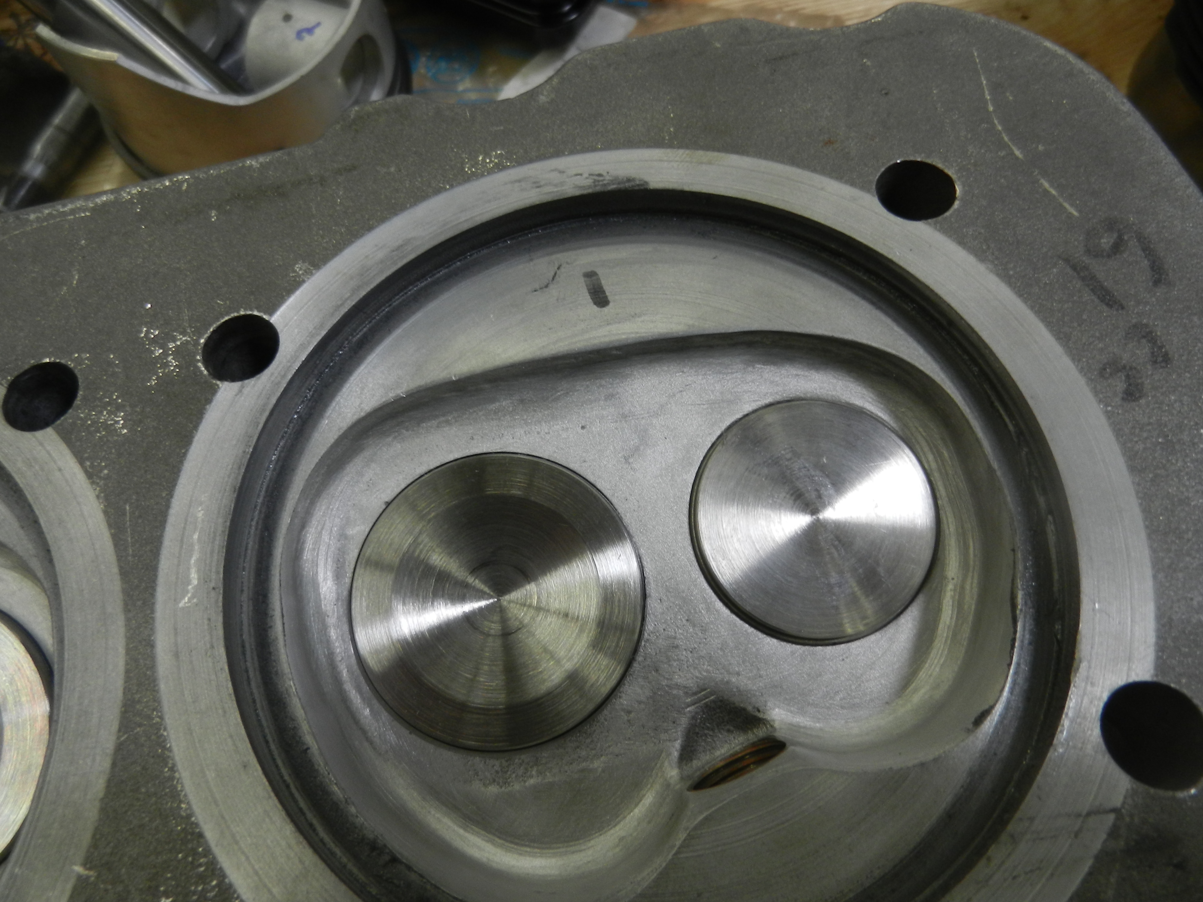

My original intent was to use stock 94mm 2L pistons which have a 7cc dish. plugging the 61cc head chamber volume along with my desired deck ht. of .035 to .40, I realized that my comp ration would be too low, under 7:1
So, while the heads were sent off to Delzani's to install my new stainless steel valves and the valve springs supplied by the cam manufacture, I explored my options.
Option 1 was to use 914 Euro spec 94mm flat top pistons.
This pic is not the 94mm flat top but shows the deck ht. .001 not clamped down. .000 was the measurement clamped.
This was an unintended result of decking the case. But worked, as I could now choose the appropriate shim to get my desired deck ht. and comp ratio.Assuming a .030 deck shim. I came up with 8.4:1 comp ratio. acceptable, but I tend to be conservative when it comes to comp ratio for a bus. .040 deck shim got me 8.2:1. Again acceptable but I was shooting for under 8:1
Option 2 was to use 96mm NPR dished pistons. Using a .040 shim, for .040 deck ht( The max I would accept), I ended up at 7.72:1 comp ratio. Larger displacement 2.1 liter and a comp ratio I can live with.
Just a word on deck ht. In addition to being part of the comp ratio formula, There is a happy number. Too low deck ht and you run into the problem of the piston hitting the bottom of the combustion camber, BAD. Too much deck ht and you have an issue with "squish" The goal is to have the combustion energy directed to the center of the combustion camber and the center of the piston. Too much deck ht and too much of this energy extends to the outer area of the chamber and the pistons putting more stress on the rings and the sealing area between the cylinder and the head.
Mark Stephens determined that somewhere between .020 and .025 deck ht became 0 on fully warmed aircooled VW motor. Making .030 to .040 ideal. This means that on a fully warmed engine, the comp ratio is going to be higher than your cold calculations. Also, eventual carbon build up decreases the chamber volume which also increase you comp ratio. This is why I tend to be conservative on comp ratio and like to be a bit under 8:1.
We will get back to this when we get back to the heads. Next up will be piston prep.

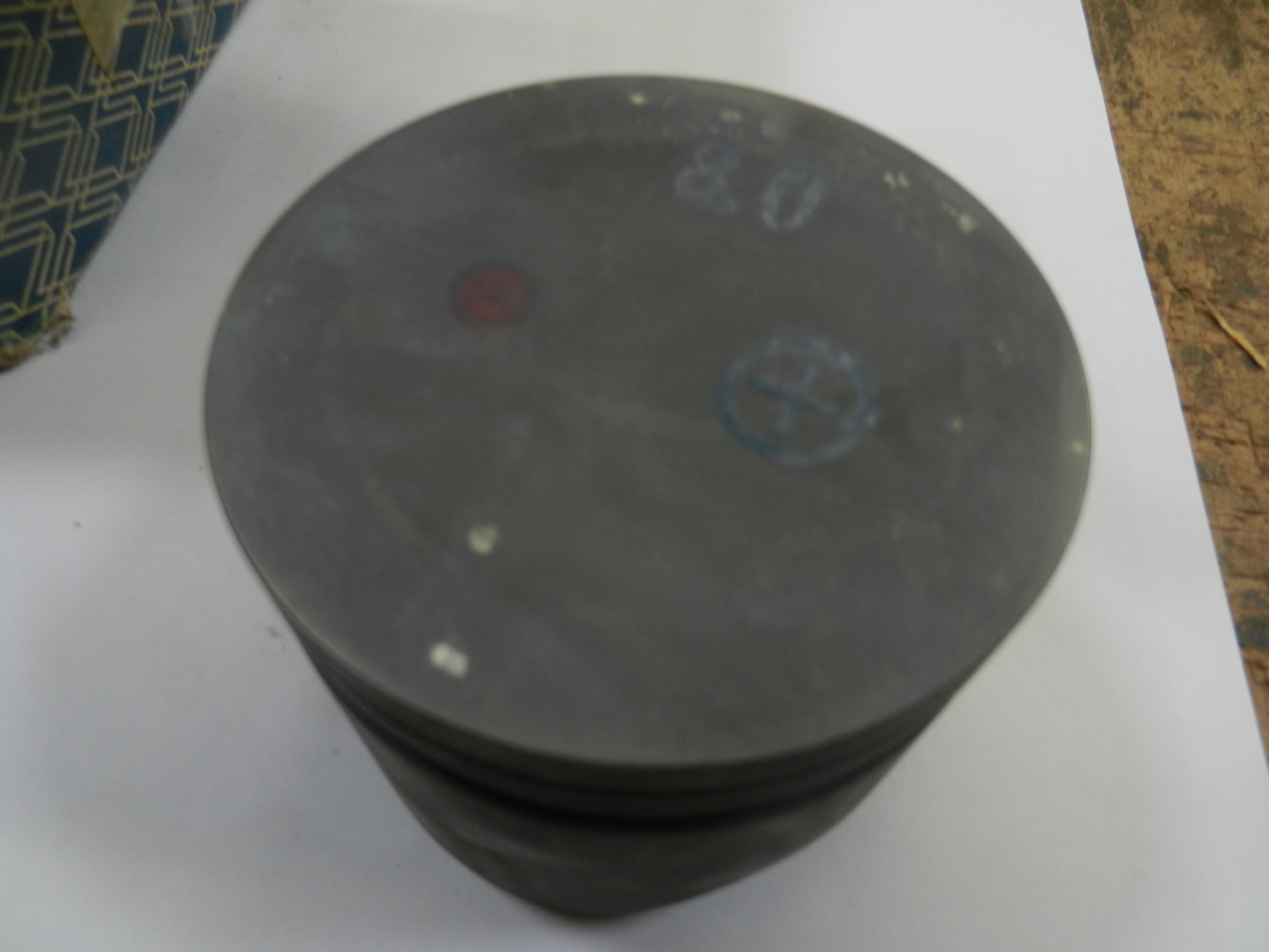

First thing, we are going to weigh them. Past experience with the NPR pistons, sadly no longer available, is that they are within 1 gram of each other. This held true for this set all 4 at 726 grams.

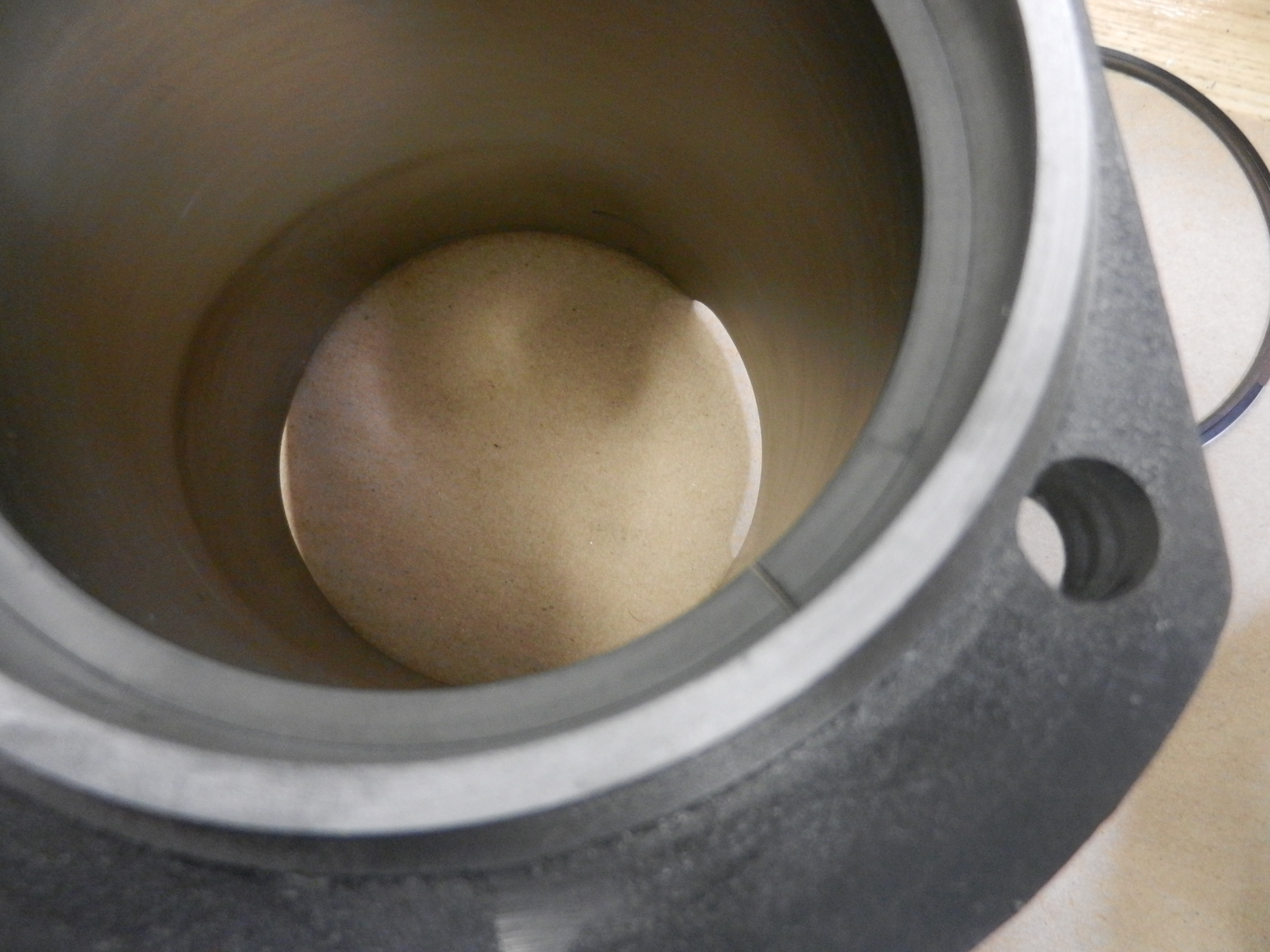

Next I like to put a little valve grinding compound around the rim of the cylinder. Then place the cylinder in the head
and rotate the cylinder back and forth, lapping the surfaces.
Wipe it well and wash both surfaces thoughoughly with brake clean.
Also, wipe down the inside cylinder walls. I like to scrub them in a bucket with blue Dawn. then clean again with brake clean. This step is important as there is a thin film from the factory to prevent rust.

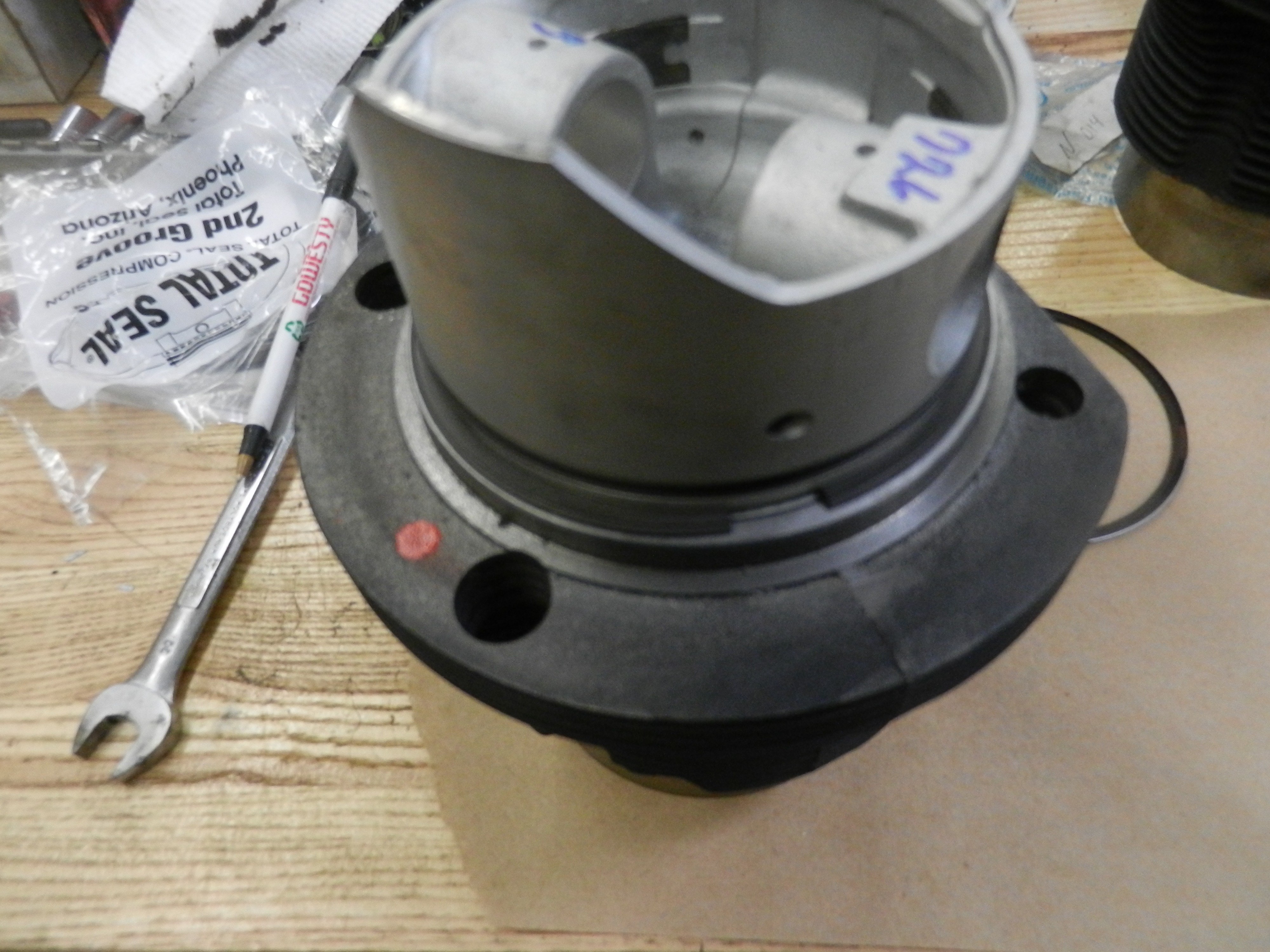

Next, we will remove the rings from the piston. I do the same cleaning with them as with the cylinders. It is best to do one piston at a time so you don't mix the top and middle ring. Then, wipe the rings with brake clean.
Since this set came with rings, there should be no need to to check some measurements. But, we are going to do it anyway. This MUST be done if you are re ringing a set of pistons.
Install the ring ( top or bottom) in the cylinder and square it with the piston.
Using a feeler gauge, measure the gap. Spec for the top ring is .014 -.022. We are .017

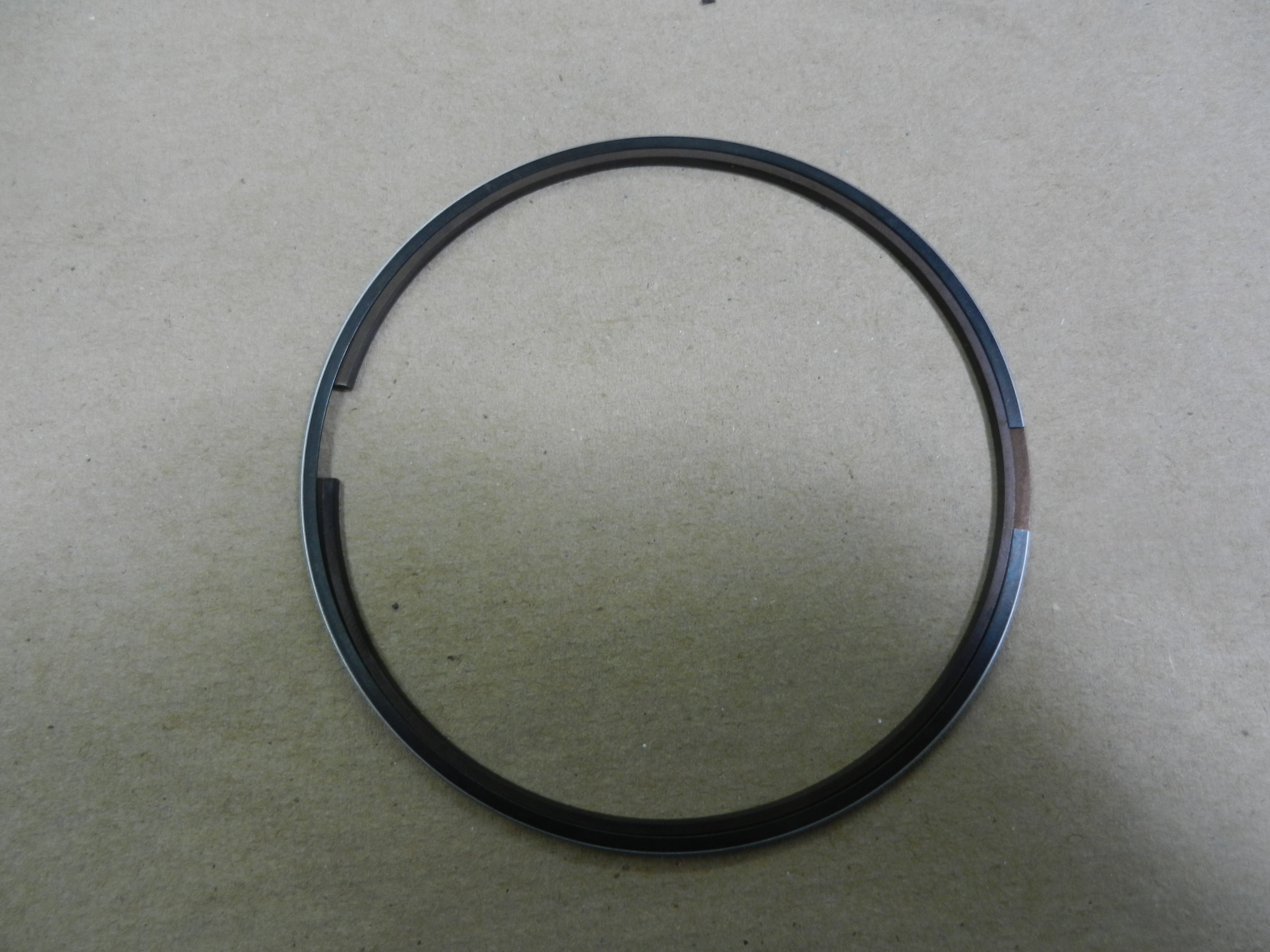

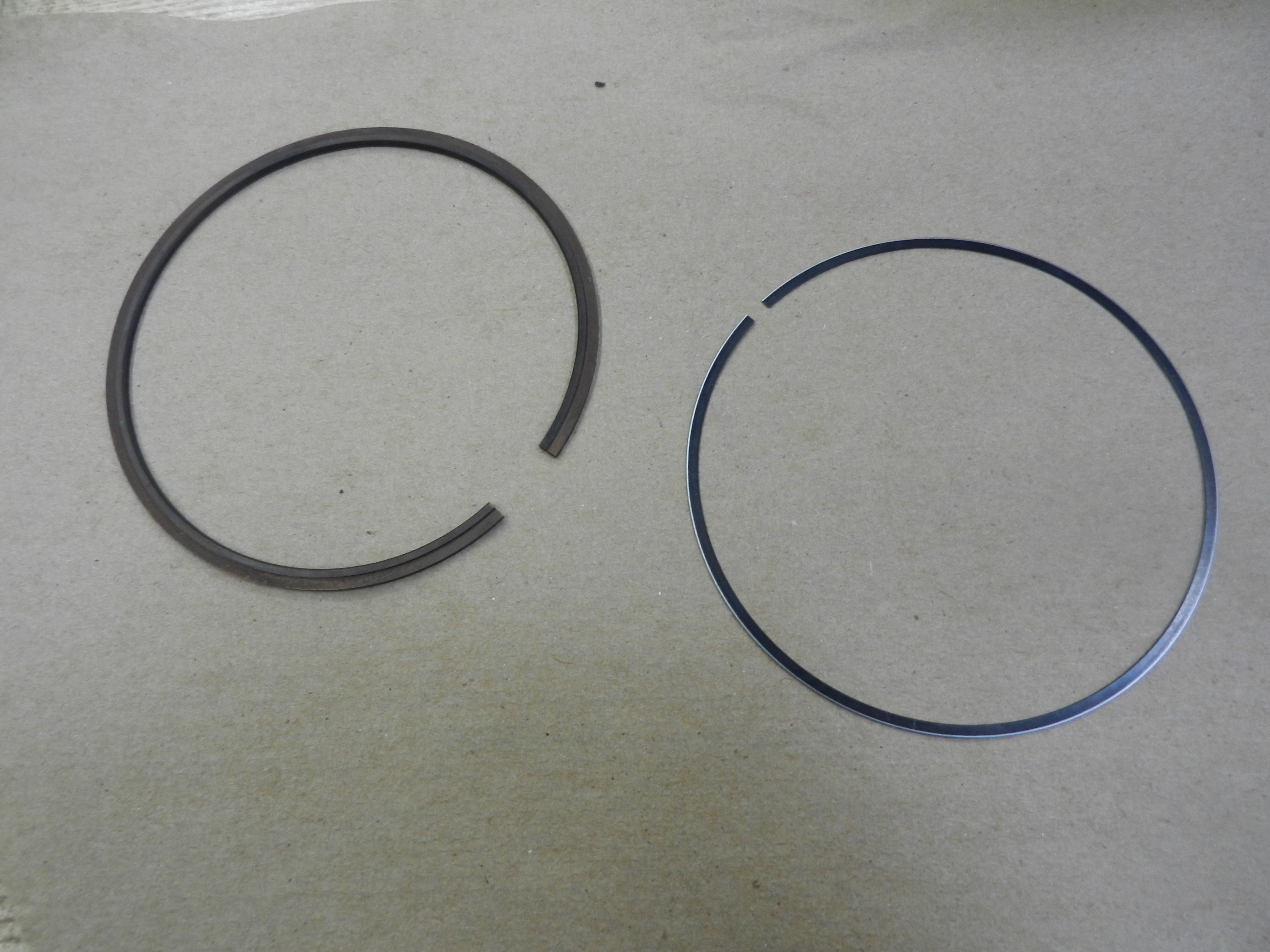

Do the same for the middle ring. spec is .012 - .022. I did not do this as I am using Total Seal gapless middle rings.
The Total Seal gapless middle ring Is a 2 piece ring with a machined ring and a rail ring.
When assembled, with the gaps at 180 degrees, they form a gapless ring.
A leakdown test will show the cylinder holding 99% using these rings.

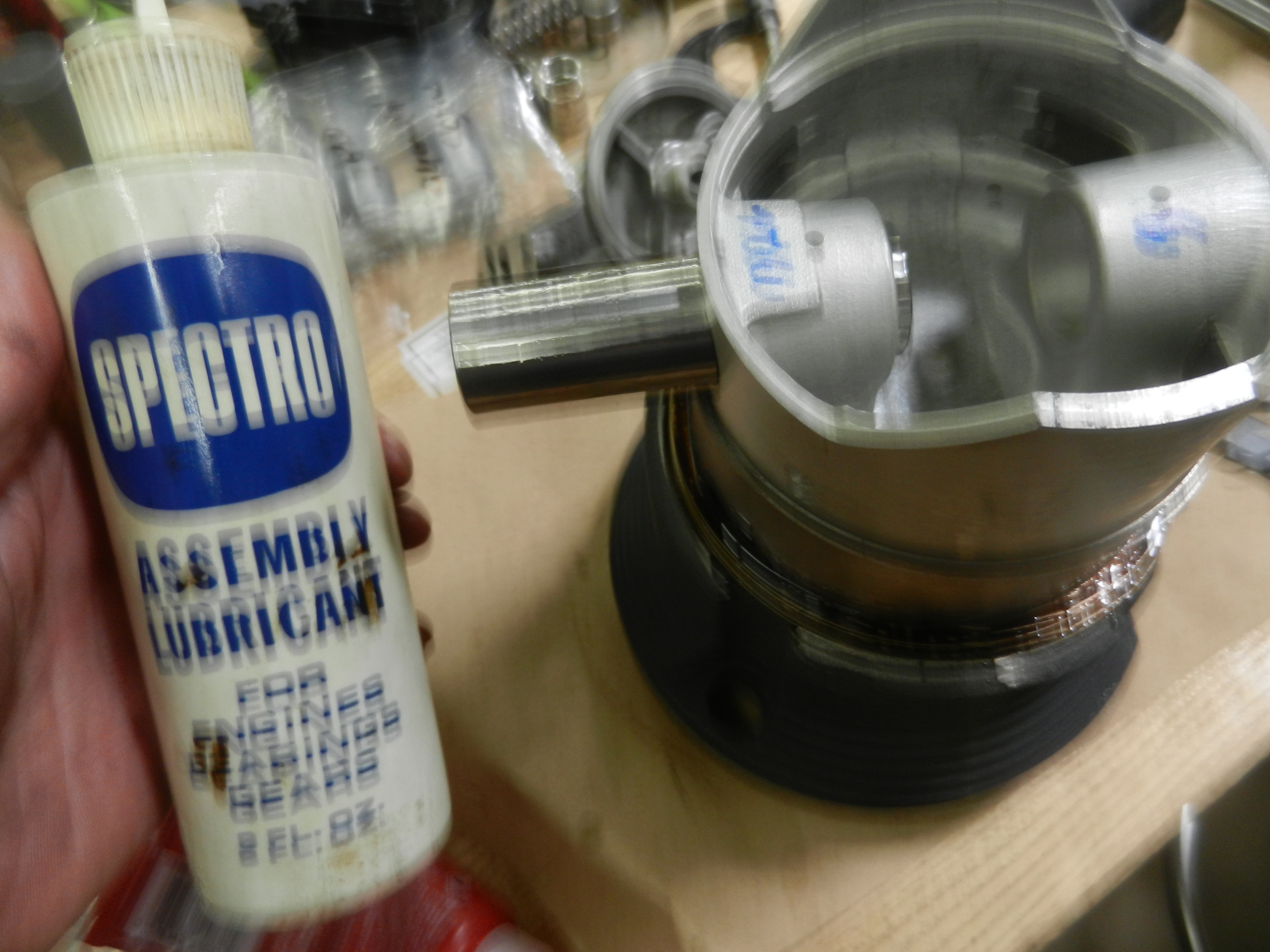

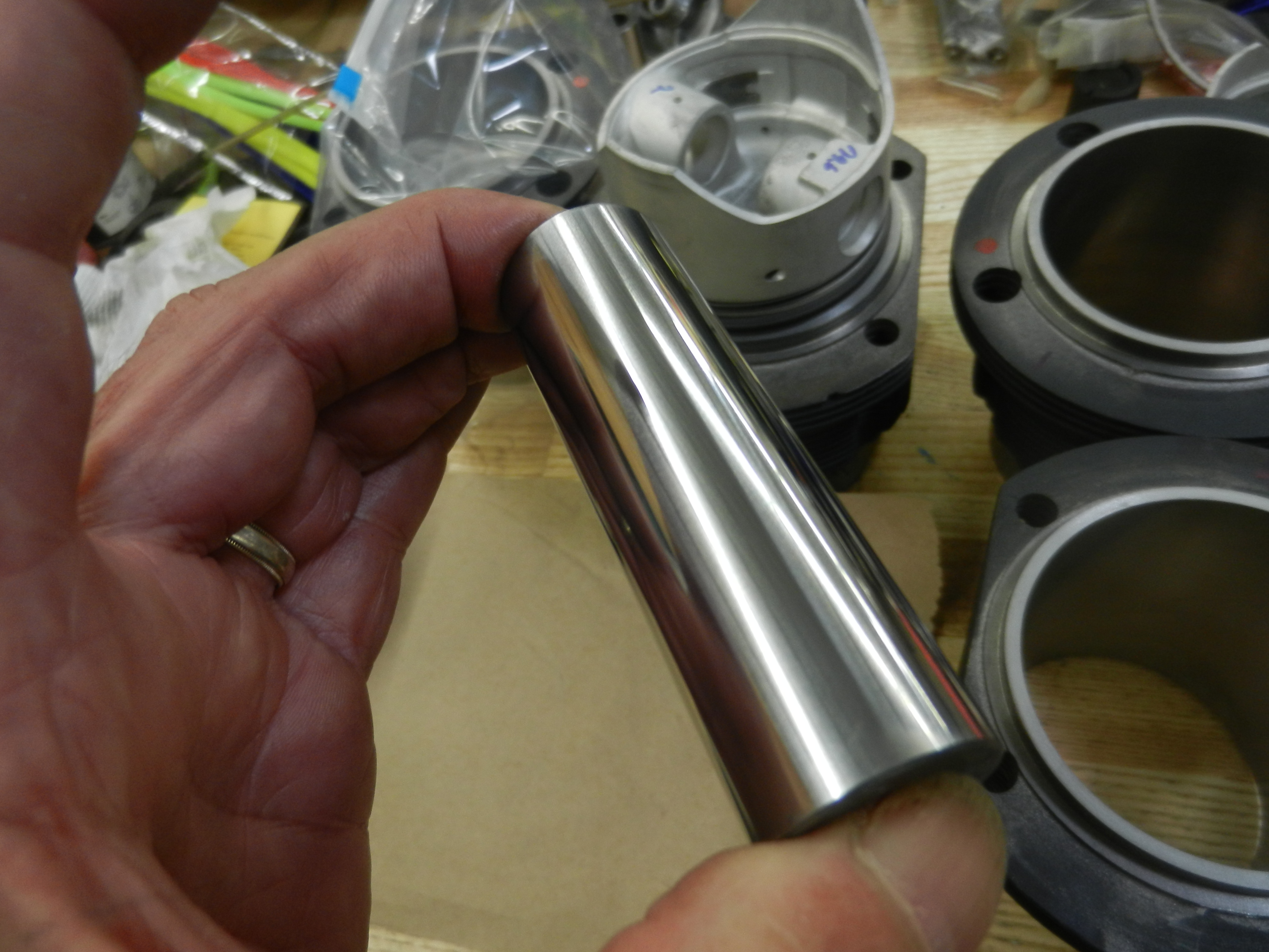

a couple of hints: like all the other parts, wash the piston pins with brake clean to remove any film. I like to polish them.

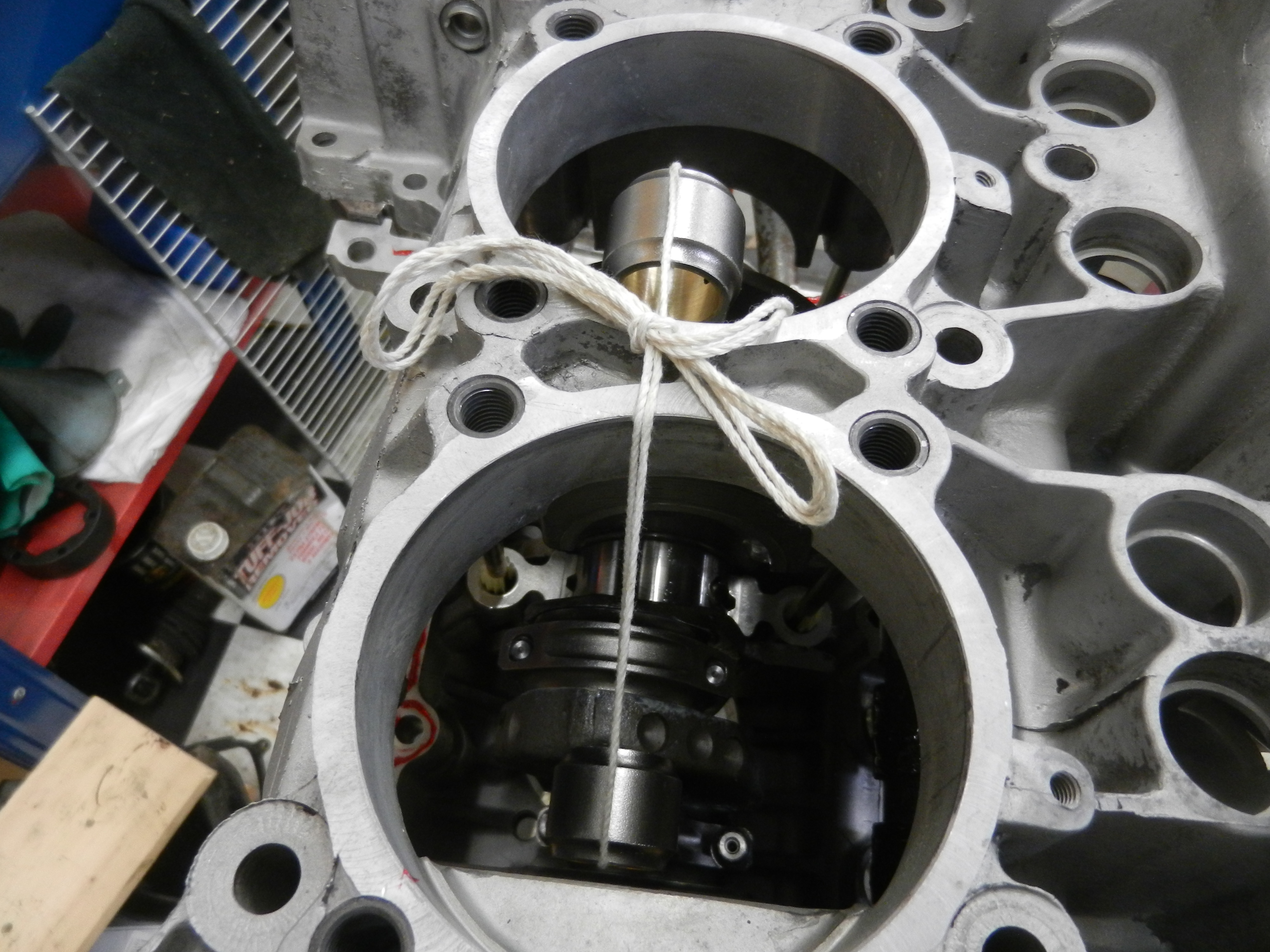

It's a good idea to number the pistons and cylinders 1-4. Before you assemble then you need to note their installation sequence for the type 4. arrow on the piston pointing toward the flywheel.
I usually do the #1&2 side first. install the circlip in the side of the piston on the flywheel side. The pin needs to install from the #2 side,as the flange on the flywheel side will not allow for the pin to install from that side.
For #2, install the clip on the #1 side and install the pin from the opposite side.
Stuff a rag in the cylinder hole so when you drop the second clip it won't fall into the case.
Here's the assembly ready to install on the rod. Some permatex at the cylinder base, then the shim, and another thin coat of permatex. Lube the pin with some assembly lube.

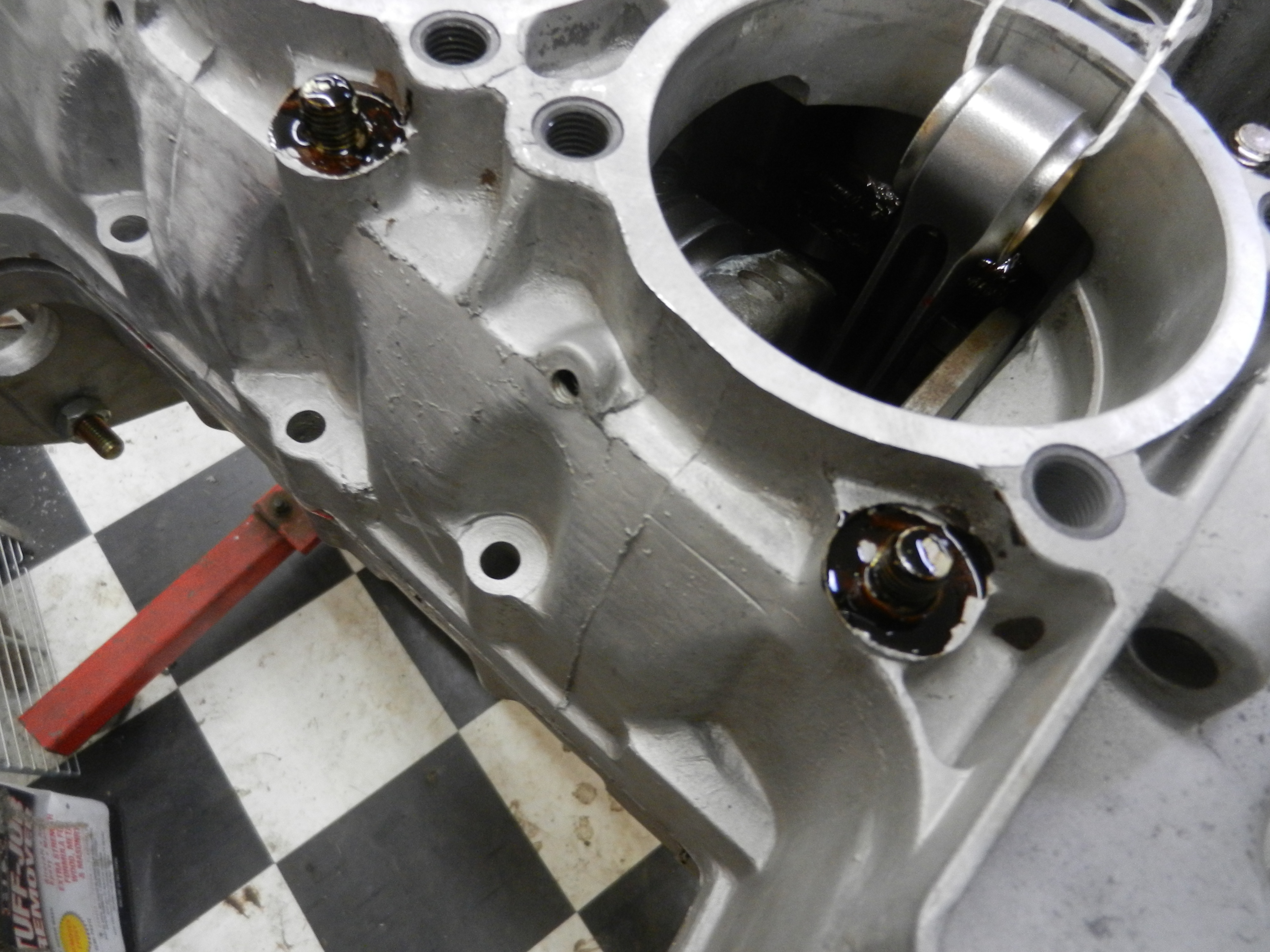

Despite a good pic. ( I completed this build months ago and am trying to recreate for this thread) we now have a long block, less rocker and push rod assembly.

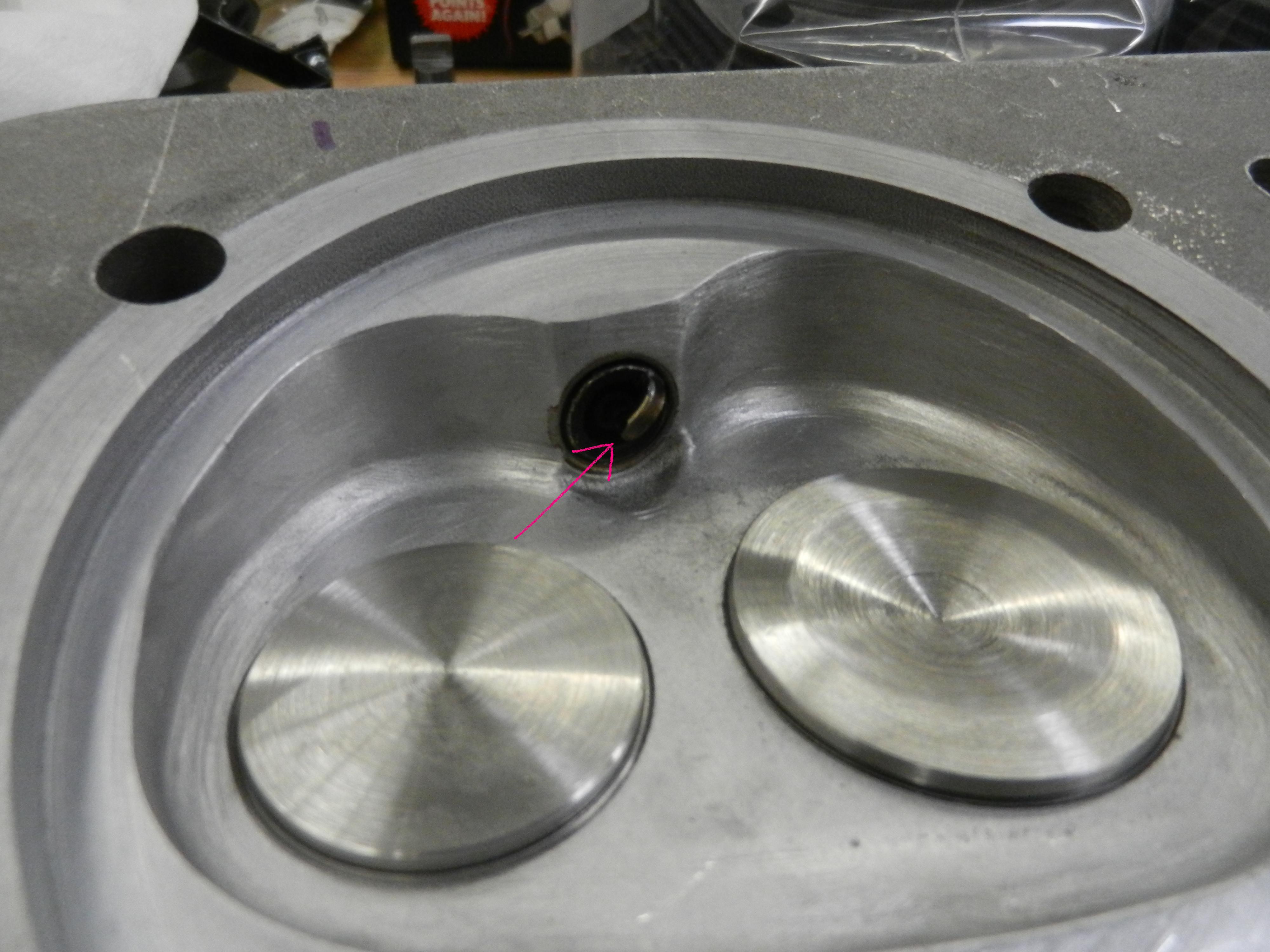

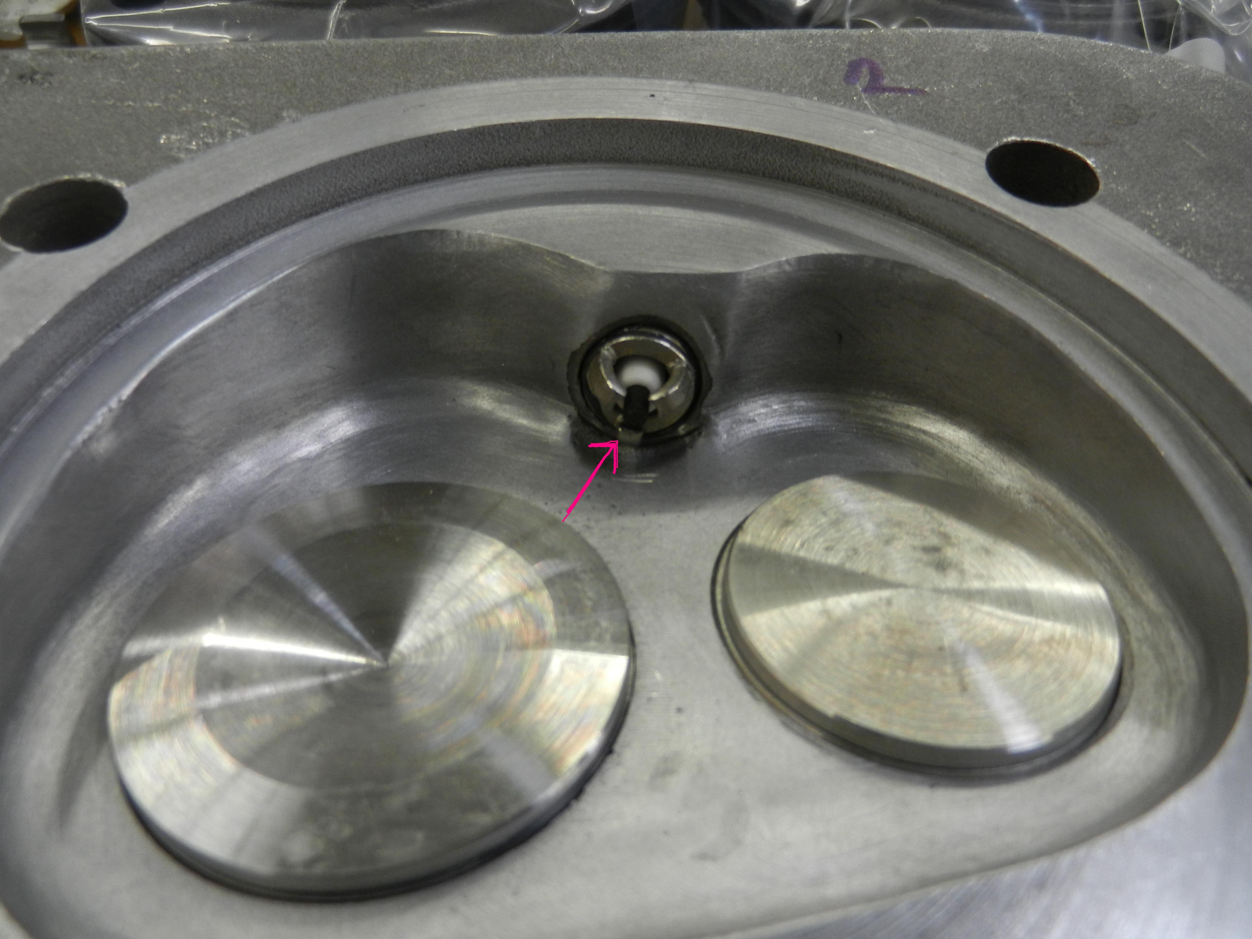

Just a note on the heads and spark plugs.

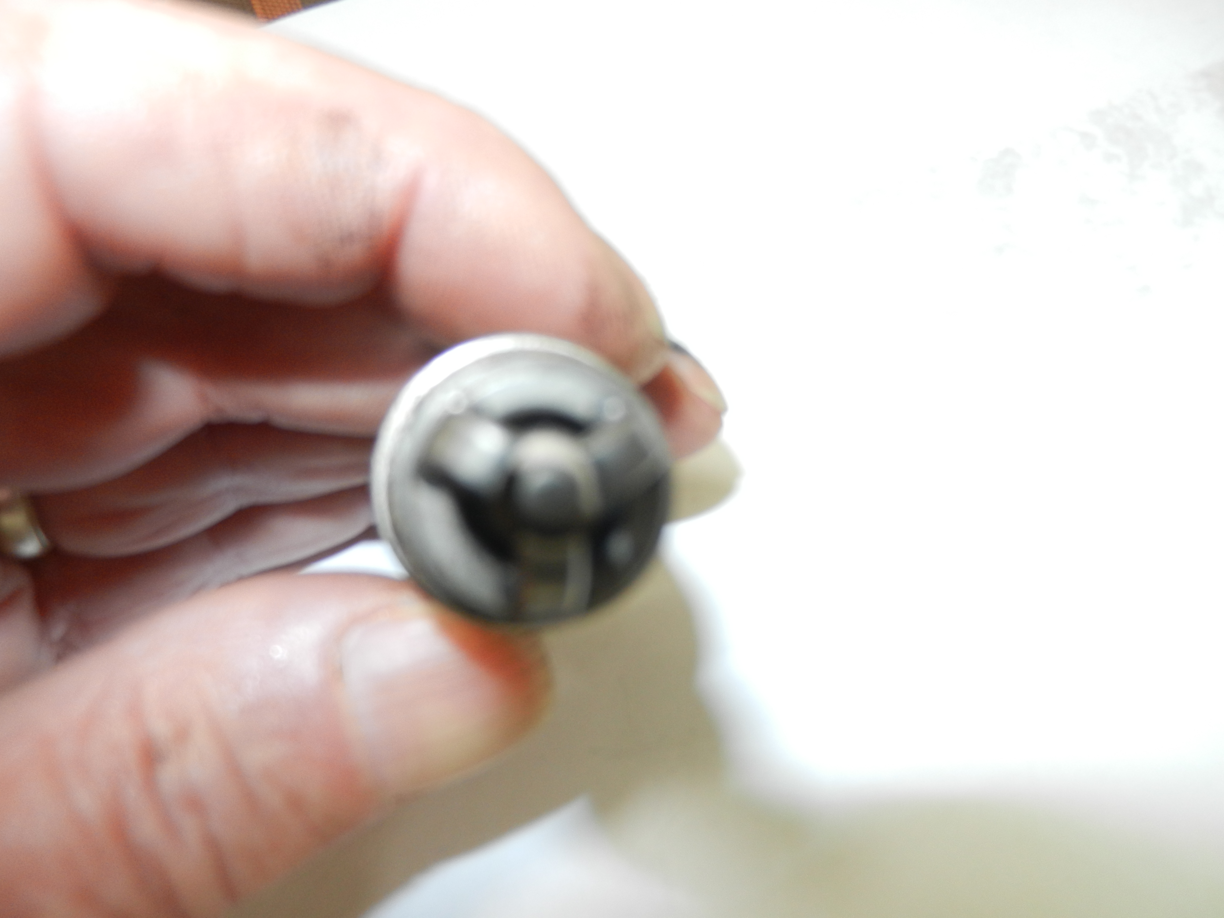

This is a standard spark plug. Notice the gap. It is directing the spark towards the side of the chamber.
An old racers trick was to shim the plug so that the gap was pointed towards the center of the chamber.
We don't need to do that.Bosch made a 3 electrode plug W8DTC, Which they stopped making. But Mick at Micks' 440 465 1985 can still get them. also available i step hotter W7dtc.
As you can see, this plug directs the spark towards the center of the chamber, which is what we want.
