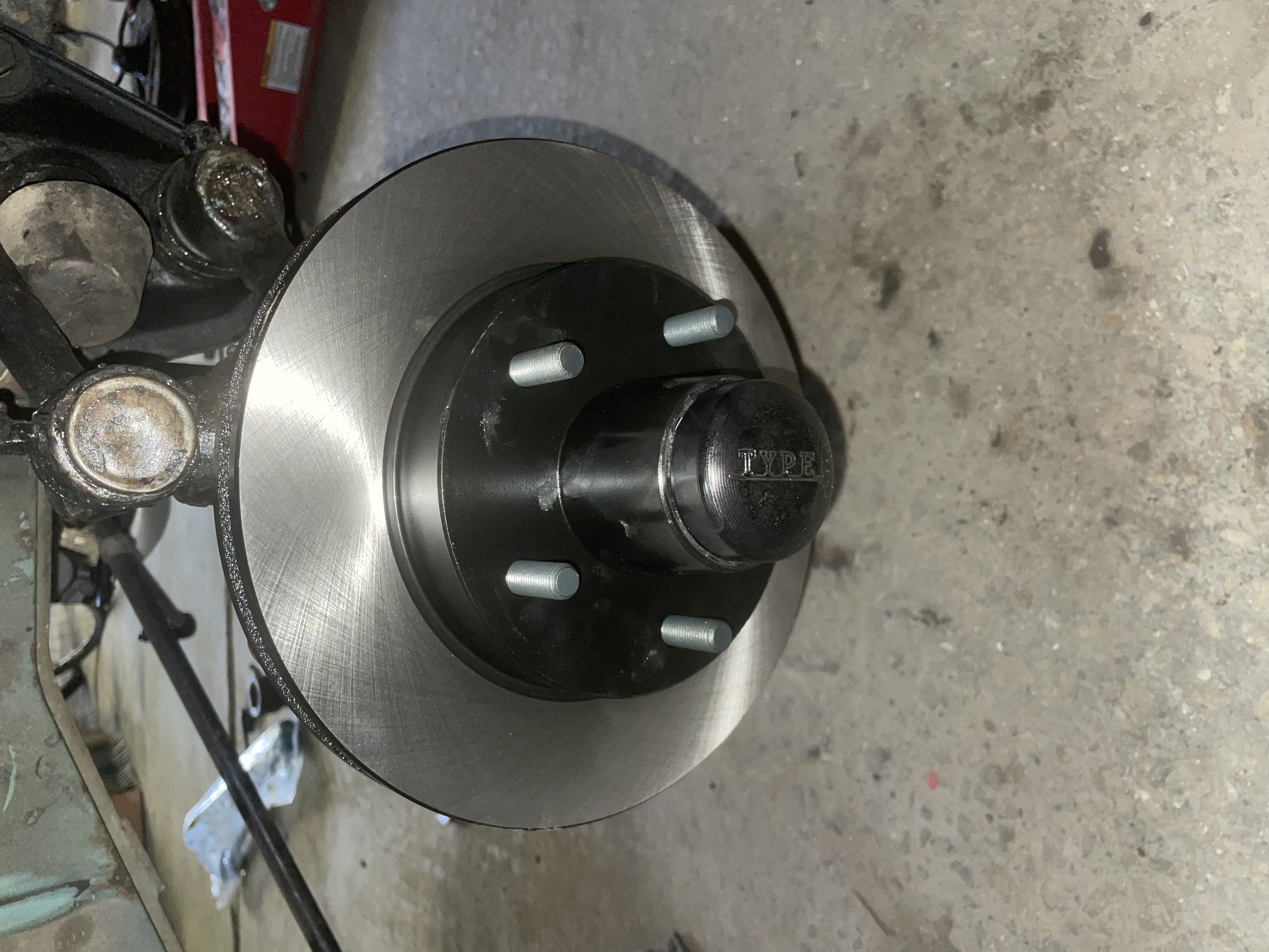

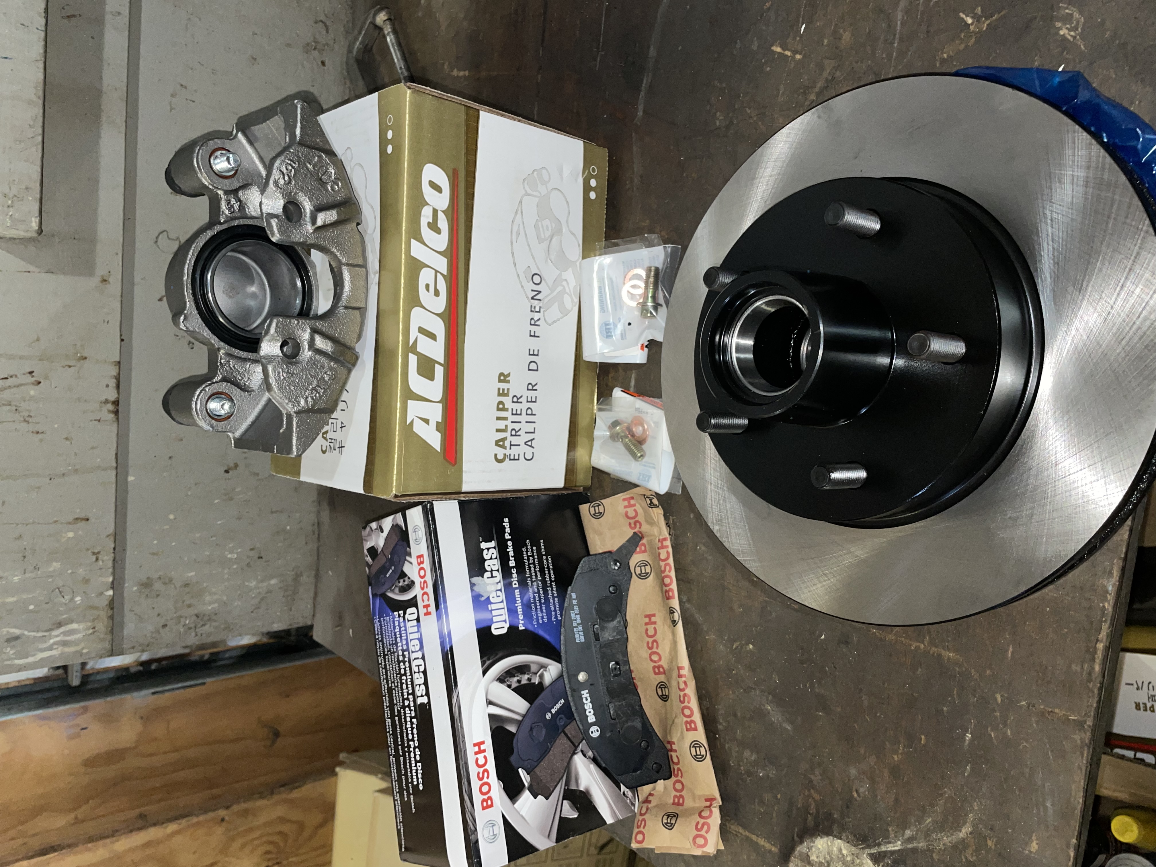

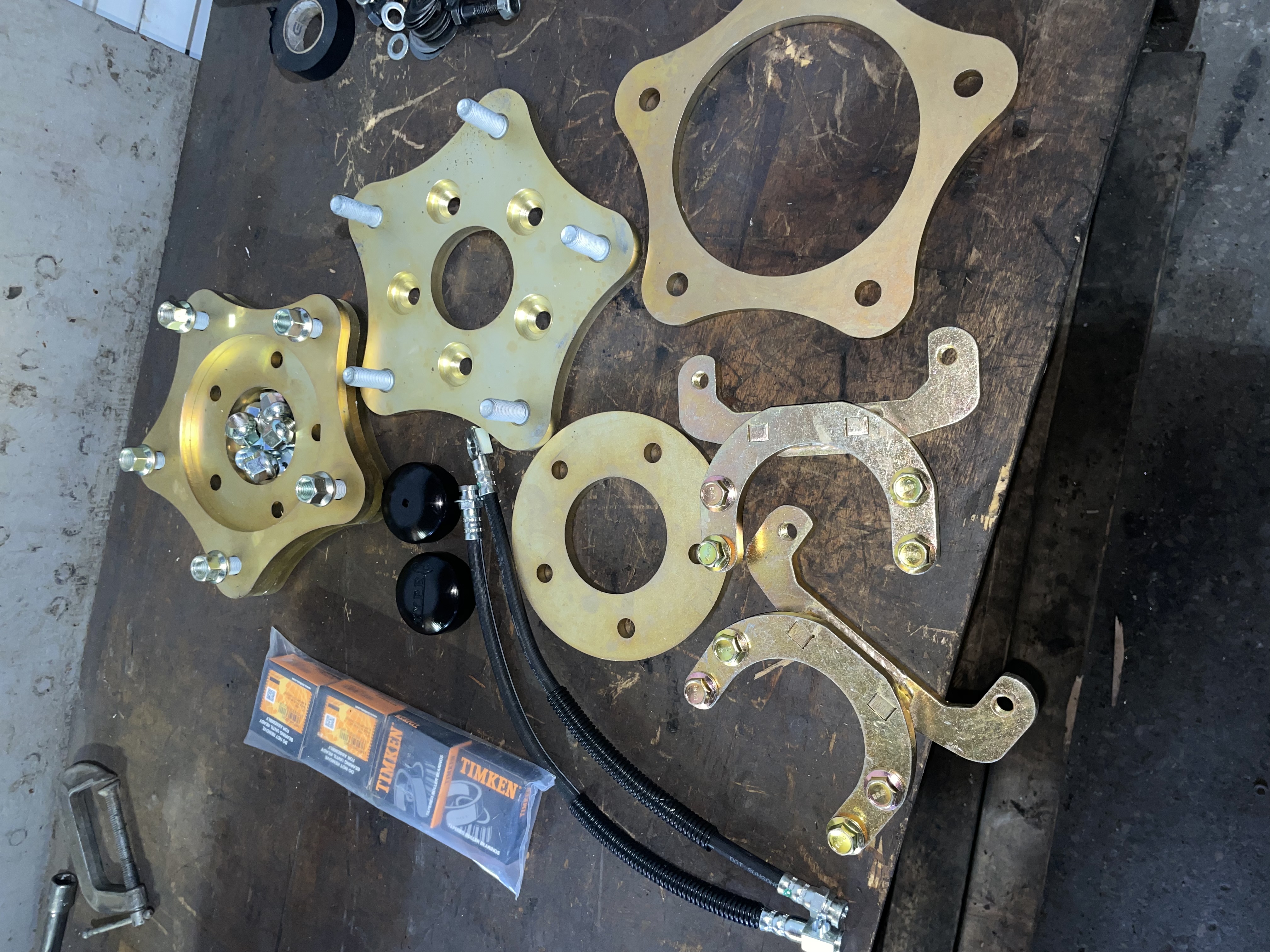

I will touch on brakes quickly. I purchased this disc brake kit from E-Motorsports. https://type-emotorsports.com/products/ ... -brake-kit
I choose this kit because it fits stock 15” bus wheels and uses generic off the shelf GM parts.
The kit comes with soft brake lines, caliper brakets, bolt pattern adapters, bearings, all hardware, and a few spacers if needed. The metal parts are all beefy 1/2” thick zinc coated steel that look to be water jet cut. Nice looking stuff!
You, the buyer need to procure calipers and pads from a late 80’s Chevy Celebrity. Rotors/hubs from a late 80’s Chevy Camaro. Rockauto had a myriad of choices from cheap junk to nice OEM and performance options. I spent a little extra and got good quality parts.

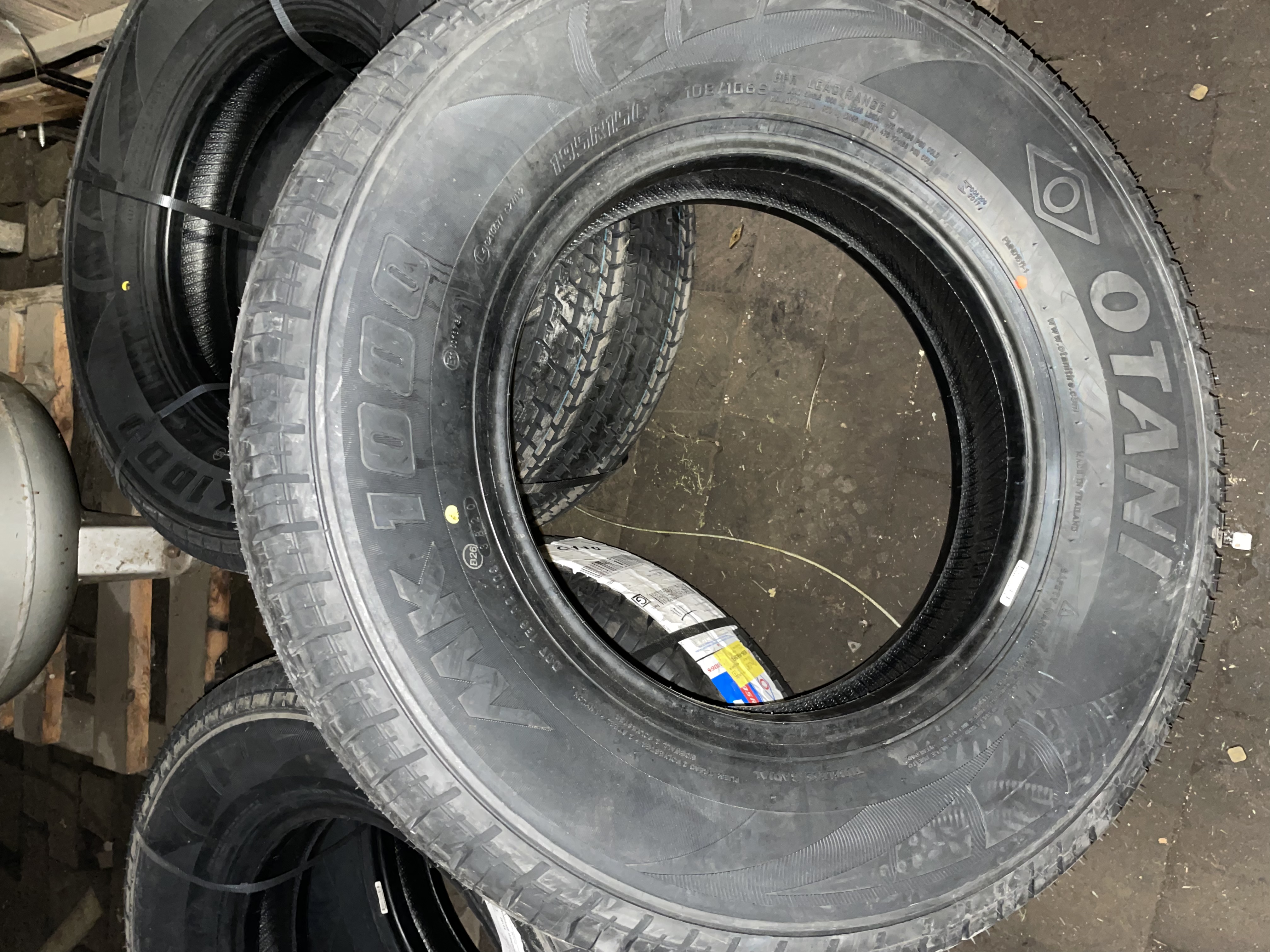

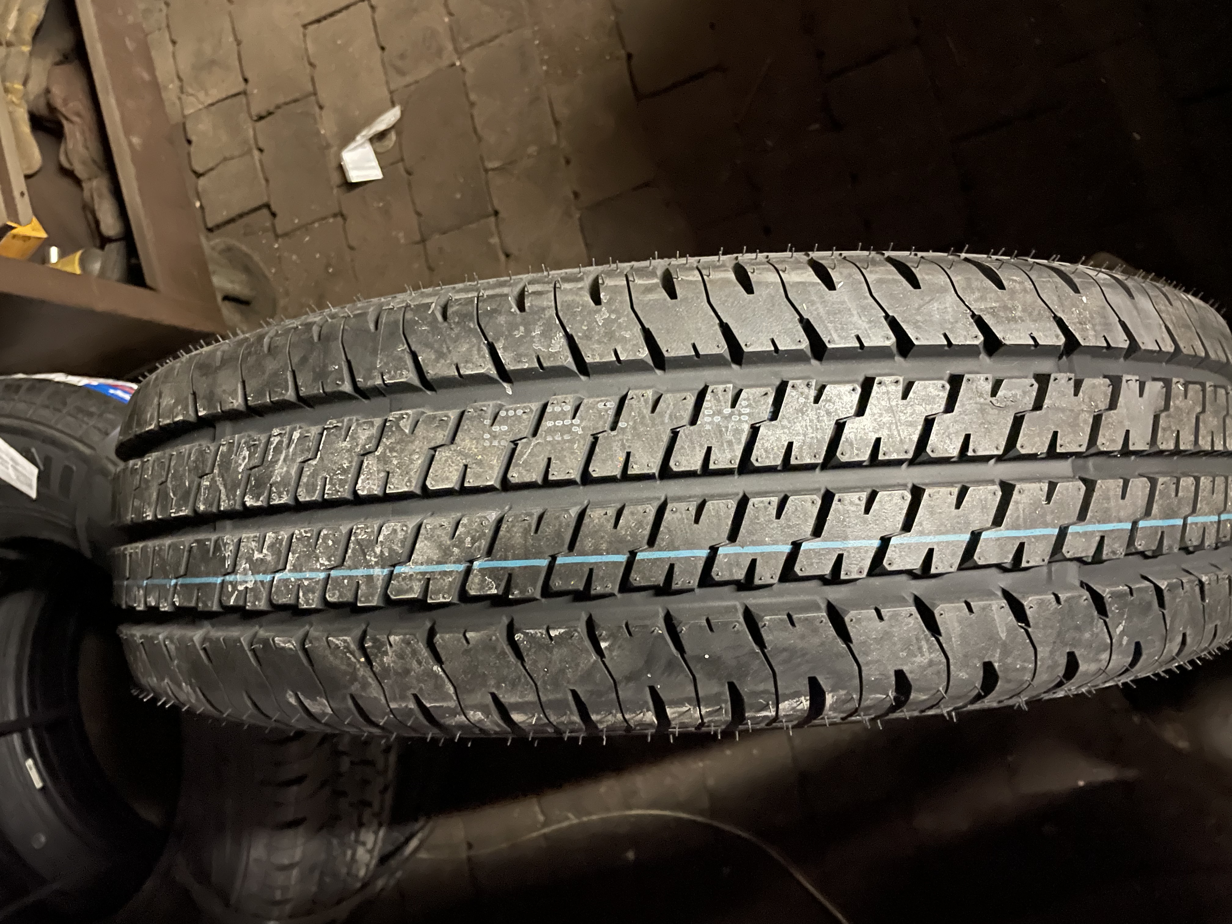

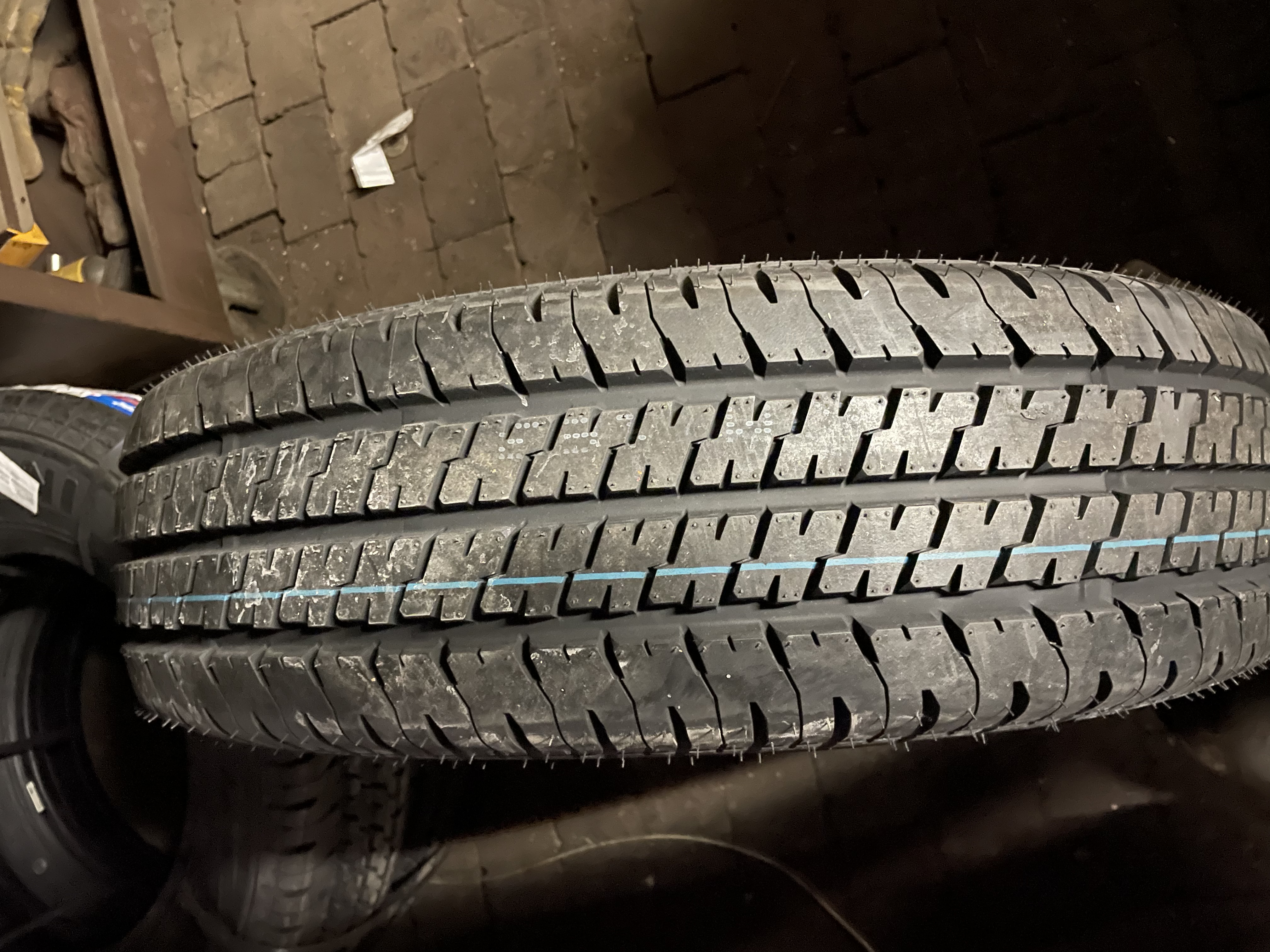

Tires can be a fun subject but after a little digging around I settled on a 195R15. These are basically 195/75 series tires. They can be found in higher weight ratings and the Otani Mk1000’s I choose have a 8ply “D” weight rating at 2,200 lbs each. These have the tall and skinny look to them I wanted.

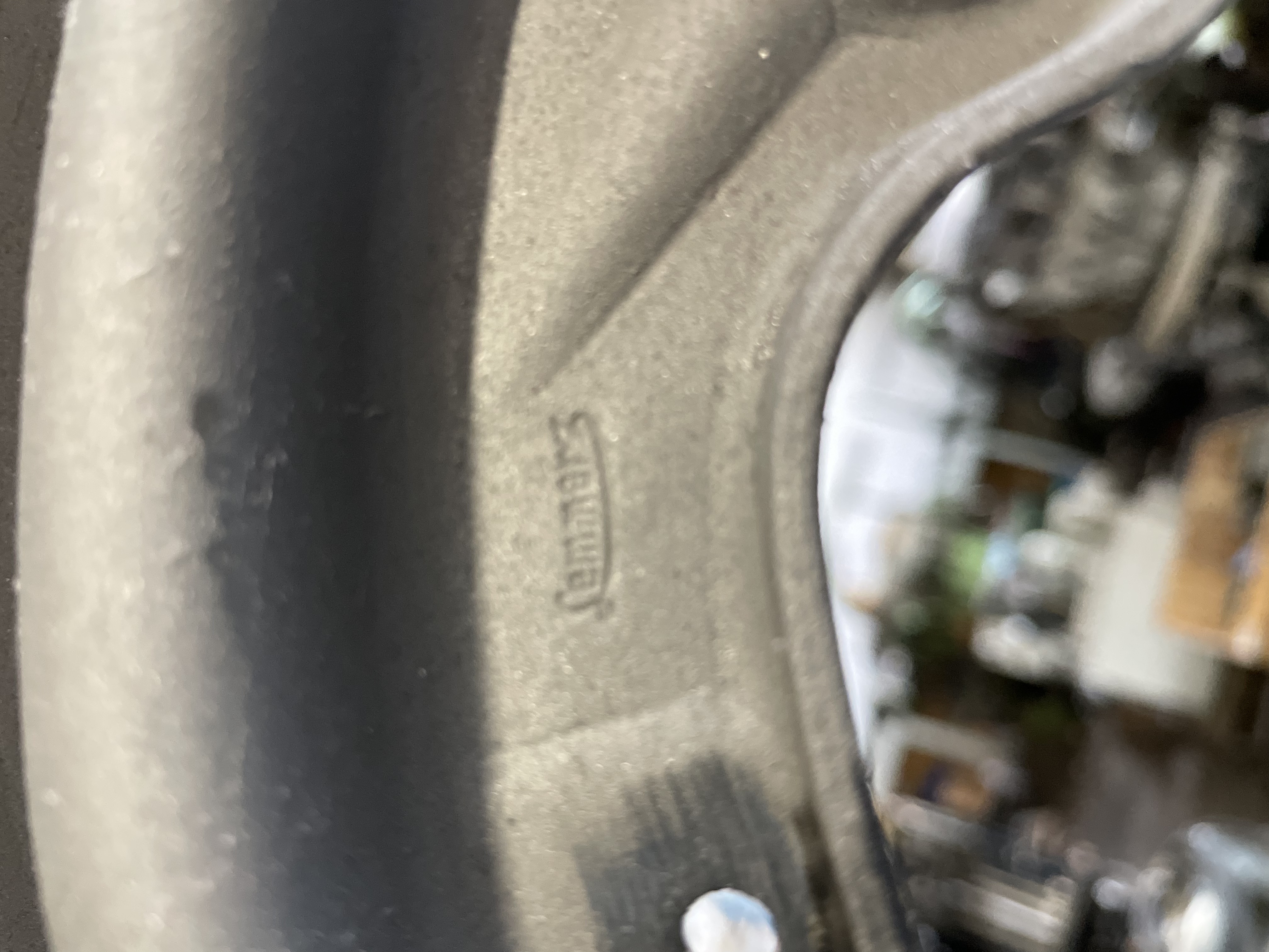

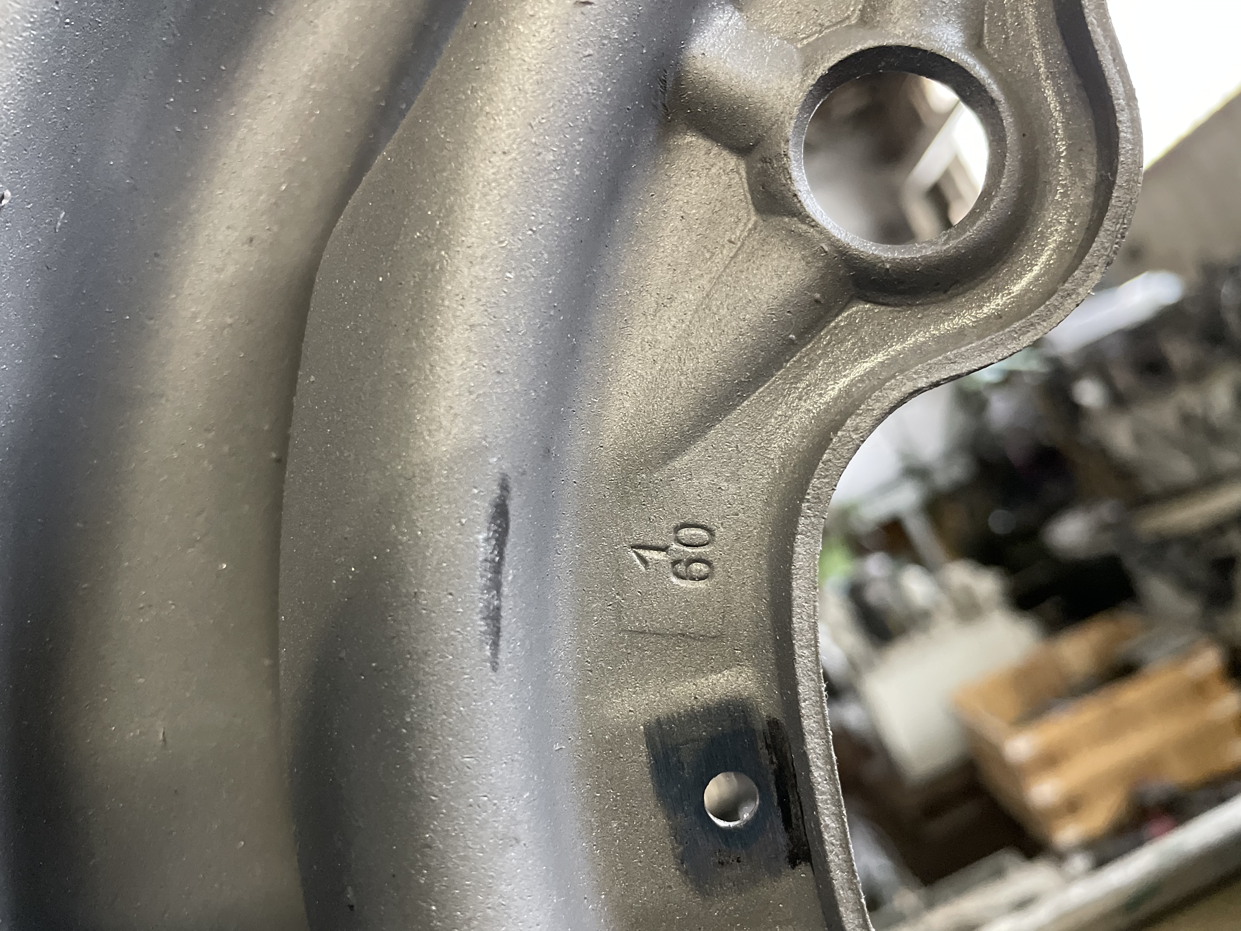

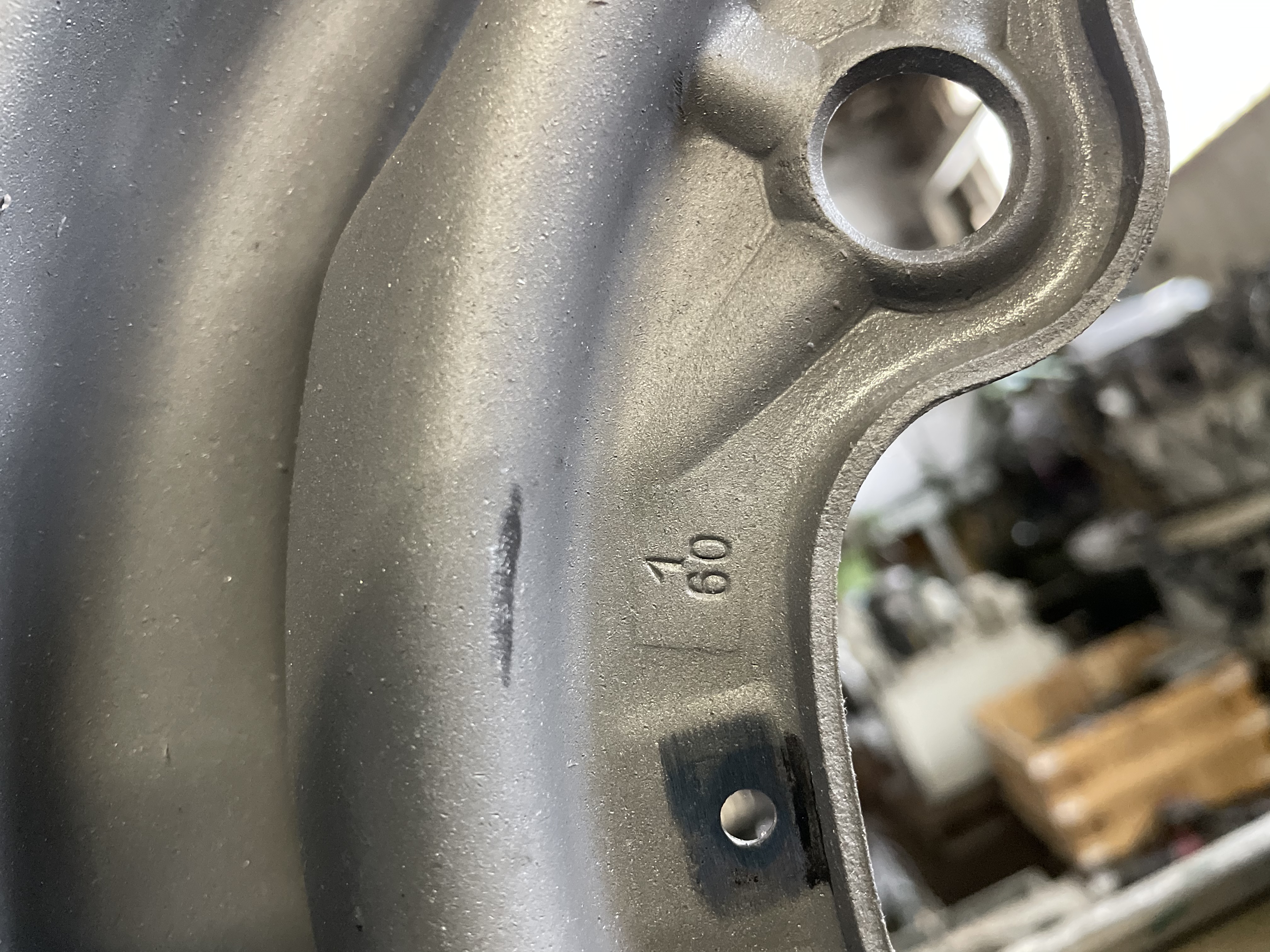

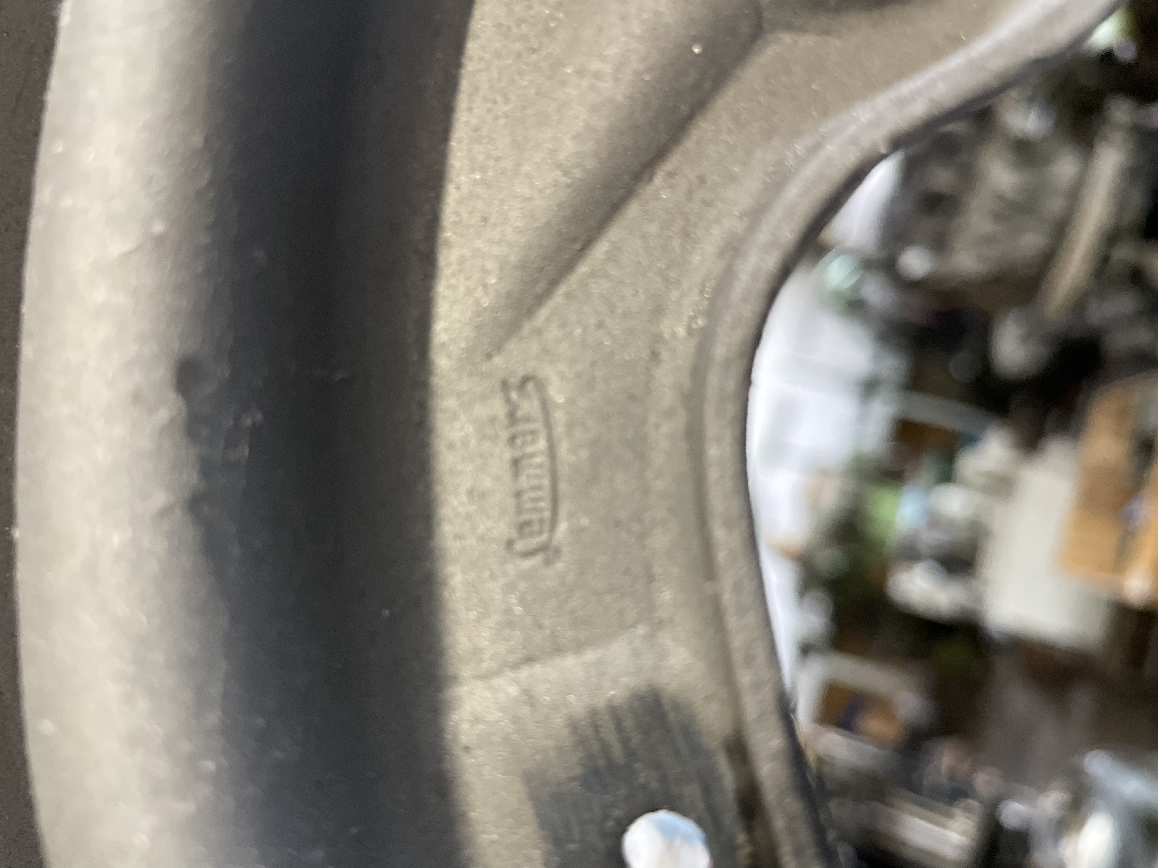

Its been wheel week. I had 6 bus wheel sandblasted and they came out great! Its cool to see the little details hiding under years of crud and layers of paint. One of the Lemmerz made wheels has a date stamp of 1/1960 but the barrel of the wheel has it’s own date stamp of 12/1959.

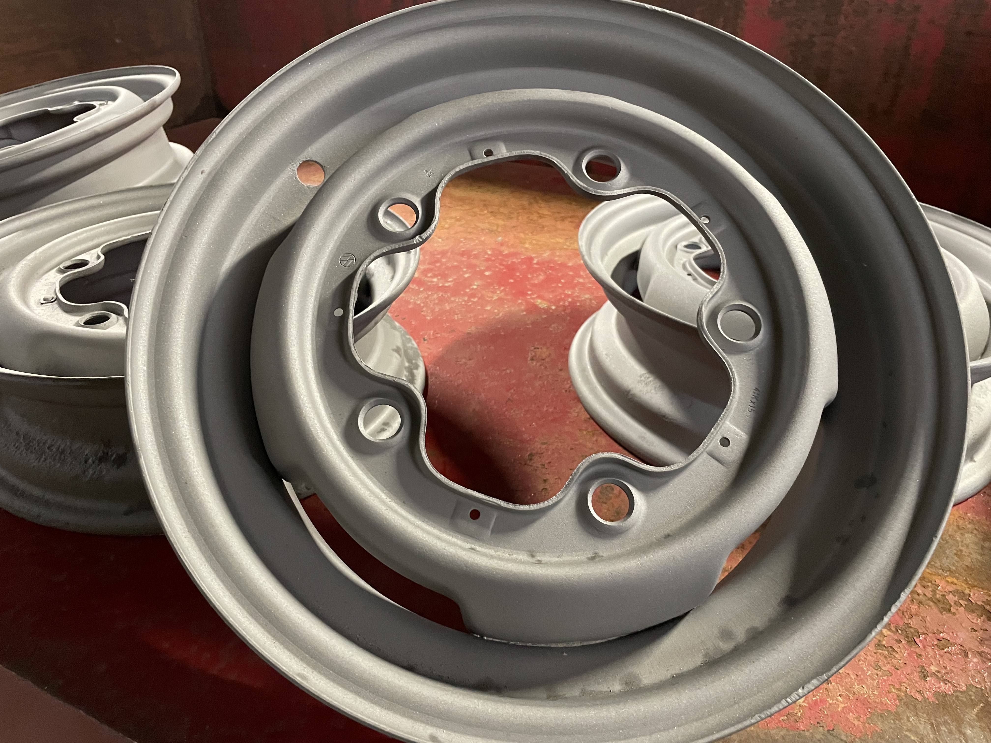

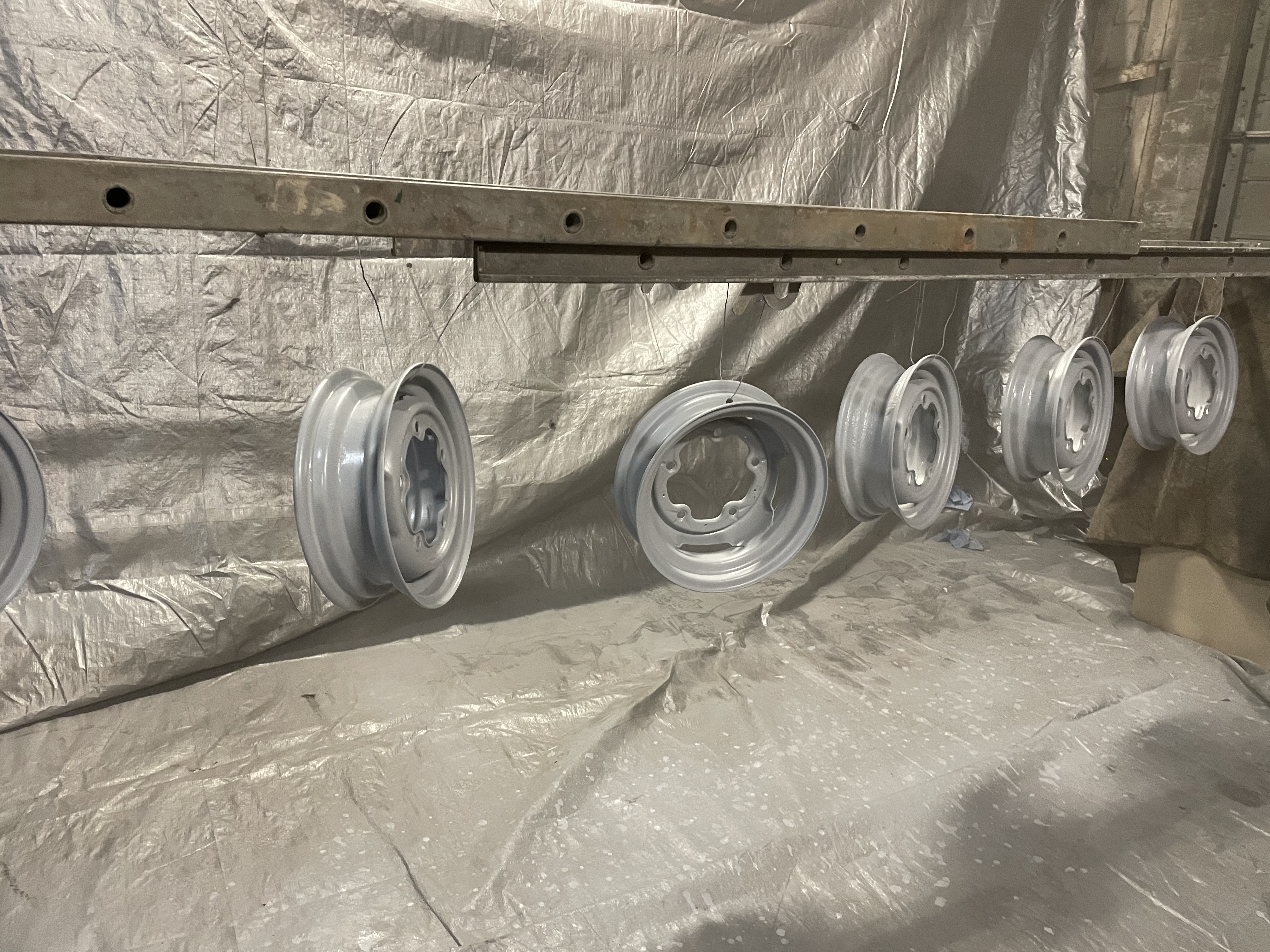

I prepped the wheels for paint by using some Fast Etch metal prep from Eastwood and then getting the wheels set up on my makeshift painting rack which happens to be a old ladder.
Im not a great automotive painter but I do my best. Sprayed on a few coats of primer. 2 of the wheels had some heavier pitting compared to the rest so I used a rattle can of high build primer I had to layer up a few coats and then sand back down to help fill some of the pitting. That helped smooth things out a little.

I put wheels on a turntable, lazy Susan or round stool and spin them while shooting to get a more even application. If you haven't mounted them on a front spindle and spun them to check for being bent, it's a good idea to do this first. I think I went through about 10 to get a set that ran true.

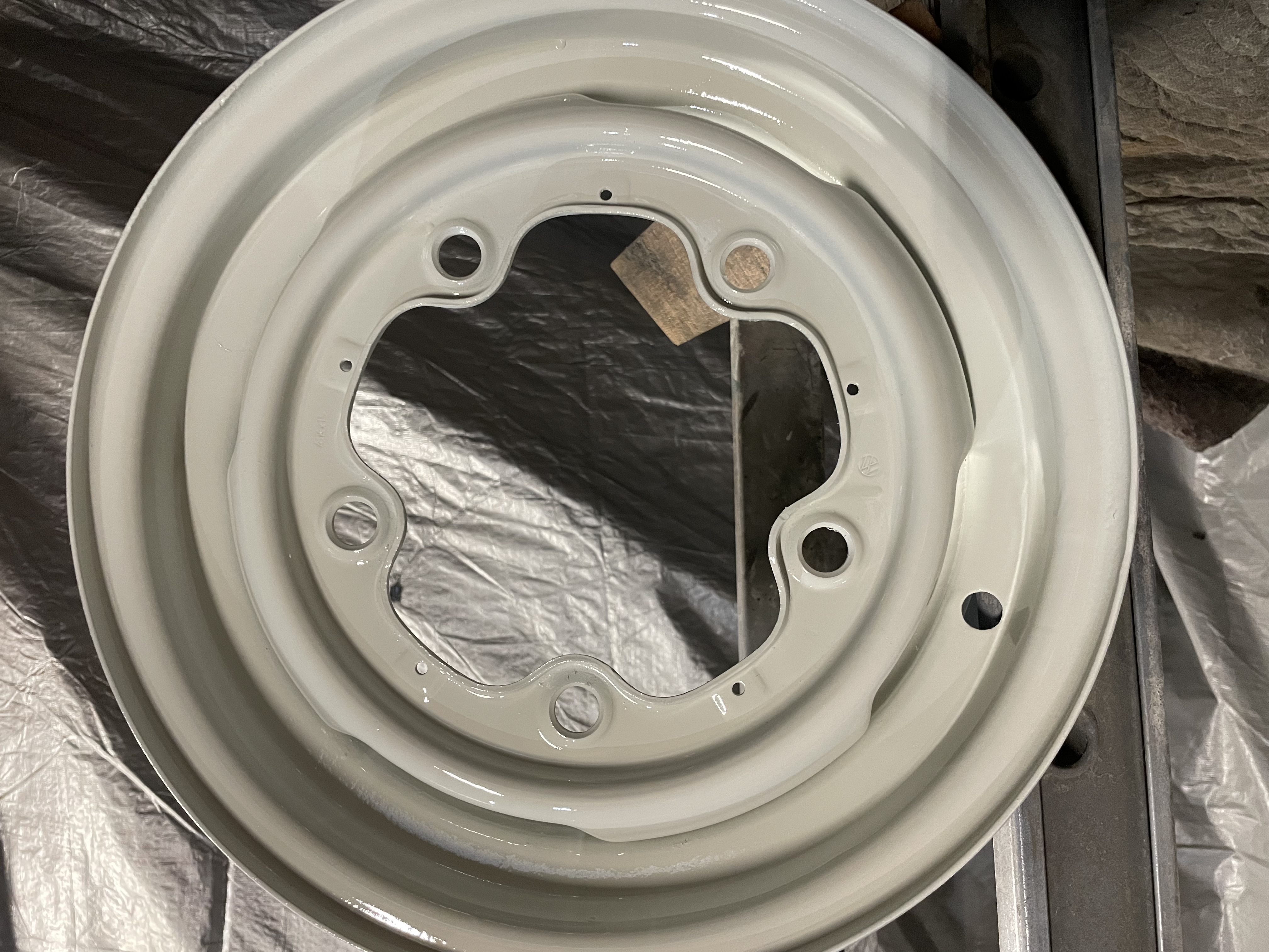

I think the "crows feet" wheels have a slightly different backspacing from the standard bus wheel.

Well they are correct, but not by much. At most a 1/4” of positive offset.SlashKirk wrote: Tue Mar 01, 2022 9:32 am I think the "crows feet" wheels have a slightly different backspacing from the standard bus wheel.

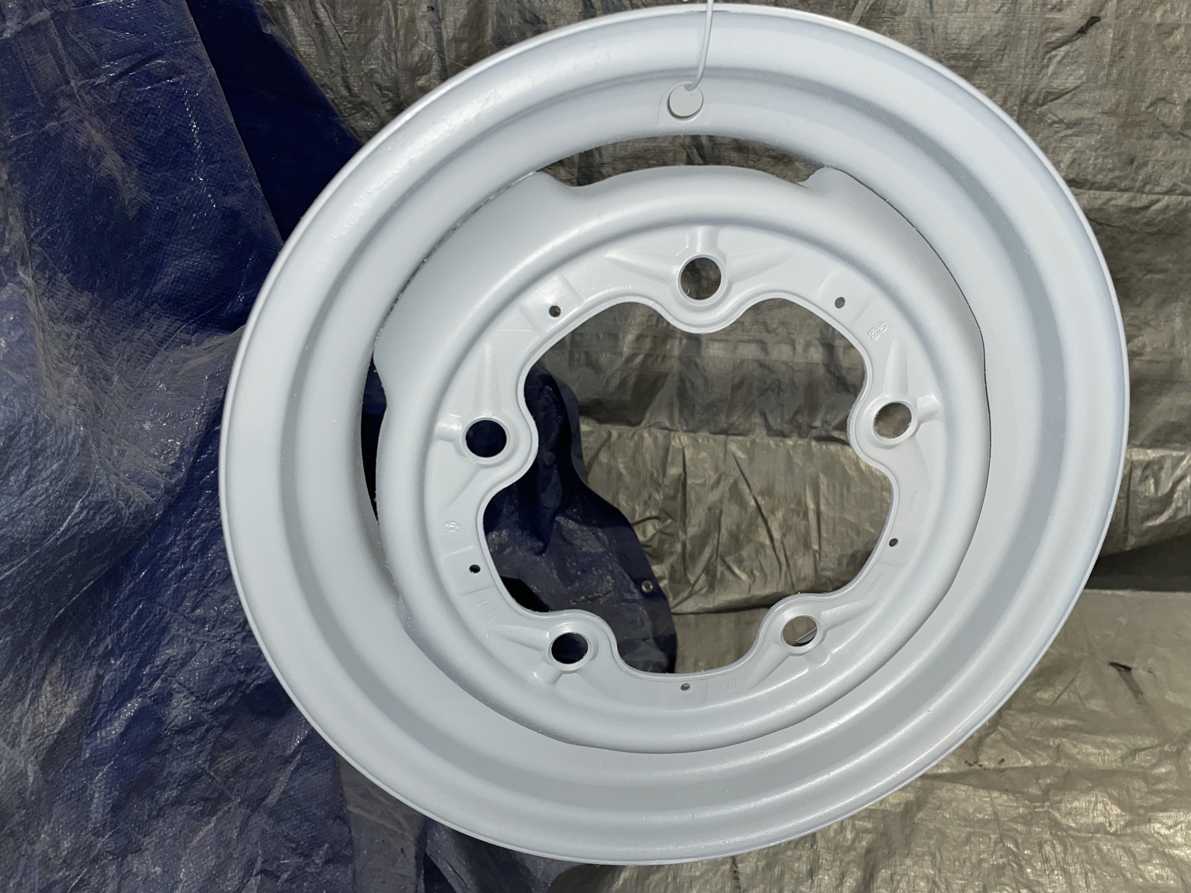

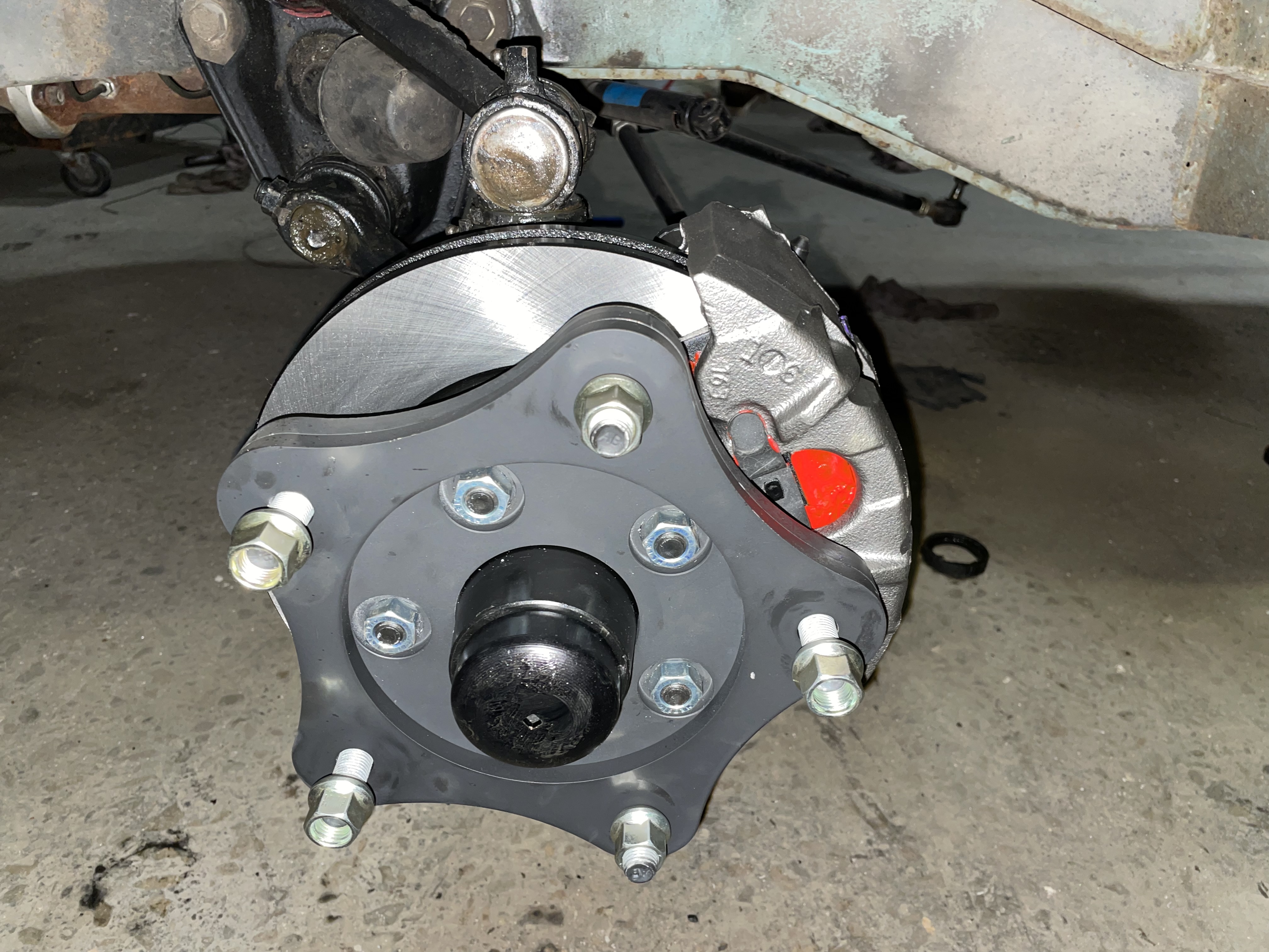

So, wheels have been painted. A couple
oops here and there but the most importantly, I had a good time painting! Color on the front and back of the wheels. Black on the outer barrels where the tires will hide to somewhat mimic the factory paint job and to save some paint for a upcoming bumper project. While paint was drying I got cracking on assembling the front suspension and brakes.

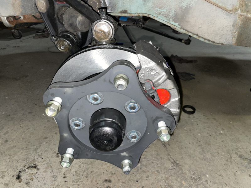

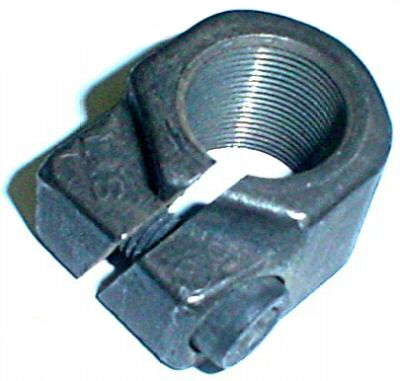

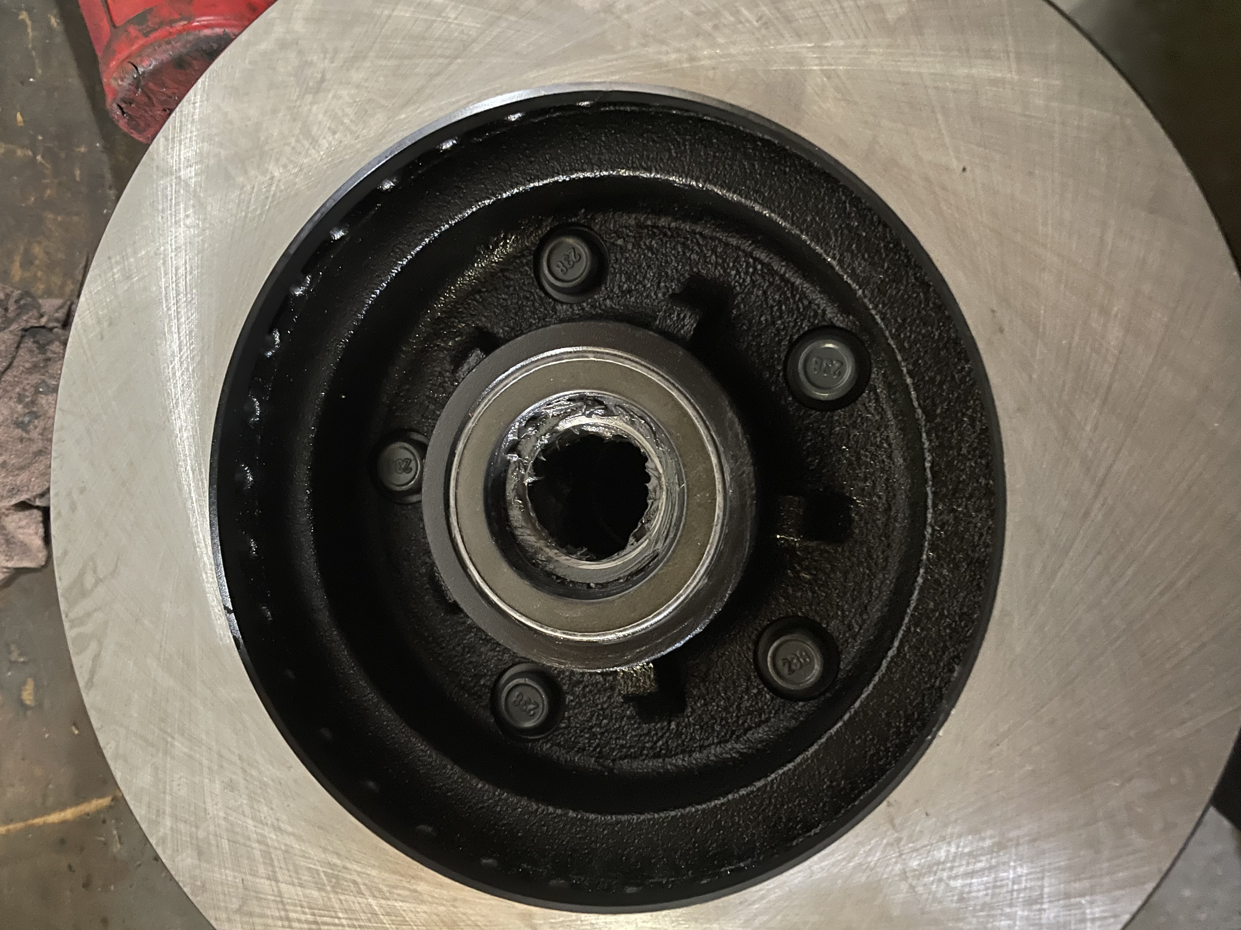

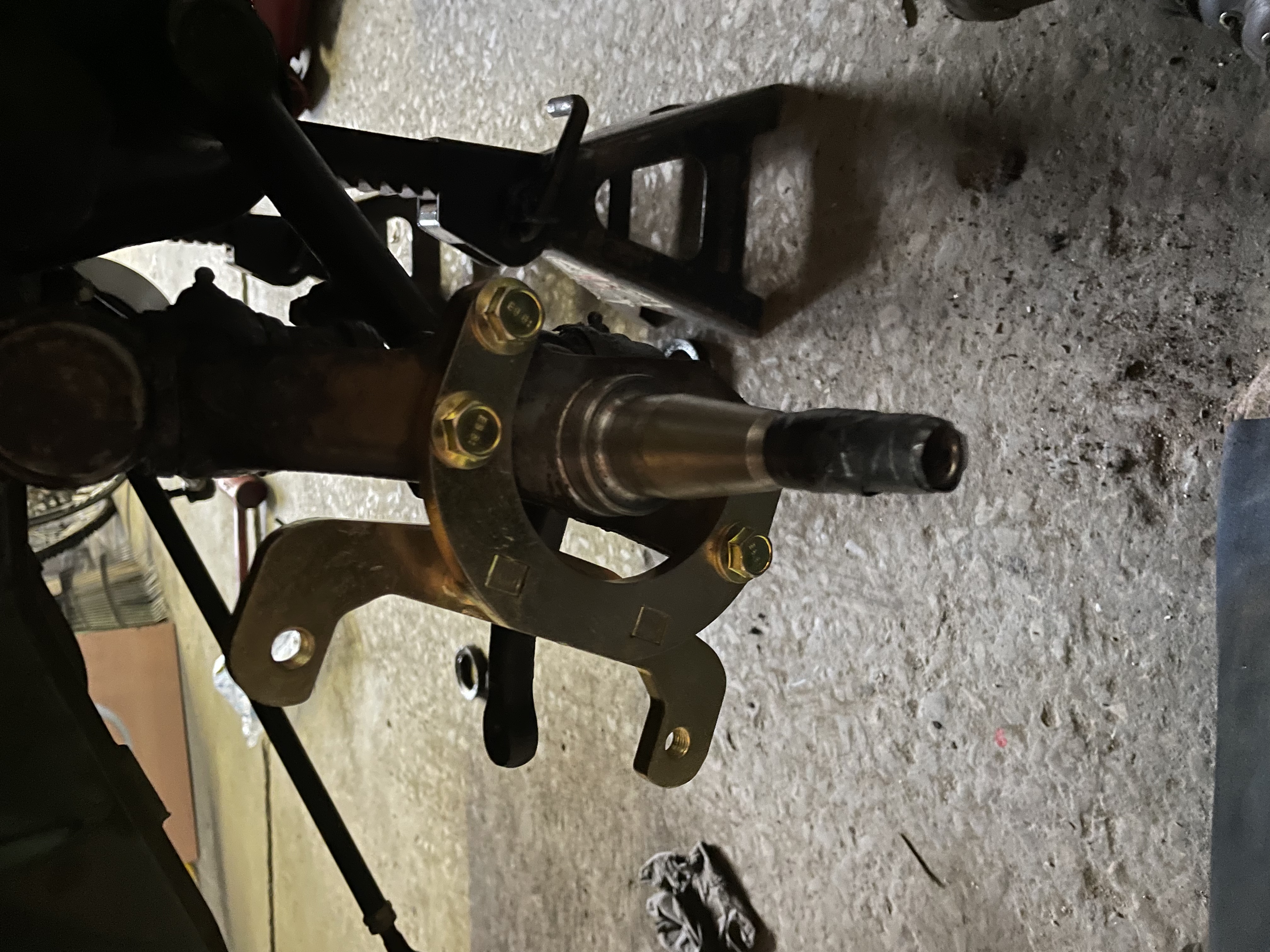

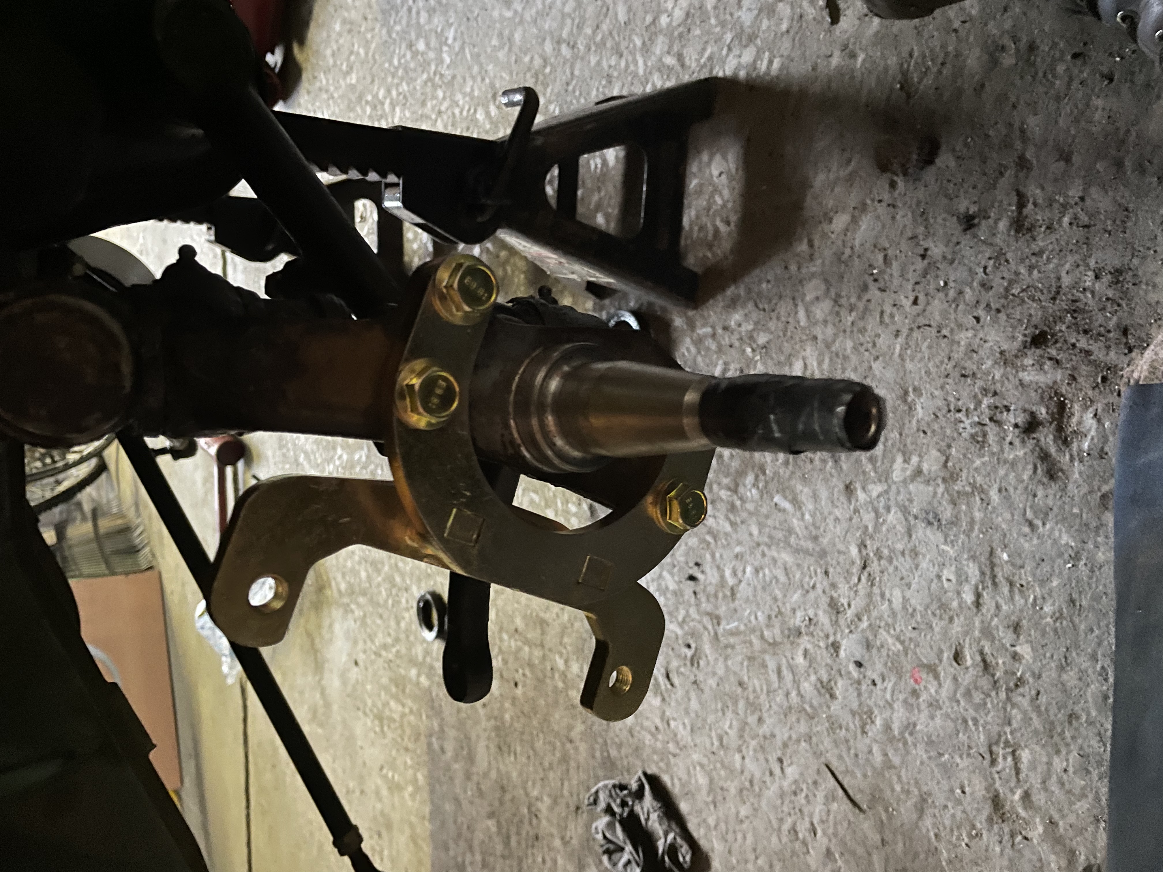

Stocks spindles cleaned up and link pins lubed up and installed with correct shims. Packed up new wheel bearings with grease and installed them along with inner grease seal into the brake hubs. Caliper brackets torqued down and rotors installed. I have always preferred the larger screw locking baywindow spindle nut over the two tiny split bus style ones. They just needed a little shaving to clear the dust caps. Finally installed calipers and the chevy to widefive wheel adapters. Cant wait to hit the brakes

- Baywindow spindle lock nut
