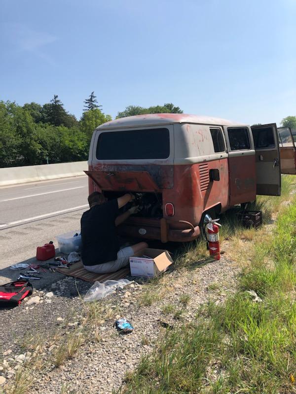

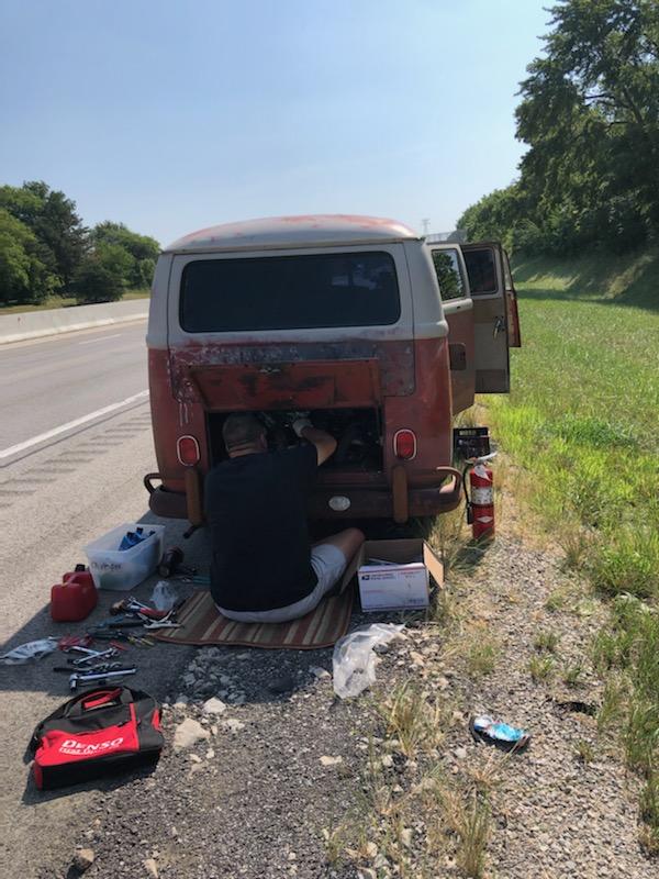

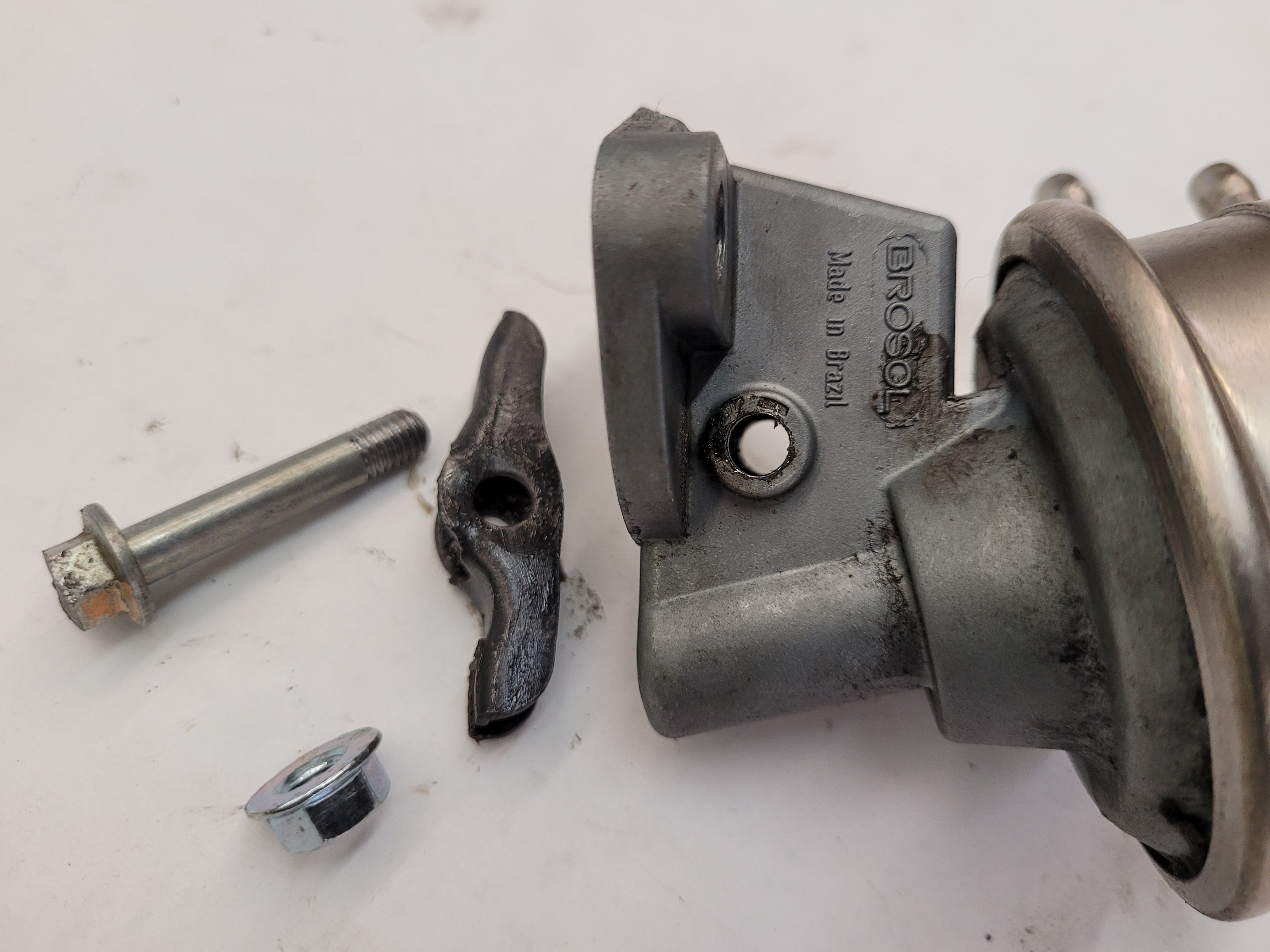

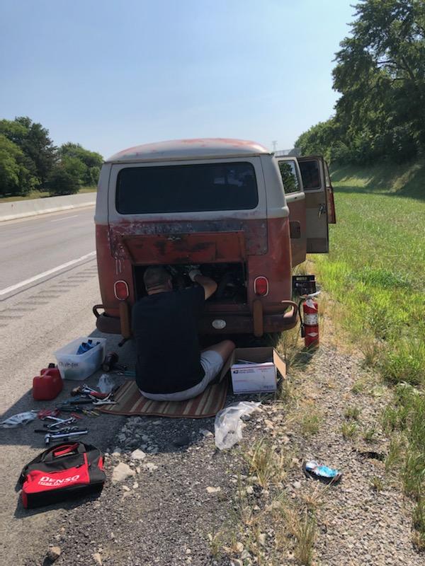

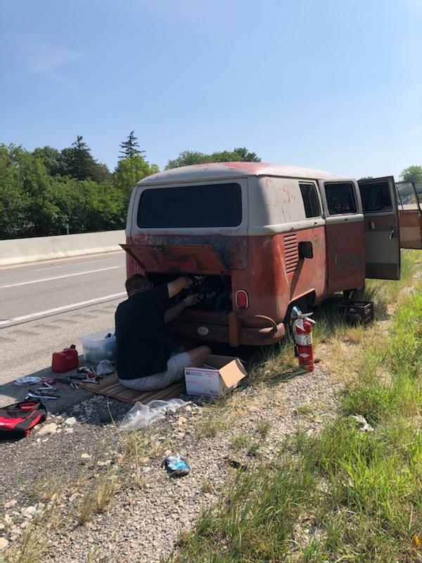

One problem on the Qwesty trip- the fuel pump pivot pin fell out on the way home. Not a big problem, it took about 20 minutes to diagnose and repair it since I had a pump and tools with me. Oddly enough this is the THIRD time on three different vehicles this has happened in the last 10 years! Once I returned home I put a bolt in it (with a dab of weld) and reinstalled it.

Dual Port wrote: Wed Aug 31, 2022 10:09 am One problem on the Qwesty trip- the fuel pump pivot pin fell out on the way home. Not a big problem, it took about 20 minutes to diagnose and repair it since I had a pump and tools with me. Oddly enough this is the THIRD time on three different vehicles this has happened in the last 10 years! Once I returned home I put a bolt in it (with a dab of weld) and reinstalled it.
I by chance bought one of these when I was having issues with the OE pump on the truck. Comes with e-clips on the pivot pin. They claim testing up to E85 on their components.
