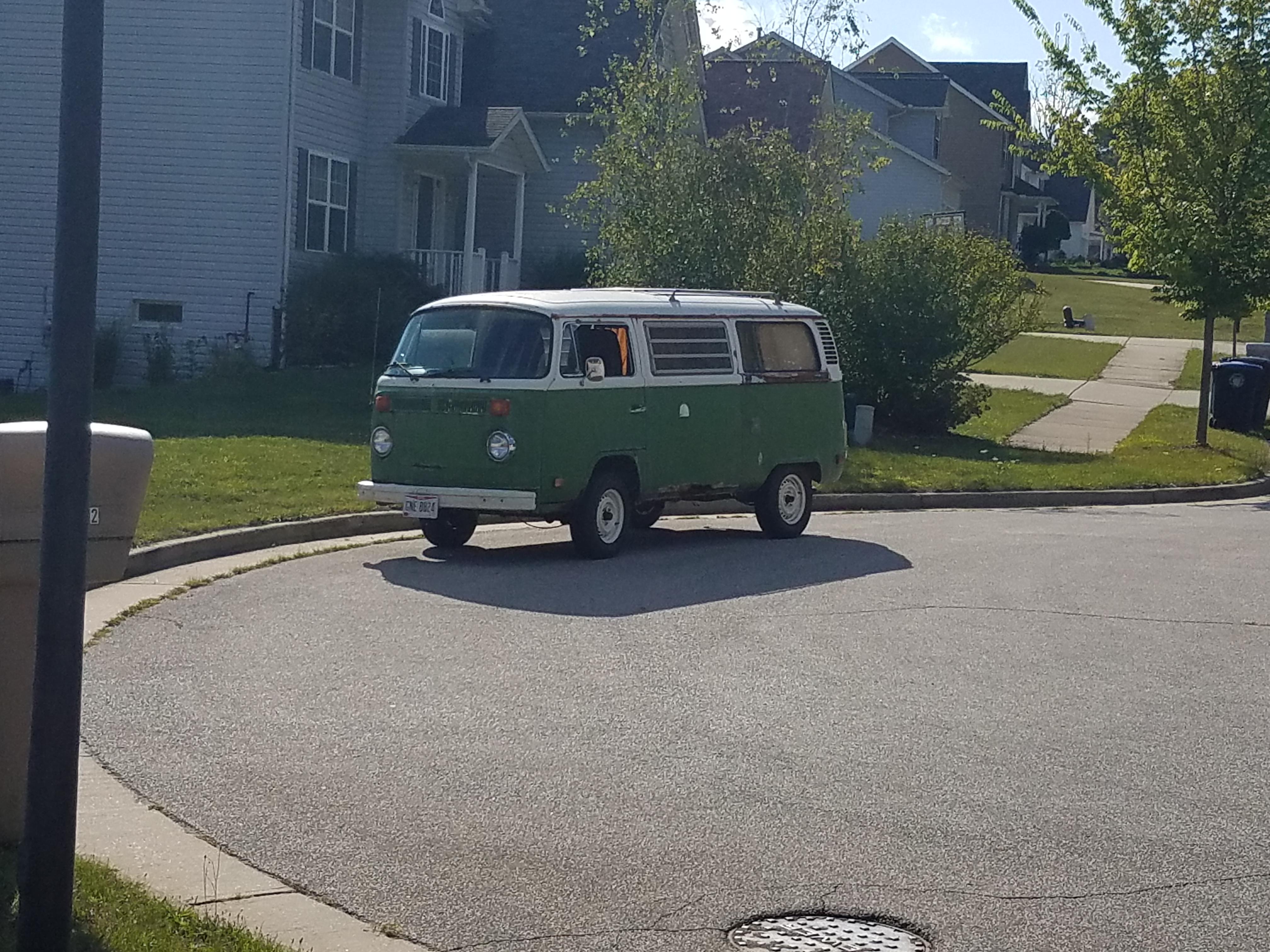

Took the bus to my parents house for them to see it.

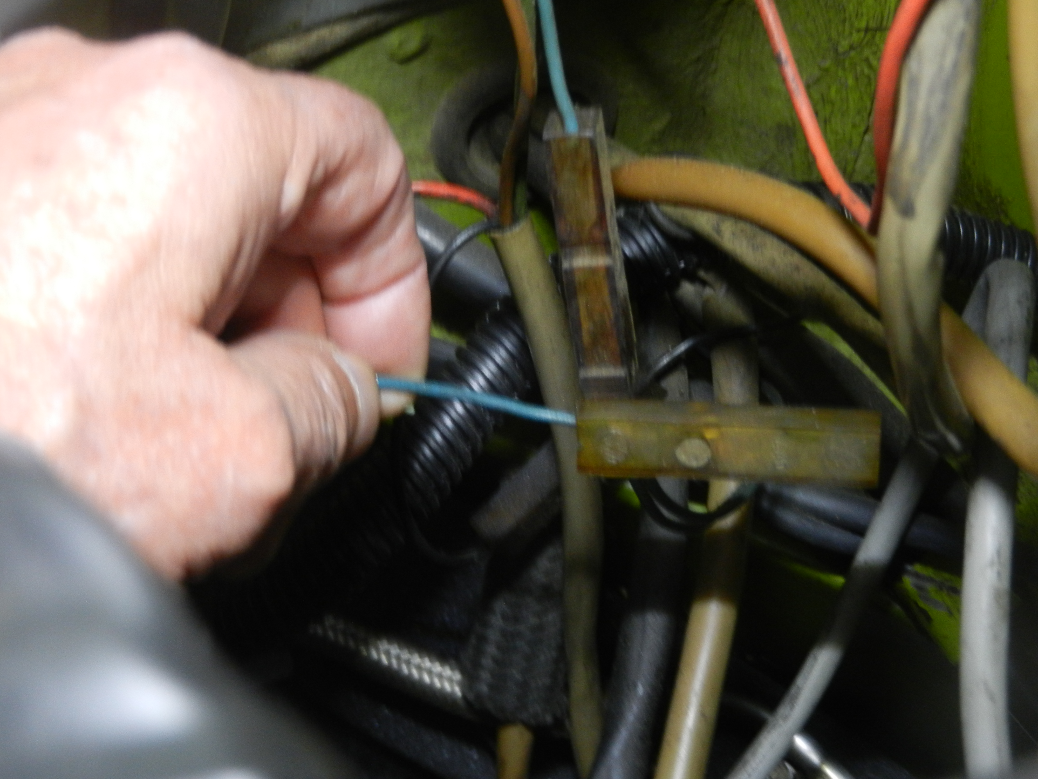

Look closely at wiring diagram for alt/reg. I will try to post a pic today. There is a blue wire that dangles near the regulator. It is the excitor wire that goes to the lite on the dash. Alt will not charge battery if this is not connected.

About the blue wire: its connected and the alt light functions correctly. I fixed a bad splice and now I'm getting about 12.8 volts. Still seems low.

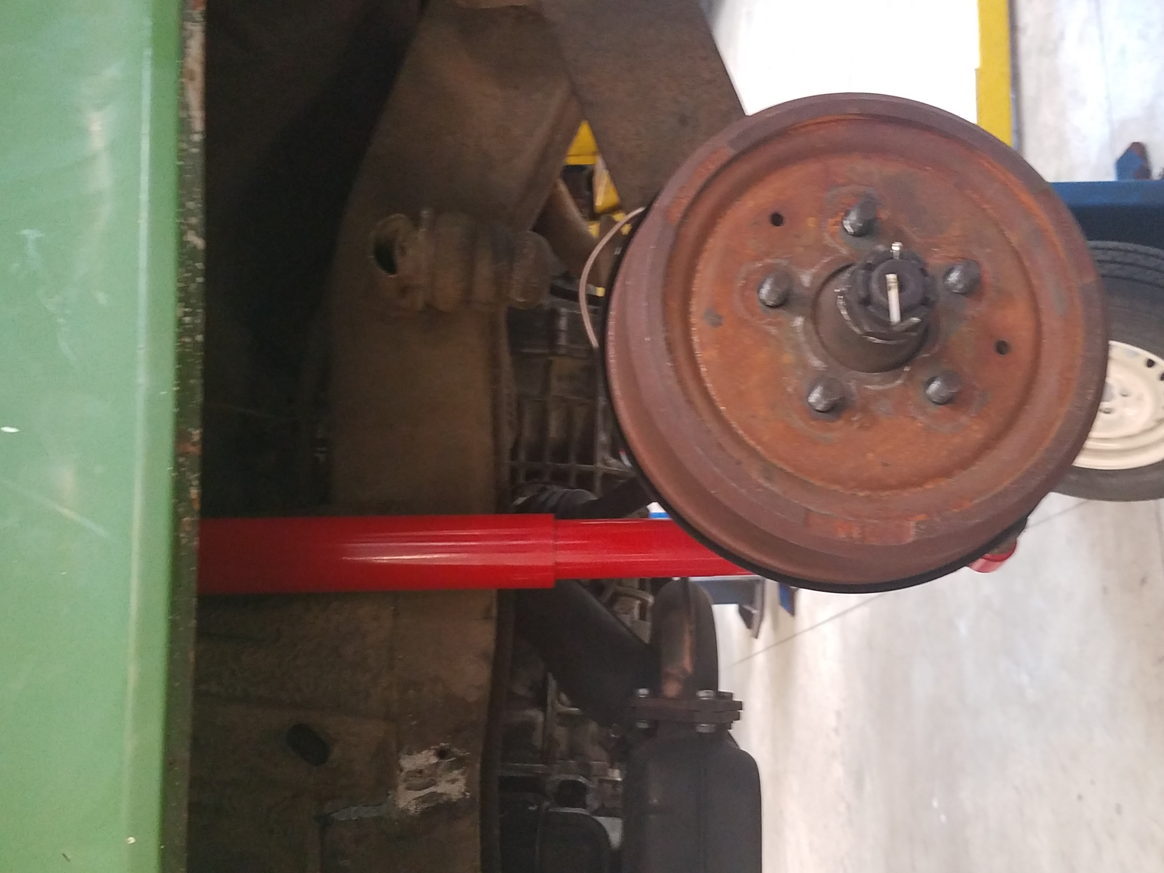

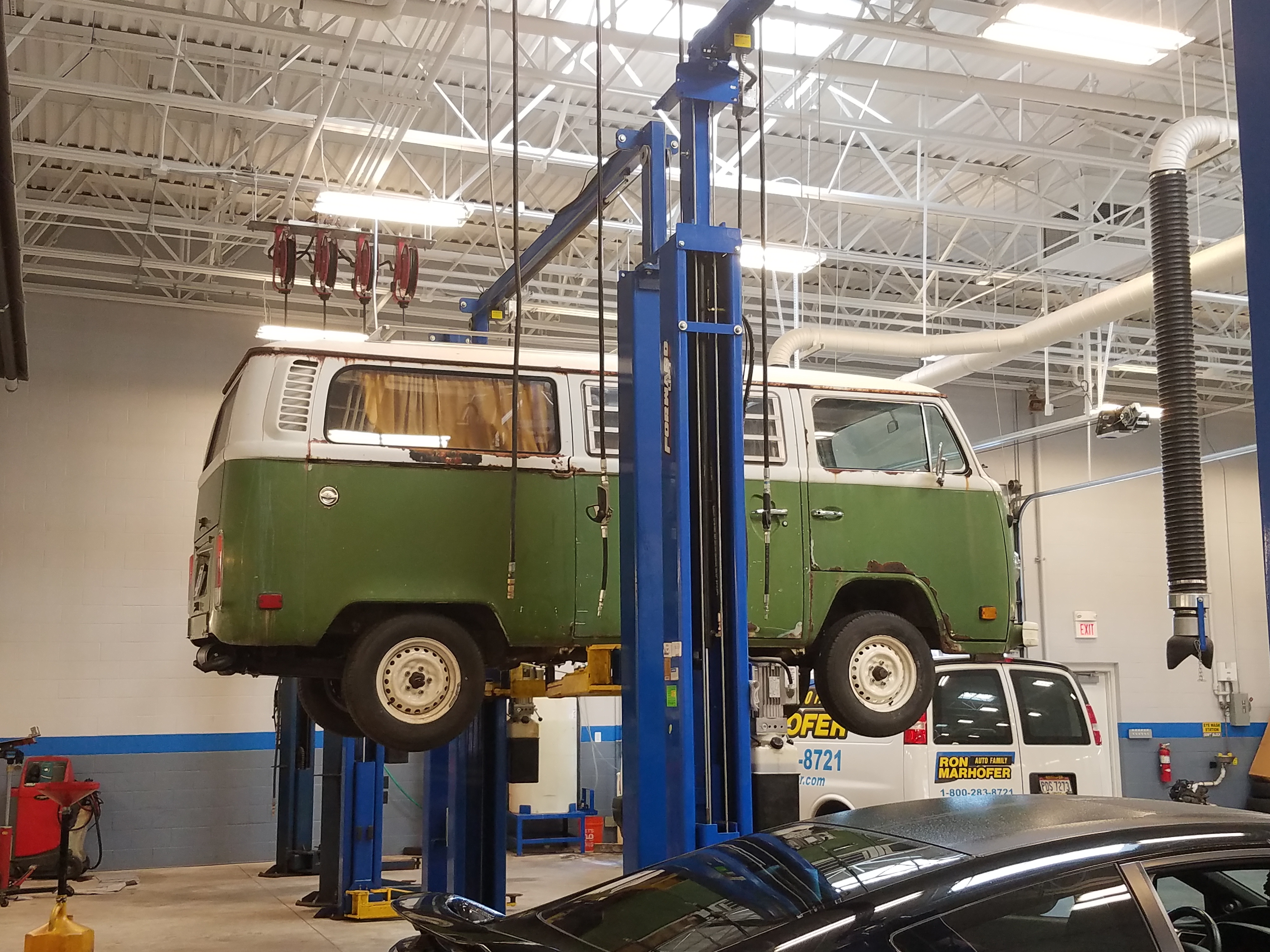

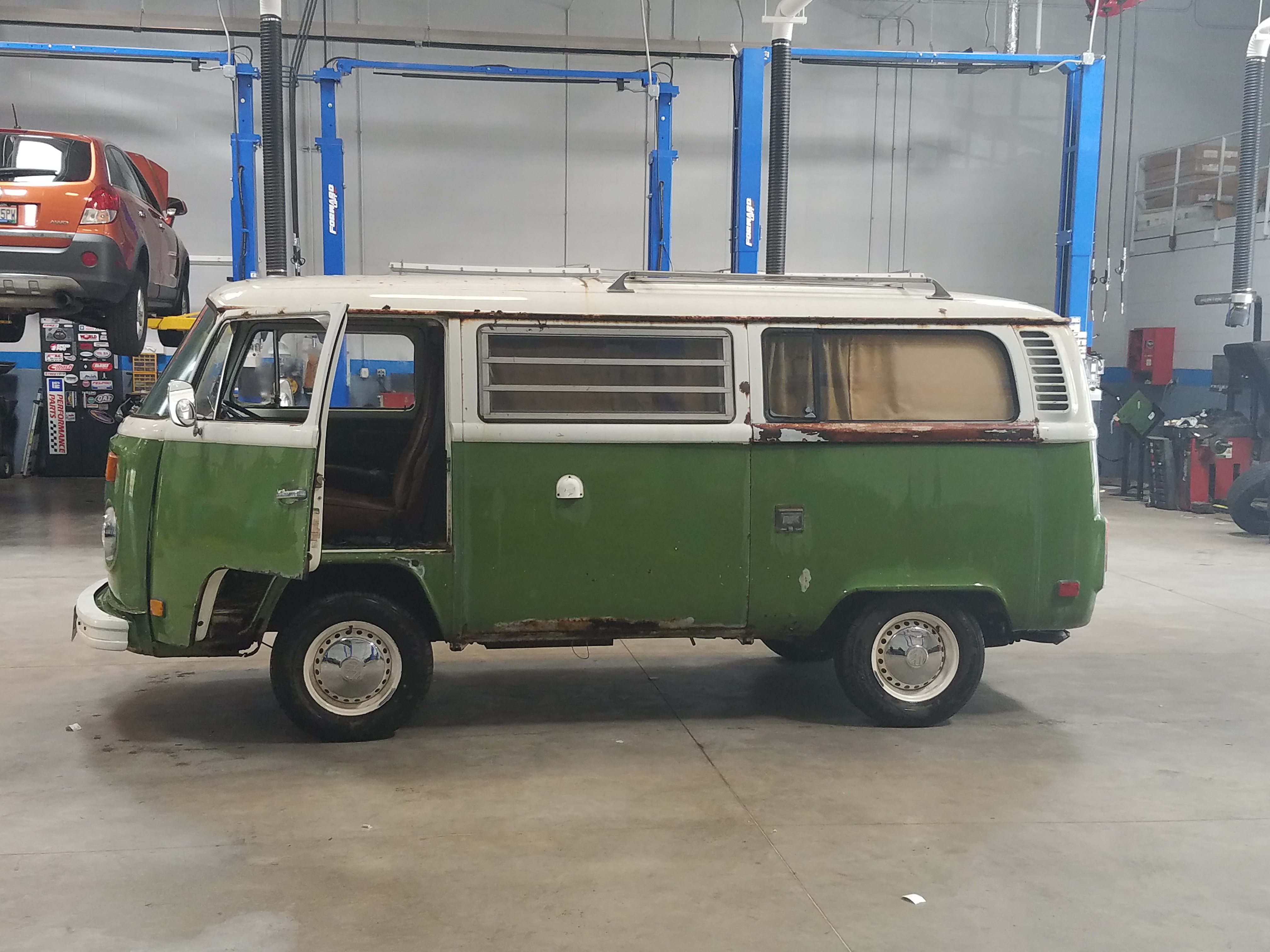

The bus really swayed on the highway during my drives on Friday. I took it to work with me on Saturday and installed my new Koni shocks and a new Cofap steering damper. Rides way better now. Also washed it and put the hubcaps on.
