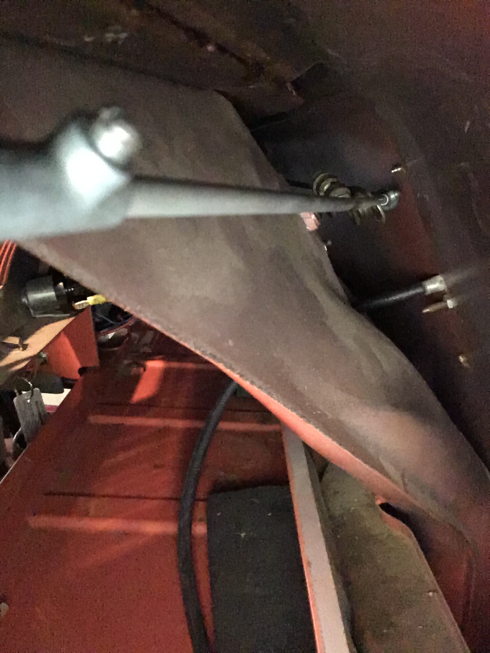

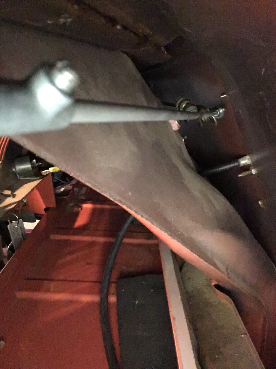

I finally got the wiper arm on the passenger side reinstalled. When I went to 12V, the pivot ends with the set screws were not in the correct location causing the arm to bind up and actually bend. Once that arm was bent, I couldn't get it straight enough to reinstall it the correct way. Thanks to HeyEd, who rolled it out and straightened it for me, I was able to re-install it the correct way. He pointed out the divots in the arm created by the set screws. Where the pivots were set to the first time, the arm was 1/16" too long. So I noted the correct original location and put them back on in the same exact location. They seem to be working fine now. At least for the moment and as good as the wipers can work. :D

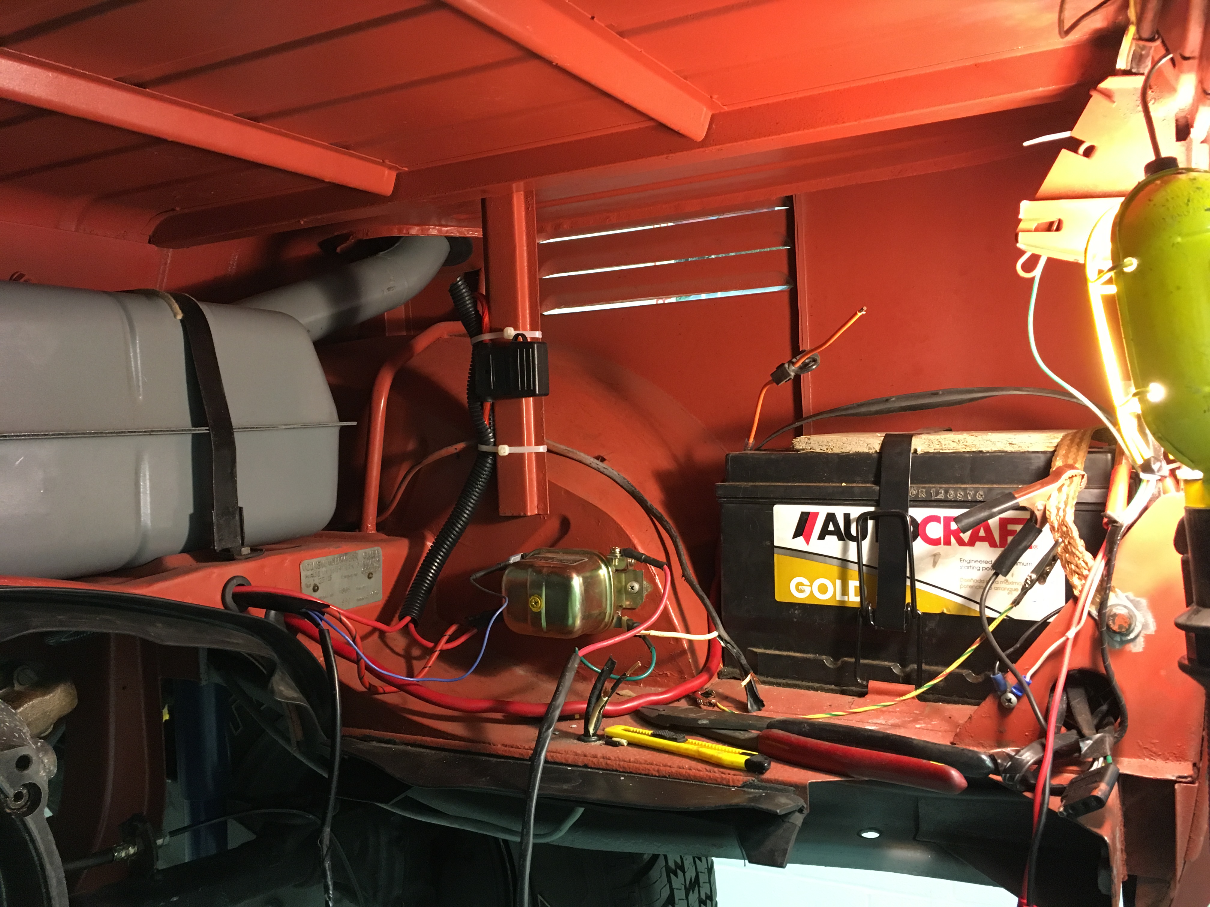

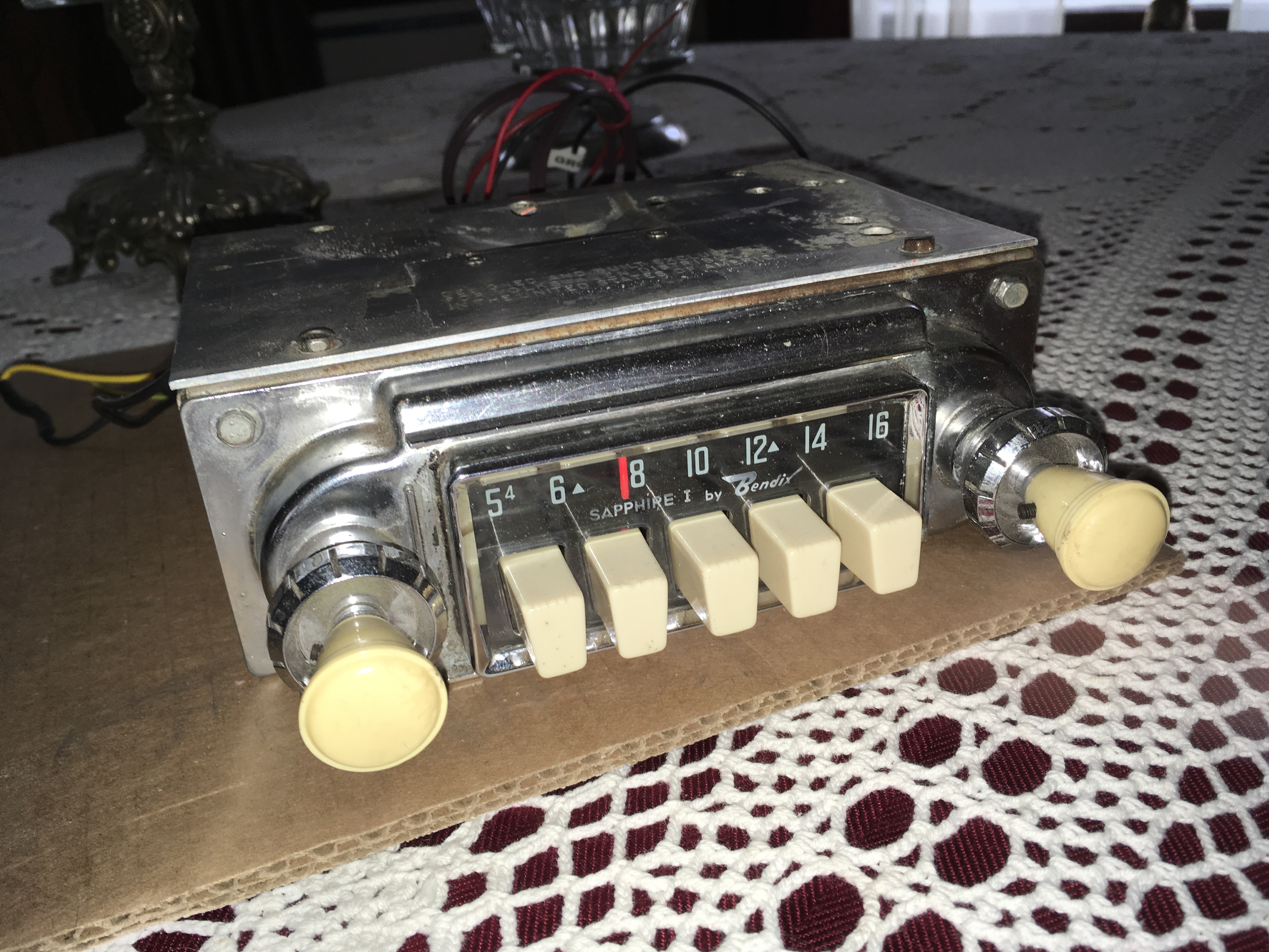

Now it's time to re-install the radio and then, possibly replace the antenna. The radio was sent out to have it rebuilt, fixed and have a voltage drop installed for the 12v conversion. He labelled the wires for me so I should be able to get it working without too much trouble.

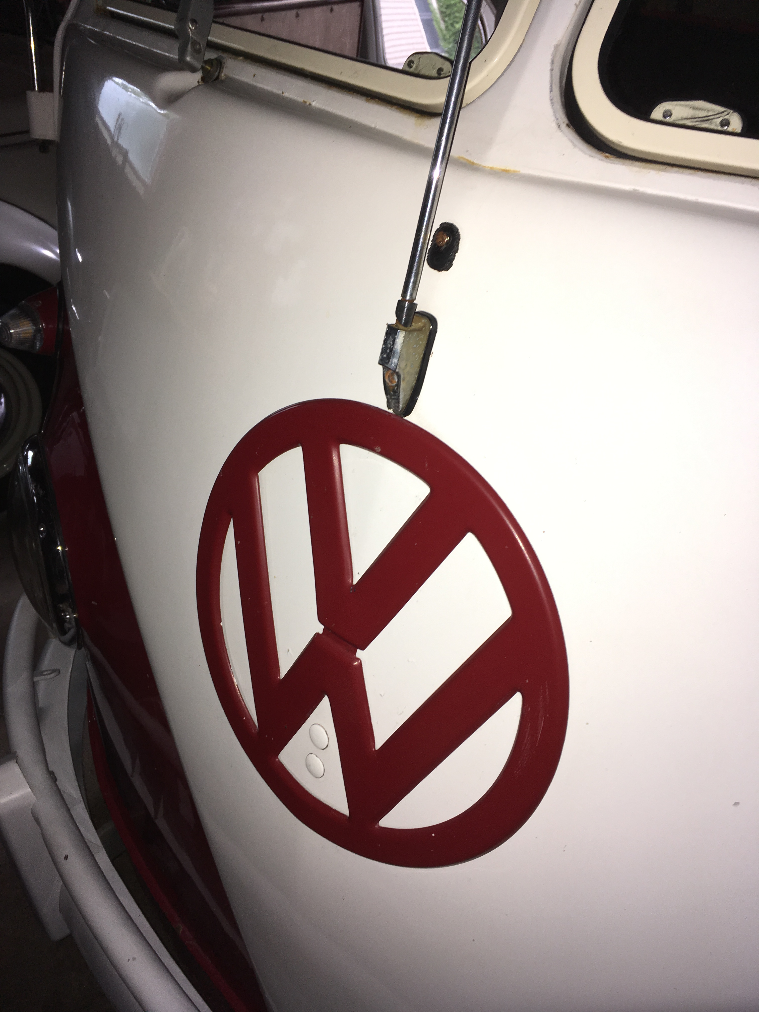

I am deciding if I want to keep the original crusty antenna, or install a new one. I purchased one from Wolfsburg West and I am not happy with the quality of the antenna. If anyone has a nice looking, easy to clean up "original" antenna, I would consider buying it from you. I would consider the 2 post mount style or the single. There looks to be holes that were plugged in the emblem, so I am not sure if that was an antenna mount location or not.

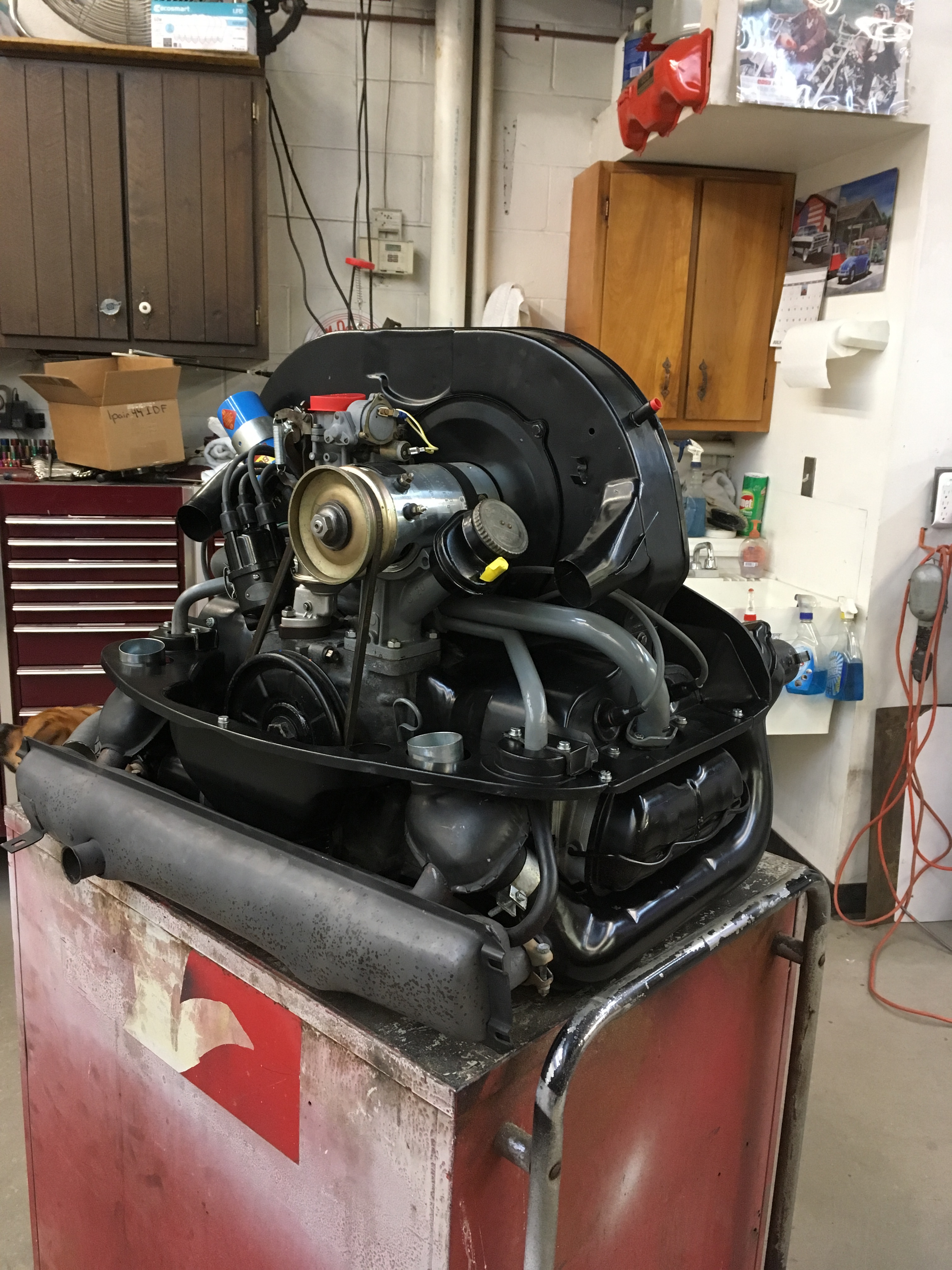

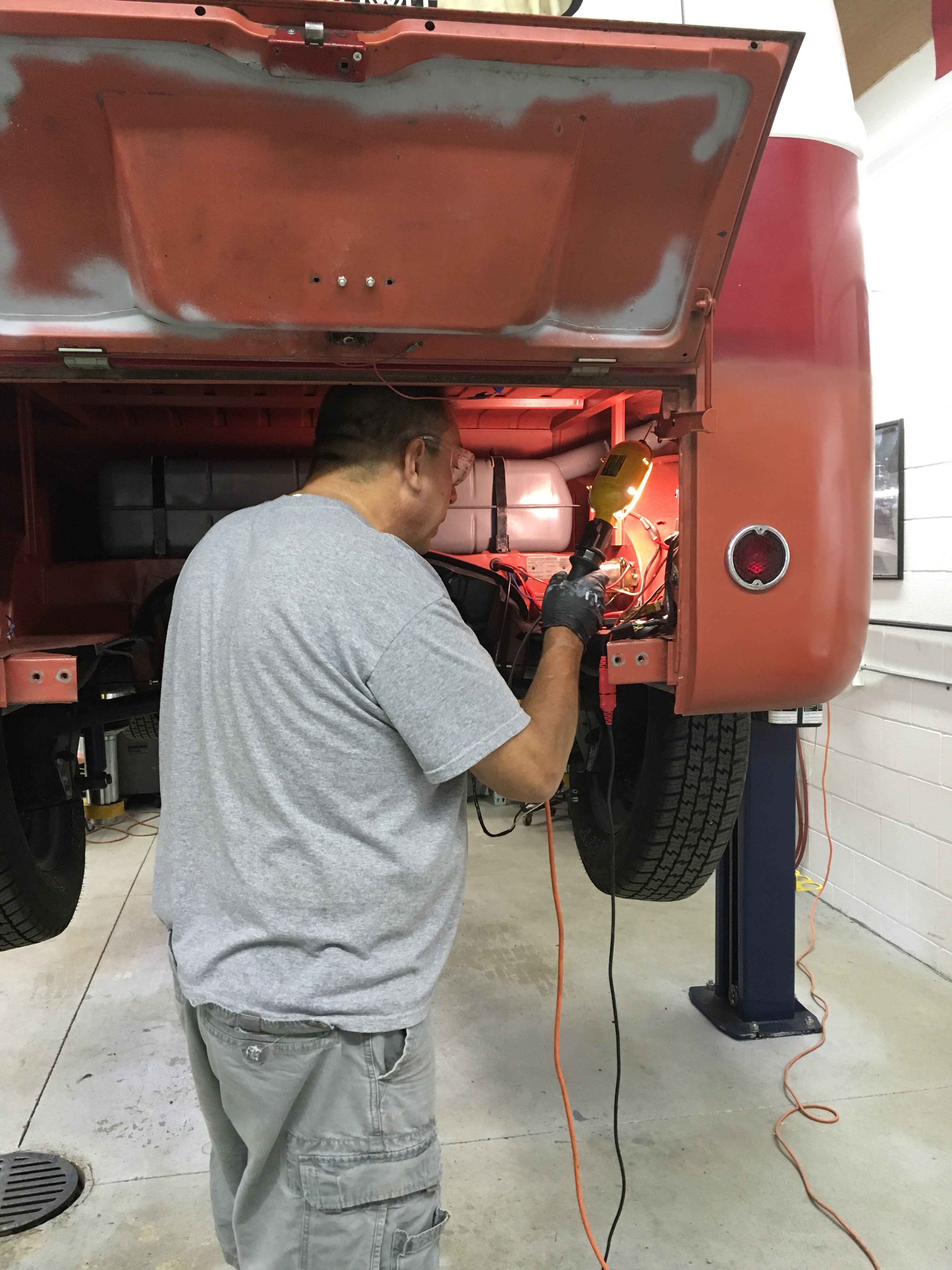

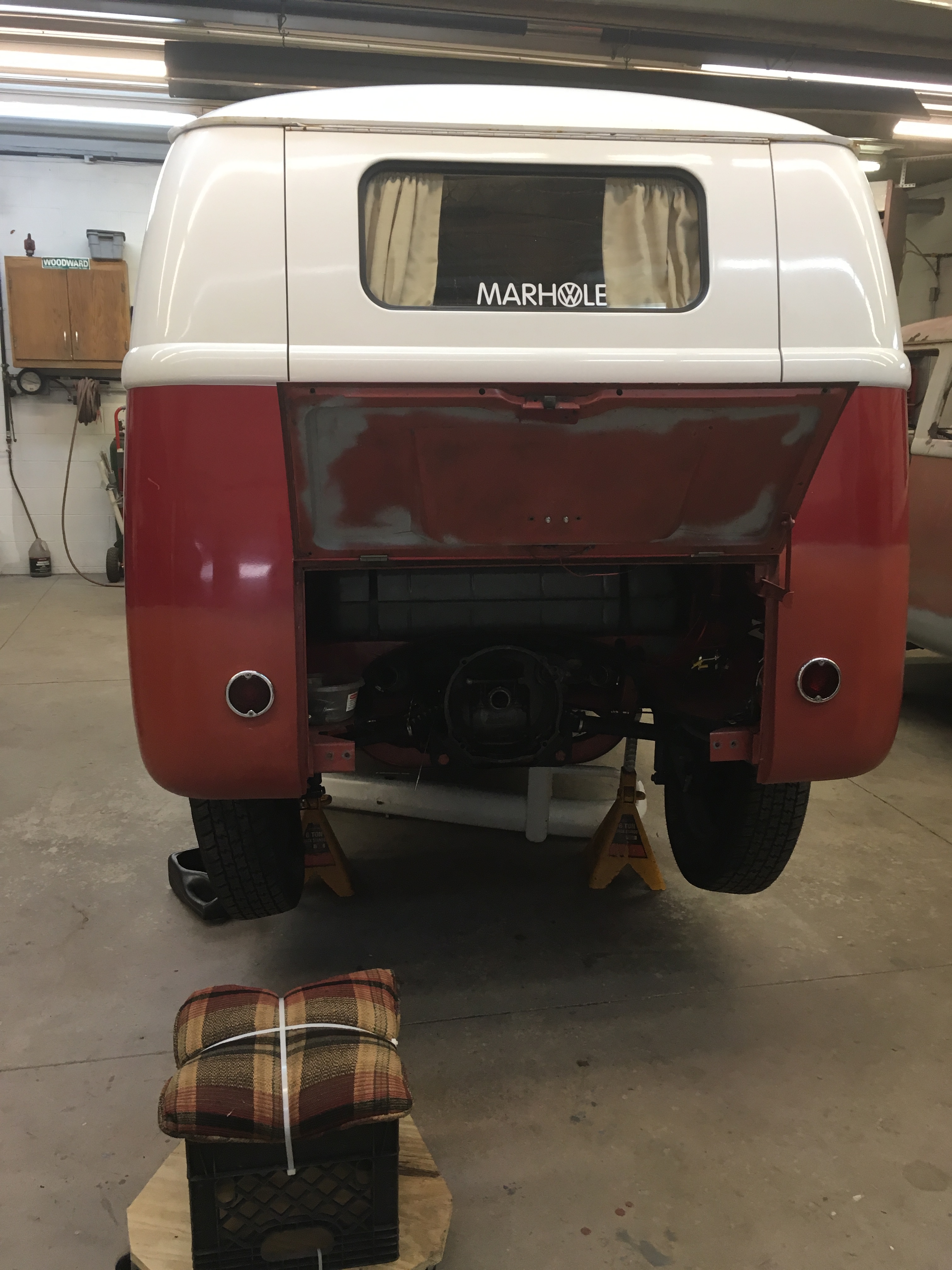

Some of you may have heard Gunther had some issues on the way home from the Vermilion Beach Market. Long story short, I ended having it towed to Bruce’s shop who ended up taking the engine out to Rich Sedoris (RIS) for an engine re-build. It turned out there was an issue with the main bearing. You can go to the rismachine/tumbler page to see all that was done to the engine if it is of interest to you. While RIS was doing the re-build I took the opportunity to make some minor upgrades. I had to replace the crank, so I got a new counter balanced crank from CB Performance. I also got a new oil pump with the oil filter on the side, and I had RIS replace the original valves with new stainless steel valves. My valves were not damaged at all, I just wanted to give it the extra belts and suspenders. RIS was able to turn the engine around quickly and I was able to drop it back off to Bruce to have it re-installed. I picked it up on Friday and he is back to running like a champ again. Freeway driving was a breeze, great acceleration and good power. Bruce did a lot of other things for me while the bus was waiting. Among other things, some electrical fixes that were needed in the engine bay, adjusting brakes, some front end adjustments and a general lubrication of all hinges, door latches and replacing missing hardware. We were able to get power back to the sconces and water pump that were accidentally disconnected in the last run of fixes. Amazingly enough the LED sconces only draw .01 Amps when they are both on. I got warm white bulbs so they look great.
A big thanks to Bruce for all of his help, to Bill for getting me parts in a pinch giving great advice, and to RIS for the quick turn around on the engine re-build. I drove it around quite a bit this weekend. I am ready for an oil change and getting him cleaned up and ready for KI.

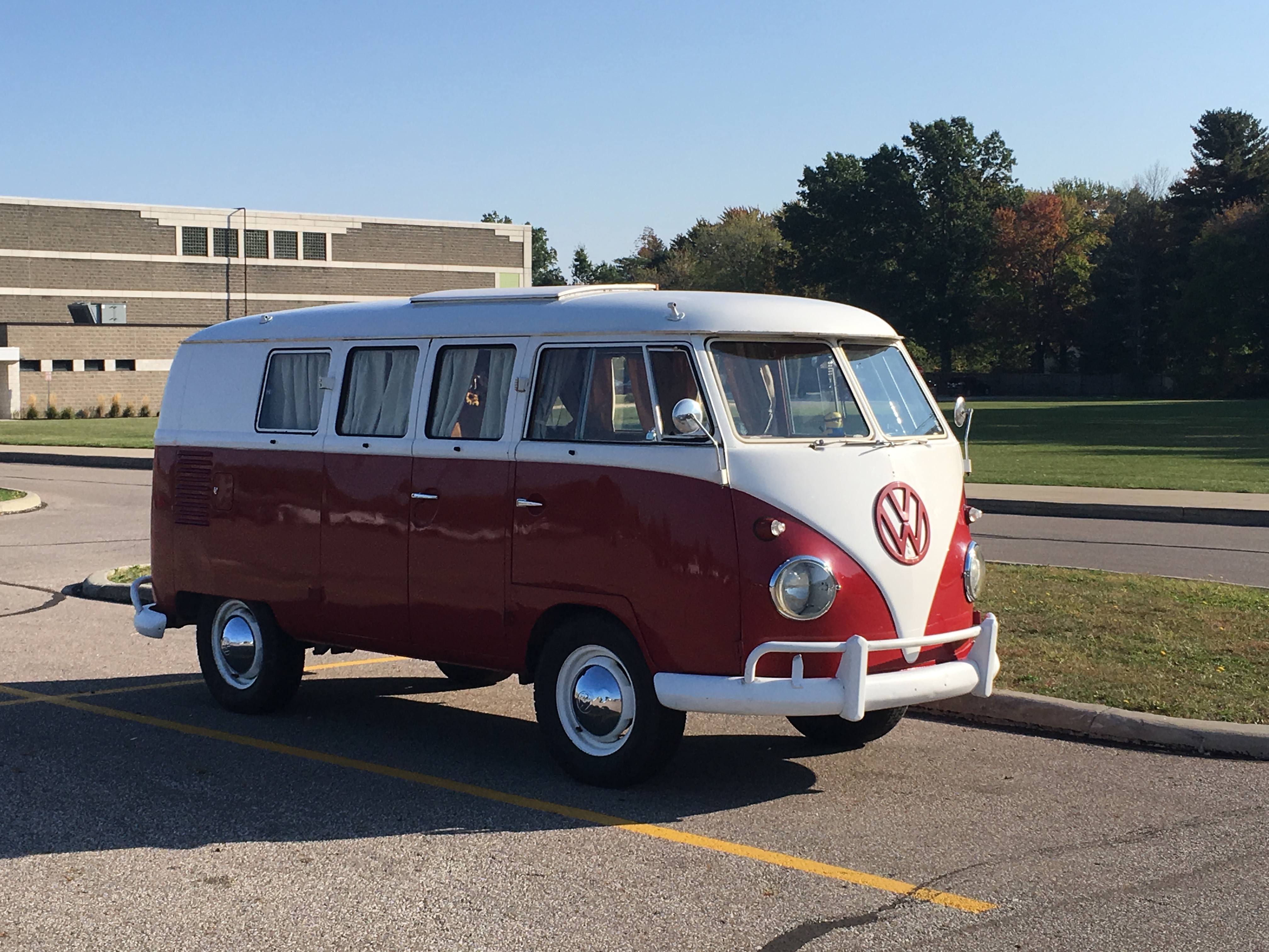

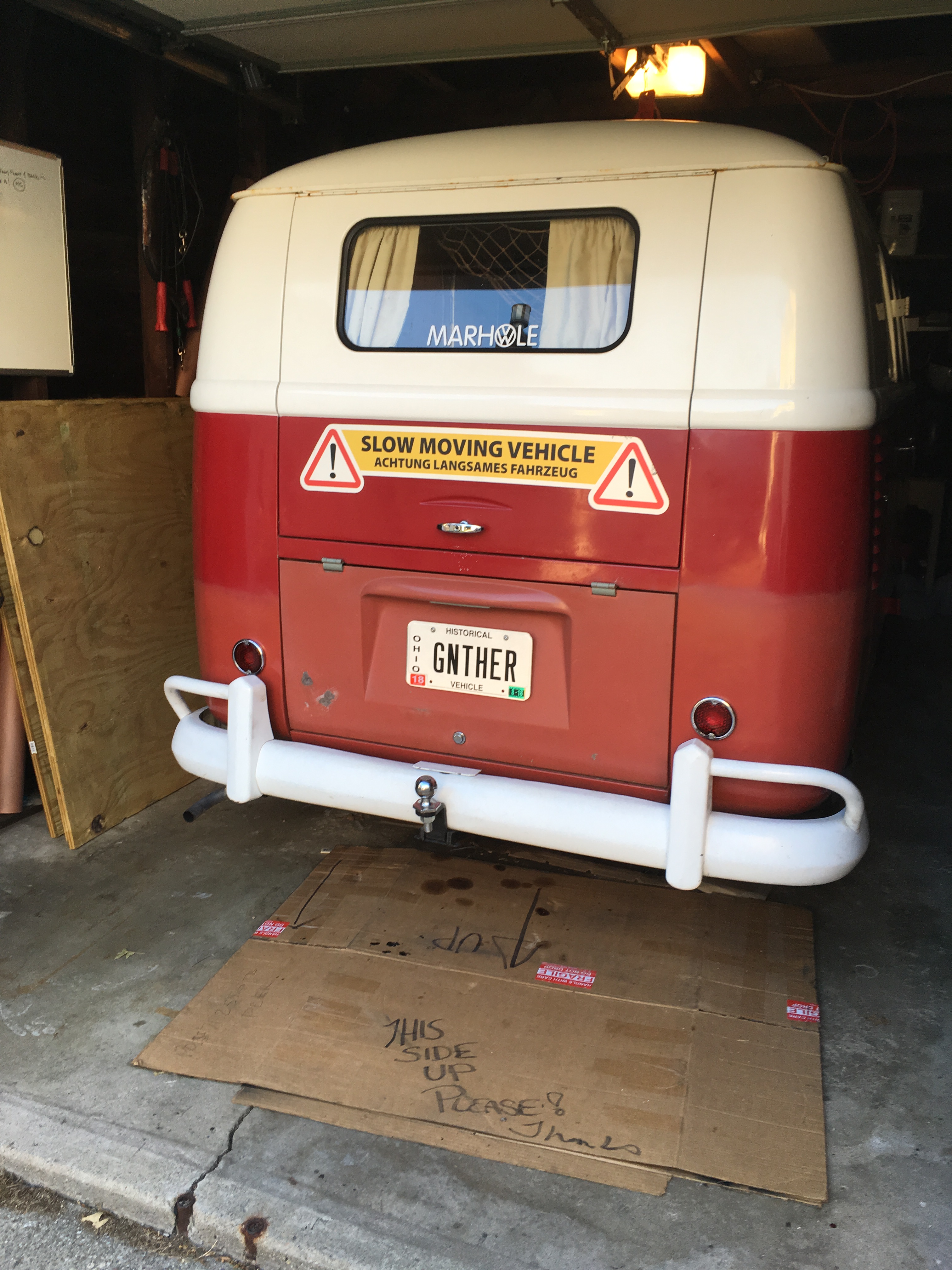

Running around town
Running around town
Back at home where he belongs

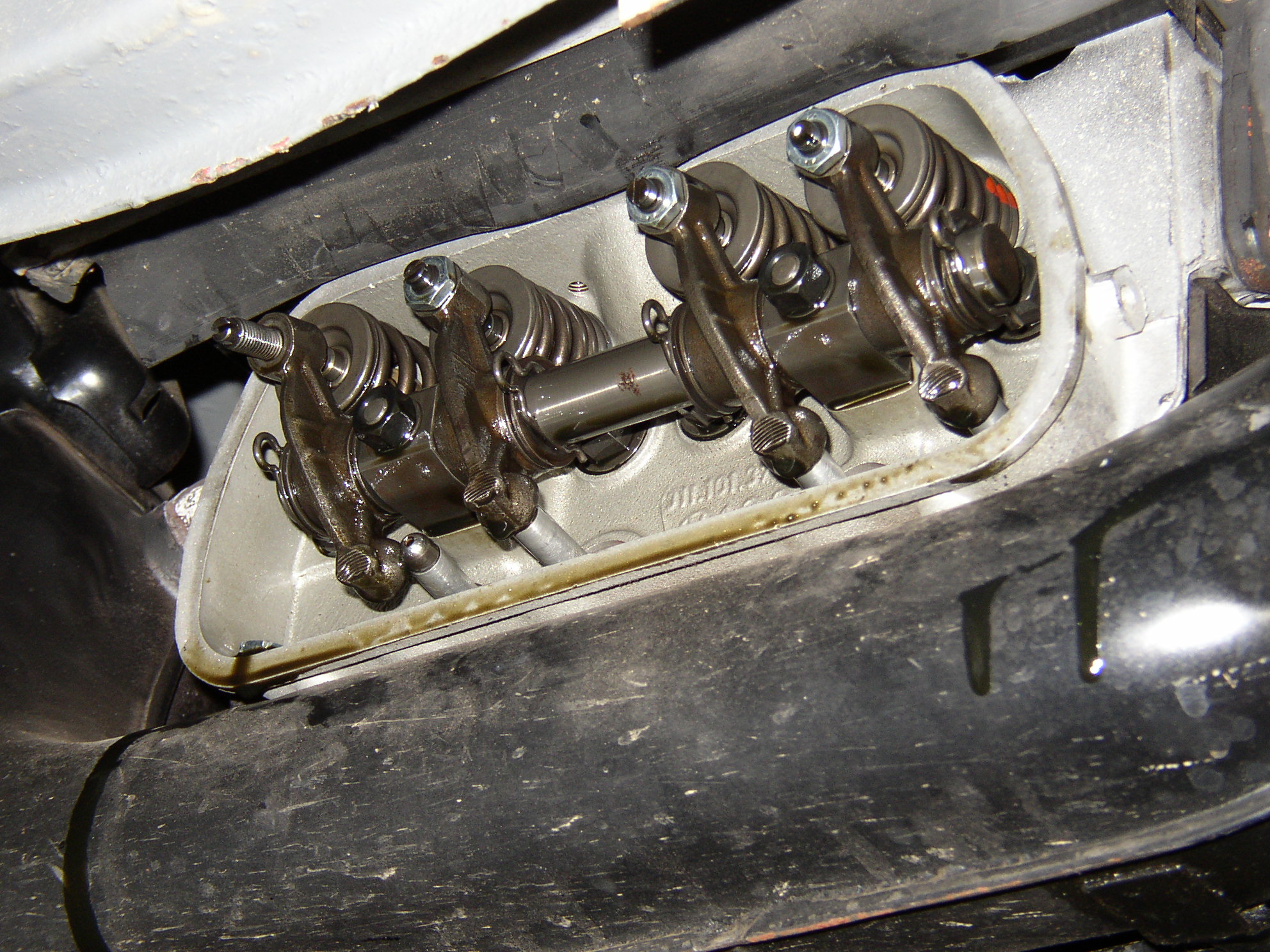

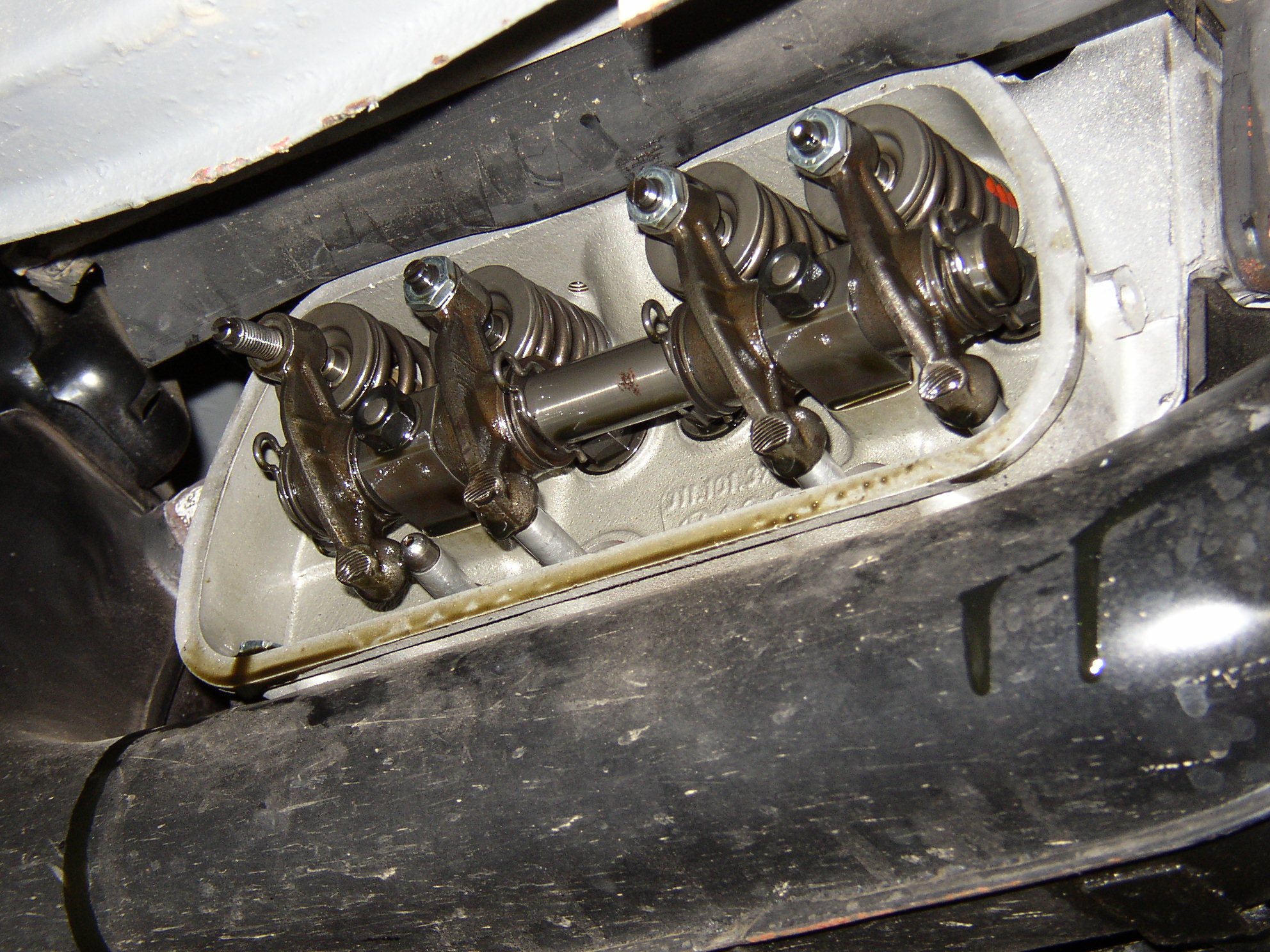

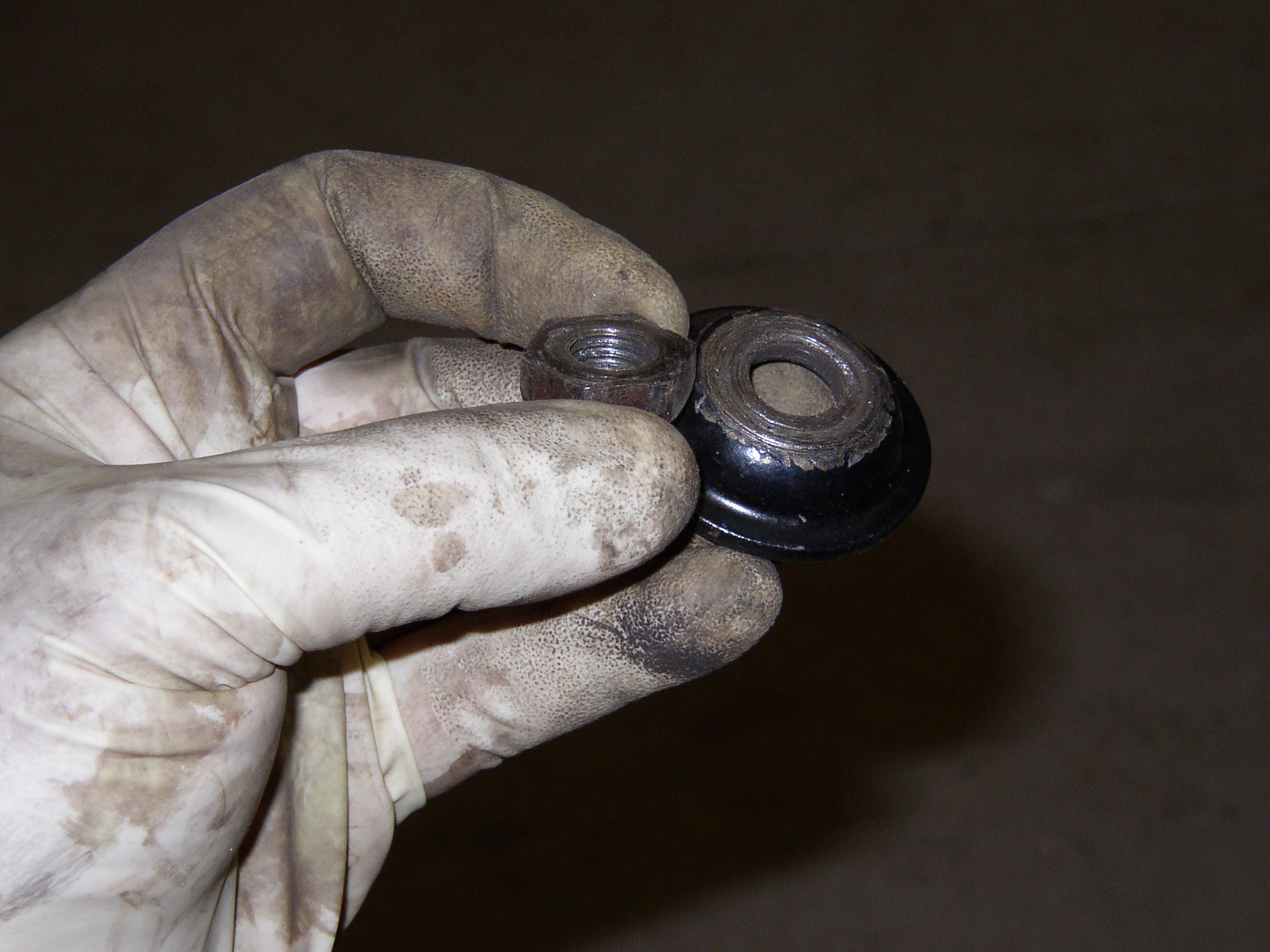

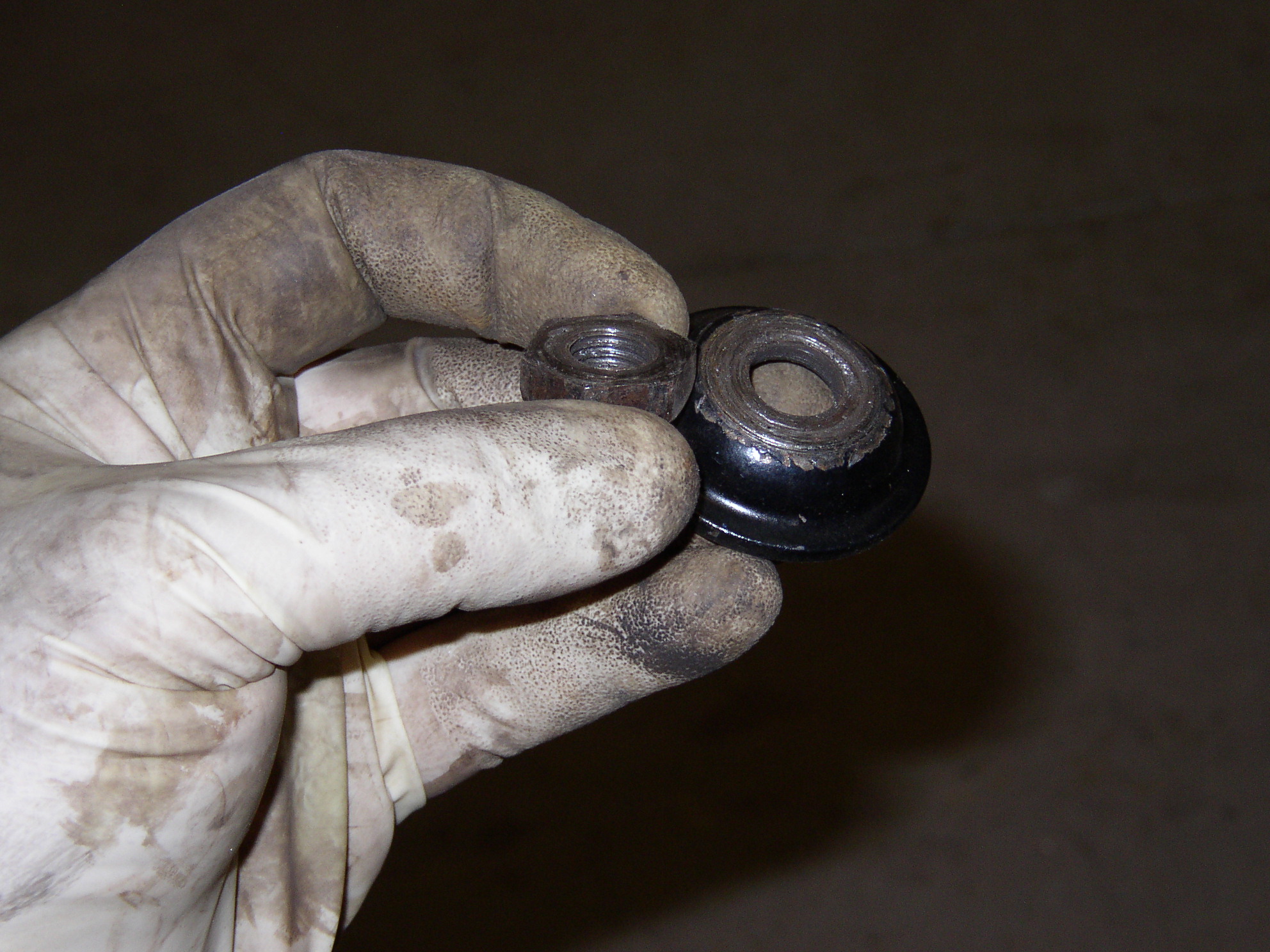

Well, it started out simple and innocent enough, a valve lash adjuster loosened up, the nut walked off, the screw backed out and the pushrod fell out. This caused constant backfiring into the intake manifold because it was an exhaust valve not opening. No sweat, put that back together, adjust the valves, good to go, right?

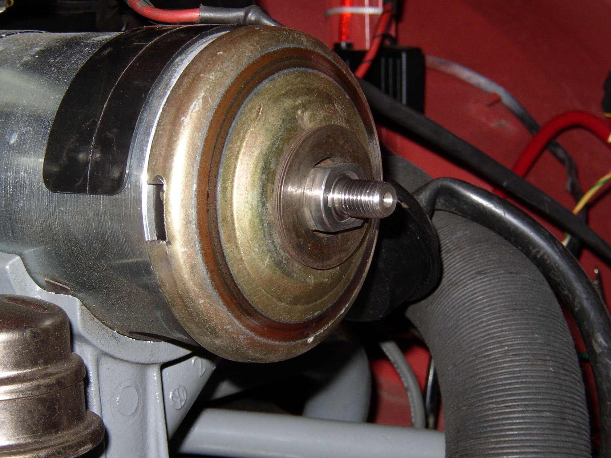

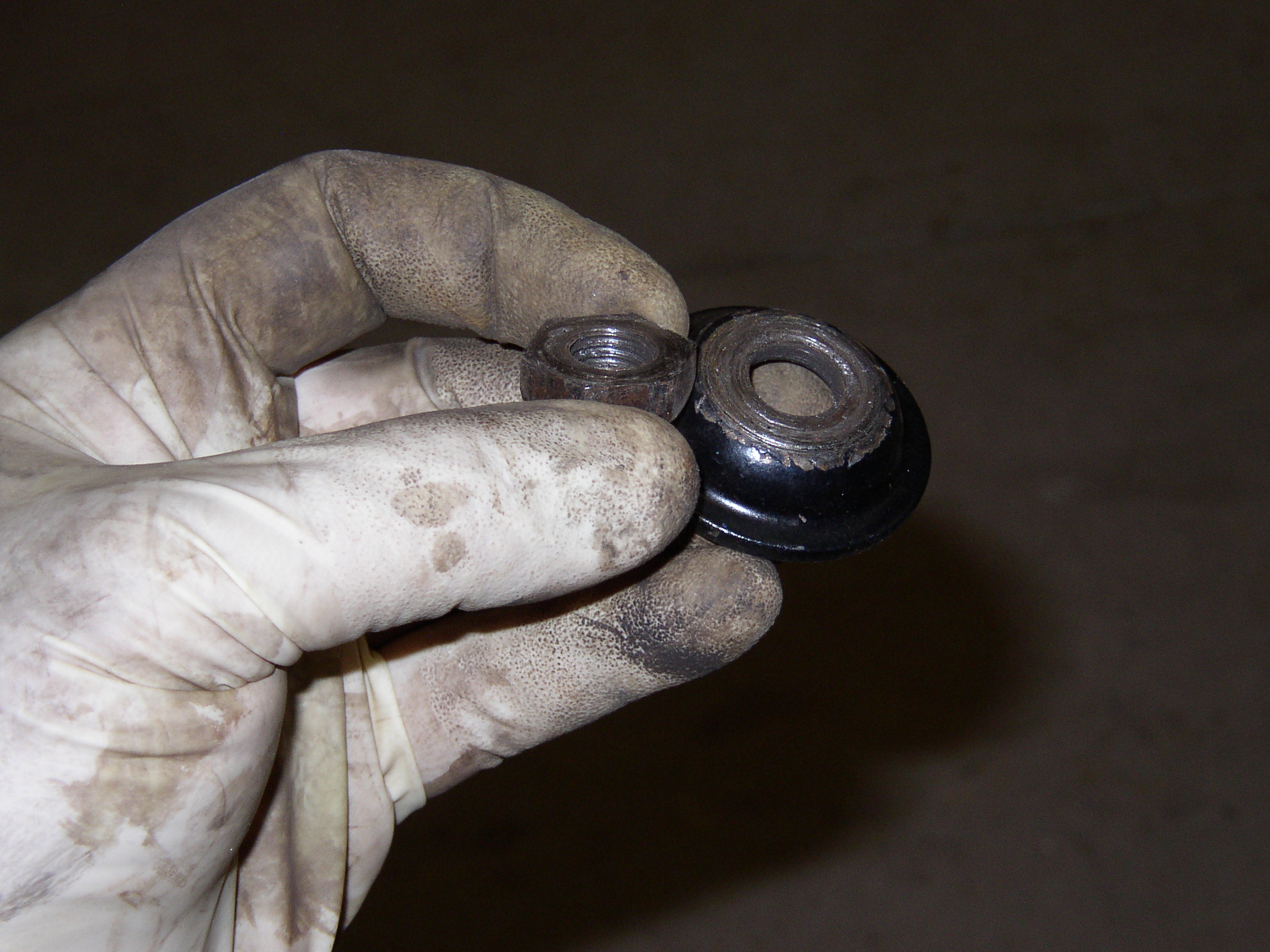

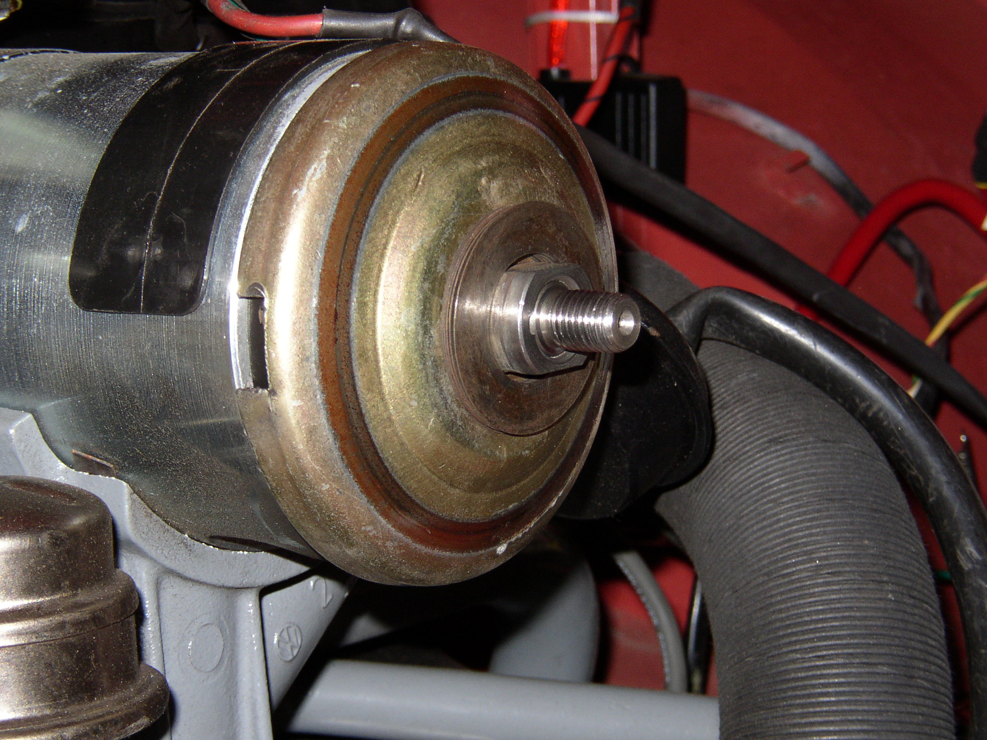

The fan belt's loose, better take care of that. Crap, the nut's all mucked up with the threads gone

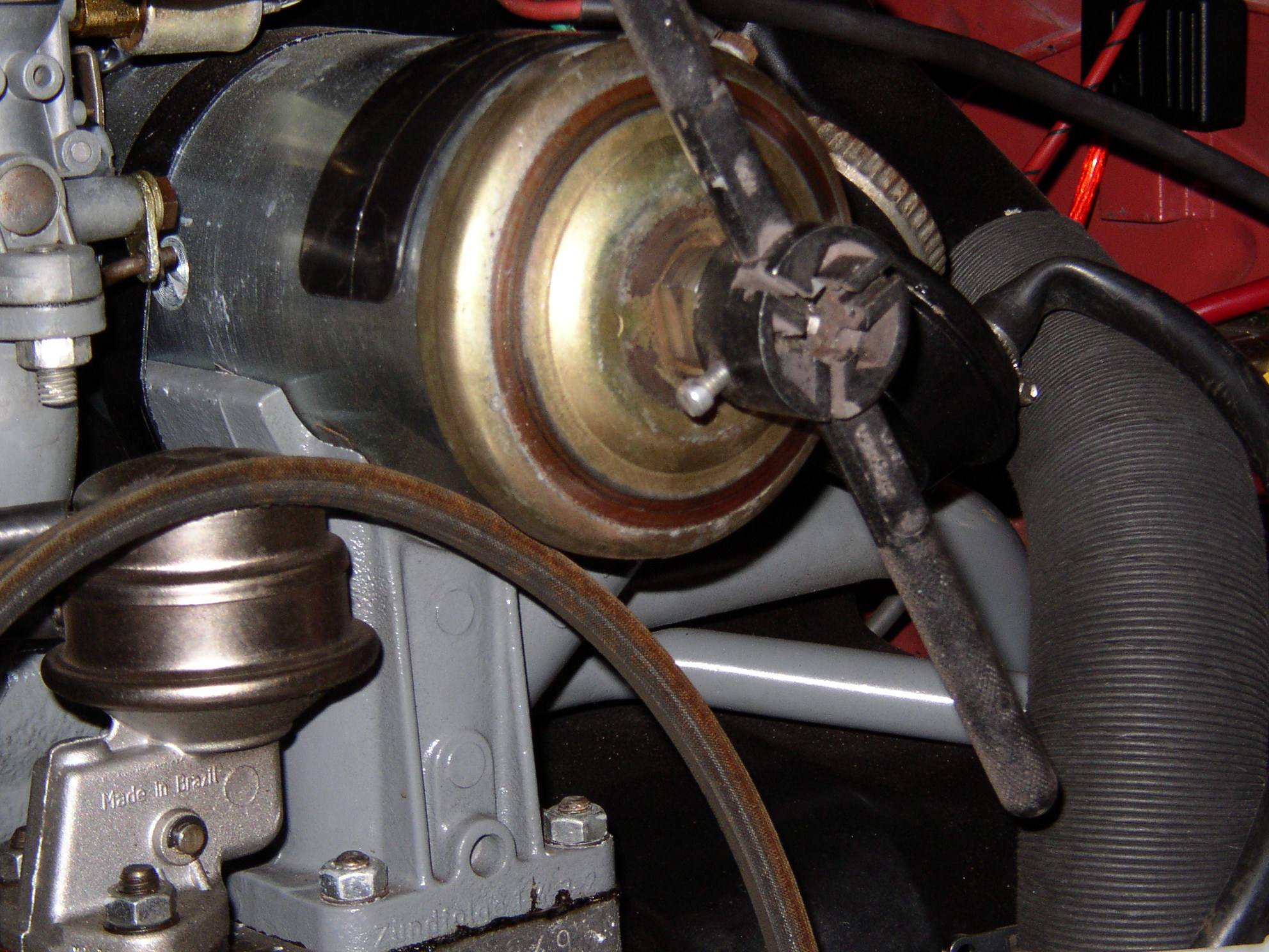

and deposited them on the gen shaft.
No sweat, we have the technology. Chase the threads,

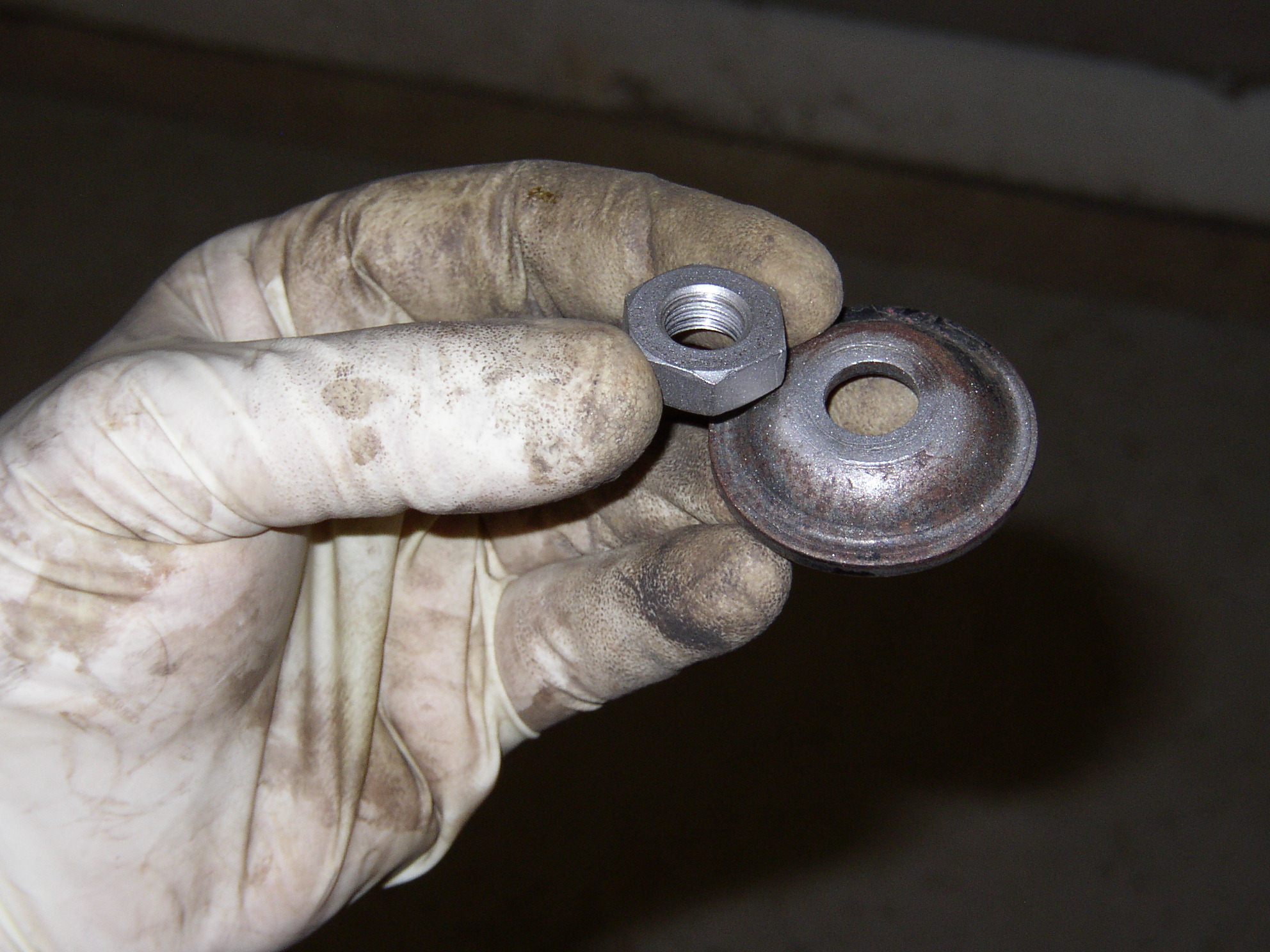

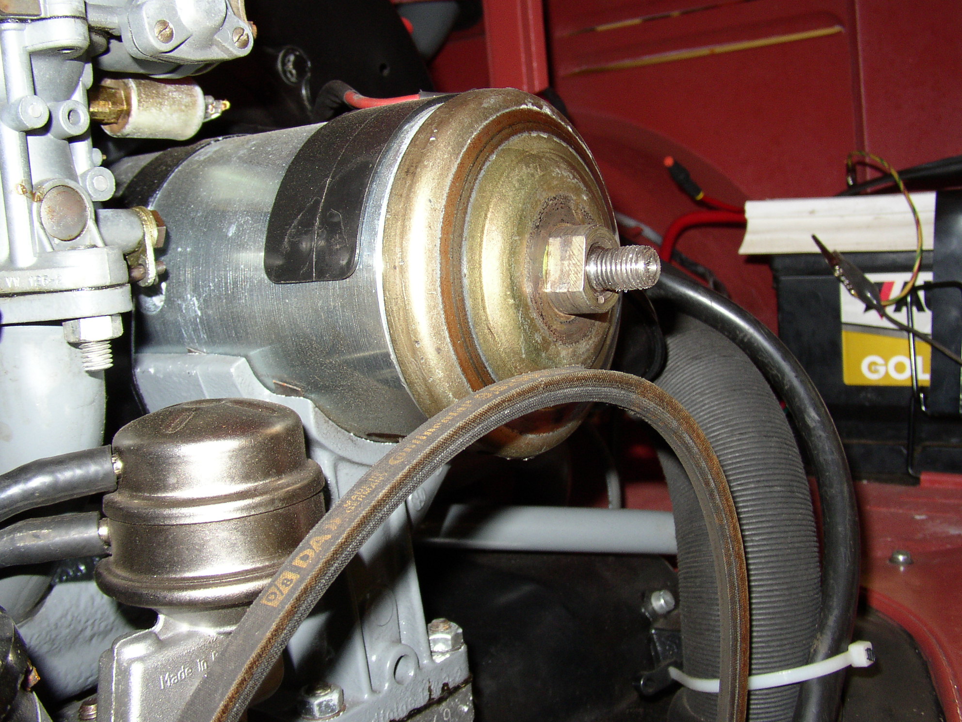

Find a nice German nut and washer thing in my junk,
And we're good to go. Easy, peasy, she'll be happy, right?
