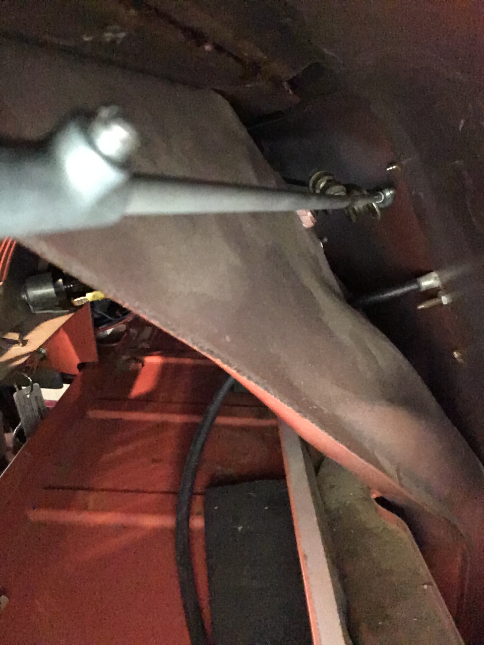

I finally got the wiper arm on the passenger side reinstalled. When I went to 12V, the pivot ends with the set screws were not in the correct location causing the arm to bind up and actually bend. Once that arm was bent, I couldn't get it straight enough to reinstall it the correct way. Thanks to HeyEd, who rolled it out and straightened it for me, I was able to re-install it the correct way. He pointed out the divots in the arm created by the set screws. Where the pivots were set to the first time, the arm was 1/16" too long. So I noted the correct original location and put them back on in the same exact location. They seem to be working fine now. At least for the moment and as good as the wipers can work. :D

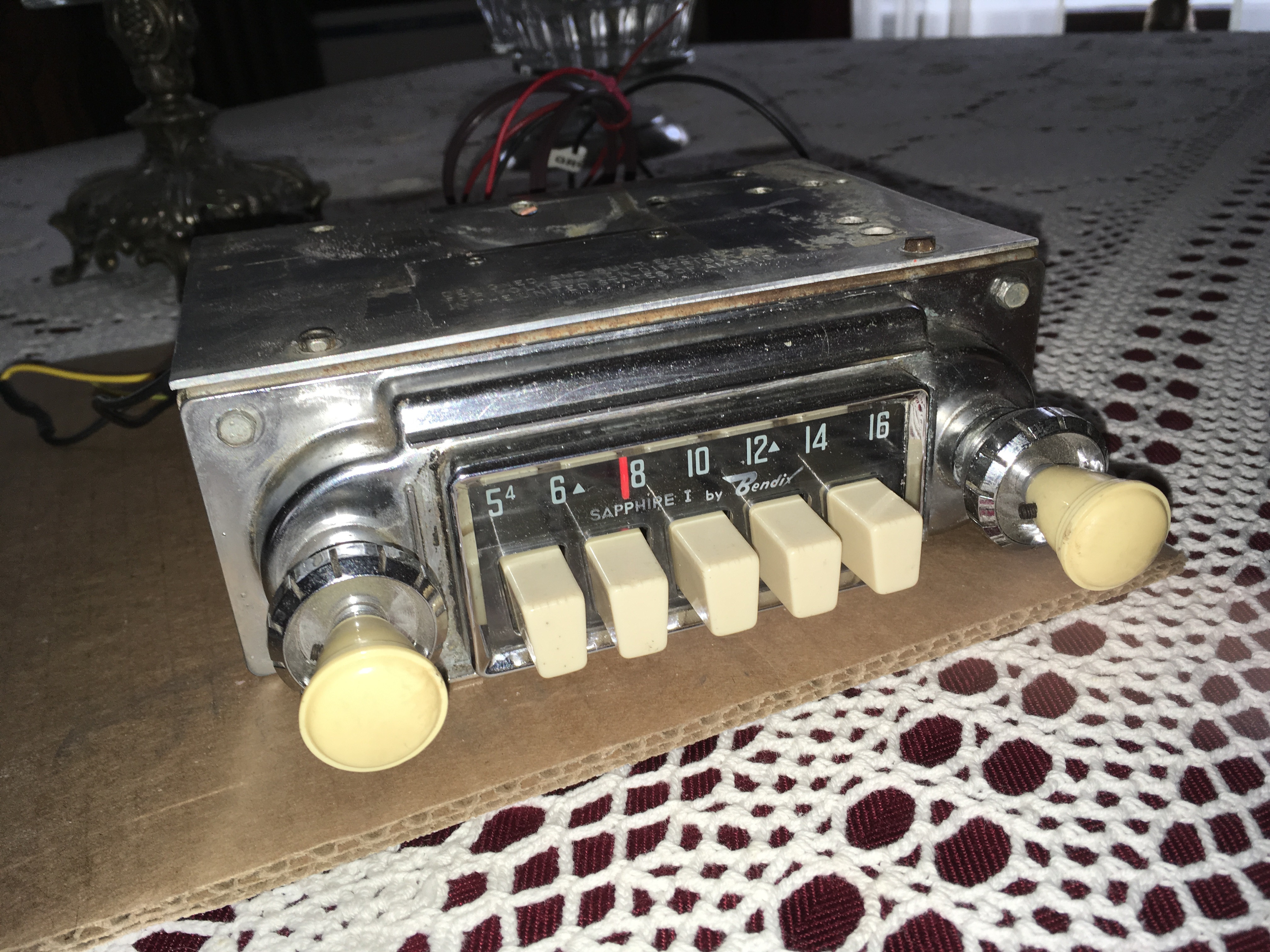

Now it's time to re-install the radio and then, possibly replace the antenna. The radio was sent out to have it rebuilt, fixed and have a voltage drop installed for the 12v conversion. He labelled the wires for me so I should be able to get it working without too much trouble.

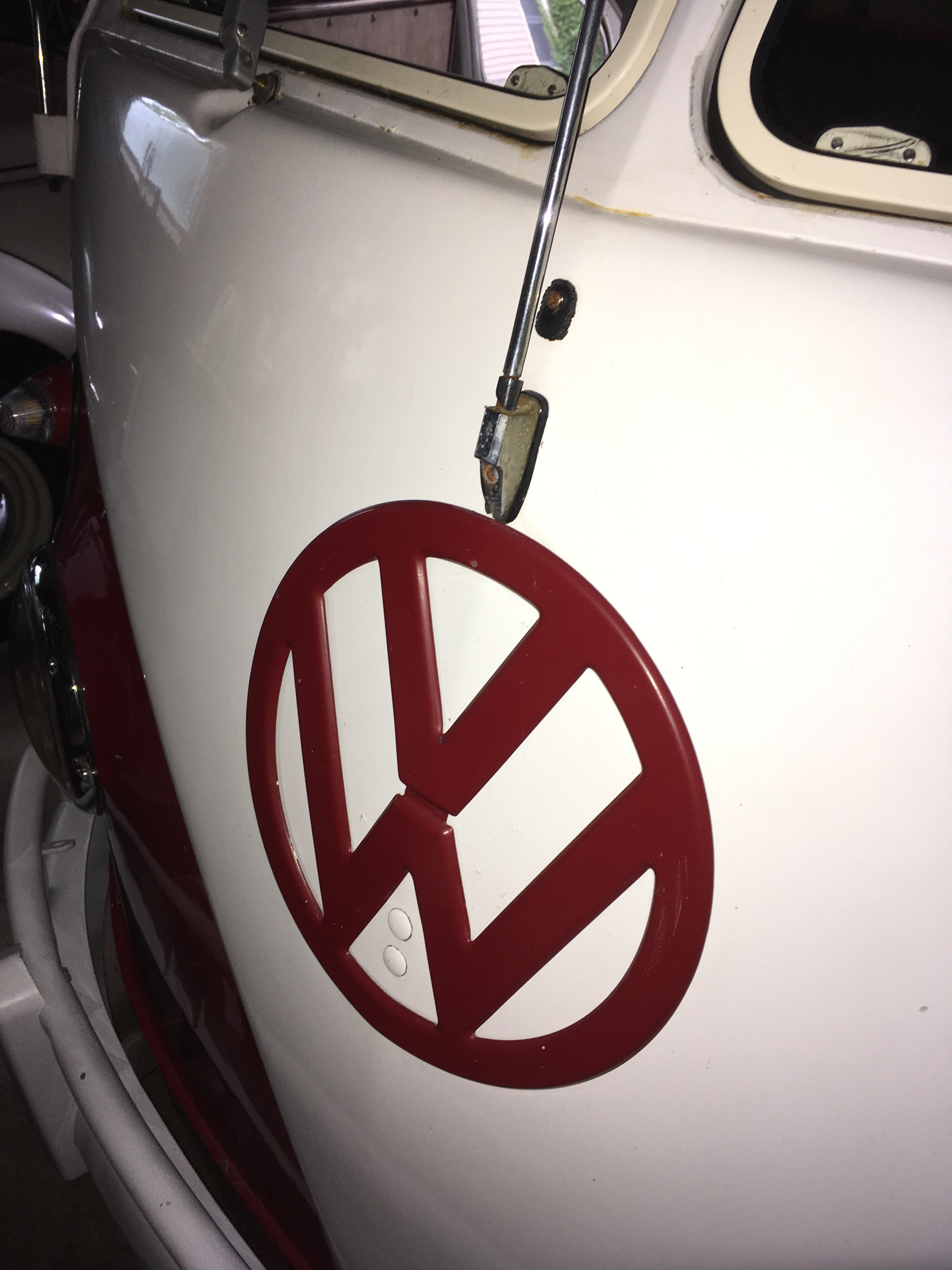

I am deciding if I want to keep the original crusty antenna, or install a new one. I purchased one from Wolfsburg West and I am not happy with the quality of the antenna. If anyone has a nice looking, easy to clean up "original" antenna, I would consider buying it from you. I would consider the 2 post mount style or the single. There looks to be holes that were plugged in the emblem, so I am not sure if that was an antenna mount location or not.
