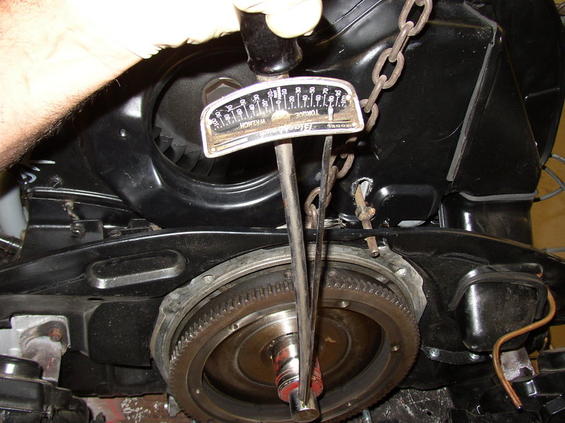

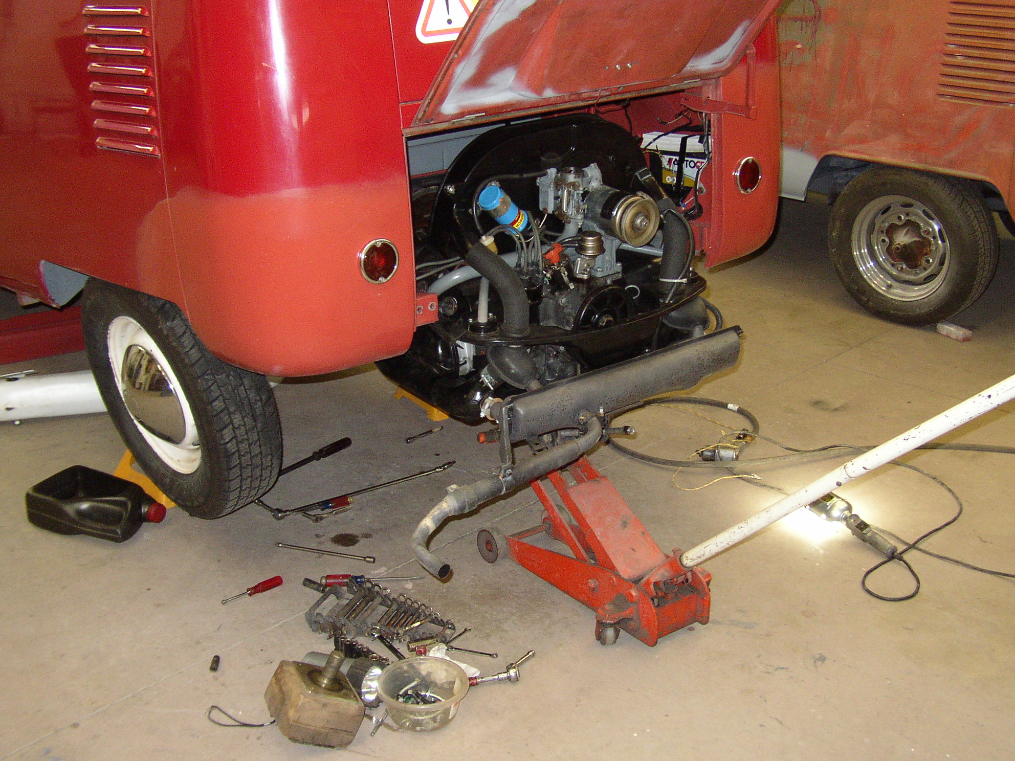

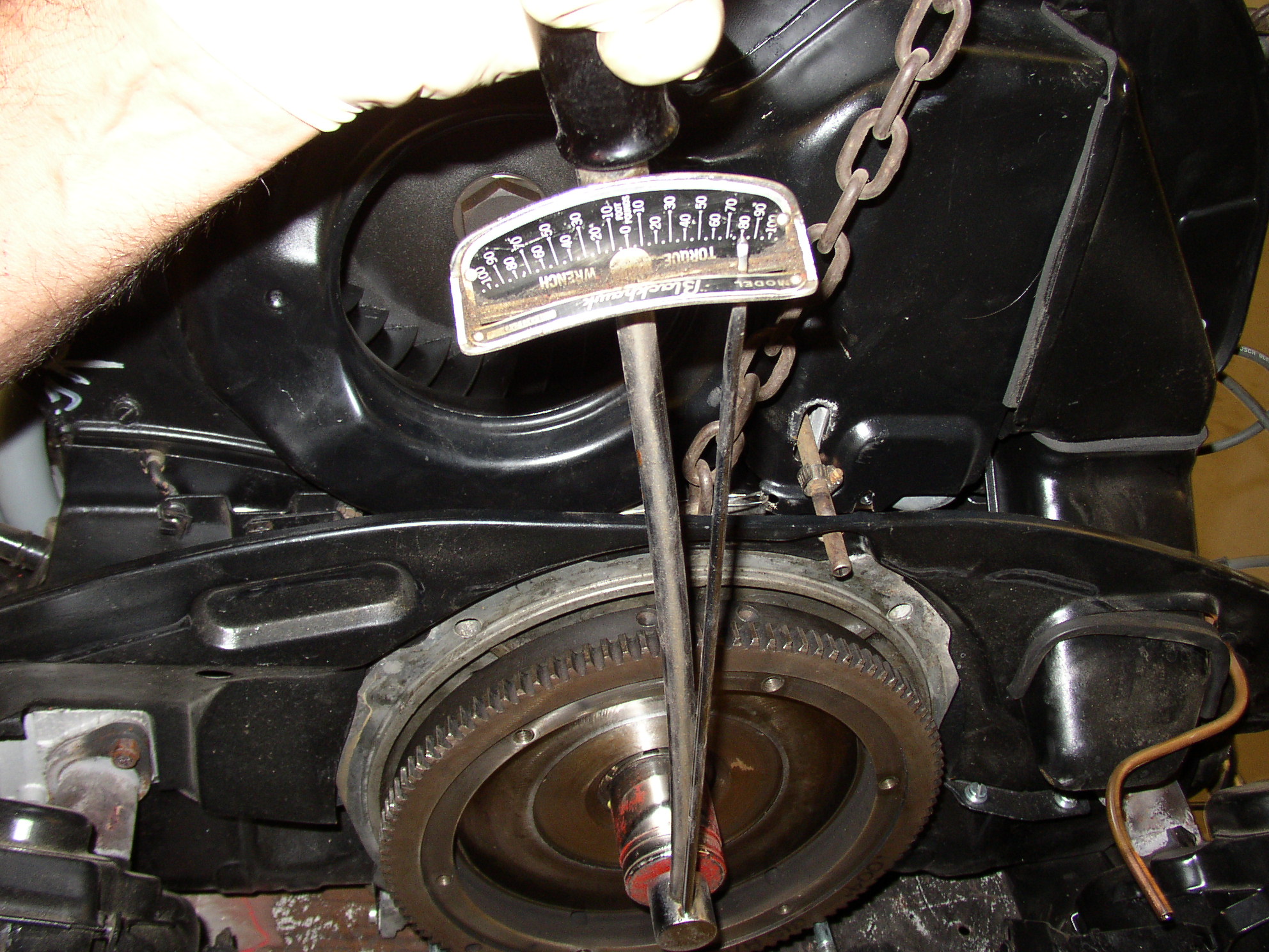

Then the rolling black cloud named 6Volt came down and Marla's luck turned to $hit. I put a timing light on it and the timing seemed like it was off quite a bit but I wanted to verify TDC. I put a wrench on the engine to find TDC and things went really south from there. I had Sean take a video but it's laced with inappropriate language so I won't post it here. ;) The engine will barely turn over with all my might on a crescent wrench. WTF? I thought maybe the starter had bound into the flywheel or the FW/clutch was rubbing on the bellhousing so I pulled the starter out to find nothing. At this point it's starting to look like it's internal which is bad. Really bad.
Out she comes.

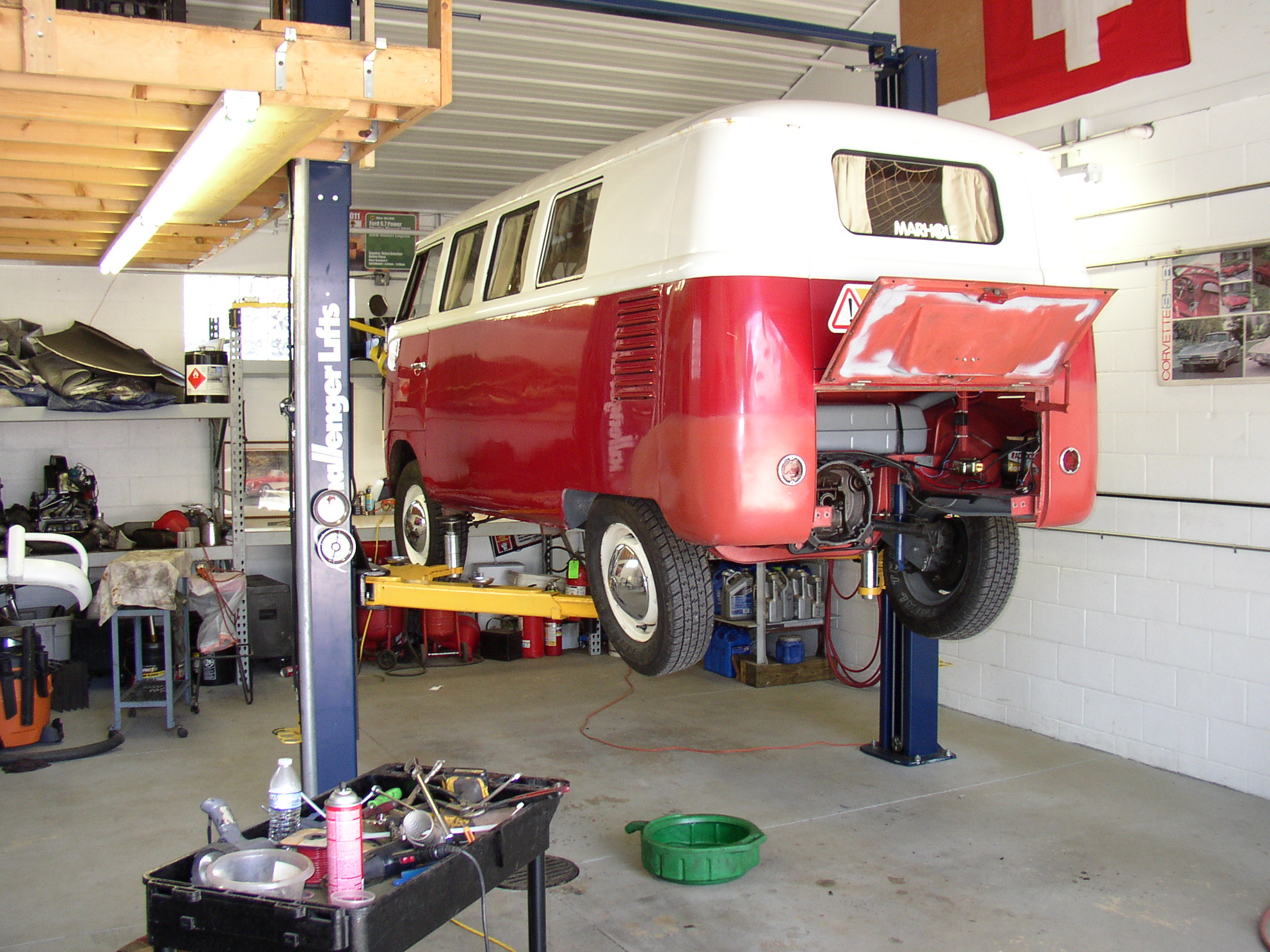

Somebody's Beetle was on the rack so here I am, lying on the floor like a dog.

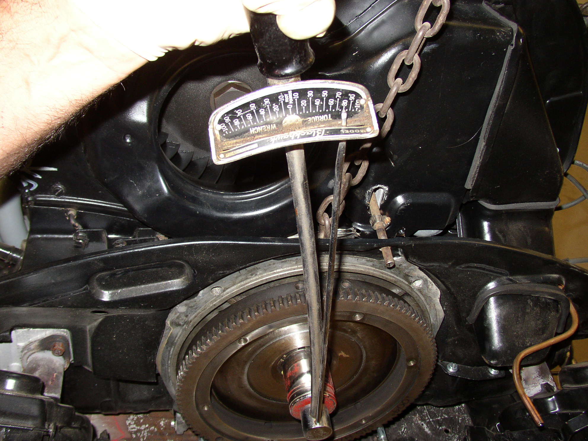

On the bench the engine takes way too much torque to turn but it has a funny little free spot of about 1" at the pulley where it turns free. 80 ft/lb? WTF?
I tell Sean the only time I've seen that is a seized main and mucked up main bearing dowel. Man, I had to open my big mouth. Off to Rizz's it goes.

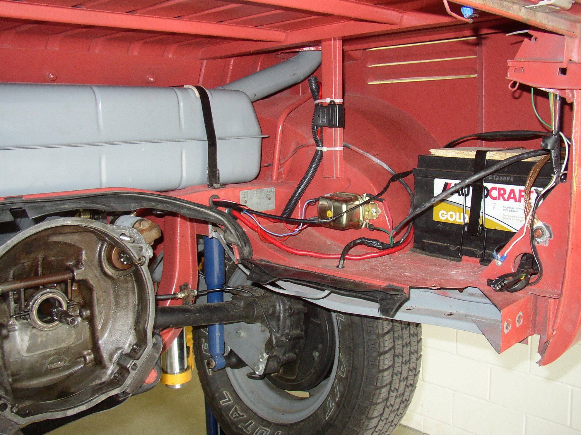

Meanwhile I might as well look it over so I corrected a bunch of little stuff that wasn't up to my standards.

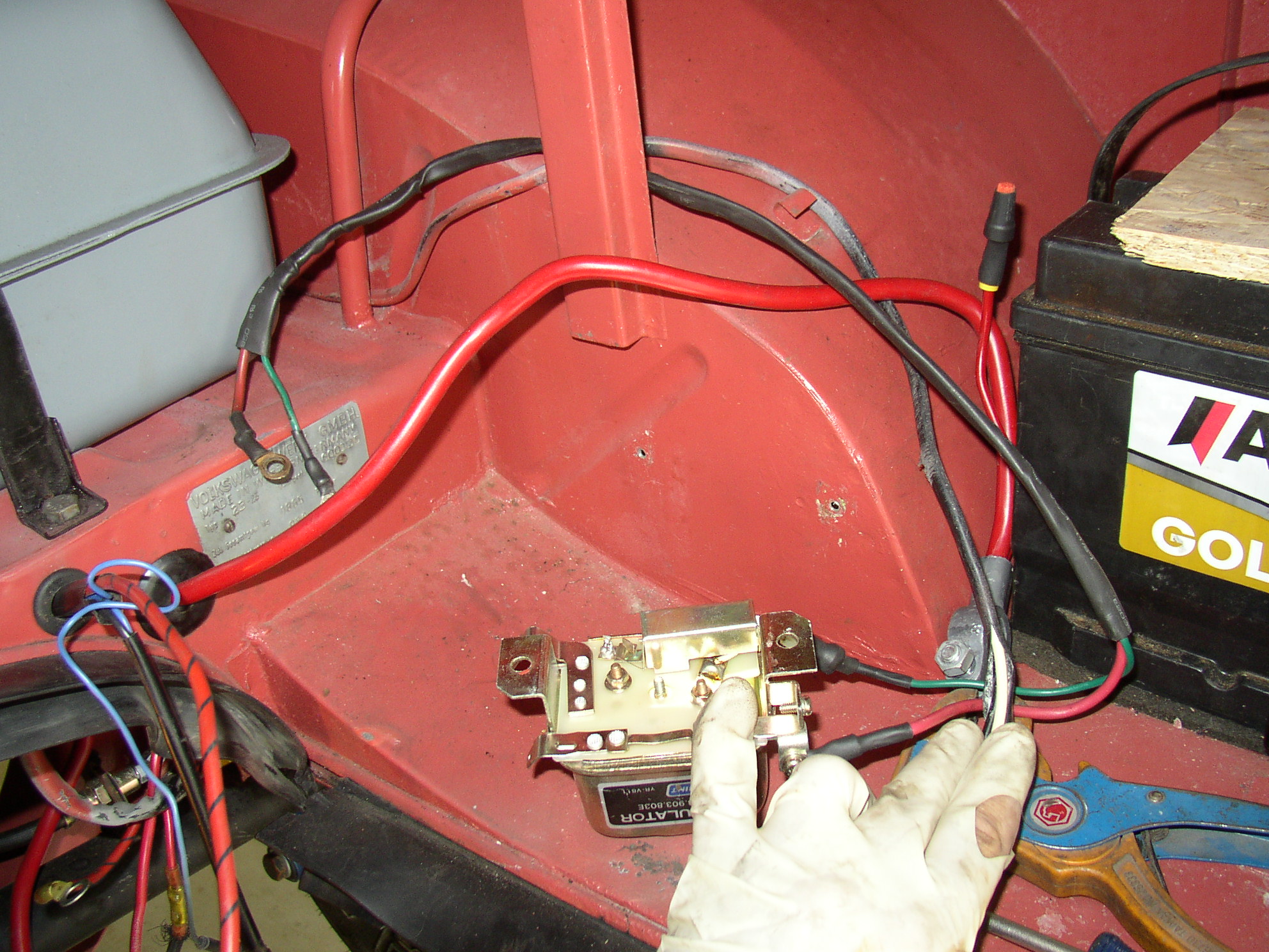

Wiring, cleaning connections,
adjusting the brakes, clutch, st box, greasing the front end, filling the leaky trans, lubing sticky door latches and hinges, cleaning grounds,

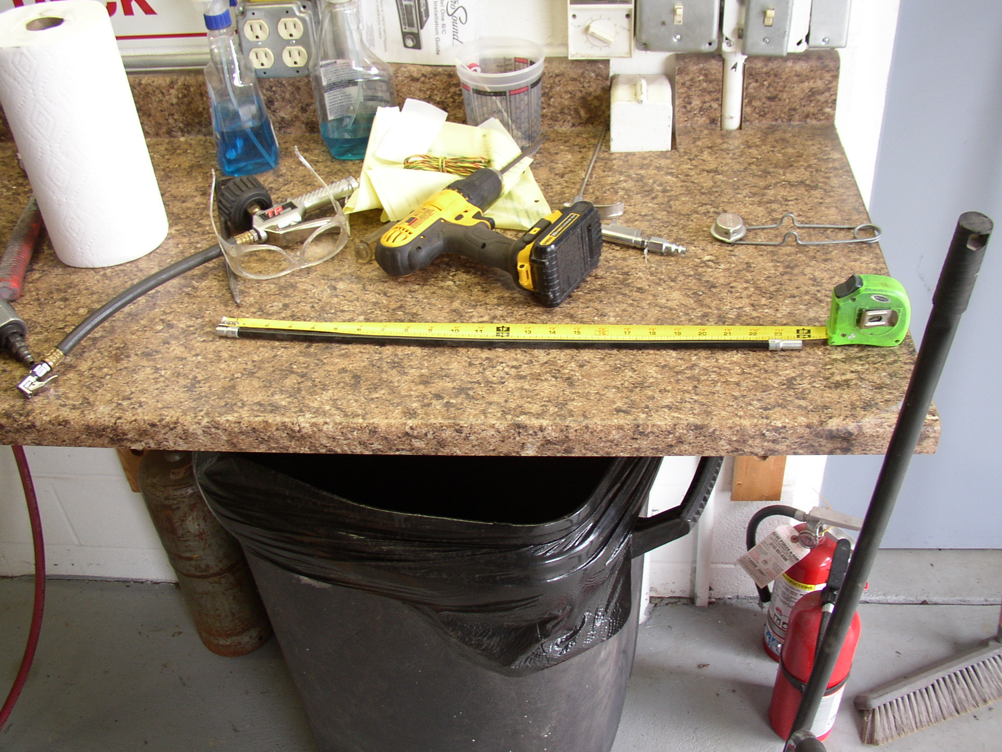

all stupid little maintenance stuff. I shortened and installed a throttle Bowden tube because she didn't have one and I don't like the throttle cable swinging in the breeze above the tranny the way VW did.

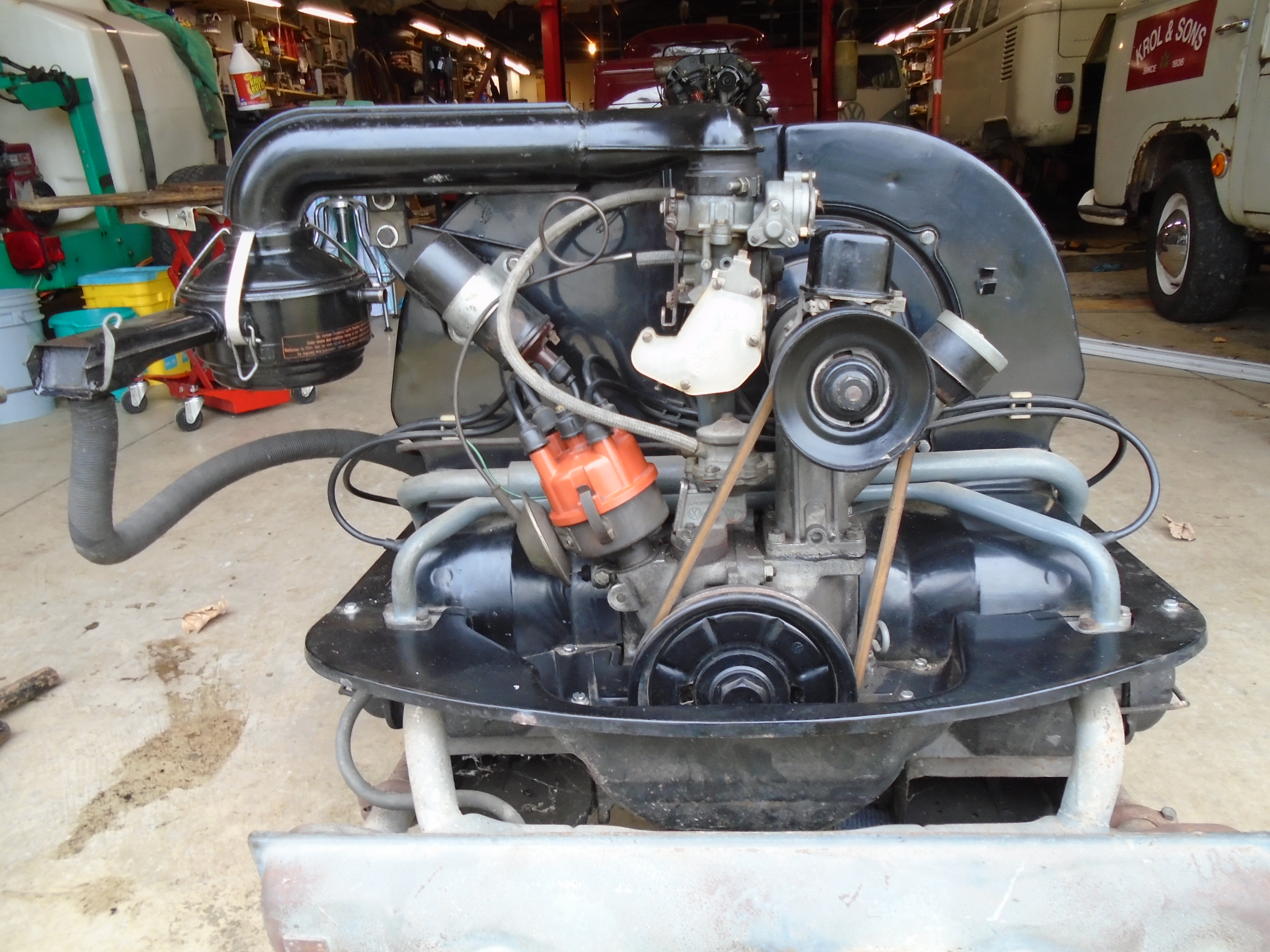

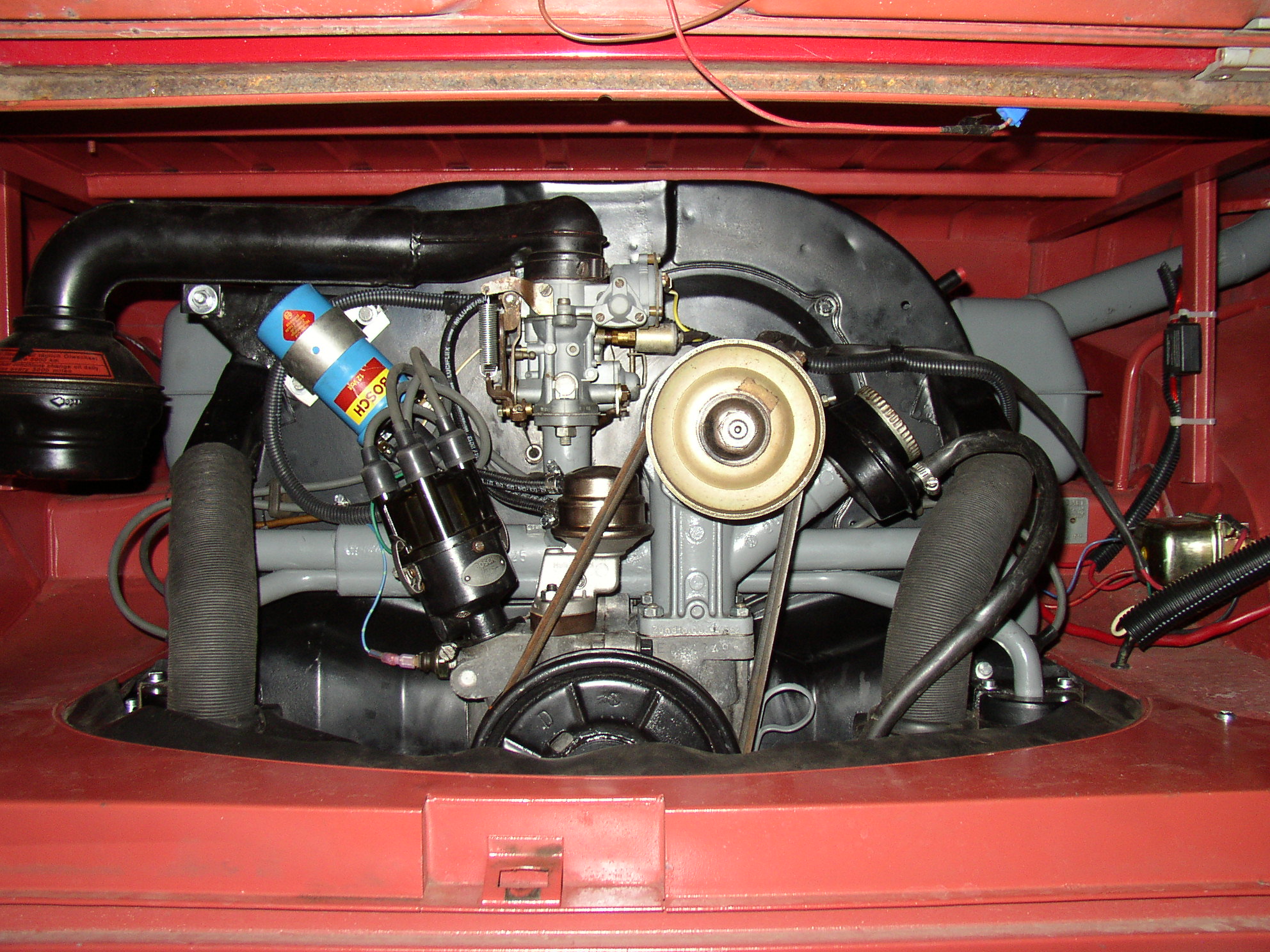

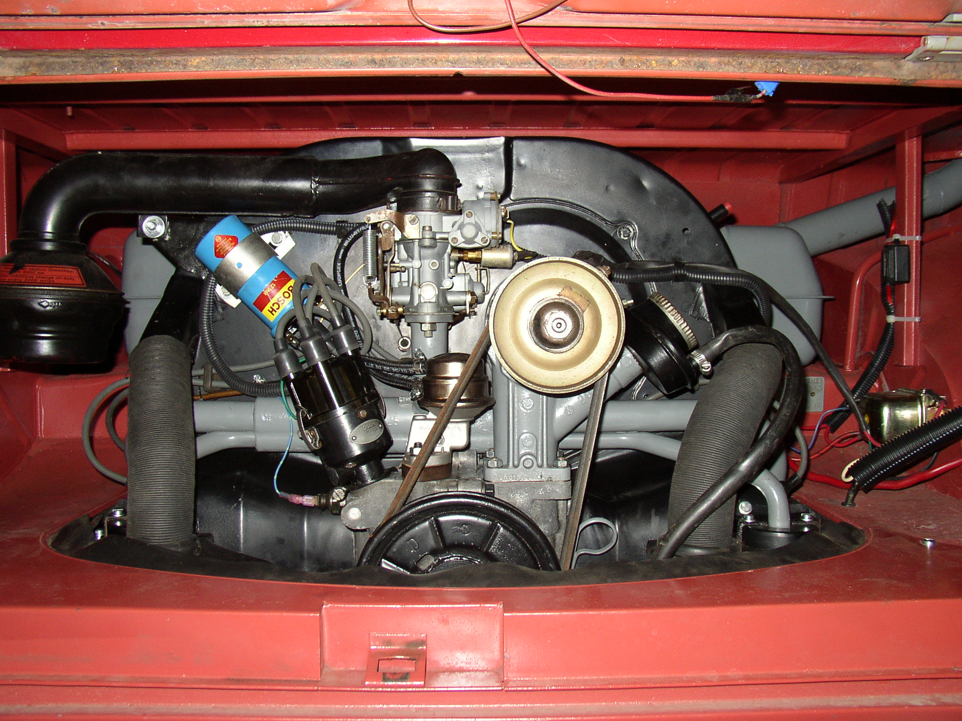

The only thing I don't like is the crankcase breather. Who's a 40hp guru that can tell me what's wrong here? If it were me I'd ditch the draft tube, weld a nipple on the air cleaner and go that route. I've looked at pictures on Samba until I'm blue in the face. Some have a nipple on the AC for the hose but most don't. How should this be set up?

The rolling black cloud has an assortment of G stands. Could offer this to provide both forms of venting. Not sure how many 12V ones I have.

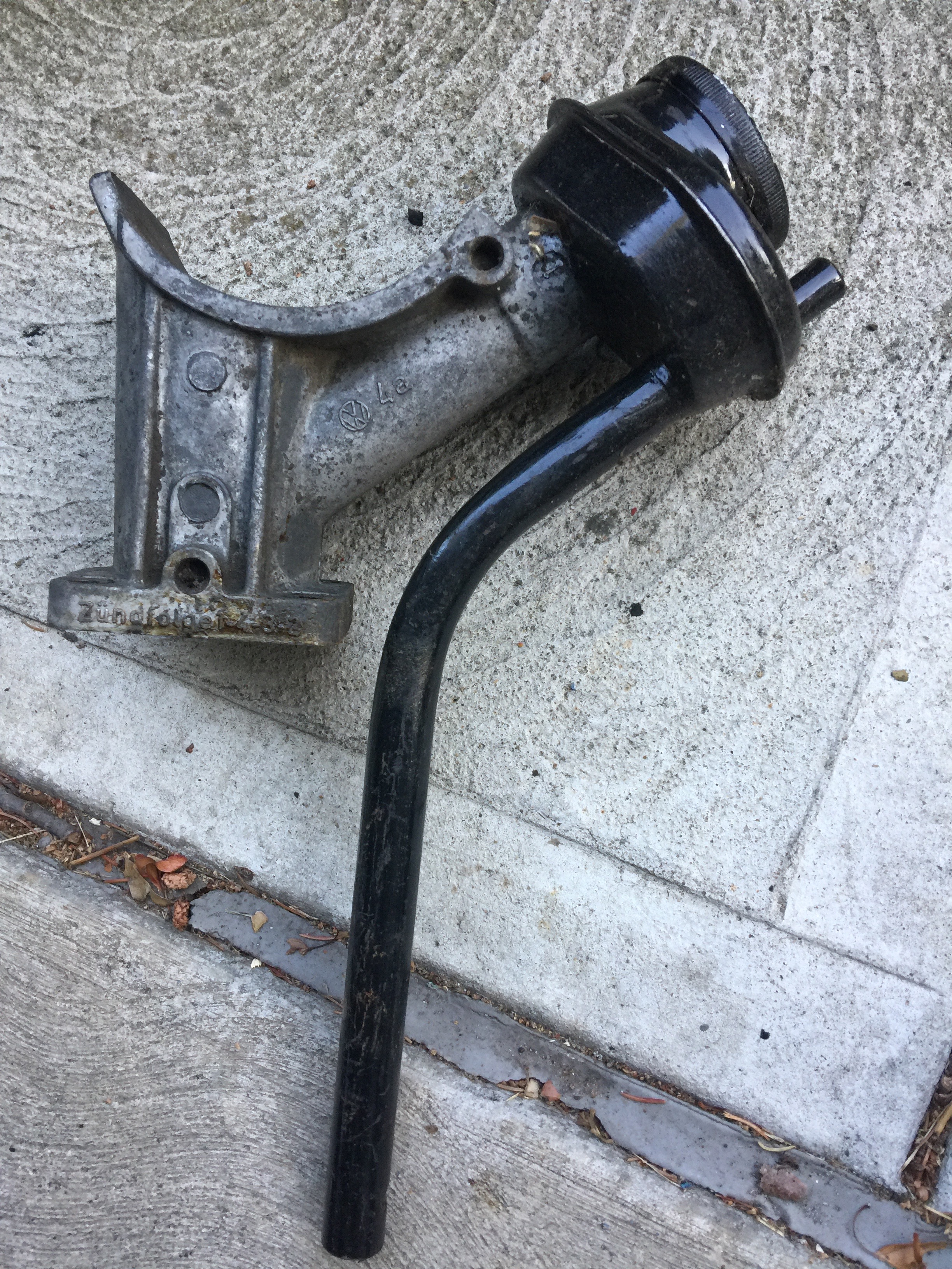

Looks like the nipple was welded on the air cleaner for the crankcase vent at the factory on my 63 40 horse.

I don't like the kink in the vent hose on Marla's oil filler. Would almost be better to vent to atmosphere with a small filter.

Yes, that tube was a temporary solution.

Ken: is there a 5/8" hose nipple on the back side of that breather/oil filler? Or does it vent to the atmosphere?
Option 1- find a 40hp breather like Ken has pictured above. Does anyone know if it will fit the top of Marla's generator stand? (it should?)
Option 2- http://www.ebay.com/itm/Breather-Elemen ... UU&vxp=mtr (or similar)
Option 3- weld a hose nipple on your air cleaner and install a breather hose
Option 4- buy the air cleaner linked in my previous post
Option 2 might be a little dirty- venting the fumes like that might build up an oil film in the surrounding area. It's a quick fix, though.
I have some after market (CB) valve cover vents that would work to get the hose into the air cleaner. But, it looks like a long odd route to get there.

Go with the correct air cleaner. The current one is off a 36hp. Look at the one on Ken's motor, it is much deeper and the nipple is high on the body. You can also hook up the preheat hose to the correct unit.

I went with Option 4. I am getting the correct air cleaner and will hook up the hoses correctly. :D
