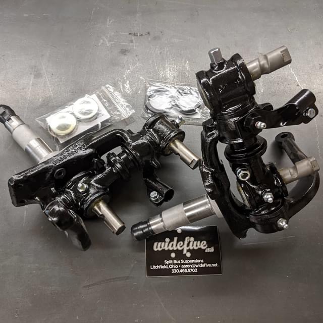

The spindles have been dropped off at Aaron's - #Widefive to give them a once over. Thanks guys!

Front Spindles are done. Cleaned up and link pins replaced. Thanks Aaron.

Got some photos on the front disc brake install progress. This is looking really nice.

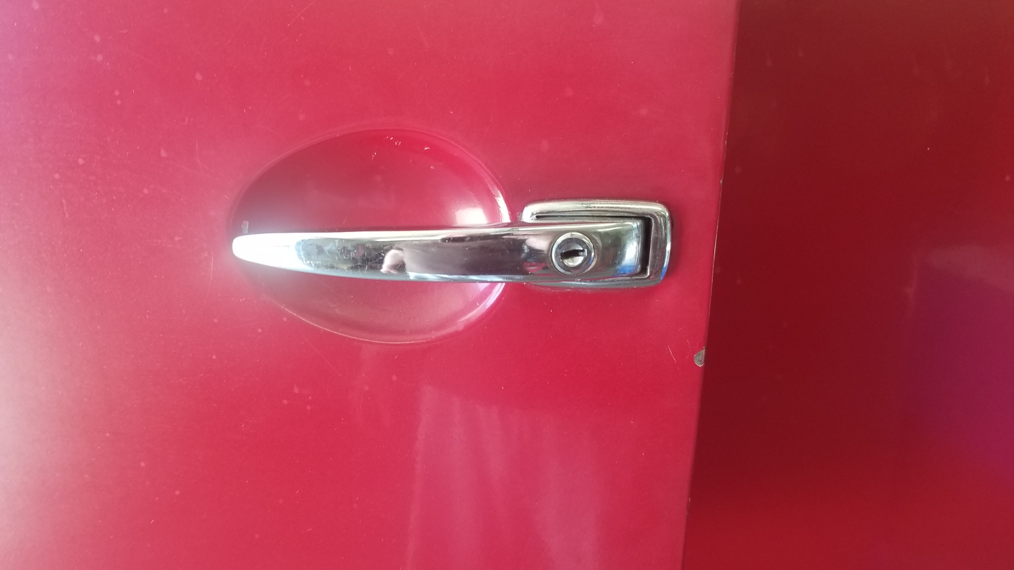

Here is a photo of the drivers door handle, finally got the lock cylinder replaced. The handles were sent out to Justin with VW Key Locksmith in PA. The ignition key was pretty worn out so he cut a new factory key for me and made sure all of the handles work with it. All handles and ignition work with one key. This is project that I meant to do a few years ago as well.

Bruce, your key is probably just really worn down. My key was able to pull out of the ignition while it was running. If you email Justin Baughman at vwkey@yahoo.com he probably get it all sorted out. He is very quick and reasonable too.
Baughman Locksmith
1201 S. 9th Street
Altoona PA 16602
814-931-8538
I actually did my locks because the cylinder fell out while I was trying to fix the pin in my handle when I first bought the bus. The springs and paddles flew everywhere. It had been an empty hole since then.

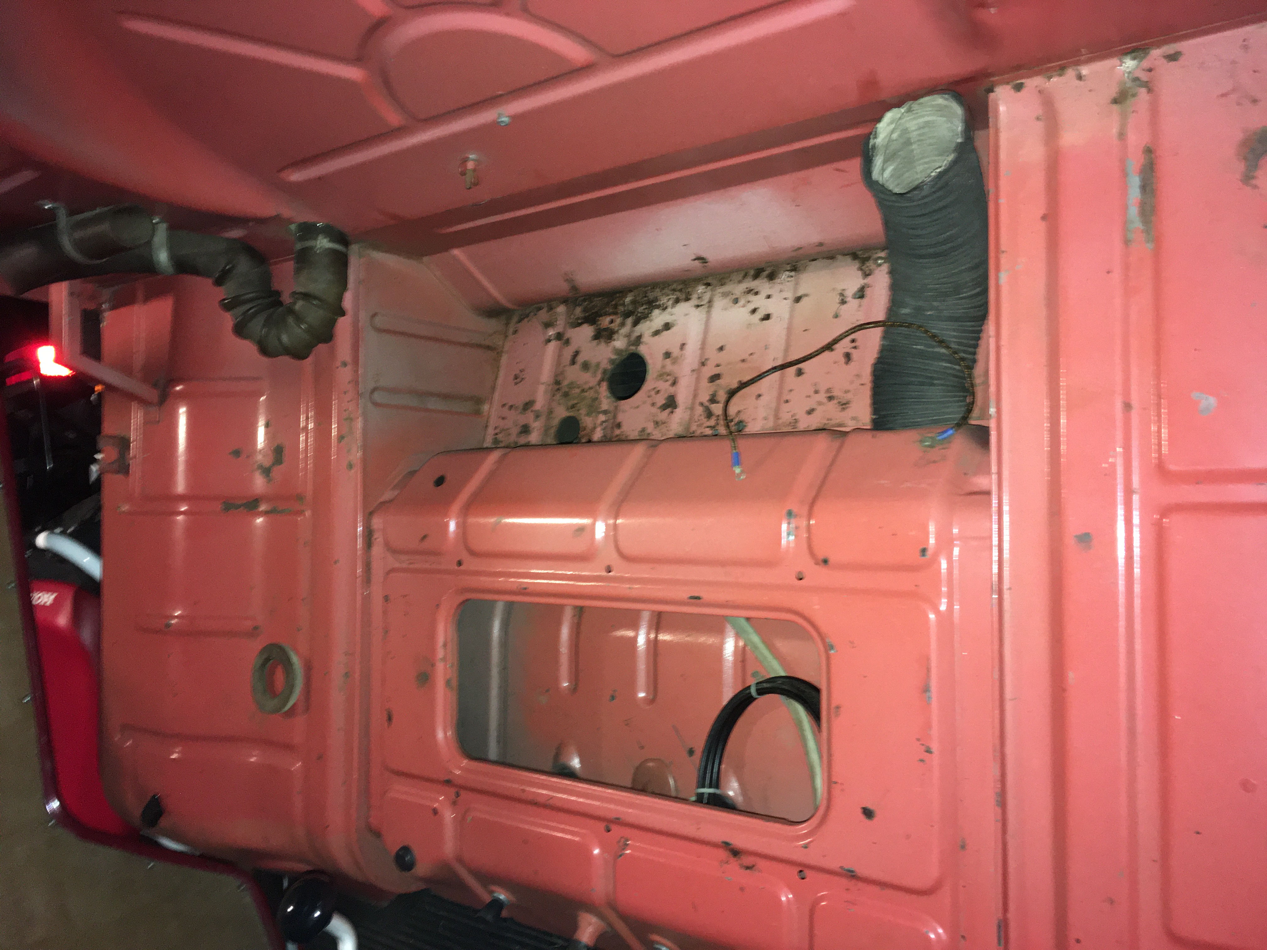

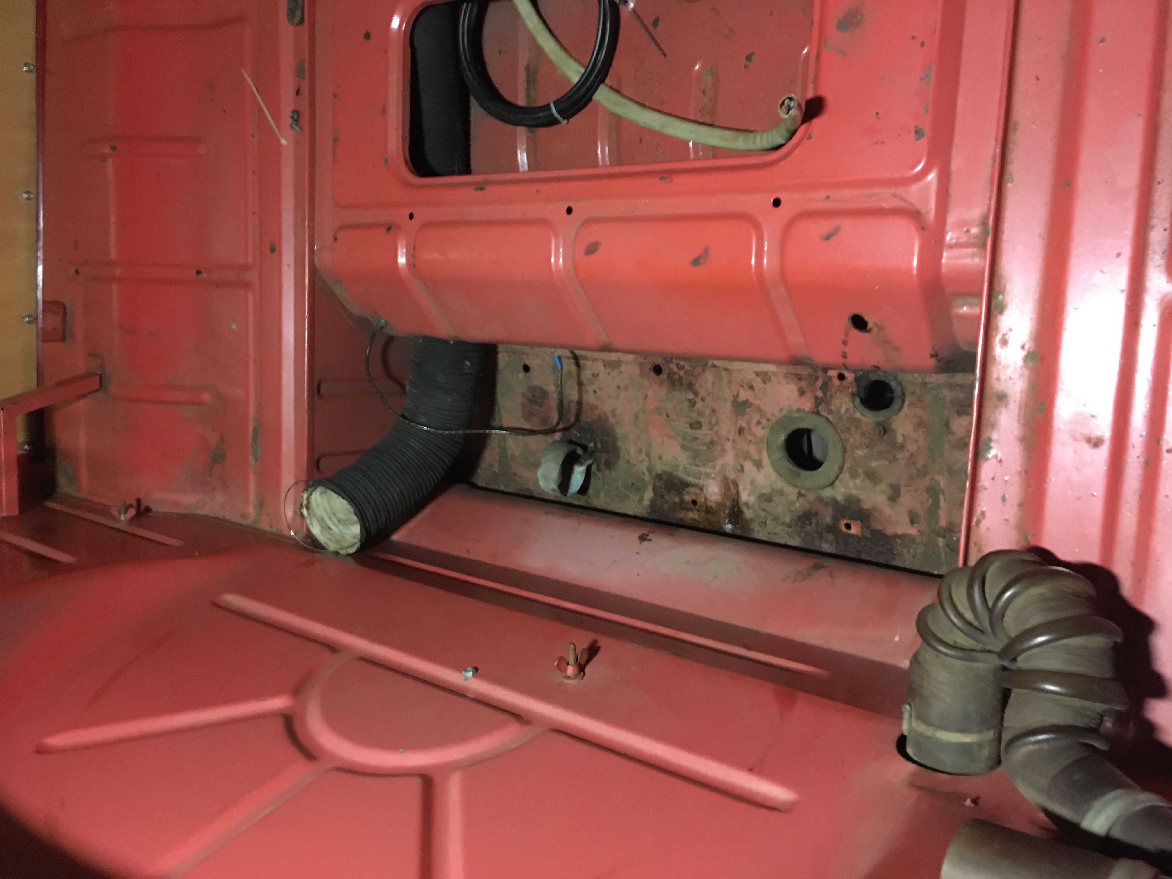

I managed to get a little bus and garage time in while home for the holidays this round. I decided to take the 60 year old, 6v gas Eberspacher out of the bus so that I can make room for an updated diesel heater. I am still torn between Eberspacher and the Webasto heaters but will probably fall on one or the other. Both get comparable reviews, are German made and have been around for a long time.
Taking the old unit out was a little bit of a challenge, but I managed to get it removed and the area cleaned. Next time I am home I will prep, paint and hopefully install a new unit with a small diesel tank in this same area, under the front seat. This was a Canadian delivery bus with the cold weather option listed on the birth certificate. They would use these heaters while driving to keep warm. My intention is just to use it on chilly nights while camping.
Here are some pics for reference.
The original unit in place.
Dirty Bus...
Cleaner Bus...

Make Craig update his thread about his heater install and we can compare the two when you're finished.
I like the idea under the front seat, especially since the duct is existing already, I hope you have enough room under there.
