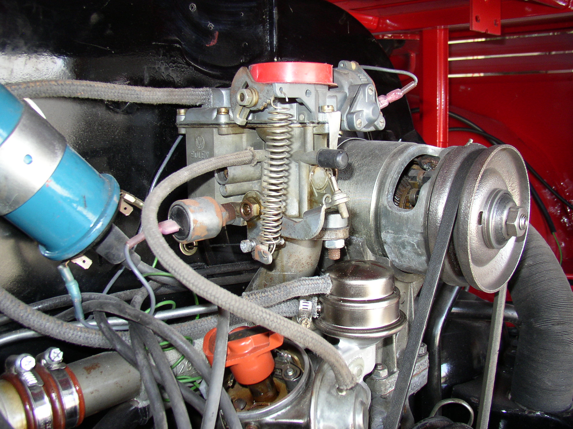

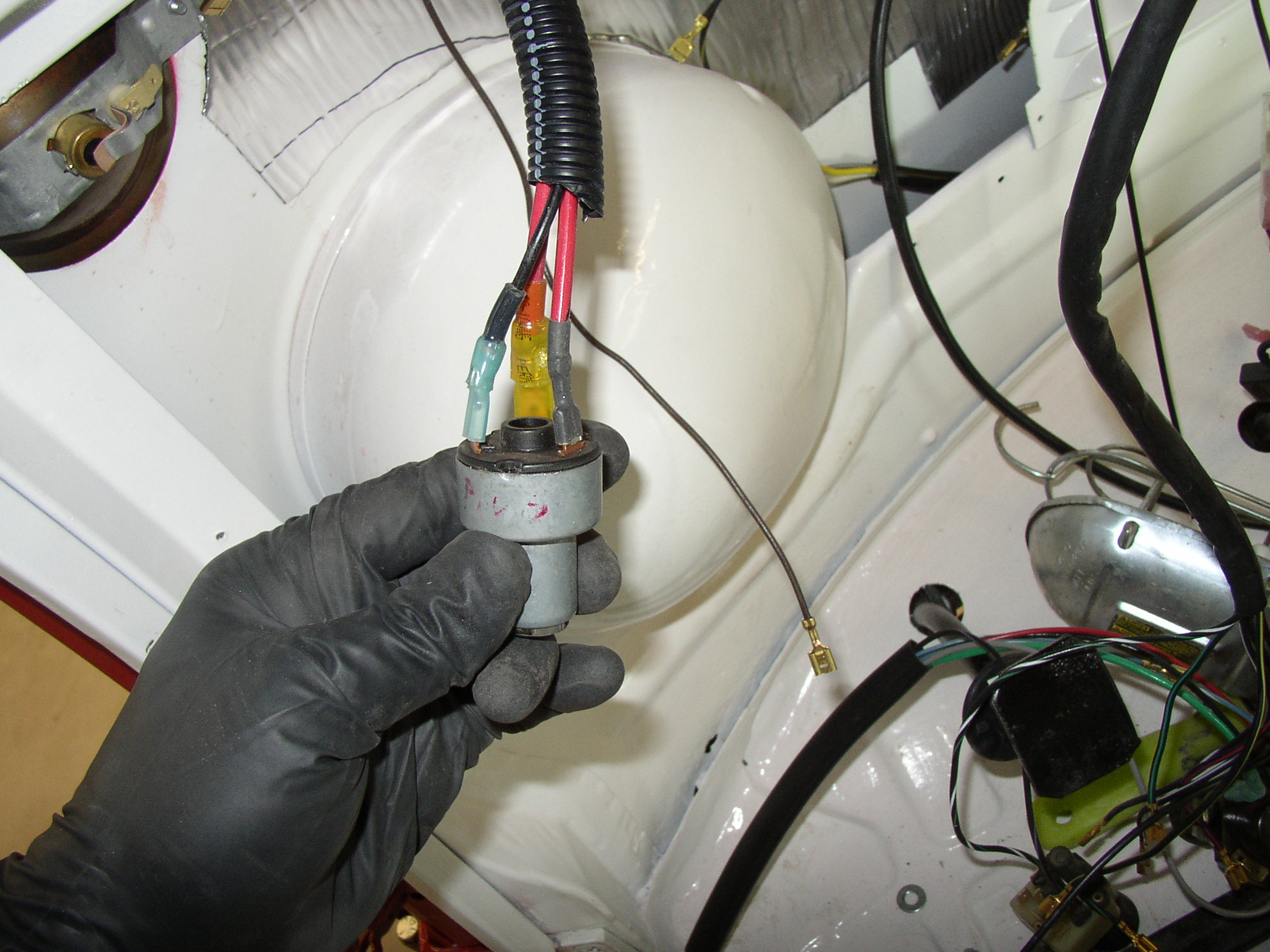

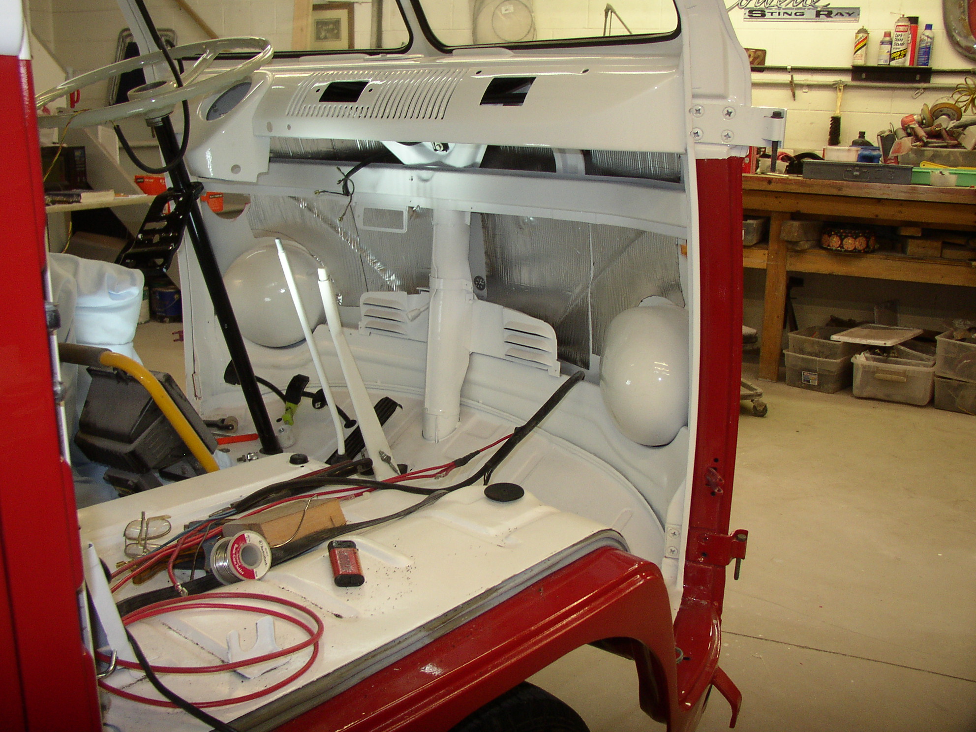

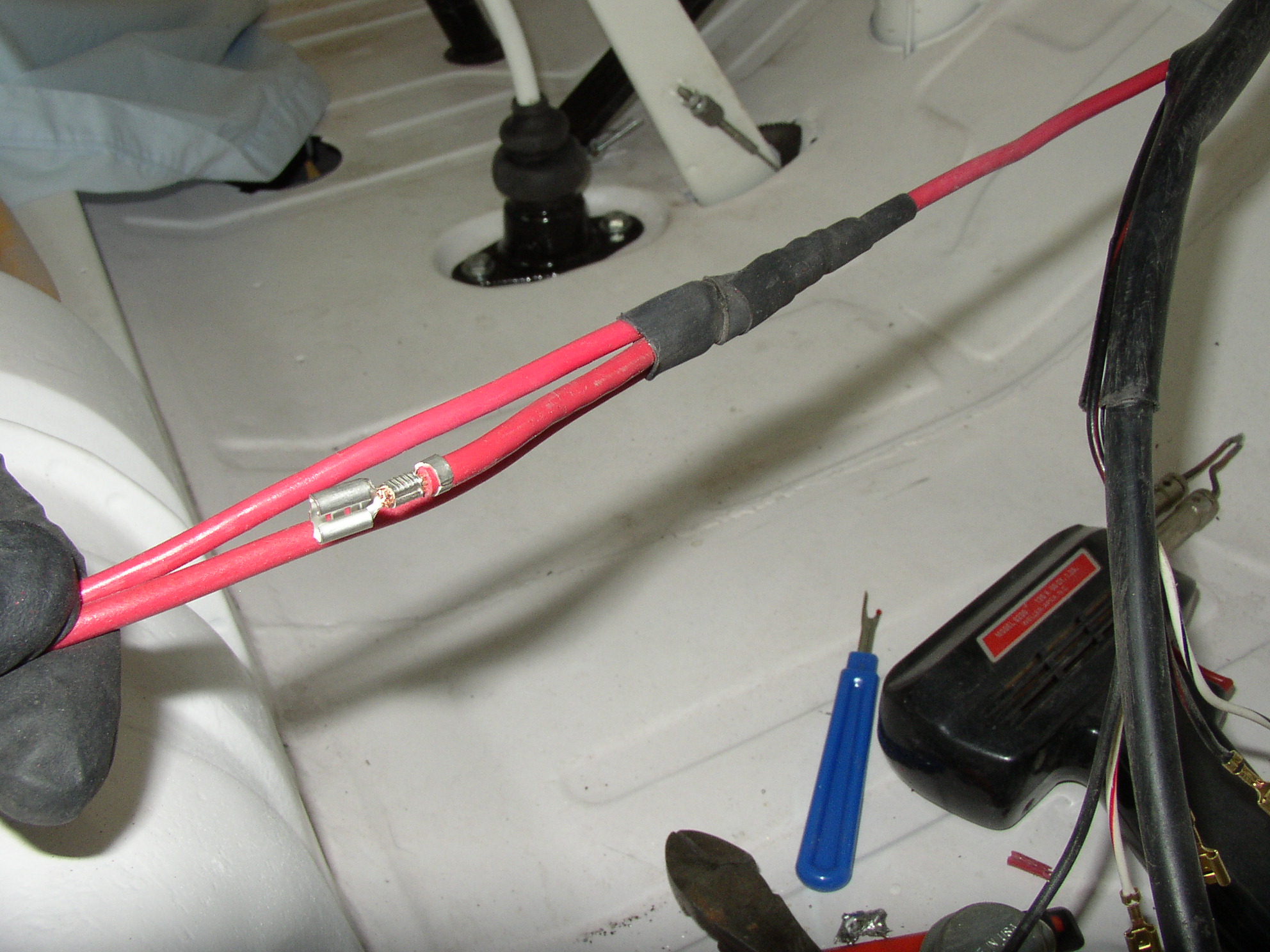

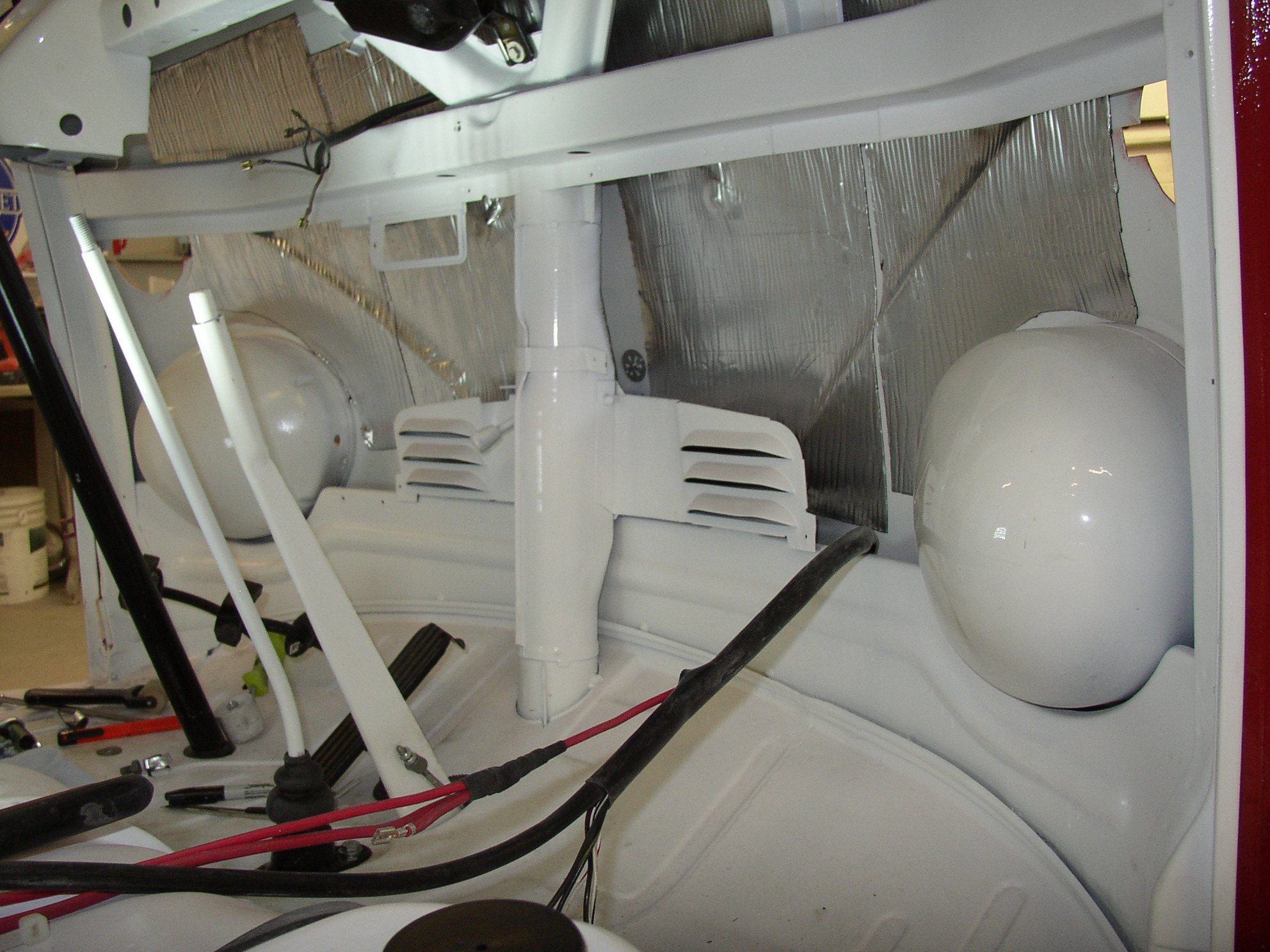

I made a lot of progress this week even though I was out of town a couple of days. I installed the clutch cable, modified the Bowden tube slightly, throwout brng, starter, harness, etc. I put a 40amp Maxifuse in the power feed that heads up front to prevent shorts from burning the bus down. I suggest everyone consider this. I can't believe VW never put circuit protection in millions of cars, they'd all be recalled if they did that today. I don't know of any current mfr that doesn't use a fuse or fusible link in their main power feed. VW doesn't fuse the front parking lights, either, a short up there melts the wires. :roll:
There's a weather cover for the fuseholder, too. I'll put a 15A fuse up front in the coil feed circuit, too, when I'm up there. You see I also put shrink tube on the female hot spades for protection. I use sealed crimp connectors almost exclusively, they're expensive but worth it.

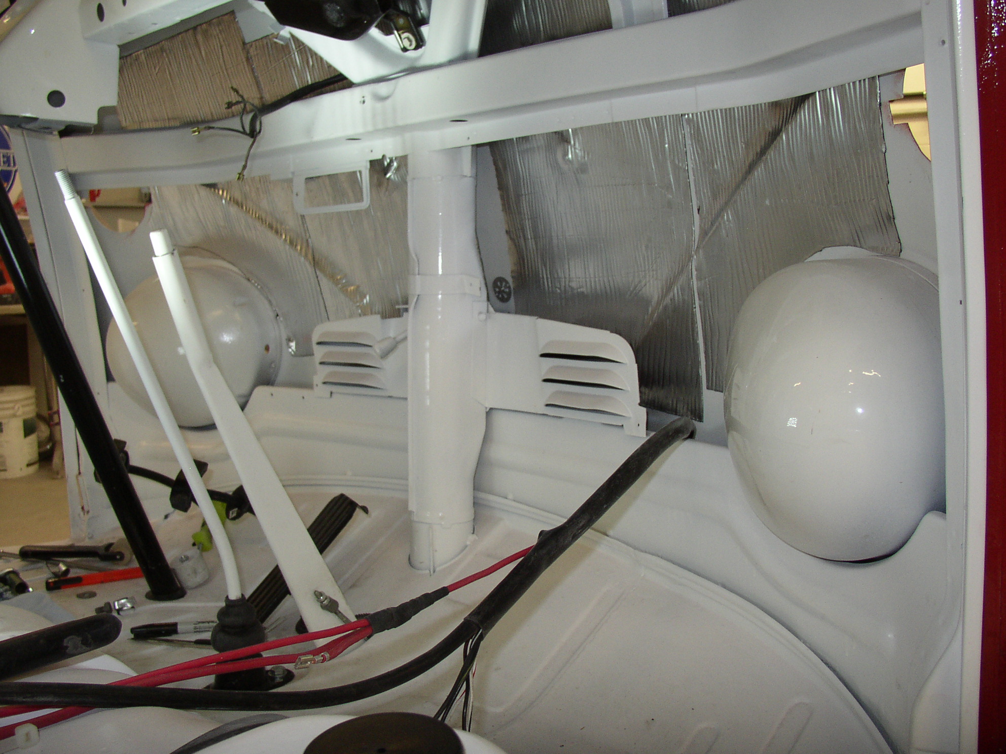

The tank went pretty smooth (tight fit!) requiring even the voltage regulator to be removed to barely squeak the tank in place. New sender (checked it, too), and rubber strips cut from roofing material (just like inner tube material) to dampen noise. I used a stud on the right side since the harness is right below the bolt. The air seal around the engine went in smoothly, too.
When I was test fitting the engine I found the heater box levers were all over the firewall giving me grief as the engine went into place. After a high level discussion with Master Bill we determined that these were for a T3 or something and not needed. 10 seconds later with a whizzer wheel, they were history.
The engine slid in like butter! Usually with new air seals you have to fight them quite a bit but this one went smooth. Once the 4 bolts are in, the first thing I do is verify the clutch disengages, that means putting the tranny in high gear, rocking the LR tire with a long broomstick while pushing the clutch pedal up and down. You can easily feel the clutch work while doing this, and there's no sense in going further with the install job if the clutch hangs. I learned this from doing a zillion HD truck clutches, and believe me, you're really pissed after you finish a Fuller install to find the clutch won't release.

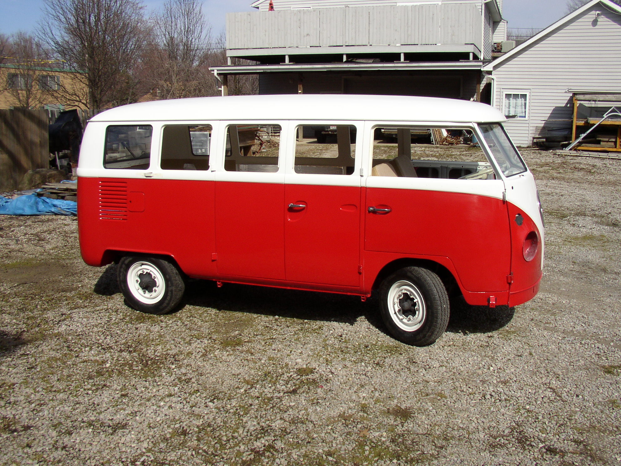

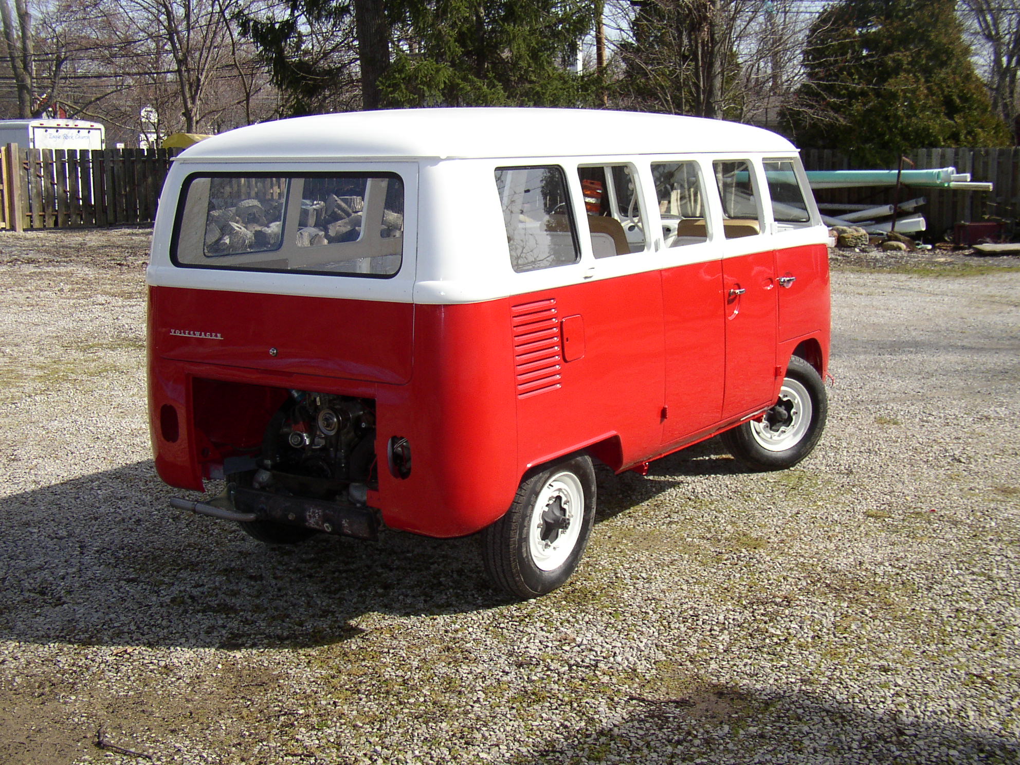

Big day today. Roecker came by with his 1300 in a basket for me to inspect, normal rebuild needed, case bored, nothing out of the ordinary for a 48 year old 1300. He has some NOS Mahle jugs it will go together with.

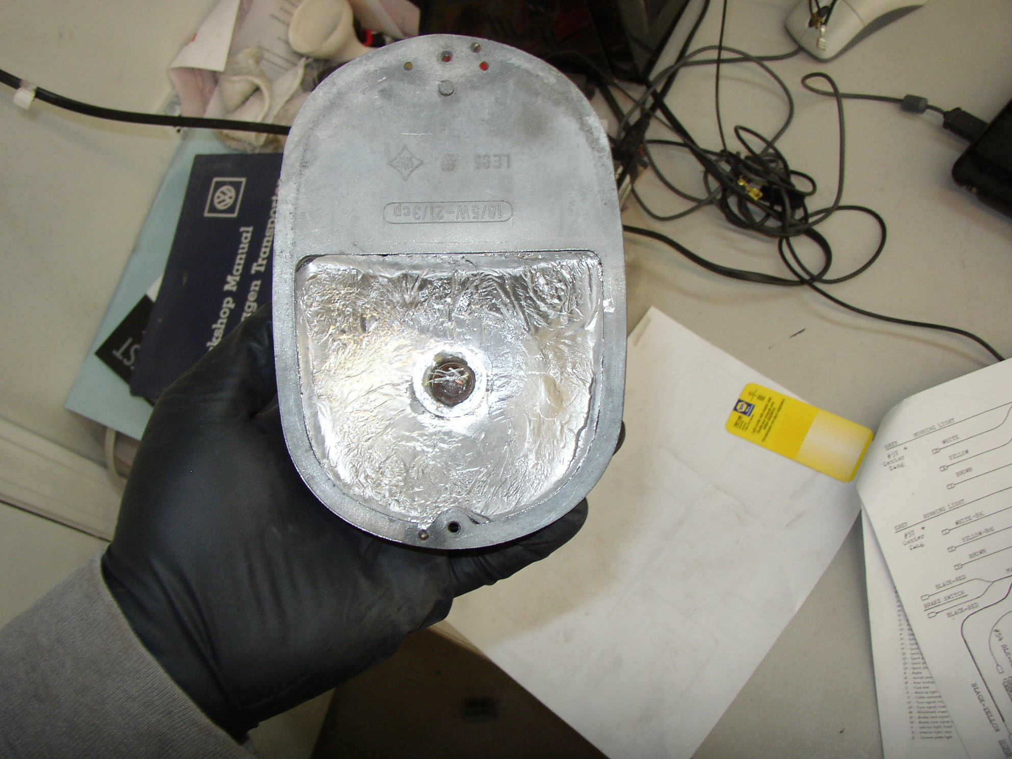

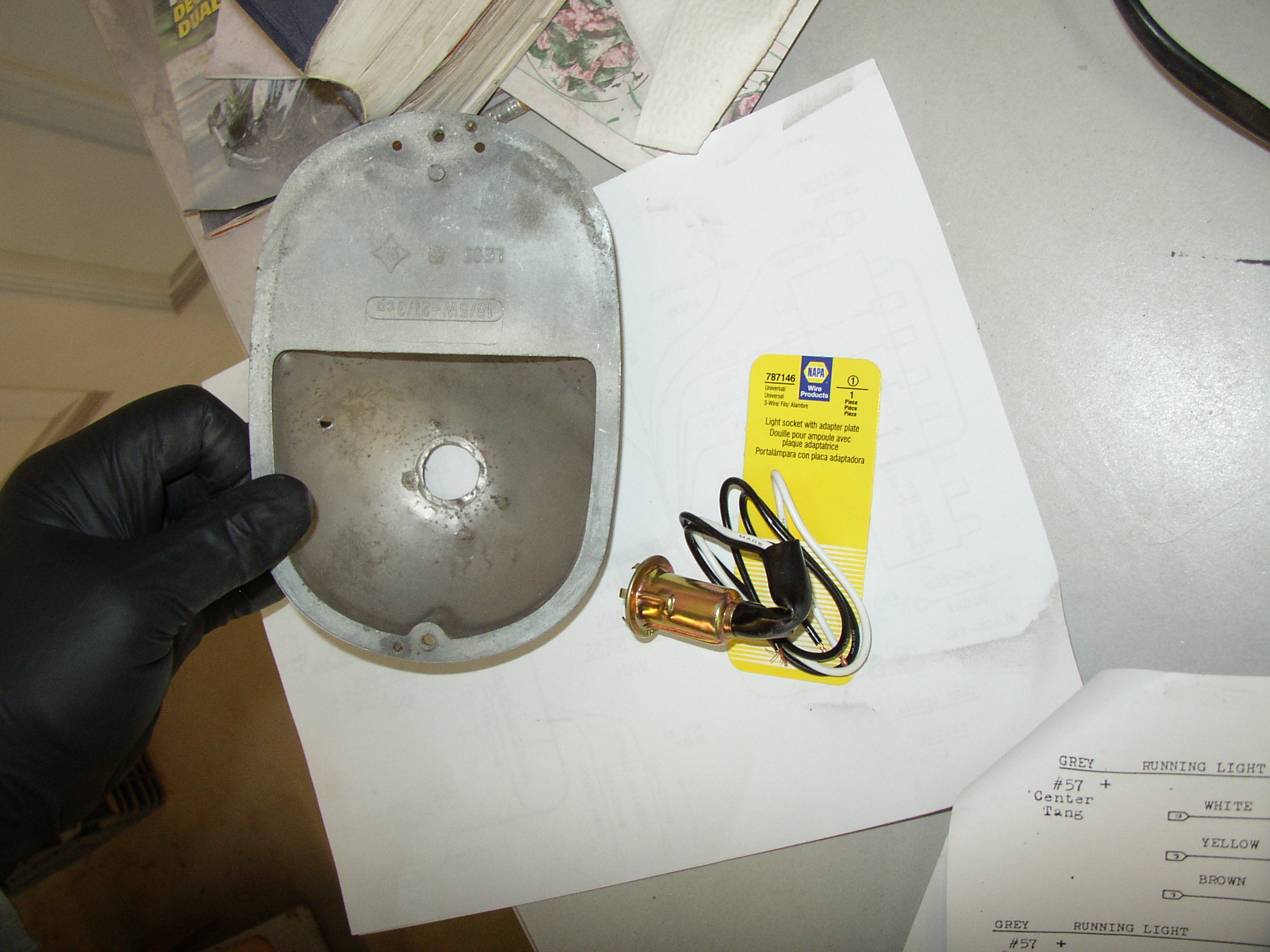

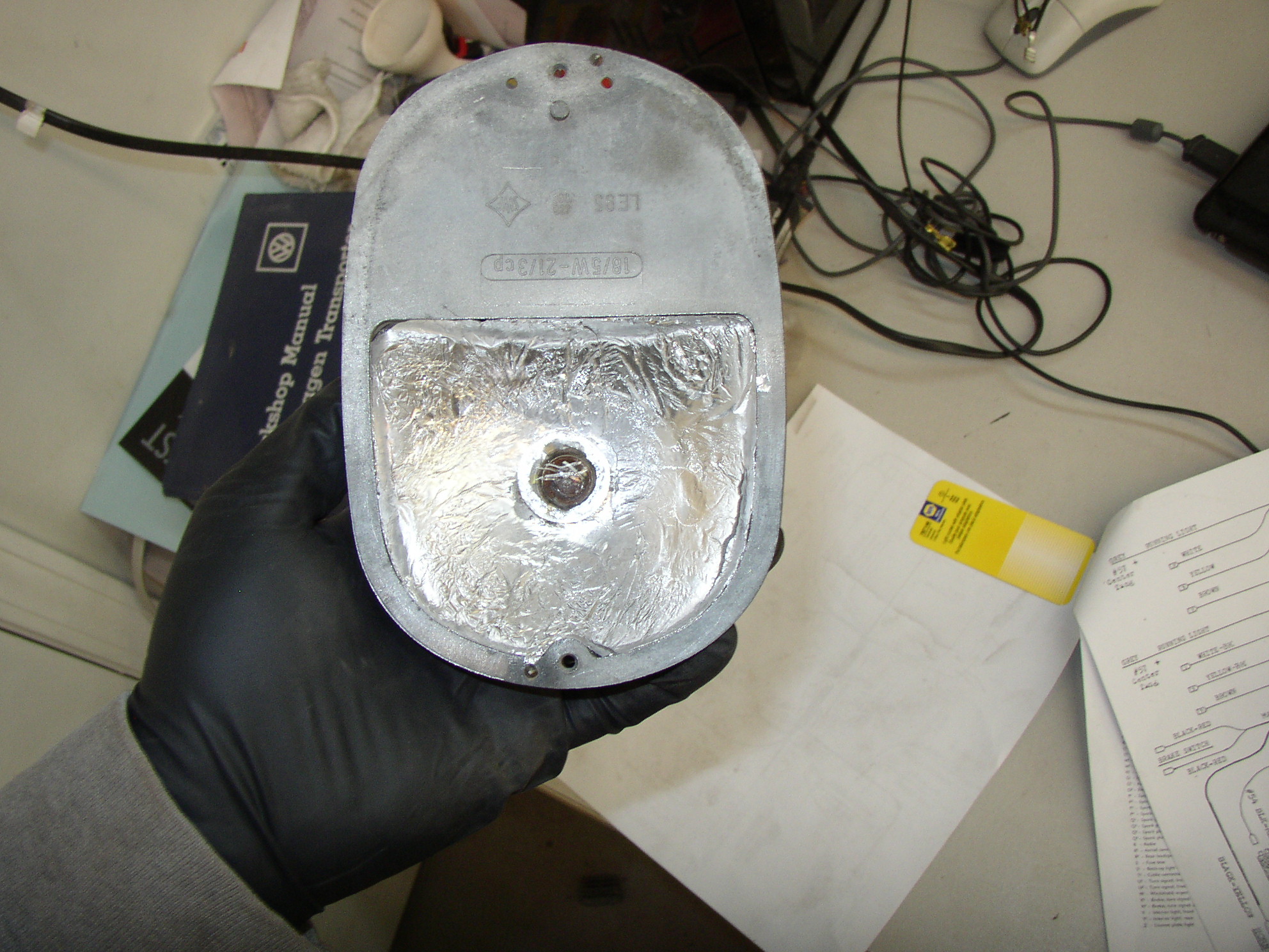

Over the last couple of days I restored the rear taillight assys, front TS assemblies, installed the headlights, installed the battery and fabbed a strap. Today I got the dash wiring pretty much complete, the speedo head back in and the dash tray in. All lights work, all warning lights, high/low, tail, stop, turn signals, horn, etc. I had 3 frigging bad brake light switches in a row! Good thing I have 5 on the shelf. :) I put an accessory fusebox in place in addition to the OEG one to spread out loads and put fuses where they need to be. I used a 6 wire '58-'65 turn signal switch and wired it with a modern flasher instead of that antiquated old flasher that mine had, and put a dimmer switch on the floor instead of running them through a relay. The idiot lights work and the gen was pushing 14.5v, perfect.
Today was a huge milestone because it left the shop under its own power and went for a 12 mile road test around town before I ran out of time. I've been waiting for this day for about 16 months and 850 hours. Aside from the bum first gear, it ran, drove, shifted, felt, and sounded beautiful. Smooth ride, no noises or clunks, tracked well, quiet (or as much as expected with no interior and 8 windows missing), no surprises. Lots of looks and comments from other drivers at stoplights (easy to do with no side glass!) All in all, an exceptional day. :D
