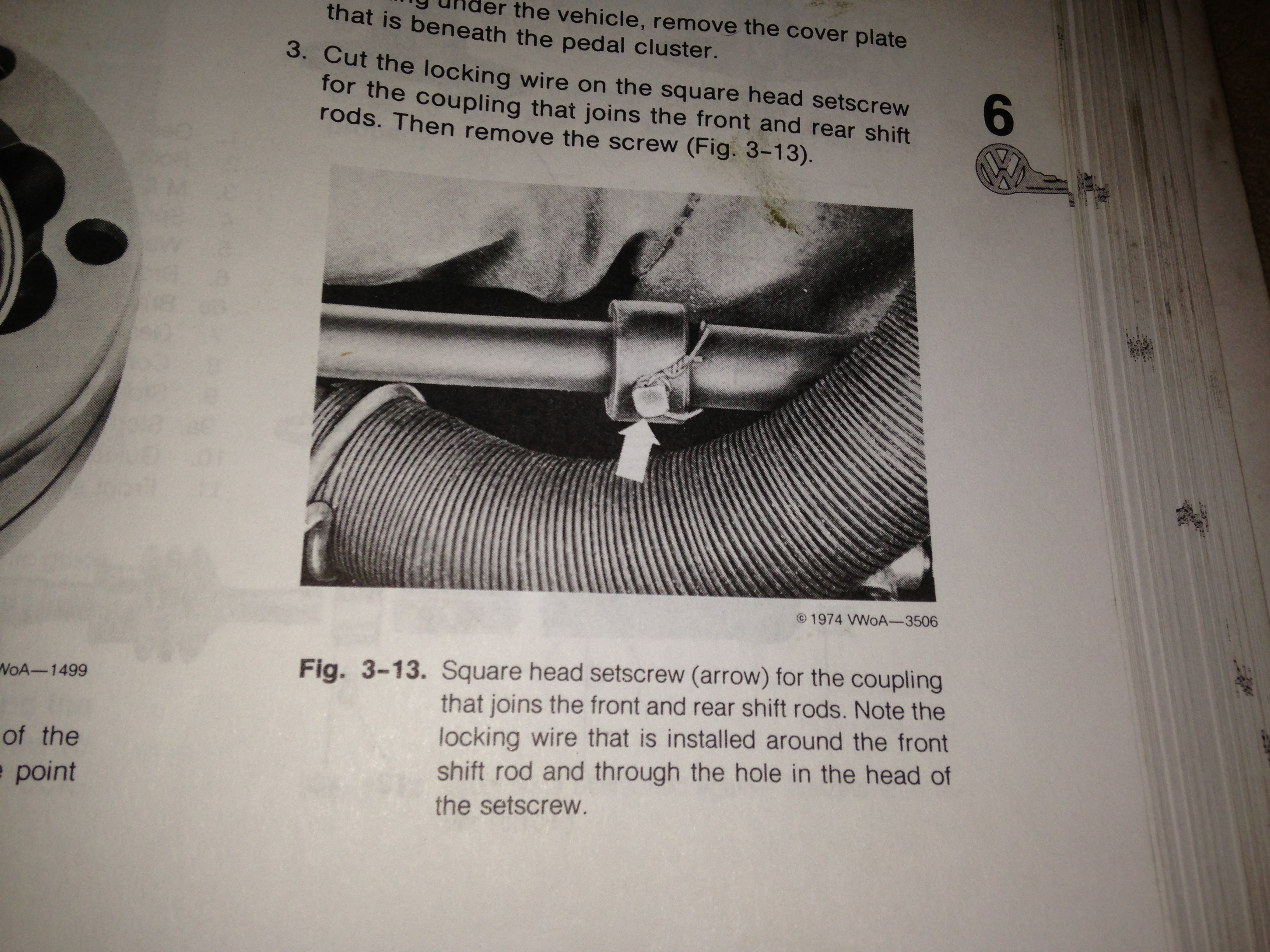

Ed,
Grub screw and safety wire for shift linkage
X
Re: my 67 13 window deluxe
Mike Kever Kombi wrote:Ed,
X
I have these grub screws if you need one.
now it makes sence to me why those screws had holes drilled thru the head......thanks guy's I made a new one bill but thanks for lookin out :D
