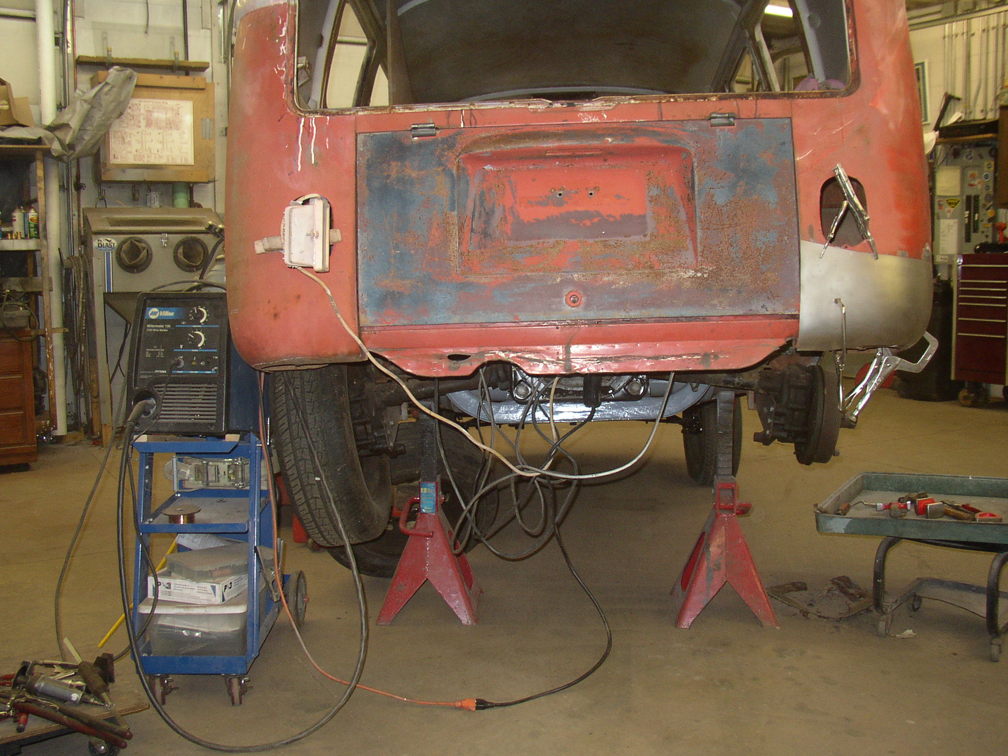

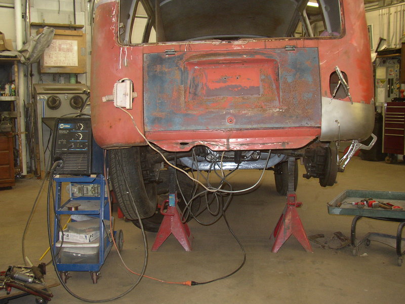

I started the last bus with a small Lincoln but it wasn’t getting the job done. Miller is one of the best names in the welding field so I got lucky and stumbled on a MillerMatic 135 110v mig welder and have loved it ever since. I use a standard 75/25 mix of argon and CO2 and .024” wire.
On the inside lid there is a factory “cheat sheet” on what settings to use with the size of wire and material which I’ve found to be pretty good so I just stick with these. You can see I have the heat on 3 and the wire speed on 45 for 20 ga sheetmetal.
Sheetmetal is the worst thing to weld anyway so getting a high quality welder was a big step up, years ago I had a Snap-On YA212 mig which was great then, but when I sold the shop all equipment went with it. Now I find myself buying all the shop equipment I sold with the business. :|  The important things to remember with sheetmetal is patience and really short welds. The metal (both new and old) I’m welding is about .031”. If you weld for more than ¾ of a second in one tack the metal just falls away and leaves a big F’ing hole which you must now fill in. Also on long straight welds like replacing a body panel you must wait between each 3/8” long weld for the metal to cool completely off, otherwise your nice flat panel turns into a potato chip. I also stepped up to a nice Miller Digital Infinity helmet with a big window which is nice. I cheaped out and didn’t spend the extra $10 for cool graphics.  :roll:

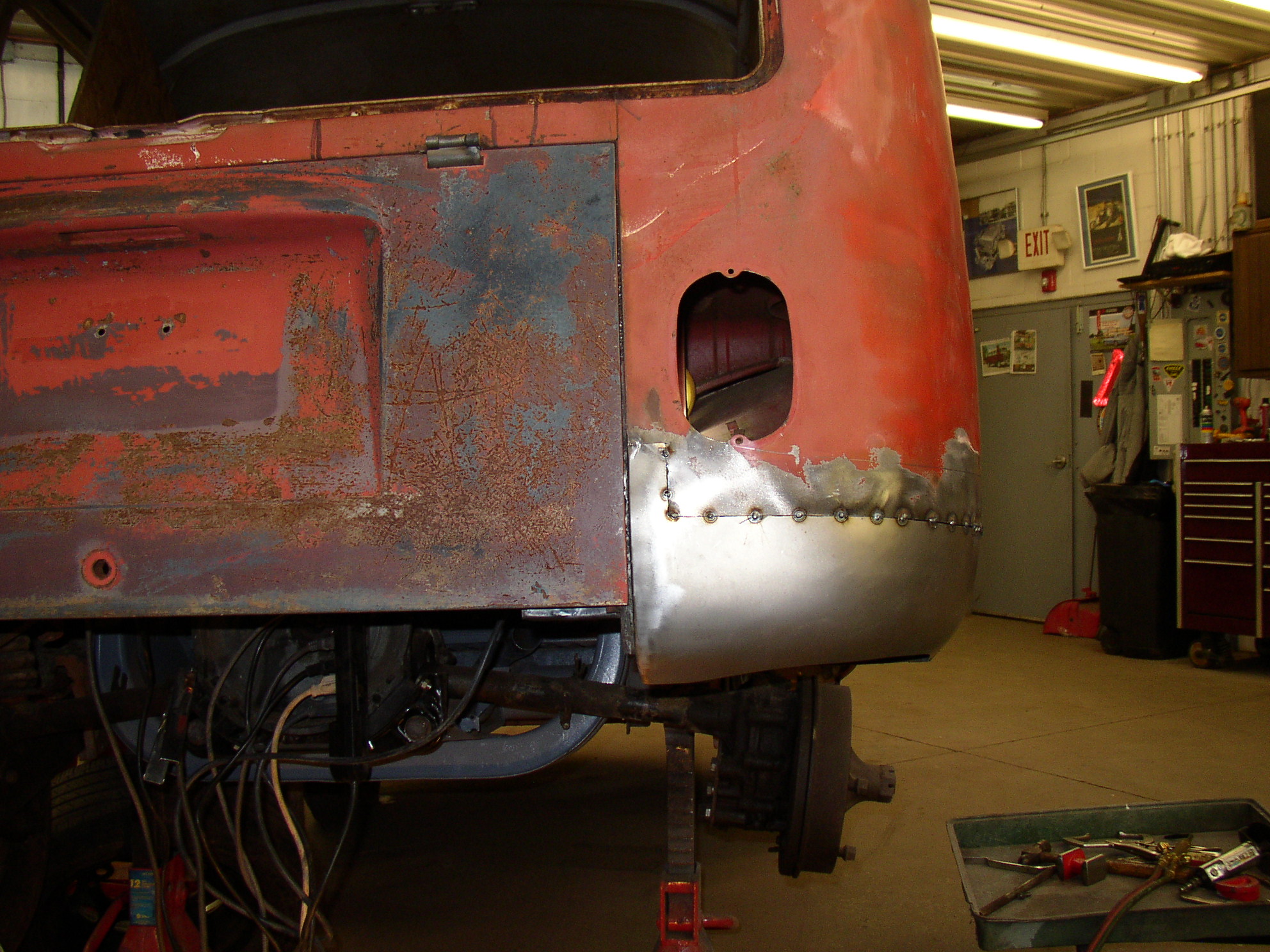

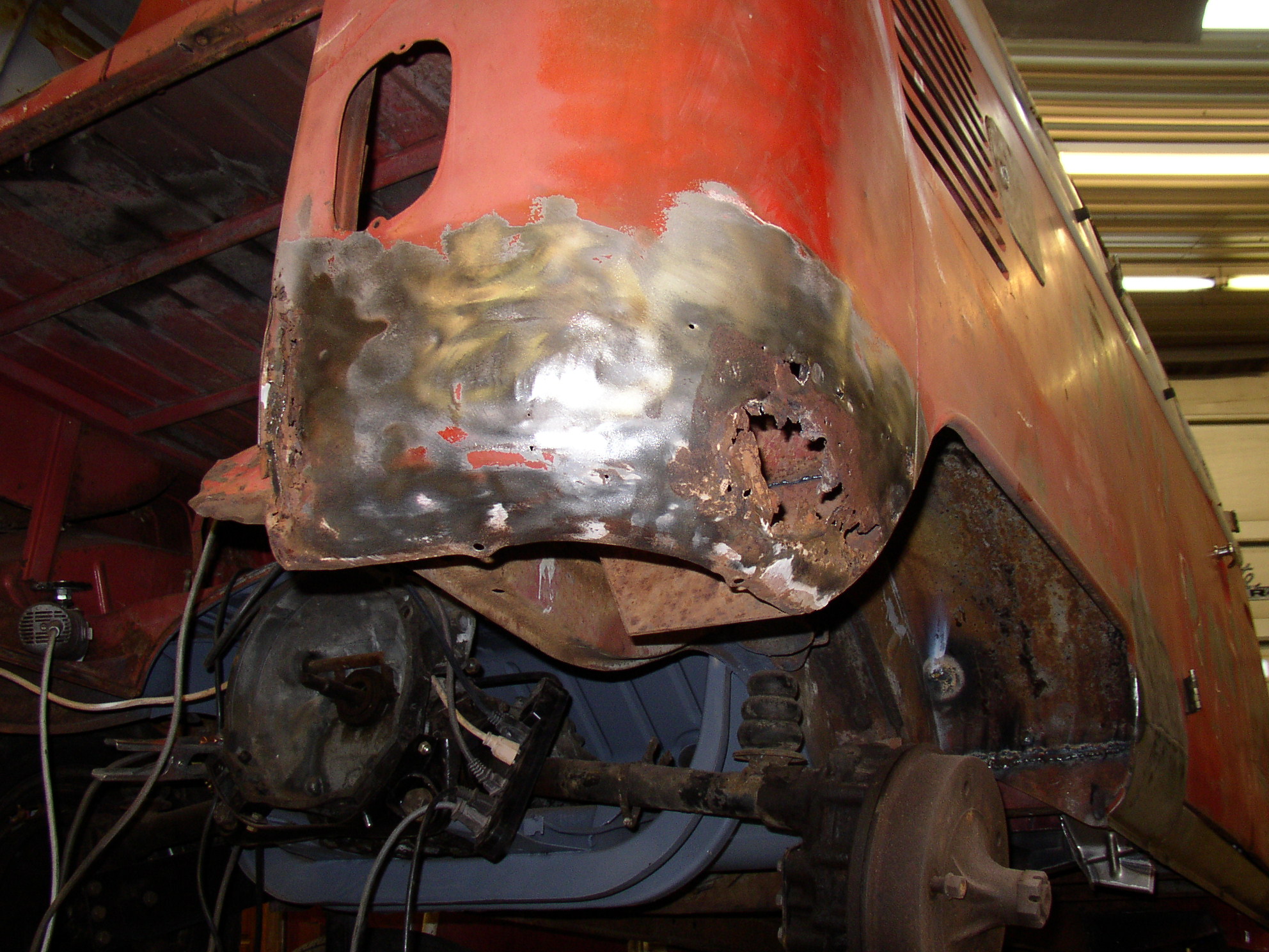

Anyway, back to the bus. The RR corner was next and it was crumpled up from a light hit. My gut instinct is to not cut the crumpled metal off, I generally straighten it back to near-correct before cutting so I don’t get too much going on at one time. So I took my monster wire wheel/bondo/flesh remover and took off all of the bondo, which takes about 30 seconds. Then I hammer and dollied out the crumpled metal until it resembled the correct profile.

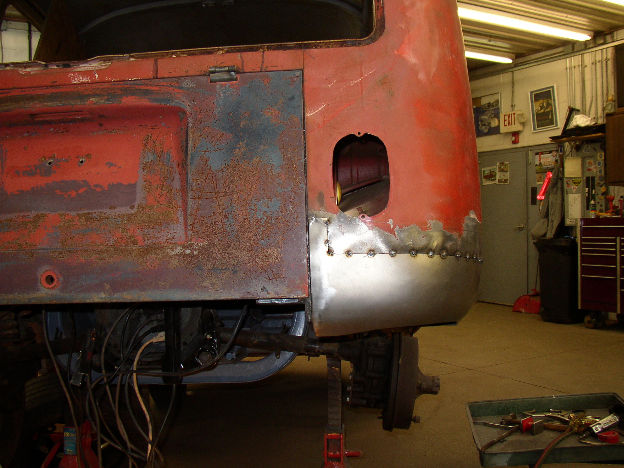

I then cut the wasted portion of the metal away and started eyeballing the new panel, which was the curved section and not the flange next to the engine lid.
I cut reliefs in the edge of the metal and folded them over to create the curved flange needed. I put a piece of I-beam in the vise and clamped a hunk of angle to it to create my hillbilly brake.

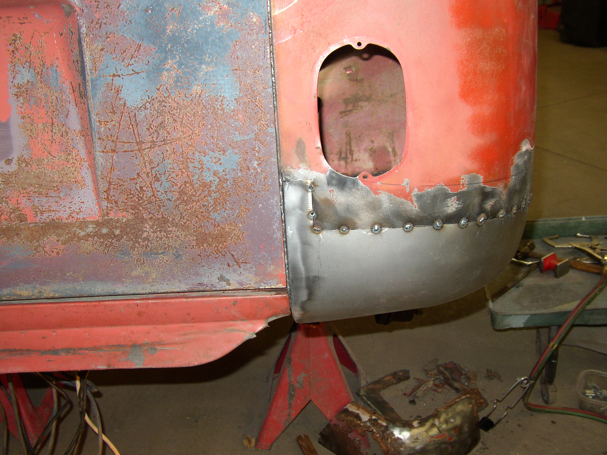

Here I’m test fitting the piece, the big flange in the foreground was also mangled pretty good so I glowed it, straightened it, and welded it back where it belonged.

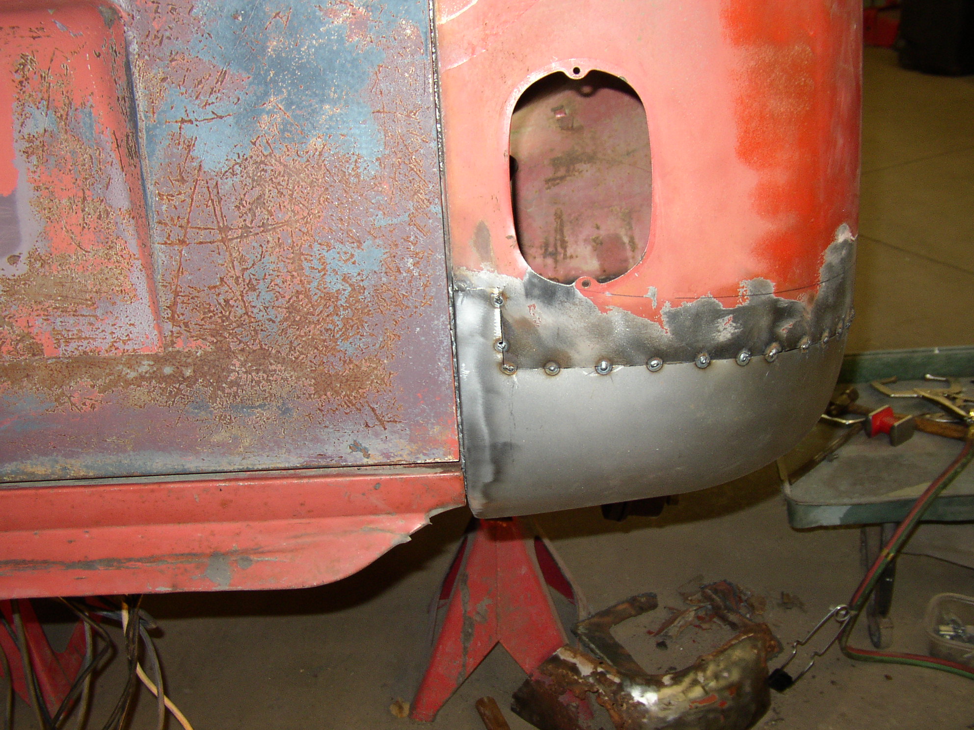

Here the corner is tacked in with the lid and valance showing the gaps are good. No overlaps here, those panels are butted with zero clearance.

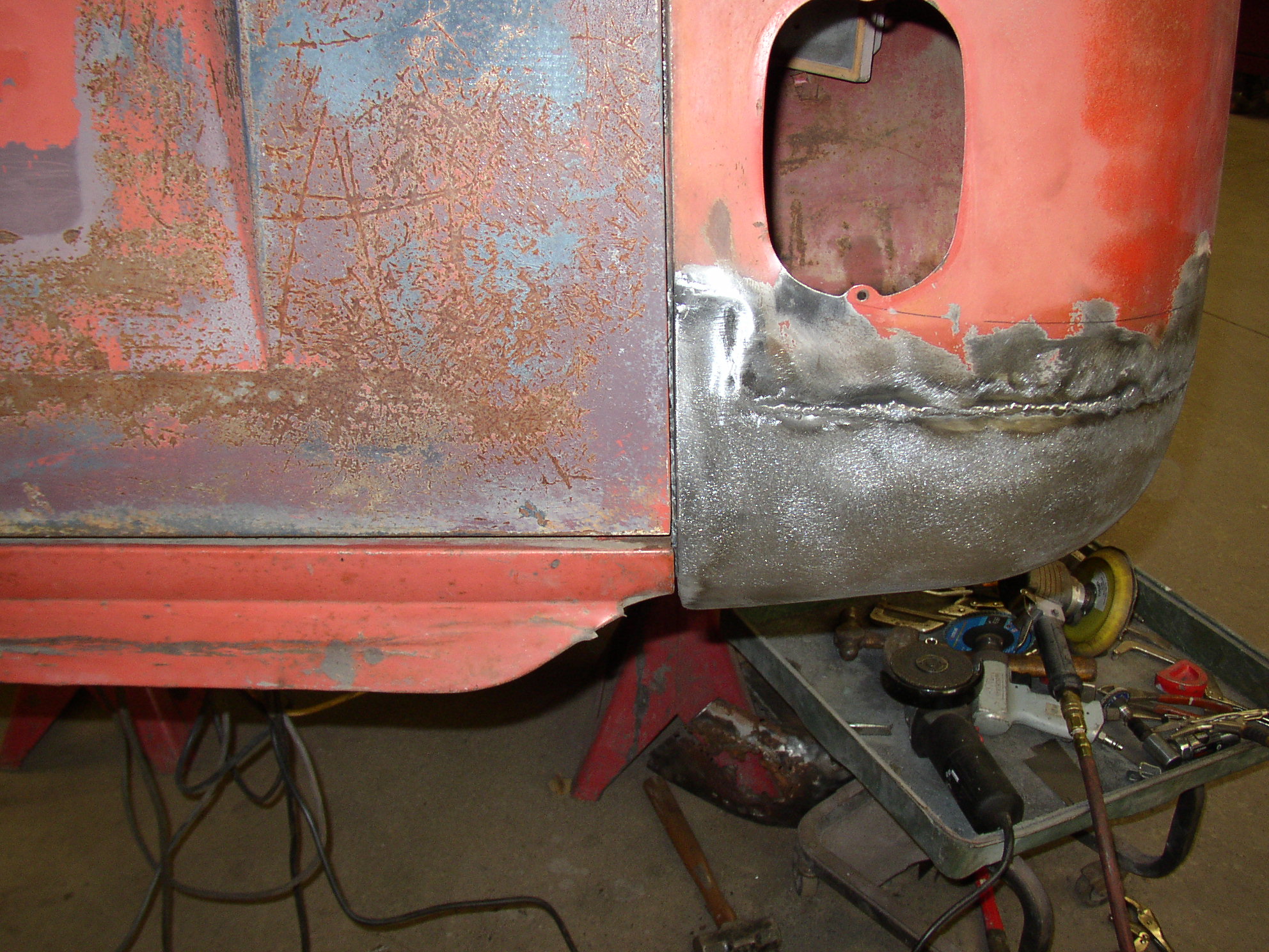

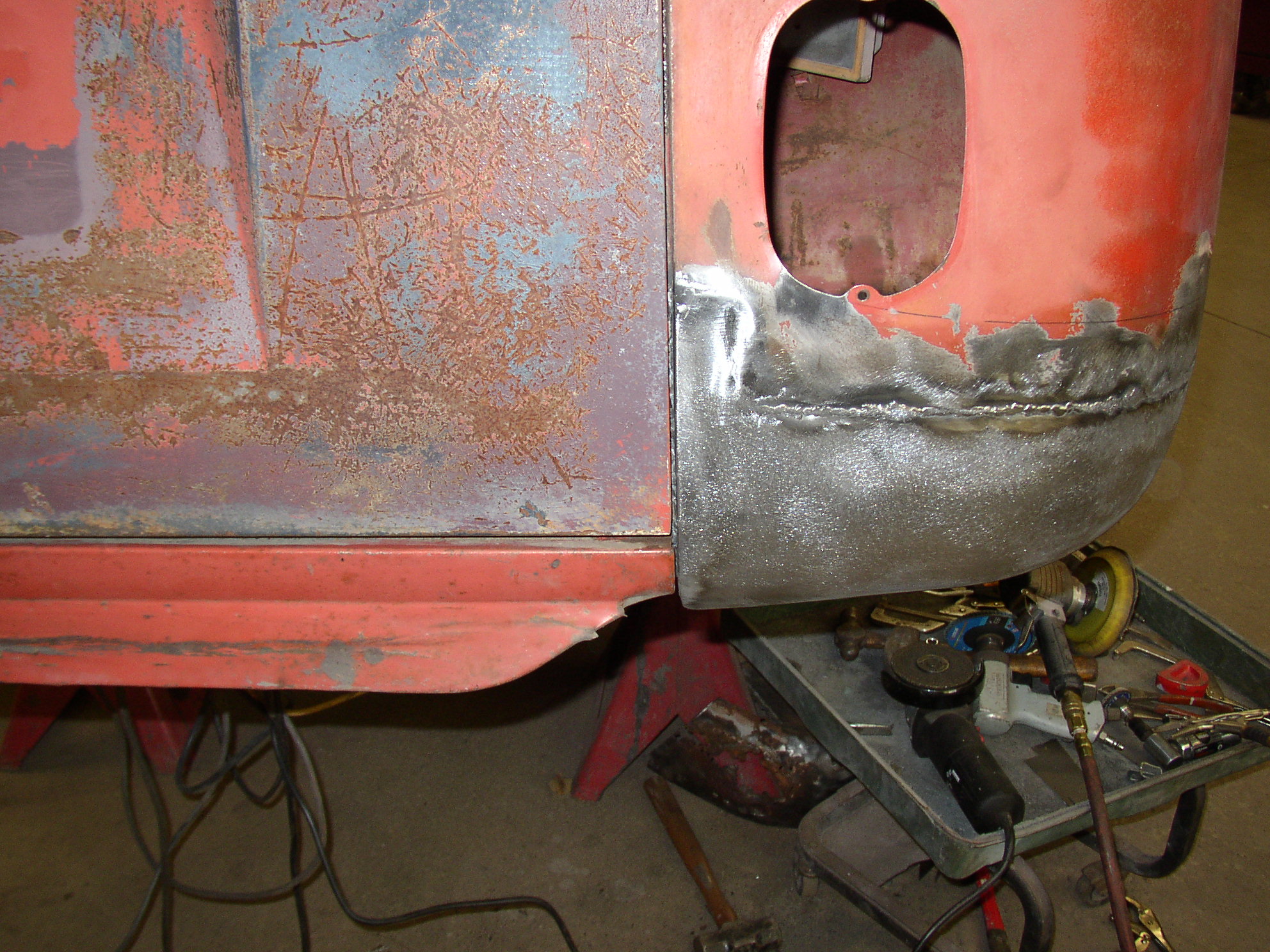

Welding….
Fully welded and rough ground, nice gaps.

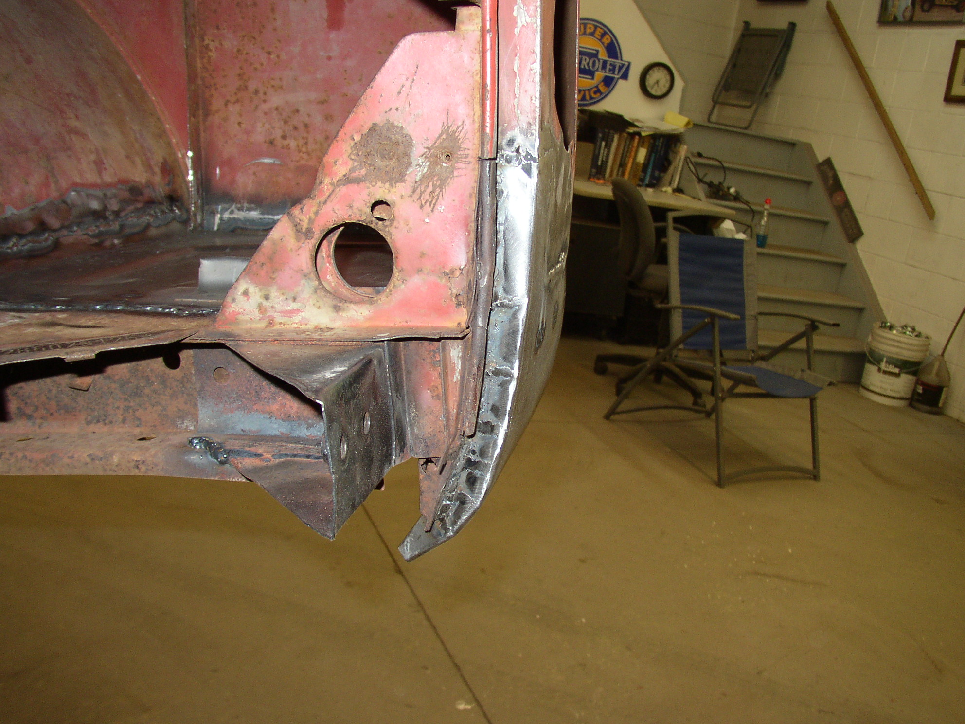

Here you can see the relief cuts welded together. A bit more finish work and this won’t be visible at all.

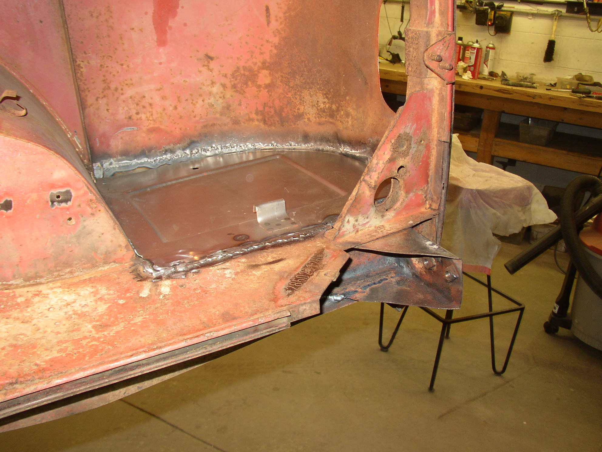

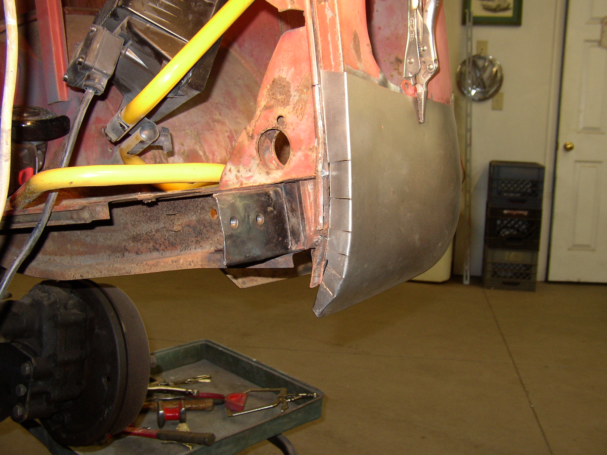

Here I’ve put the battery tray in, the ugly welds in the background look like the tray but they’re actually the inside of the corner welds. The far edge of the tray was welded from underneath.

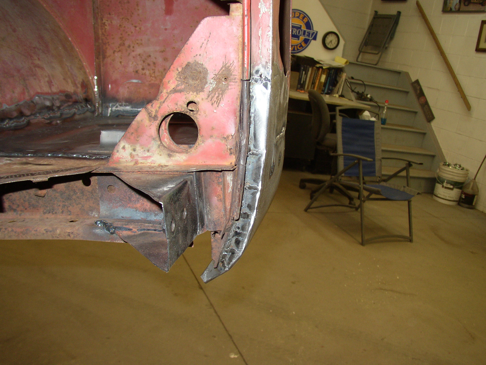

On to the front floor. To remove the floor I made a perimeter cut about 1” from the edge the whole way around with a whizzer wheel tool.
This leaves the edge which is spot welded in place, I then sandblast the edge to show up the spot welds. If you use a flashlight held at a steep angle the spotwelds show up well, dot each of them with a magic marker (Sharpie for you younger folk). Image
Chuck up a 3/8 or ½” bit and drill out the spot welds. Like I’ve said before, I’ve not had good luck with spotweld cutter bits. Use a regular bit and just drill until you see chips- this takes practice ‘cause you’re just ready to go through at that point.
Once you’ve weakened each spotweld, take a VG and pull the piece loose. If you’ve done good (not usually the case) it comes off like a zipper but usually you fight it like an SOB, eat your Wheaties. Once the piece is gone clean things up with a flap wheel. If I remember I’ll take pictures of each of my tools so you know what I’m talking about.
Here I’ve cut the floor out, note the driver’s step area is rotted and the lower A pillar has a big hole in it, I’ll address those soon.
I’ve cut out the rotted piece in the driver’s step but for some reason it doesn’t show up well in the pic. Take my word for it, there’s a big fing hole there. I also cut the lower A pillar out where it needs a patch. I take a piece of cardboard and template the replacement pieces.
I then transfer this to .032” and rough it out, bend it in my “brake” and fit it using the flap wheel. It needs a little bit more trimming here to get it butted and not overlapped. Image
Here it is welded and rough ground using the hard wheel and flap wheel.
Lather, rinse, repeat on the right side but this one’s a bit tougher cause the A pillar is a bit worse.
