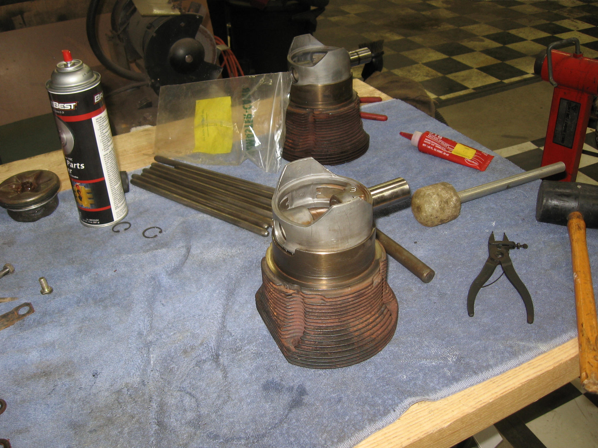

Now install the pistons in the cylinders. I did not get a pic of this,but,using a ring compressor install the piston from the top and push it down until the pin bore is accessible. Prior to this, you need to stare at things and determine which piston/cylinder is going on which rod. There is an arrow on the top of the piston. This arrow MUST point towards the flywheel. You also need to determine which direction that the pin will install from. On the T4 engine #4 has to be installed first with the pin installed from the #3 side. (the oil cooler boss prevents the pin from being installed from the other direction). Stare at it awhile and have a sequence planned.
Now before installing all 4, we will install one in order to measure deck ht. I did not get a pic of this process so I mocked up a Piston and cylinder. With the piston and cylinder installed on the rod. Check deck ht.
We measured .045in. write this down on you build sheet along with the head vol (cc's) the you did a while back.

I need to back up a bit here. Normally there is a gasket or "shim" at the base of the cylinder where it meets the case.
I measure the deck ht. WITHOUT THIS shim/gasket. THEN, figure the compression ratio. With a stock or NON STEPPED head, you do this,substituting various shim thicknesses to get to the comp ratio desired. 7.1:1 was the stock ratio. This is a bit low,but VW was trying to meet emission standards and lowering the comp ratio was what they did to do so. I shoot for 7.6:1. This is the comp ratio for U.S. spec 2L Porsche 914's. Euro spec (flat top pistons) were 8:1
I knew that with the AMC stepped combustion chamber we would probably not get to 7.1:1. I was correct. With a 60cc chamber and .045 deck ht on a 2L (1971cc) engine we were at 6.8:1. If we were off 3cc on our head cc measurement (possible), we would be at 7.1:1. So,that's what we have. No way around it other than taking the heads to the machine shop and have them mill the step out. The good news is that the previous builder had a .030in shim at the cylinder base,which made John's previous comp ratio 6.4;1. So,we are still better than it was.
Since we left out the bottom "shim" we used Loctite 518 around the base of the cylinder. Even with a shim or gasket,this mating surface needs a sealer. (NOT RTV SILICONE). Some builders use this,but you need to be carefull and use it sparingly as it builds thick and you run the risk of it getting into the sump and possibly clogging things up,which is what had happened to this engine.
