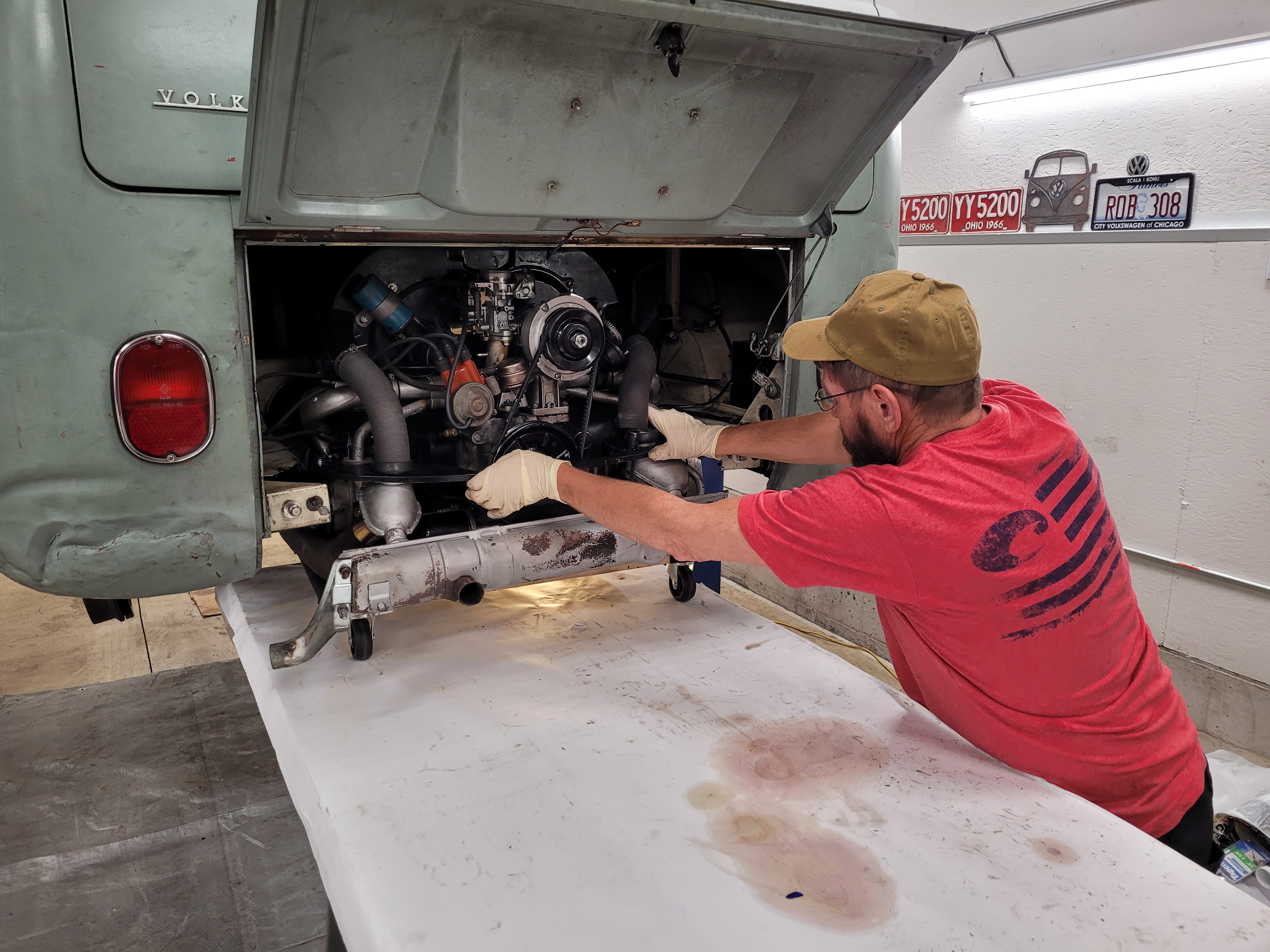

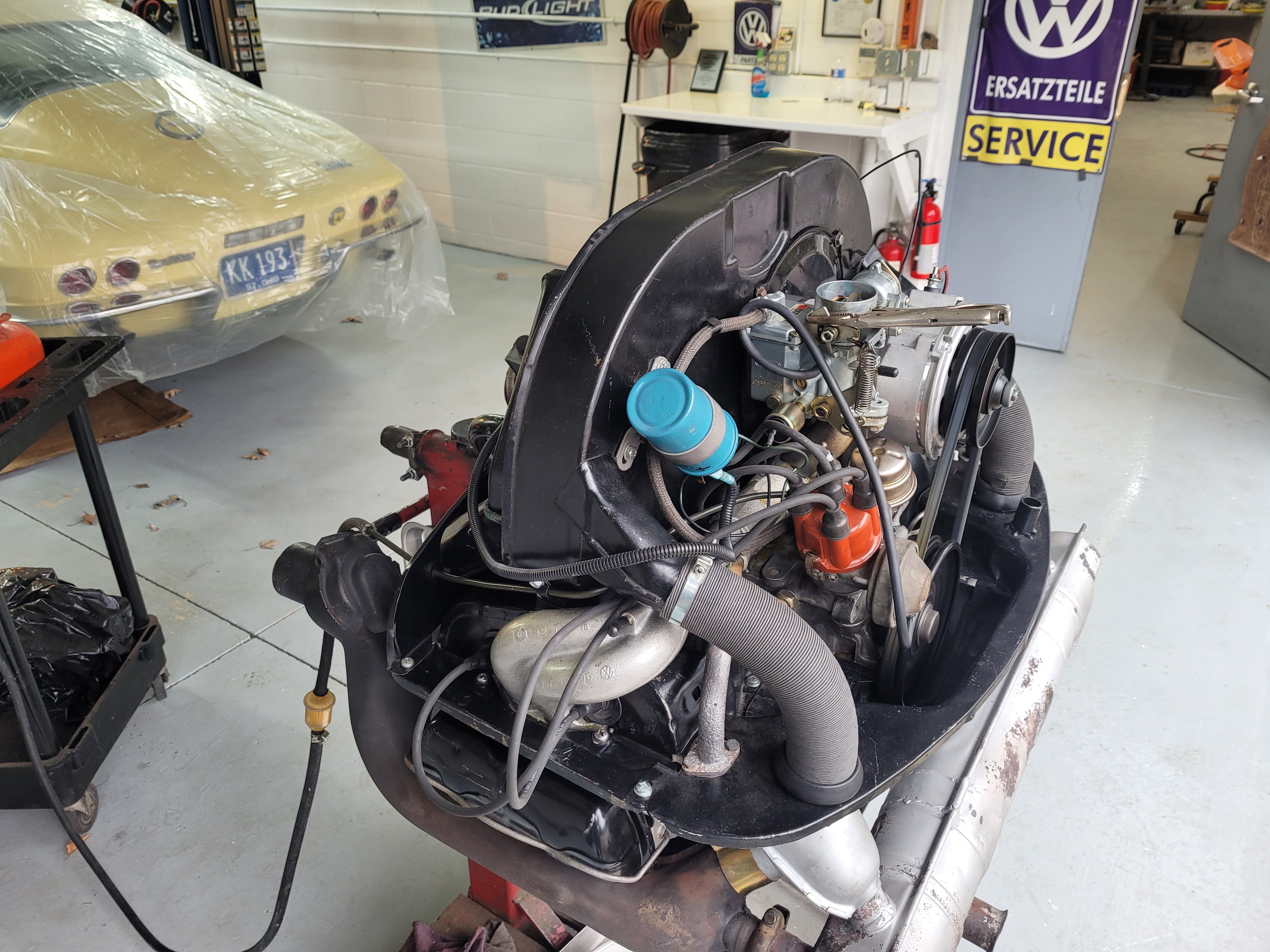

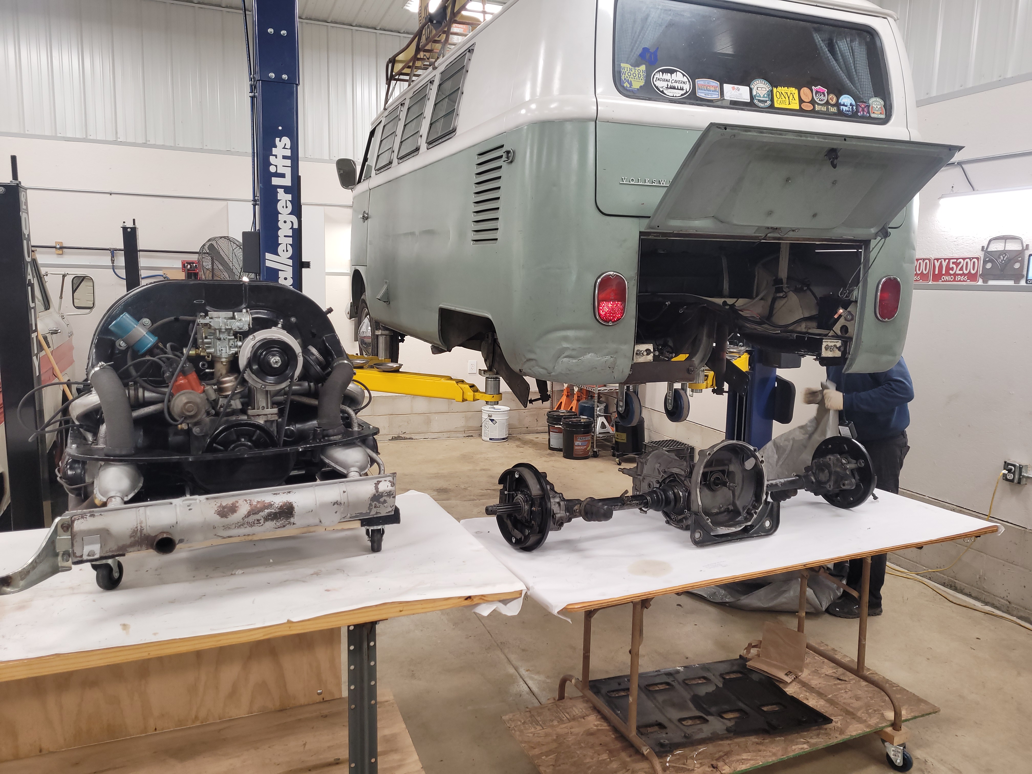

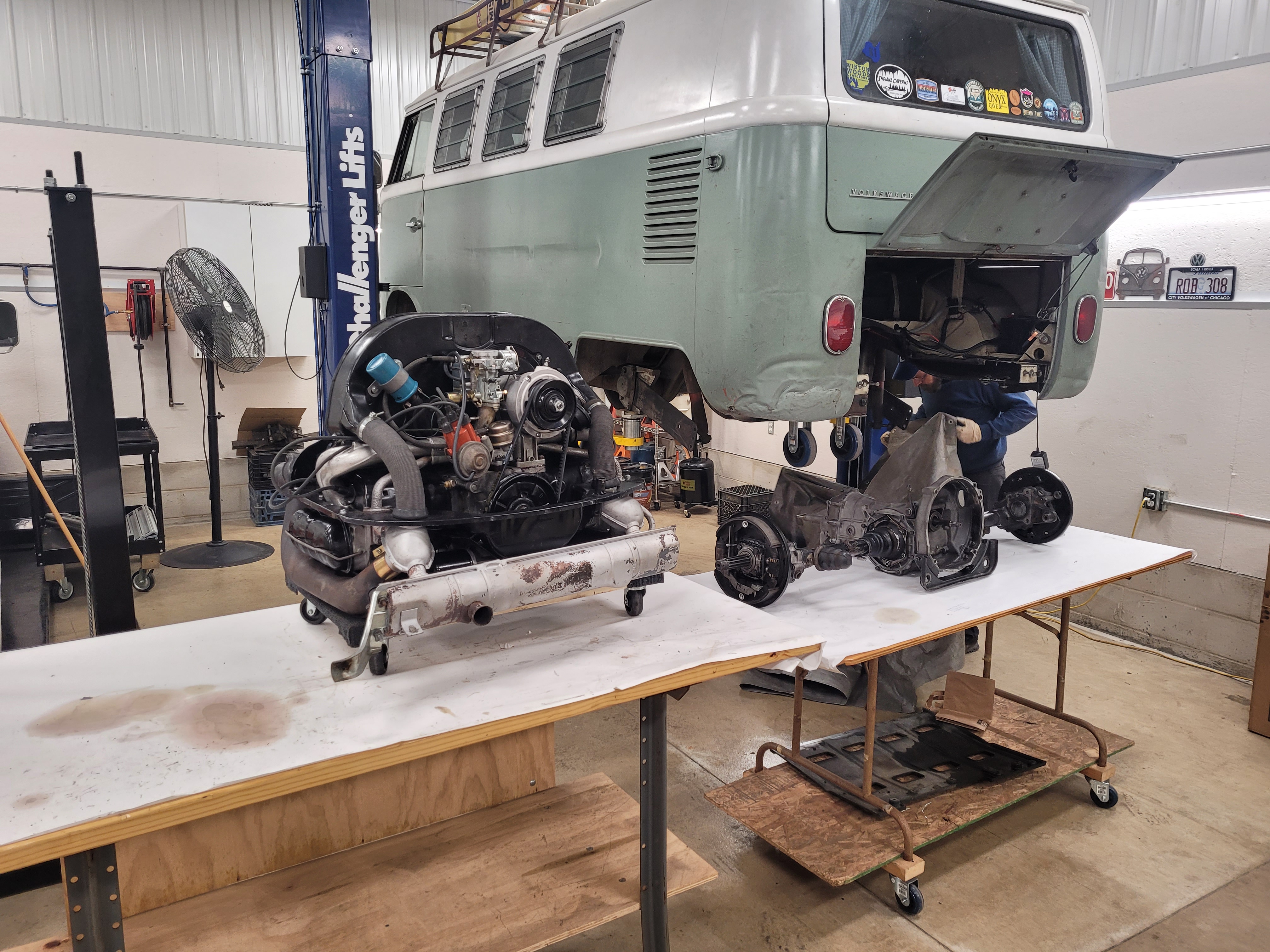

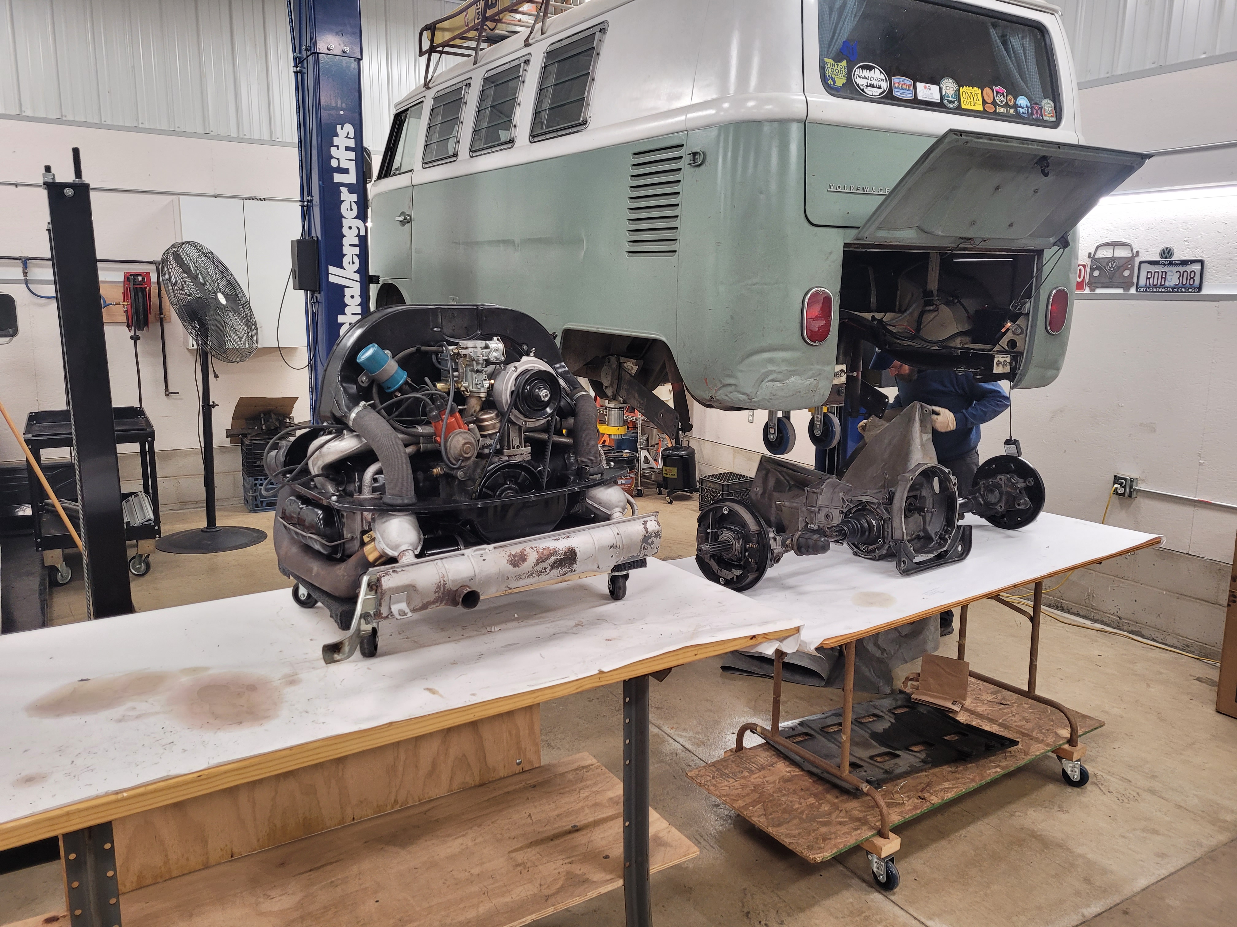

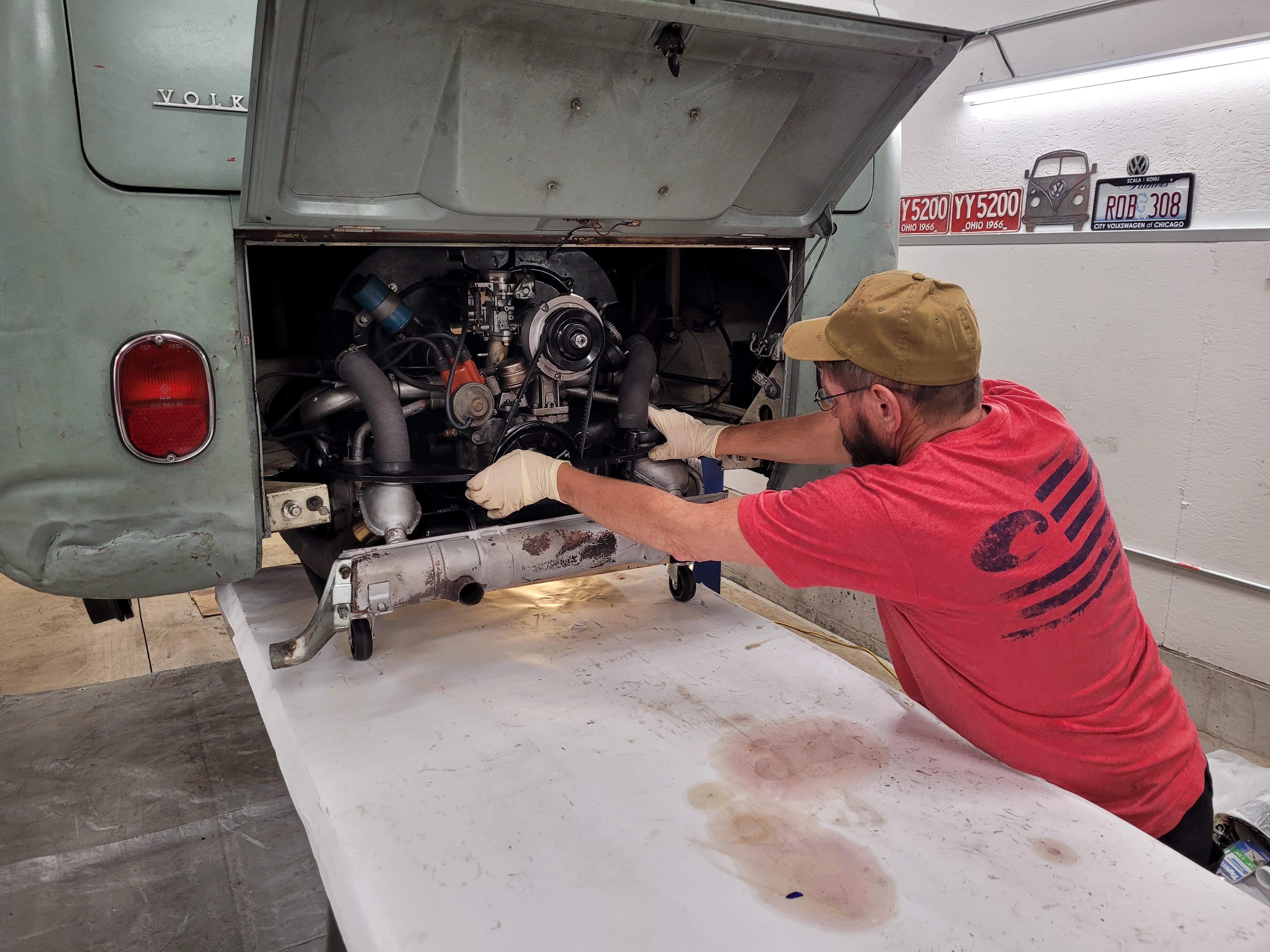

Been slow going because of multiple (non-VW) projects all going at the same time, but here's where we are:

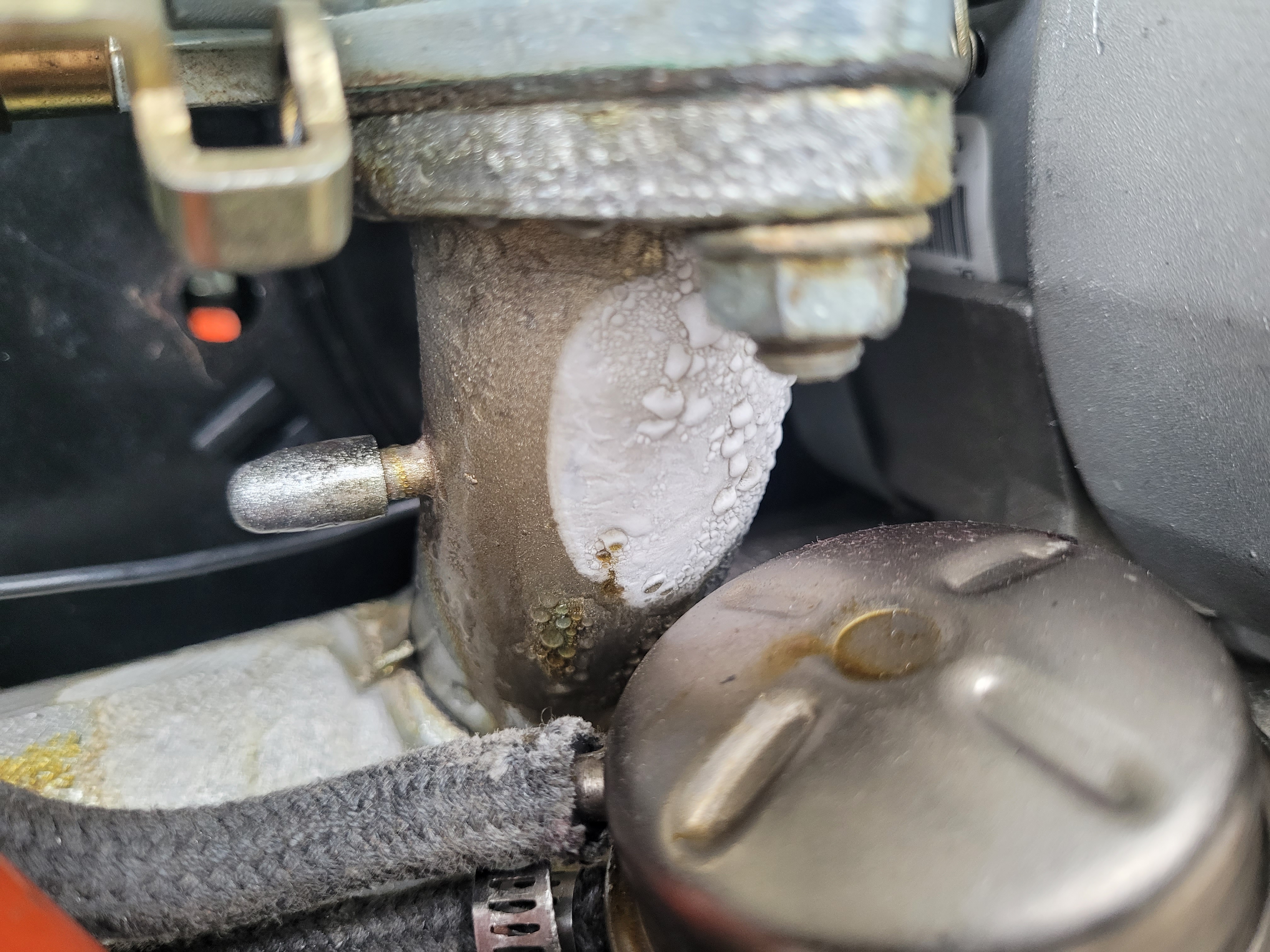

The motor is done, runs perfect, has about 8 hours run time on the run stand, oil changed, valves reset and ready to rock. Note the frost on the intake, that day was about 45 and humid, the perfect weather for carb icing. Tranny was done from Jim's (warranty job :x ) and we put the axles and RGBs back on it. We stuck the trans and motor back in but the weather turned on us yesterday so we were only able to loop it around the yard in the pouring rain. :shock: When Rob has a day off and it's dry we'll give it a true RT, but it sounds and feels good right now. My buses don't need anything right now, working on the Vettes at the shop, overhauling the engine in the 67 and some minor stuff on the 63.

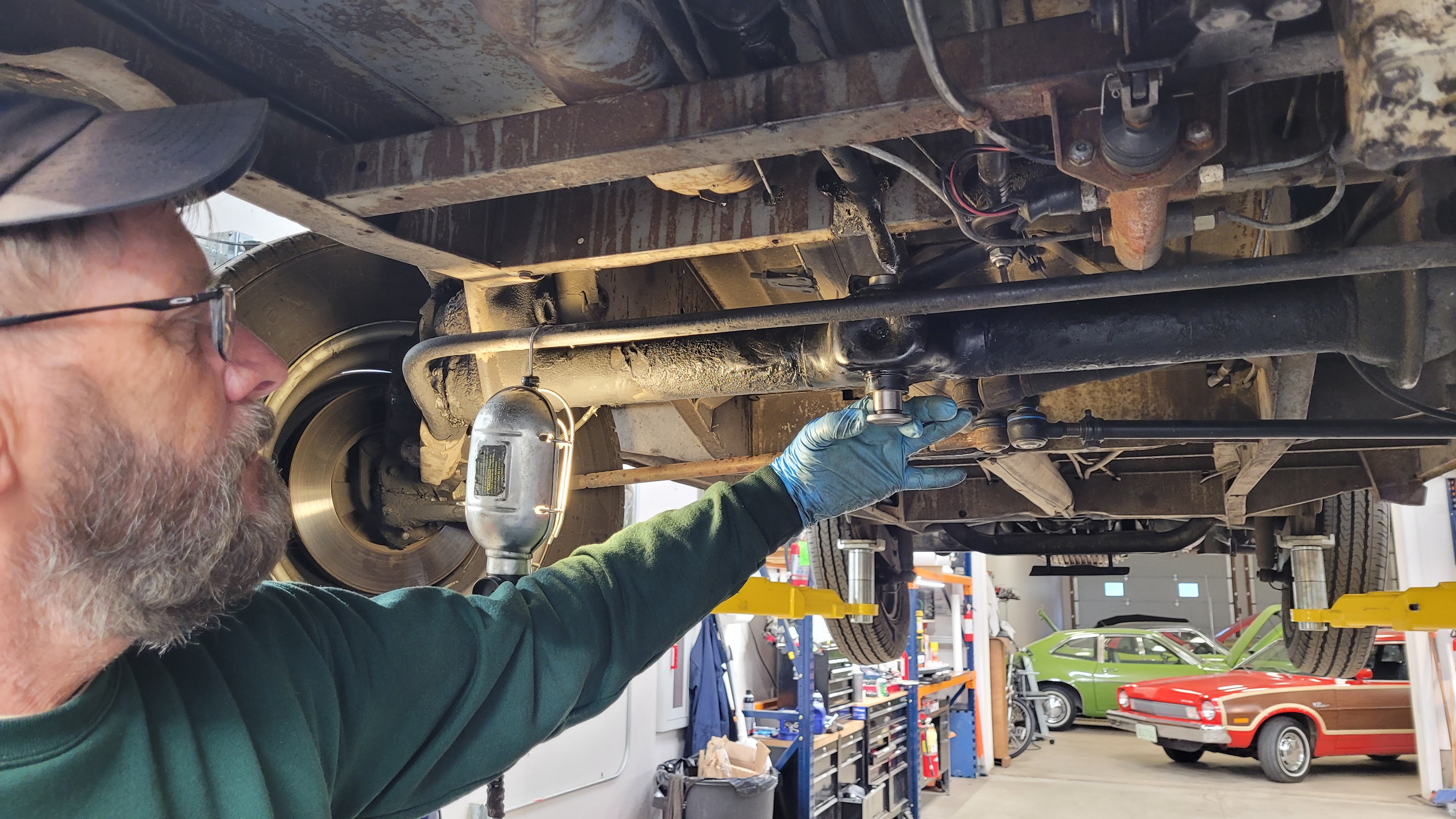

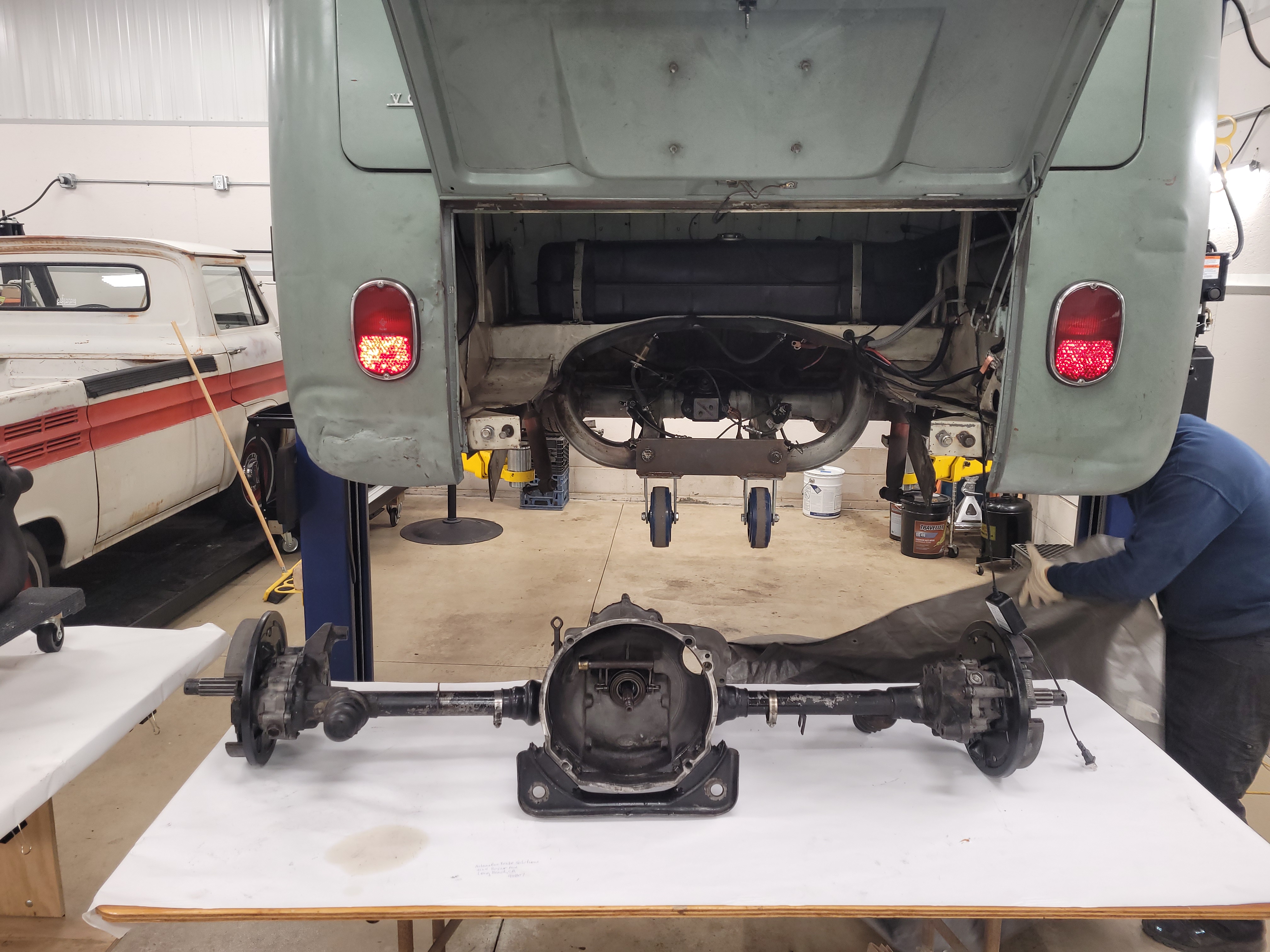

Been really busy working on Chevys lately so not much to post here. We did finally get back to Rob's bus and did the center pin bushings and steering box bushings.

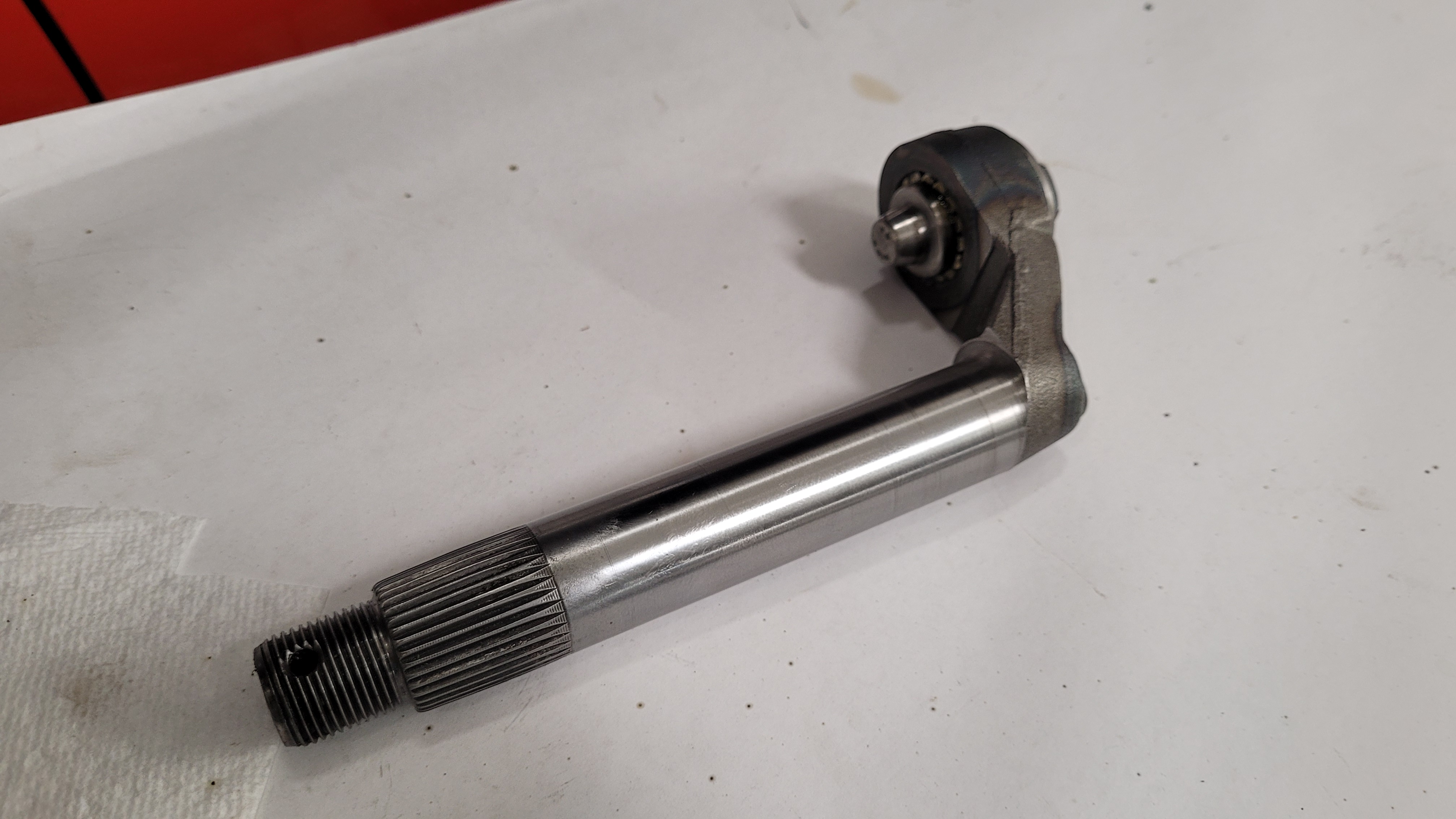

The pitman shaft cleaned up perfectly with 1000 grit paper.

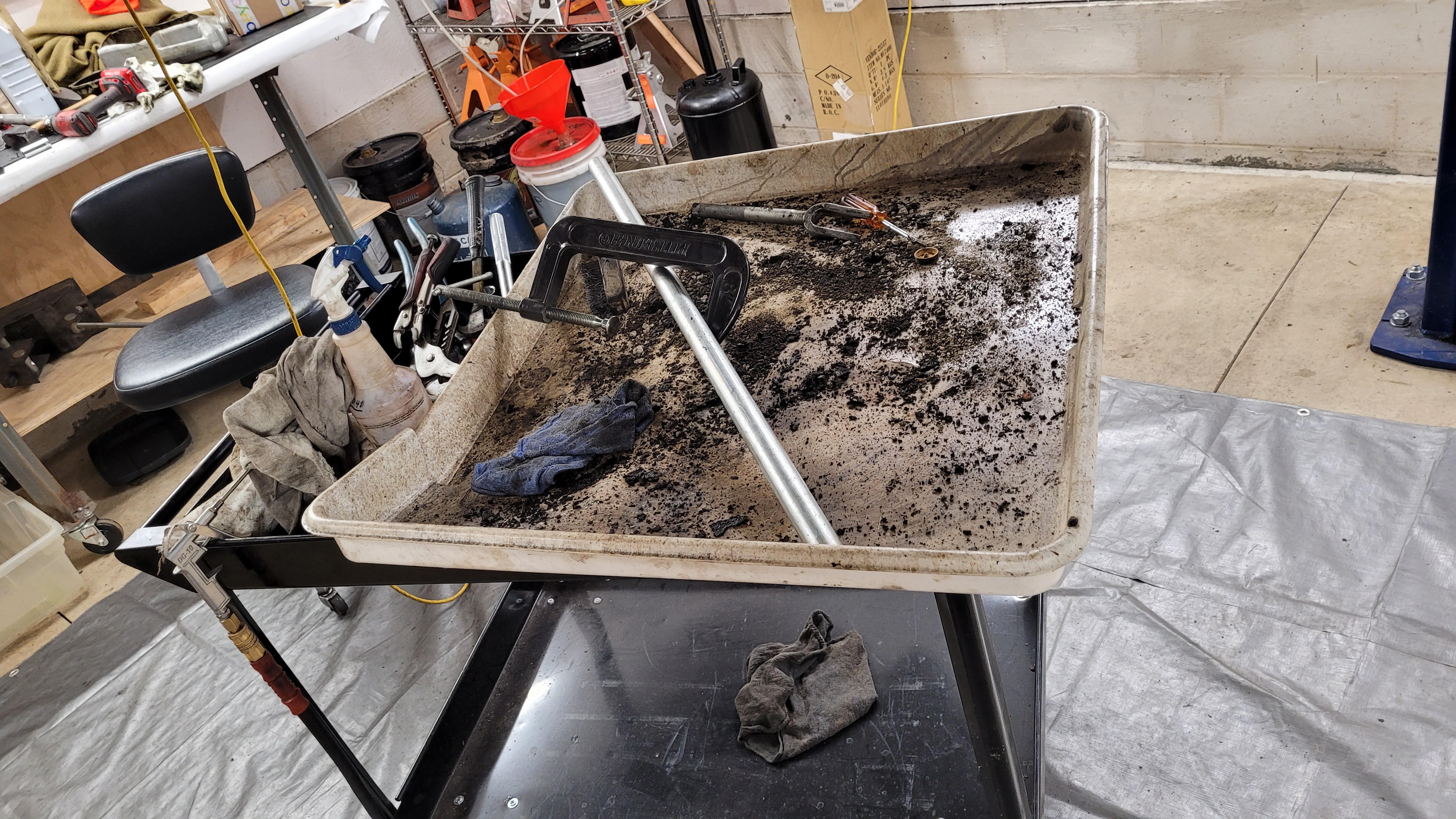

This is a shitty, messy, greasy job.  I mostly watched and made Rob do the real work.

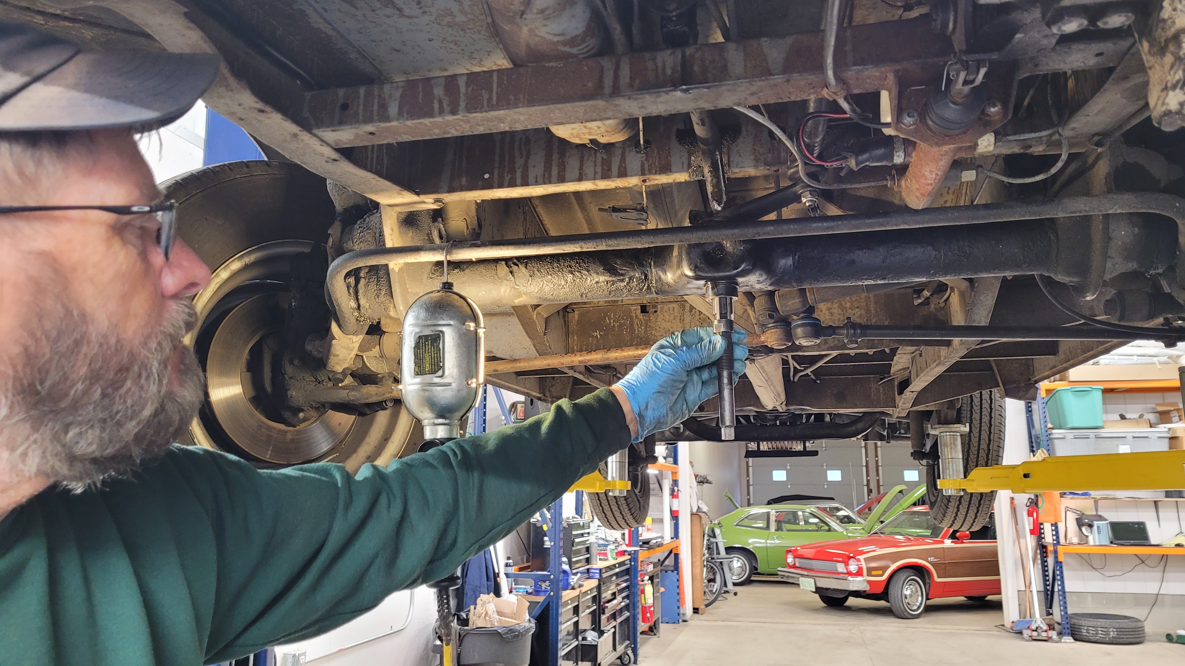

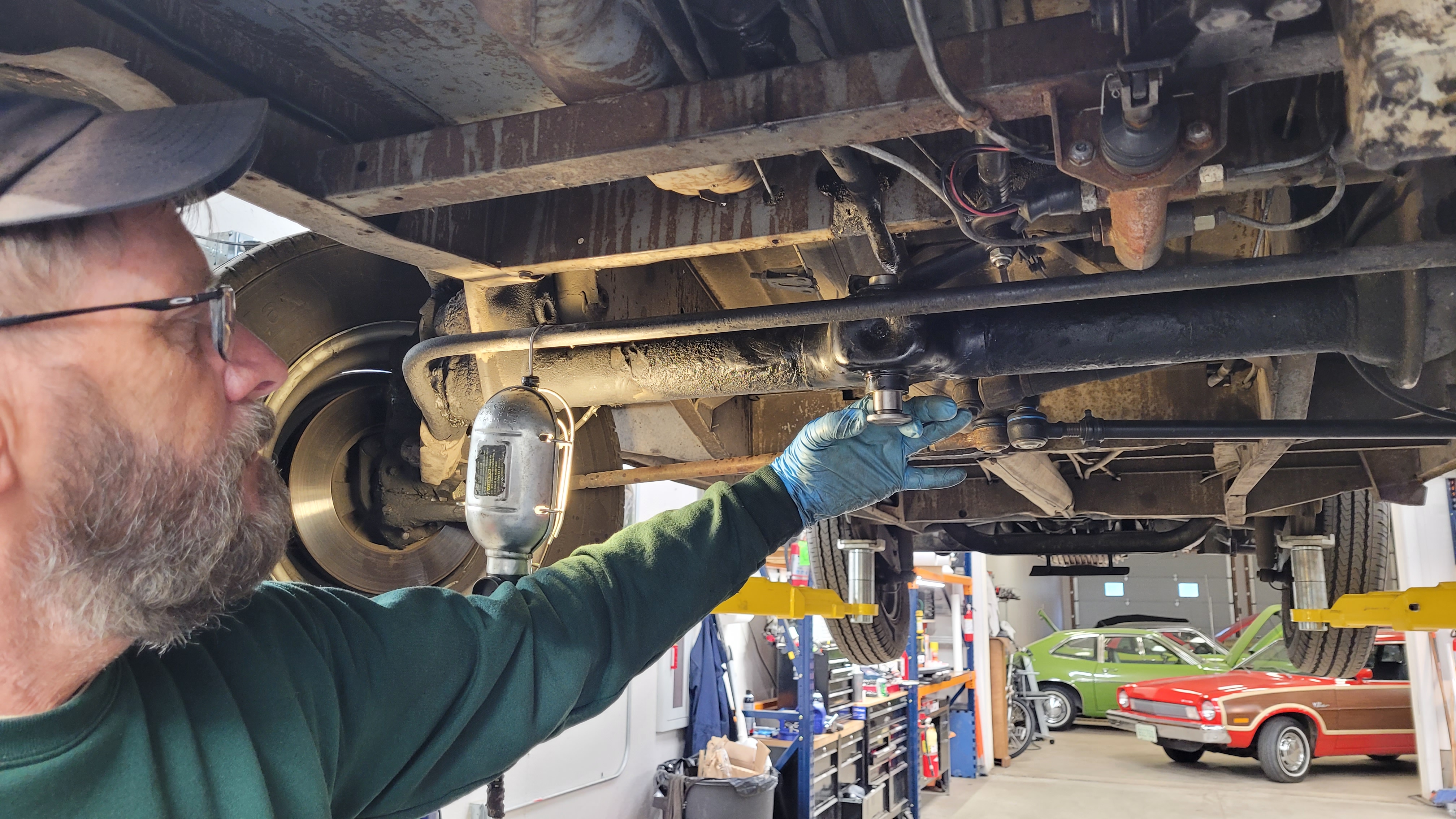

You ream the bushings until the pin "just" goes through with minimal drag. Careful, it's easy to overdo it, and then you're screwed.

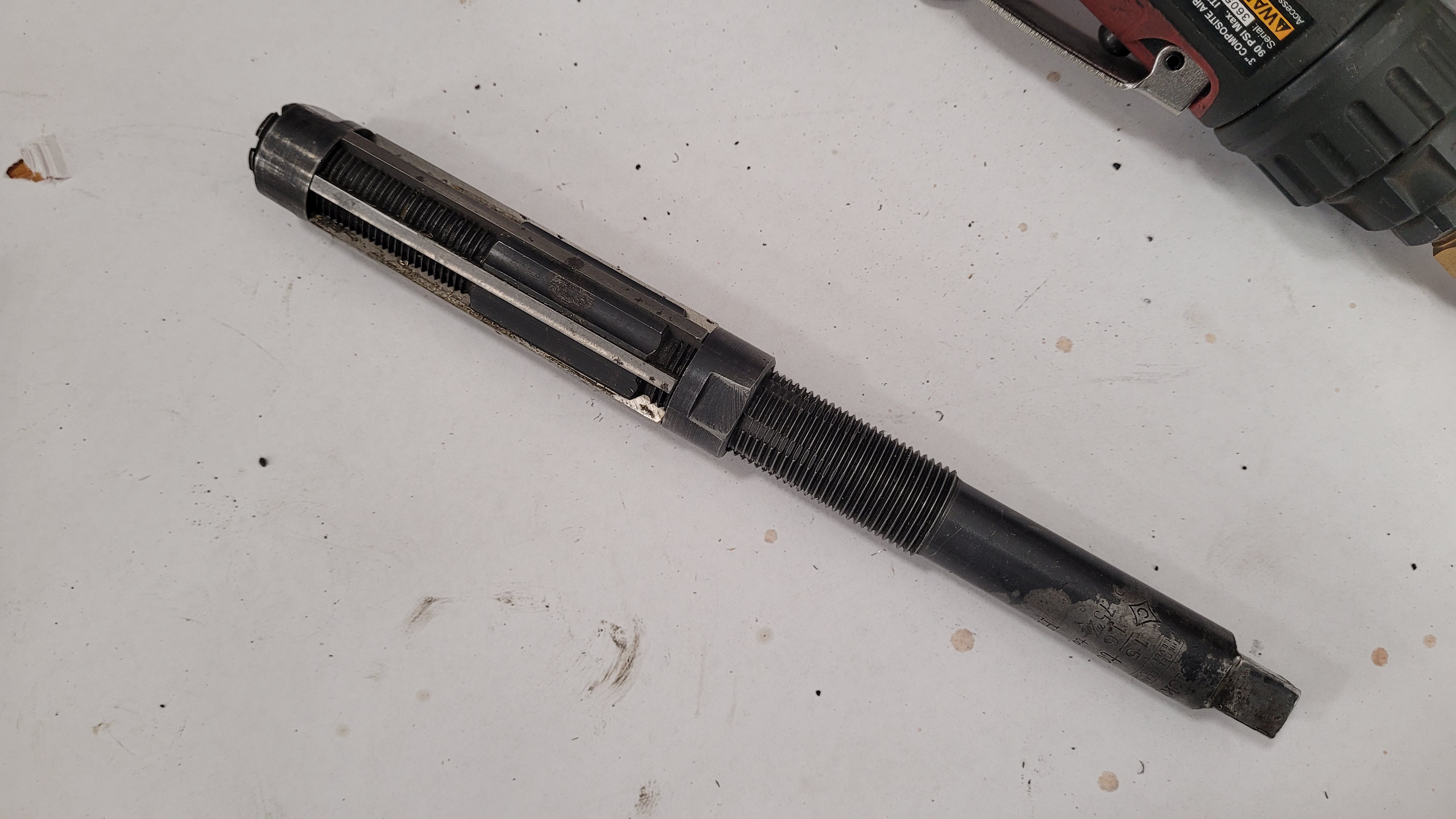

I have a set of adjustable reamers that work nicely.

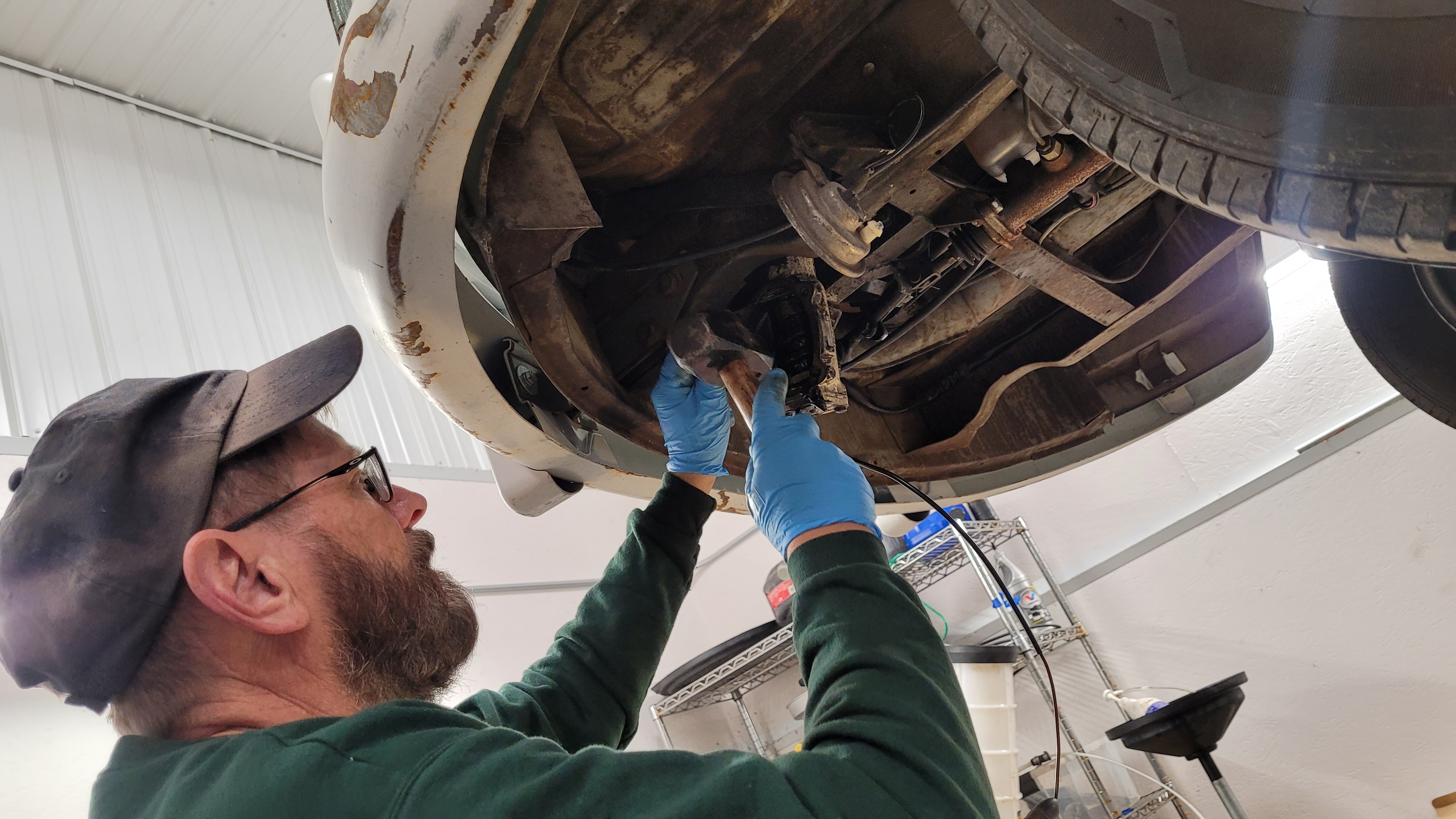

Rob reaming the bushings.

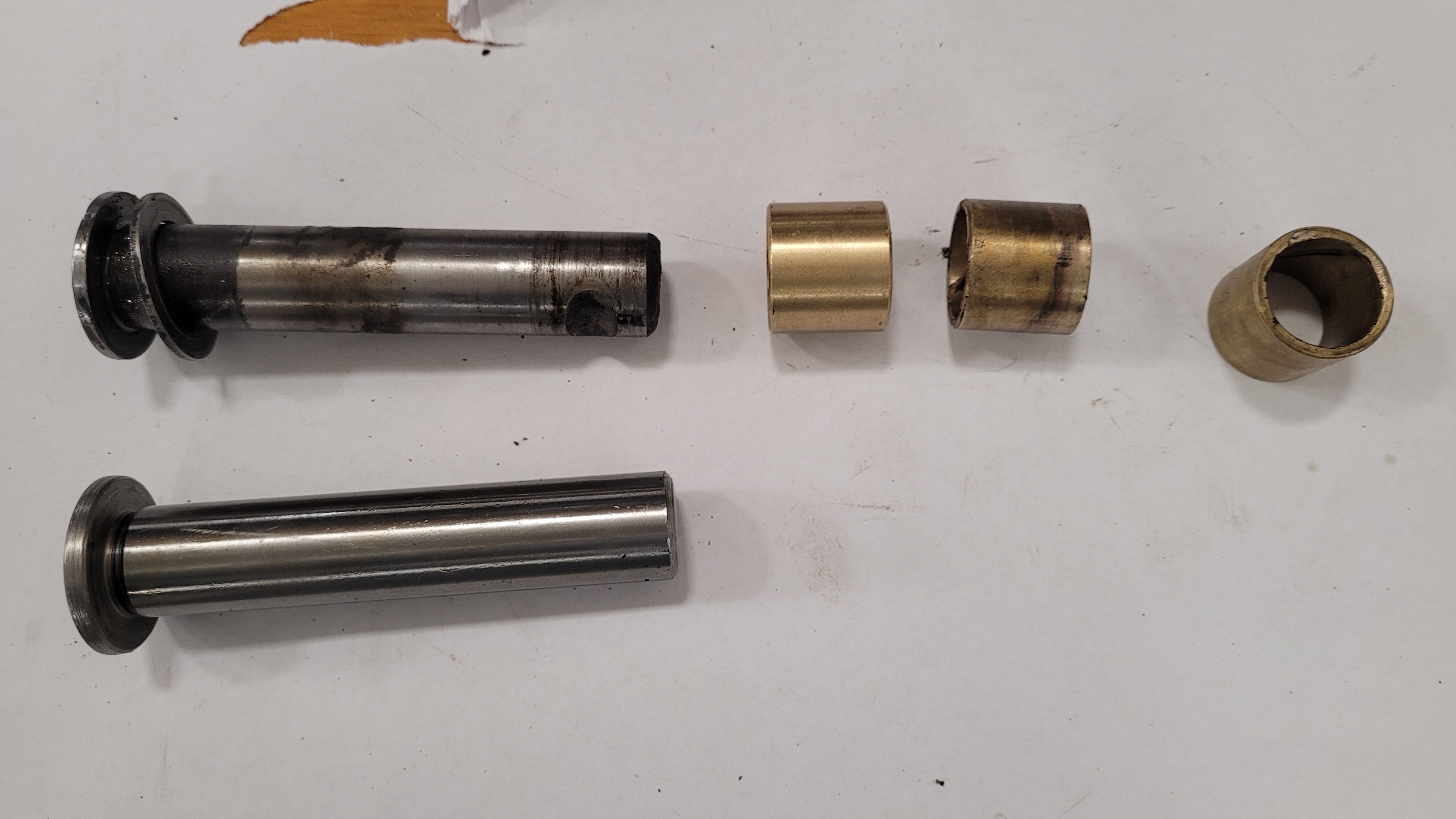

New and old center pin with bushings. Pretty straight forward to install, drive the bushings out and in, ream to size, install, grease. Still a grimy job, though.

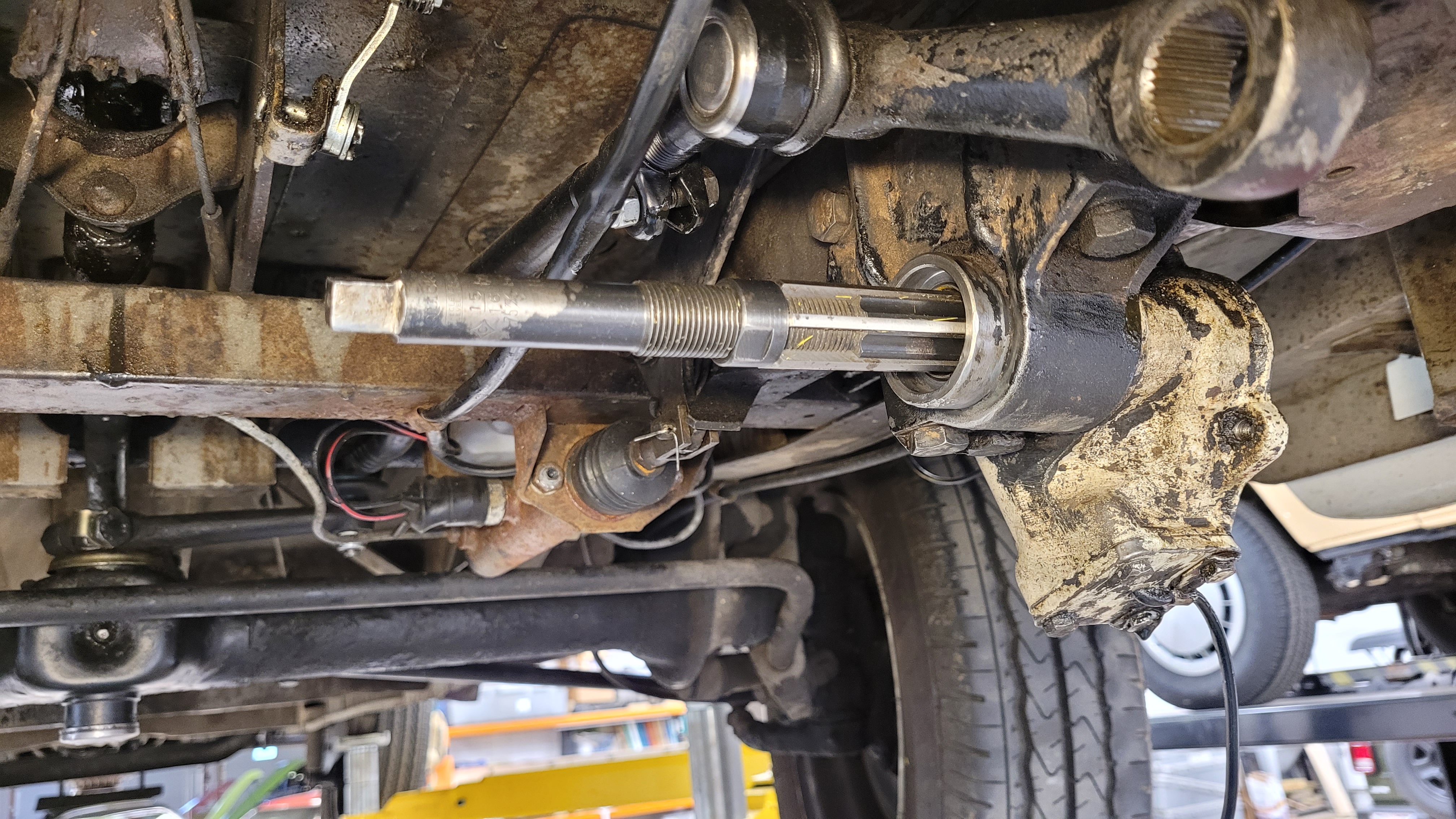

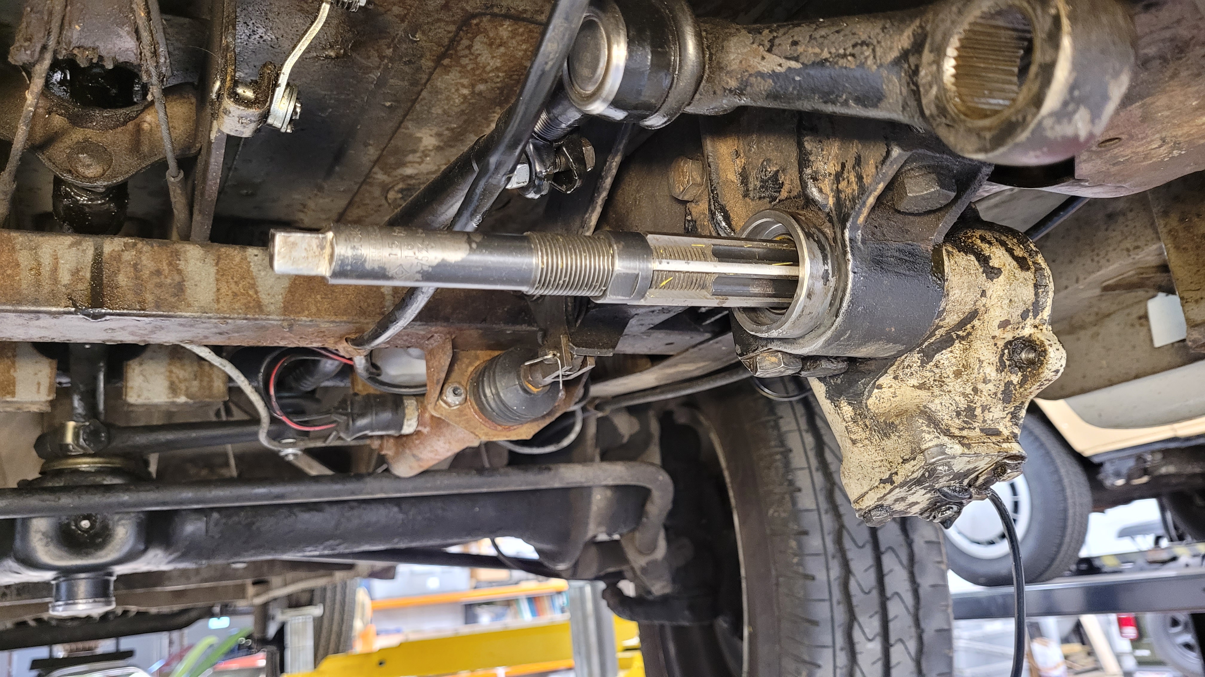

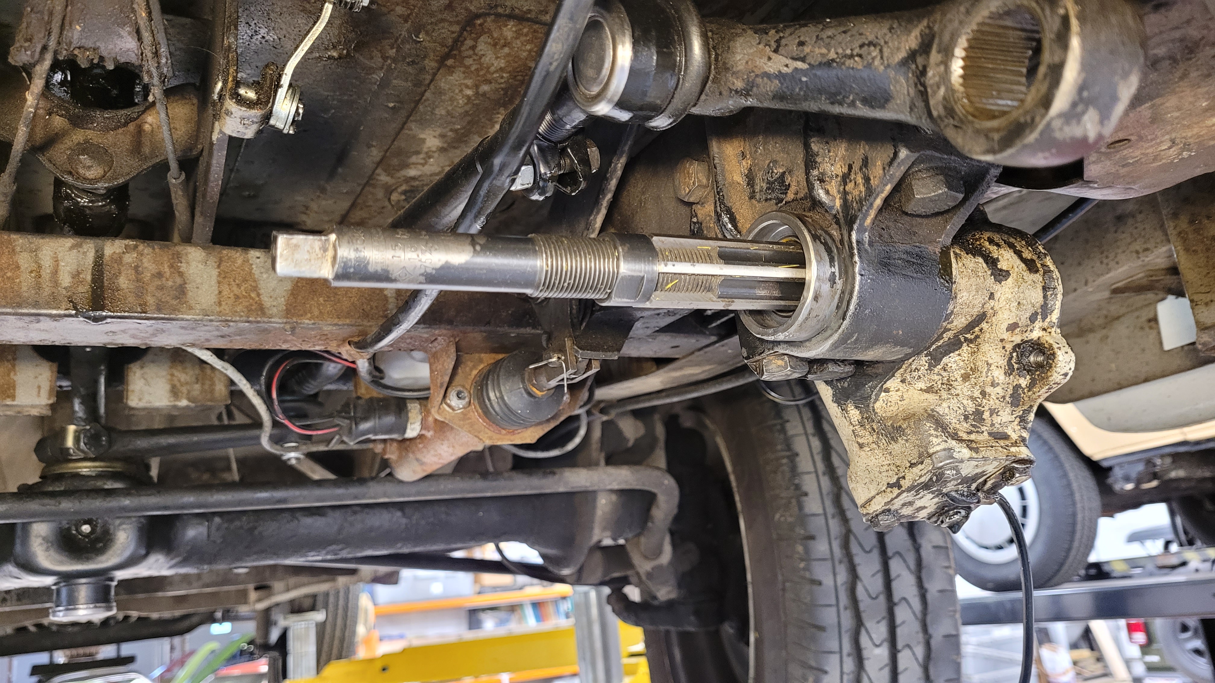

Posts: 1379
Reaming the steering box bushings.
