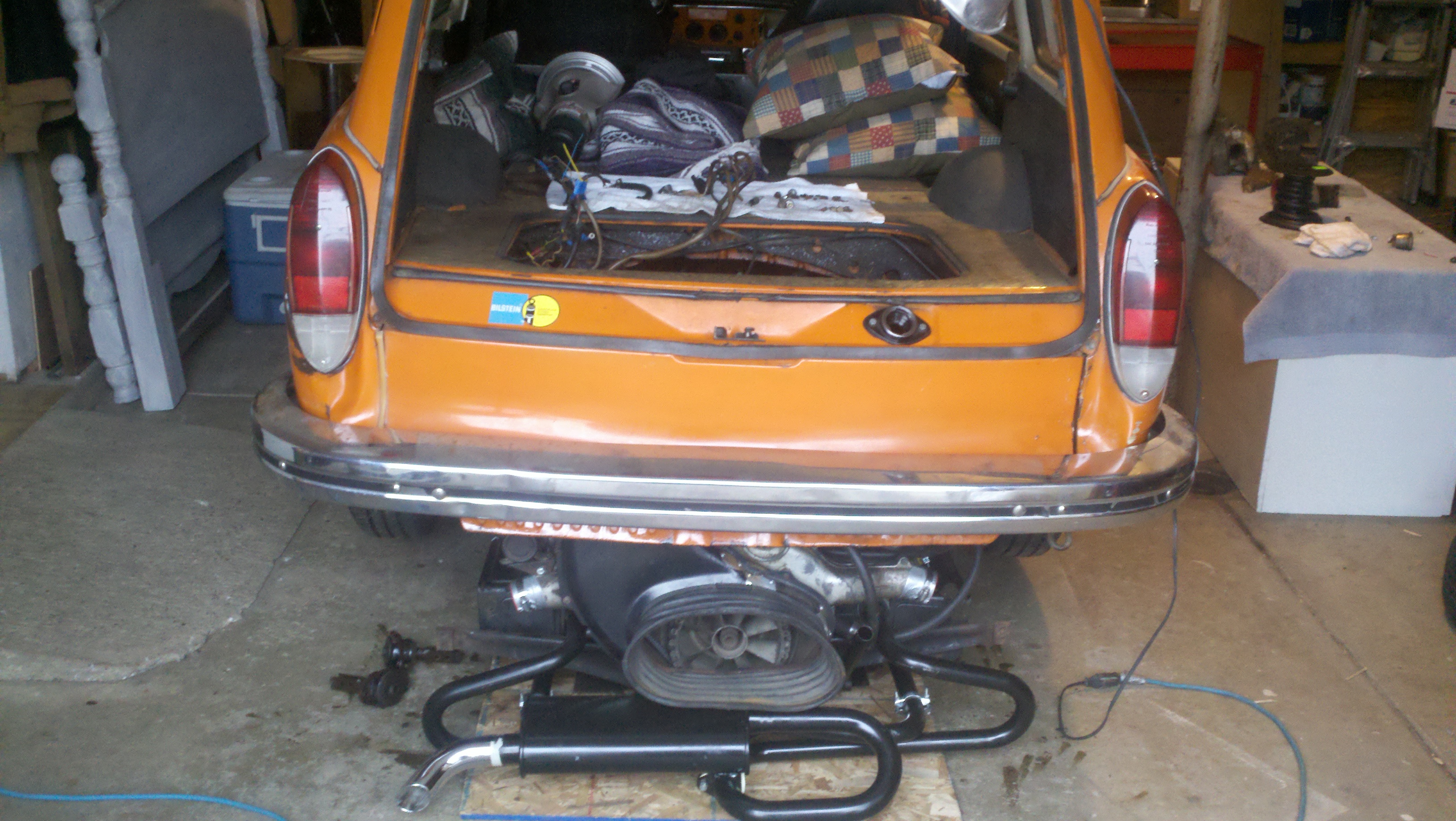

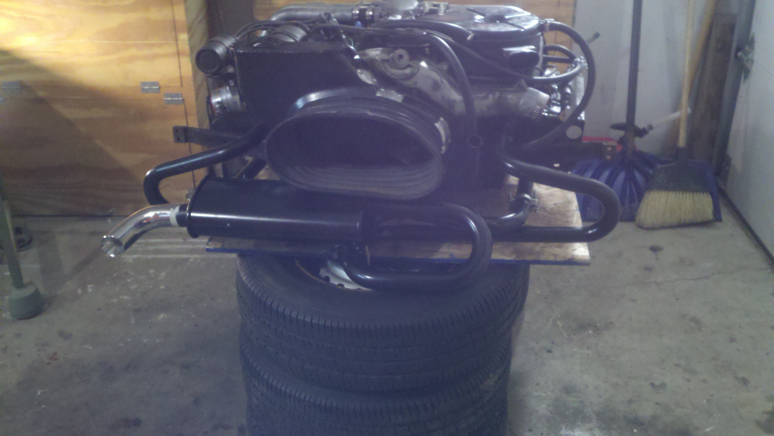

New exhaust :D. No more smelly ride. :D

Almost there. Had to put a floor in my daughters room tonight, or it would have been in.
