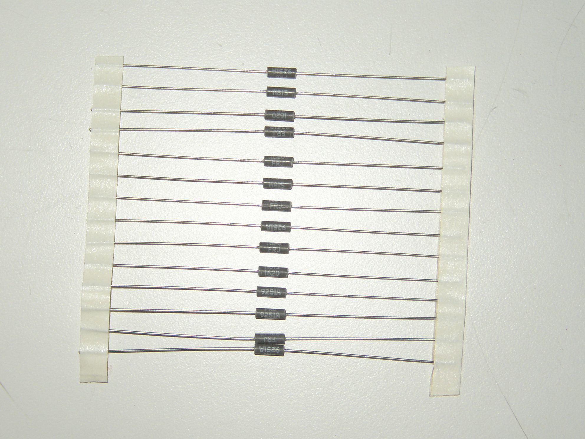

I bought a pack of 162 ohm resistors from Fleabay for a few bucks delivered.

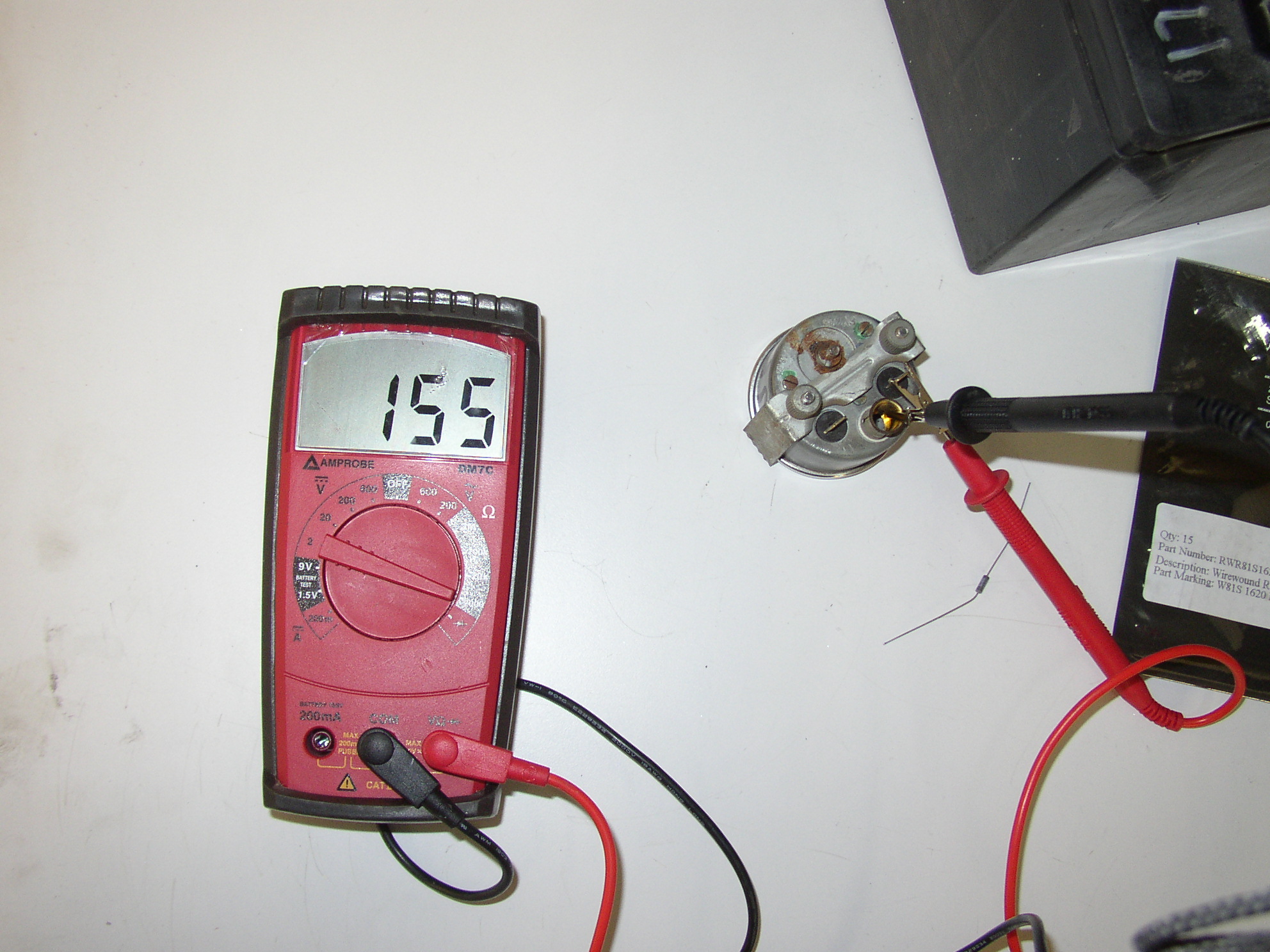

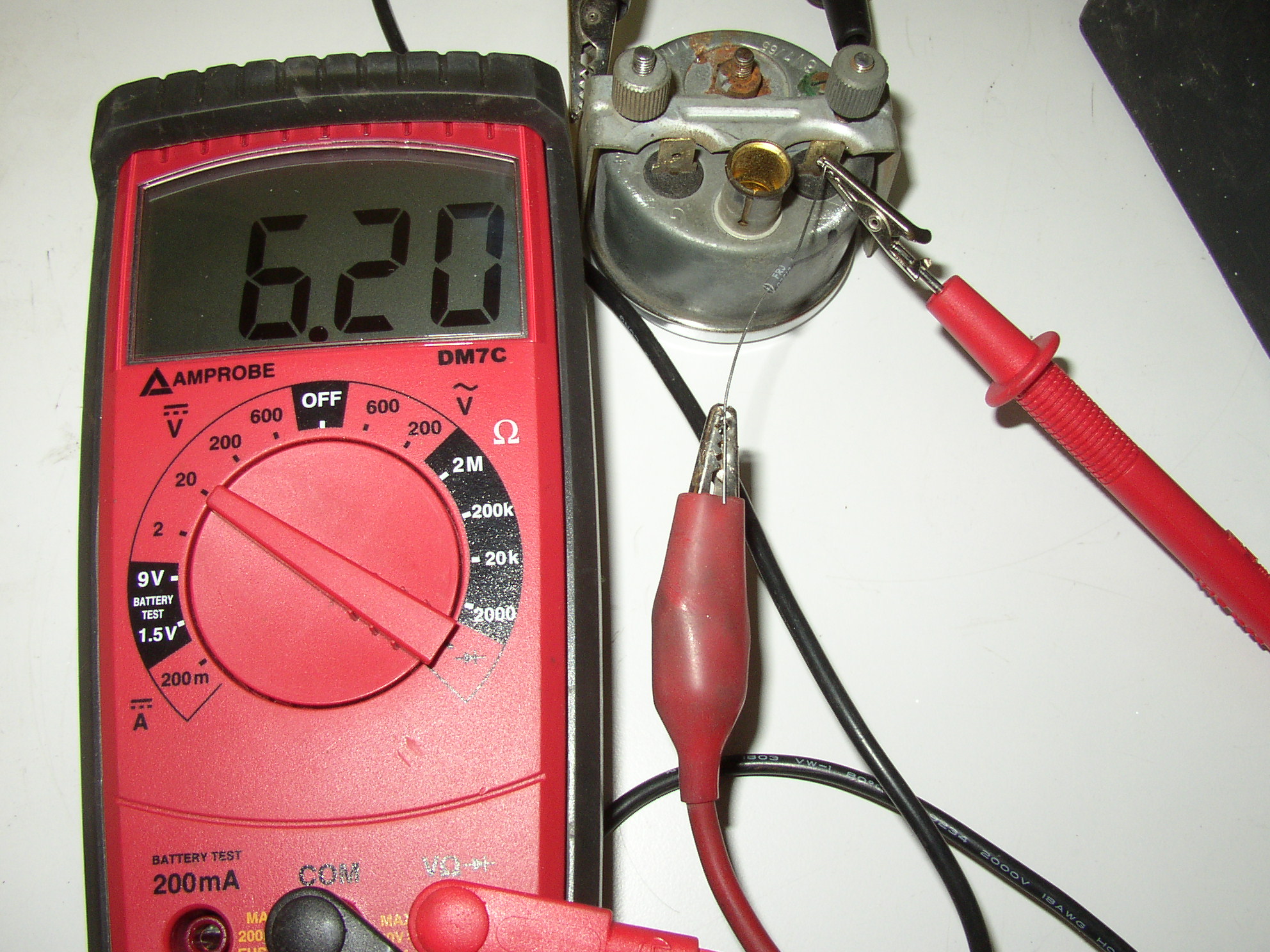

Testing on the bench showed dead on- the resistor in series gave an operating voltage of 6.25v with a fully charged battery at 12.55v on a spare 6v gas gauge.

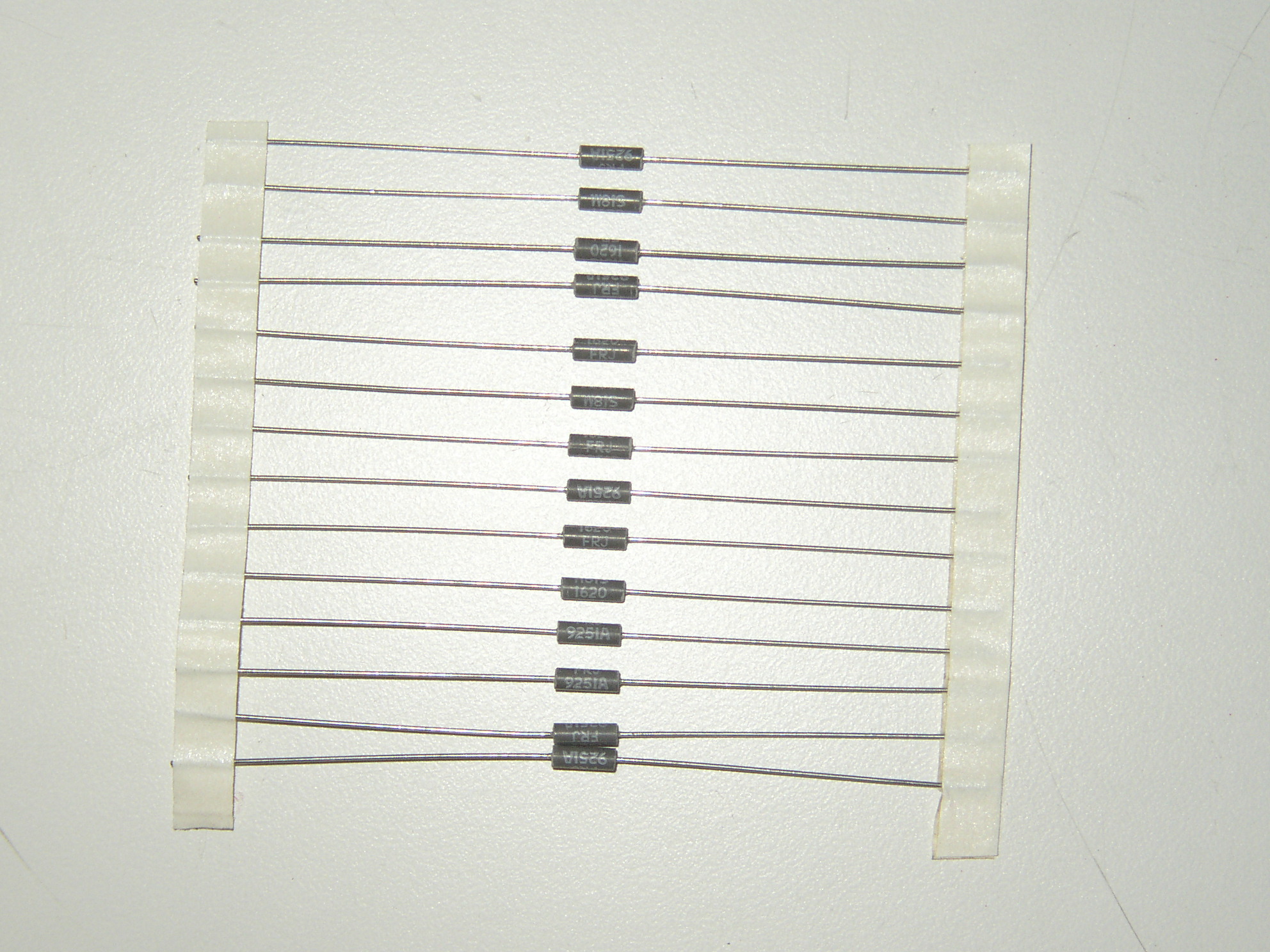

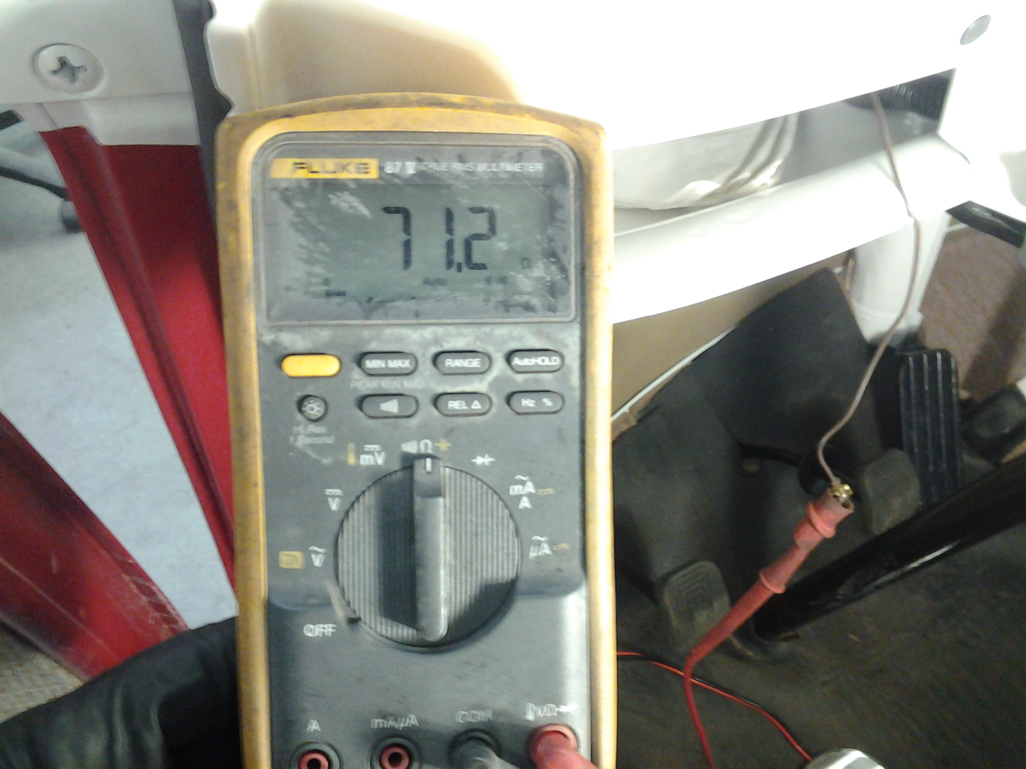

The measurement I took at the gas gauge for current flow is super tiny- 76ma (76 milliamps, which is 76- 1/1000s of an amp or .076 amp) is not enough to even make a taillight bulb glow dimly.
