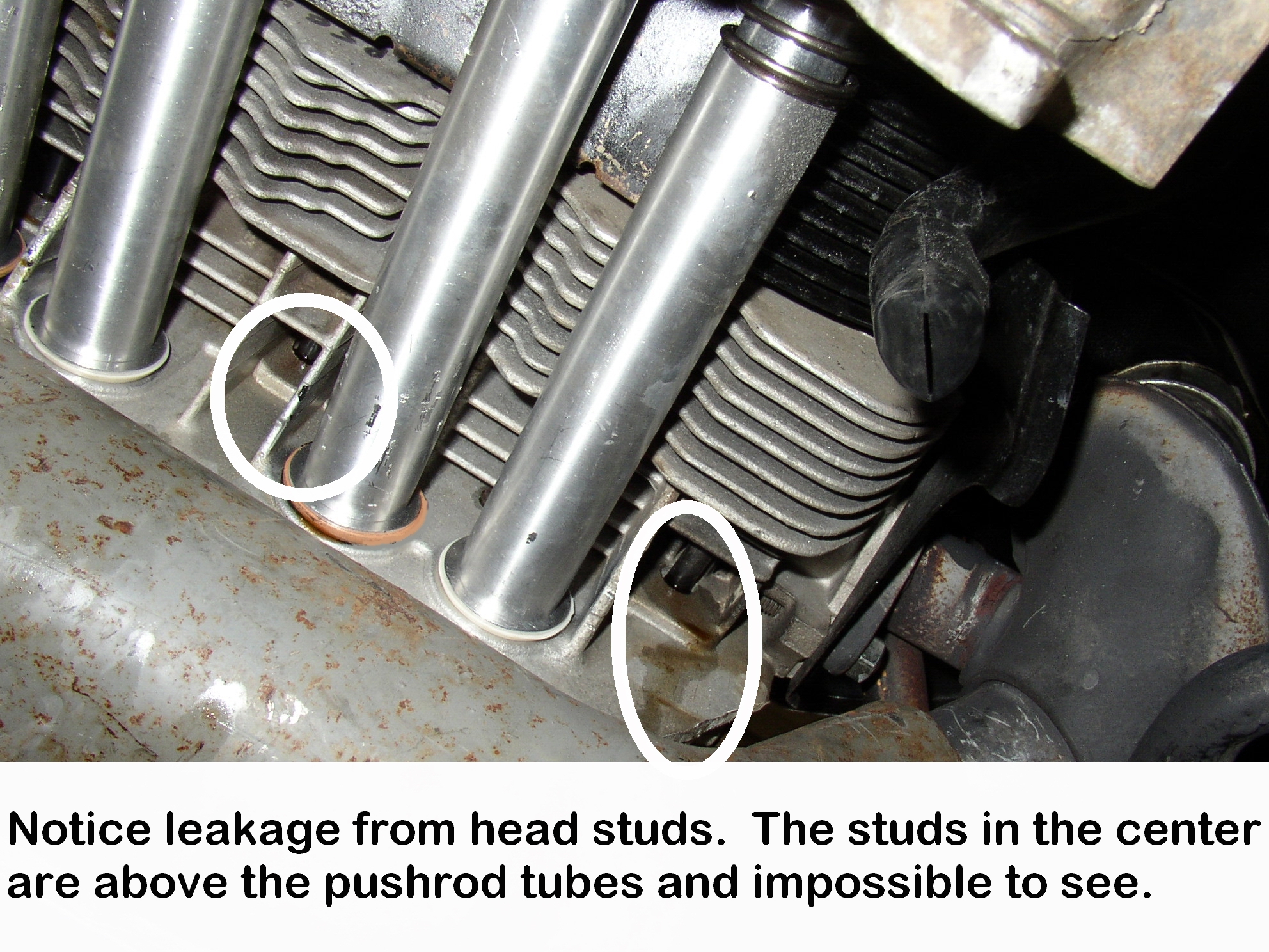

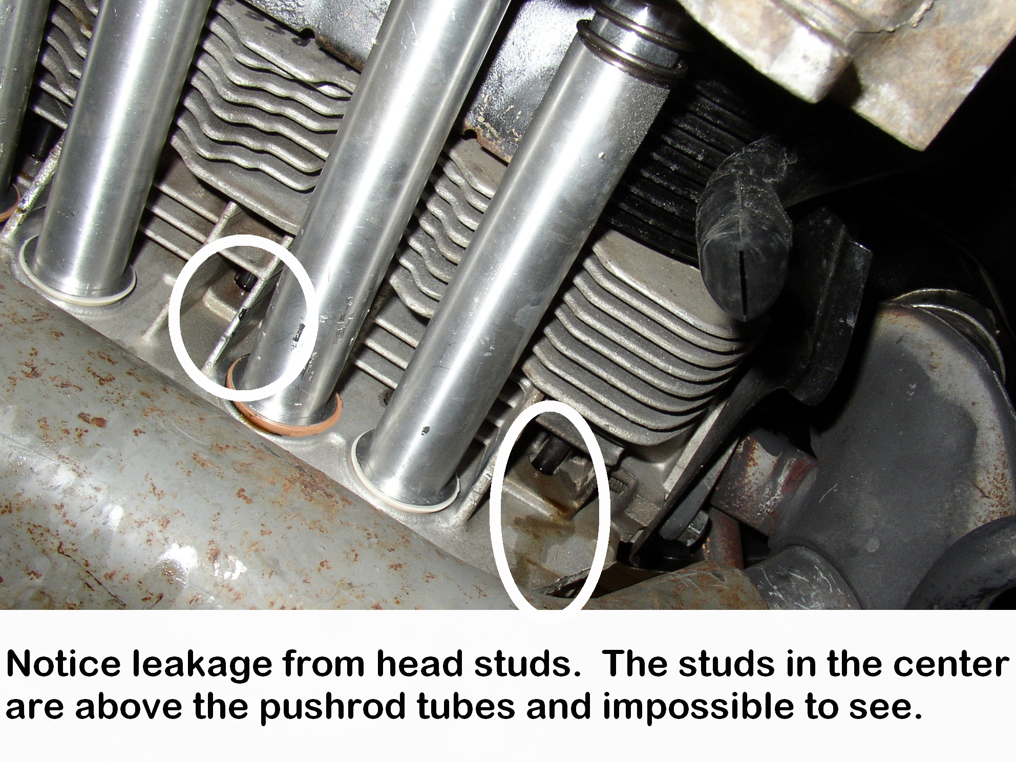

Man, this 1904 has given me a giant PITA with nuisance oil leaks. Repeated replacement of pushrod seals, fittings that didn't want to seal, head studs (like this) that leaked repeatedly, ugh. I don't think it's a crankcase pressure problem, the blowby is comparable with the 1600SP in the bus. It's just bad f'ing luck. I have dozens of hours sealing, resealing, replacing, and bitching at these leaks. That's half the reason I run it so long on the run stand, so I can work the bugs out. Usually I have 6-8 hours on the run stand, this one must have 15-20. The (desirable 36hp Beetle cast iron Bosch VJR 4 BR8) distributor was junk, too, with wicked spark scatter so I had to change that out after putting $40 worth of points/cond etc in it. The service manual says you don't have to seal the head studs (but I always have) and on this one I had to do it twice. For some reason the High Tack I've always used didn't stick to the aluminum (WTF?) and I had to redo it again with Permatex #2 which is like toothpaste. It took three times with the pushrod tubes, too, the oil pump had to come back out because it leaked, and there was an oil galley plug that took about 5 times to seal. I have NEVER had a VW (or any engine!) give me this much grief. I've been chasing oil leaks since April 12. Here the big head stud leak is circled but the center studs are also leaking and dripping onto the PRTs, almost impossible to see, and this is after using High Tack on the stud washers and nuts, and replacing the PRT seals three times. Ugh..........

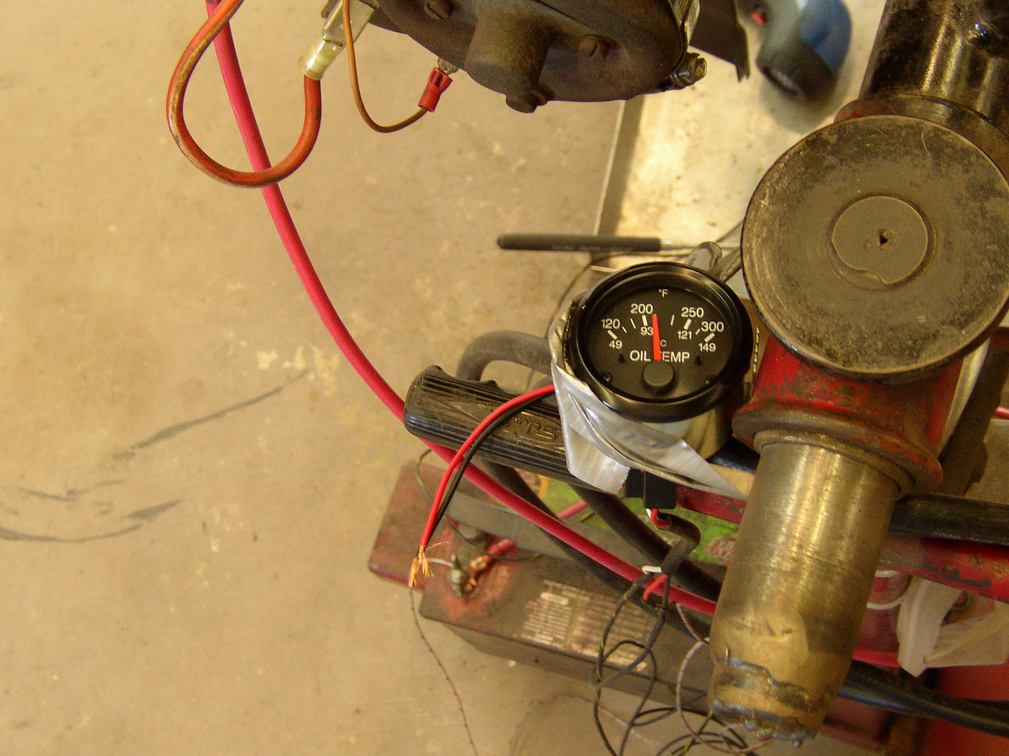

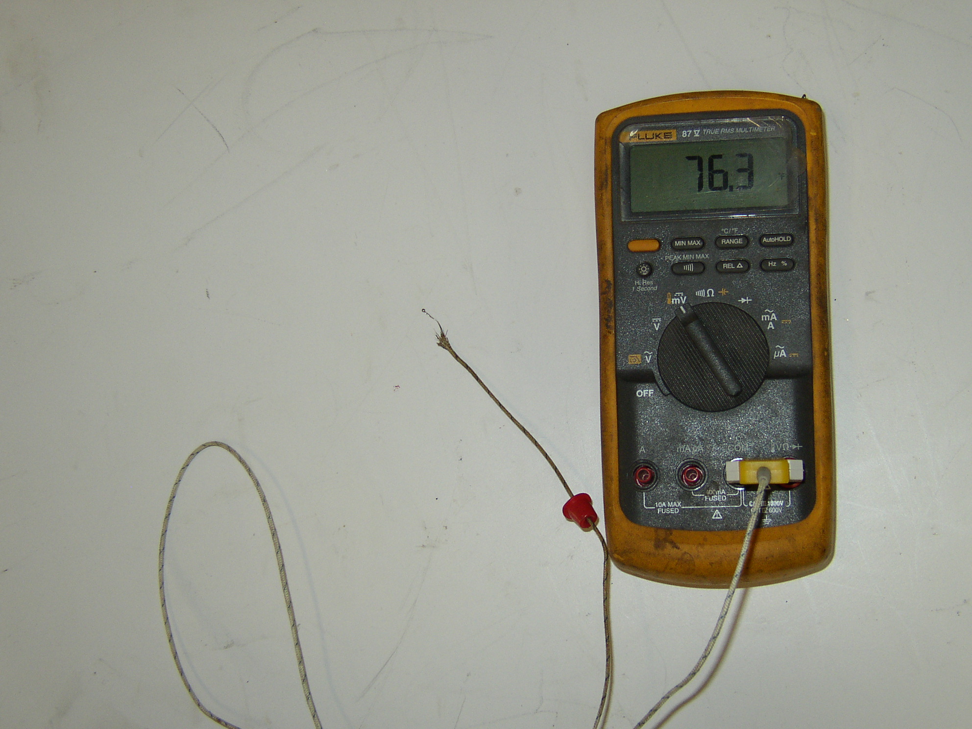

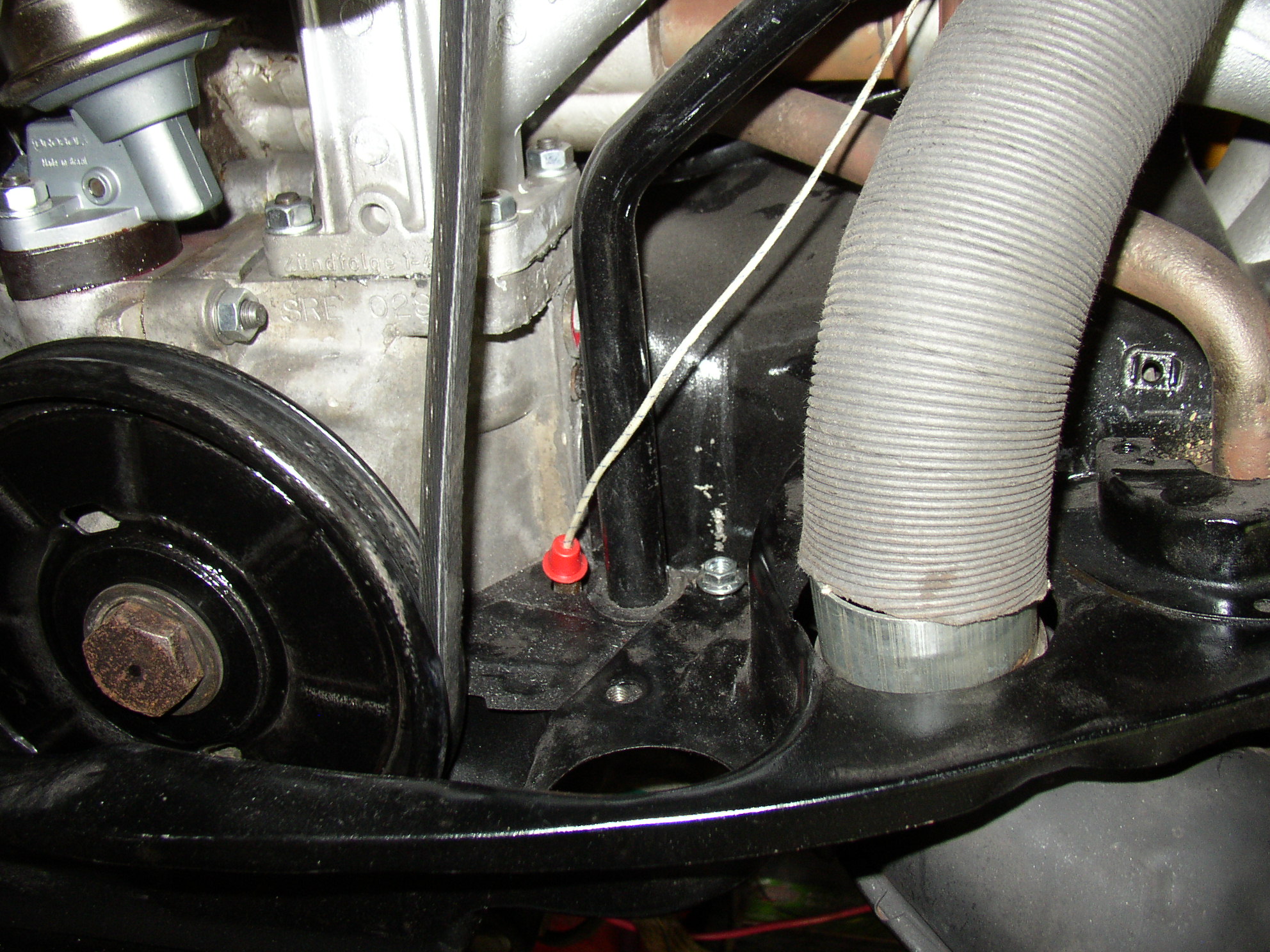

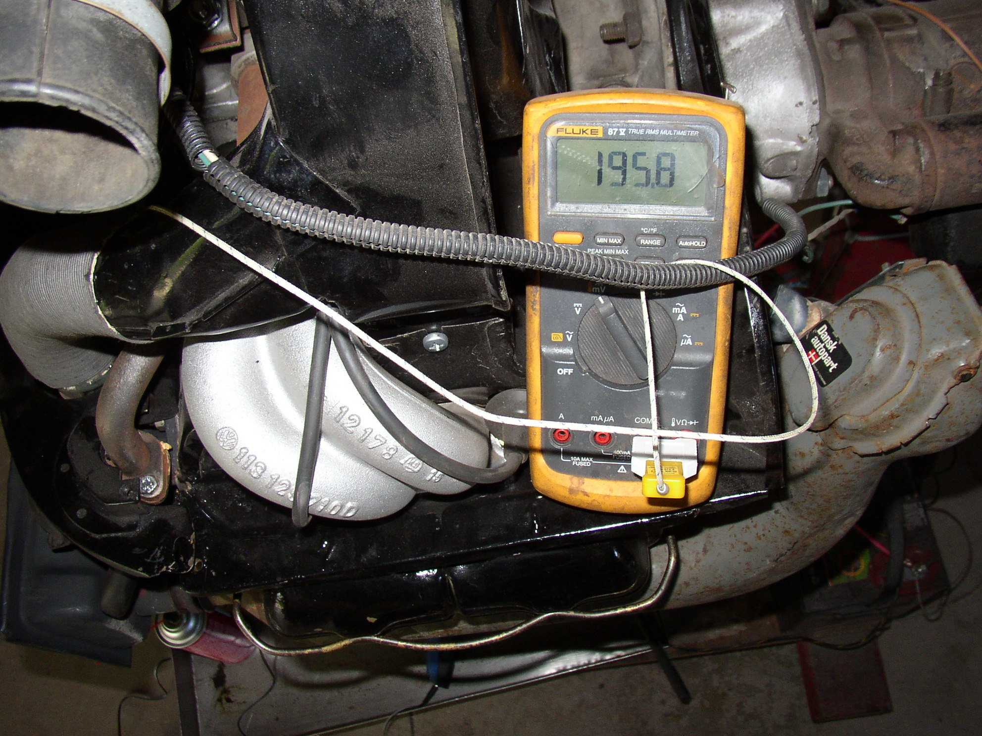

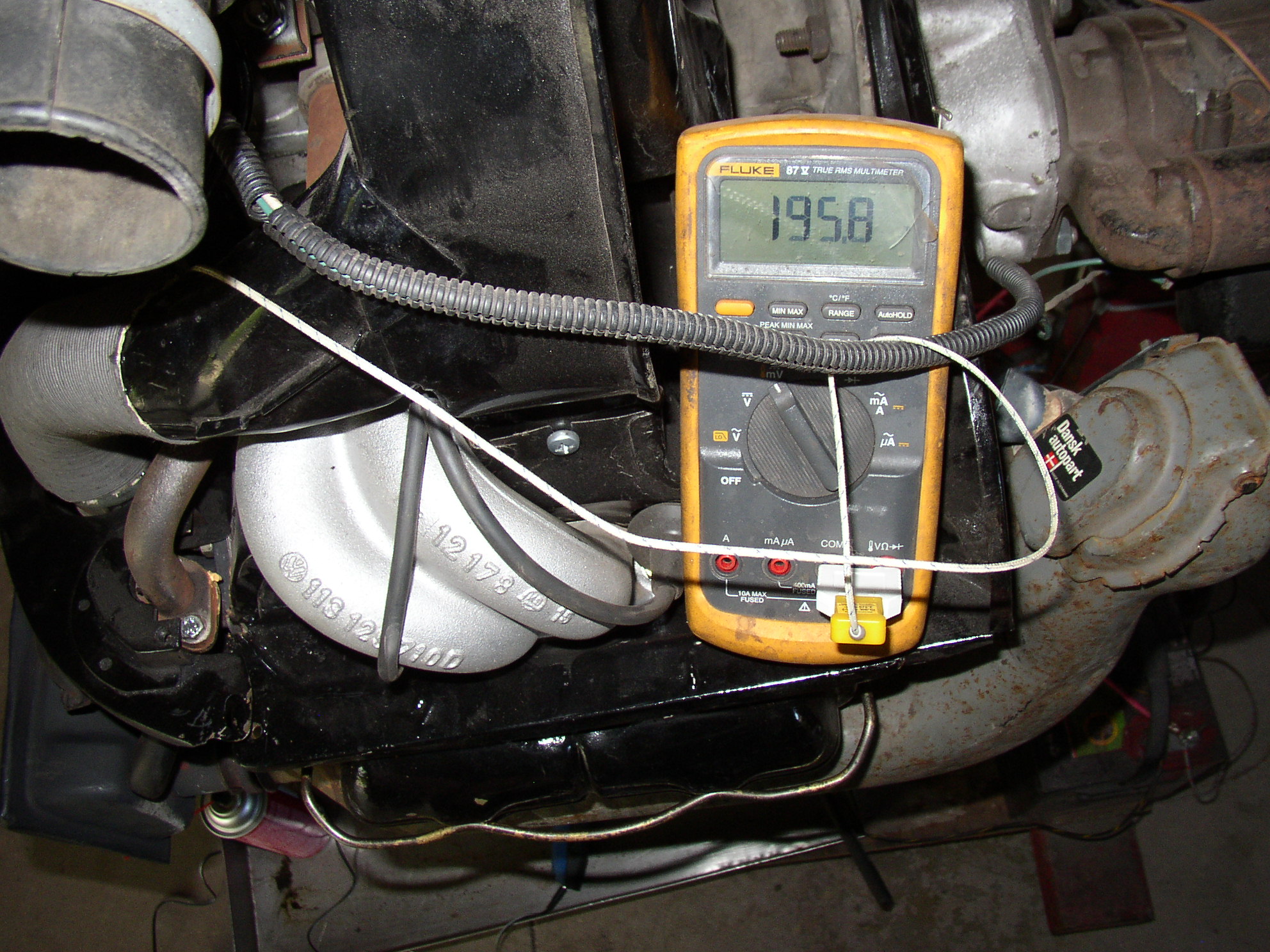

I'm using a VDO oil temp gauge and sender, but compared to a Fluke it reads about 25° higher than the Fluke. The Fluke seems dead on at room temp/body temps.
Here the Fluke reads 196,
And the VDO reads 220ish with both tips of the senders in the sump about 3" apart.

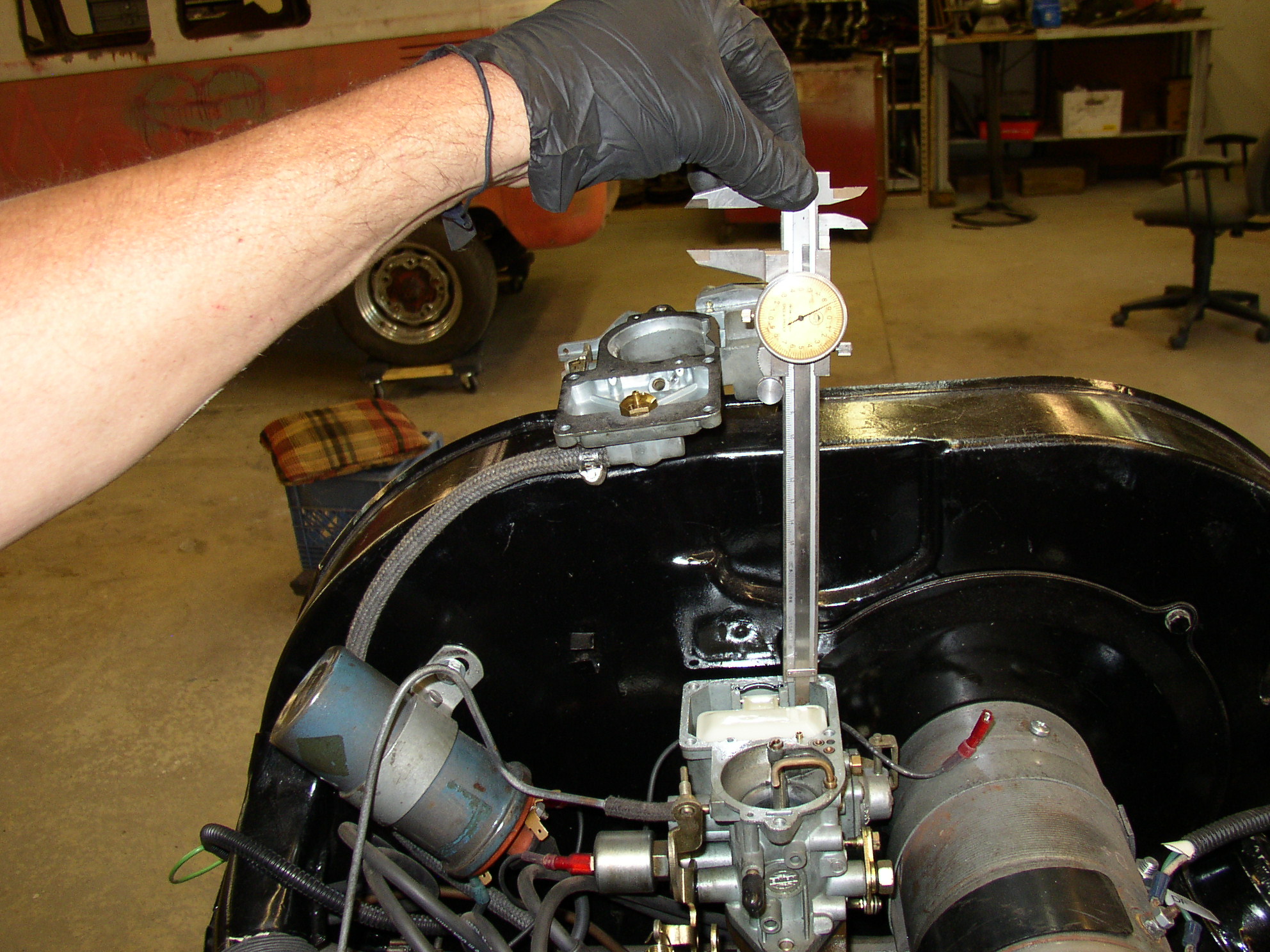

The carb seemed too rich and the float level was a bit high.
A thicker gasket under the needle/seat fixed that.

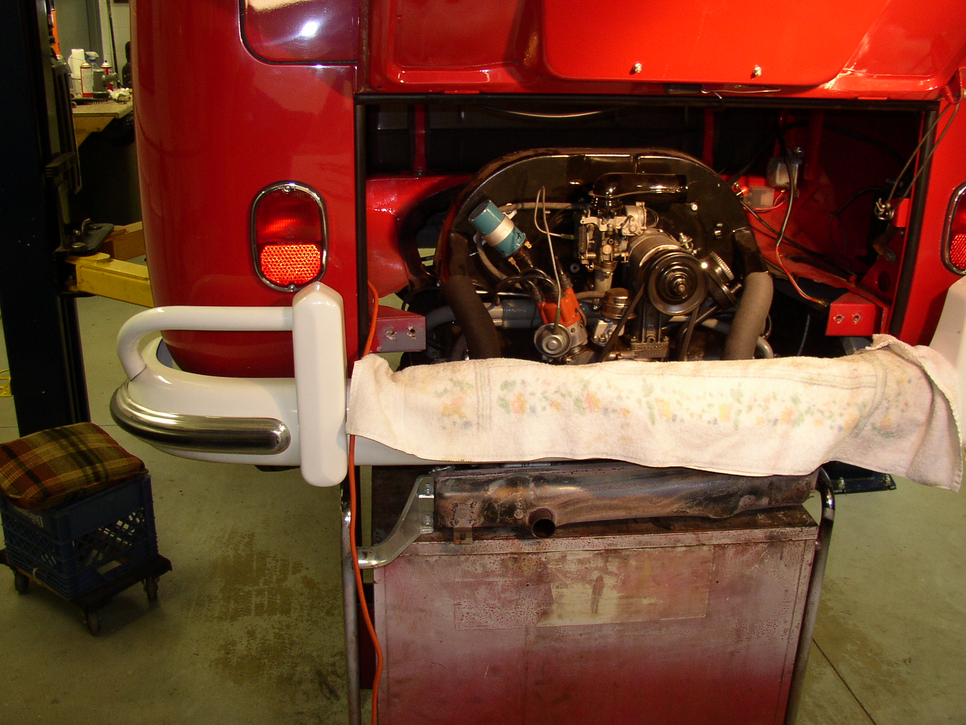

Yesterday it was finally out with the 1600SP. I thought I'd have to remove the bumper, but it was not in the way at all.
In with the 1904. Thunk! I love that sound.

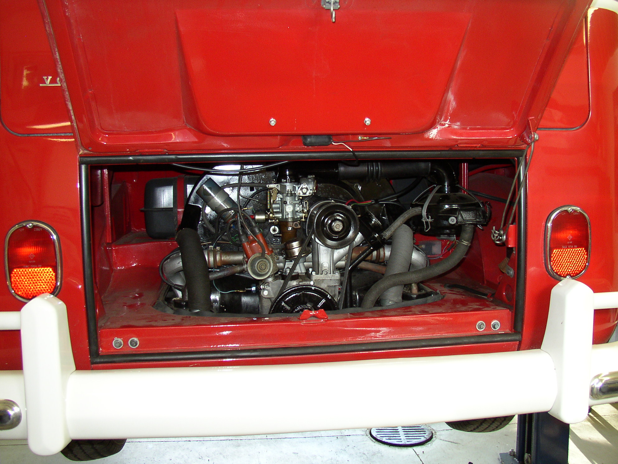

Here it is, all done, about 3 hours after pulling the bus in. Yes, I know I need to dust, that's not my strong suit.
I put about 80 miles on it between yesterday and today, mostly on the highway at 65-70mph. It runs great and not a drop of leakage, not even seepage!

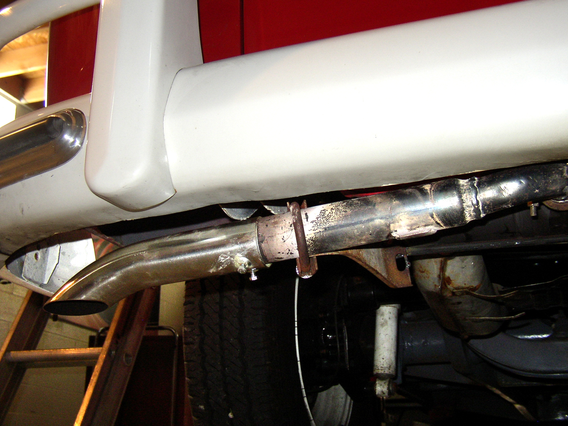

Exhaust is mostly stock- gutted muffler, stock resonator pipe but not the tiny tailpipe.
For that I clamped an Ammurrican chromie to it. It's no louder than stock,
but breathes well! You can hear it, but it's not loud or throaty at all.

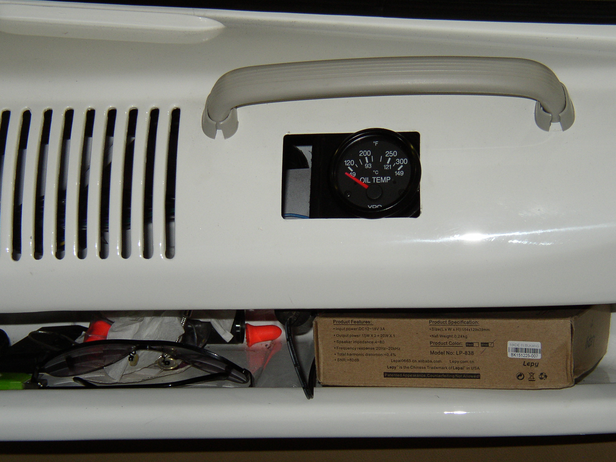

I temporarily mounted an oil temp gauge in the hole where the clock was.
