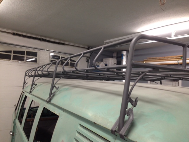

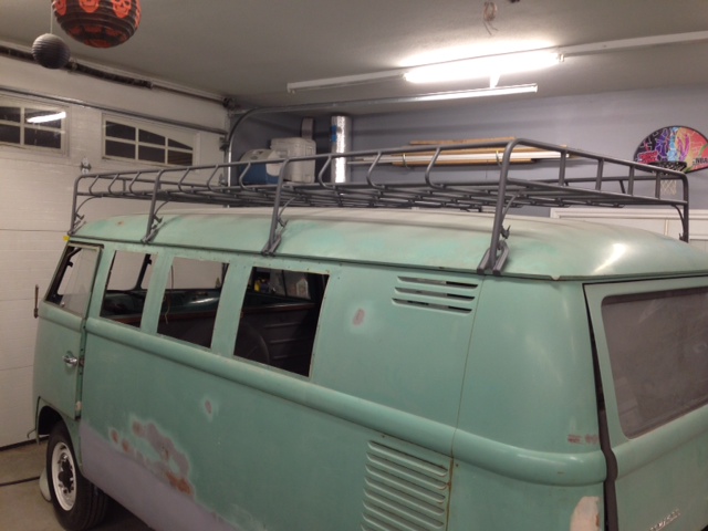

Rack finally done.
Grinded Welds , all 1000 of them and primed and painted.
Re: CampmobileCraig
You mean Kirk didn't grind his own welds?CraigOnTheBoat wrote:Rack finally done.
It looks awesome!
