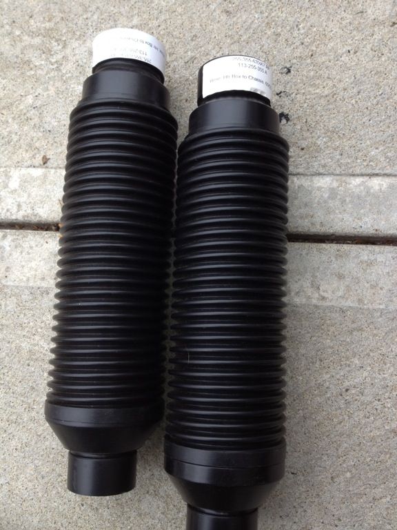

Bill Webner was kind enough to score me a set of 60mm to 50mm tubes for my '59.

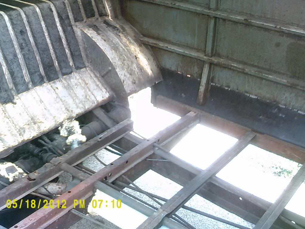

Started out by repairing the area behind the drivers seat
before:
now

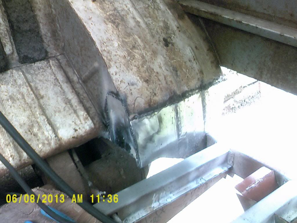

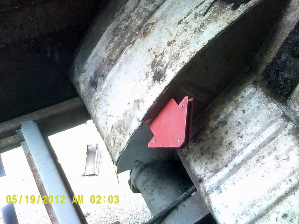

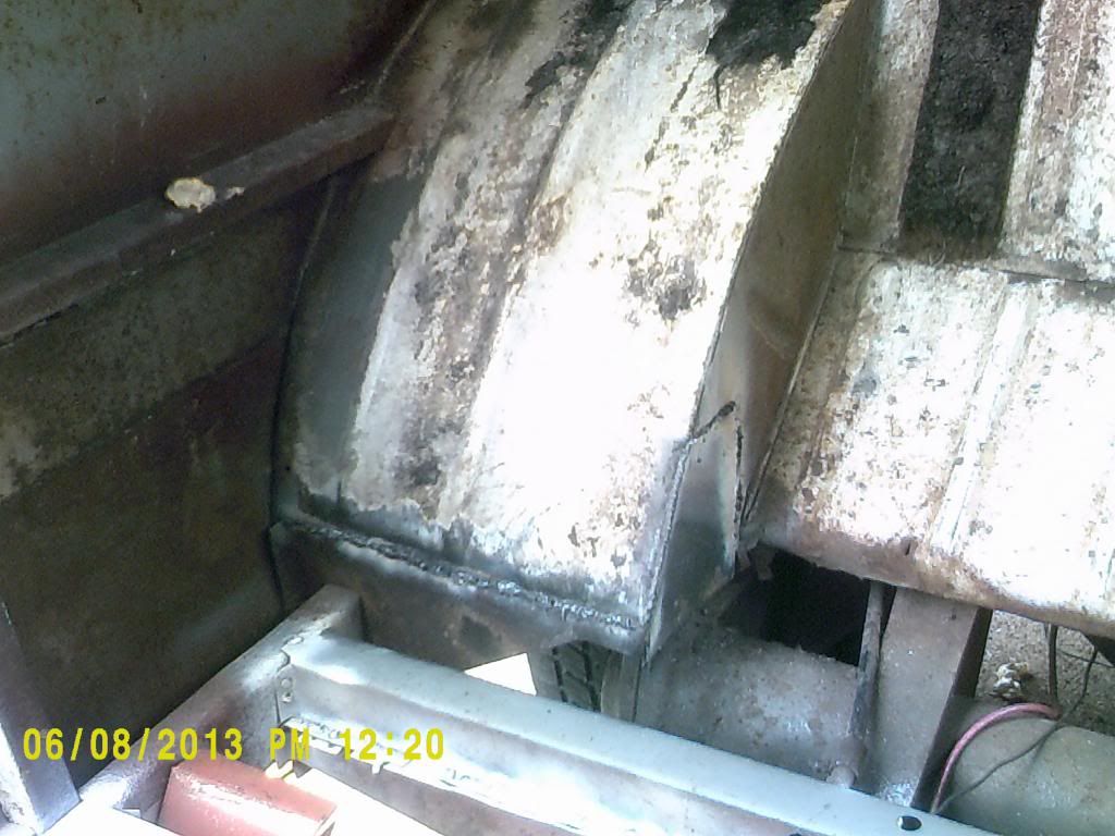

Next I moved on to the wheel wells
before:
now:
Before:
now:

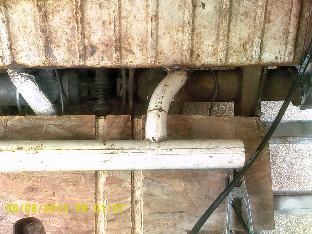

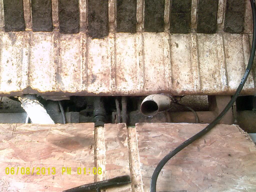

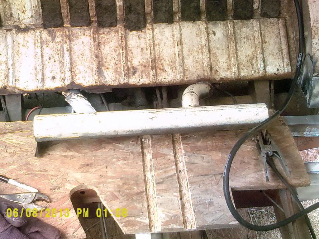

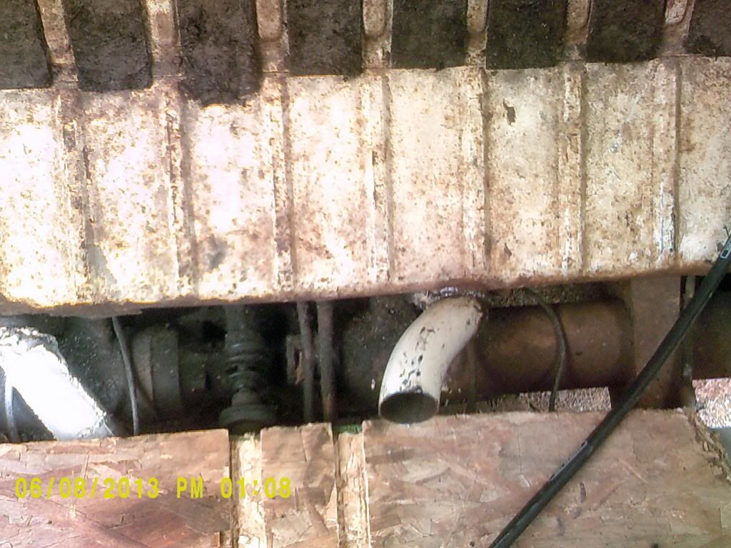

Then with all the helpful info I have received from everyone, I was finally confident enough to move on to heater log
I started by tacking the tube to the log, then using a piece of 3/4" OSB to mock floor height
Then I broke the tack, and installed just the tube, so I can get the floor in, then I will attach tube to log.
Well, it took me a little over a week to get from this pile of parts, to where I am now
Other than replacing PVC tube with metal tube, I think I am ready for floor now, I don't have it yet, but soon. I wanted to media blast and POR15 the bottom, and have a question. Once I install floor, it will be almost impossible to get at the top side of torsion bar at the rear end. Would it be beneficial to hit that area up now before floor, and be careful not to strip it later, or is it accessible enough with floor in place?

Re: 1961 Microbus
Nice job.
If you're fussy about the top of the torsion tube you could hit it now. It's pretty hard to get at it with the floor in.......

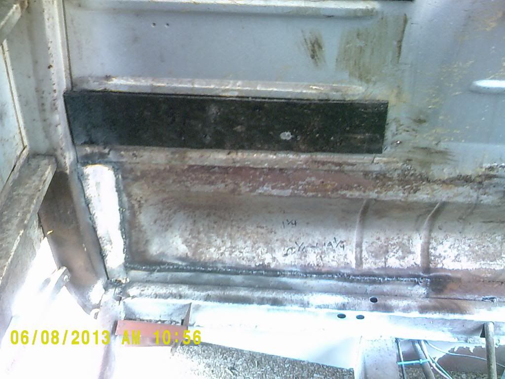

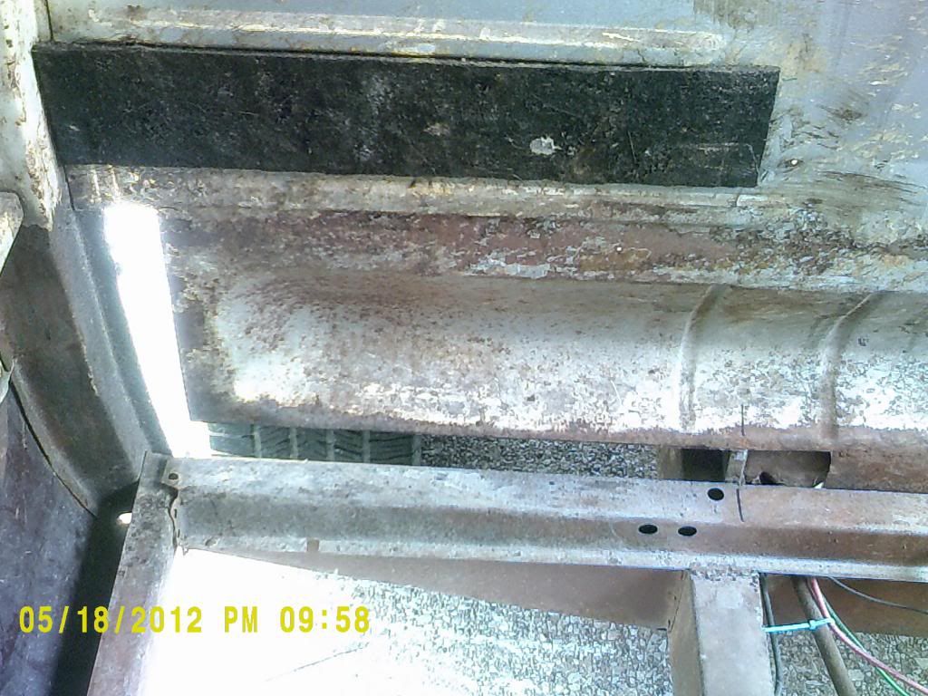

Spent an hour yesterday getting the long rocker set and welded. If you look at the earlier pics you can see where there was a big crease at the rocker, the crease is gone, and it is probably more solid than original
The only area that I was a bit unhappy with is at tge bottom rear. The stiffener and bottom lip on rocker were off by almost an 1/8". If I aligned them the contour was all wrong. In the end I went with the contour being right, and will address the rails at body prep.
I left the repair piece I made off (rocker was too short) and will wait till I do front dog leg before fitting it in.
