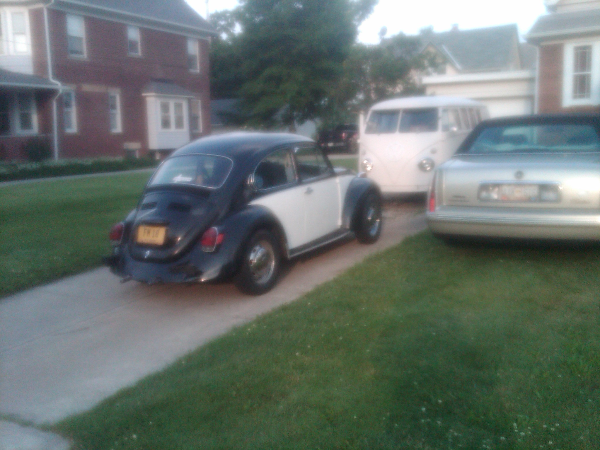

Not much to report, been spending most of the week doing little things on Kitty Malone AKA Ratty Dredd AKA 1302s AKA the 71 super. I replaced the control arm bushings, and stabilizer arm bushings last weekend, still have to replace idler arm bushing, steering dampner, tie rod arm ends, ball joints, then get new tires mounted and balanced, then a front end alignment. Hopefully after that the shimmy will be gone.
Still need a German Made camber. Bolt. Found a chinese knock off and a poor condition OEM on ebay, but don't want to go that route unless I have to

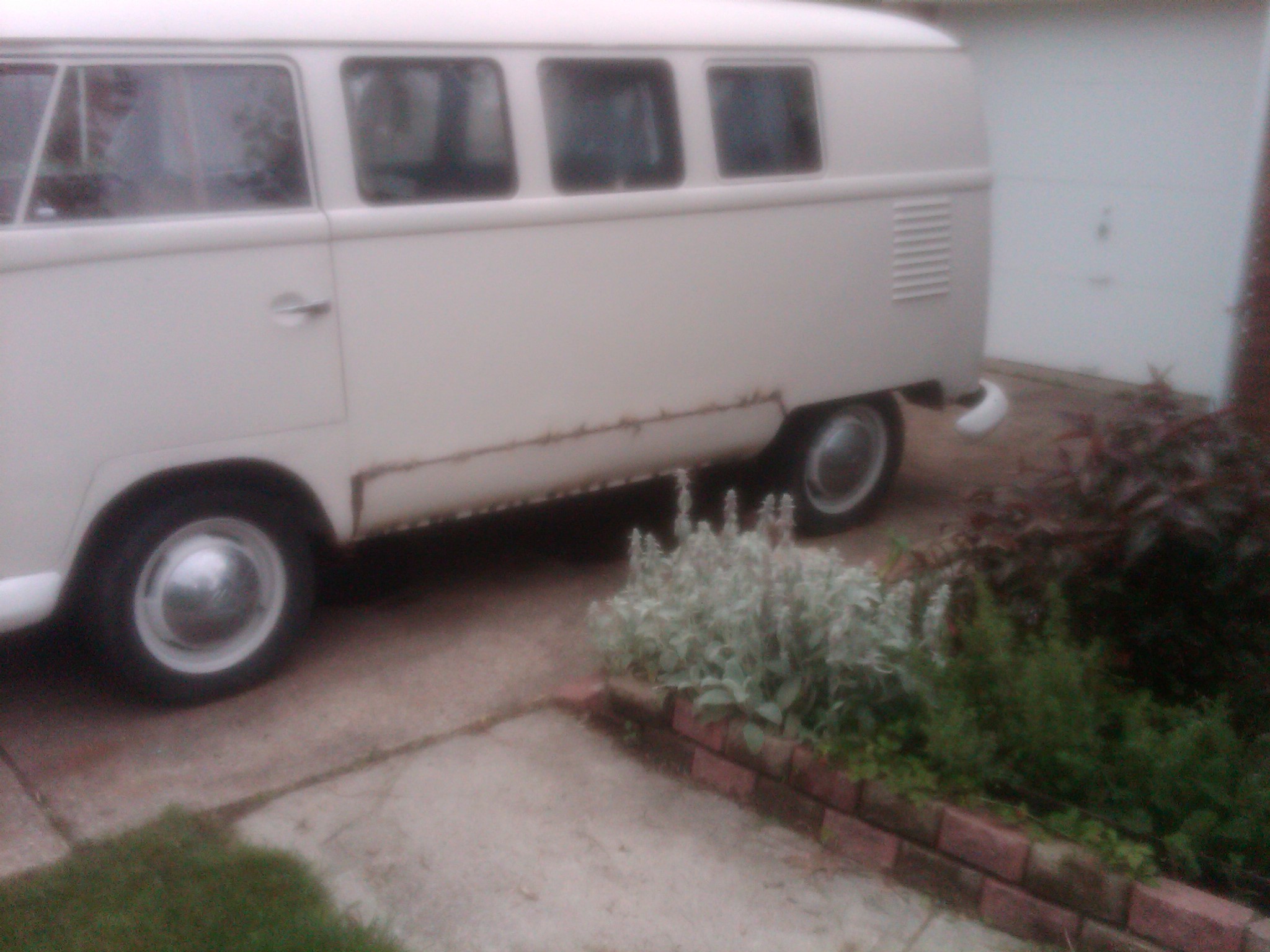

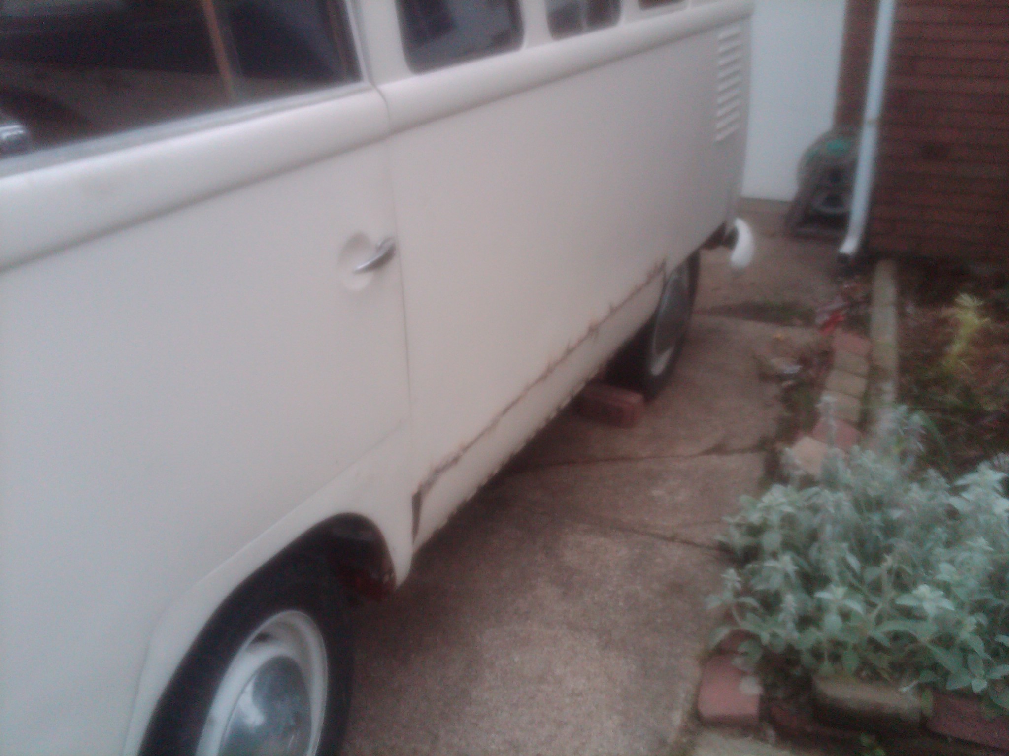

Spent an hour yesterday getting the long rocker set and welded. If you look at the earlier pics you can see where there was a big crease at the rocker, the crease is gone, and it is probably more solid than original
The only area that I was a bit unhappy with is at tge bottom rear. The stiffener and bottom lip on rocker were off by almost an 1/8". If I aligned them the contour was all wrong. In the end I went with the contour being right, and will address the rails at body prep.
I left the repair piece I made off (rocker was too short) and will wait till I do front dog leg before fitting it in.
