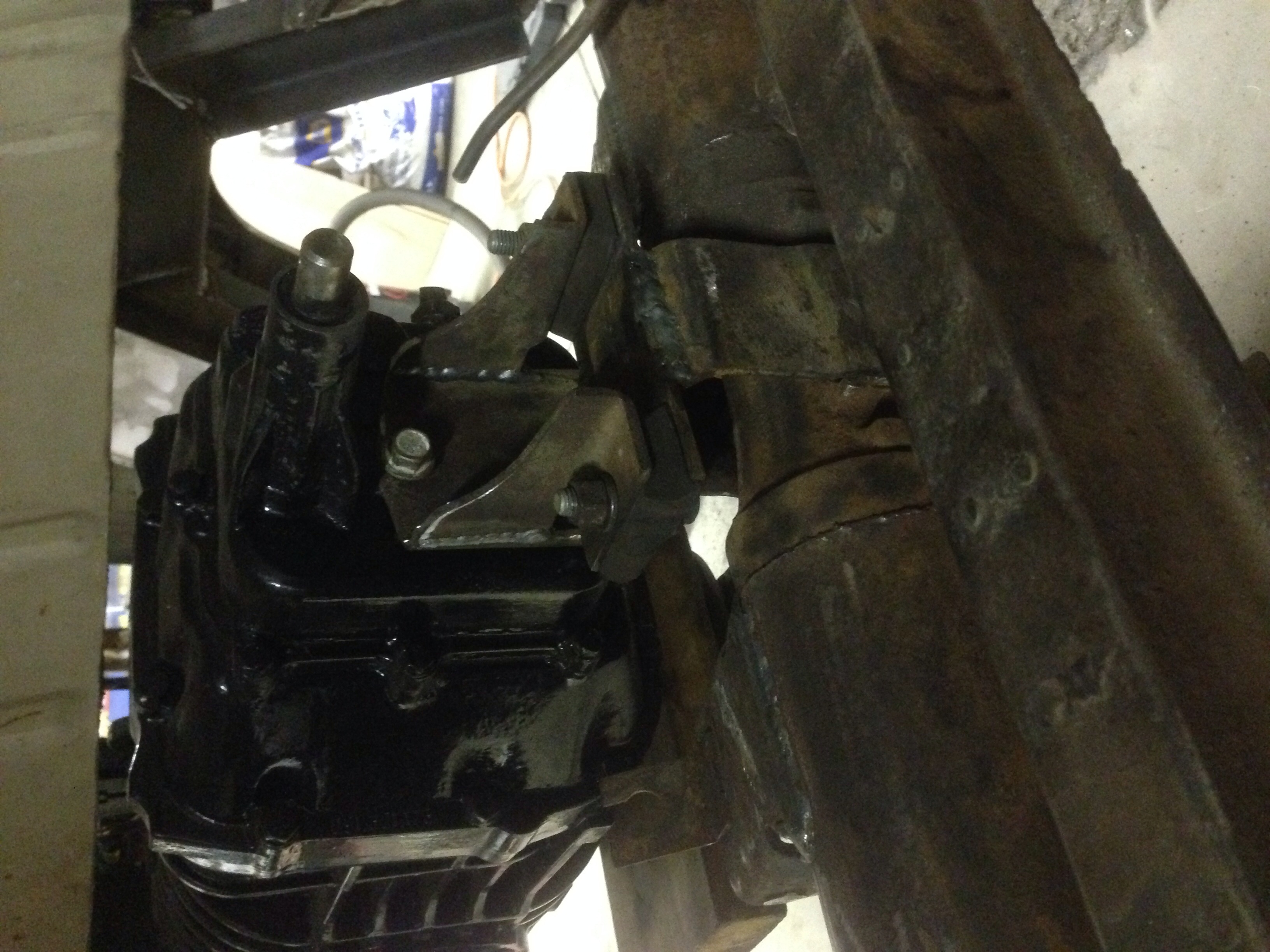

In order to be able to frame drag i had to raise the engine and transmission up 5" from their stock location. So i used the stock transaxle mounting bracket and cut it up and modified it. Basically i flipped it so that it mounts on top of the torsion tube instead of below the tube. It took alot of measuring to figure it all out, but the transaxle now sits 5" higher then it once did.
Re: 1971 Early Bay Panel
I edited that pic and previewed post^^ after i submitted the post it flipped it. It doesn't do this on any other site. Im sorry for the viewing inconvience...

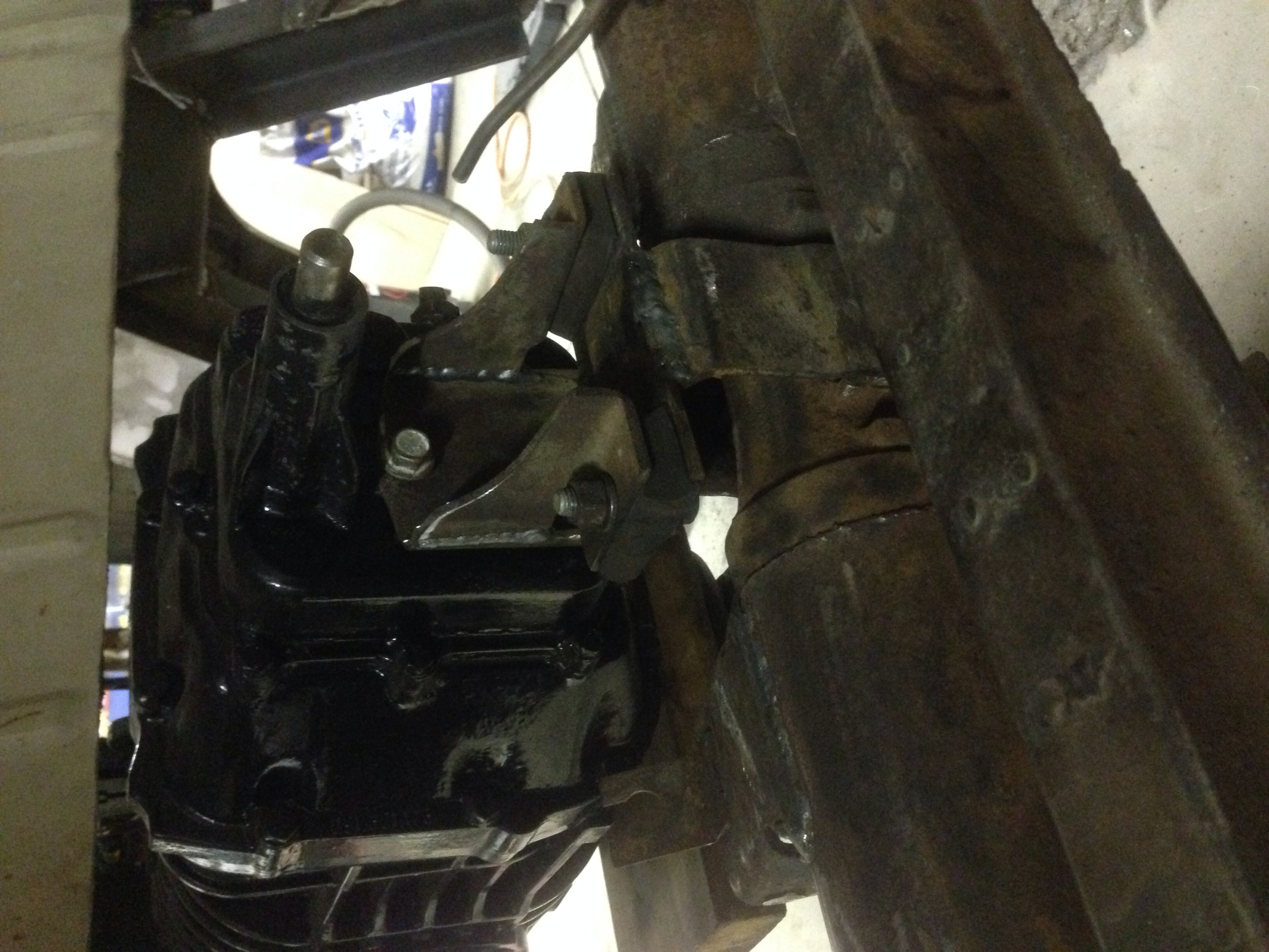

Heres a look at the engine and trans mock up. If you look closely you can see they sit above the torsion tube now. I fabricated custom mustache bar hangers and i had to cut and modifiy the bar itself.

Busjunky wrote:I edited that pic and previewed post^^ after i submitted the post it flipped it. It doesn't do this on any other site. Im sorry for the viewing inconvience...
If you click on it it should rotate and enlarge. It does for me.
