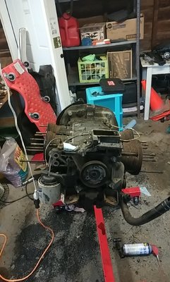

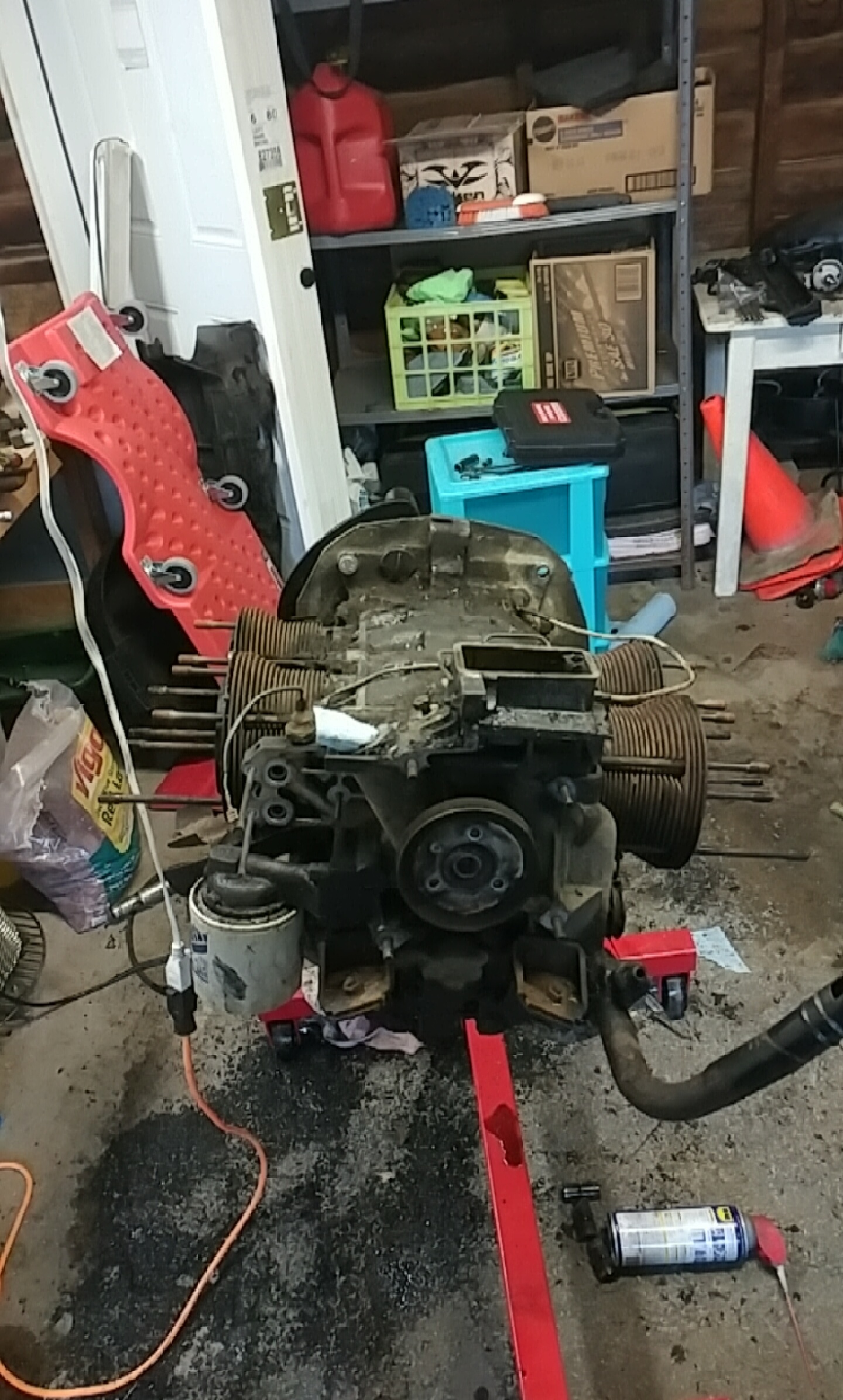

Todays progress.
Also pulled the liners off.
Looks like you have an AC pulley on the end of the crank. I have the correct spacer to replace that if you need when the time comes. Also,you will have to get the fan hub off. It is a tapered press fit. You can use 3 pieces of 3/16 flat stock fitted behind the hub and slowly crank in 3,8mm bolts against the flat stock and the hub will pop off. Alternated turning the bolts a little at a time. Stand to the side while doing this.
