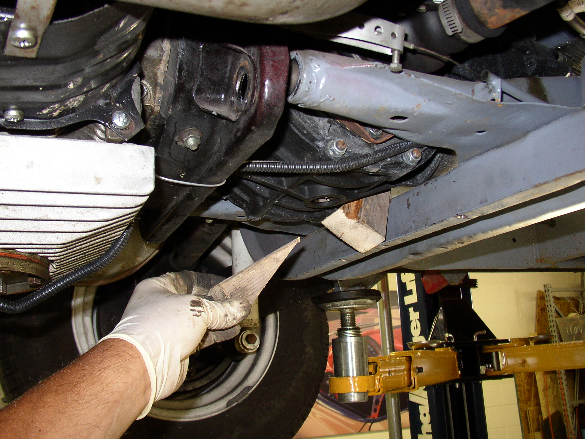

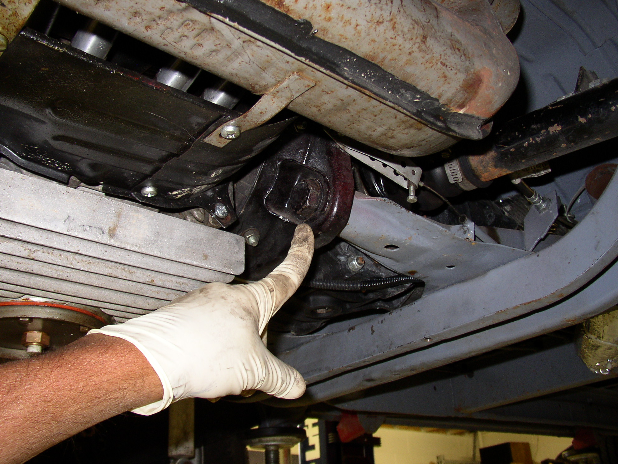

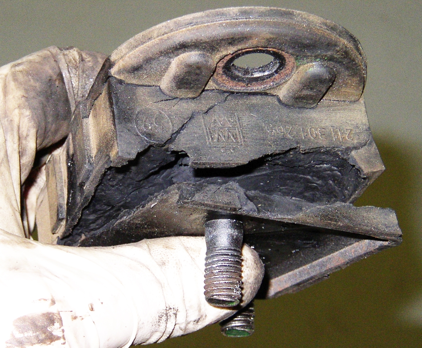

This happened a few weeks ago but I'm just getting around to posting it. I noticed while driving that my shift knob would move around when I accelerated/decelerated. I knew right away this is a broken trans mount.

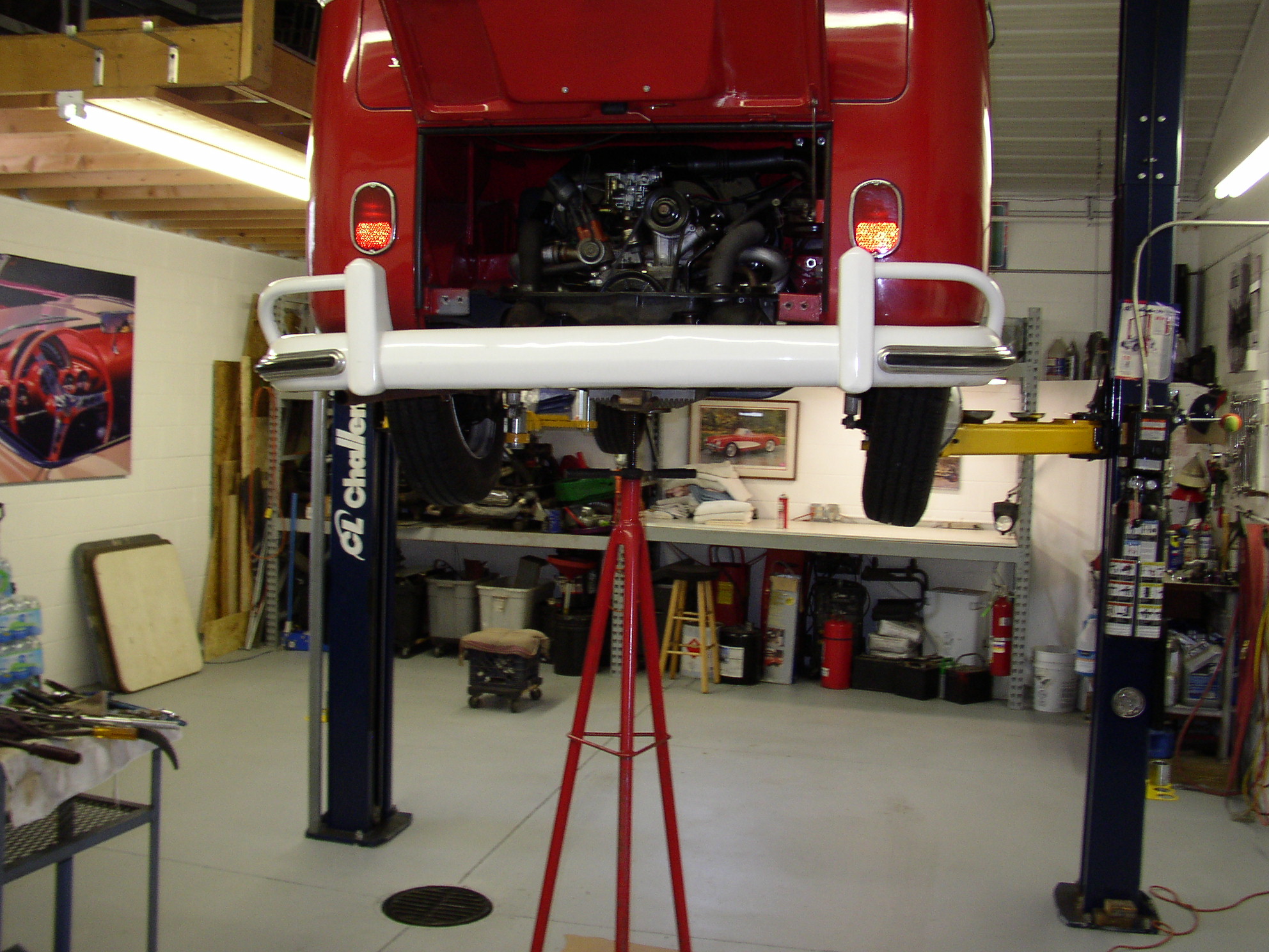

Rack it, remove the valance, and remove the left bumper bolts so when the engine shifts back it won't hit the muffler.

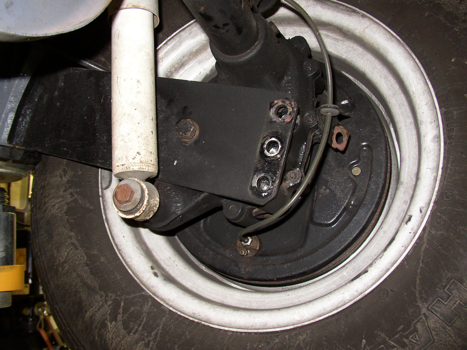

Disconnect the shifter and pull the two big bolts from the horseshoe cradle.
Pull most of the RGB bolts out to loosen the powertrain. Disconnect the throttle cable and loosen up the clutch adjustment all of the way to the end.
You must be aware of what you're doing! The entire engine/trans is now loose and not held into the bus. Keep in mind things like weight balance on the lift arms and what is holding up the powertrain. ;)

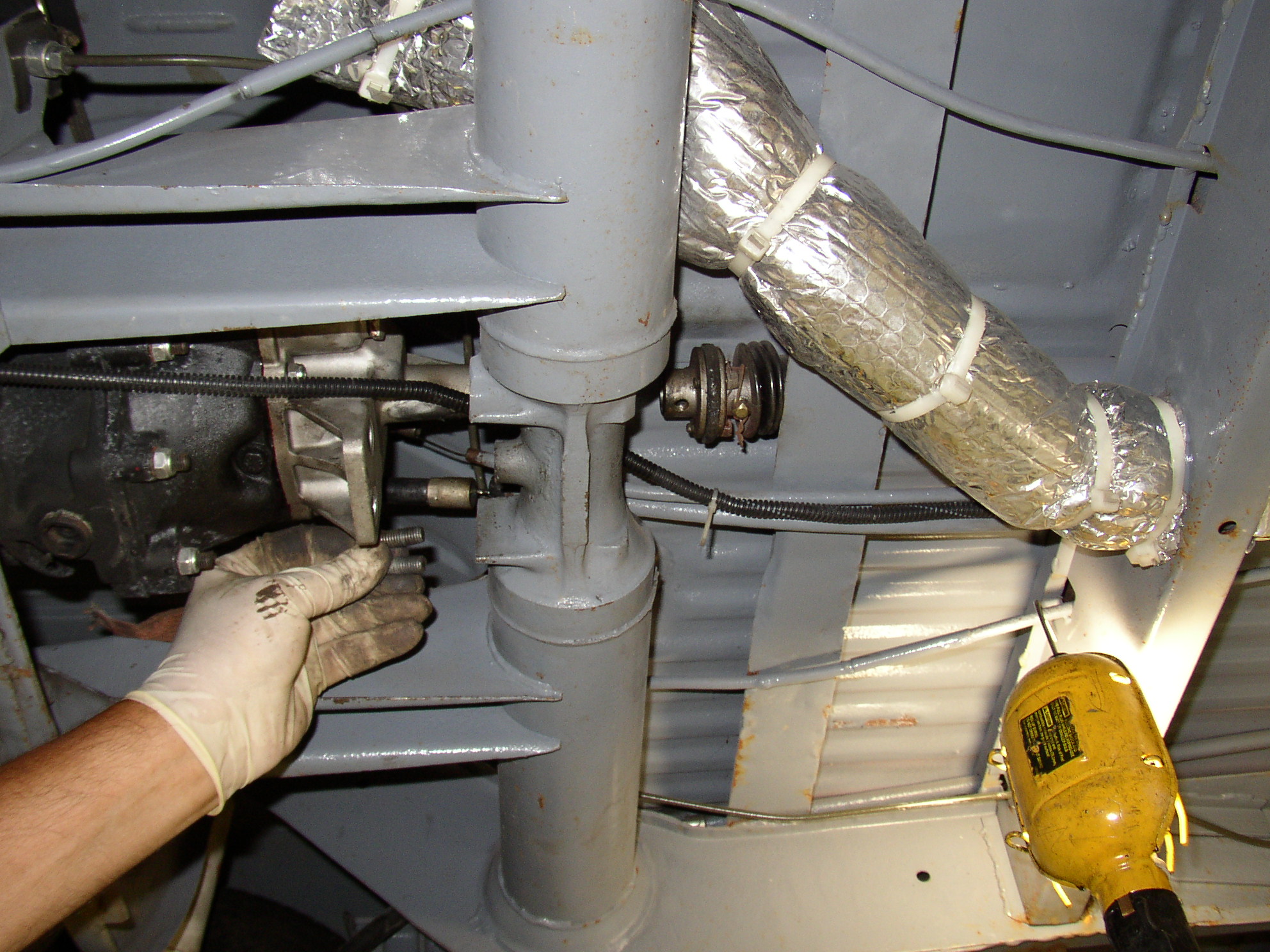

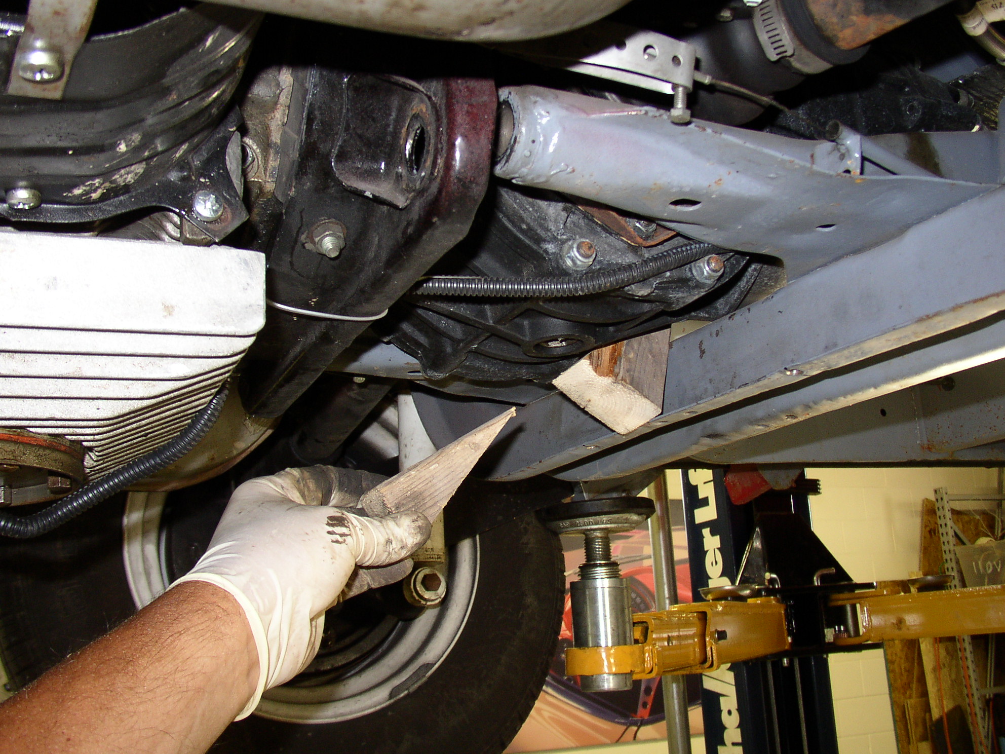

I used a couple of wooden wedges to bring the powertrain rearward so I had access to the trans mount.

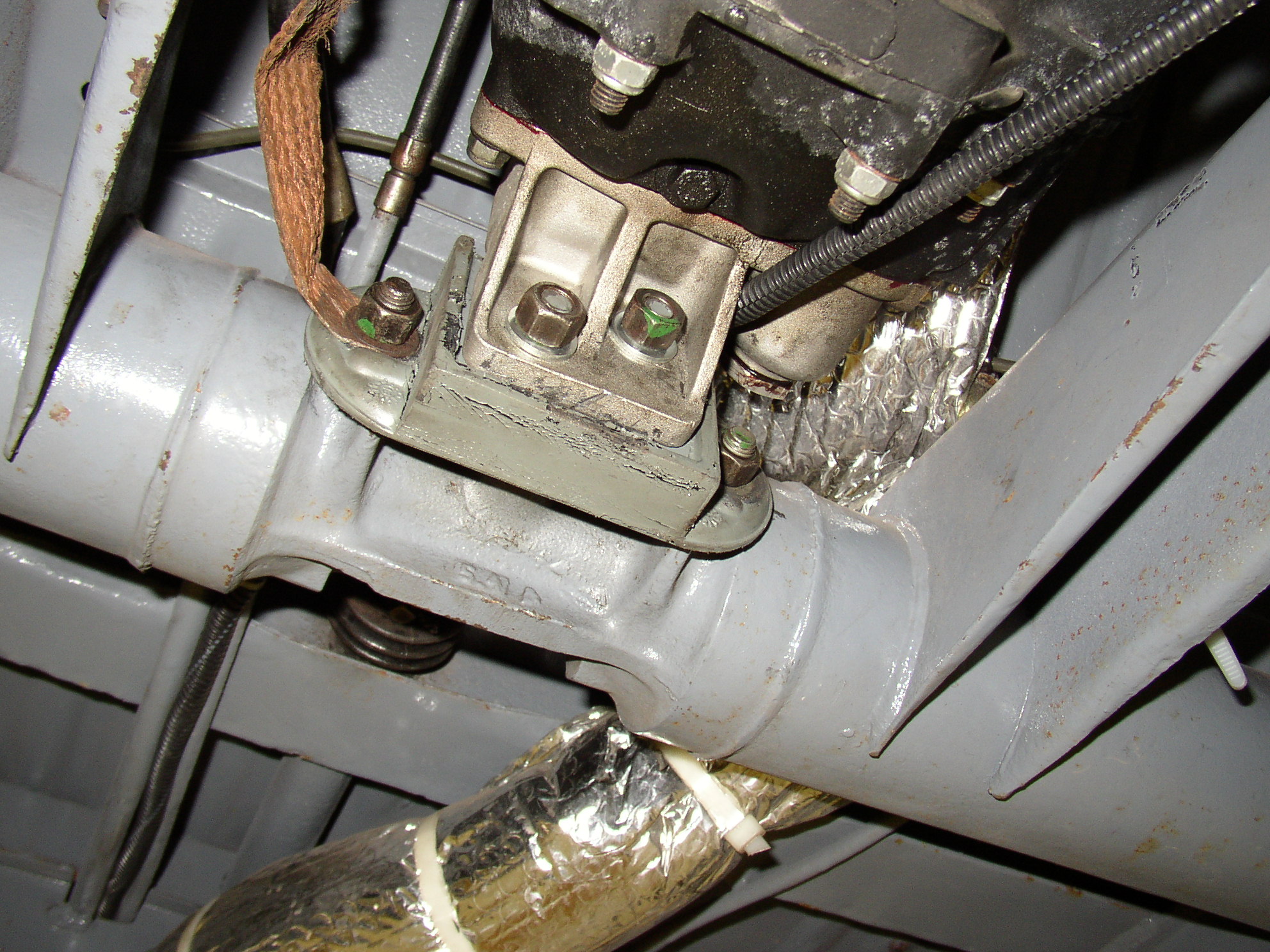

Remove the mount nuts. It's tight in there, tight enough that there's not enough room to get the mount out without removing the studs too. Luckily I had sandblasted and thread chased the stud holes so they came right out for clearance.

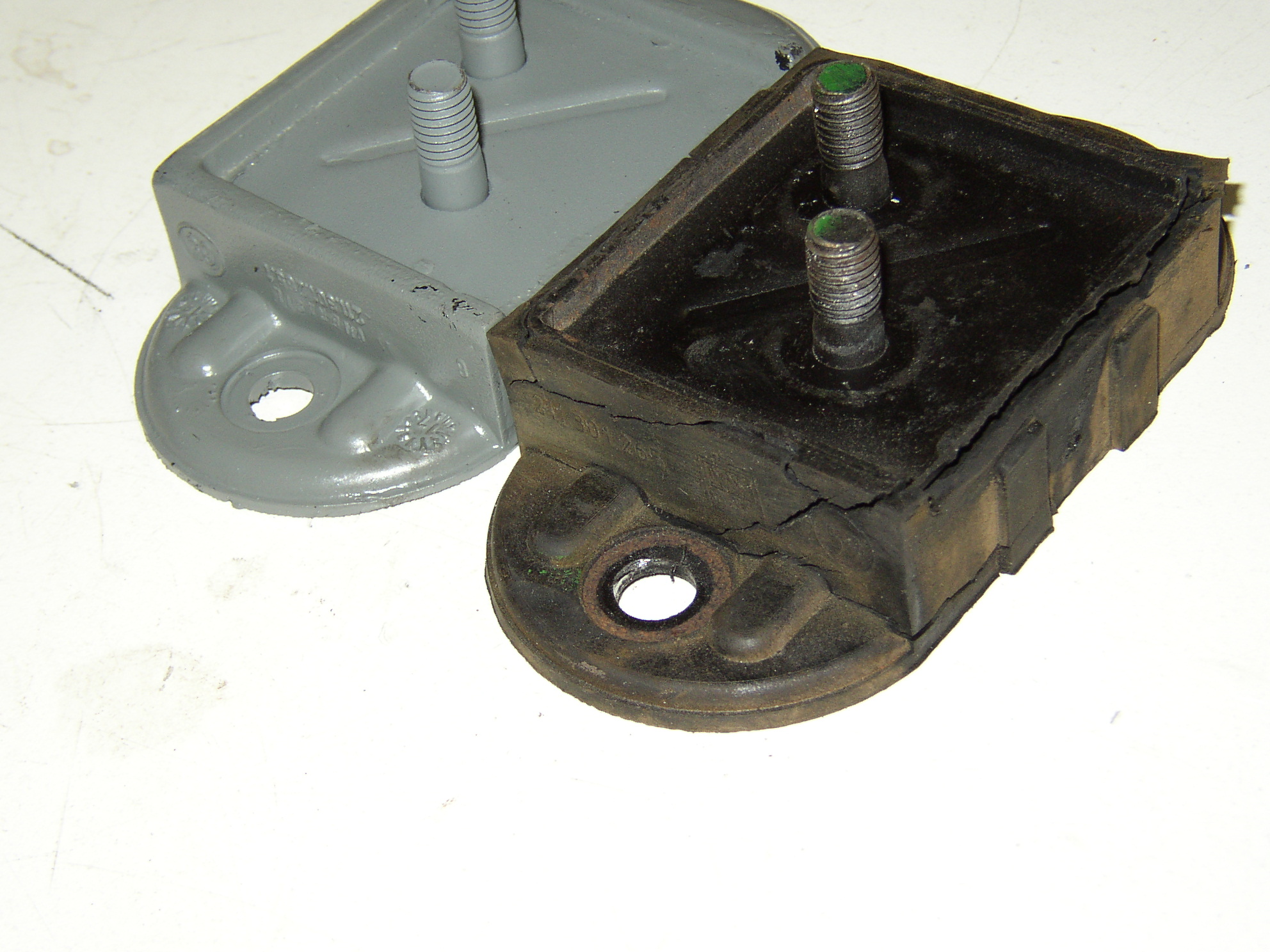

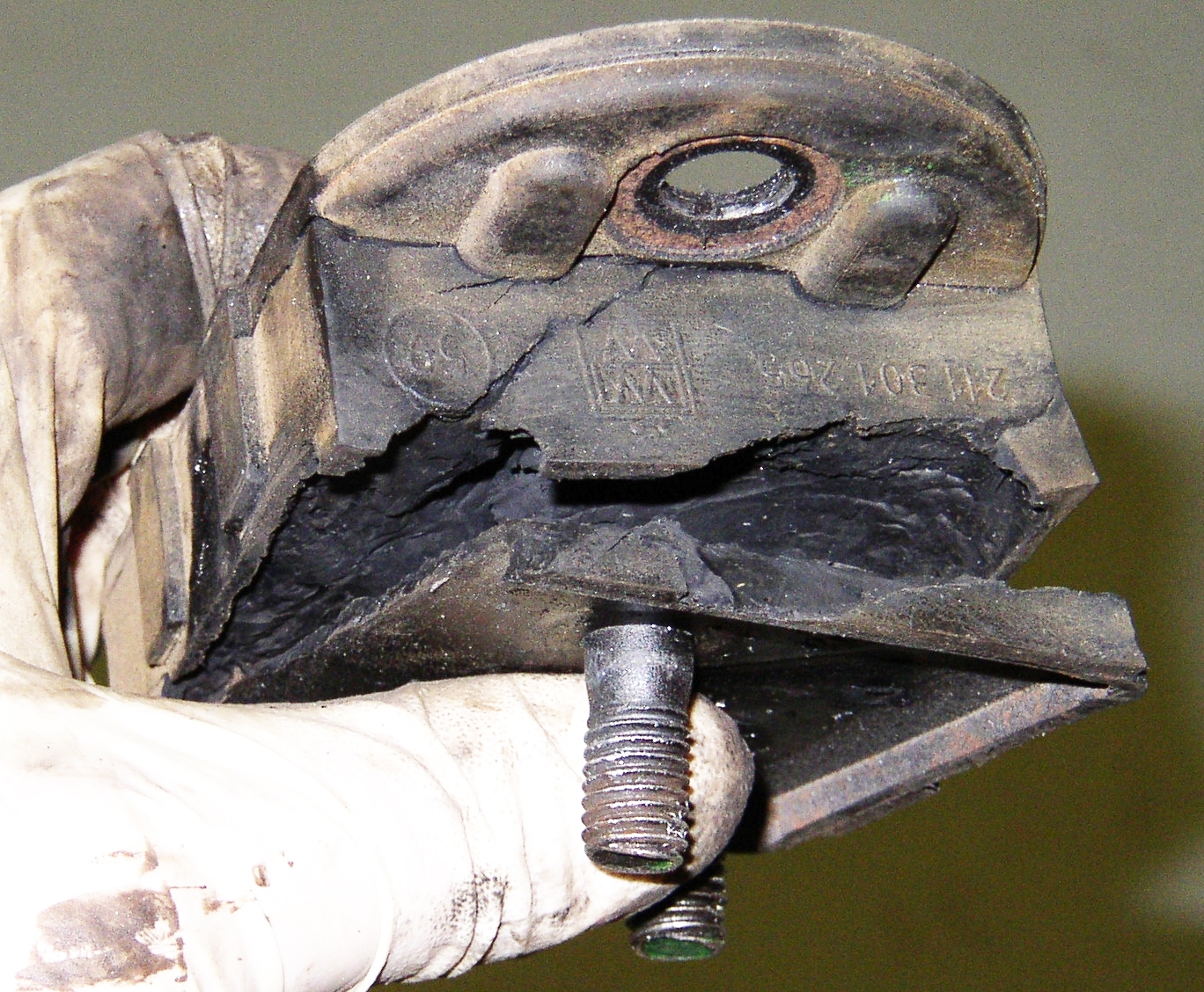

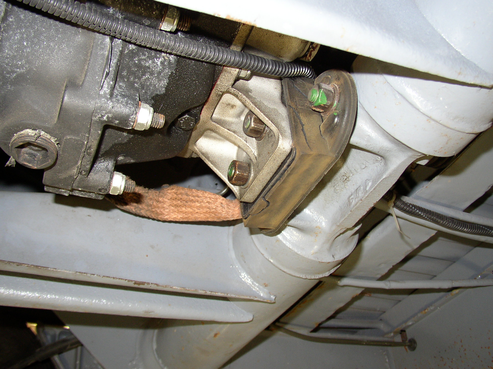

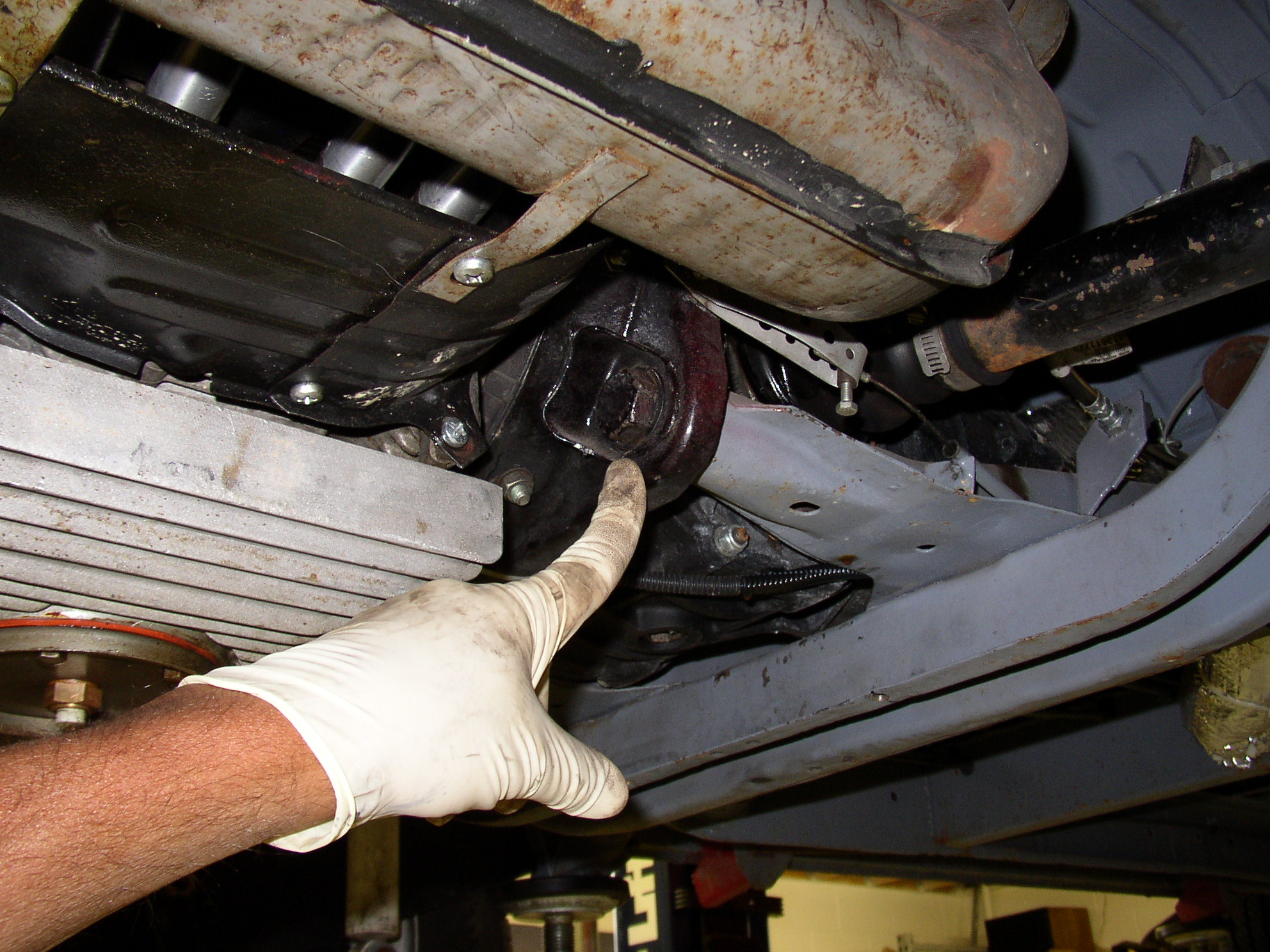

Yep, it's broken, a WW mount I put in new 5 years and 11,000 miles ago.

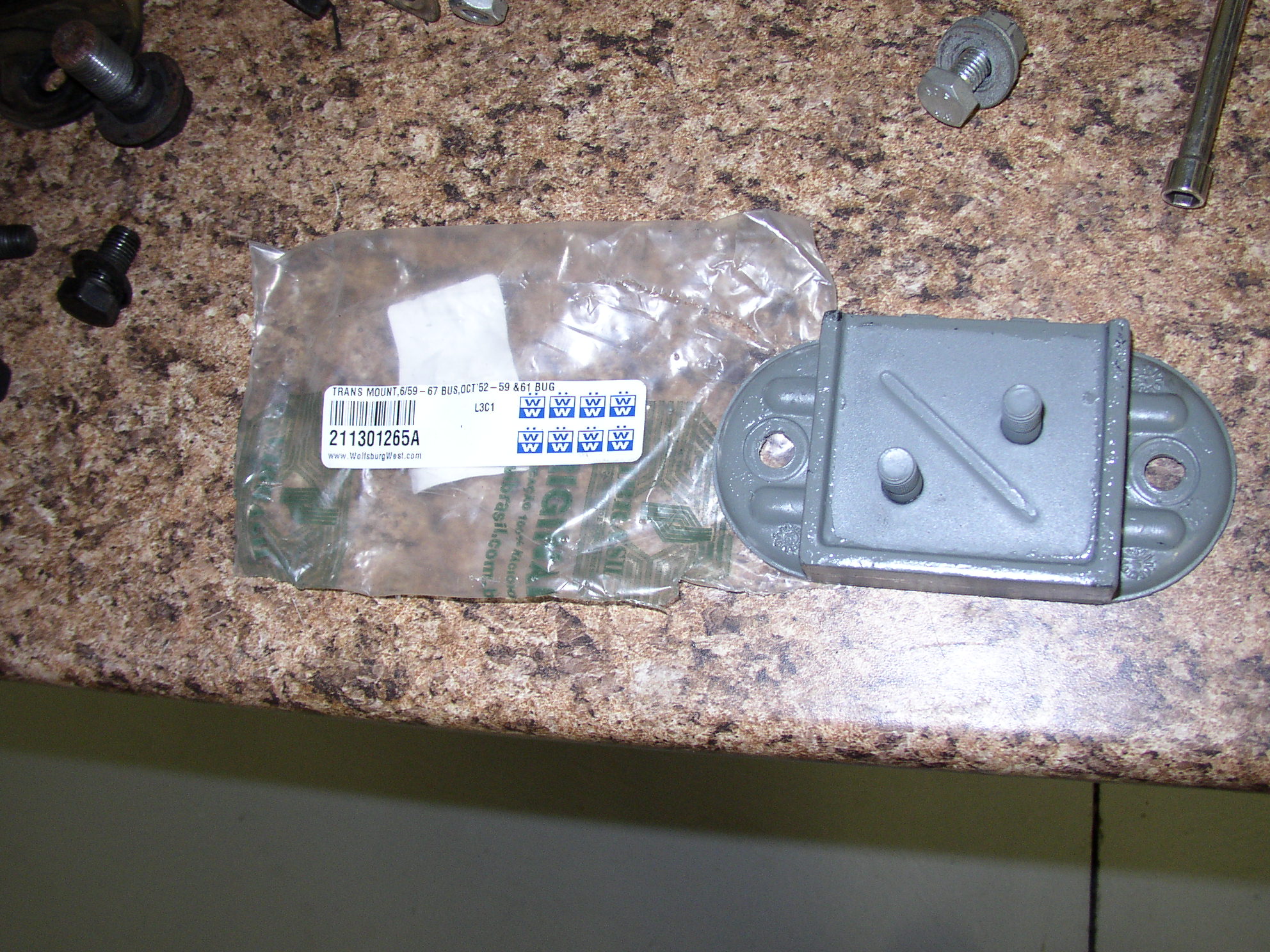

Fortunately I stock these, it happens to be a WW mount but it looks like WW changed their supplier. It no longer has their logo on the side and it's a gray one from Brazil. The Samba gang seems to think the gray ones are better. :roll:
This is a PITA job on the lift, I wouldn't even think about doing it on the ground. Maybe if I was younger and more flexible, but that was a long time ago...….

Install it with the open side "up" like a coffee cup. Shit won't work right if it's upside down and plenty of guys have done that. The two center nuts have limited clearance, usually they're 17mm hex (10x1.5 thread). Cylinder head nuts are 15mm hex and give you more working room.

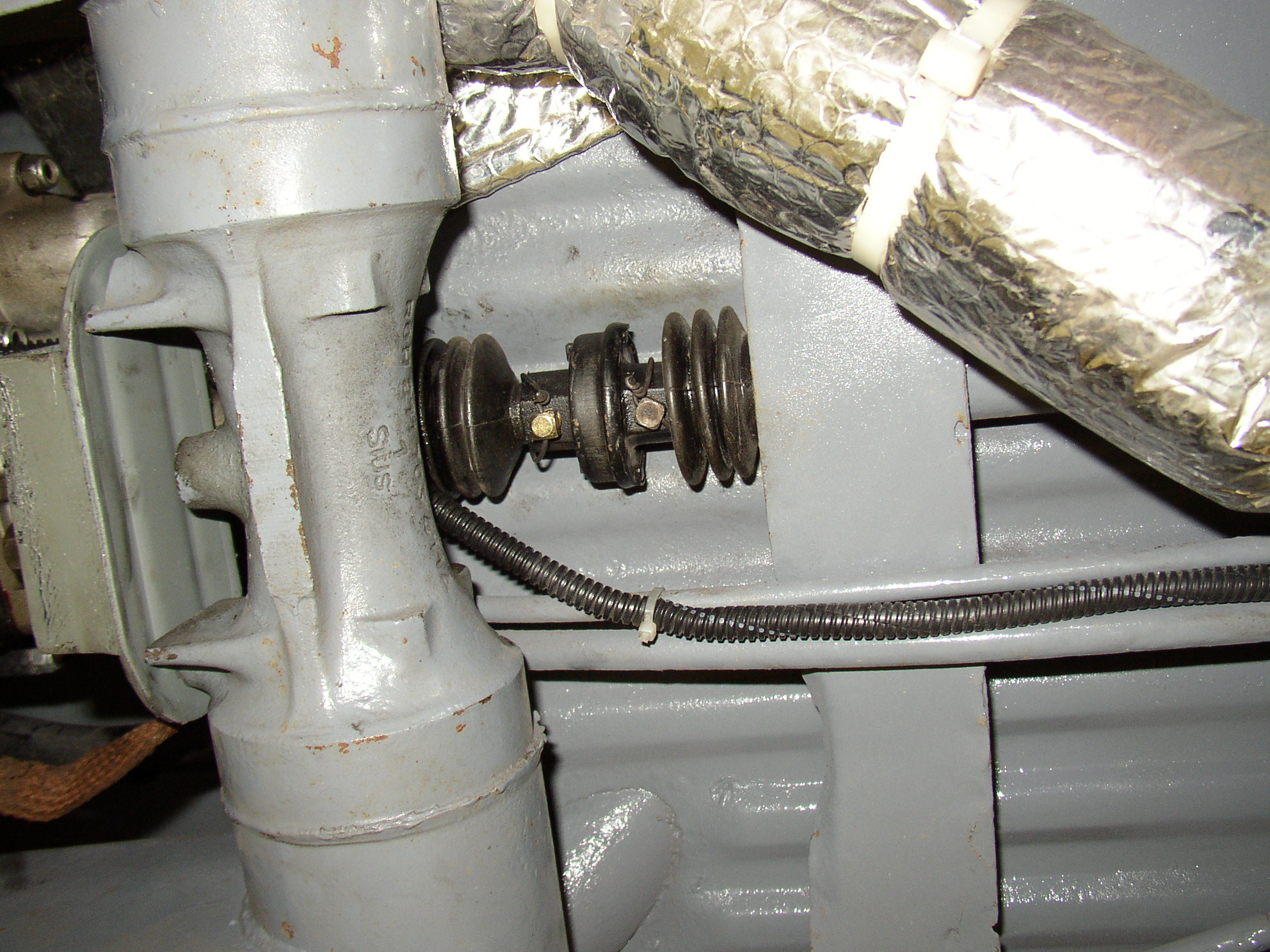

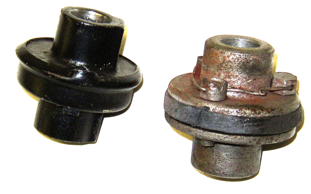

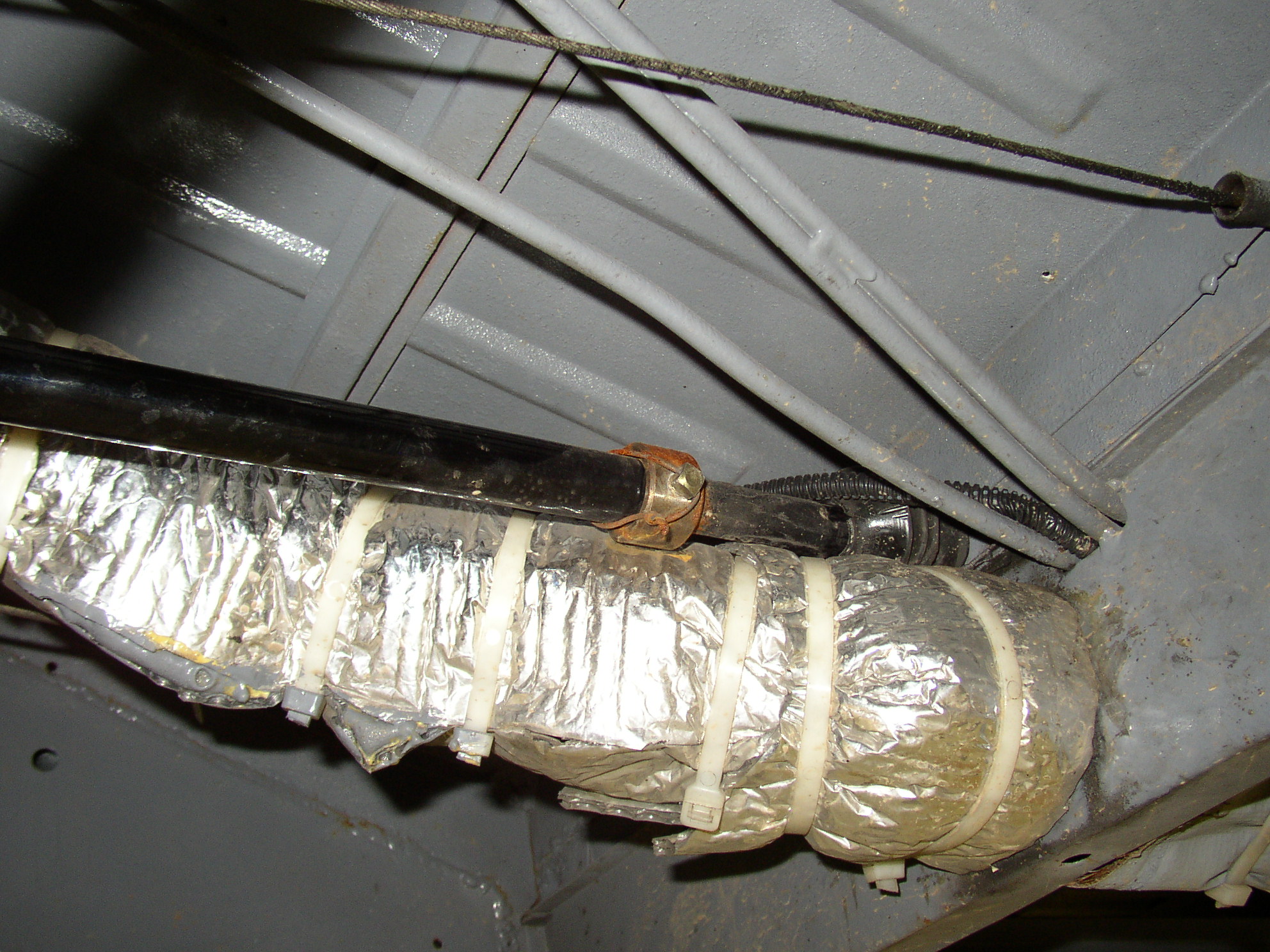

My coupler was also a bit tired so I changed that out too.
The coupler didn't look "turned" but evidently it was. I needed to turn my front coupler a few degrees to get the shift pattern in the right place and R working correctly. Don't forget the safety wire. :mrgreen:

I'm glad we have aftermarket parts to source, but it sure is no fun when they only last 5 years and 11,000 miles. I'd pay 10X what that mount cost for a lifetime (100,000 miles) of service.

Dual Port wrote: Wed Aug 21, 2019 11:05 am Yep, it's broken, a WW mount I put in new 5 years and 11,000 miles ago.P7240094a.jpg
I'm sure you've read about many people pre bolting them together through the rubber to lessen the chance of breaking the nosecone when they give it up.
I have never done it and fully expect to be replacing mine too.

You could also install a Wolfgang mid mount in addition to the stock mounts.
https://www.wolfgangint.com/store/produ ... mid-mount/
