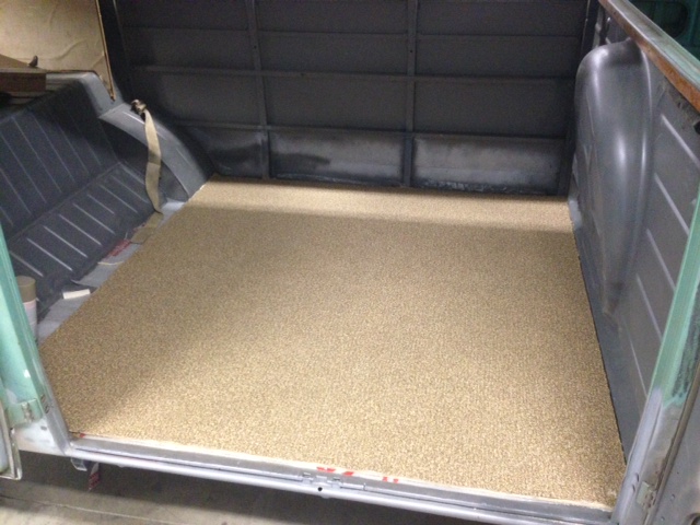

Floor

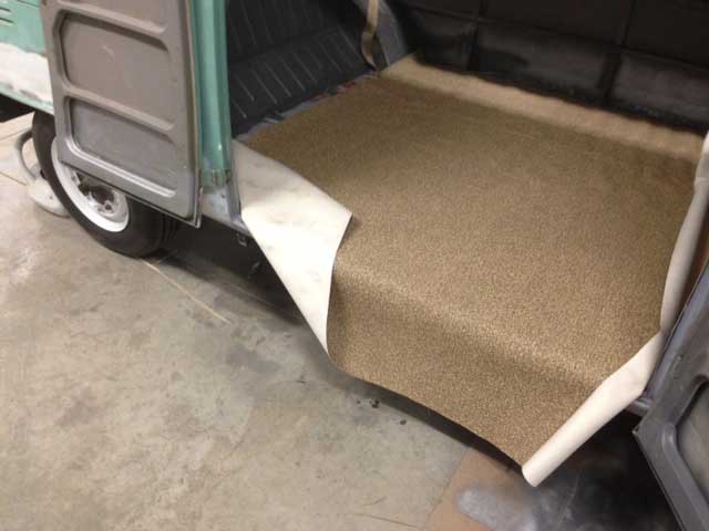

Bus Flooring - Vinyl Marine Grade I got from my neighbor which owns a Marine Canvas Shop that had this scrap left over from a job.

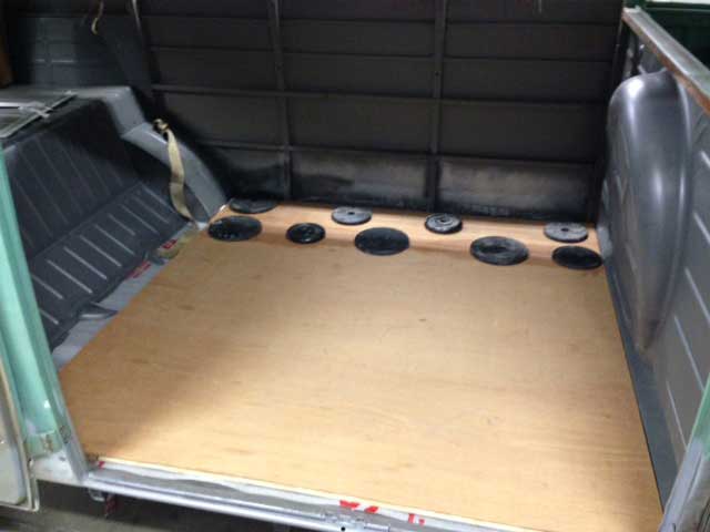

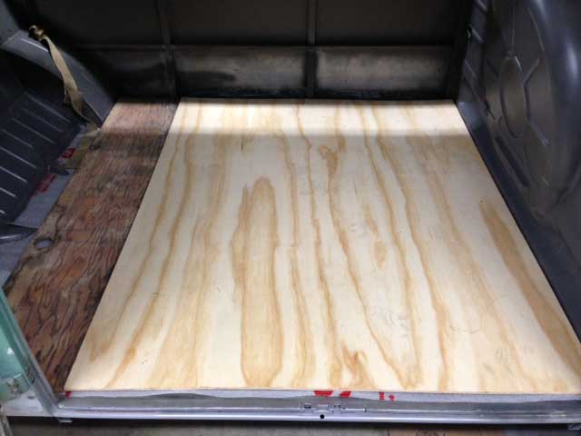

This bus is a USA conversion so the original plywood flooring was 3/8"
I used the same specs so my Wardrobe Cabinet would fit nice and snug. 3/8" Ply cut which comes 4' x 8'. I cut it down to 5' then reused the filler which measures 60" x 12"

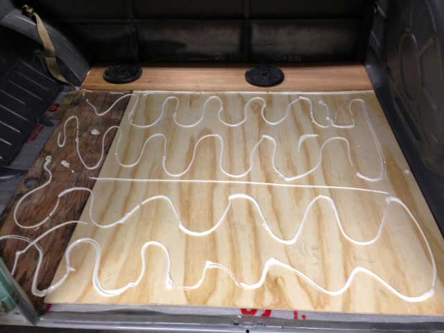

Overlay going the opposite way using 1/4" Luan with the same measurements of the plywood and glue down using Liquid Nails.

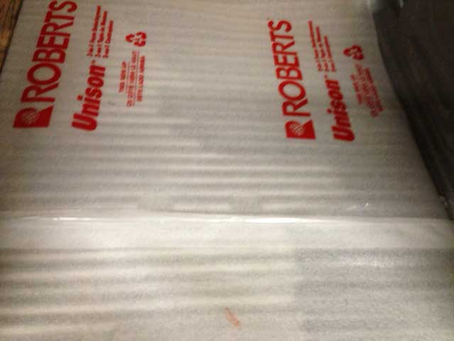

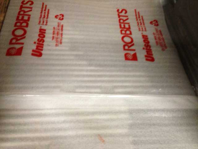

Foam Vapor Barrier
Foam Vapor Barrier
3/8 " Plywood
3/8 " Plywood
Glue Down Luan using Liquid Nails
Let it set overnight
Vinyl Marine Grade Flooring
Floor is floating so it can be removed.

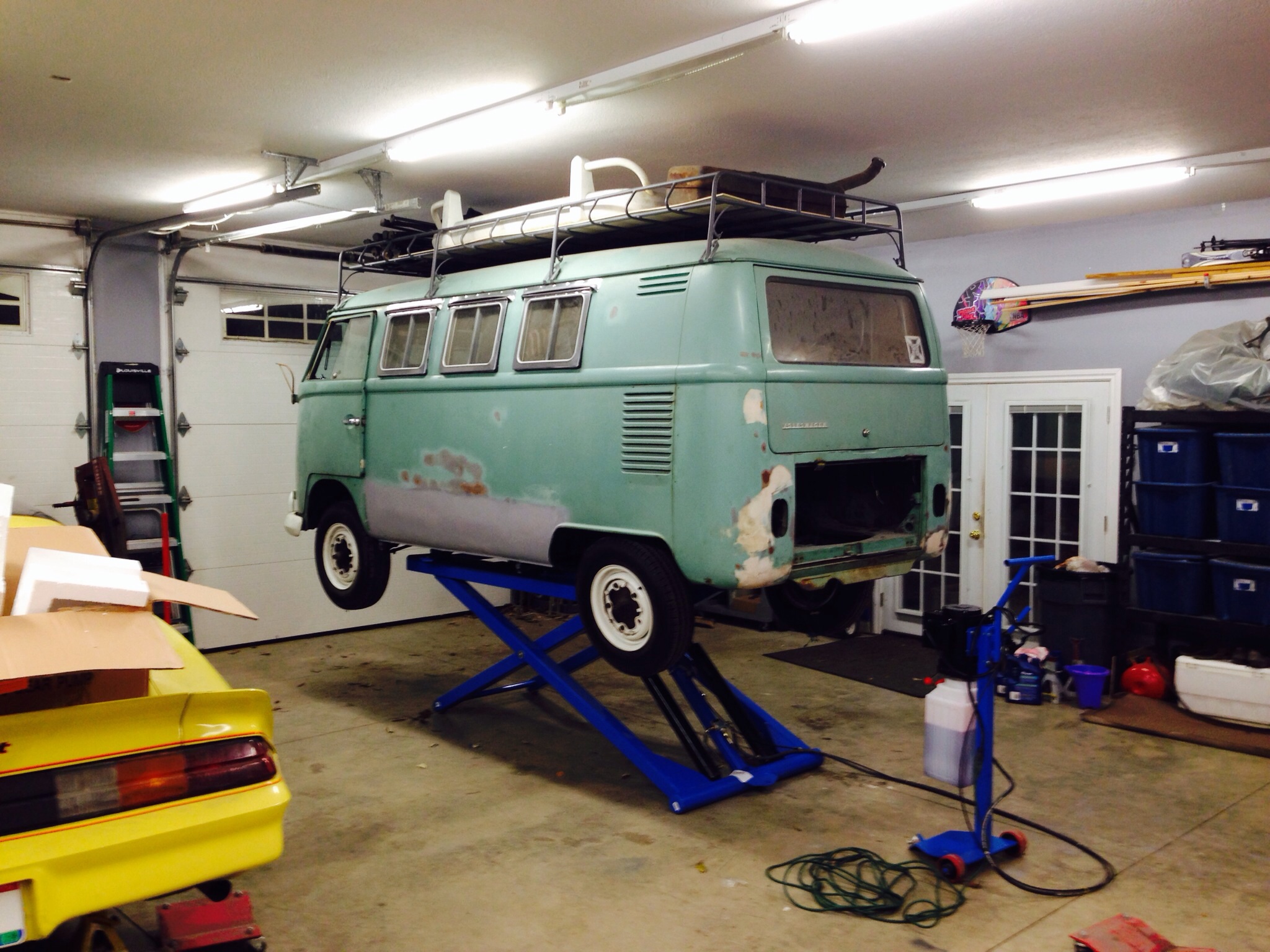

That lift is awesome! :D Why didn't I make my garage taller! :?
Re: CampmobileCraig
you cant hide money!
Nice lil lift for sure!
We'll have to ask Aaron if this puts you in the "car guy" category....
Posts: 911
Re: CampmobileCraig
vw7266 wrote:you cant hide money!
That's just his garage, his wife has her own.
