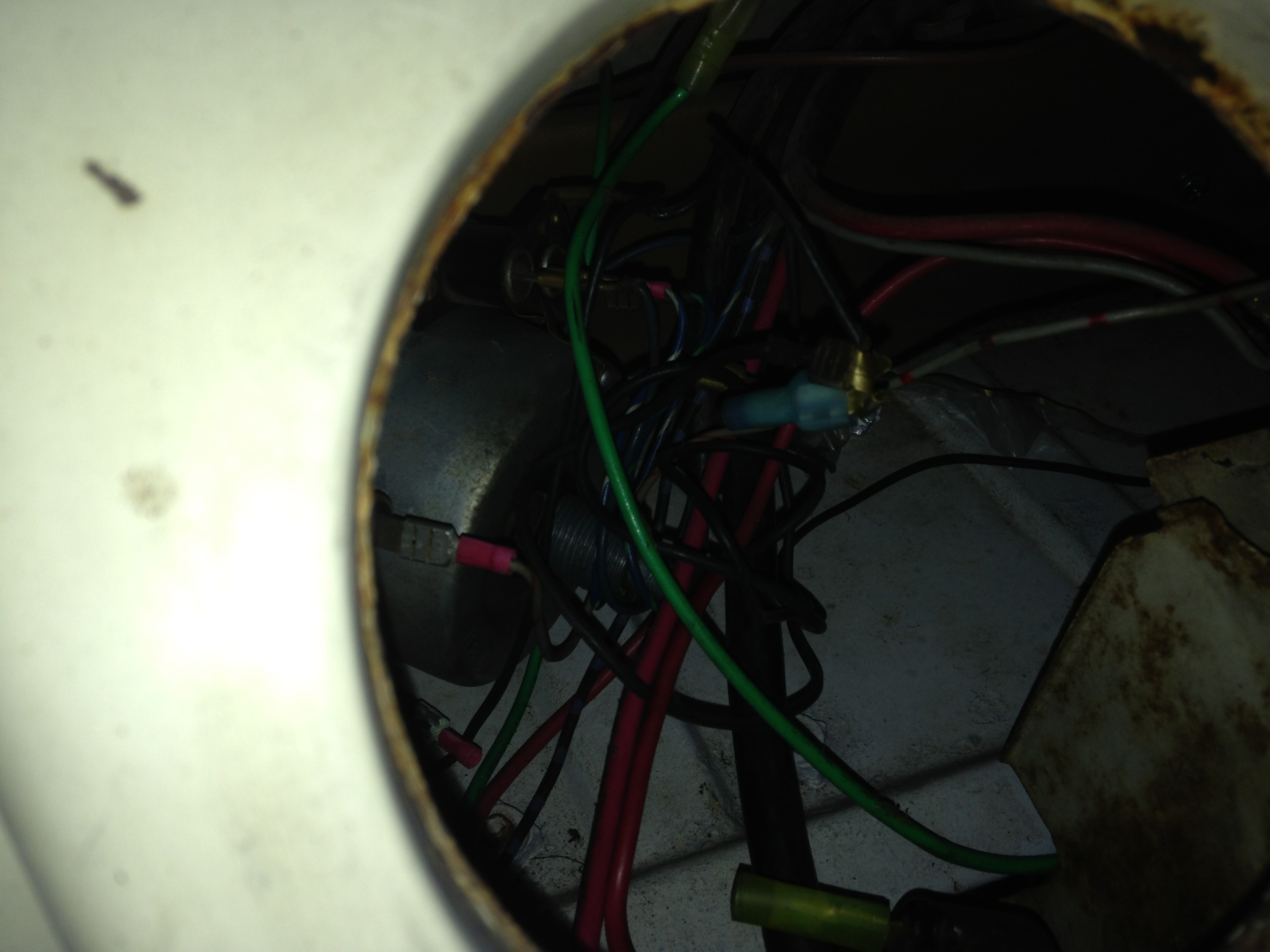

Then i crawled up in the loft to get some spare looms and fuse blocks, so i can get my future use cr@p wired up. I am going to try and stay as true to the original european wiring conventions as i can. The wiring job currently is a disaster. There are wires added in and spliced all over the place. The plan for tomorrow is to bust out the solder gun and get everything back to original, start pulling wire for accessories, add a fuse block and wire terminations, and fab up some holders for the new relays, pump, regulator, etc.

no pictures, and nothing major to report. Spent most of the day chasing down wires and doing continuity tests. I have the wiring back to about 90% original, still some things left to sort out in the cab with lights, switches, and gages, but everything ignition wise and back is good to go.
