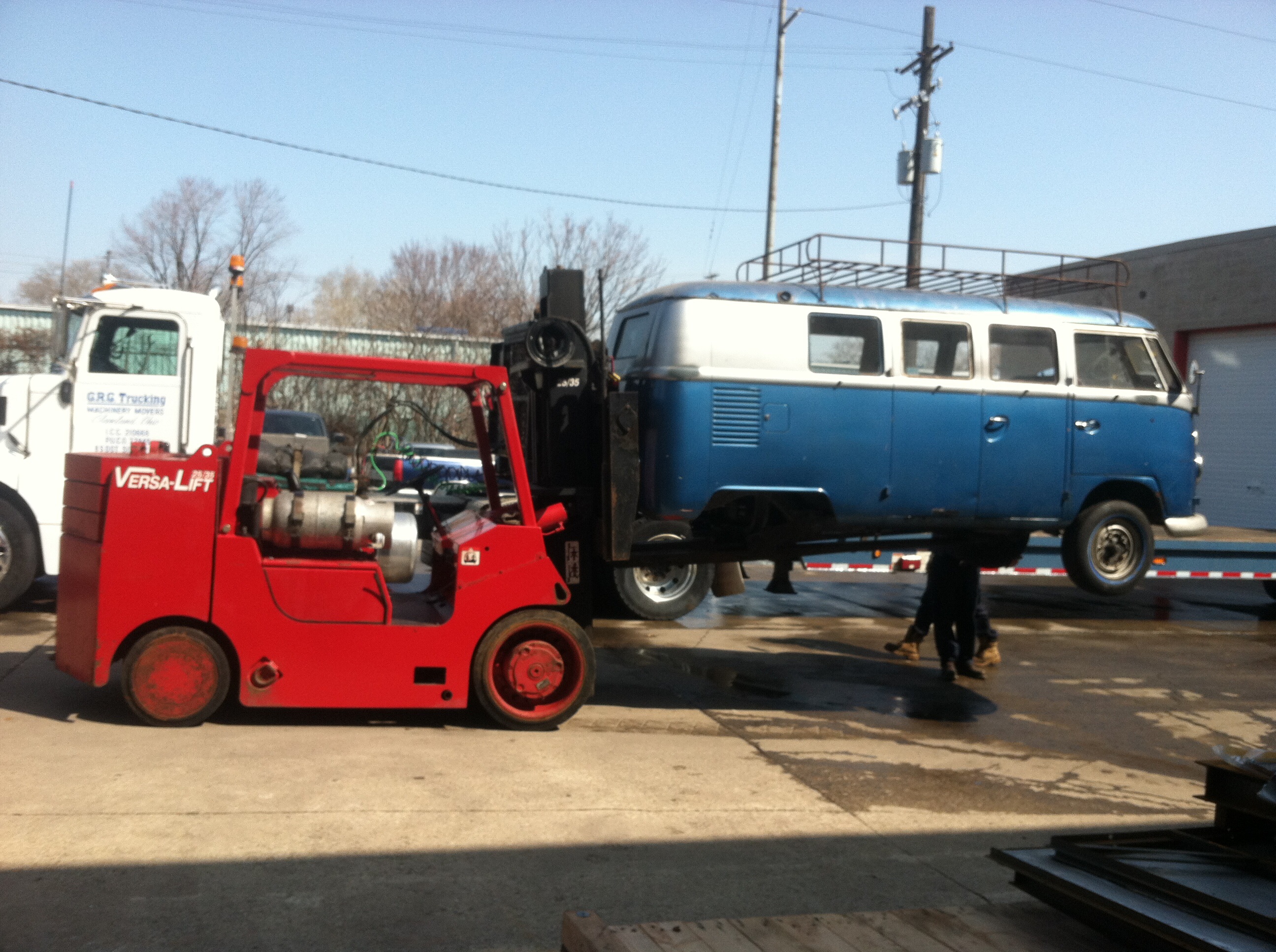

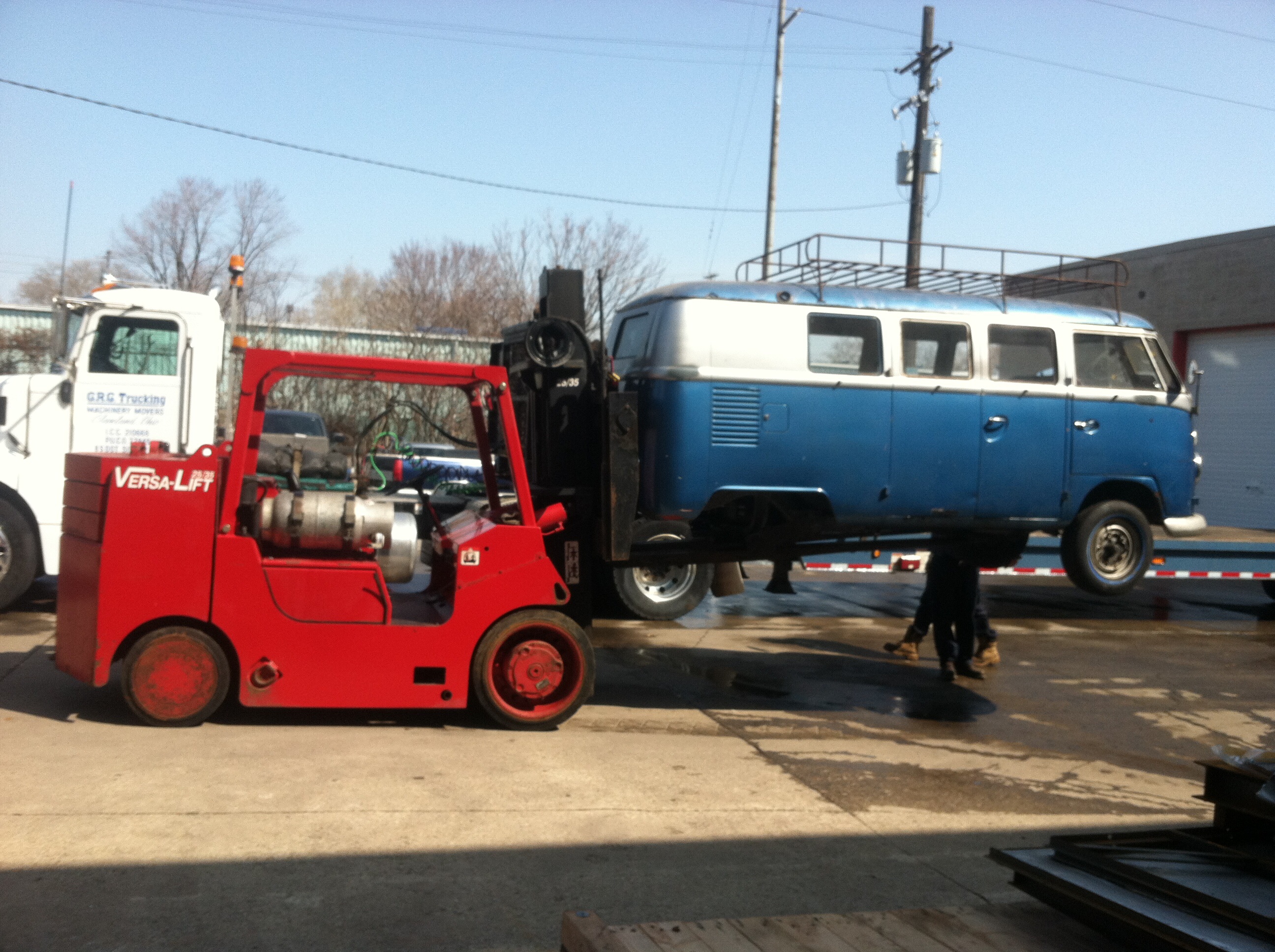

Moving a suspensionless bus is easy :lol:
Re: 1971 Early Bay Panel
Is this operation WSD approved?

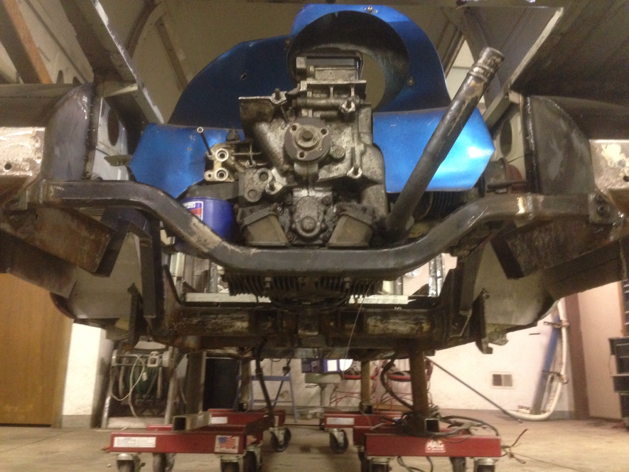

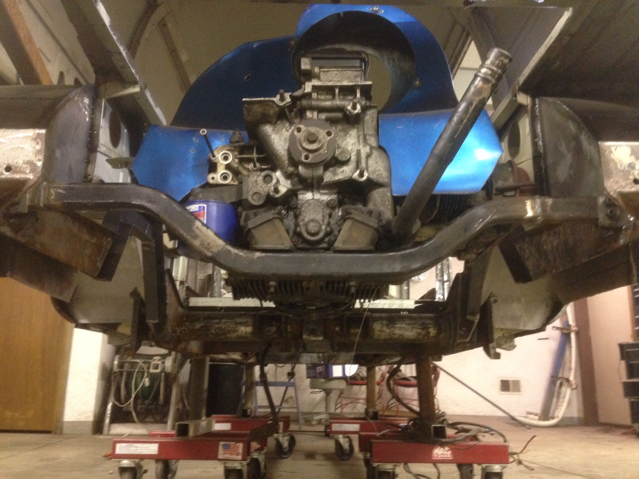

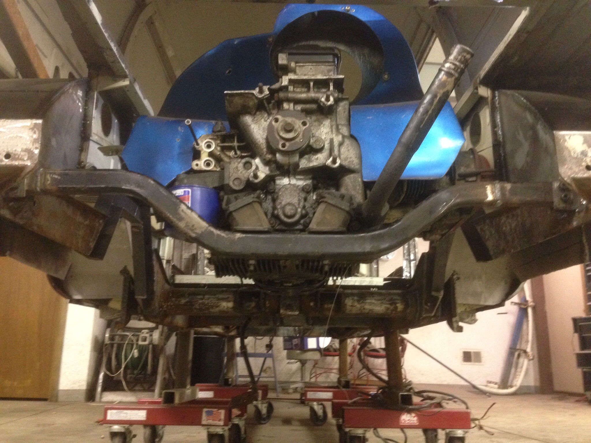

Here that engine and trans raise pic. Note how much higher above the torsion i am :)

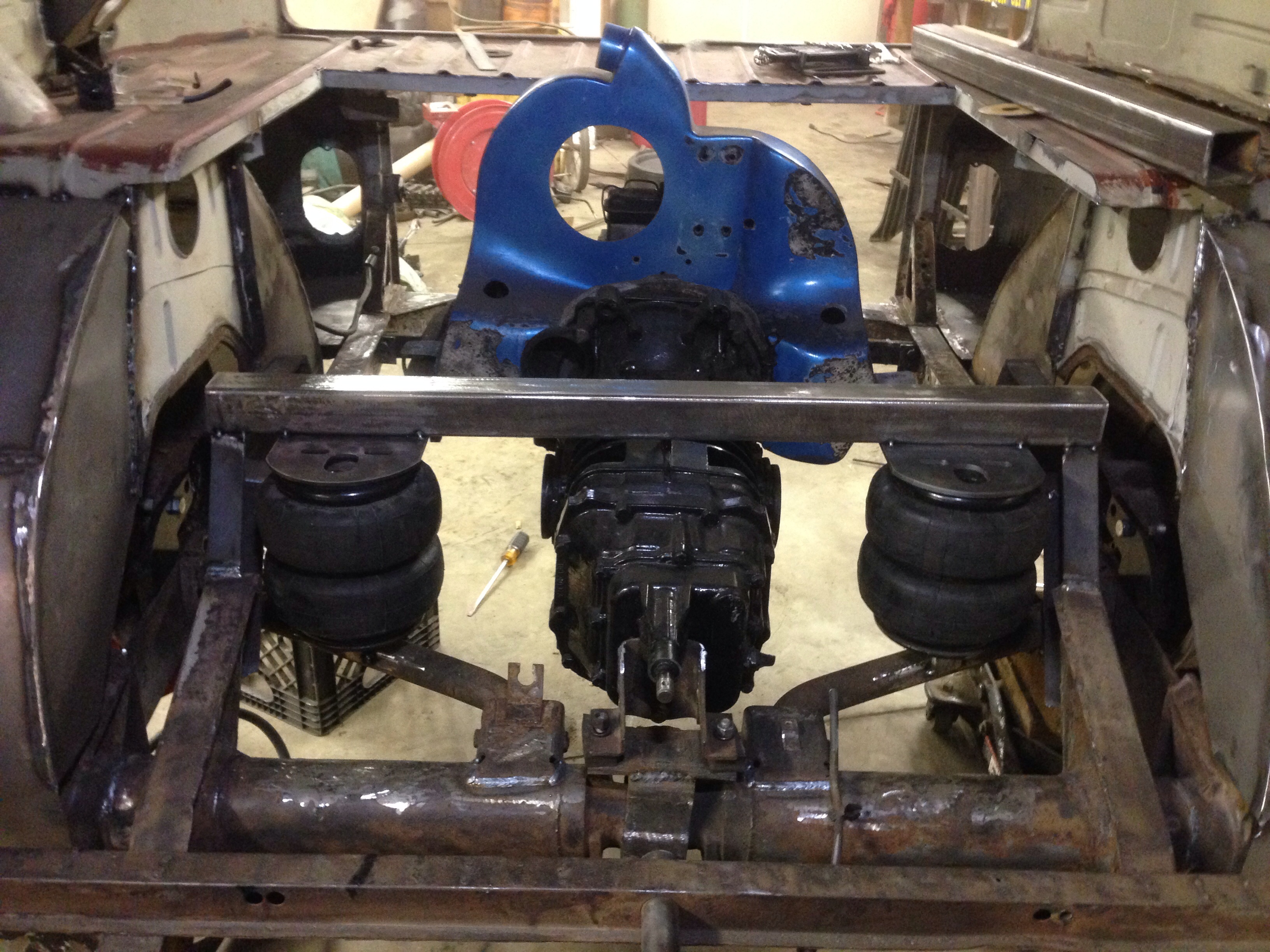

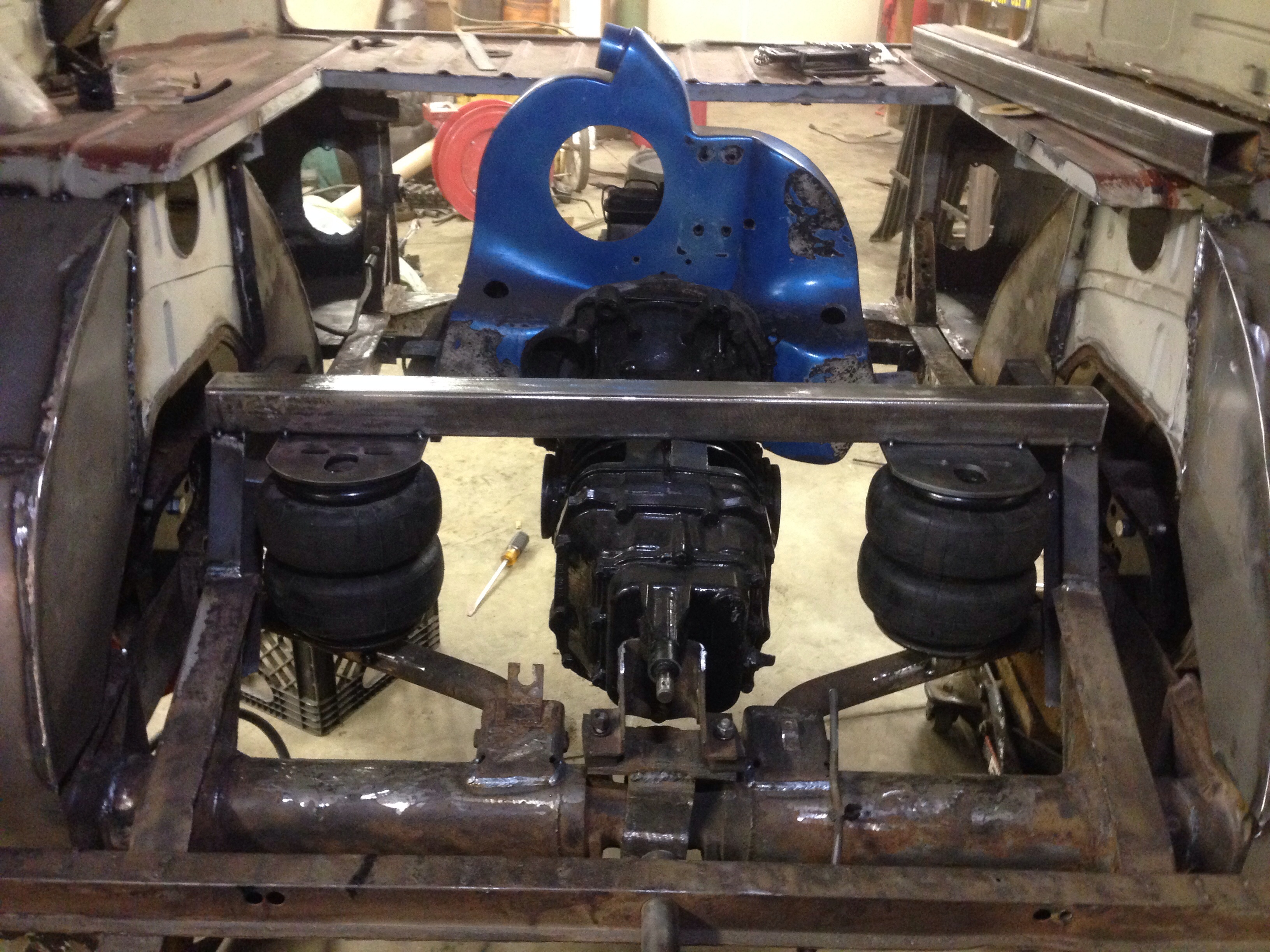

Here's a look at the bag/suspension mock up. I had to clock the trailing arm mounts upward on the torsion. The bag bracket is all custom fab. Probably over kill, but better then not having enough support. Theres alot riding on the bags. In case your wondering ill have to make a custom parcel shelf. That also had to be raised 5".

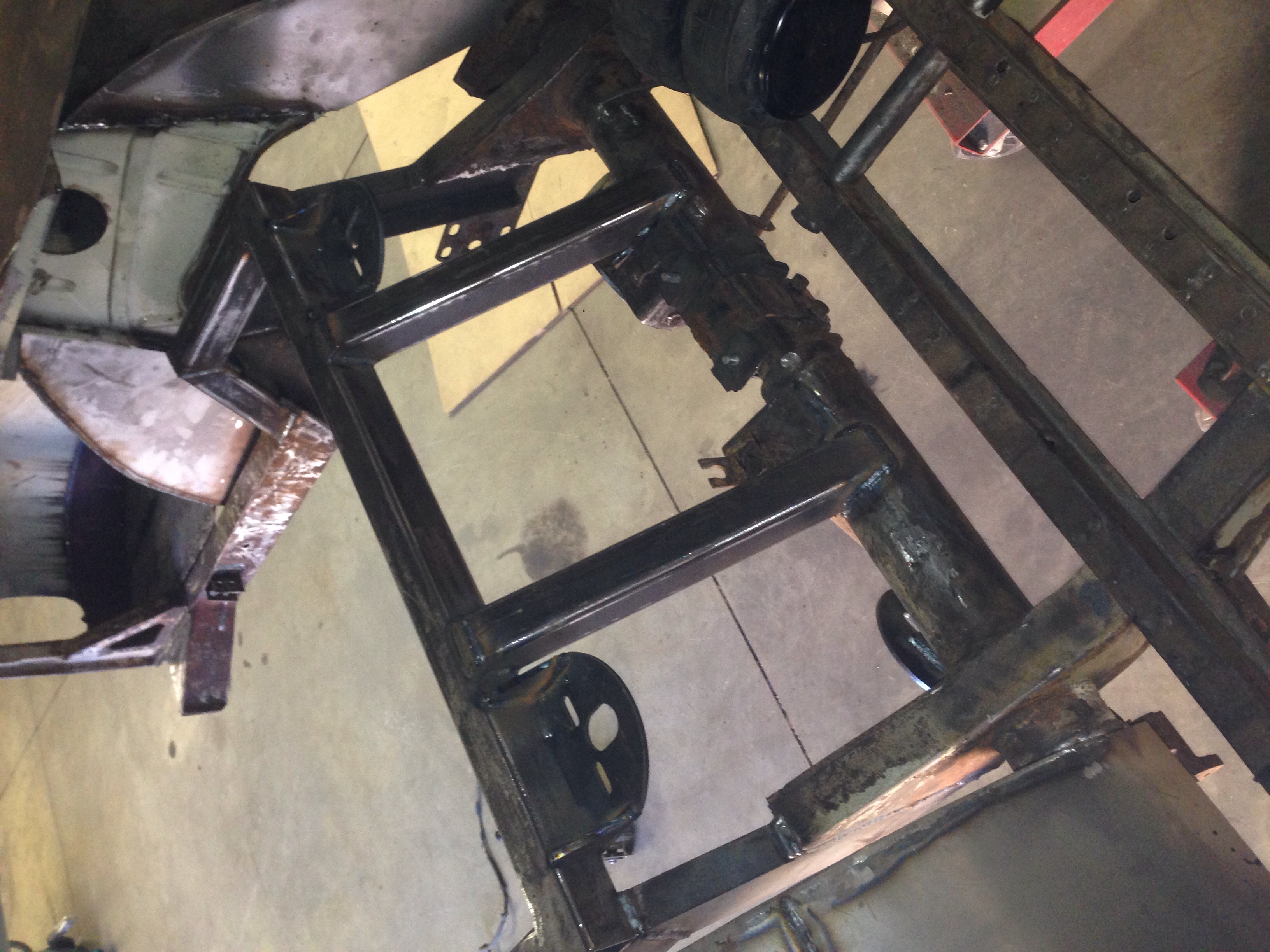

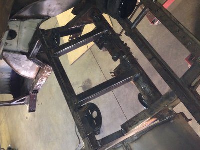

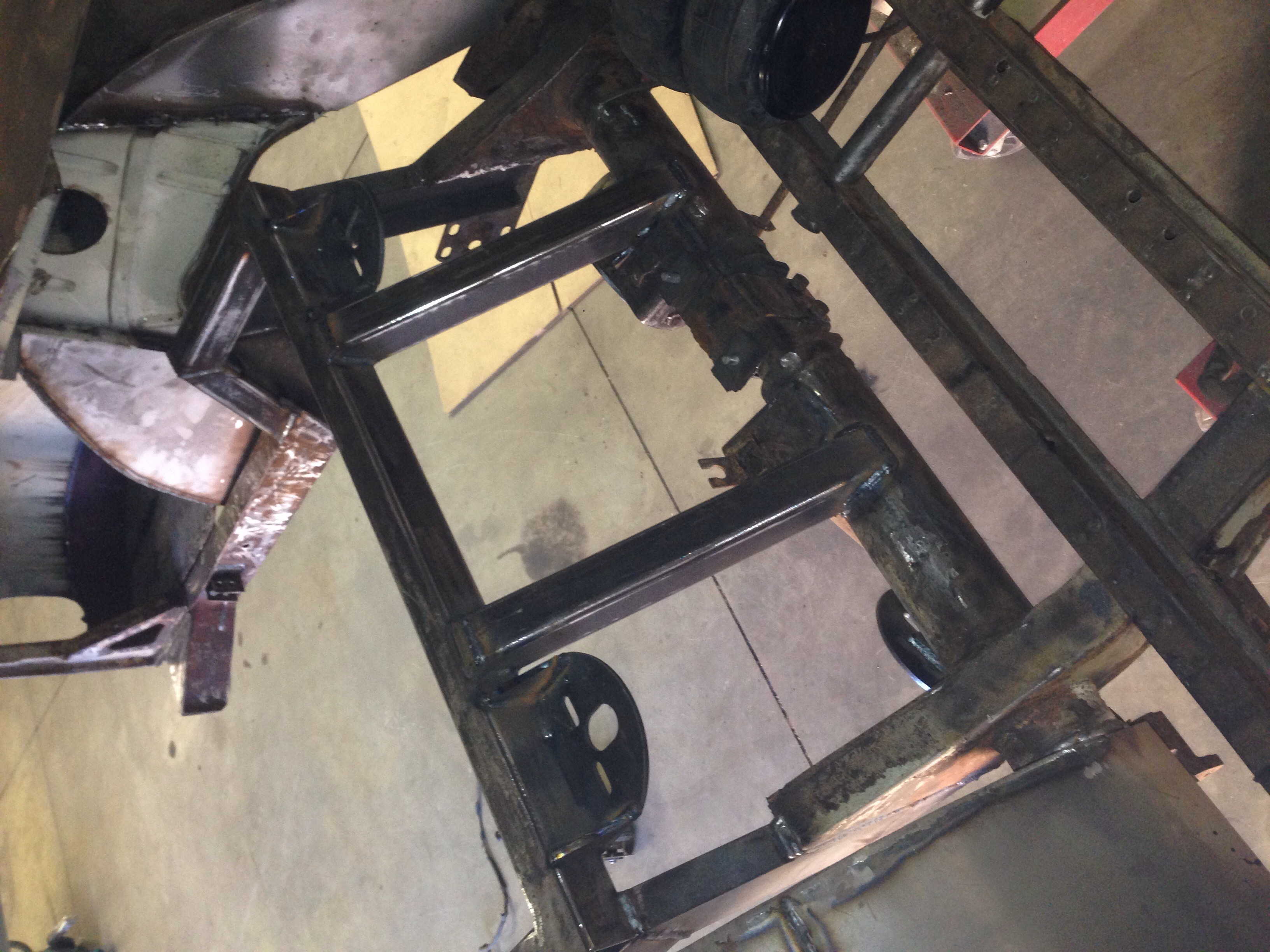

I ended up adding extra supports later on. Here's a bare bones look.

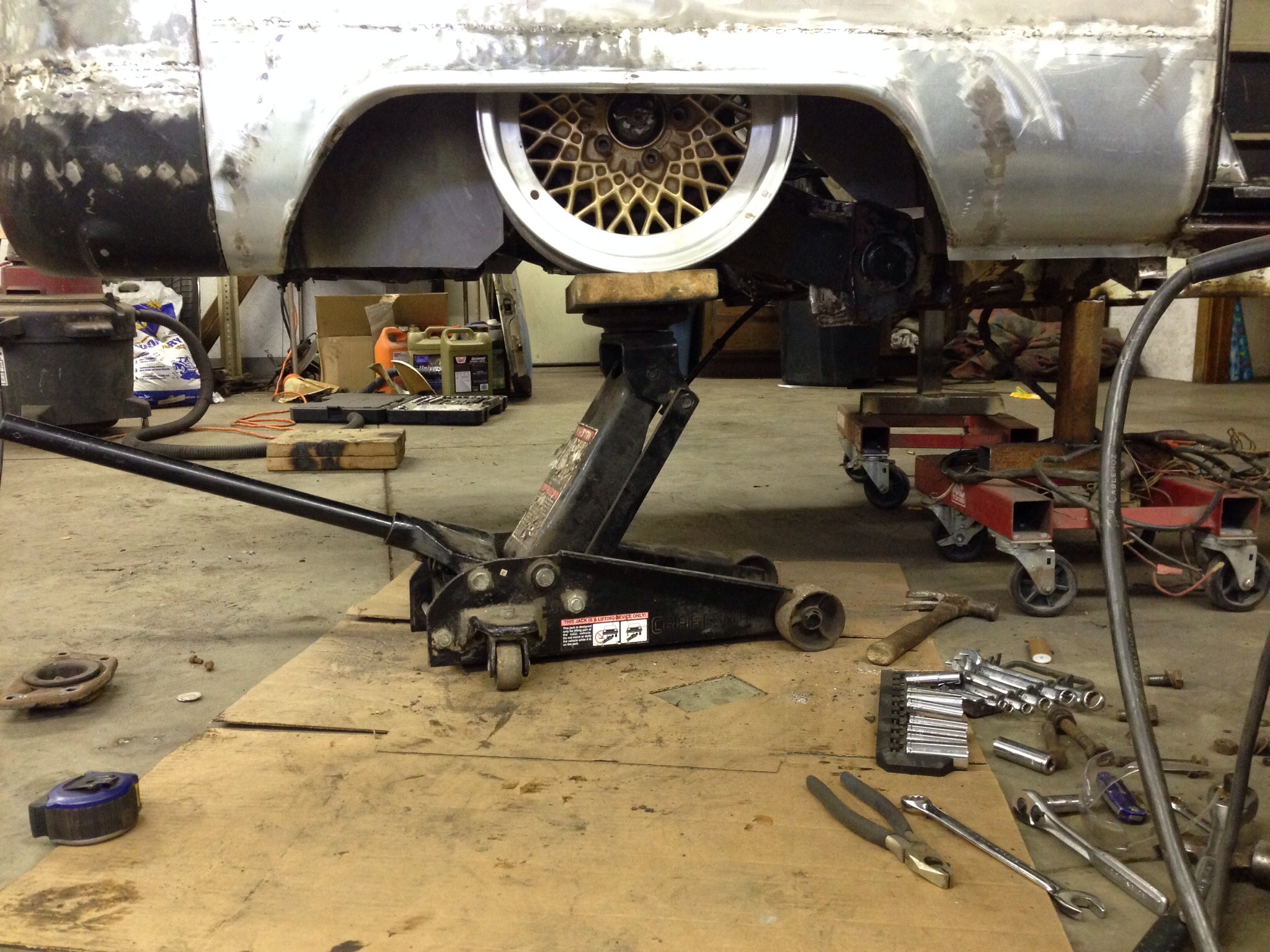

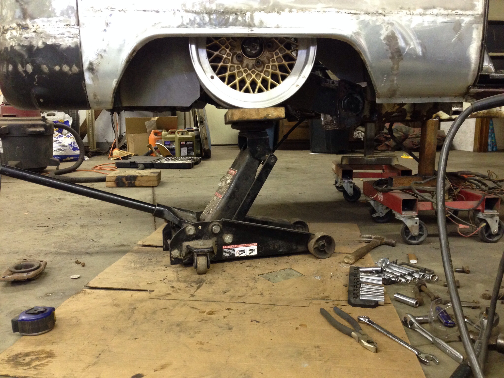

I had to step down my wheel size to get über low. Luckily, i was able to find these true bbs ra's with the correct hub bore on craigslist. So i drove out to pick them up in PA. I'll need longer wheel studs to run them safely. I think they'll look freaking awesome while stanced. At this point in the wheels travel, the frame has already touched the ground. It's like 4" higher then the torsion ends, if I remember correctly.

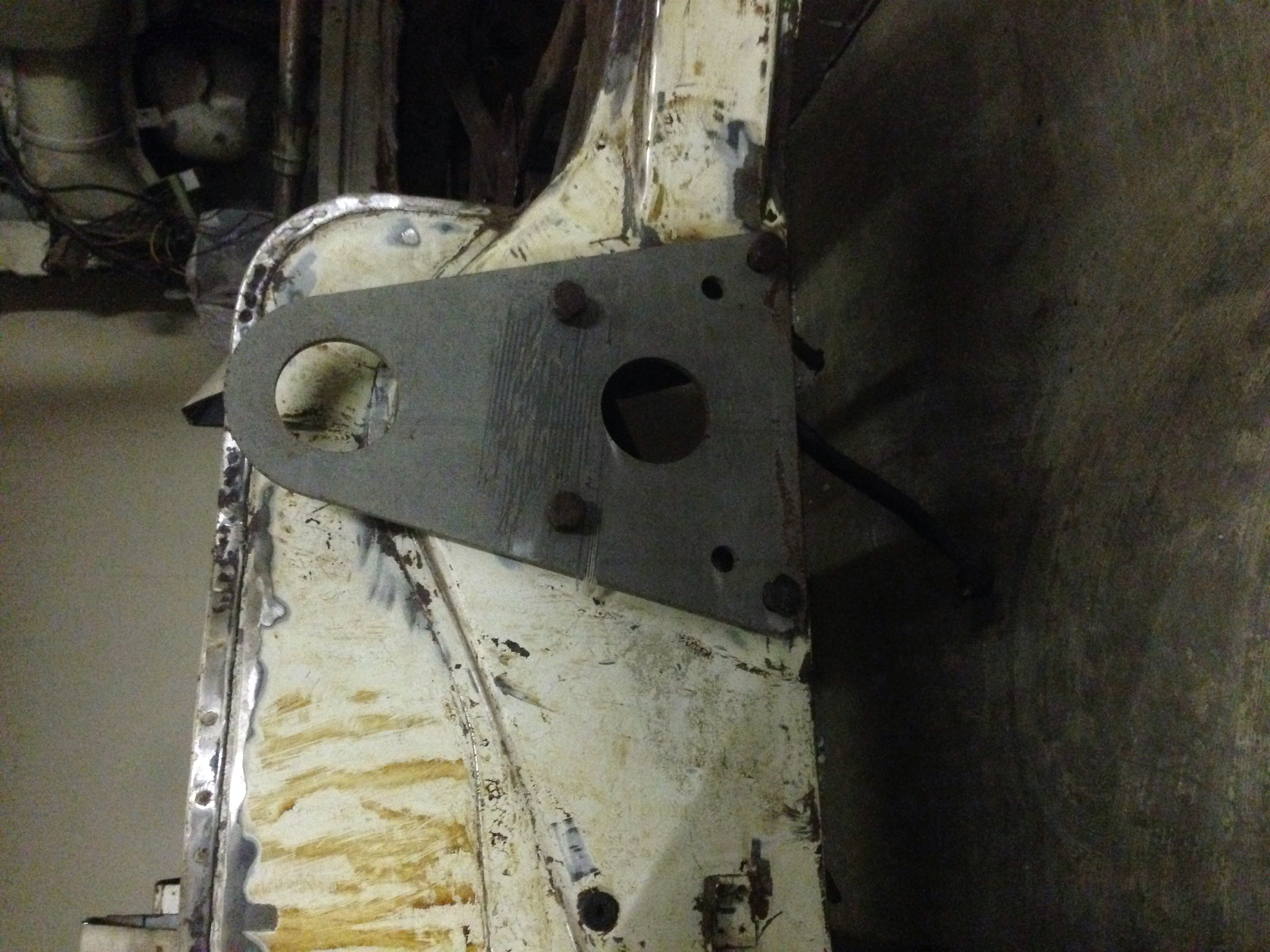

I haven't got to the front suspension, yet. I had these custom beam raise plates cut for me. This will raise the entire beam up 5" putting the top tube thru the cab. By doing this im able to run my stock spindles. No welding, flipping etc. it also allows me to keep my suspension geometry as close to stock as possible, while only being inches off the ground. The only down side is that the beam will no longer be removable from the bus once ive welded the tubes to the end plates. At this point though, removing the beam is the least of my concerns.
