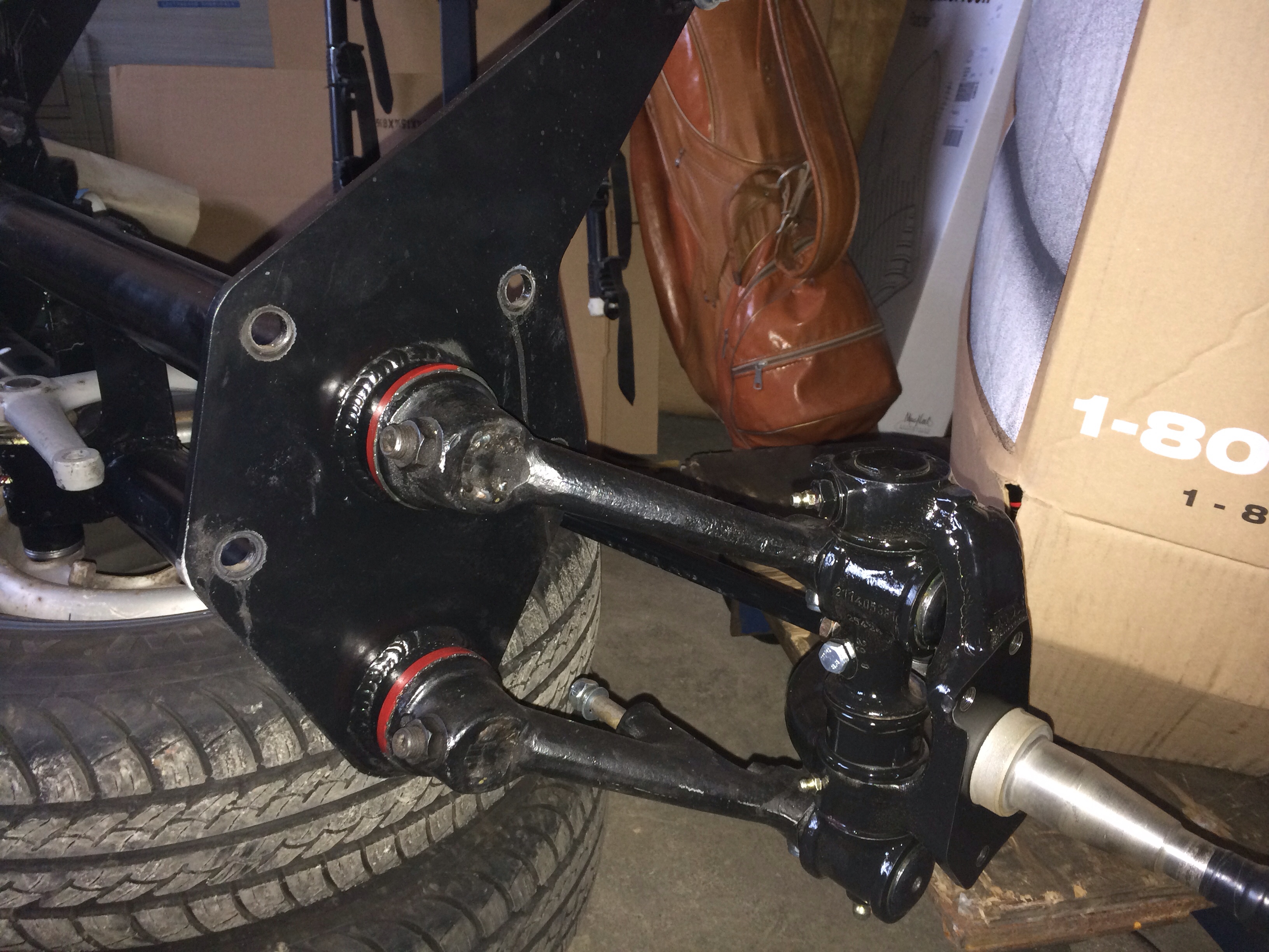

Well I picked up my new Widefive Spindle-spindle beam and all I can say is beautiful. Im going to feel bad attaching something so pretty to my crusty bus :lol:
So thanks to the TEAM(Aaron and his partner, beard) at Widefive Inc.

Just wondering, is this a whole new beam or did he modify your existing beam.
I'm looking at wheel options and it looks like if you go aftermarket, front beam needs narrowed?

Kirk wrote:Just wondering, is this a whole new beam or did he modify your existing beam.
A whole new beam, 3.5" narrowed. Aaron said a 2" narrowed beam is great for stock rims w/ flipped spindles. And to run aftermarket rims around 4" is ideal
