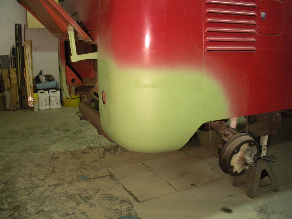

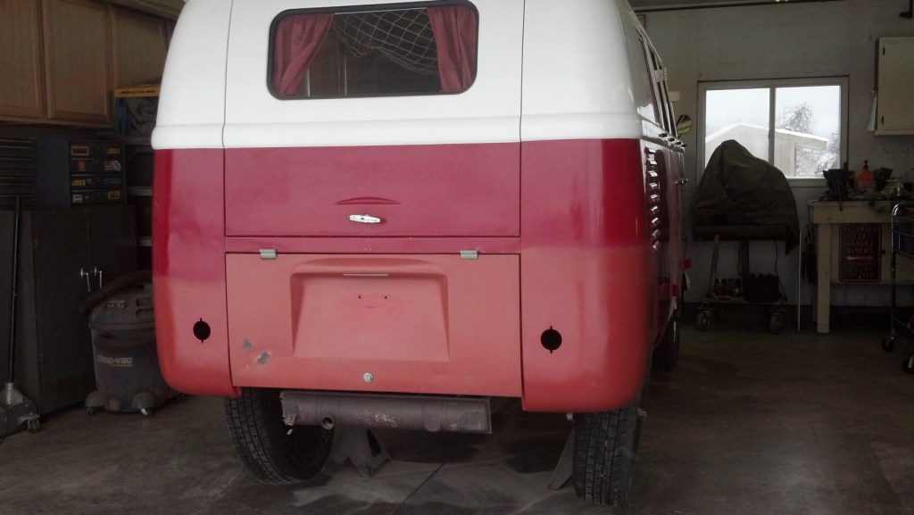

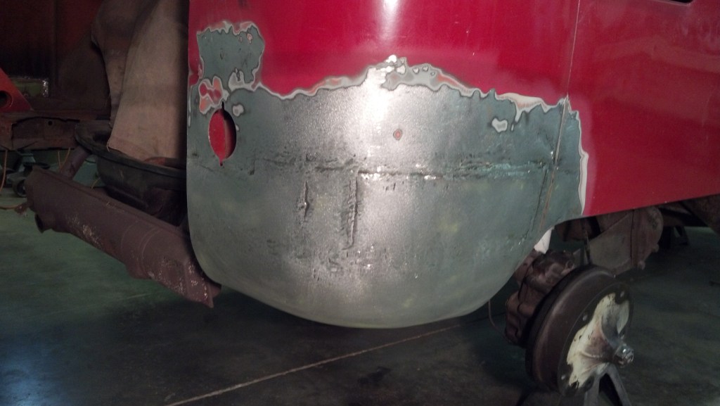

Kirk got some body work done yesterday on the right rear corner. That is coming out very nice. He might be kind enough to post a picture. My phone pics came out blurry...

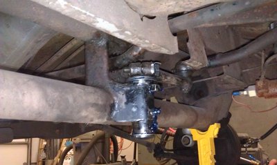

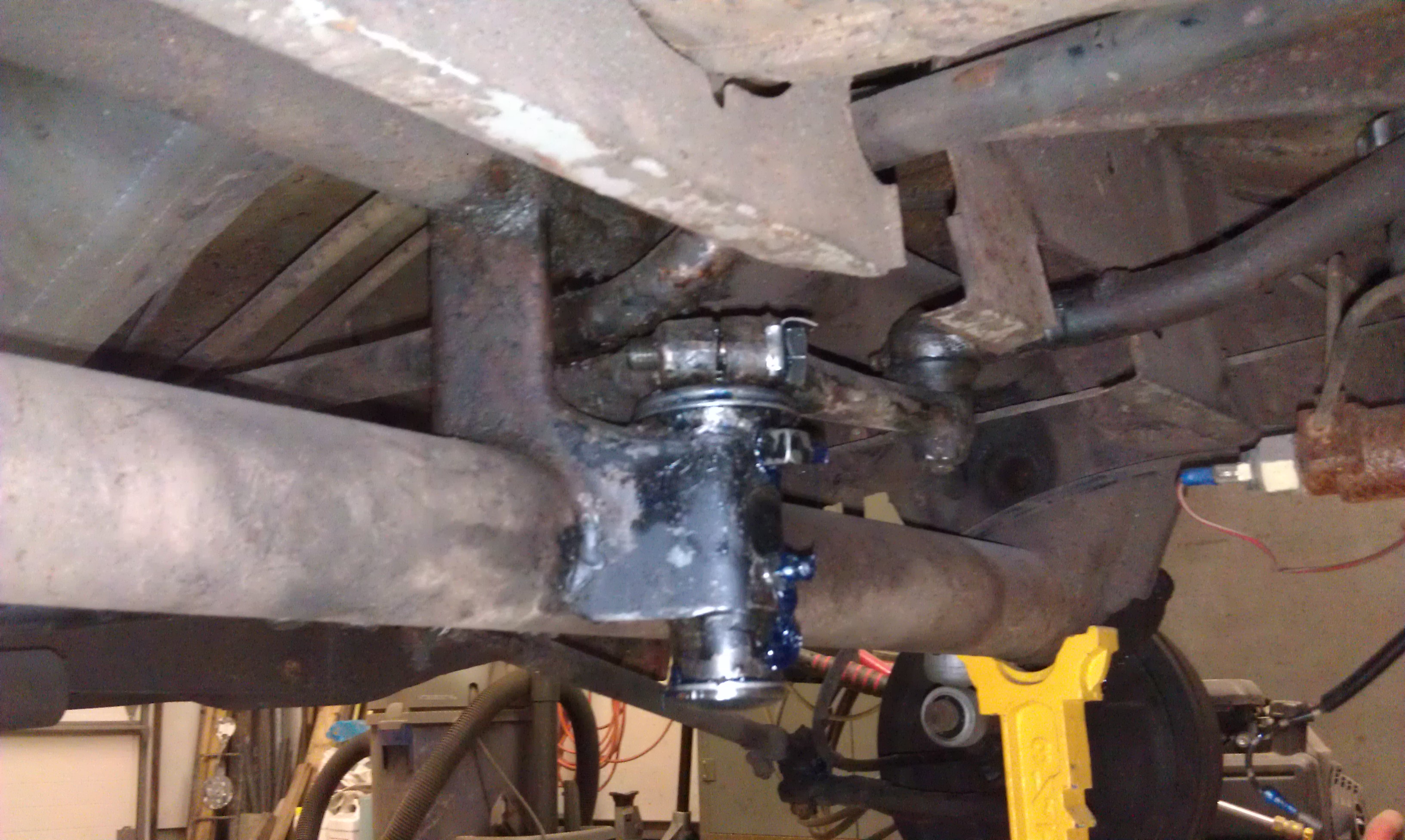

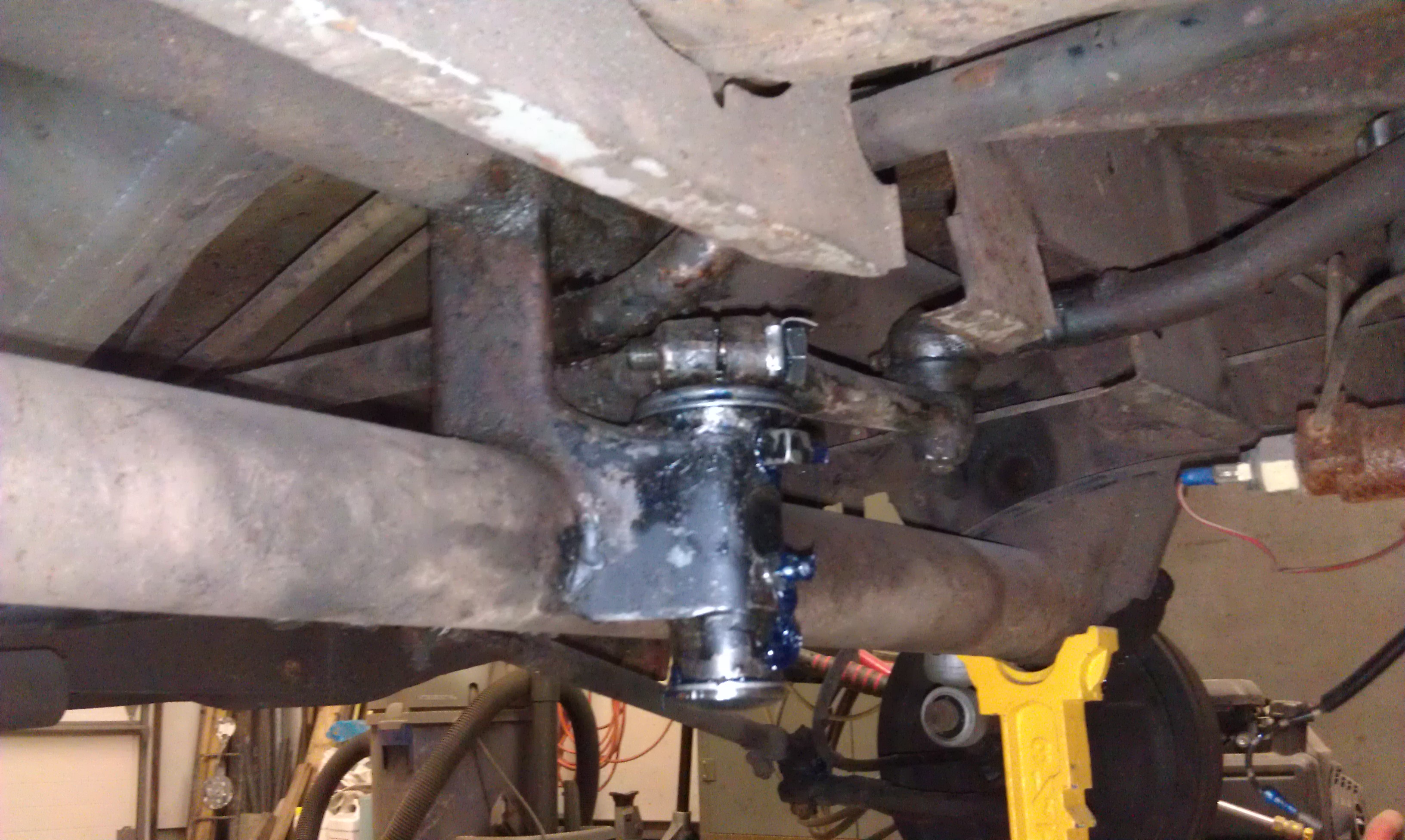

Today we got the swing pin replaced and all new gear oil back into the transmission. Then we greased the front end at all of the points.

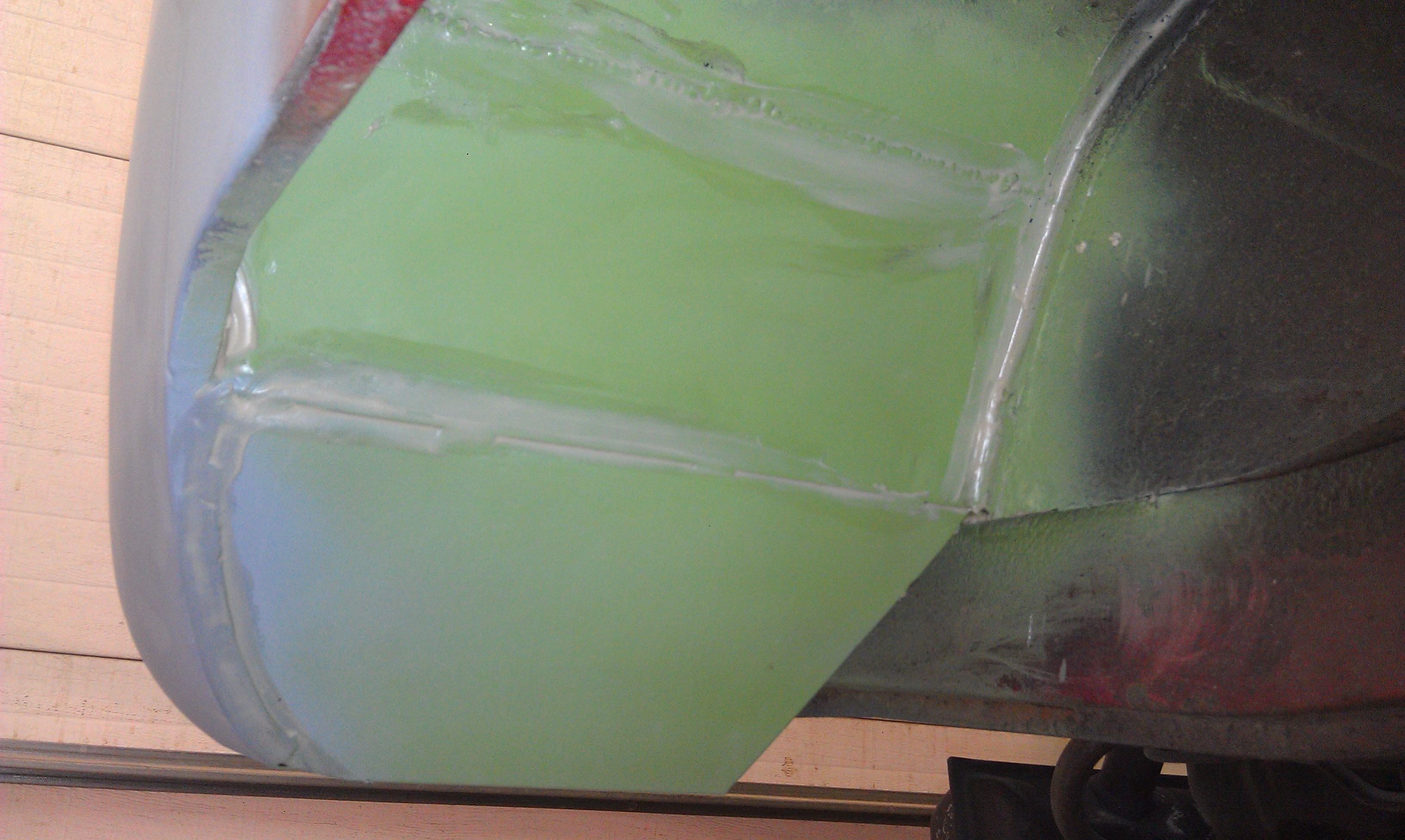

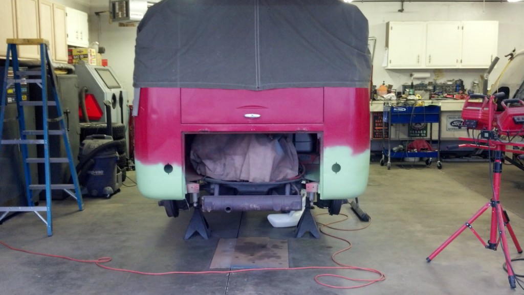

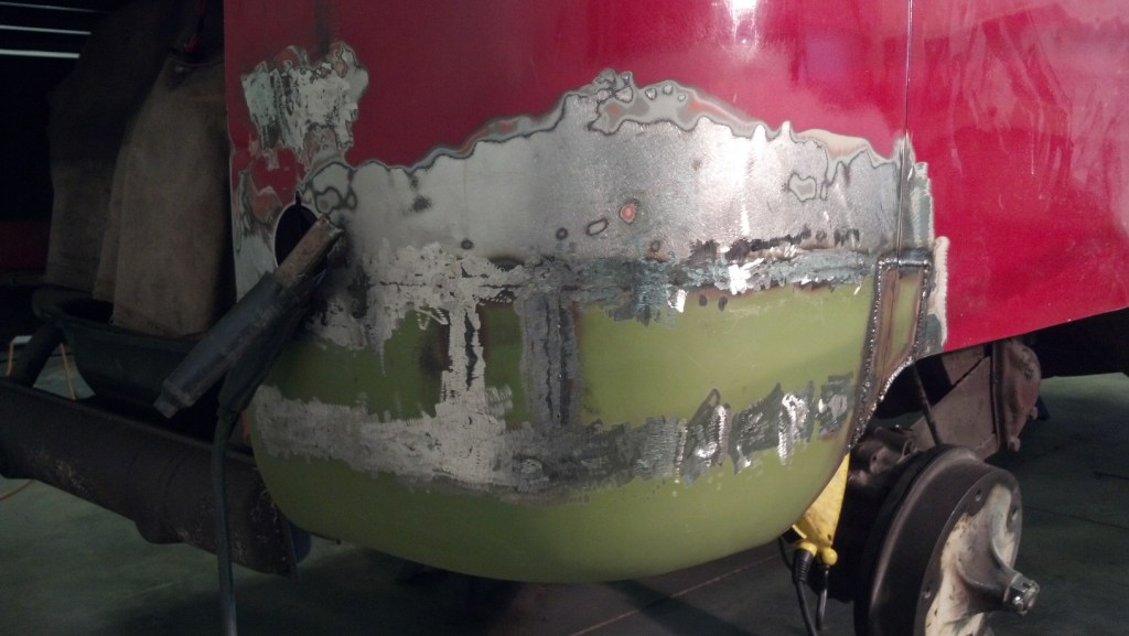

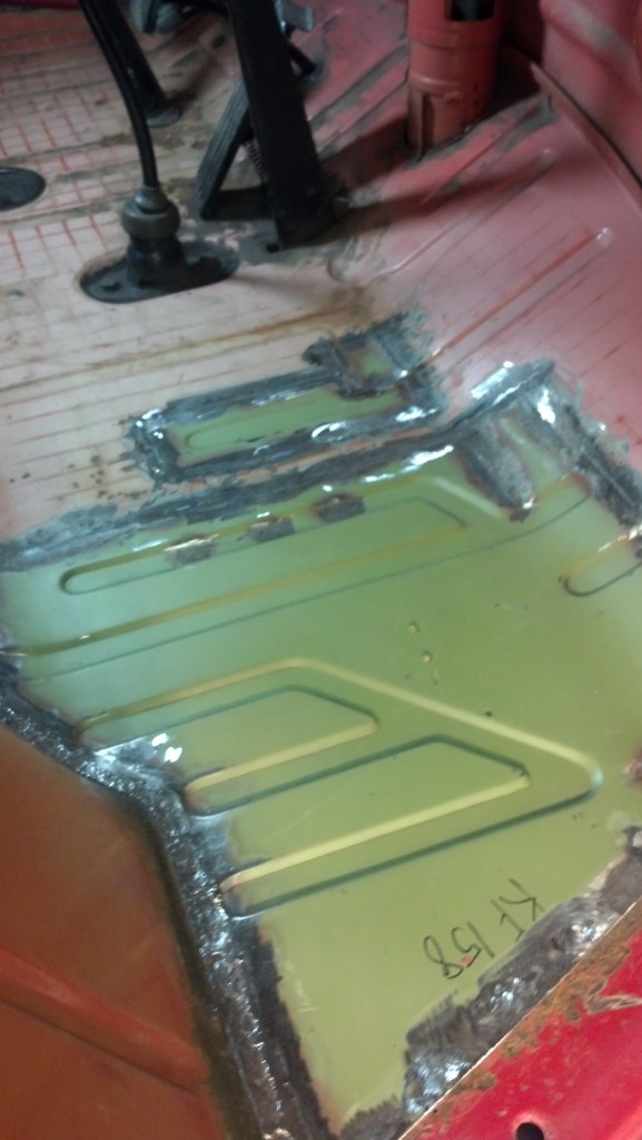

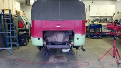

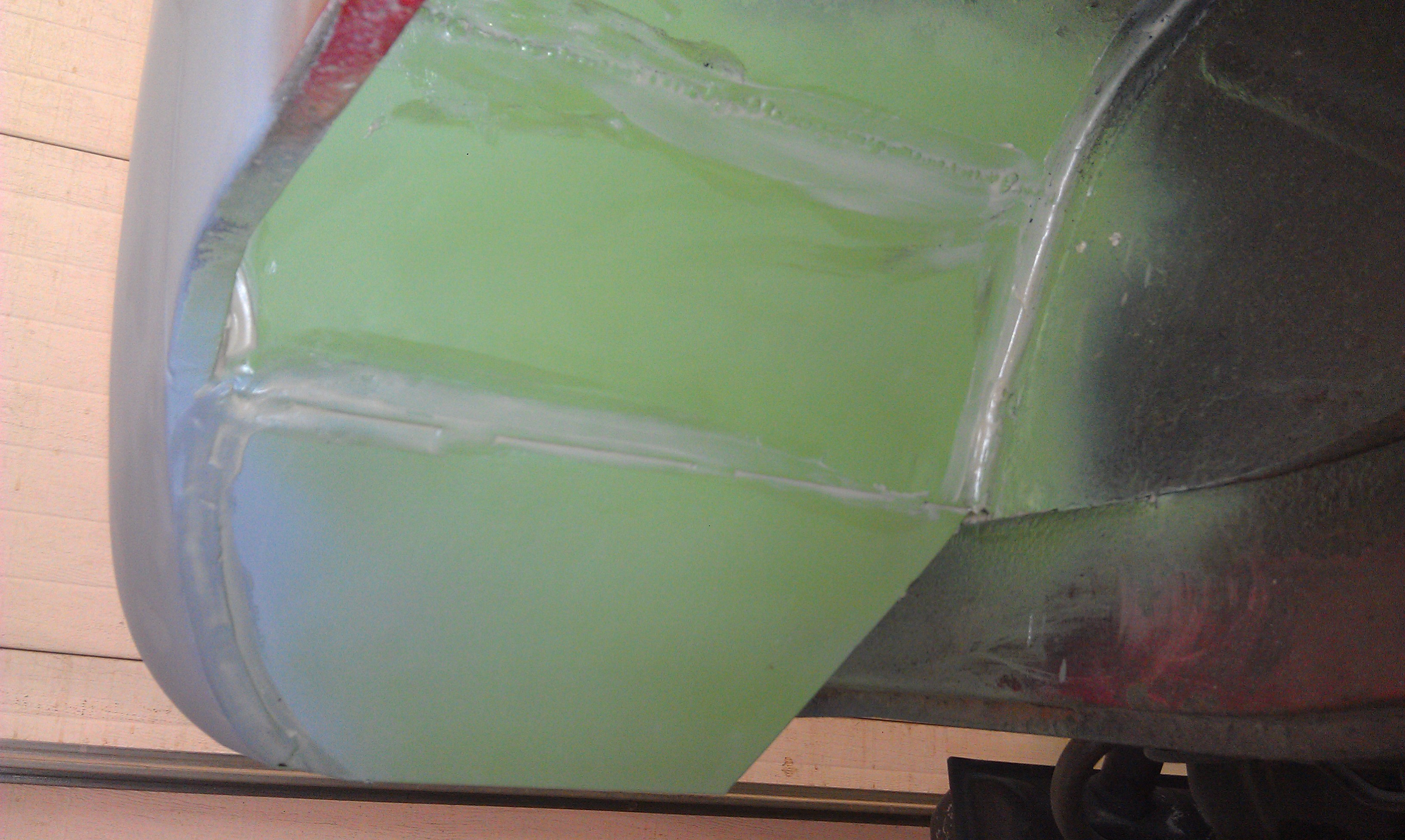

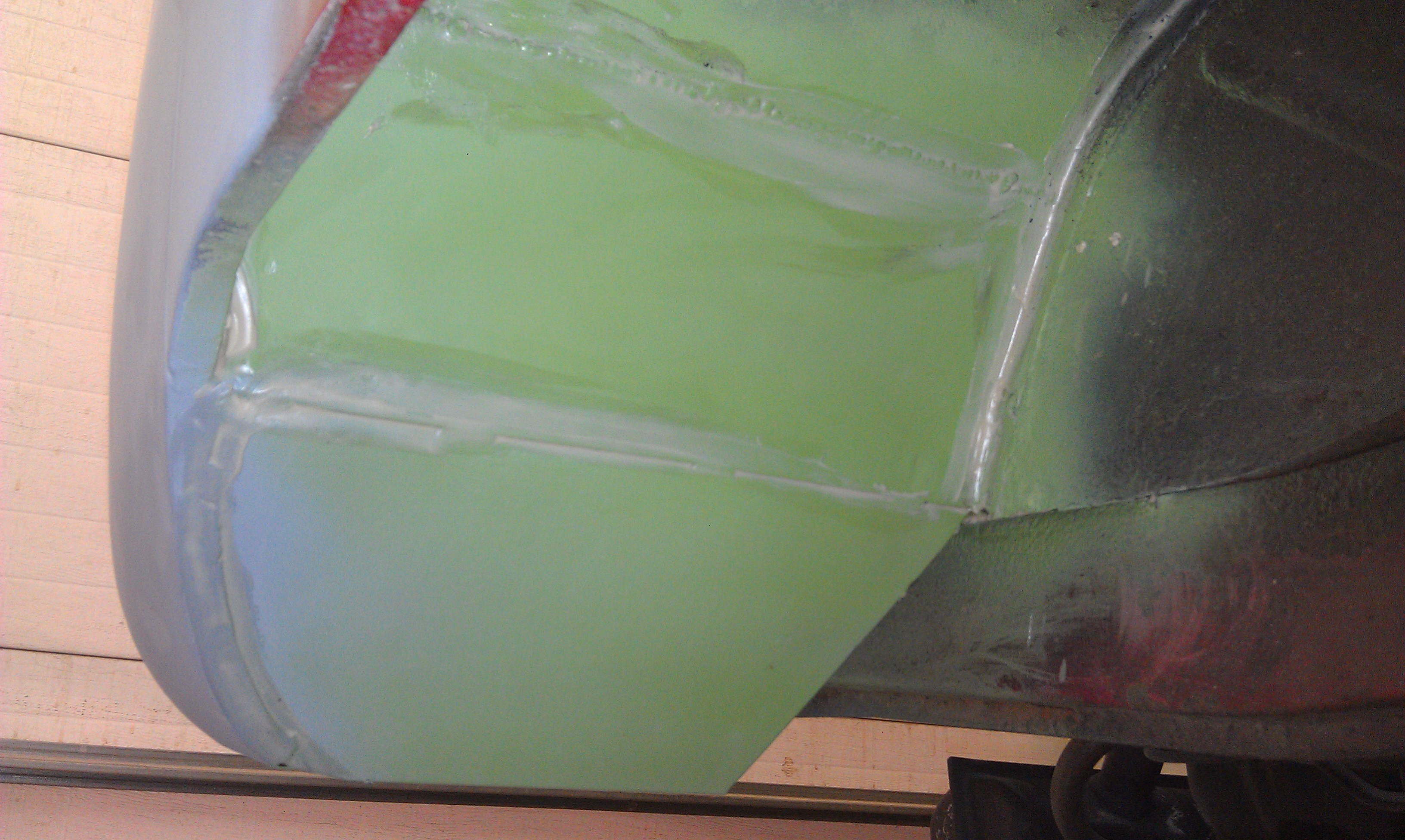

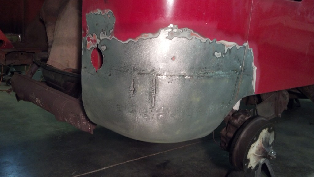

Made some more headway on the bus, getting close to the end.......maybe.

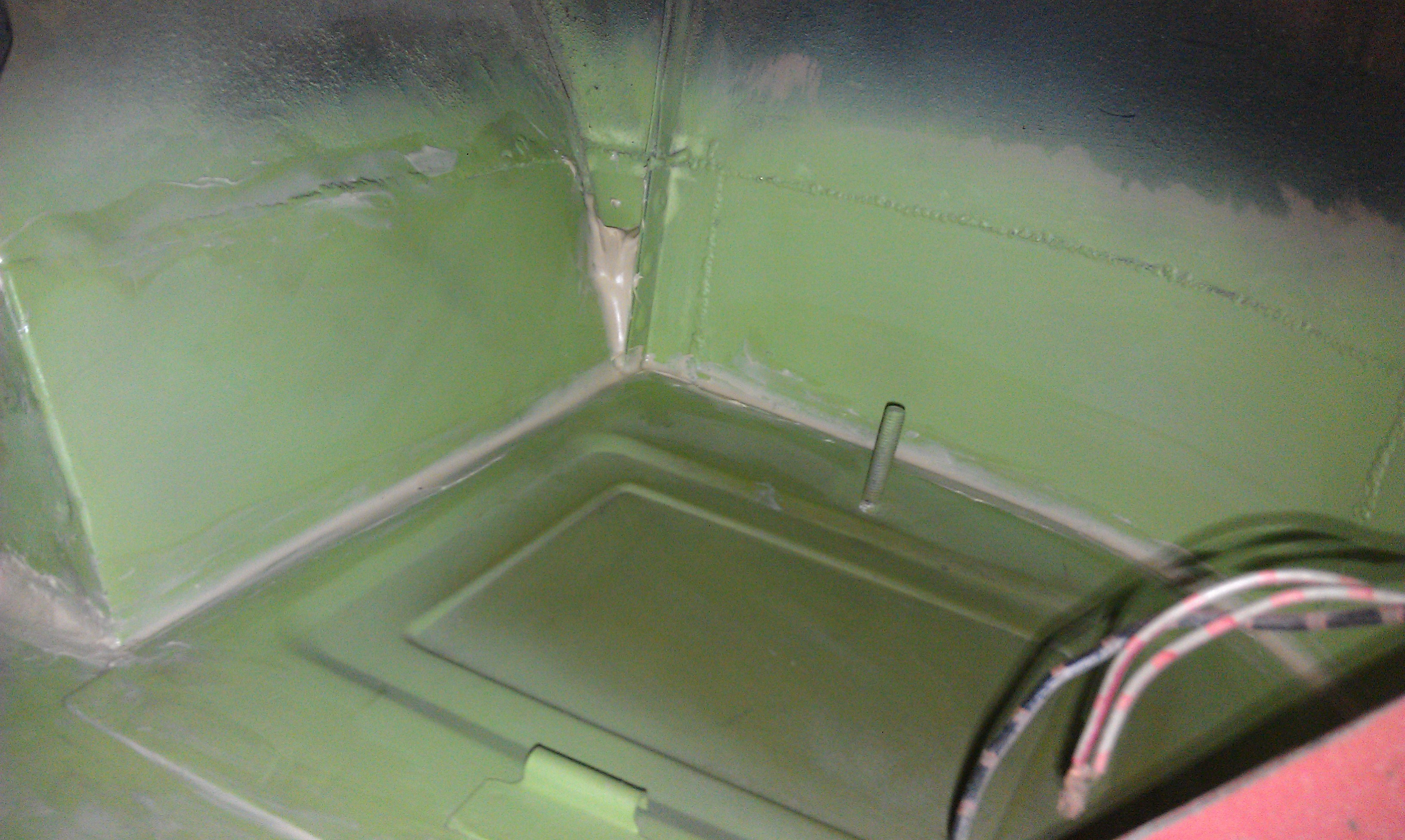

Also needed to have battery tray replaced along with wheel tub sections/apron/wheel well opening/front passenger floor area, etc. etc.
And just for future reference to anybody considering corner replacement with Gerson metal; be warned that they are too short and will most likely need to be butchered to fit correctly :roll:
Another quality job by the CKWA ( Captain Kirk's Welding Academy) ;) :D

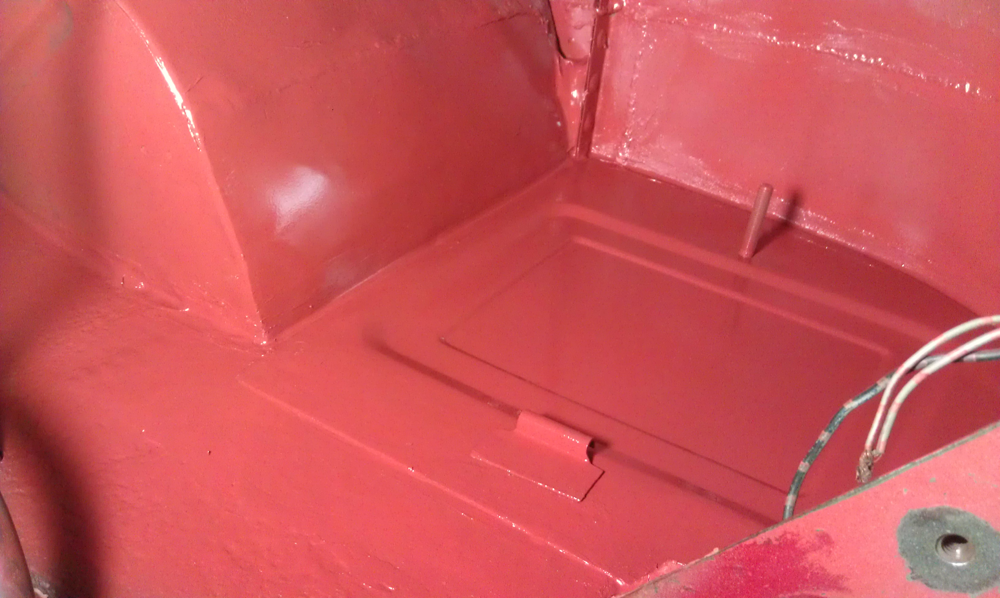

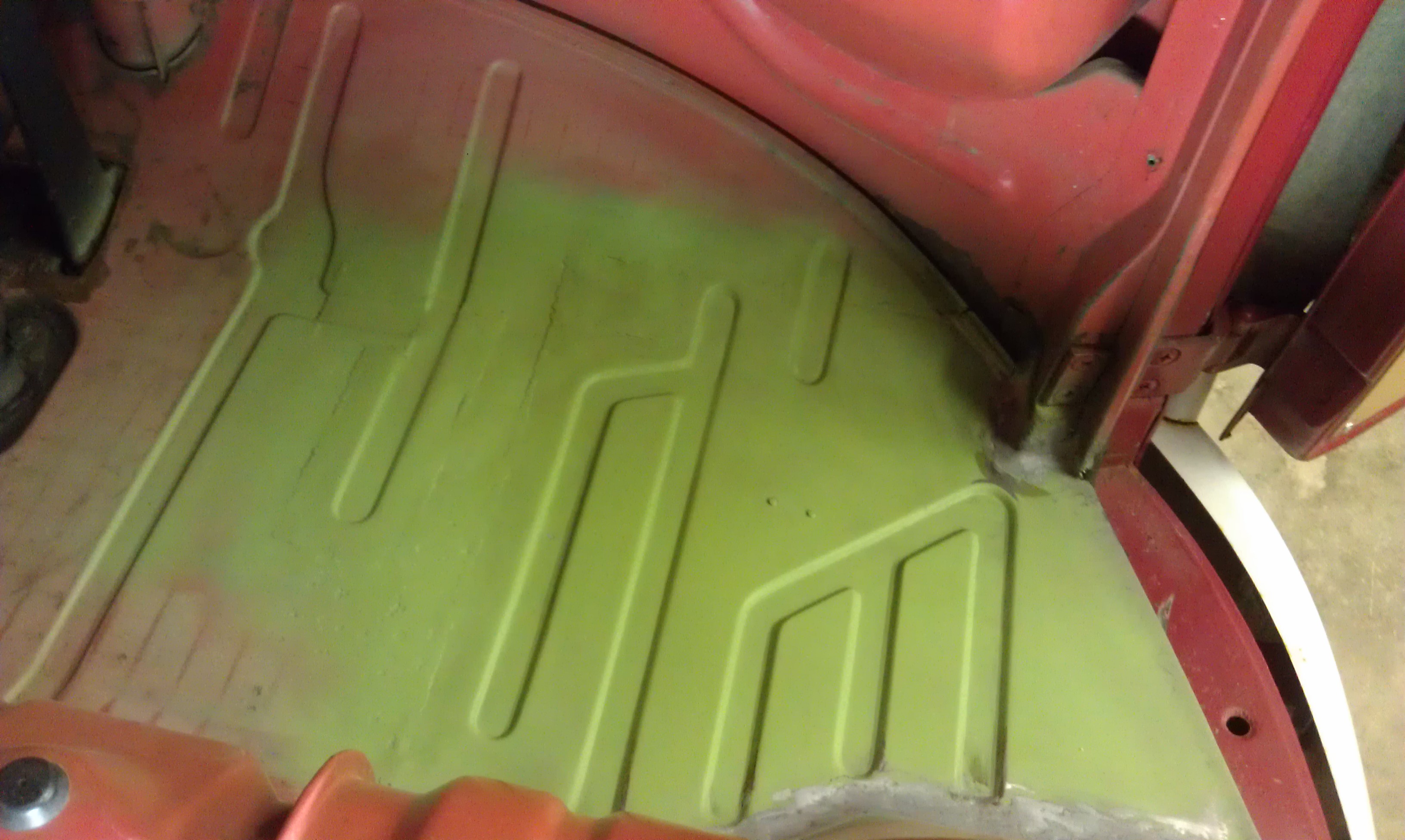

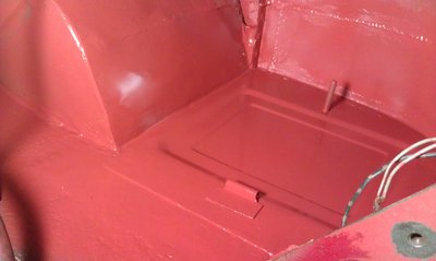

The primer was sanded and cleaned, I seam sealed everything in those areas and then painted with a sealing wax red spray paint from APS Tower Paint. It came out really nice. If anyone is looking for paint to match original colors, I would recommend them. They ship it in spray cans, real easy to use, even for newbies like me.
Here are some photos to share... I thought I took a final of the front floor, I will have to share that latter.

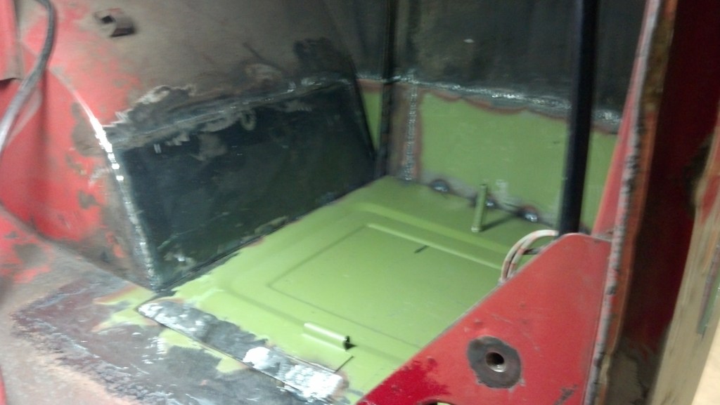

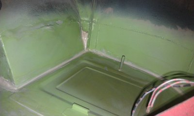

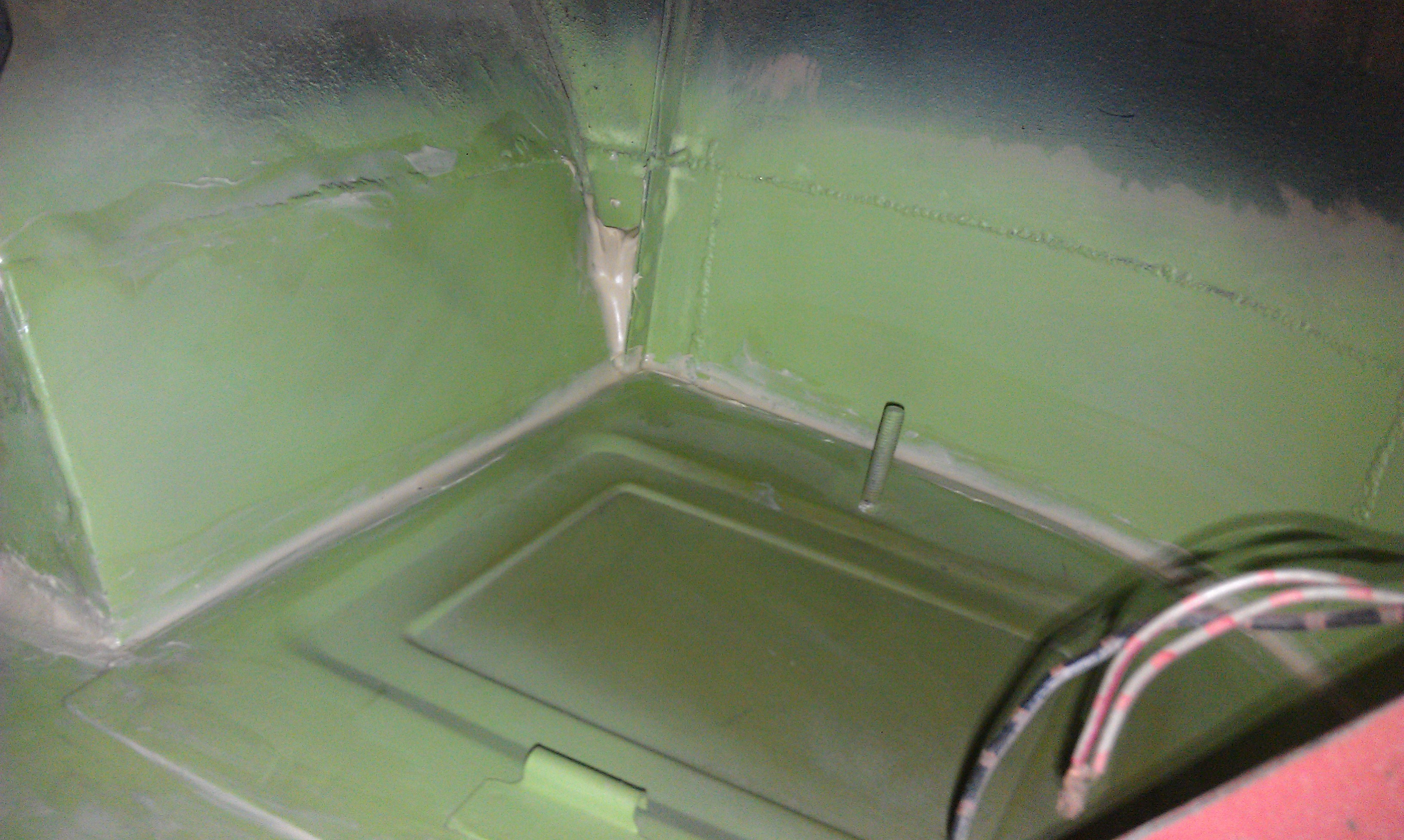

finished battery tray

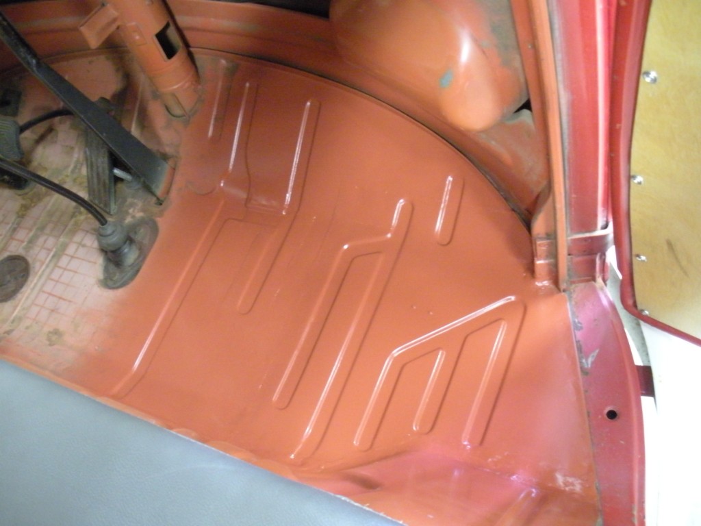

Front Passenger side floor

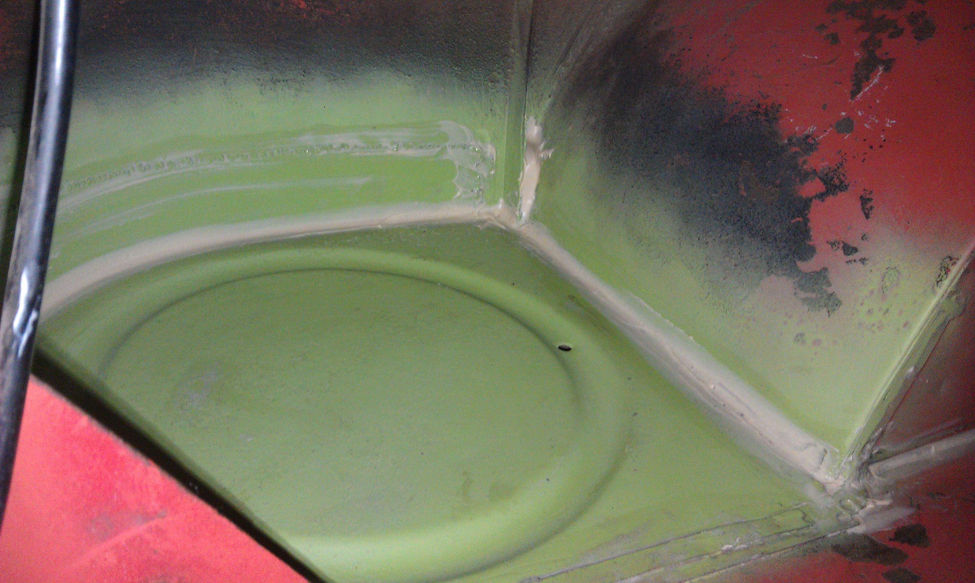

Driver side tray from inside
Battery try from inside
Wheel well under battery tray redone, & in primer
The front swing pin replaced from a couple of weeks ago.

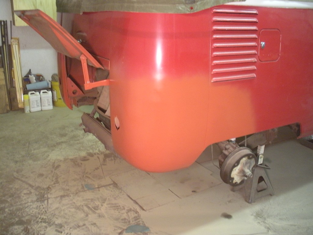

I'm done as far as metal work on this project.
We threw on some SWR rattle can paint to hold it over until Marla finds someone to do the final bodywork/paint to the whole bus.
Still have some mechanical things to do to it, but some of that can wait :lol:
Enjoy......
