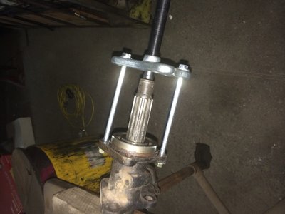

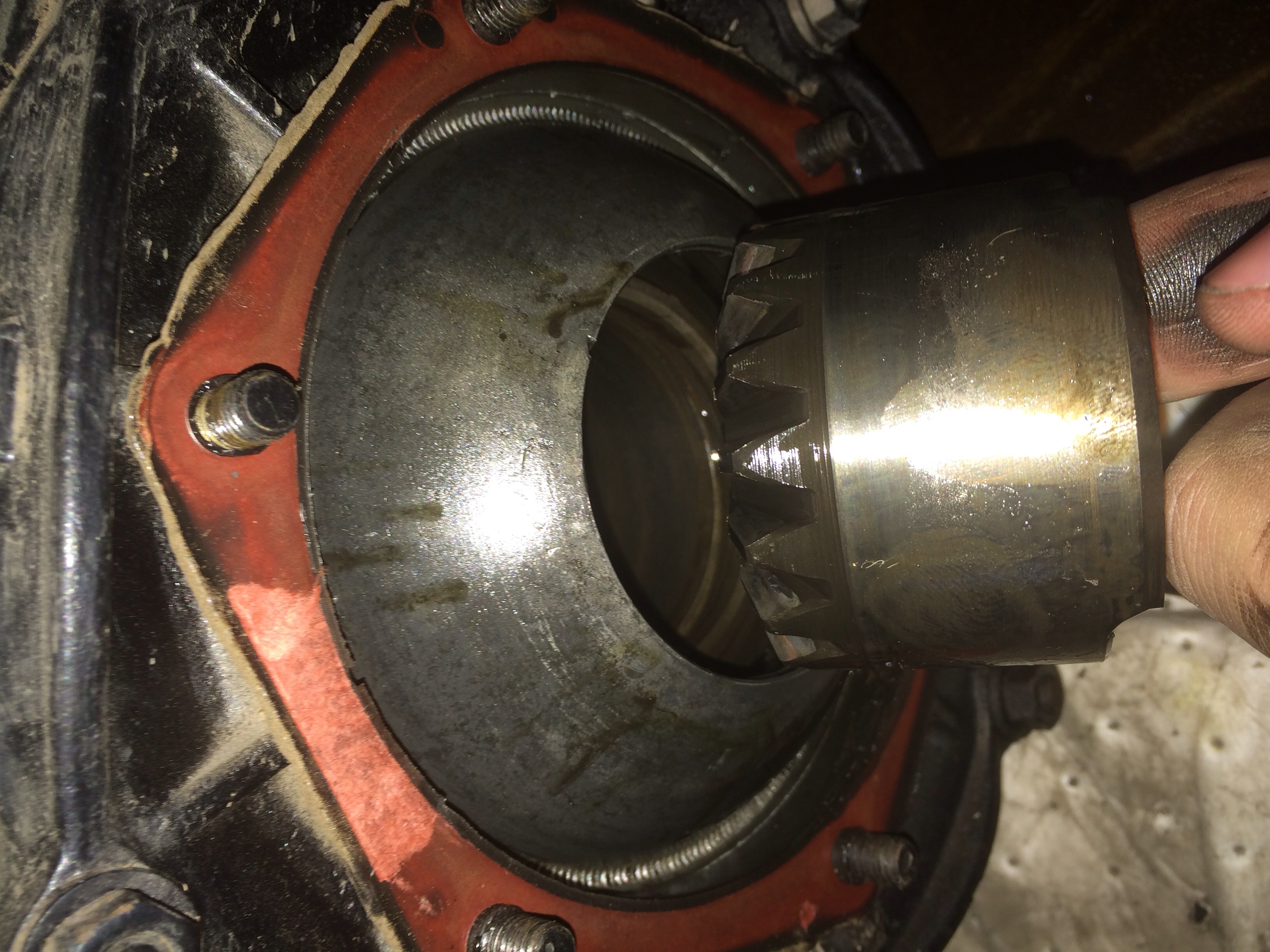

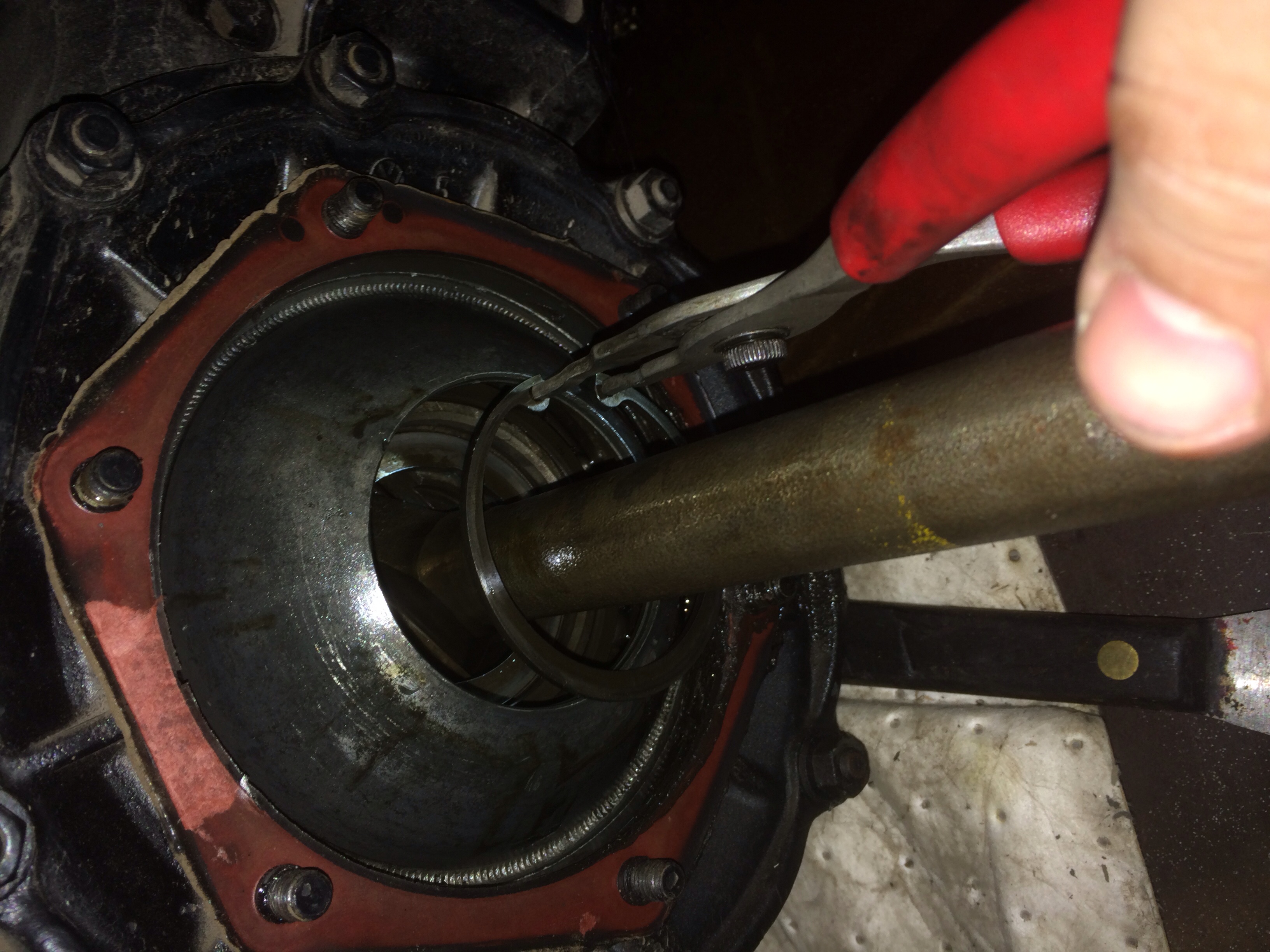

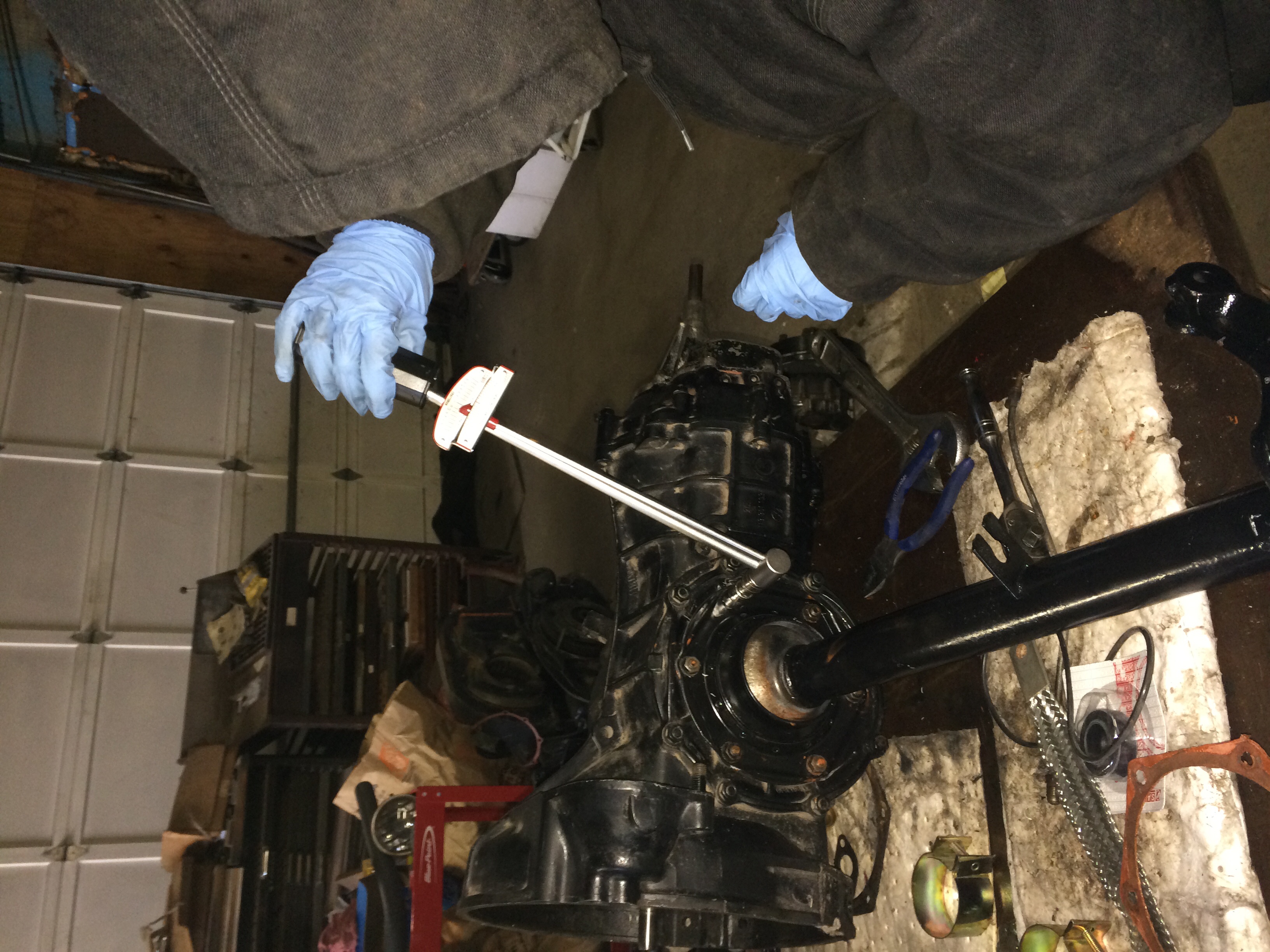

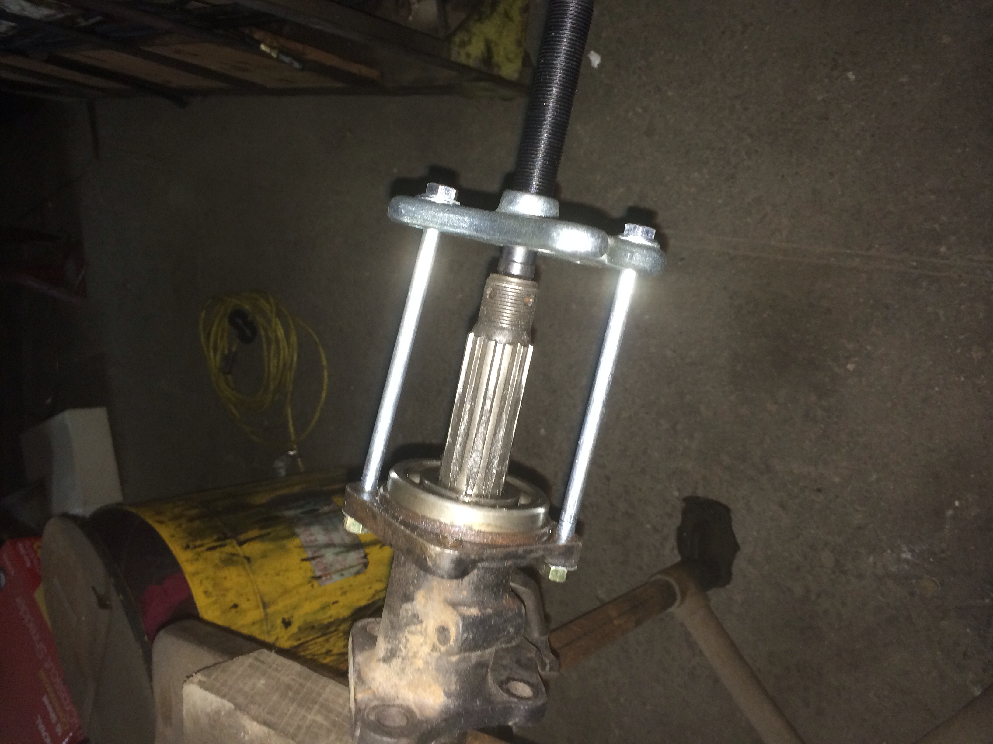

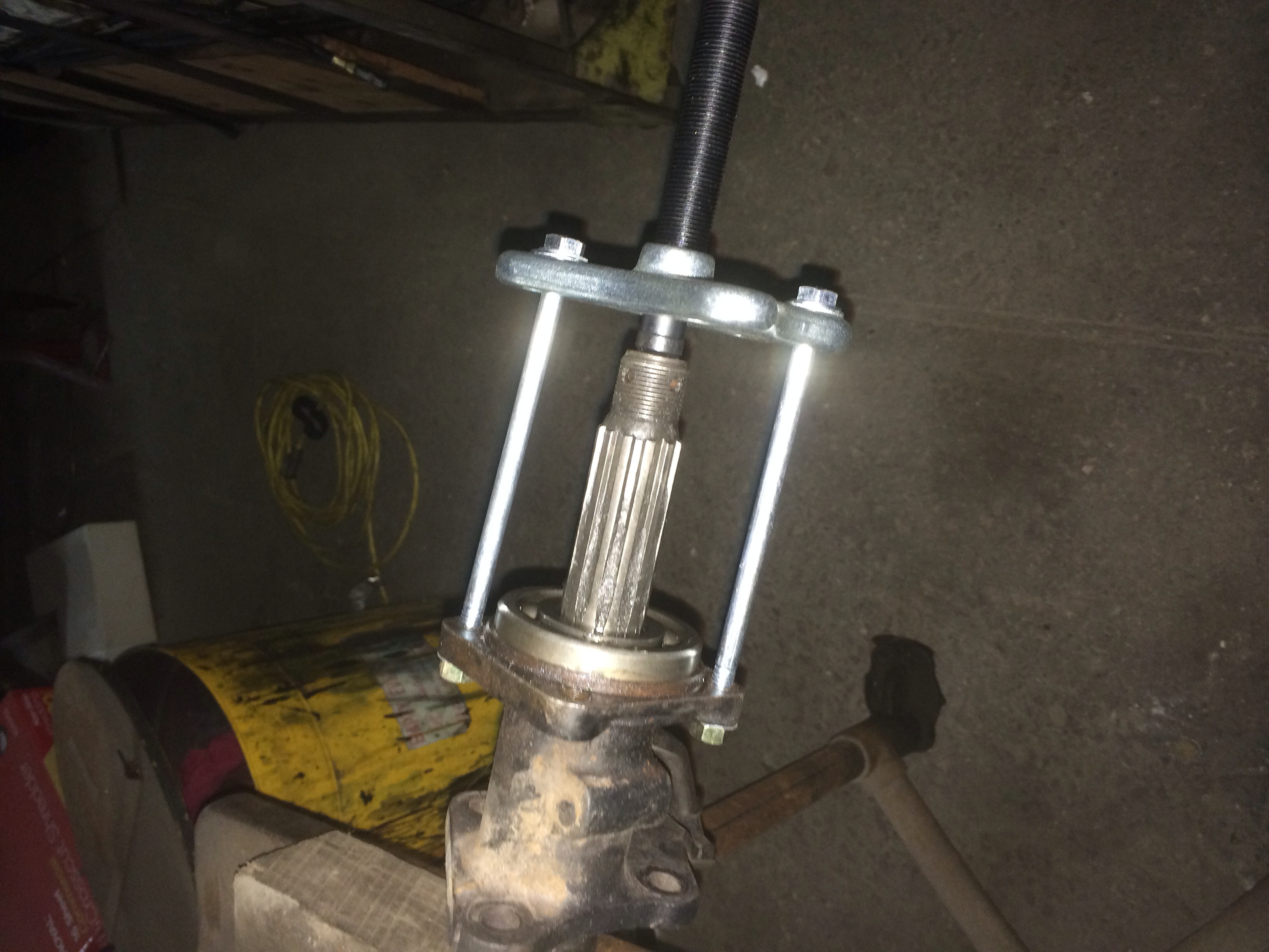

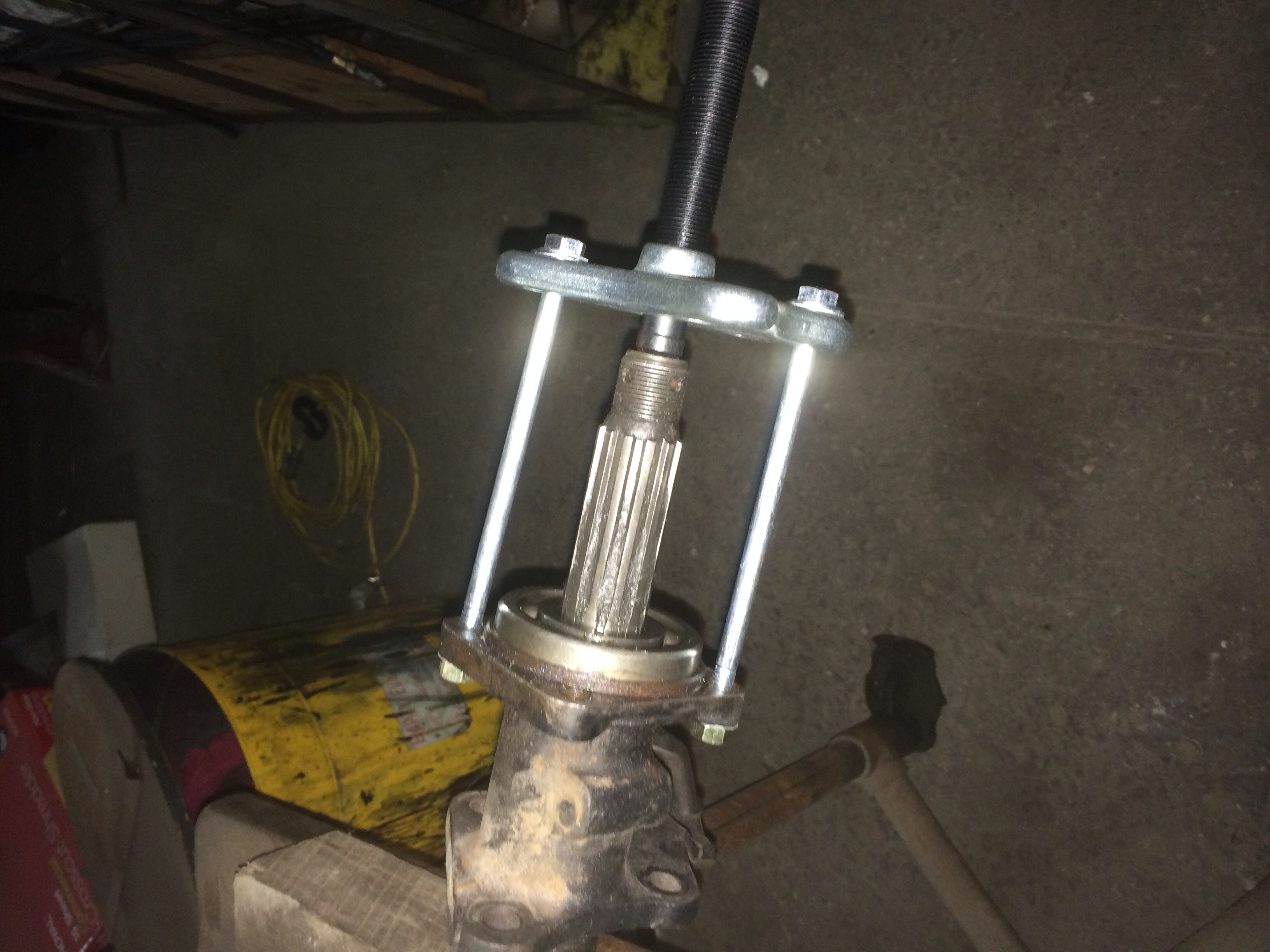

So do to several work projects I haven't been working on the bus much but I have a little break now so I got cracking again. I decided to hold off on the new wiring harness until i get the bus back on 4 wheels. So with the new goal of getting 4 wheels on I started by pulling the stock beam off and installing the new W5 beam. Next I just wanted quickly prep the straight axle trans to be put in with a few new gaskets, bearings, and a quick parts inspection. I bought a cheap universal puller from HF and it worked well to pull the bearing and axle tube off. Then I fought with those PITA snap rings that hold the axle into the diff for a few minutes and now I can start cleaning and painting things.
Pulling the axle tube and bearing off together.
The snap rings can be a frustrating and painful things. If things dont go well walk away for a few minutes! I also feel propping up the axle to keep it level helps.
Sometimes the axle carrier comes out with the axle. Others you have to wiggle out by hand.

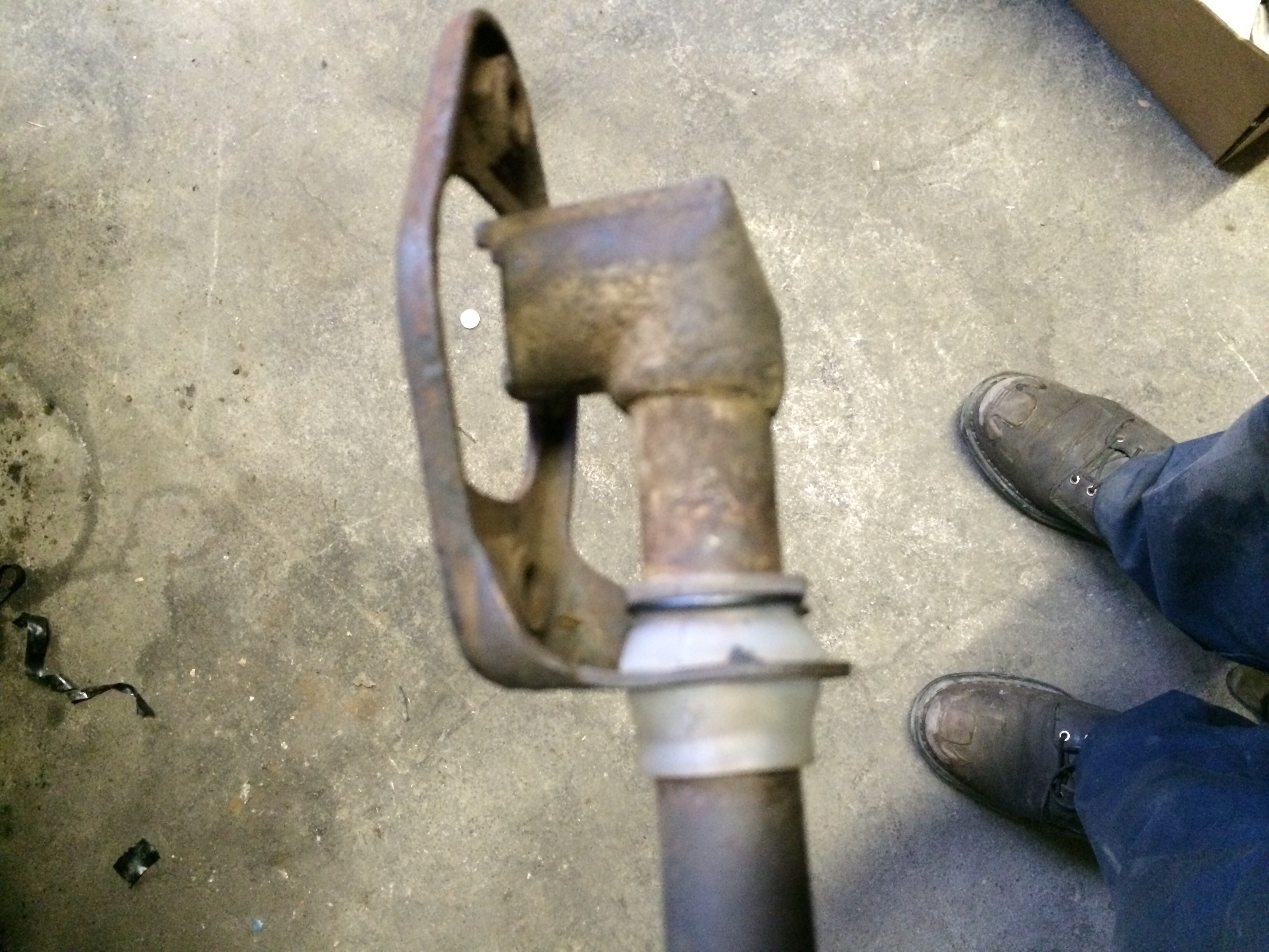

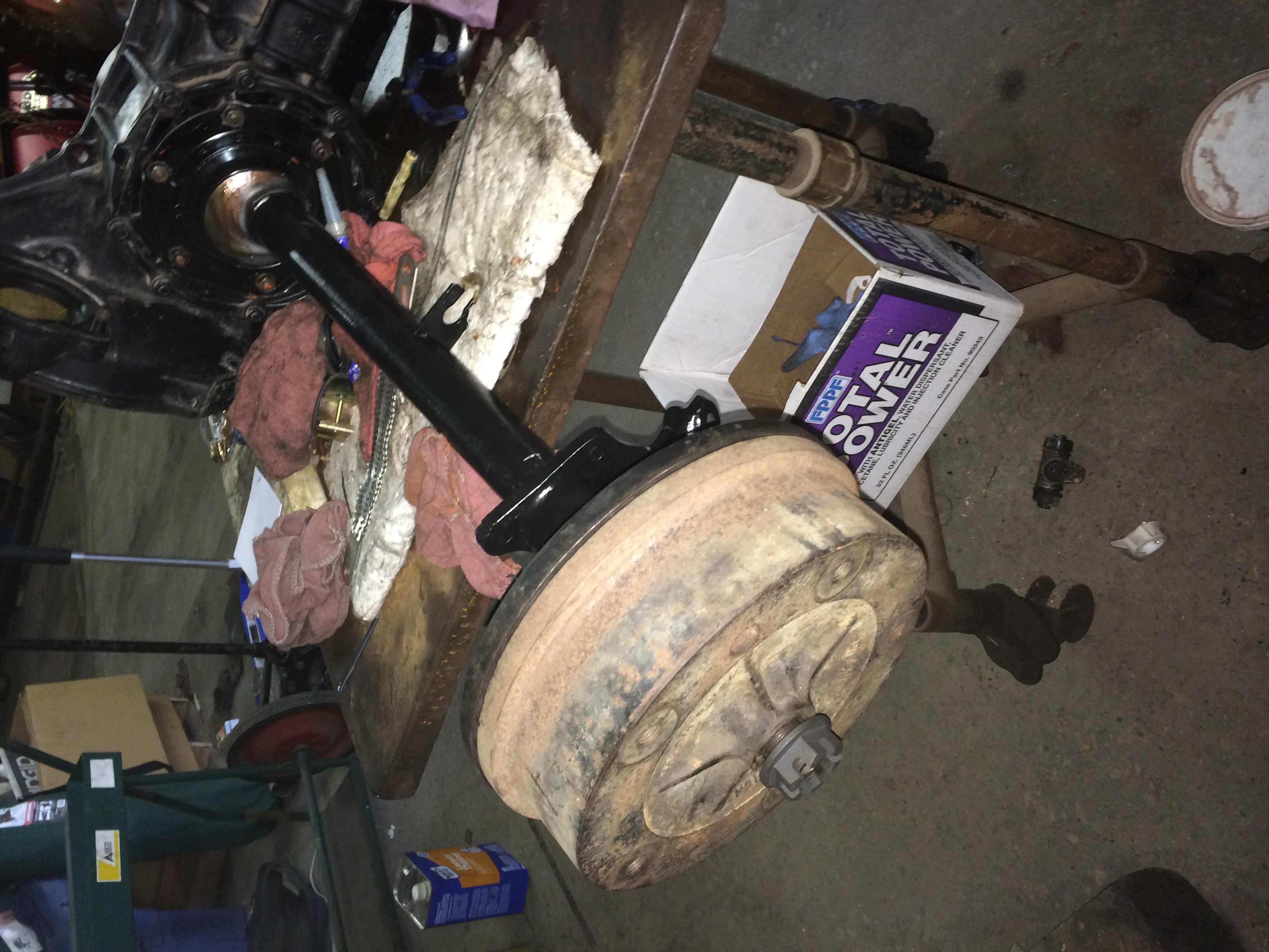

So not to many pictures. For the setup i needed I had to swap out axle tubes to a 68' only style. The tubes themselves are the same length as earlier ones but, the end casting where the tubes bolts to the spring plate are offset more and give more clearance. And Widefive's spring plates are great with the built in shock mounts. I also went with IRS beetle backing plates, pads, and late beetle front cylinders in the rear for the most stopping power. Renewed the shift linkages with new plastics guides and couplers. What a difference over the old sloppy shifting! Got the front end all set but need to adjust the drag link some to get the wheel straightned out. Just have to get it on the ground. Put the new Kennedy clutch and new pressure plate on. Get motor in and measure for shocks. Getting close to rolling again.... Finally...
The plastic shift bushing on the front shift rod. Snap ring goes on the front side and the two bushings go on the rear shift rod for my bus. Earlier buses and later buses have different setups.
Thing drums on the rear

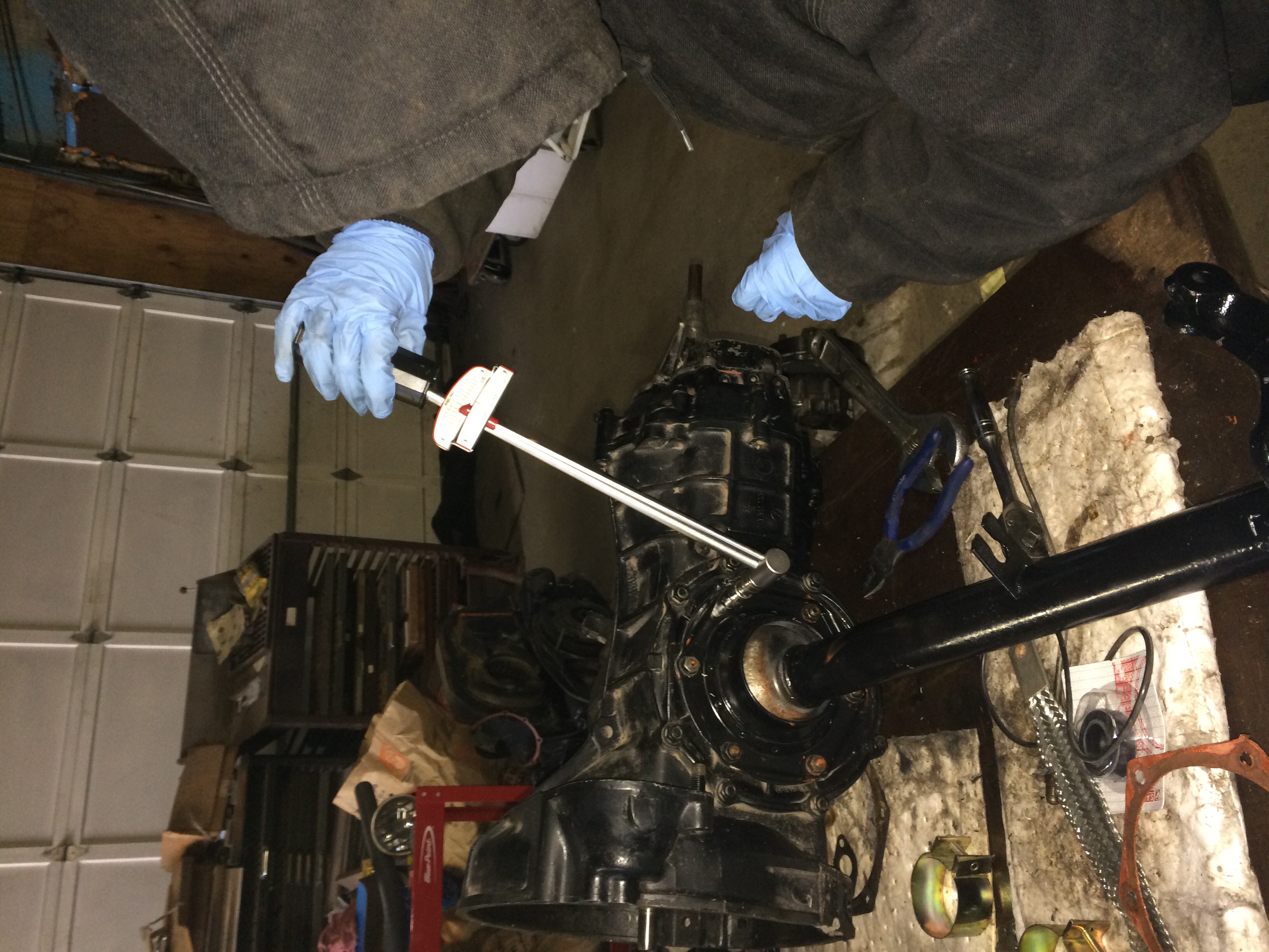

Nicole helping out by torquing down the the tubes.
