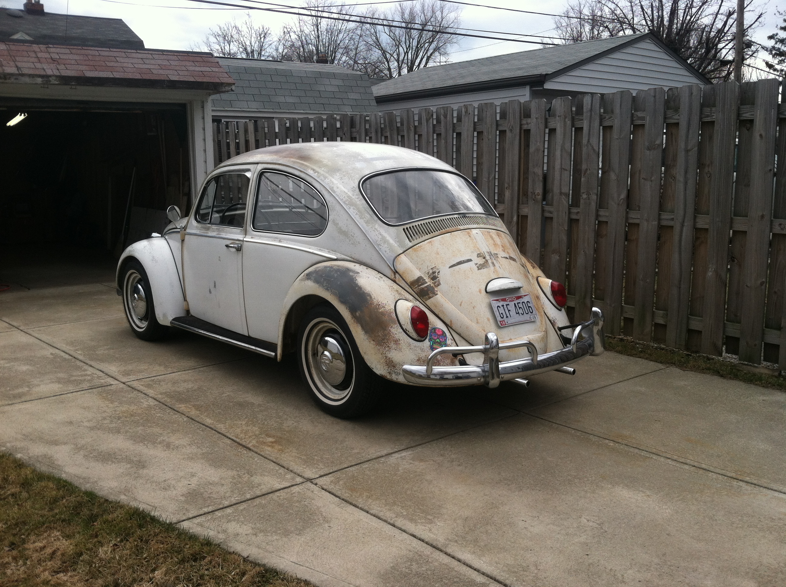

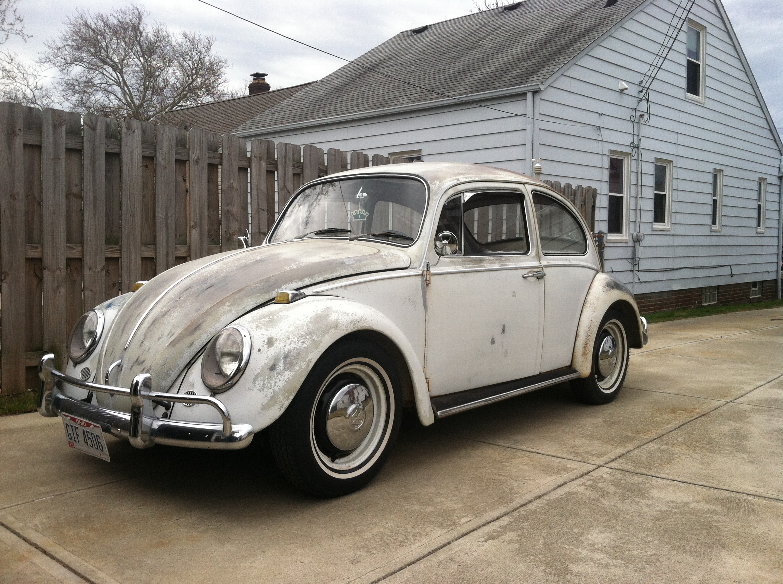

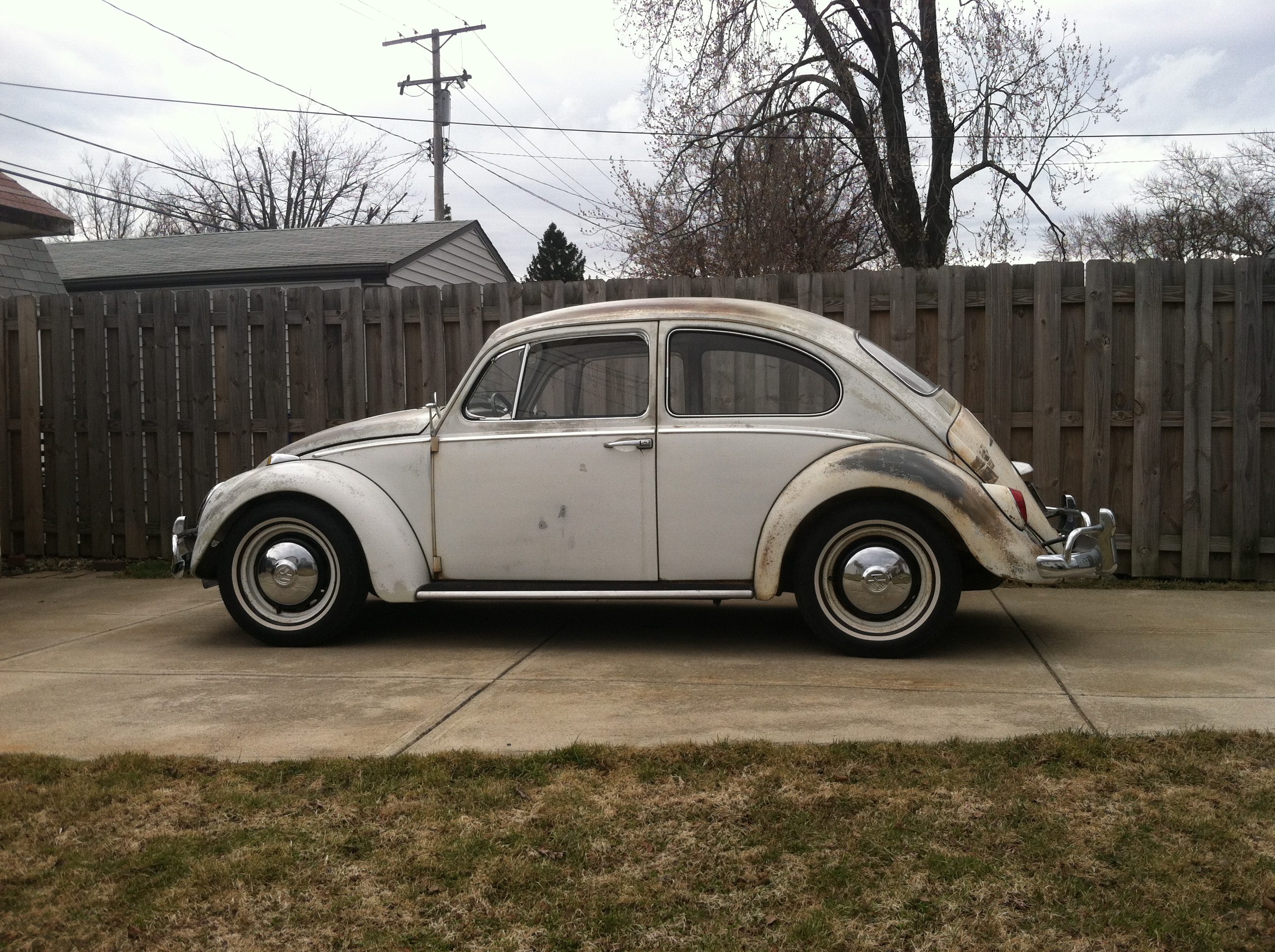

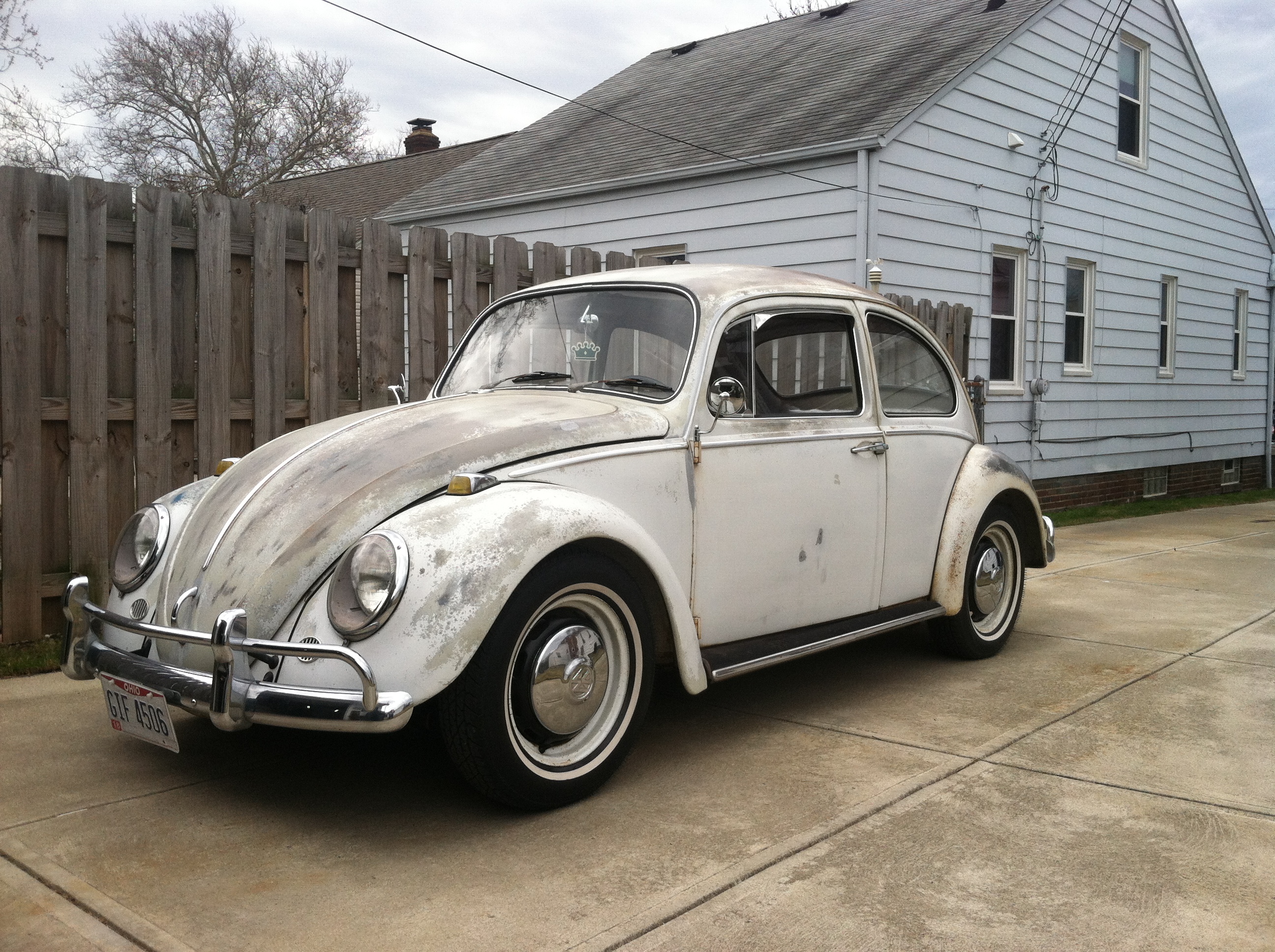

I've put some really good miles on the car the last couple of weeks. Runs awesome once you get it hot. Still a few "pops" under acceleration but I'm kind of used to it and it still pulls fine.
The front end seems to be loosening up a little bit but I'm sure that it's not supposed to be that way. So today it's back up on jack stands and the ball joints are being replaced next week. I really wasn't ready to do this again but I just can't stand the wandering and stiff steering.
I've done some more cleaning and the headliner is on it's way to Russ Upholstery for the install in a couple of weeks once I get the front end back together.
Until then, here are some pics from the other day before the rains came.

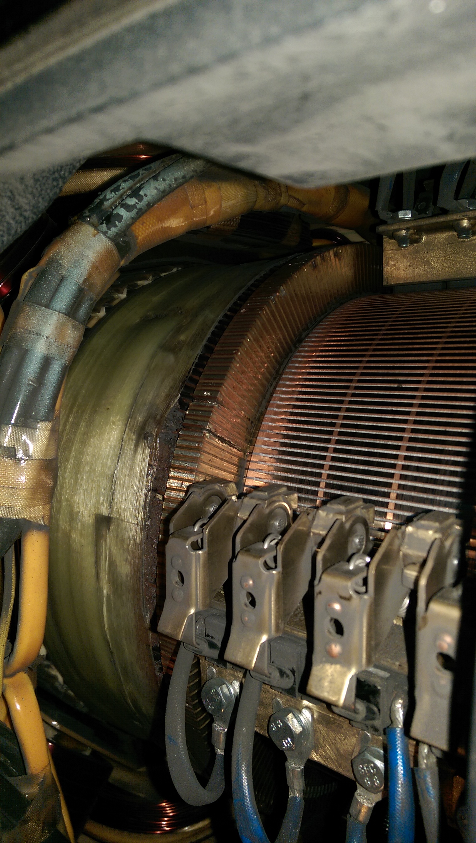

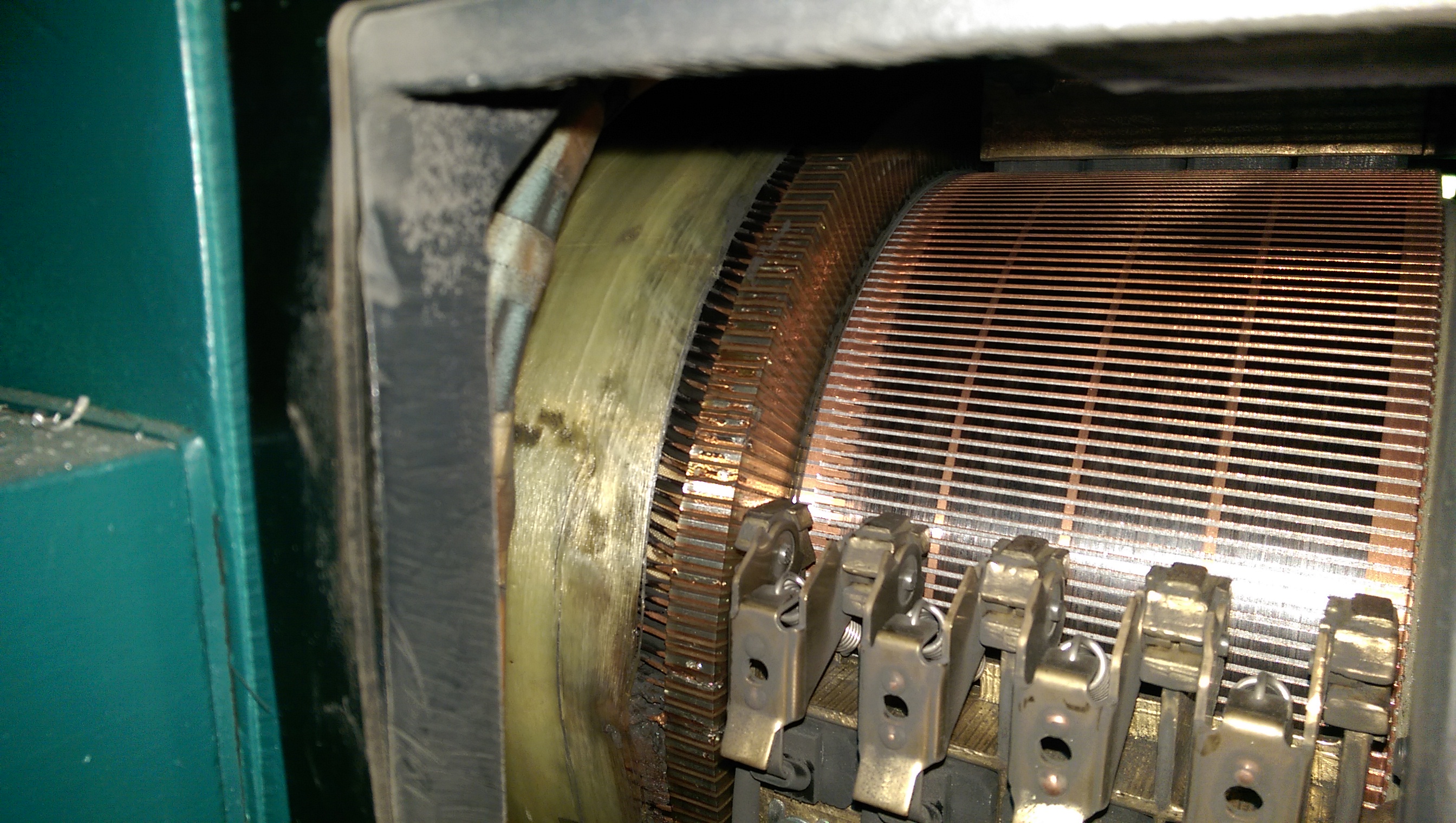

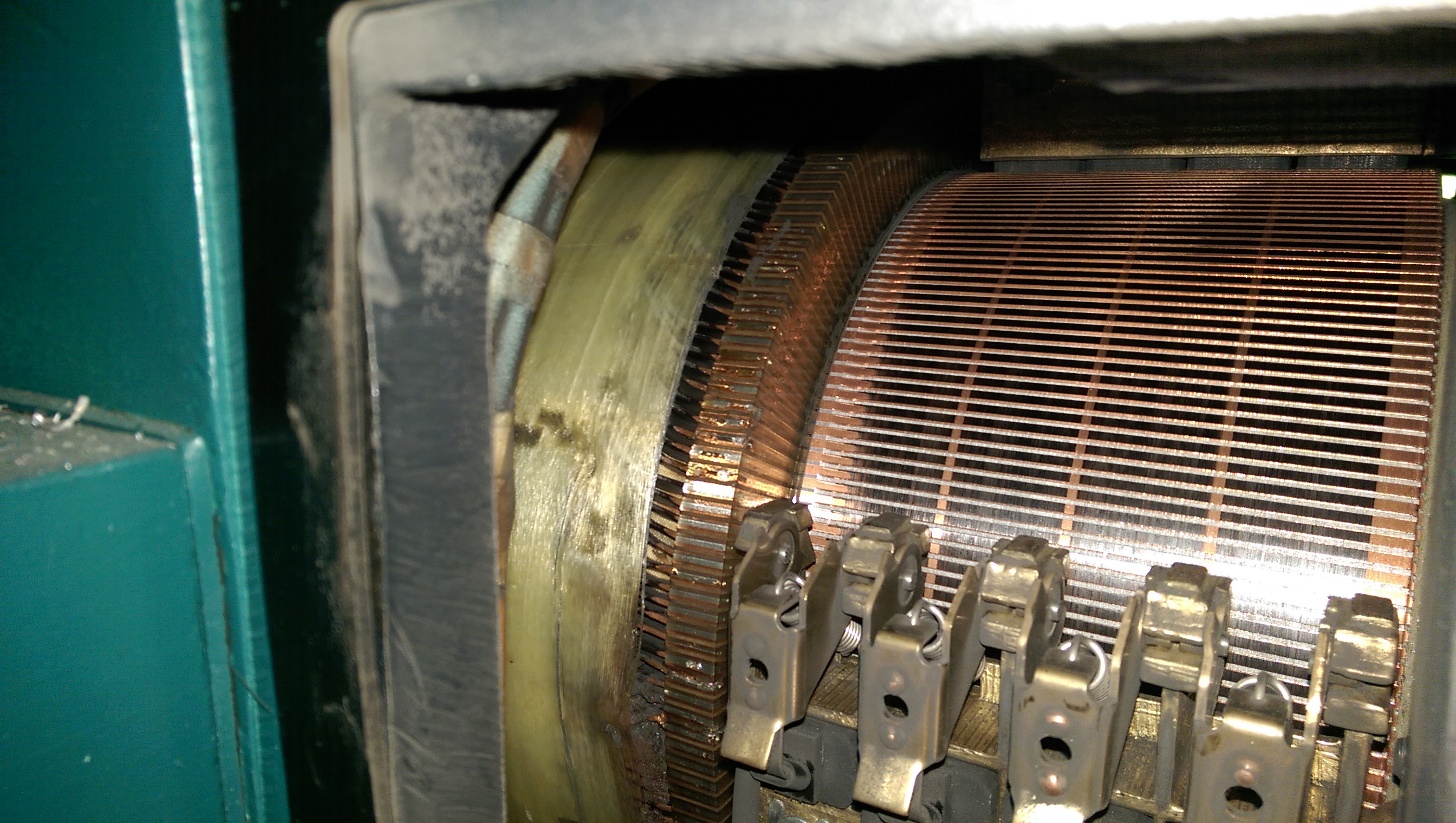

Hopefully your comm does not look like this!!
That was a $35K repair.
