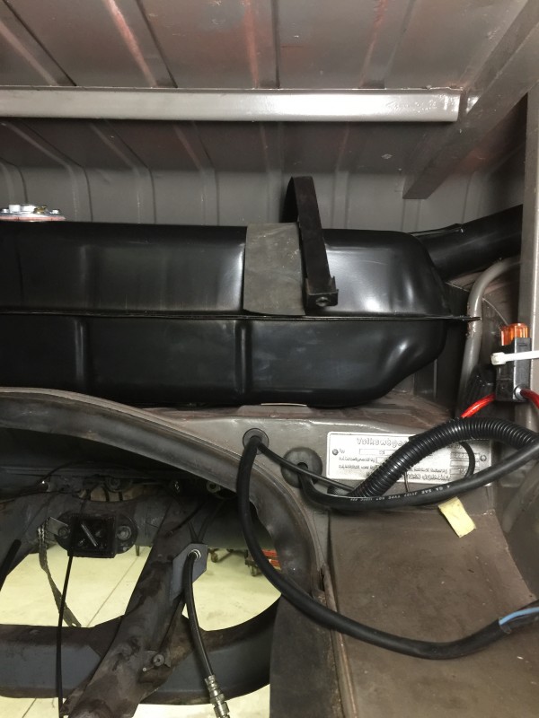

It was a great lessson. We got the new tank in and although it went in like butter, the replacement tank has the fuel outlet about 2 inches off the original, but no big deal. Bruce hooked me up with some great rubberized support for tank and straps. Got the tranny in with Bruce using the Big M*&%$#( channel locks to pull tranny and mount together. We got the spring plates lined up with RGB's using C clamp and persuasion. Good lesson for me. Everything bolted in.

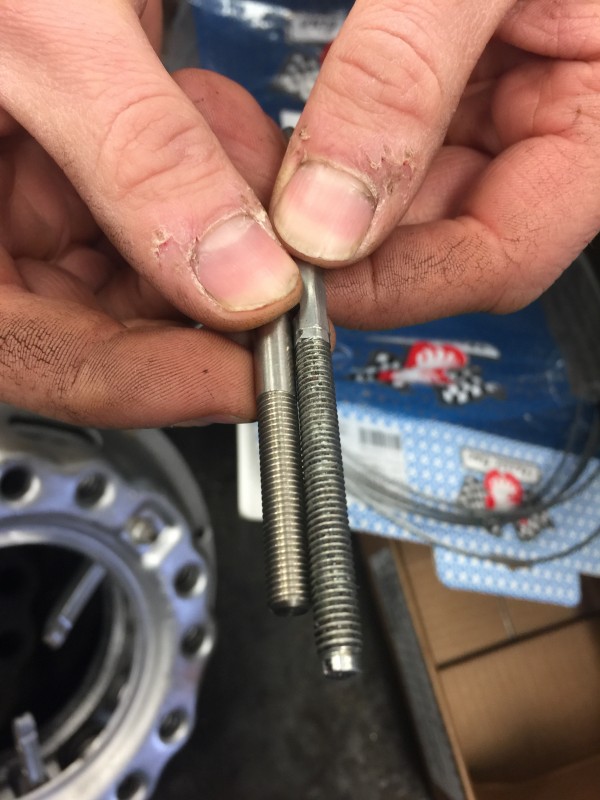

Anyway, I thought I'd try a local reputable clutch company that shall remain nameless and after measuring and cutting have them "swedge" new ends on the cables so they would be like stock. $33 later I've got my shortened cables and the installation goes flawlessly until I pull the brake cable and both "swedges" break free. Thankfully it happened inside the shop and not when I was hurting down a hill at 50mph with no brakes. :shock:

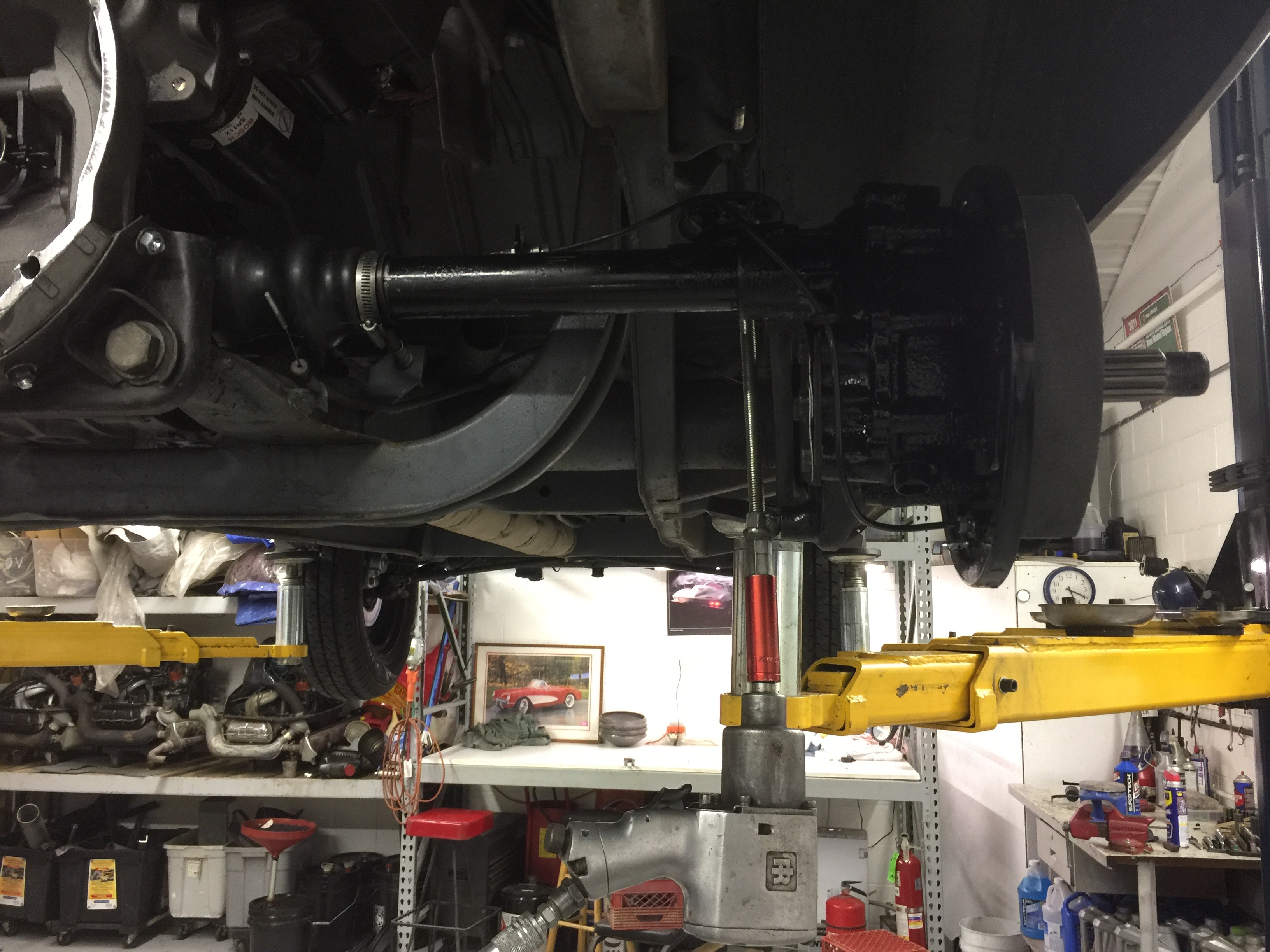

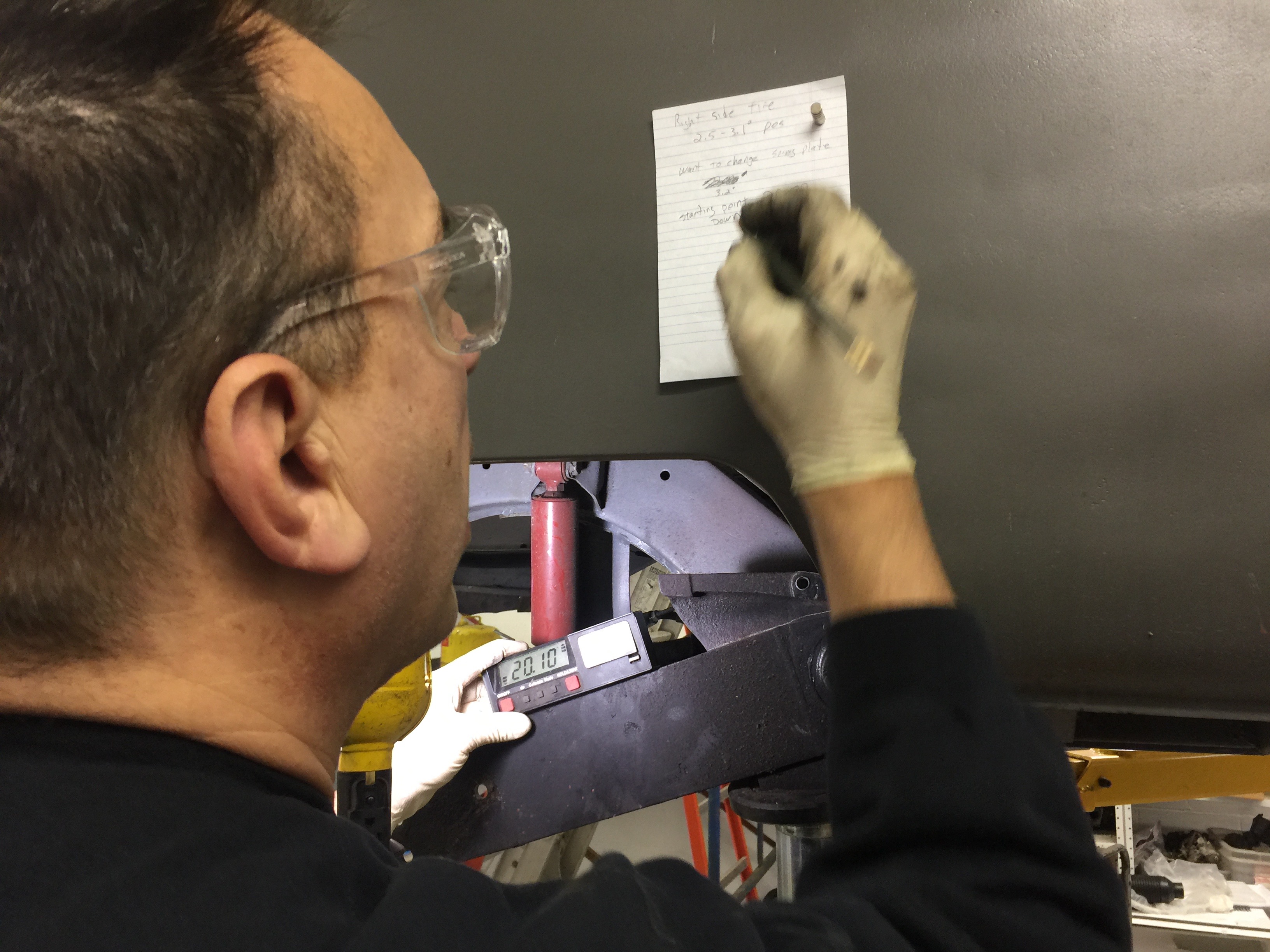

Bruce got the axle seals all buttoned up with a nice technique of leveling the axles with a gizmo he put together. I would not try this at home! :o

This was Bruce's method of leveling the axles.
This was the replacement threaded end that failed (one on left) (I'm going to buy that mechanic some Jergens.)
