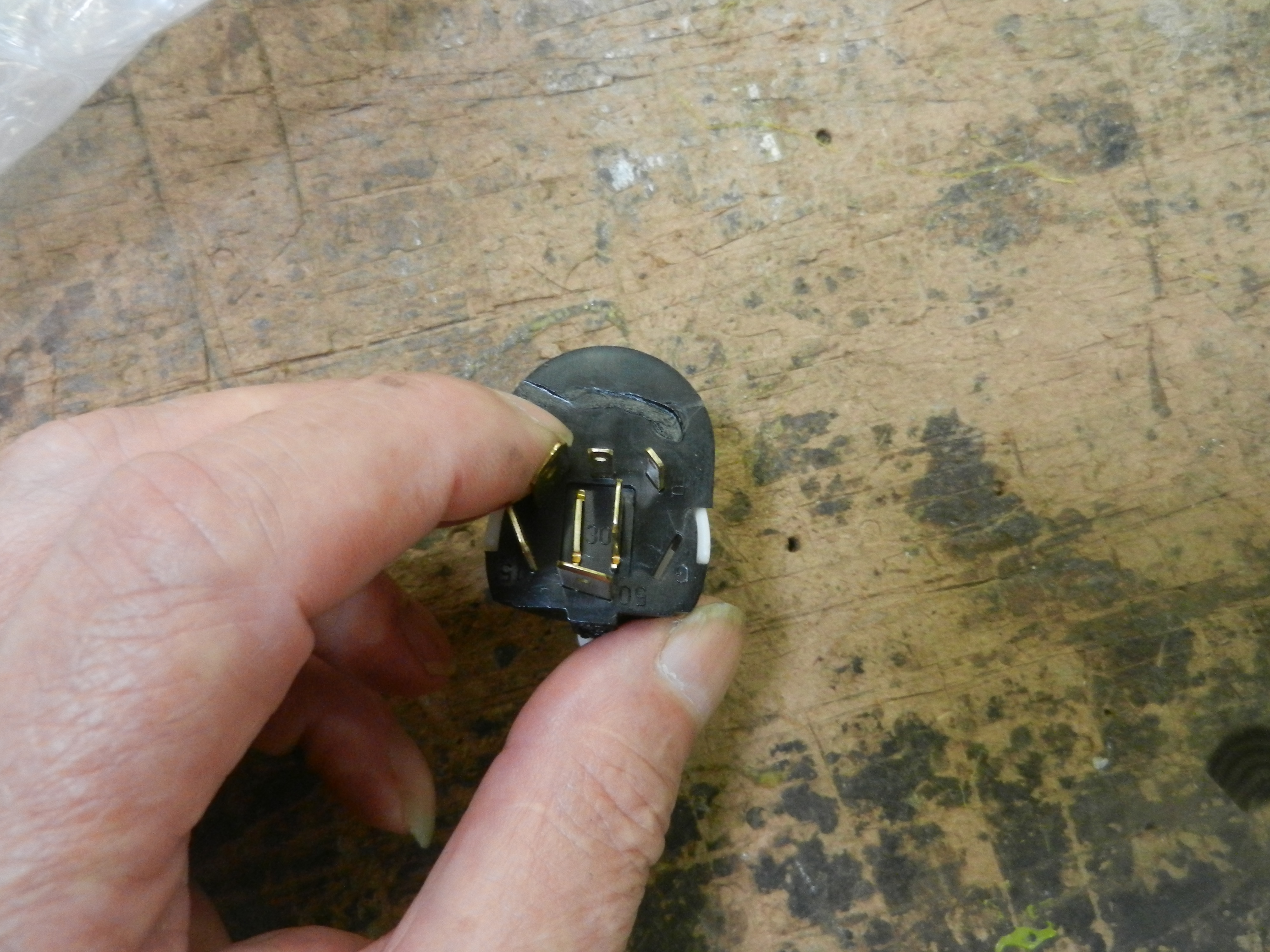

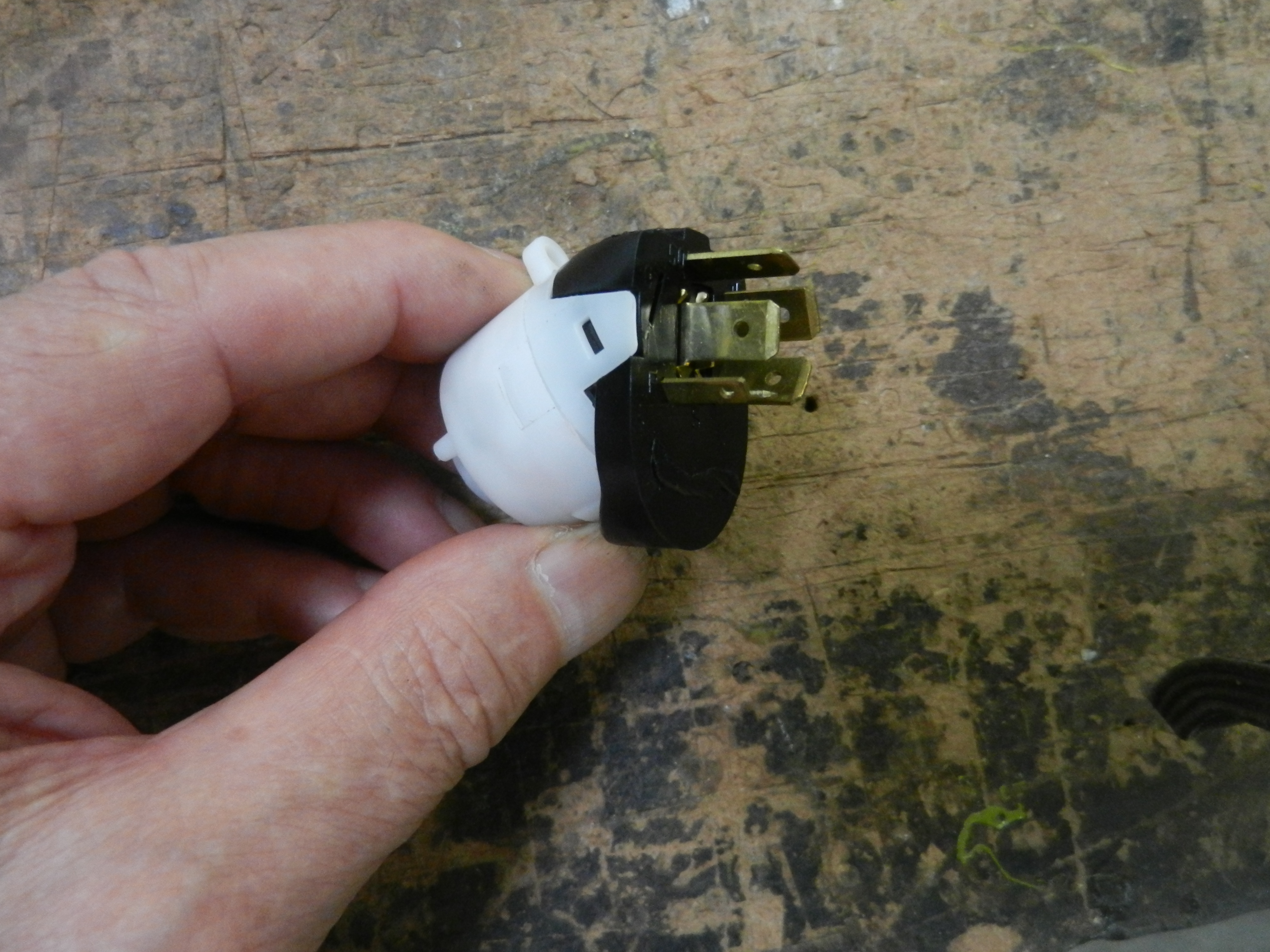

This is the Kostel ign switch. VW pt# will be ground off.

Bus Depot advised me today the German Ignition switch I ordered is back ordered indefinitely, so I canceled that order and ordered the Kostel switch from Airhead.
