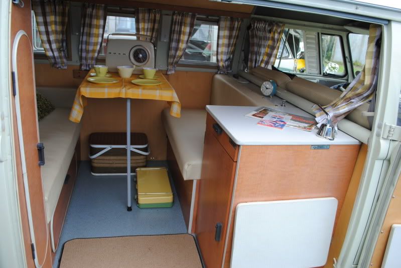

Hi Craig, They do look really nice in the flesh so to speak i know a few people who have bought them and are really pleased , a very very good copy , go for it65Westy wrote:Thanks Philip.... I actually just got an email back from her. I had inquired about shipping costs. My wife & I have been looking at her curtains trying to decide if we should do it or not. Do they look as nice in person as they do from her website?
This is mine with the japanese ones and Joanne's are exactly the same
Love your westy by the way Pearl White is always nice but then im biased , have you got a paint code sticker behind the passenger seat ? if not ive a spare one & will send it off to SixVolt with the rest of the stickers

Philip, your Westy looks pretty sweet, too.
Your curtains look great. I have just a few remnants of the original curtains from mine. The years of being out in the sun sure made them very brittle and faded. The bungee cords are gone and we were trying to figure out what color looks best. Looks like you have white?

Hi Craig, had the same problem as you with the curtains also my bungees were white but decided to try & go as original as possible so ordered a set from Josh
http://www.thesamba.com/vw/classifieds/ ... ?id=985081 i went for Tan colour as they seem to blend in just right with the curtains
if you ever need any help UK wise please give me a shout more then willing to help
ps i see you have the correct clam shell light covers are these og to the bus ?

Philip, thanks for the recommendation on the curtains. I'm gonna get them ordered soon and the tan bungee cords, too. Yes, the clam shell lights are original to the bus. When I bought the bus, it had been apart for some time. This is my first attempt with a bus (last year I finished a 3 year restoration of a 56 Beetle) and it was challenging to sort thru all the boxes of "stuff" that came with it trying to figure out what goes where. I still have a few things that I'm not sure of. About the only thing that was missing was the rear facing seat & icebox. I located a 66 Westy that was pretty rusty, but the interior was complete. When I first got the bus, I nearly thru out this old, faded canvas piece of material that was folded up at the bottom of a box. Turned out to be the child's cot! My wife & I are anxious to go camping with it now with our 5 year old grandson.
