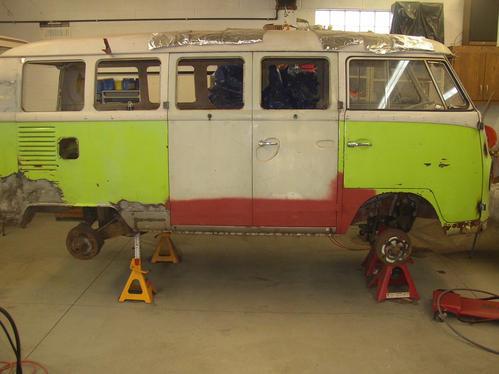

OK, here's what's going on lately:

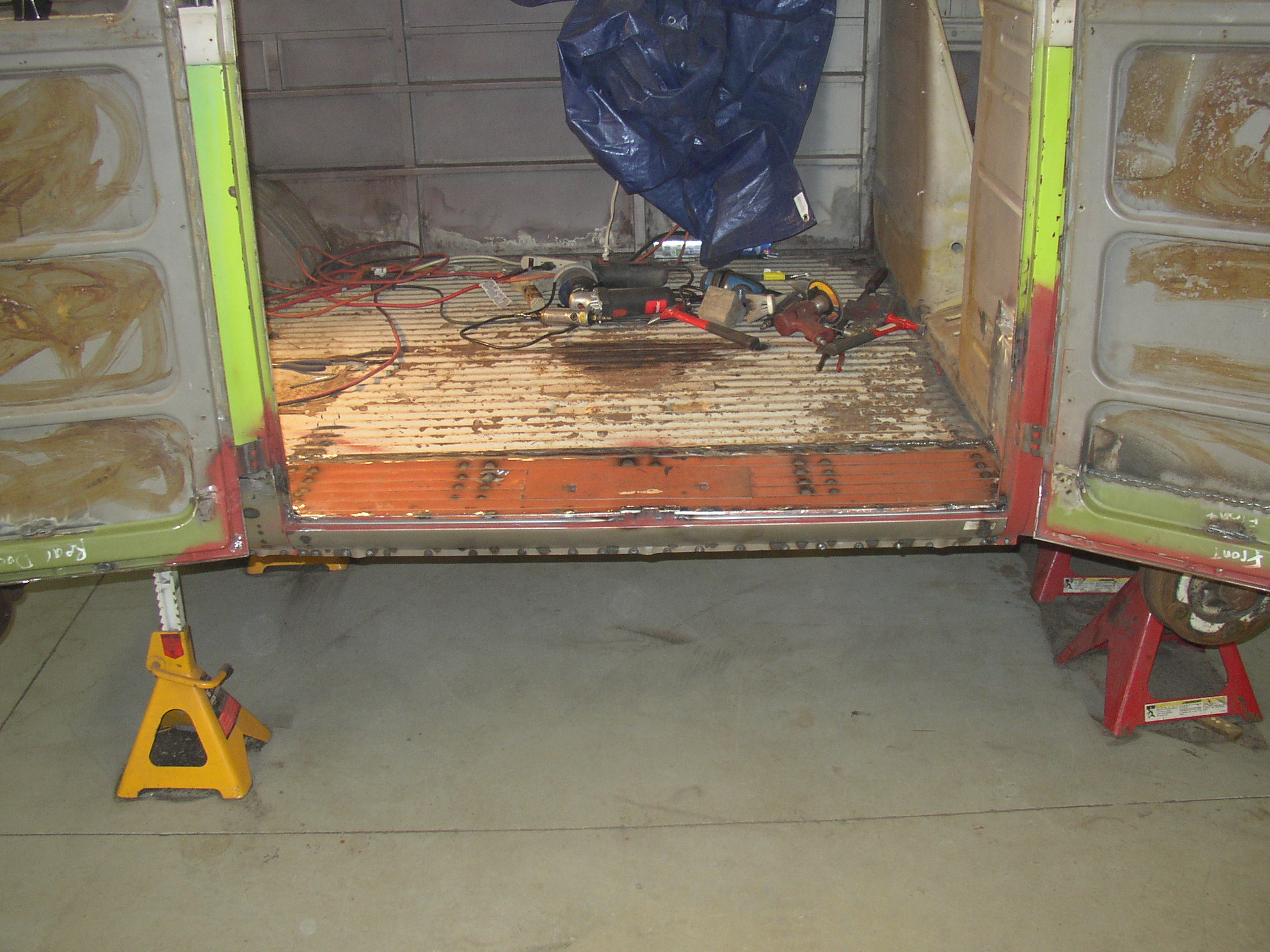

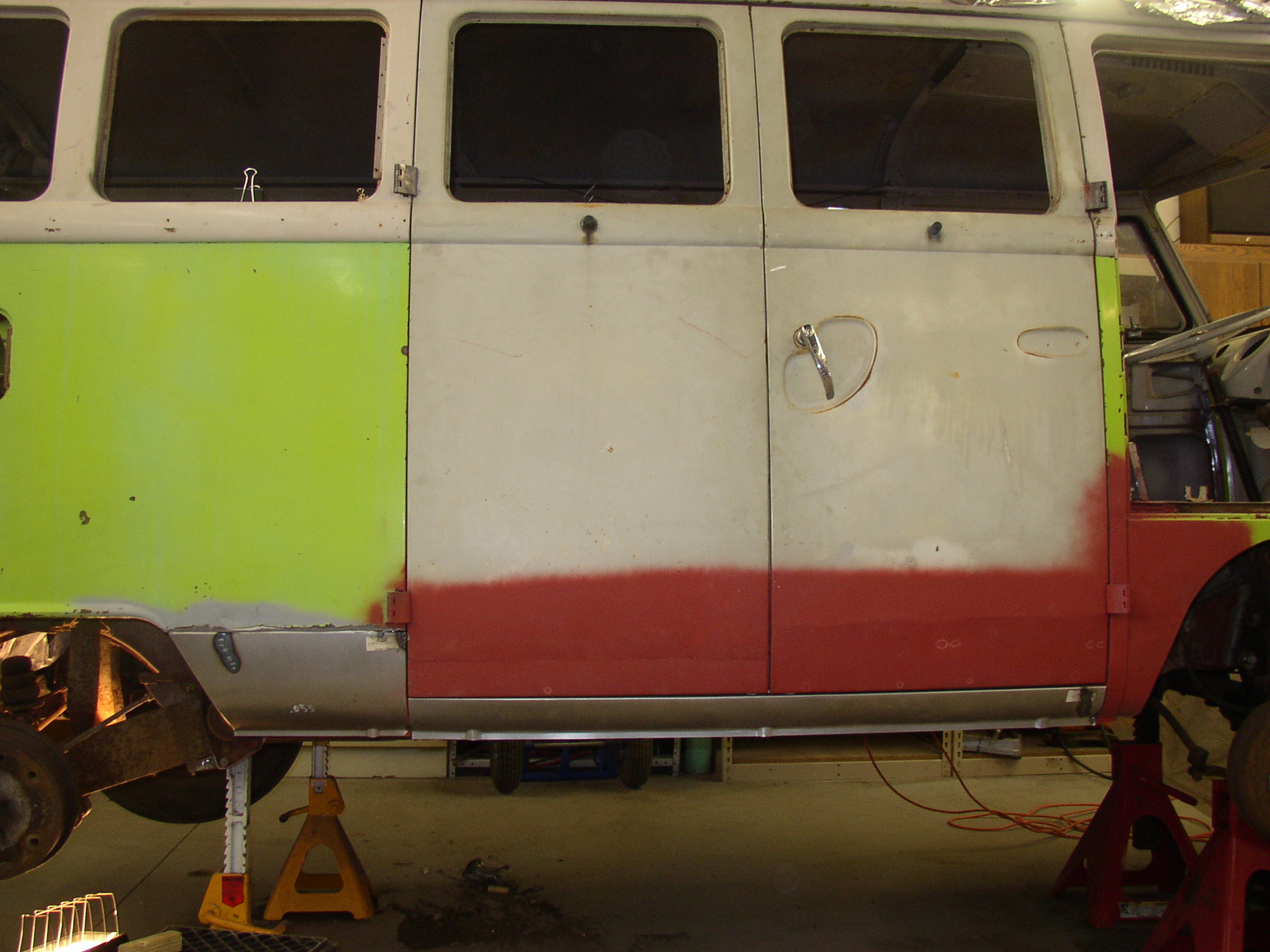

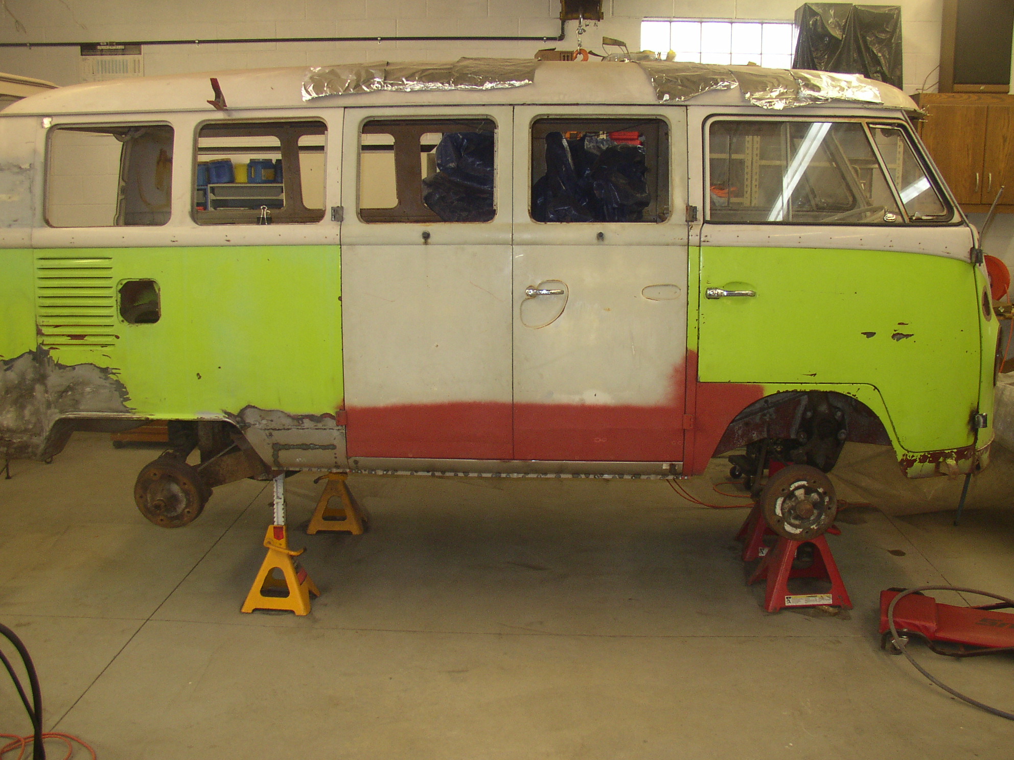

I got a lot done, pretty much finishing the cargo door/right floor/right rocker area. I did a lot of fitting and welding and I'm happy with how things look. The doors look and fit very well.

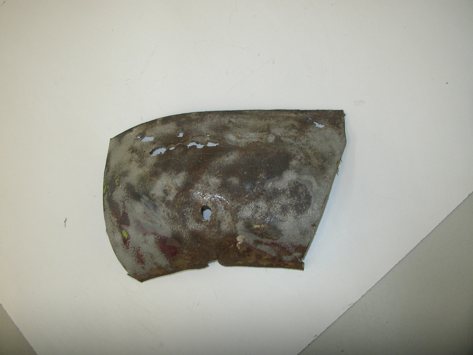

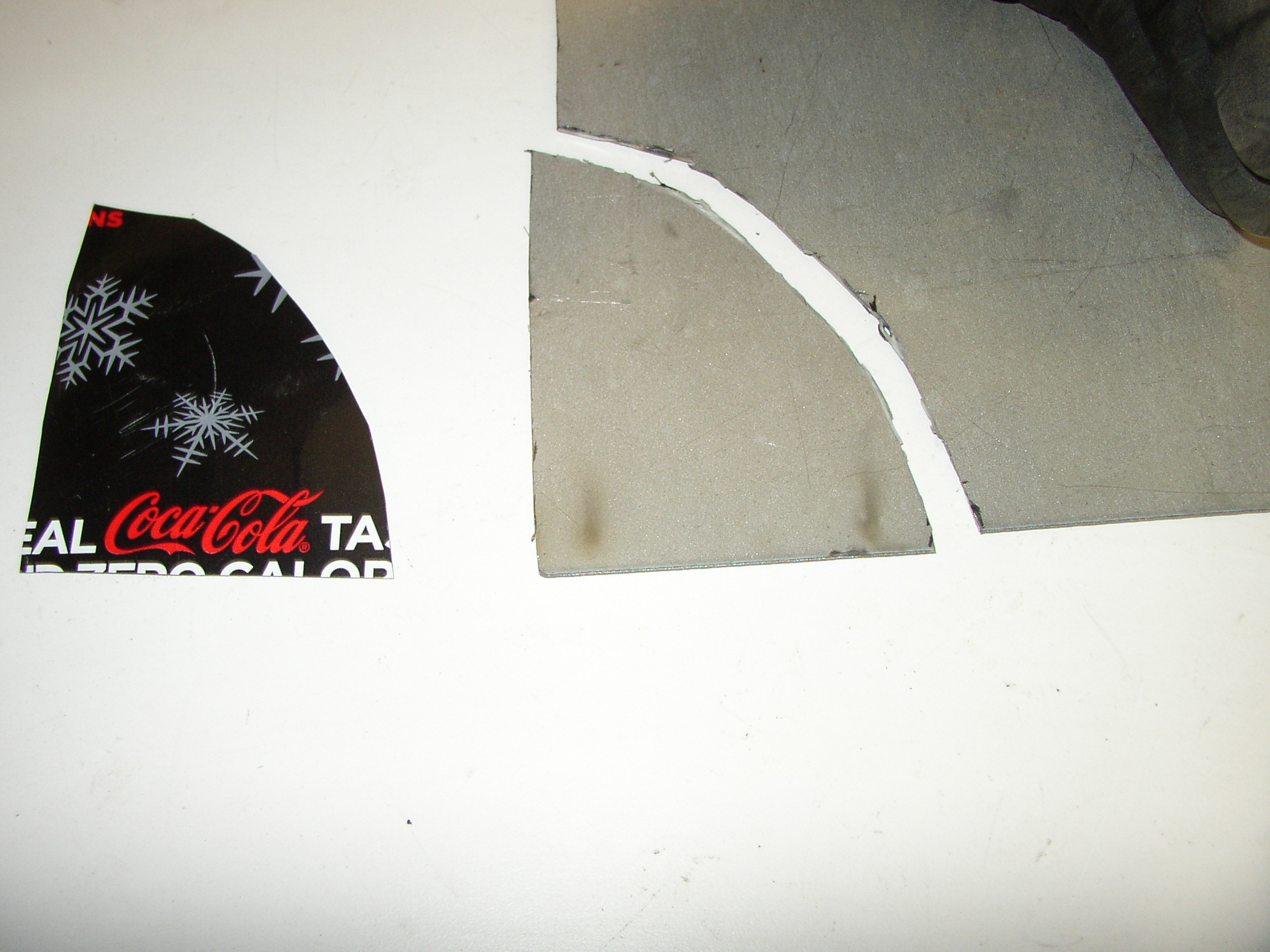

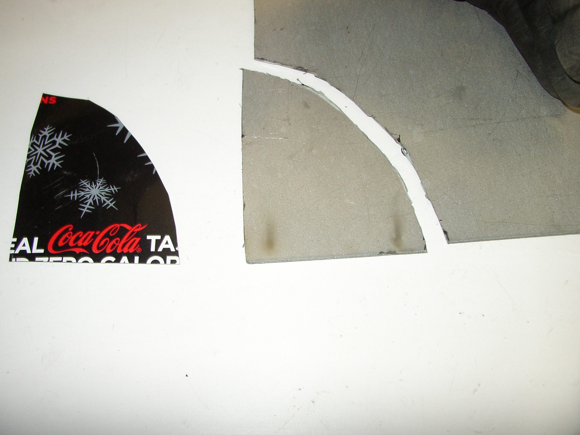

Everyone knows the tip of fitting a piece by making a cardboard template:

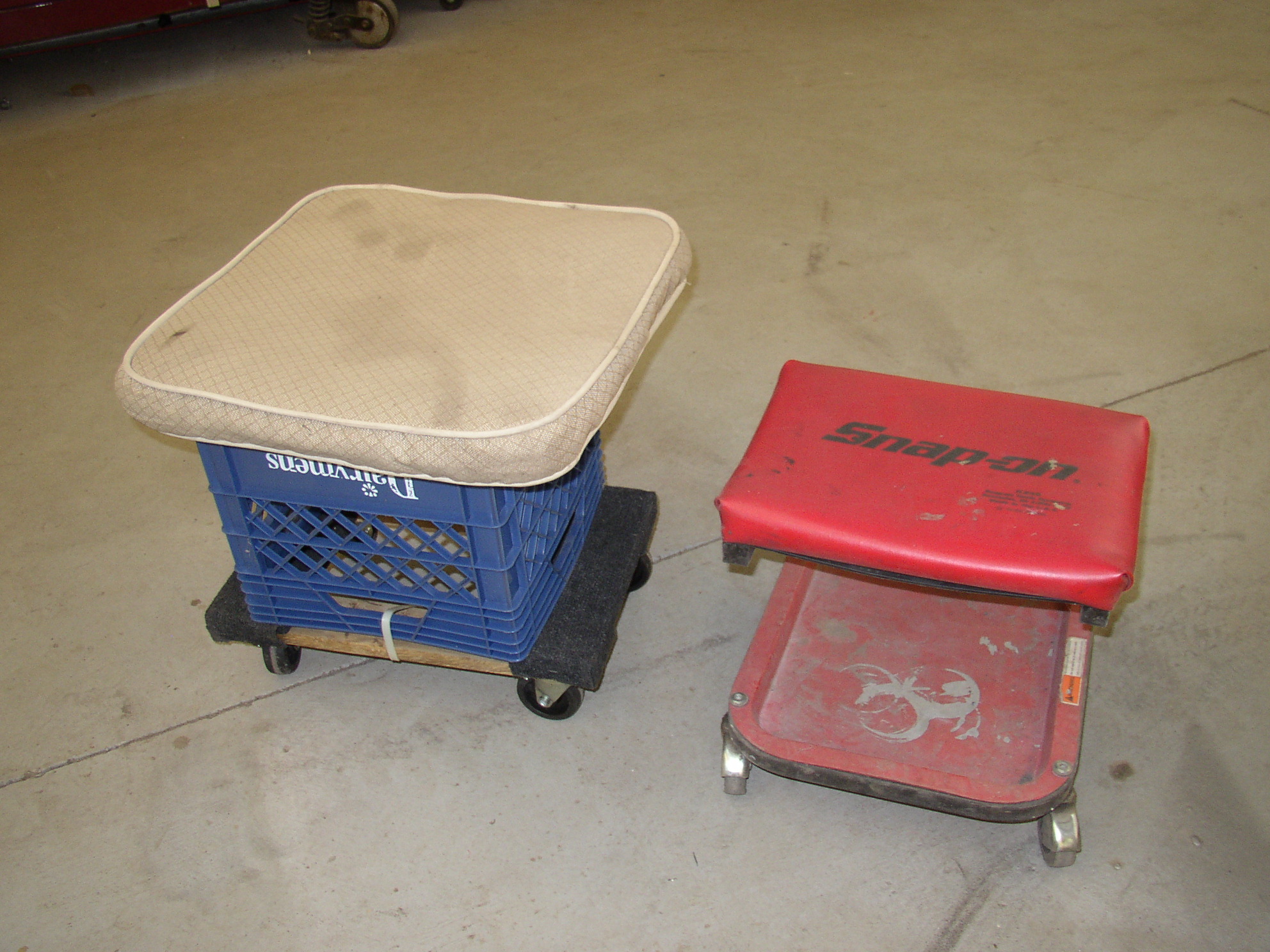

I love those Snappy roller carts, but they don't make a HD version for my fat ass. Here's my $9 version that works better than Snappy:

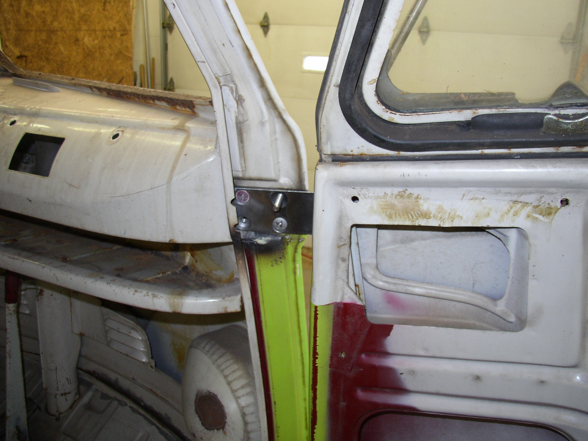

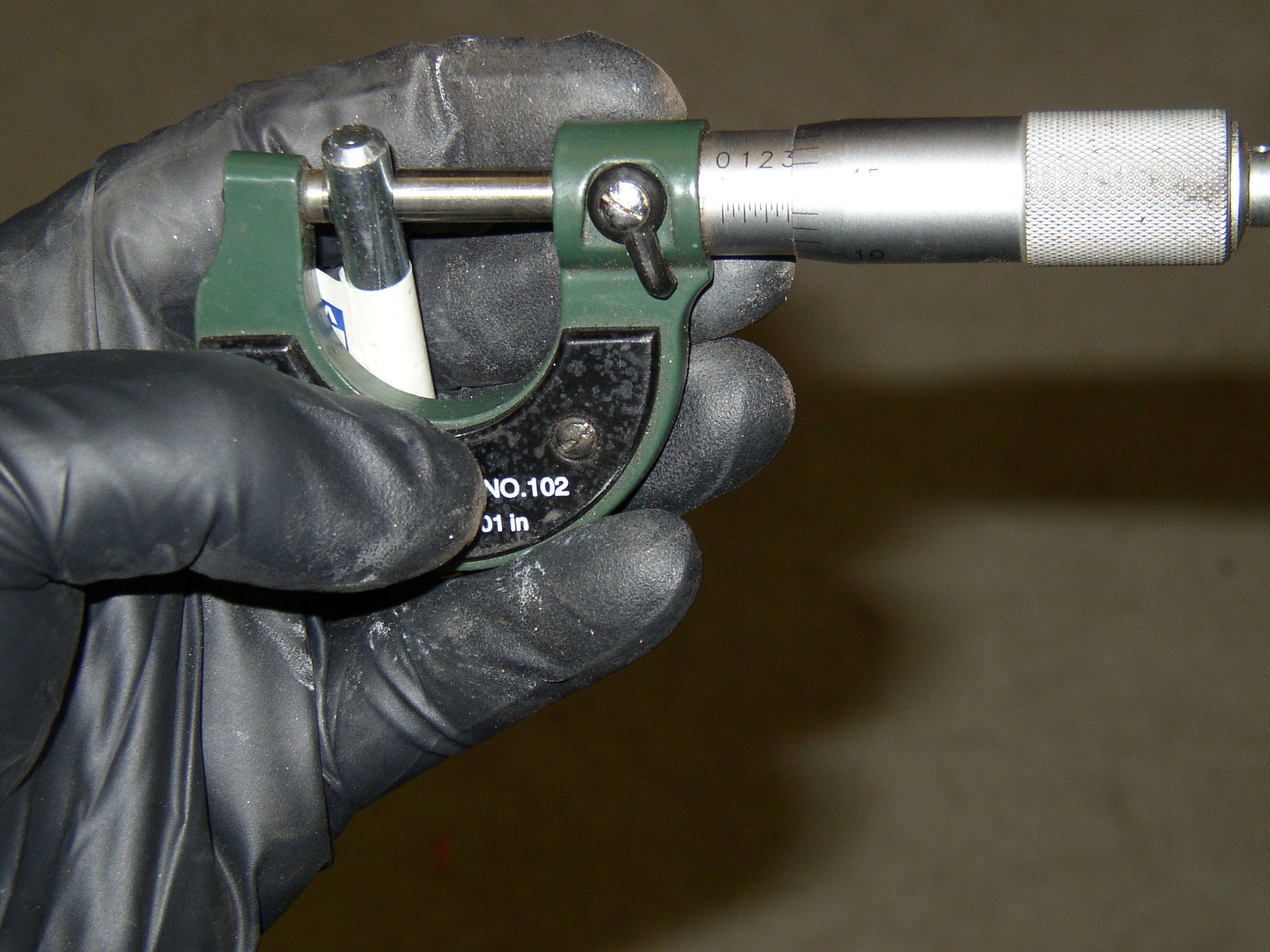

I took the RF door off and redid the pins. The pins were seized, of course, requiring glowing them to get them out. Then I found the holes were worn too large for standard pins but not big enough for oversize.

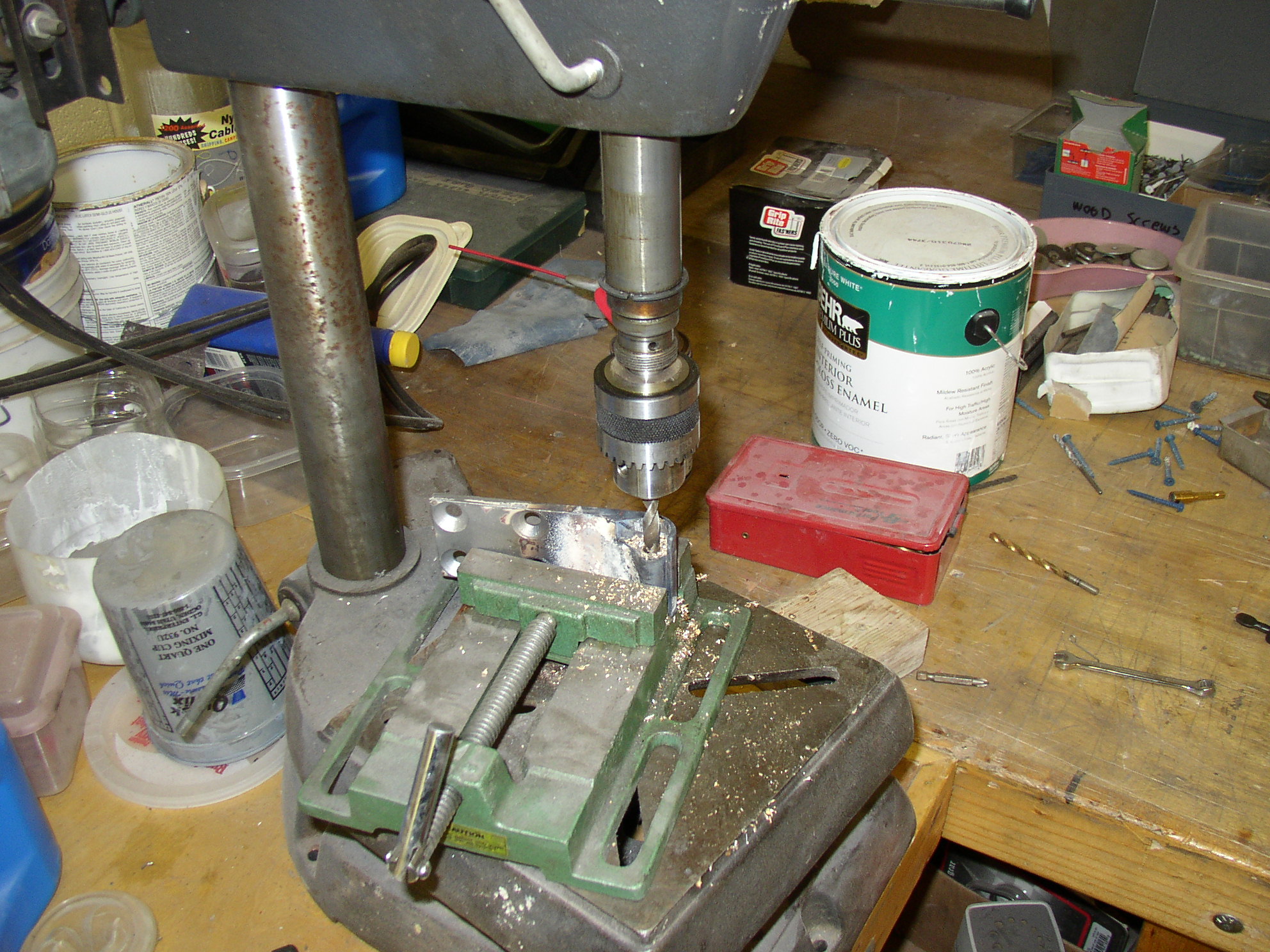

My fix for that is to braze the hole smaller. This serves two purposes- it lets me resize the hole, plus it gives me a brass surface which is like a built-in bushing:

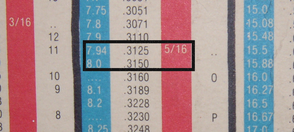

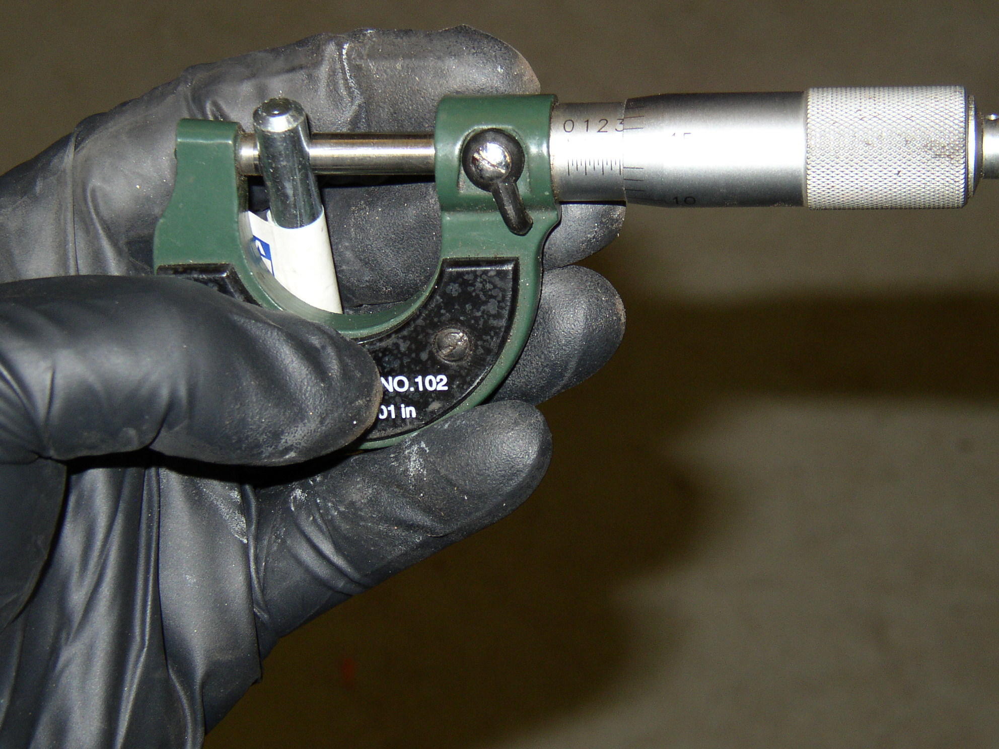

The standard pin is 8mm, which mikes out to .314":
My handy dandy chart shows 5/16" to be .0025" smaller than 8mm:
I now drill it out to 5/16". Running the bit at high speed gets me a couple of thou oversize so the pin fits nice:
Don't forget a small lube hole so I can lube them after the paint is done:

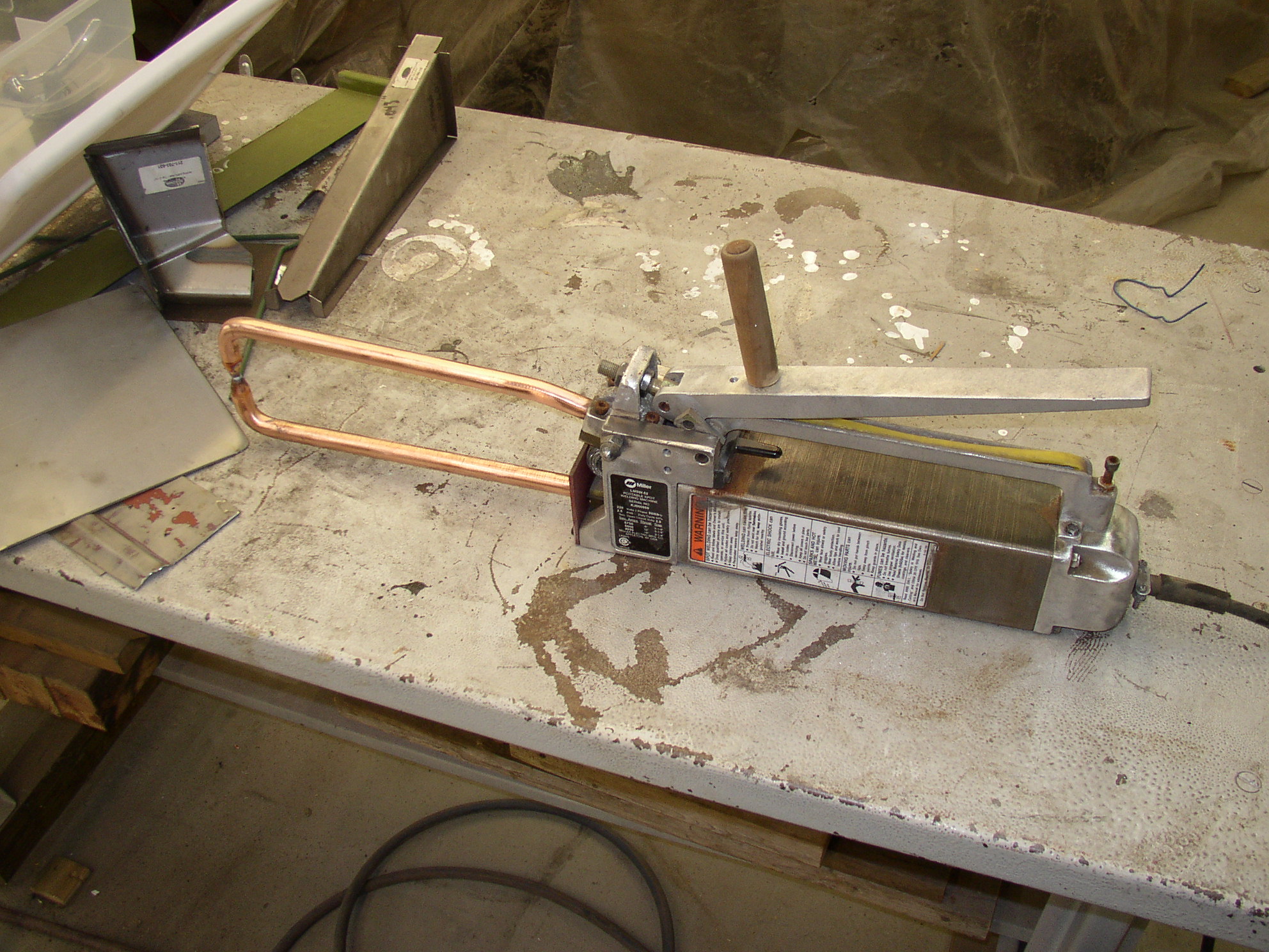

A friend loaned me a NICE Miller 220v spot welder:
This made the lower pinch welds a piece of cake:

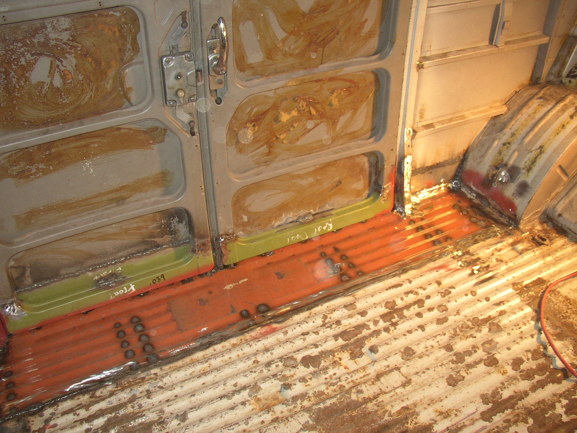

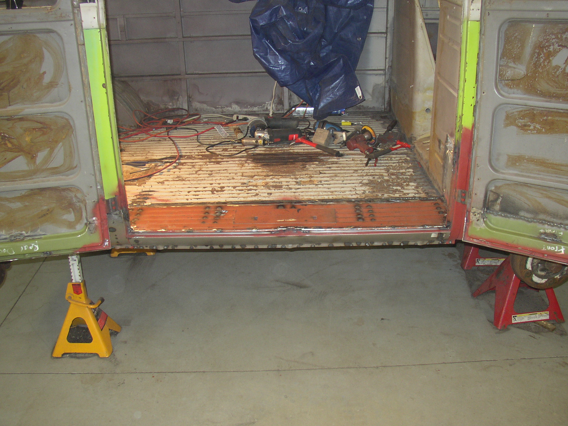

I finally beat that POS brown floor into submission and got it installed. I'll now do a bit of grinding and get on to the RR area, which shouldn't take long. Then comes the long left rocker.....

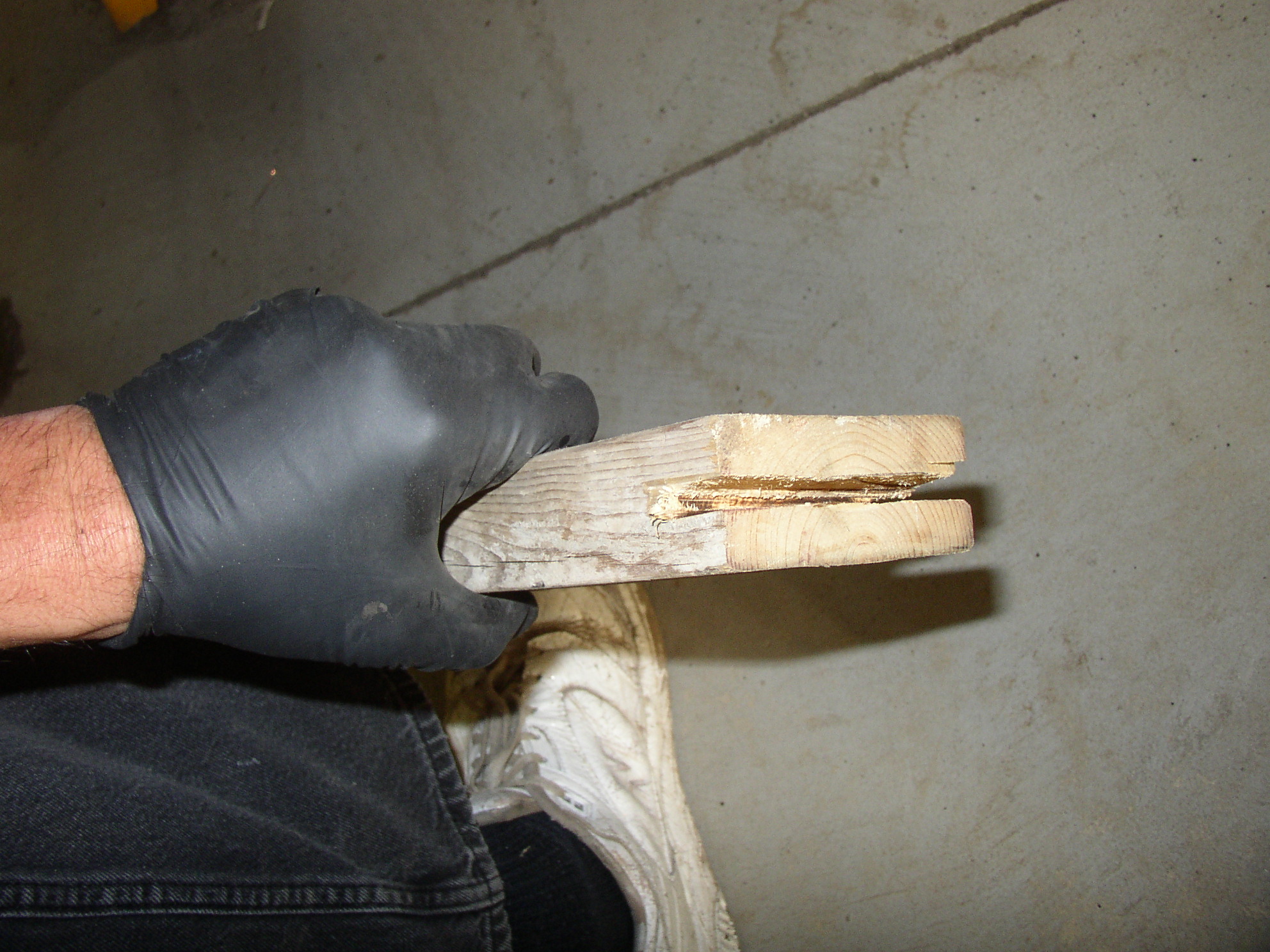

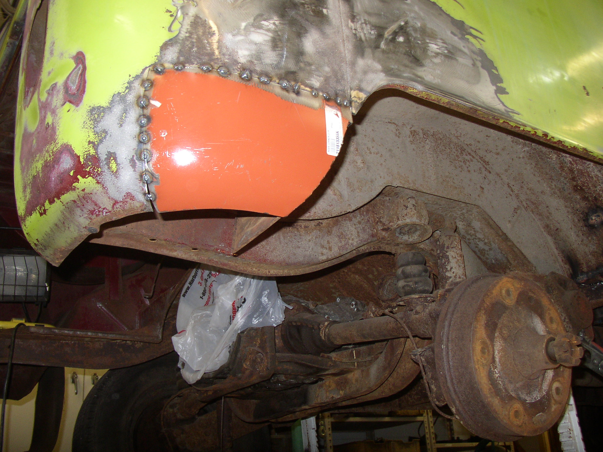

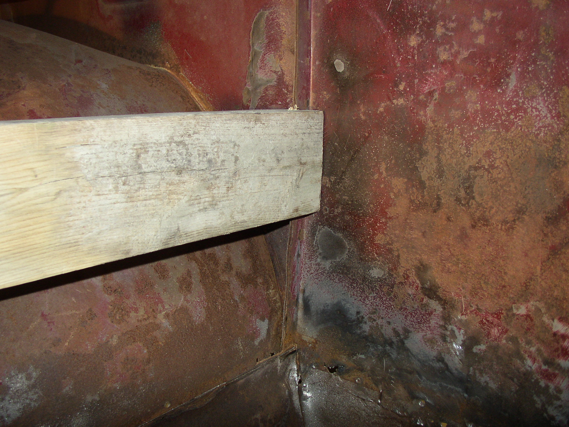

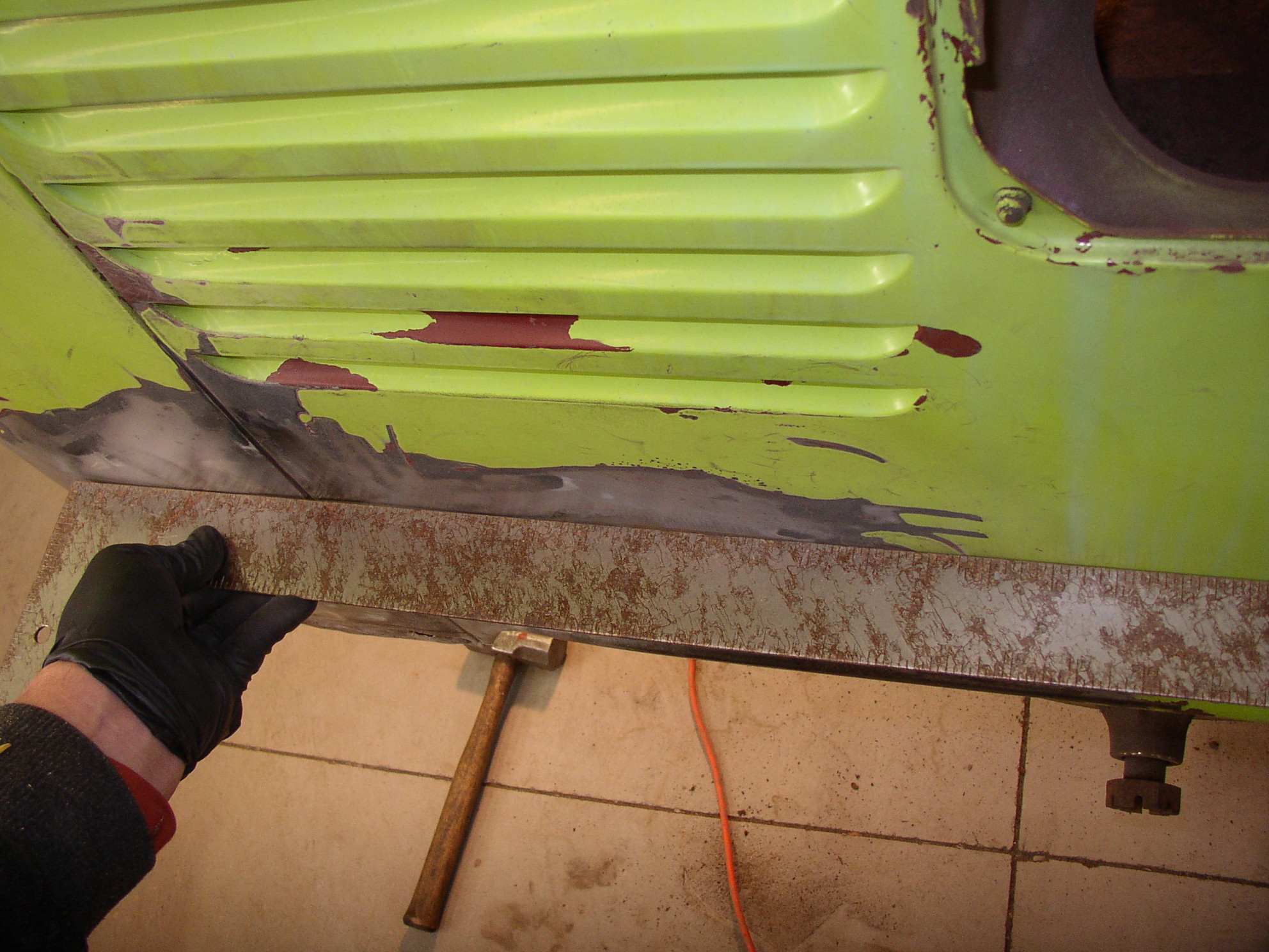

Onto the right rear corner. I still needed to push out some previous body damage, so a 2x4 with a slot cut in the end worked well for pushing right on the seam where the metal was pushed in.
I put the 2x4 against the spot and "work" it with a hammer until it's flush. It was probably pushed in 5/8"-3/4" and filled with mud when I got it.

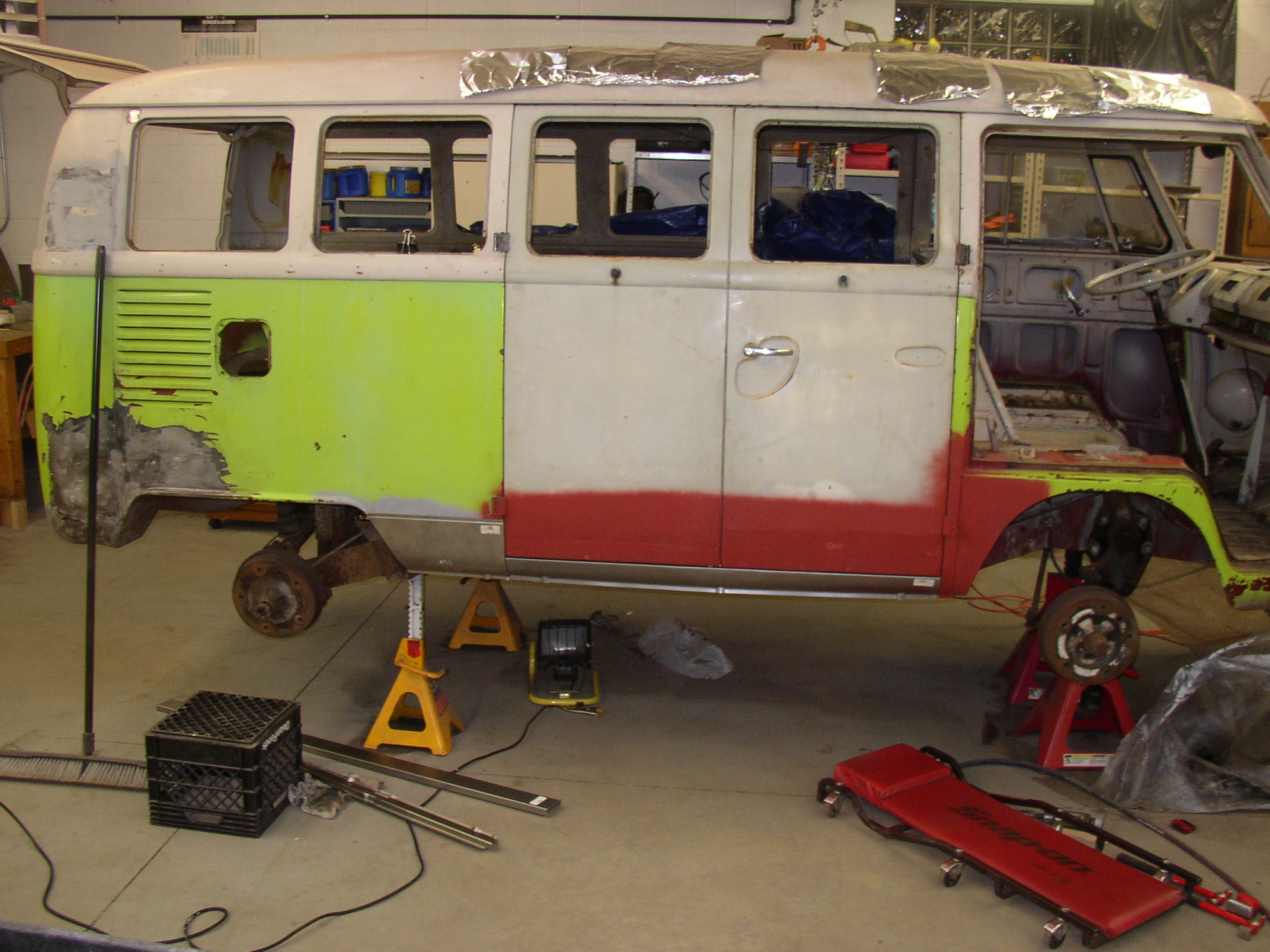

I commonly use a variety of straightedges to check my work 'cause my damn eyes are no good.
This one looks like a big gap, but it's really less than 1/8"
This bus is actually quite straight down the sides, even if you use a big long straightedge.

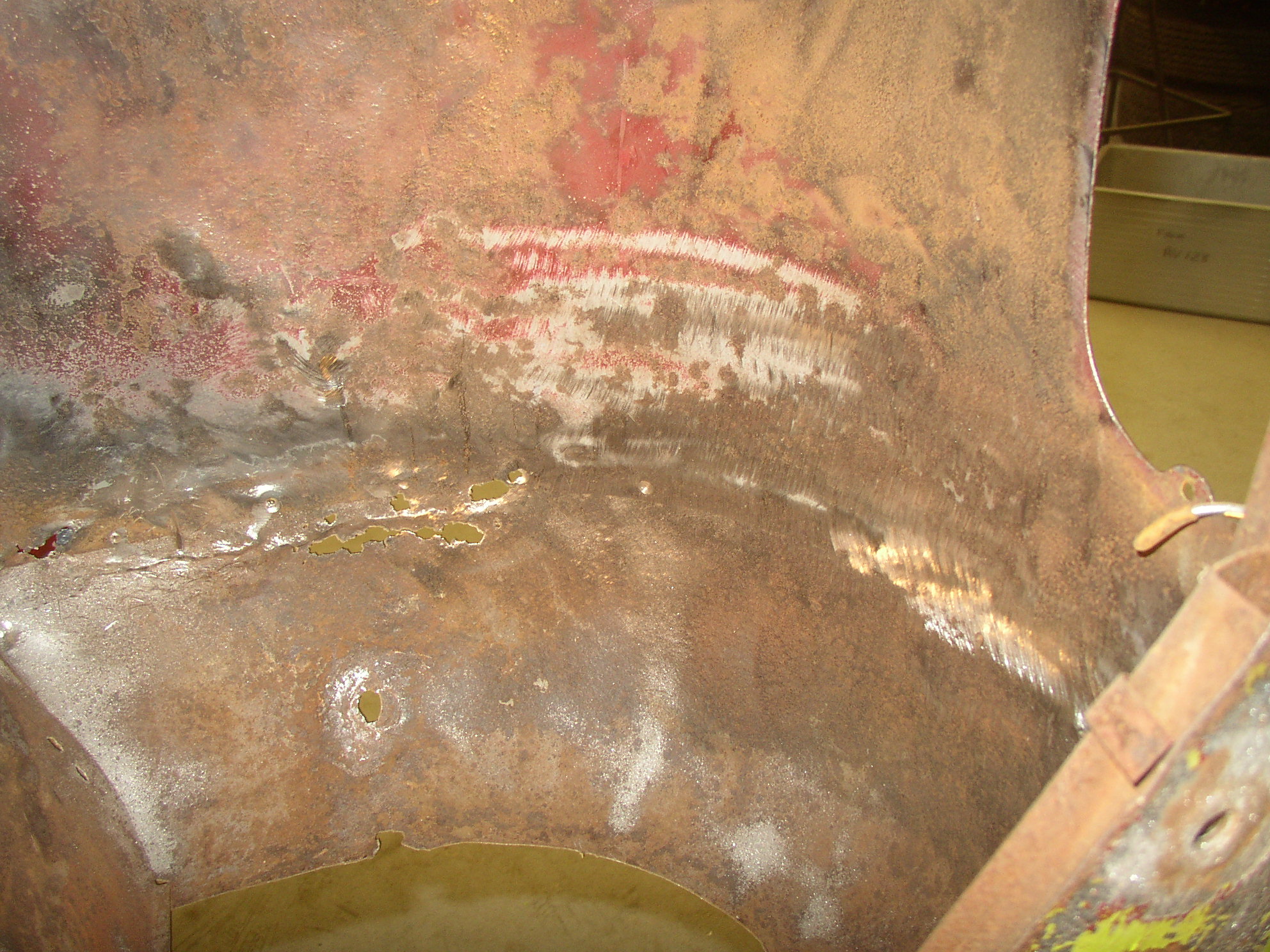

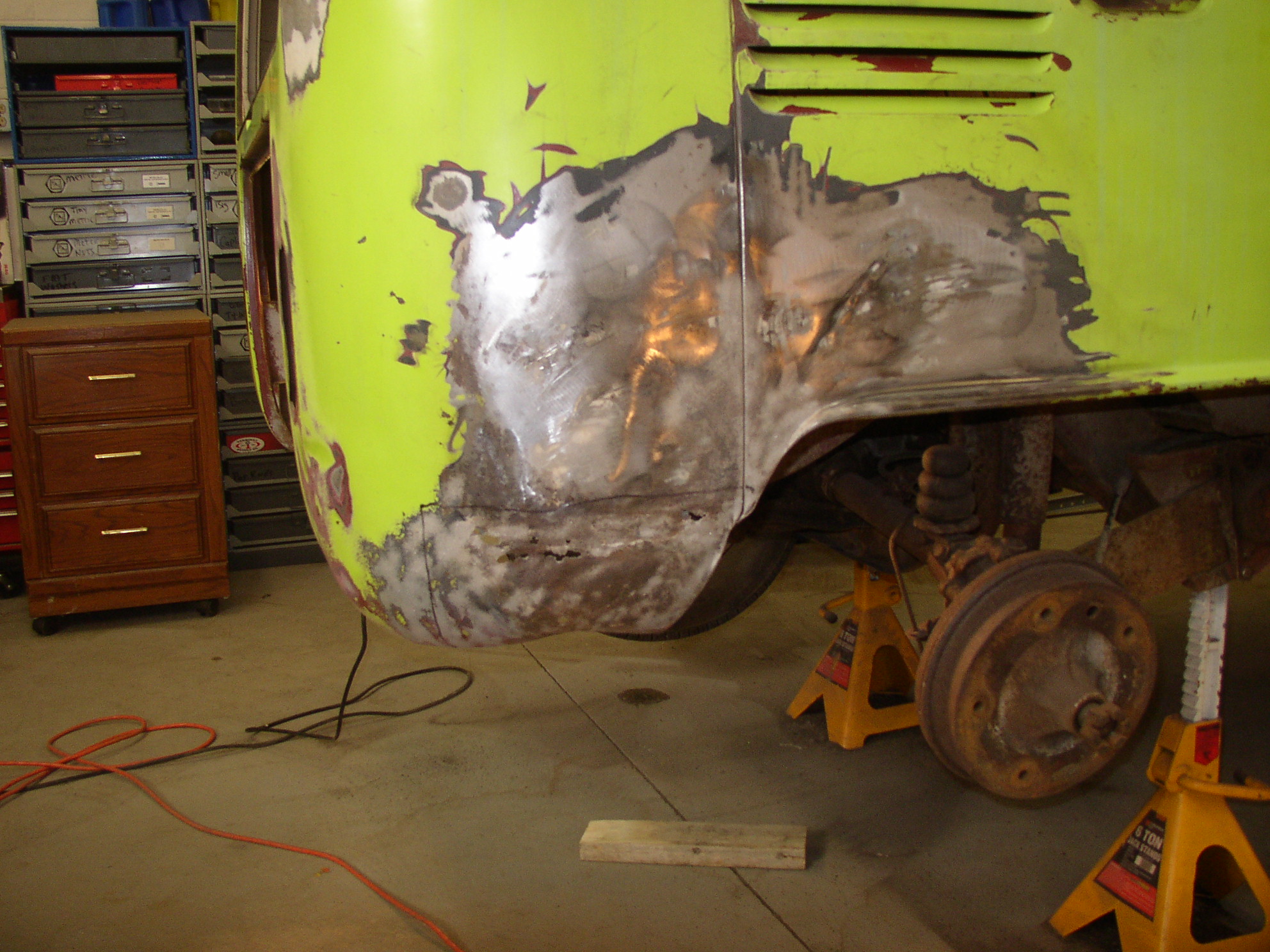

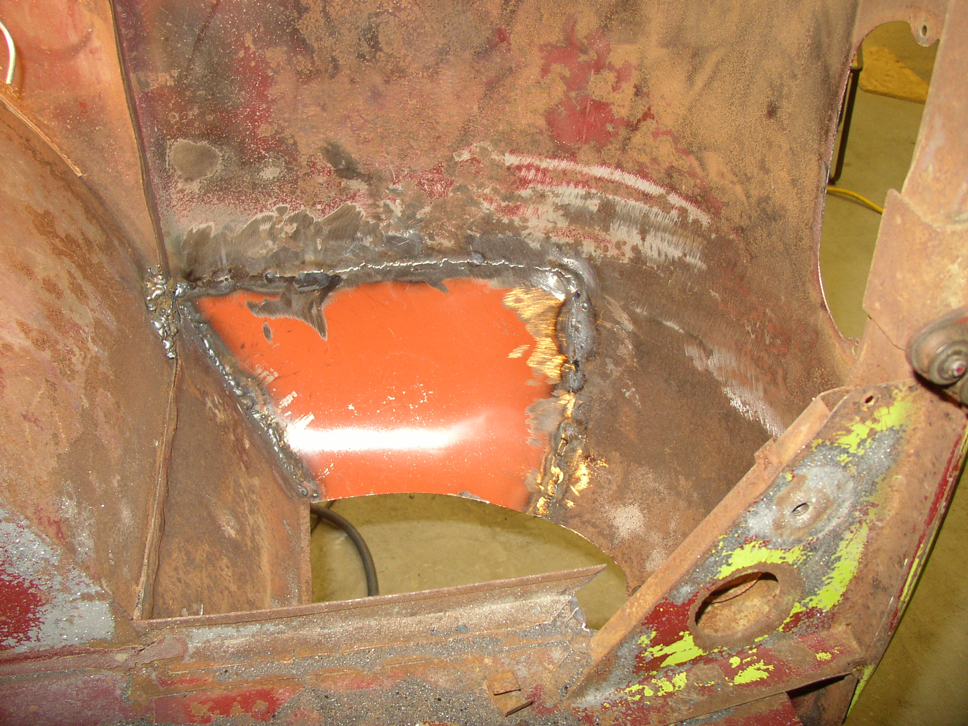

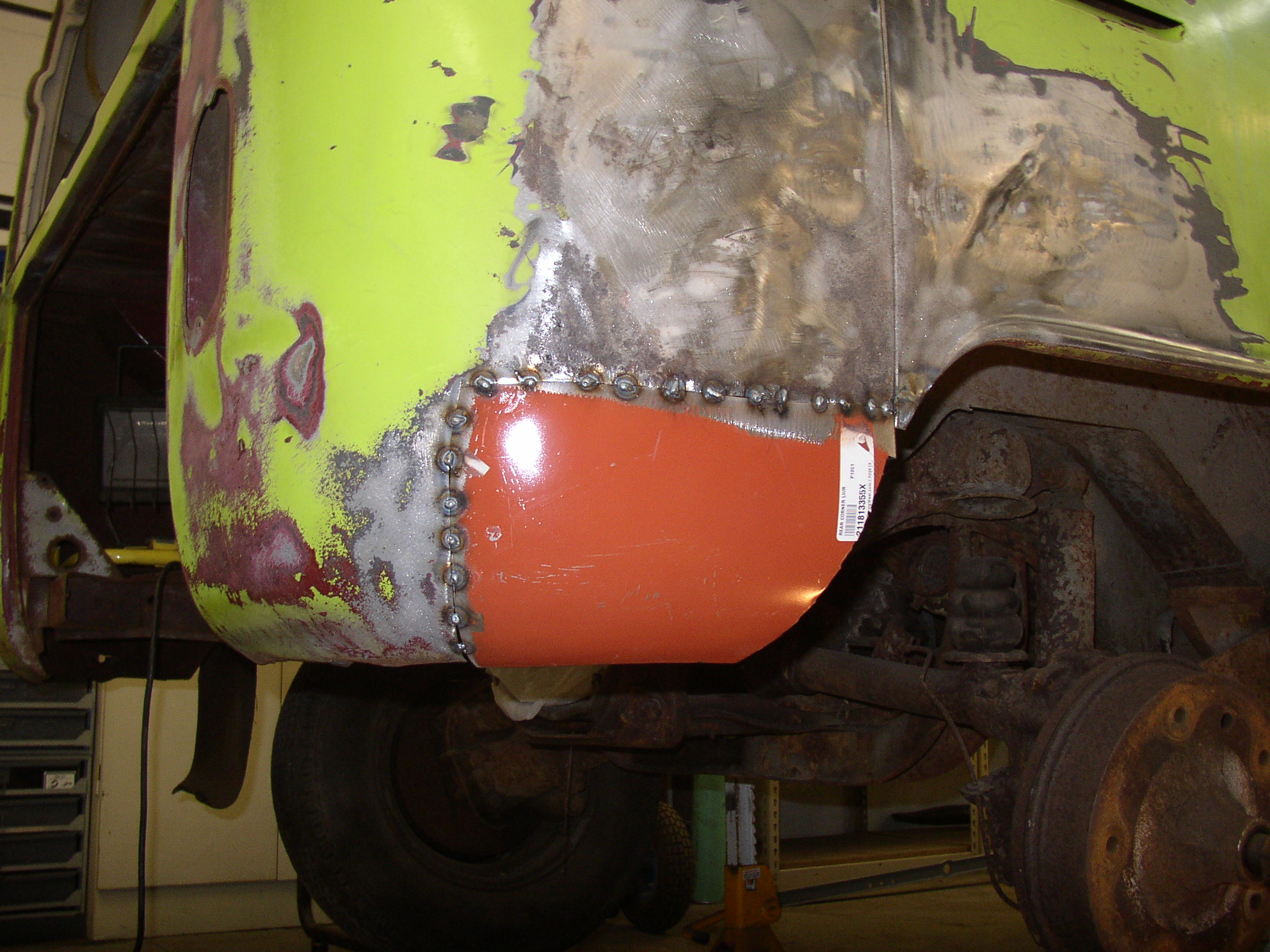

Marking the rotted section to be replaced.

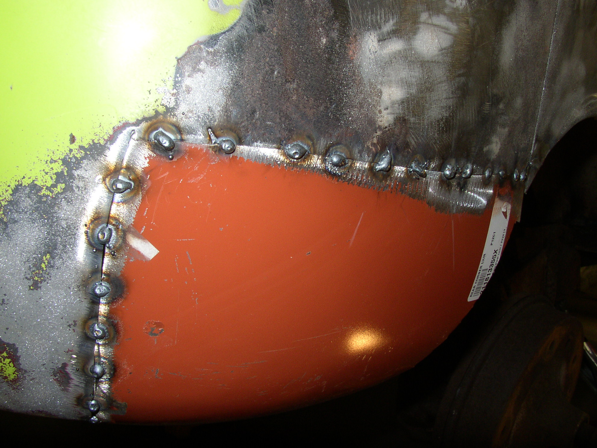

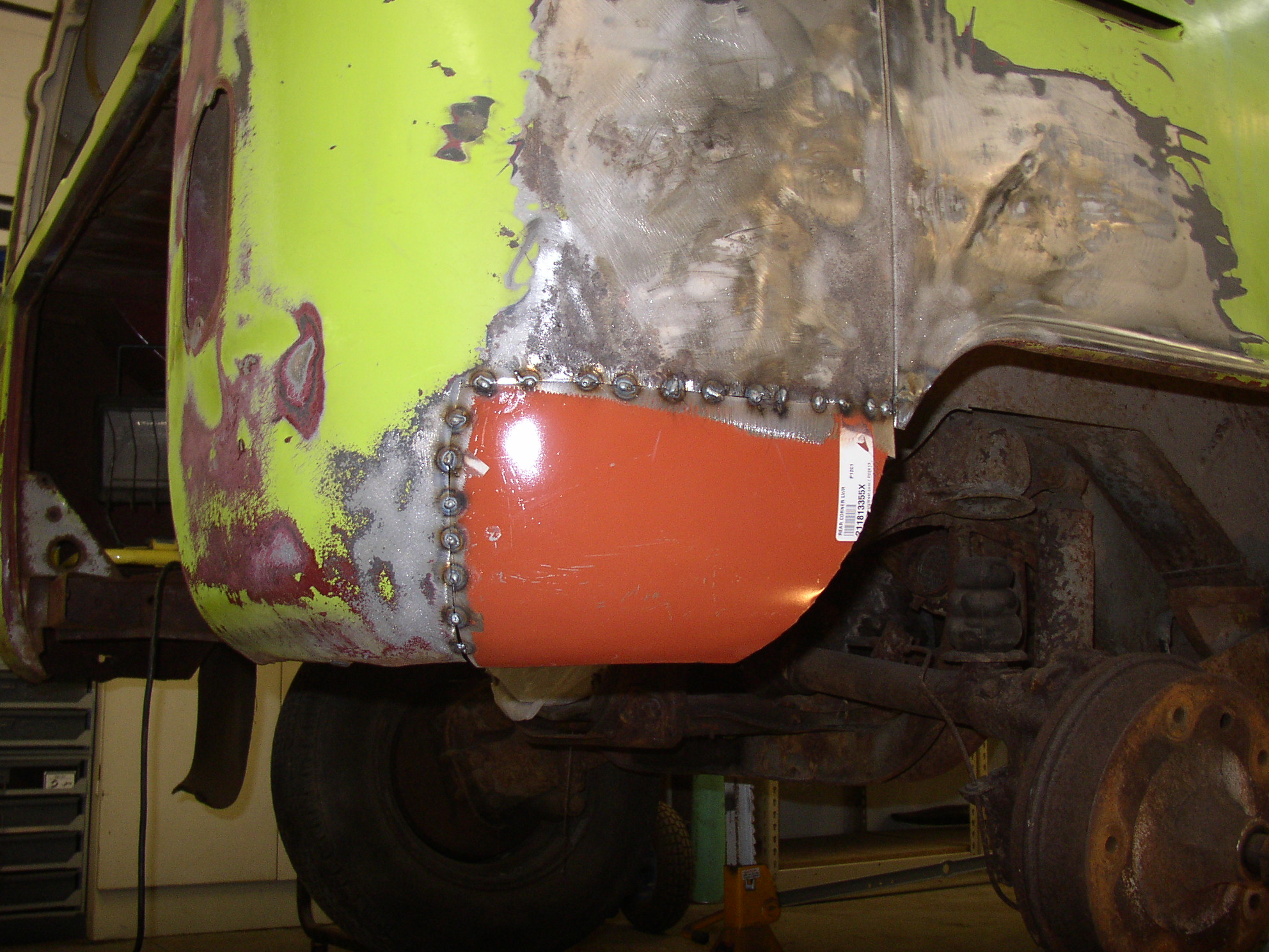

New piece tacked in place

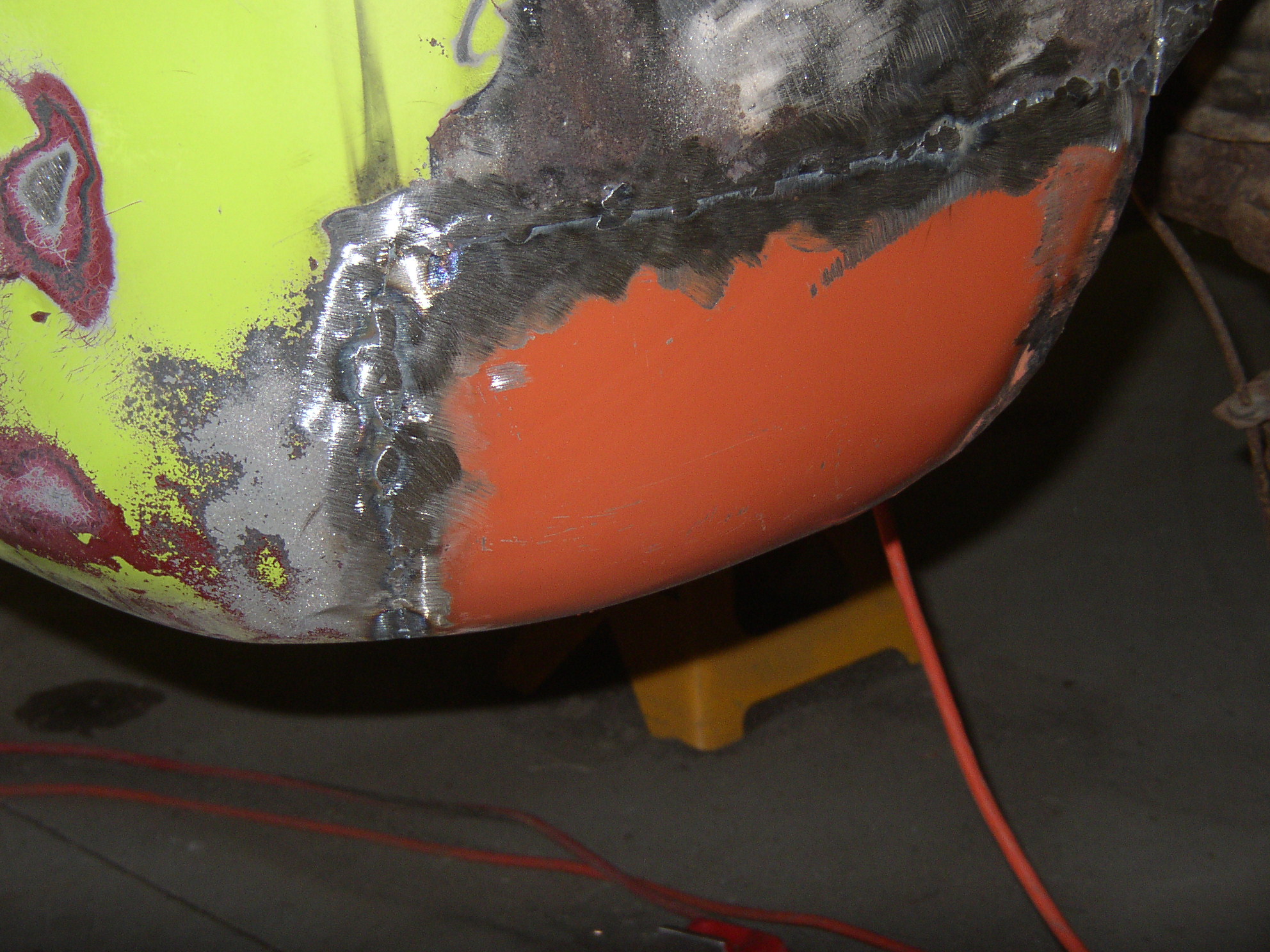

Welding completed and ground out, most of the welding was done from the inside.

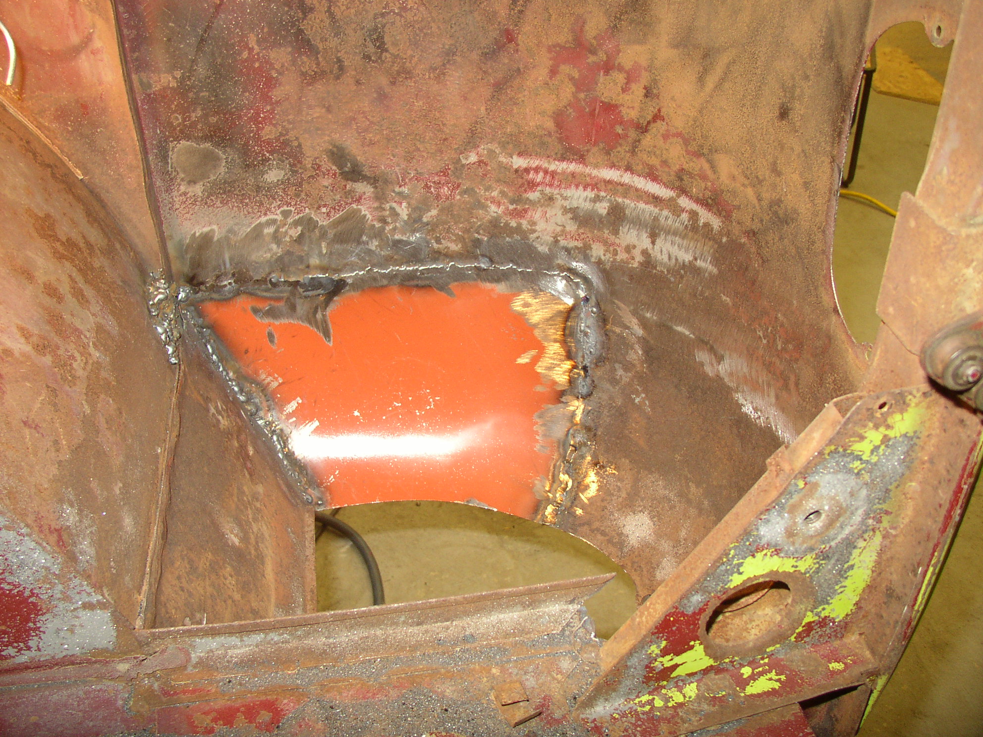

Battery tray installed, done. I tacked it from above and welded spots about 1.5" apart from below all the way around. I did use the spot welder in a couple of places that it would reach, but the curvature prevented using it as much as I would have liked.
You can see the heat marks from the weld spots.
