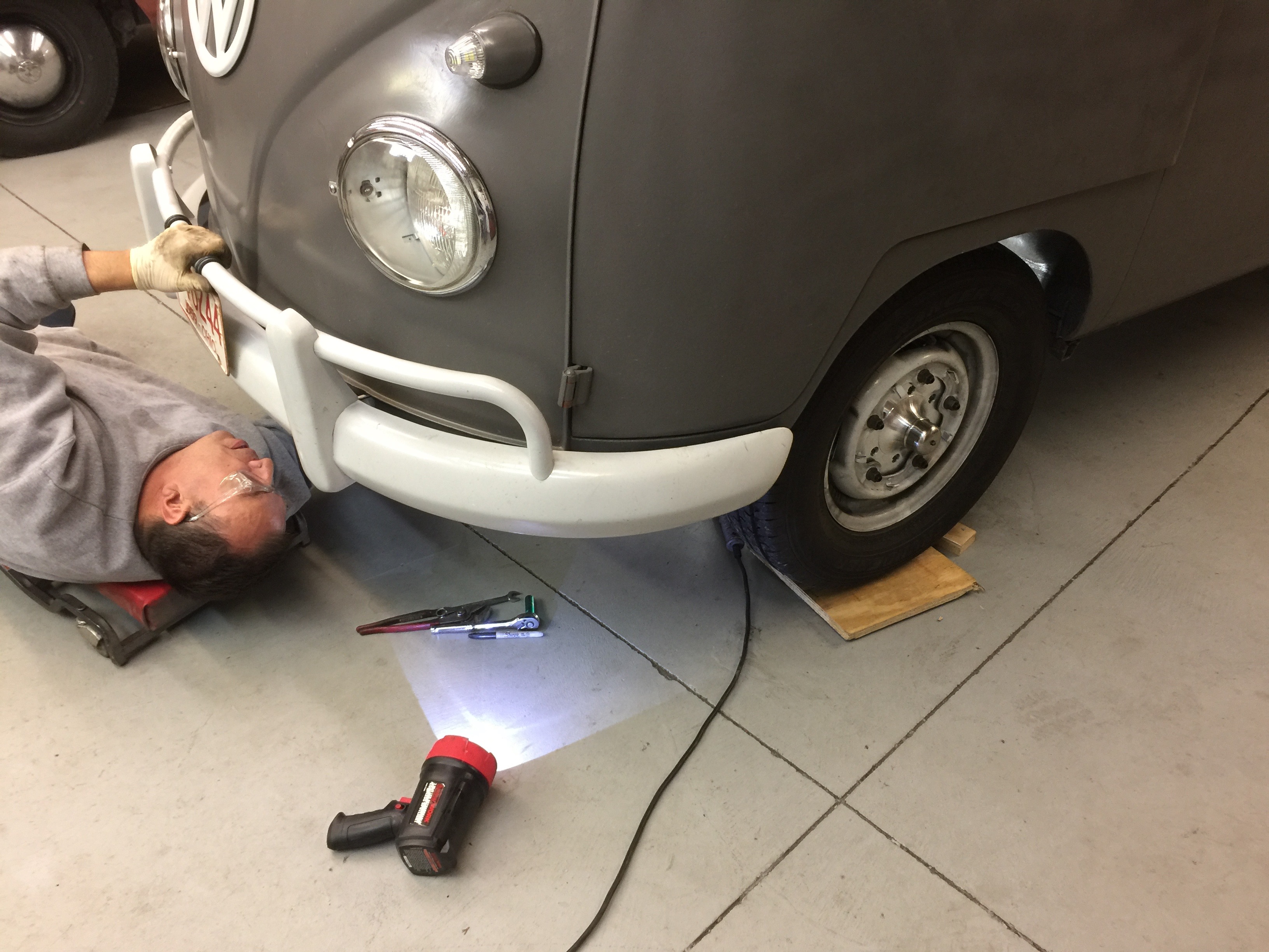

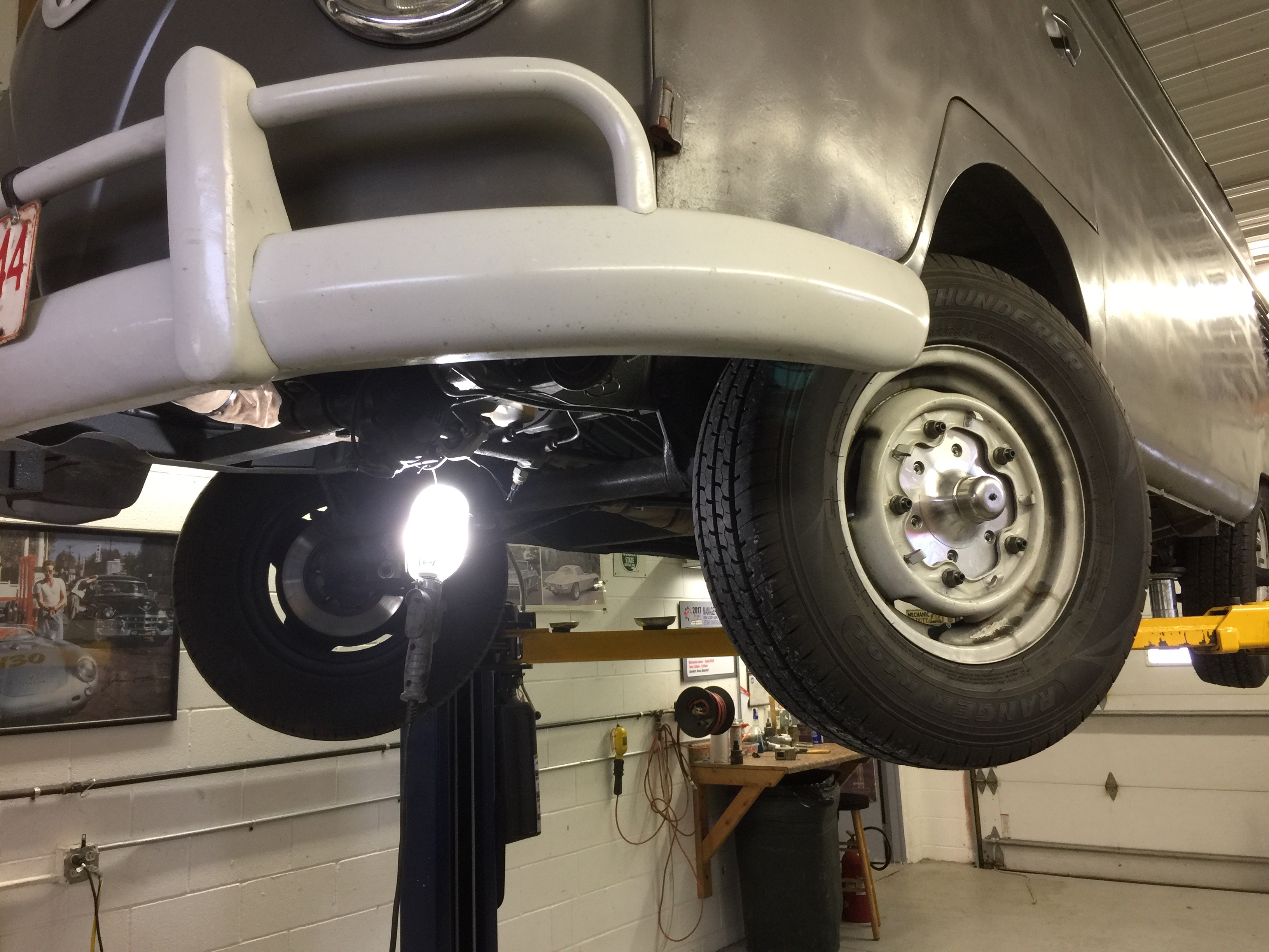

Rear camber appears spot on, but front camber and toe is a mess. I'm going to adjust the link pins today and set the toe, which was way out causing severe tire wear on the insides in less than a thousand miles.
The tires not clearing the fenders has me concerned, I've never seen this before on a stock bus.

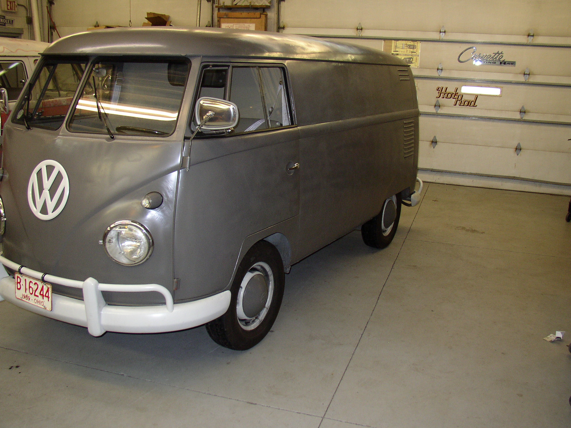

We wrapped it up today. Bus ran great on test run. Monster 40HP blasting down Rt 237 like there was no tomorrow. Women seen pulling their children inside out of fear they would be sucked into the vortex of the 40HP powered panel. This bad boy will pull the shingles off your roof next time I'm rolling through Litchfield! Look out!
Ok, maybe not. :roll: But huge improvement on drivability. Just getting the wheels in a normal setting makes it better. This will be a fun panel to cruise around in. Even with a 40HP you can feel the difference in performance from having the big nut.

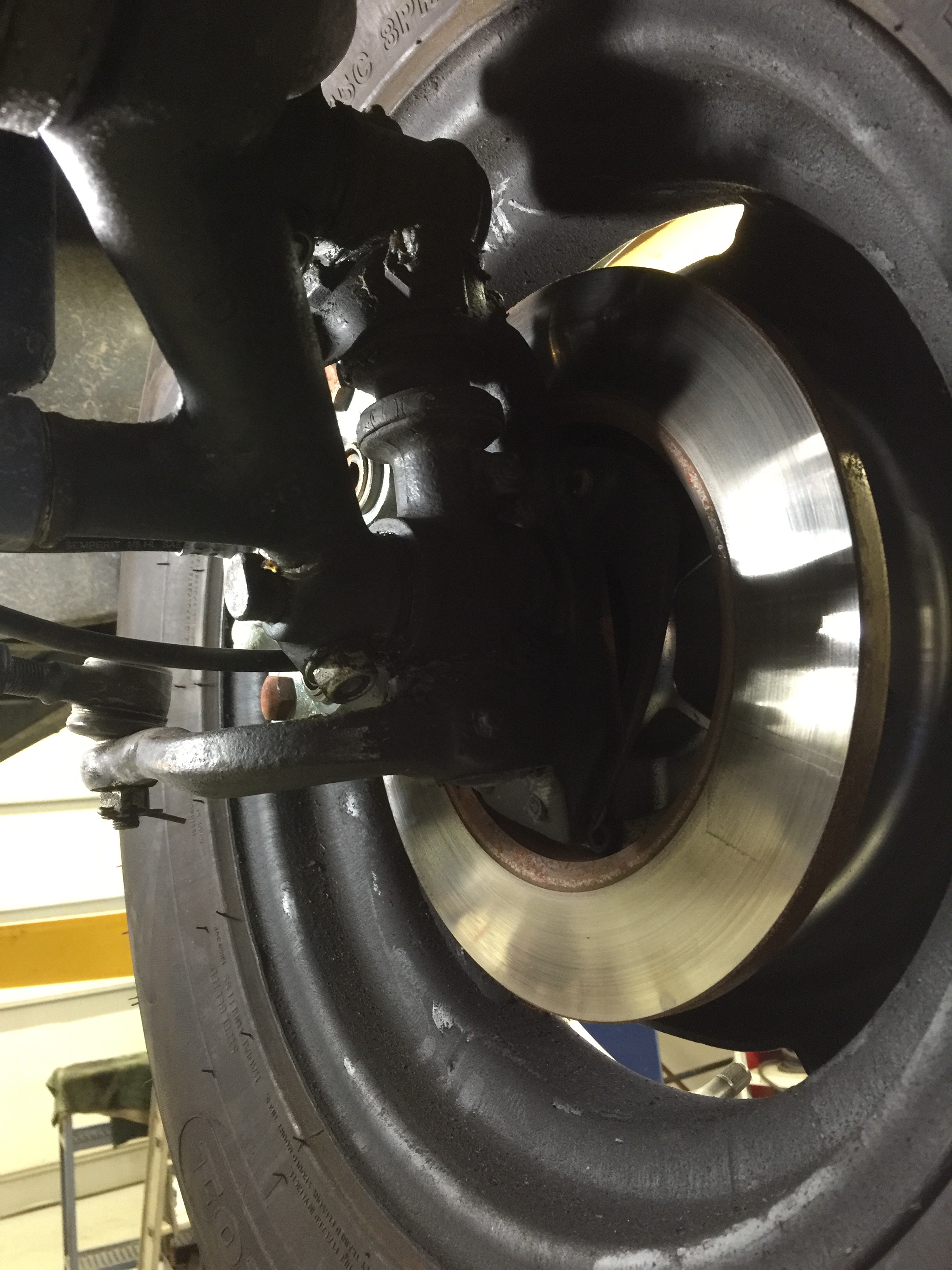

Bruce showed me how the pins (top and bottom) are adjusted. Yes, those are the disc brakes Kirk put on. (highly recommended)

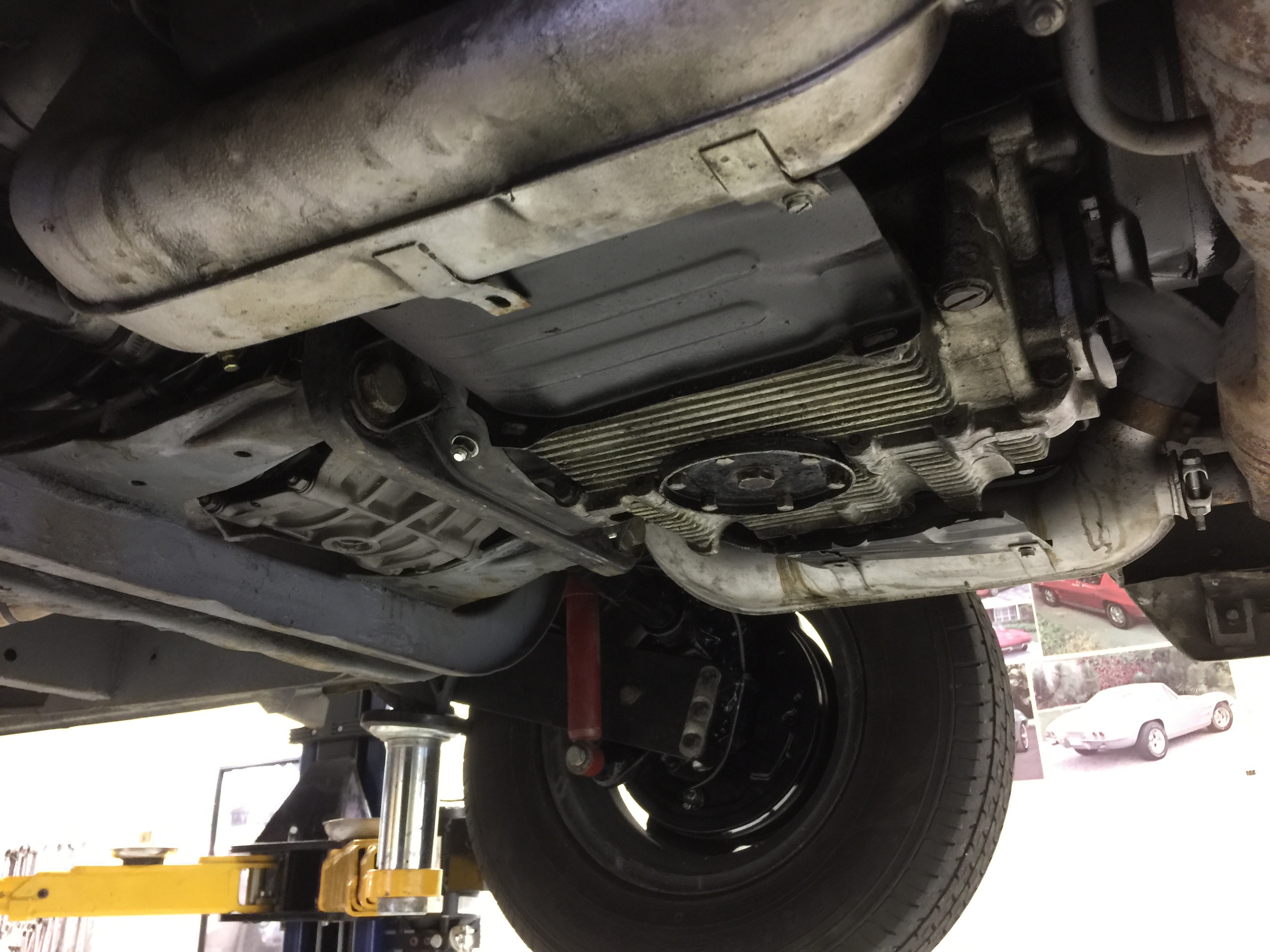

Here's the underside of the great and all powerful 40HP. The motor 'The Rick Lang' and Aaron dream of! :D

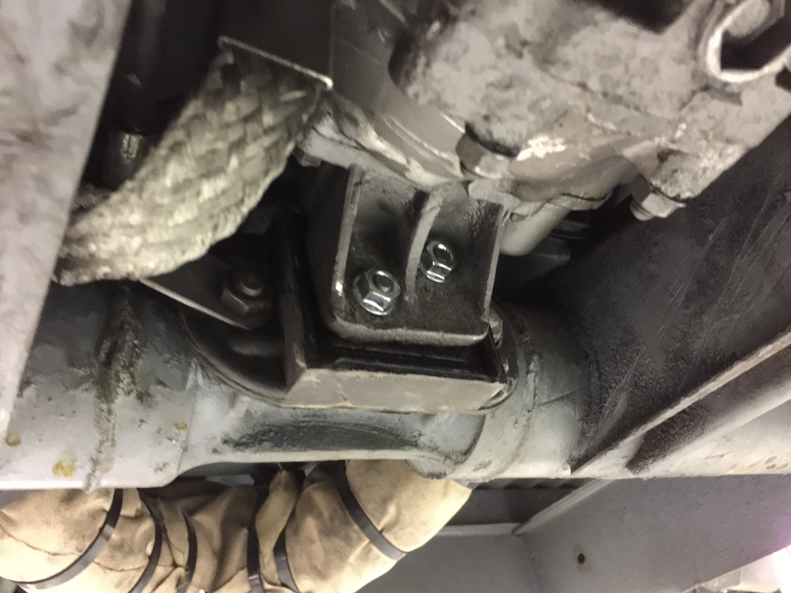

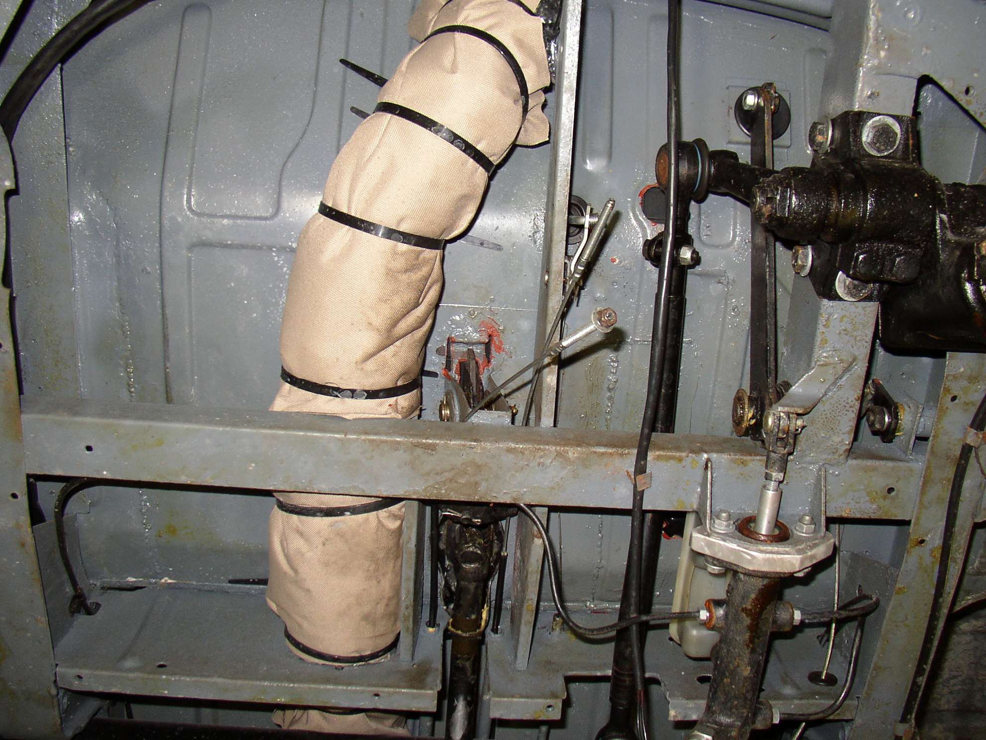

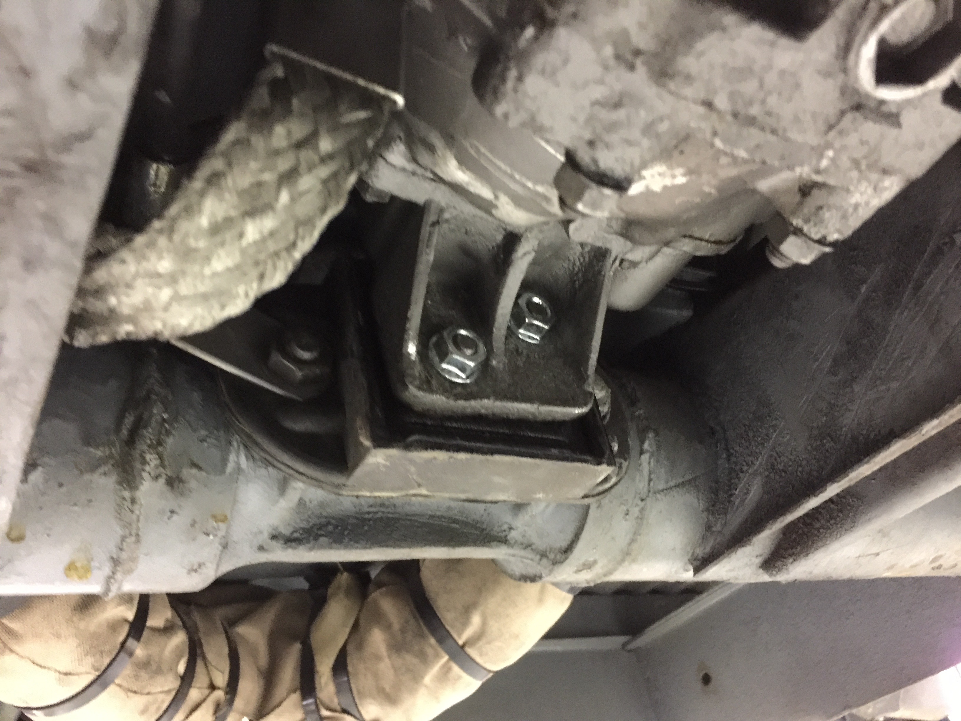

Tranny mount

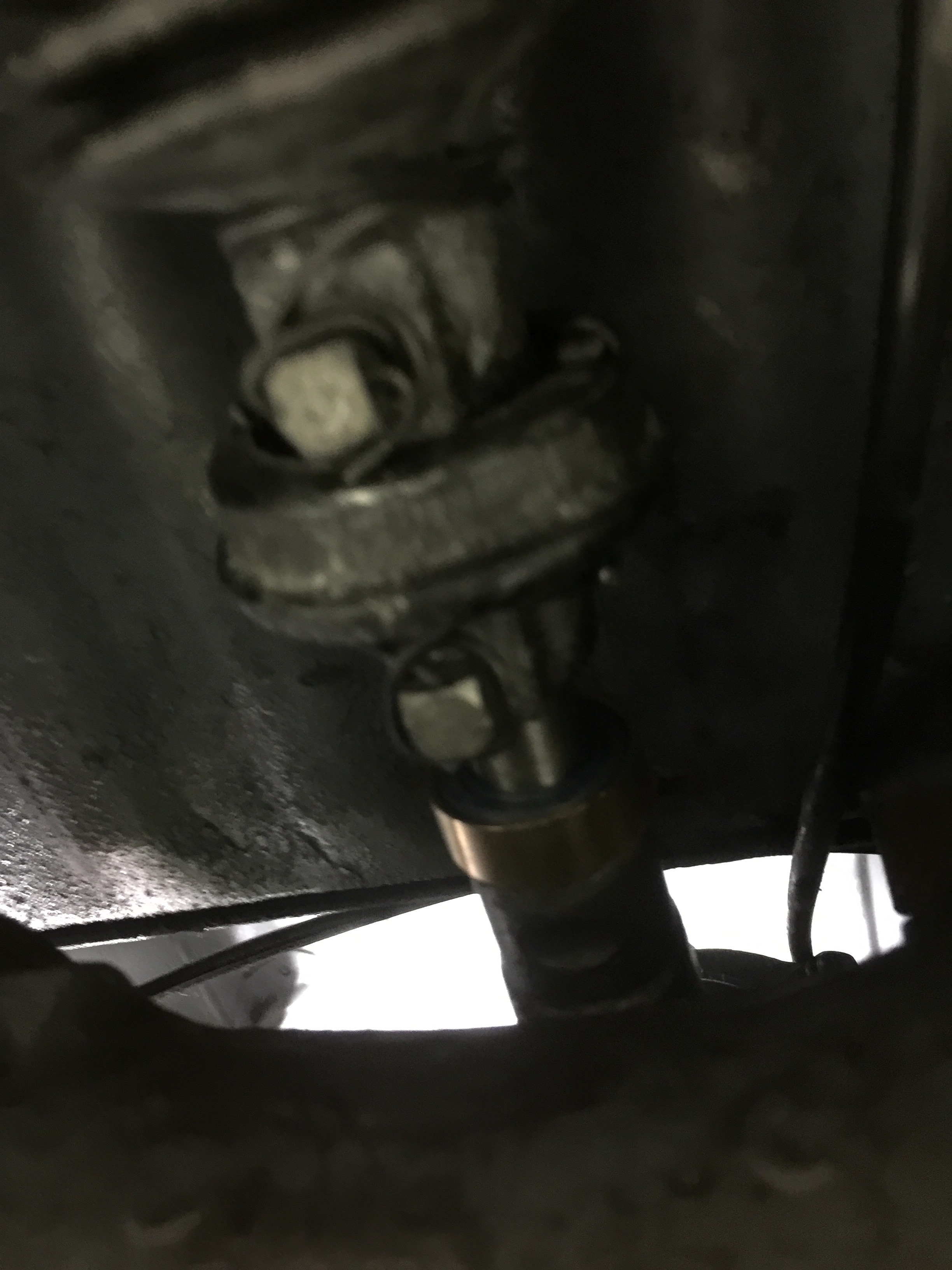

These locking plates were an education.

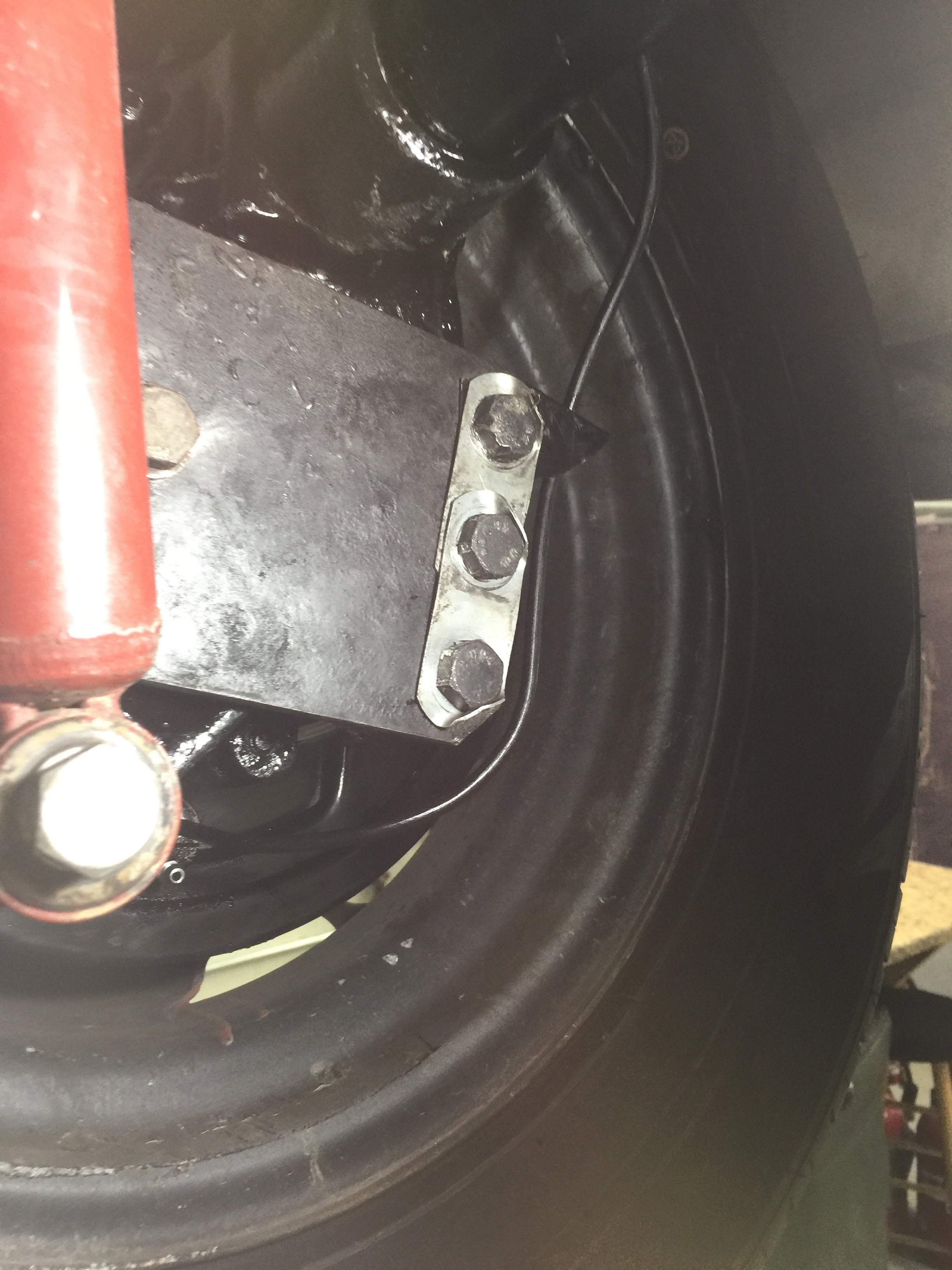

I got the coupler wired up. Looks like hell, but functional.

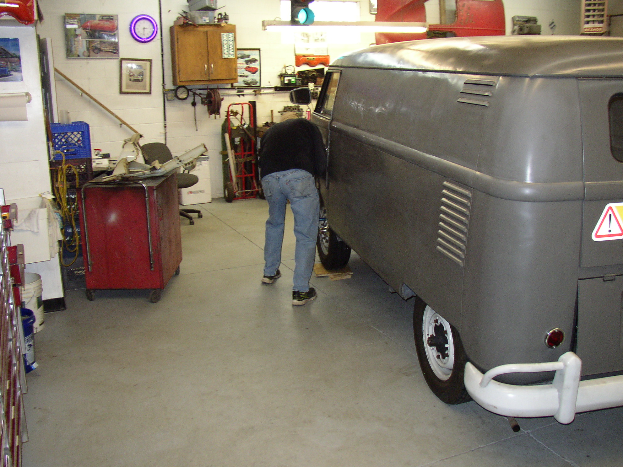

Bruce did the whole toe-in and toe-out adjustment. Made a huge difference.

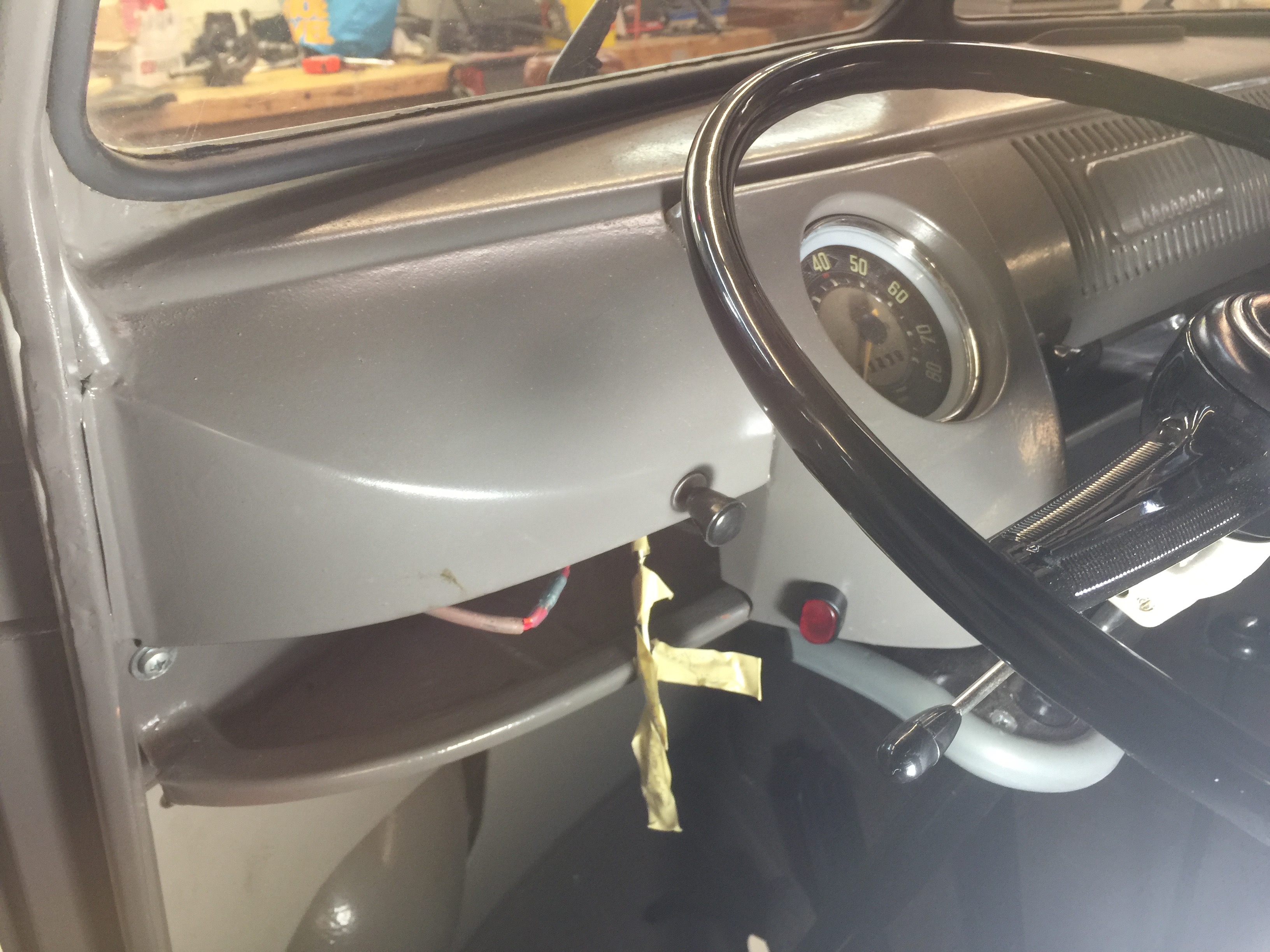

The virgin dash

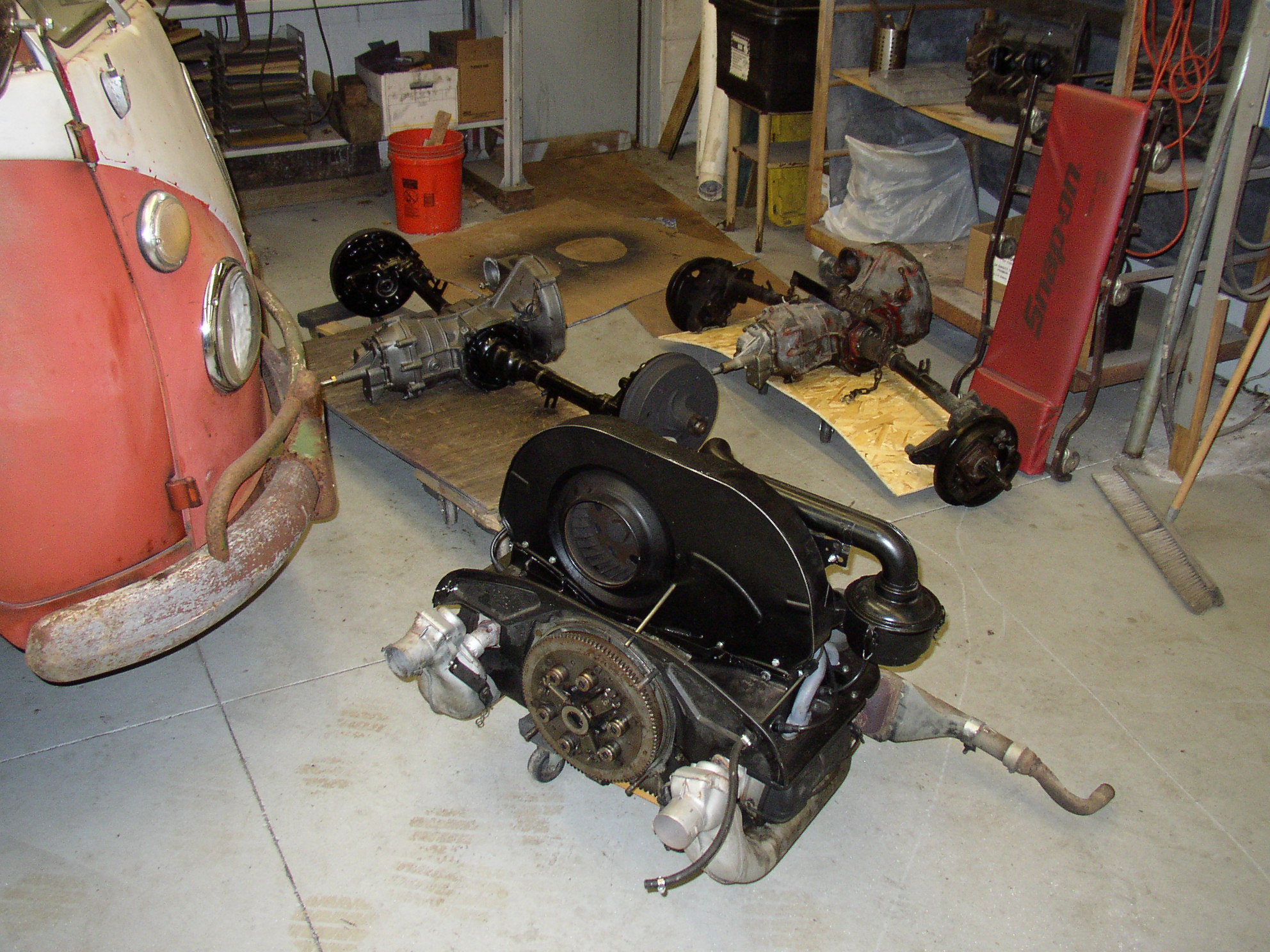

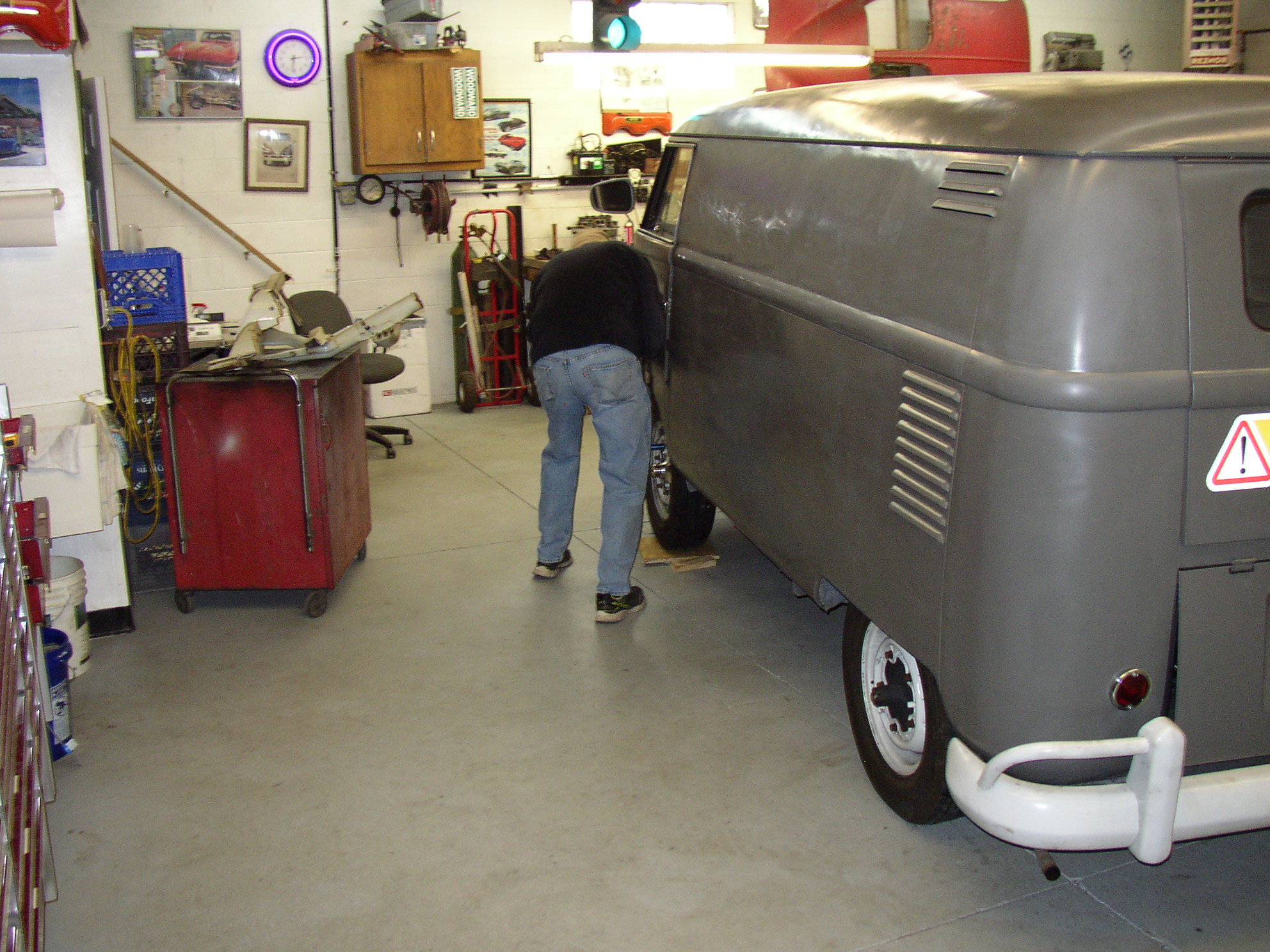

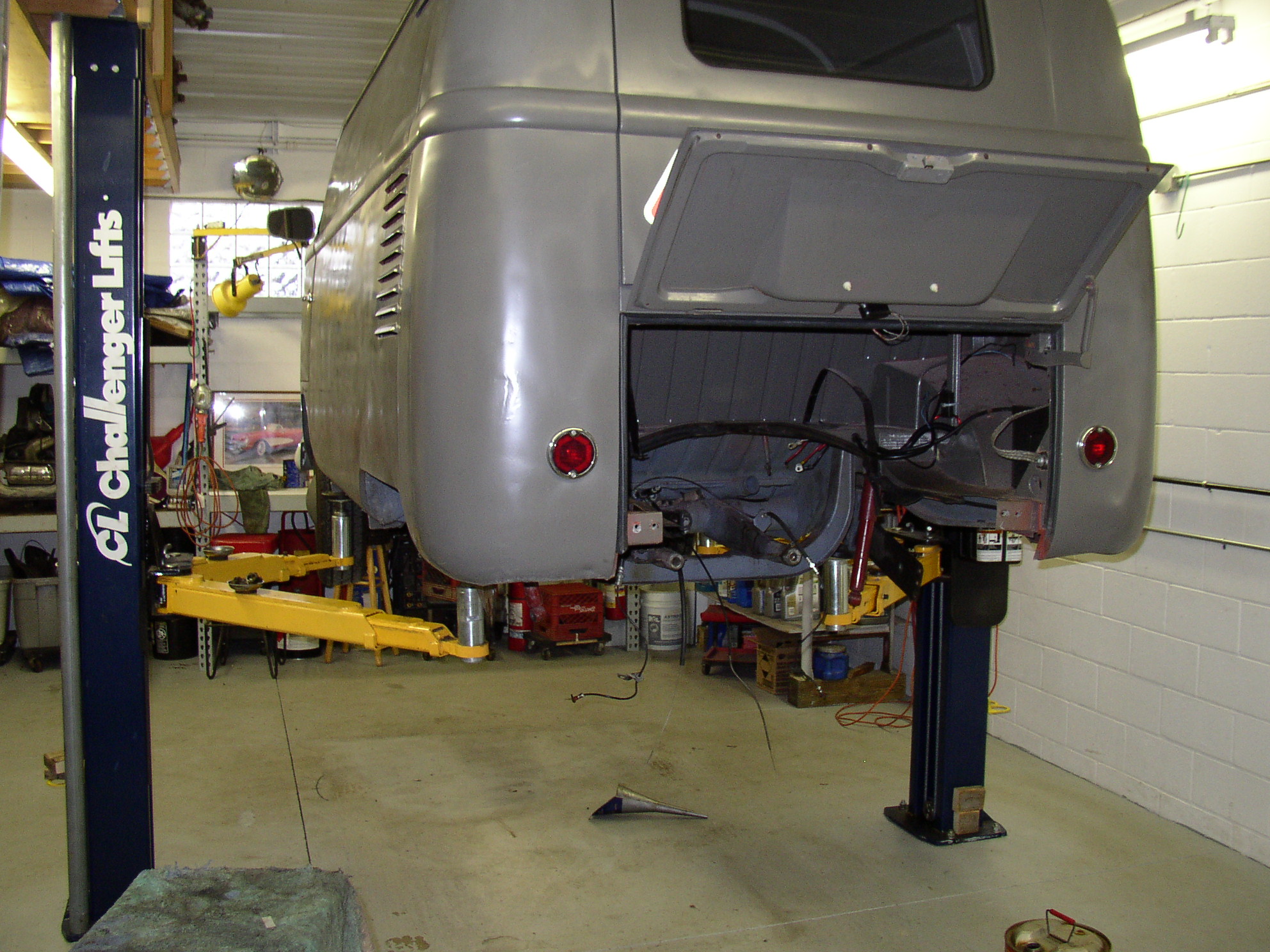

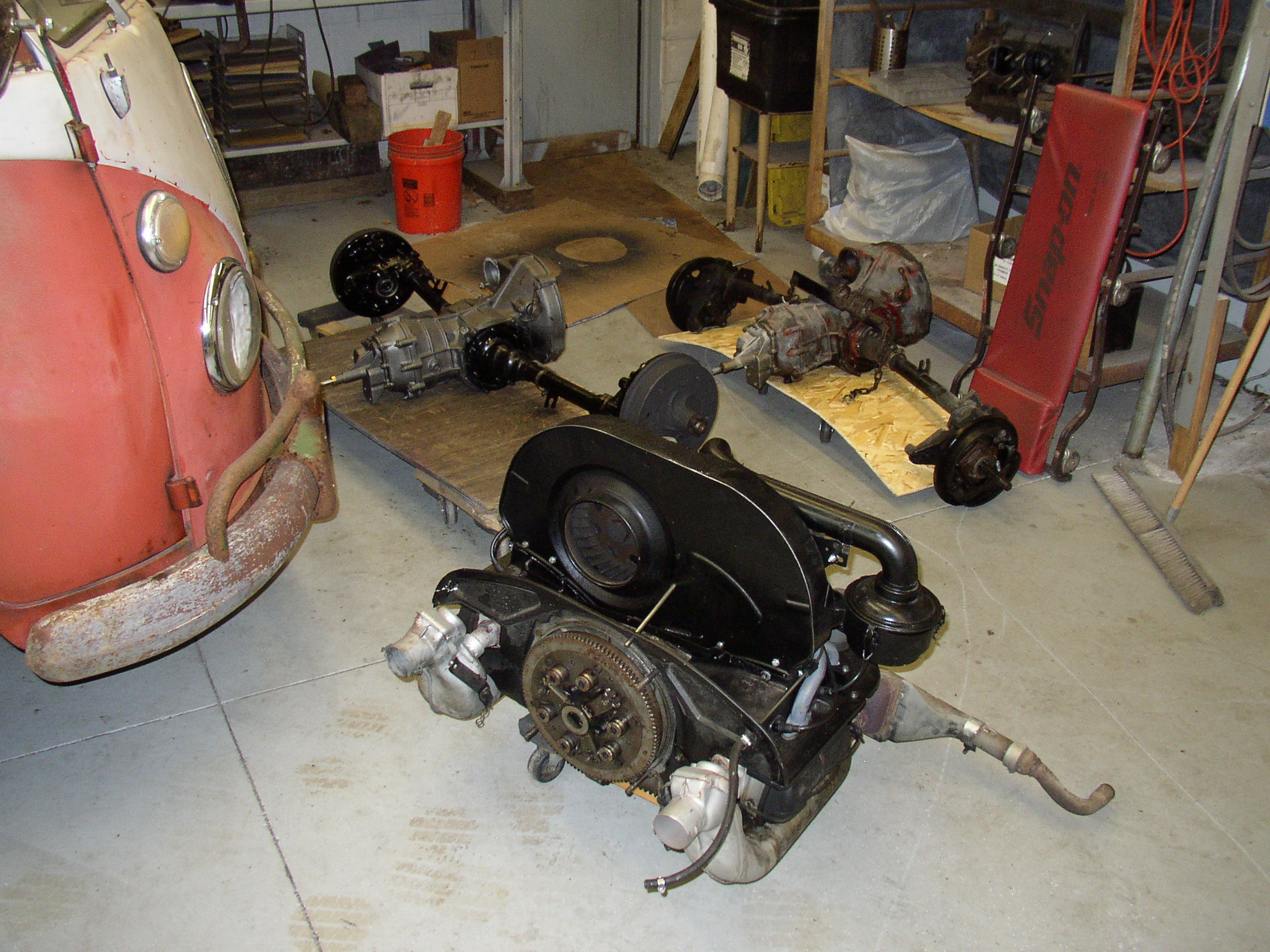

Here's the bus with the driveline removed
And the drivelines on the floor. Out with the small nut, in with the big nut.

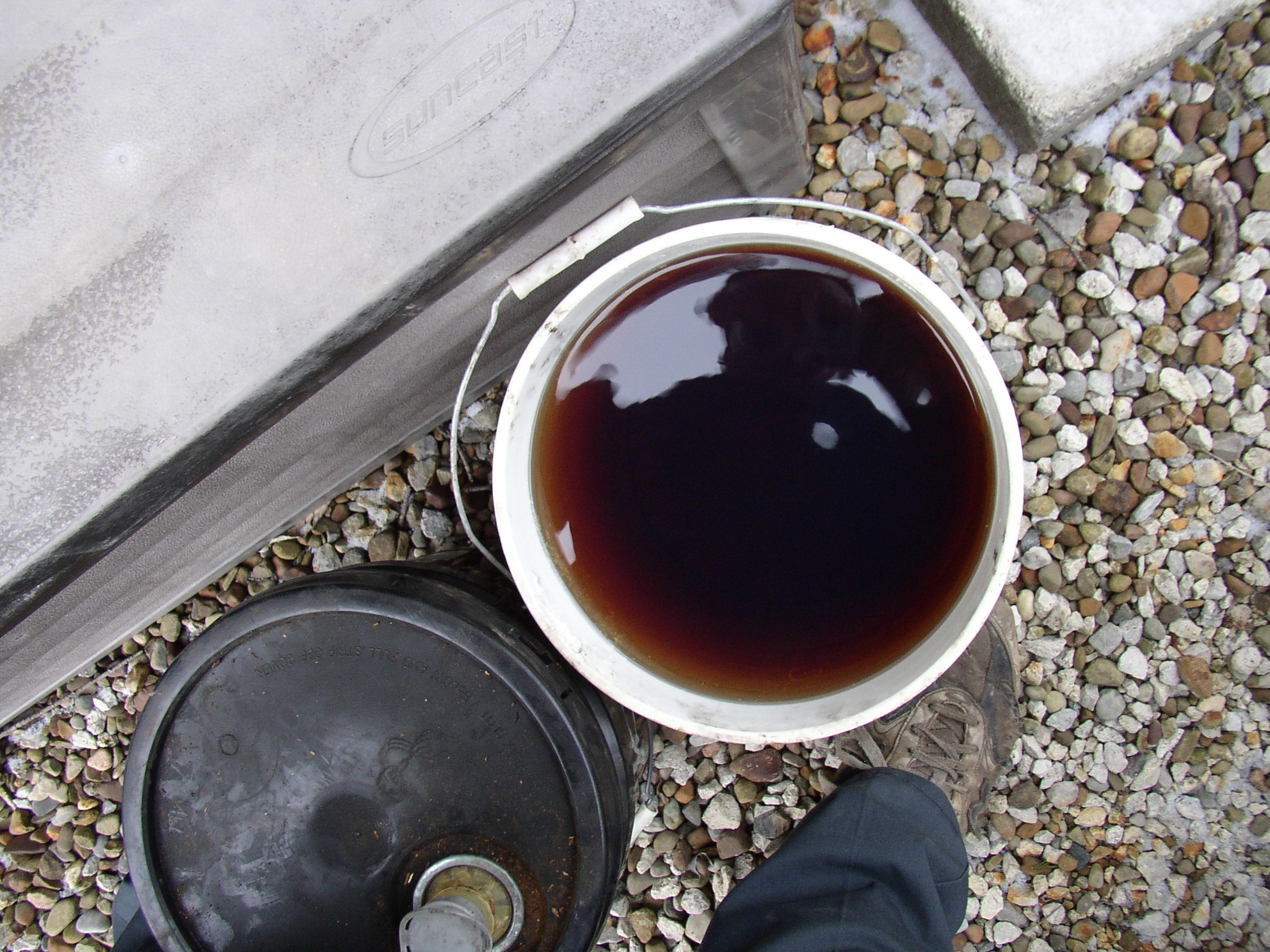

Here's the shit gas that was in his tank, I'm not sure if it was from crap in the tank or a bad gas station he bought from, but it was bad! It should be clear like apple juice, you should be able to see the bottom of a white bucket .

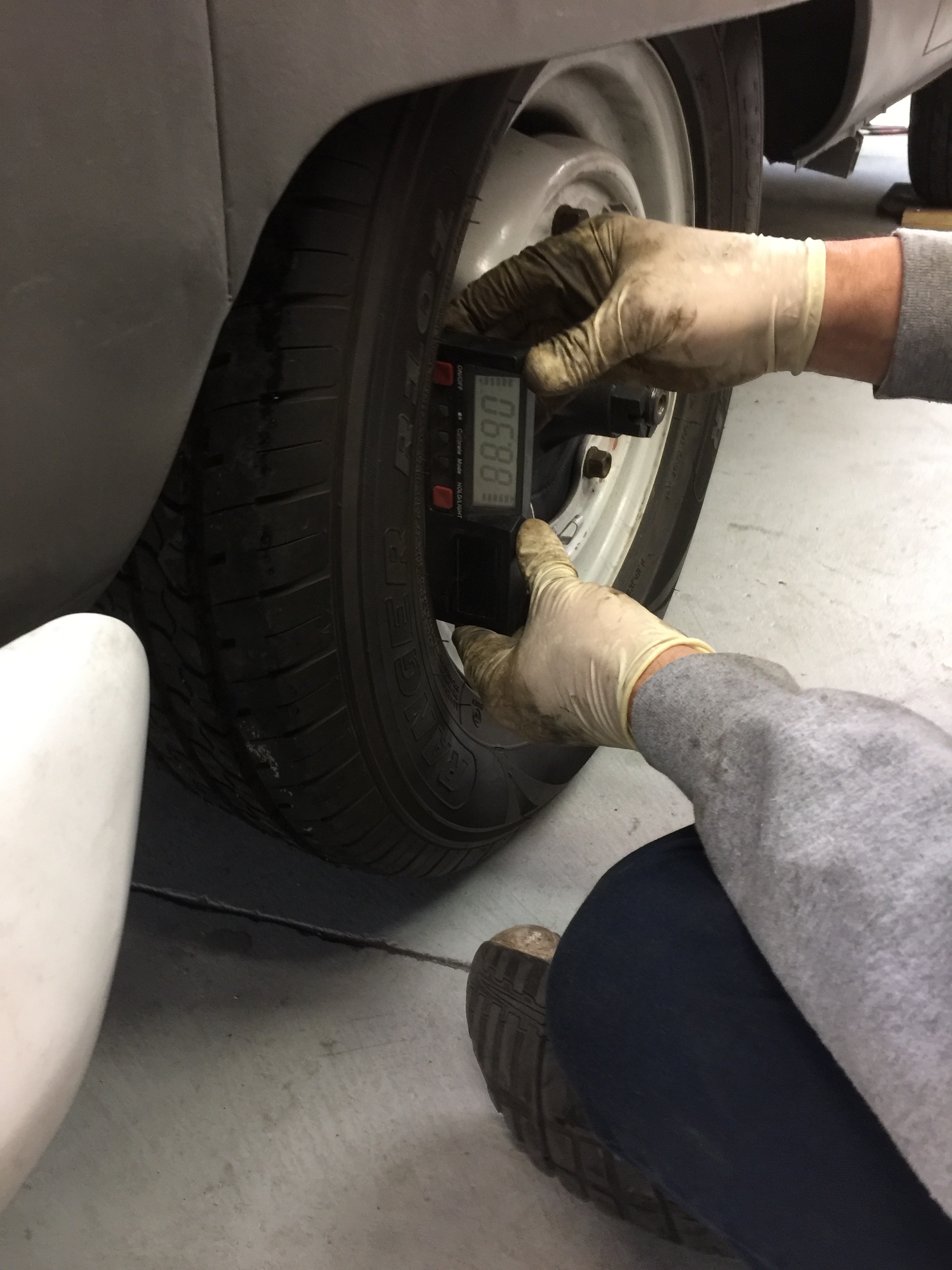

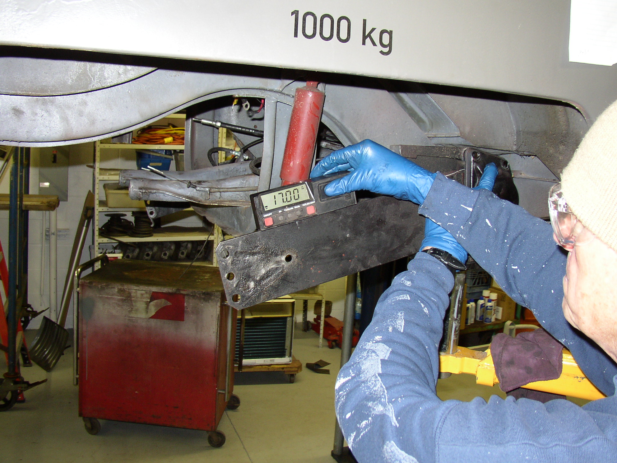

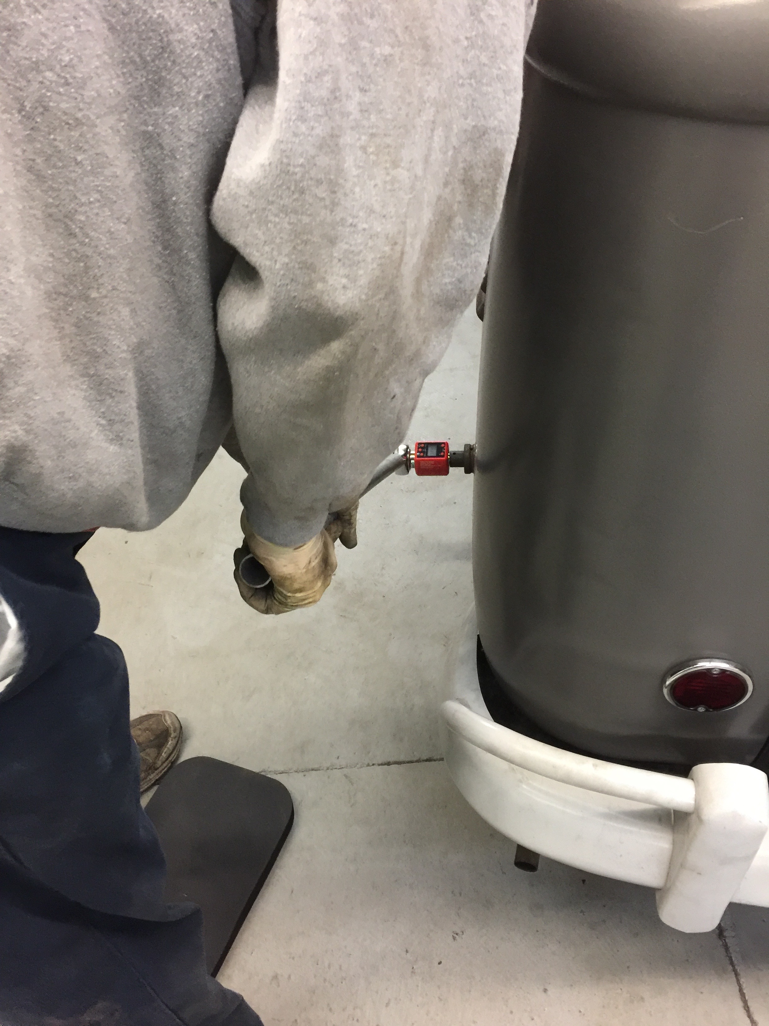

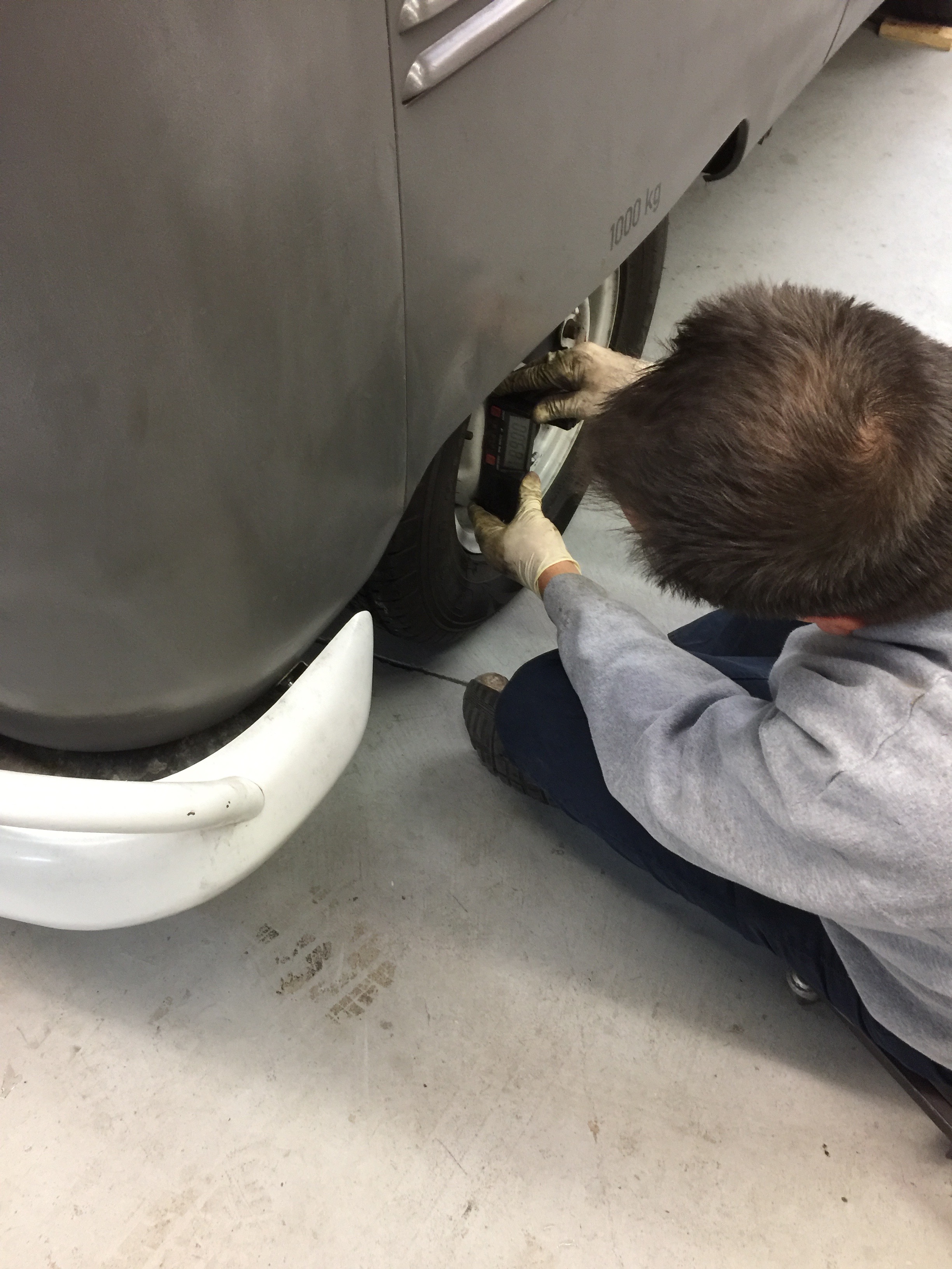

Measuring the spring plate angle.

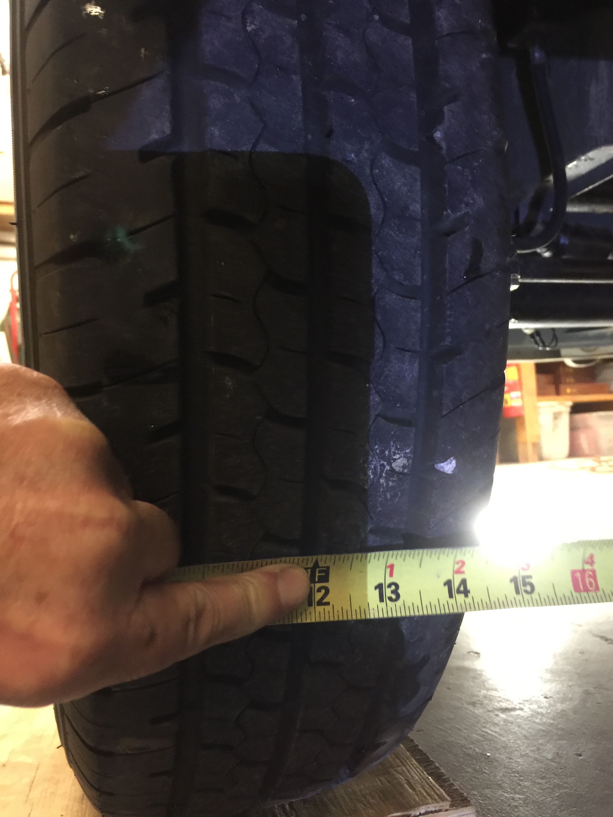

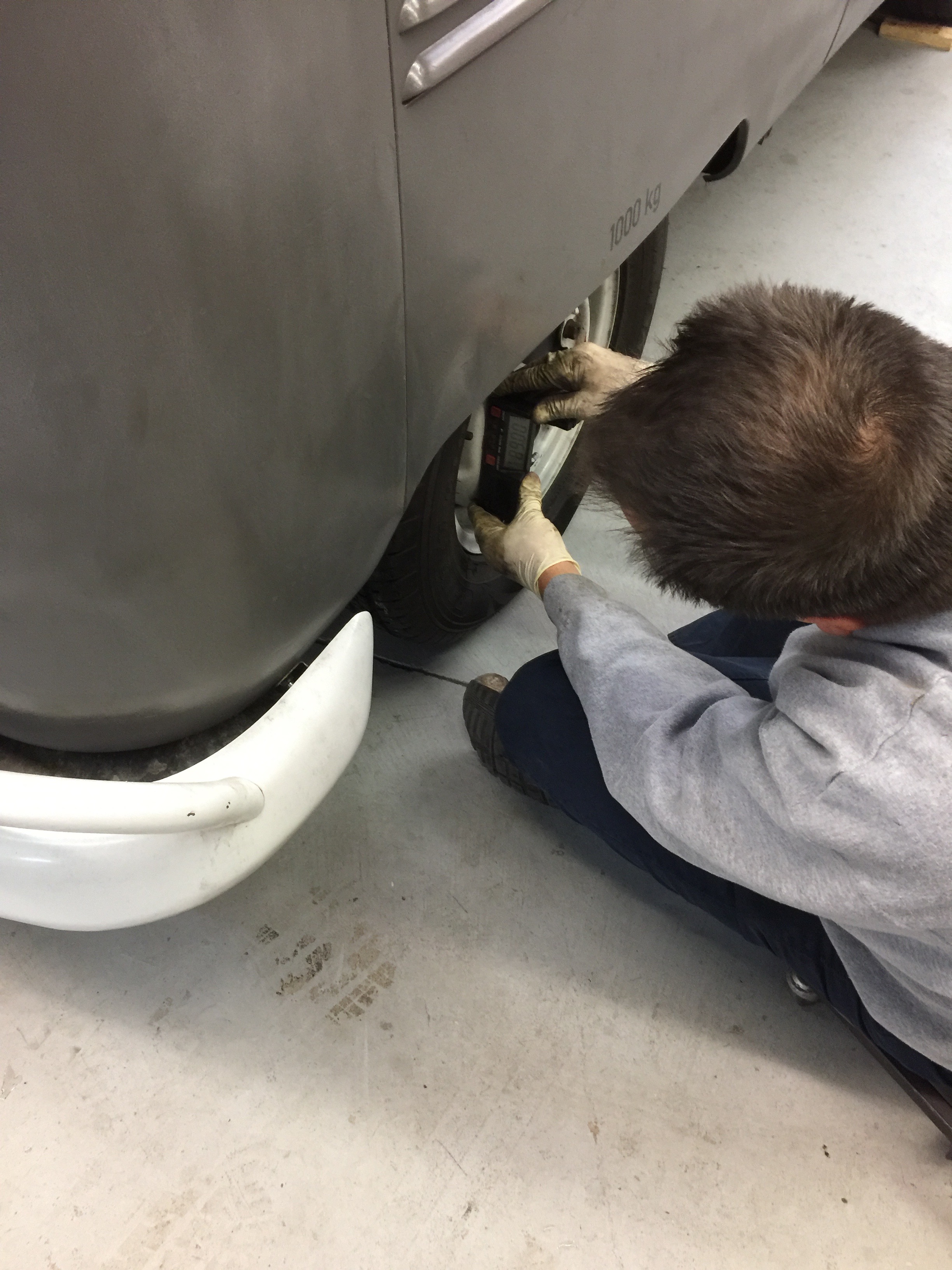

We had too much positive camber (about 3-3.5° on the rears) and needed to take some out.
Here's my notes- starting with about 3° positive and wanting to go to about .5-1° positive. Baseline on the spring plate was 20.4° down putting the spring plate target at 16.8-17.2° down. Refer to earlier picture about rotating the torsion bar 30 times to get exactly the target measurement you want.
Put it all together and drive it to level things out, and remeasure to find it exactly where I want it, about .5°-1° positive average of several measurements. I know Sean's picture above shows .1° positive but that's just one of several measurements on the tire and wheel that I average.

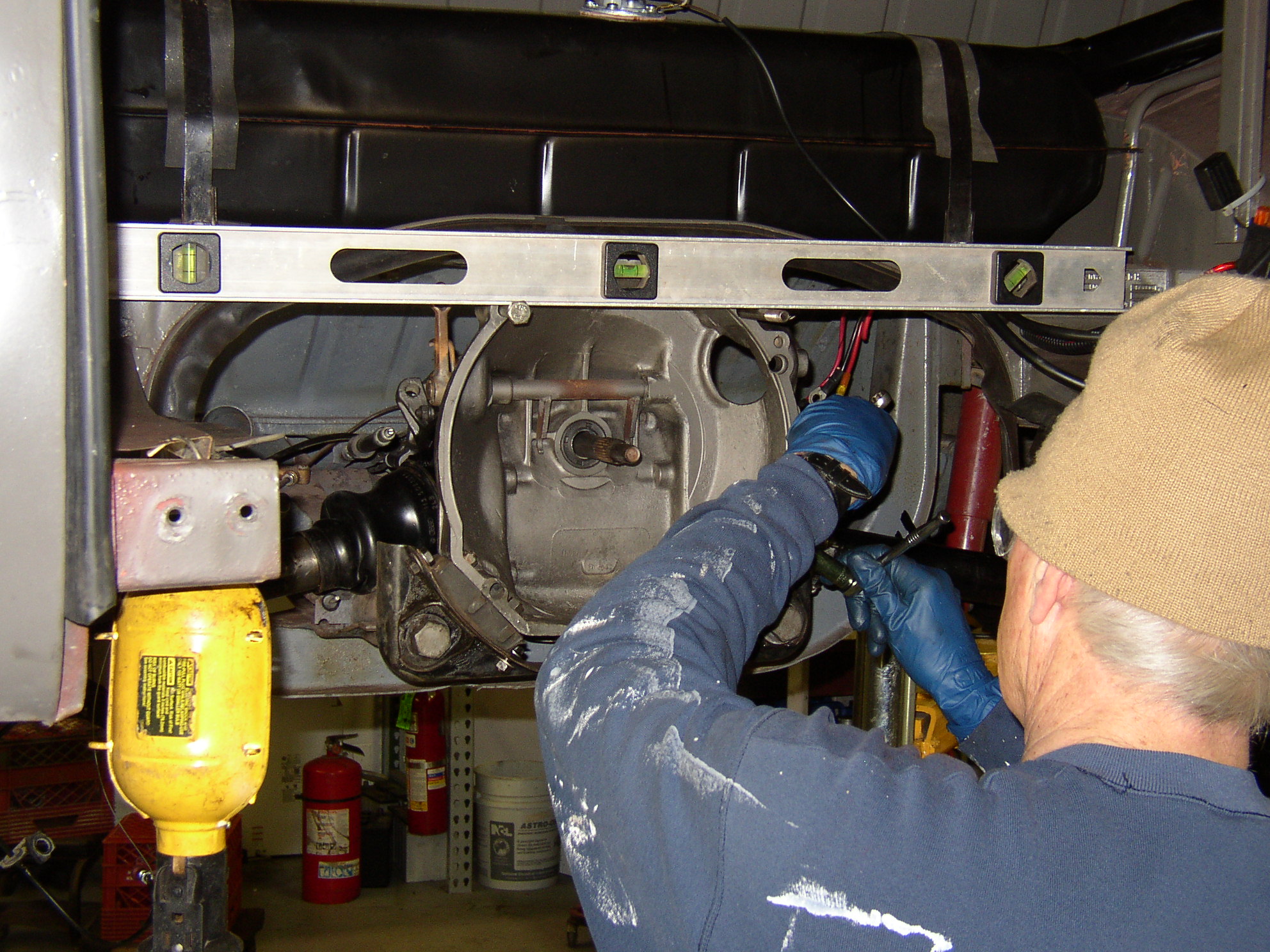

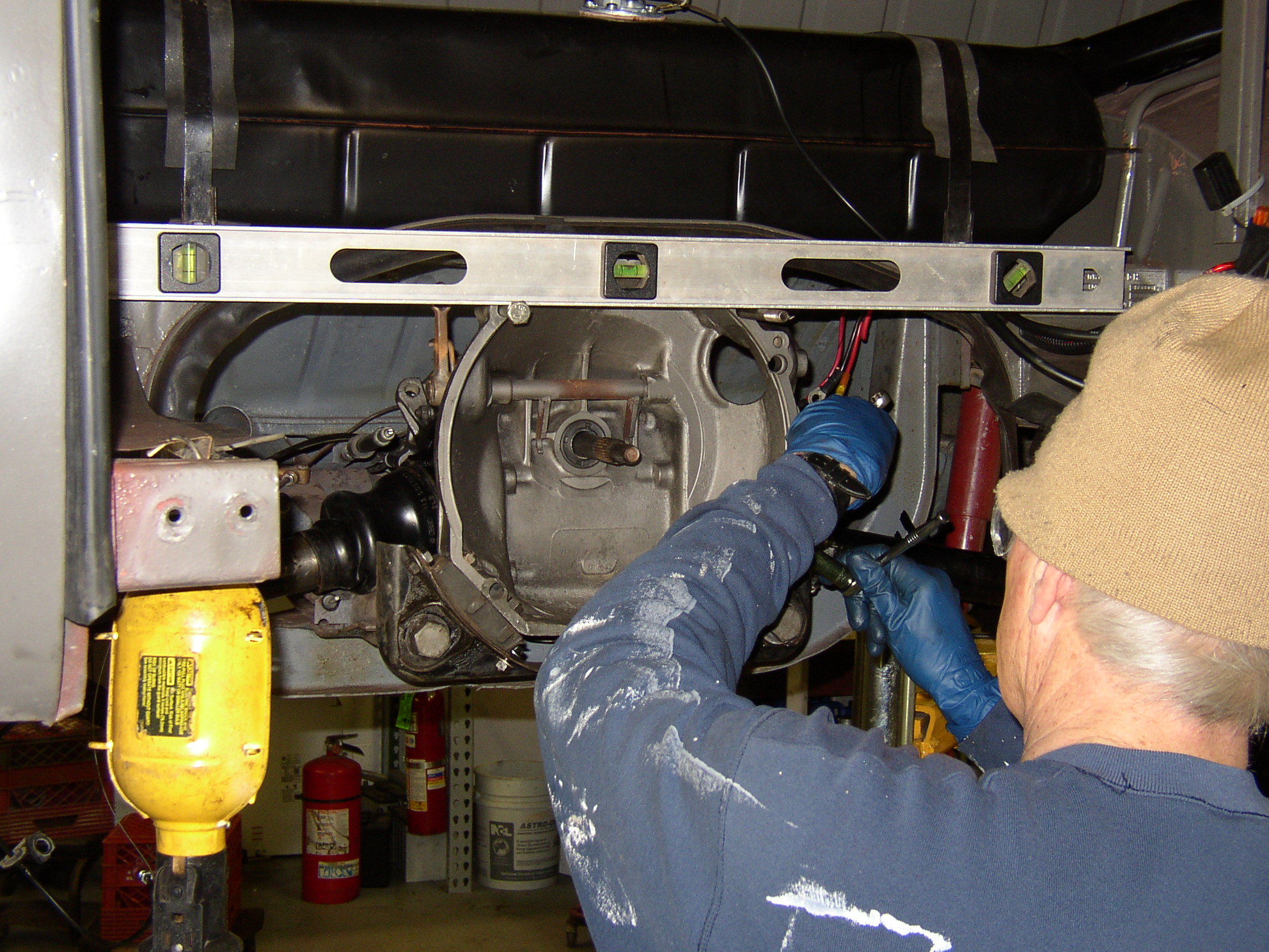

When you're bolting in the tranny mounts you want to make sure they're level. Not only does it look stupid if they're not but it upsets your shifter.

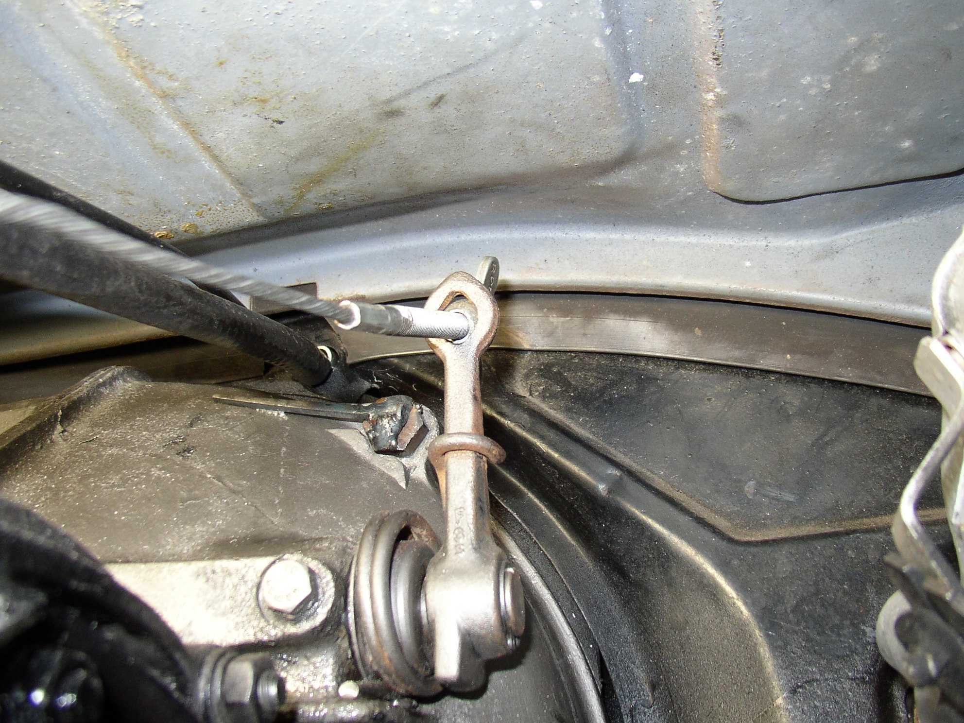

Big nut park cables, showing they're about 6" too long.

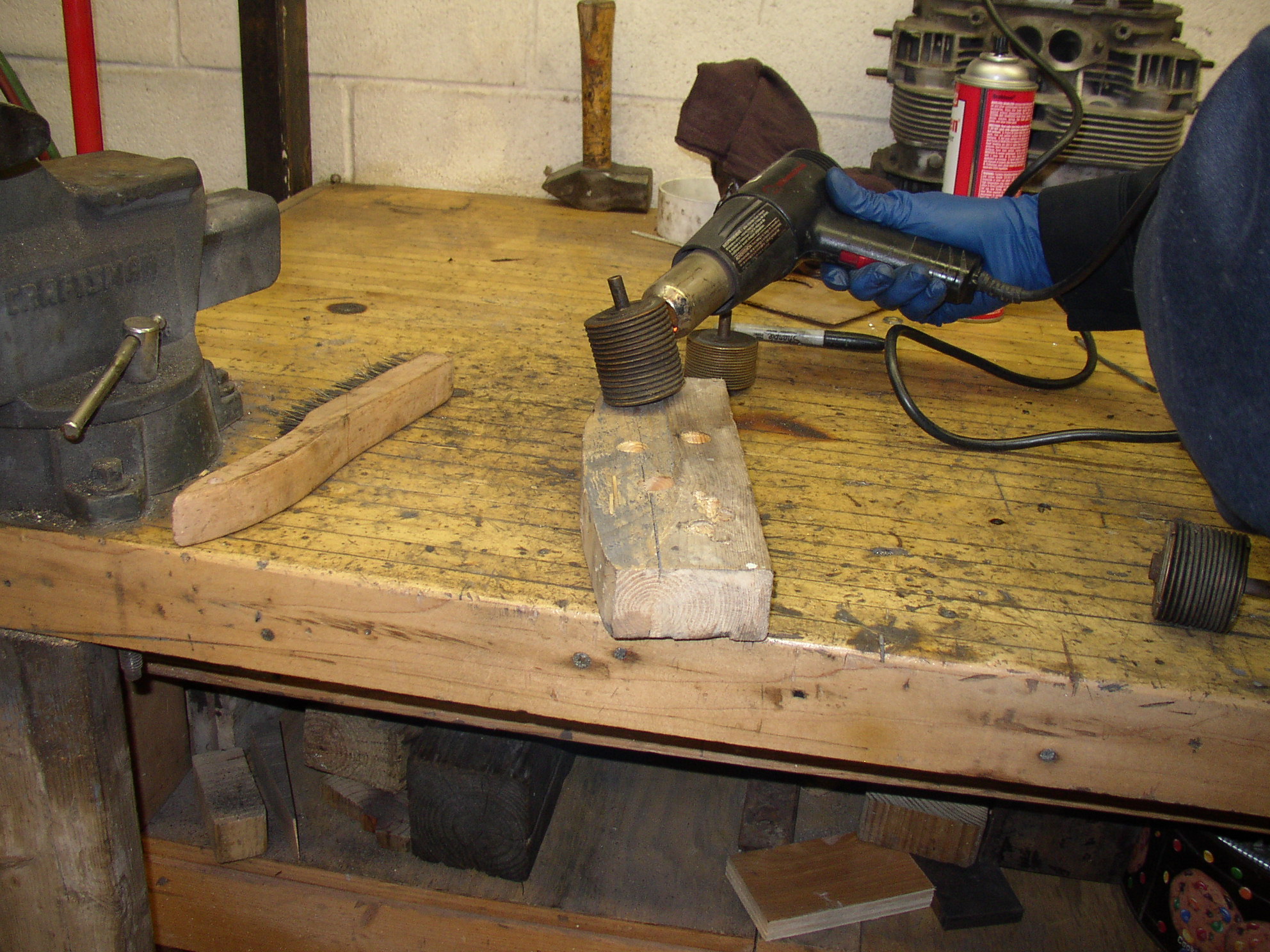

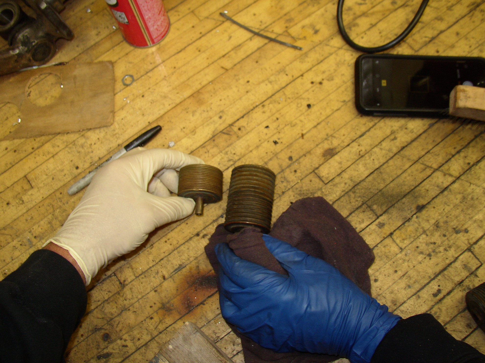

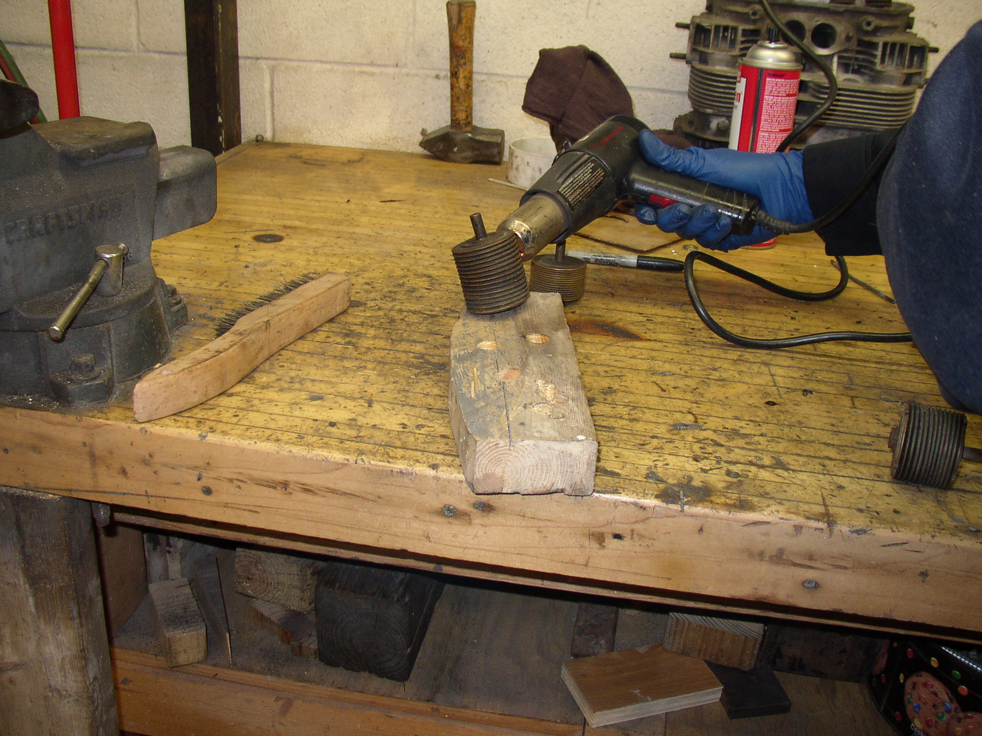

Sean testing stats with a heat gun.
Stupid bell bolts spun taking them out, I welded nails to them. No more spinning!

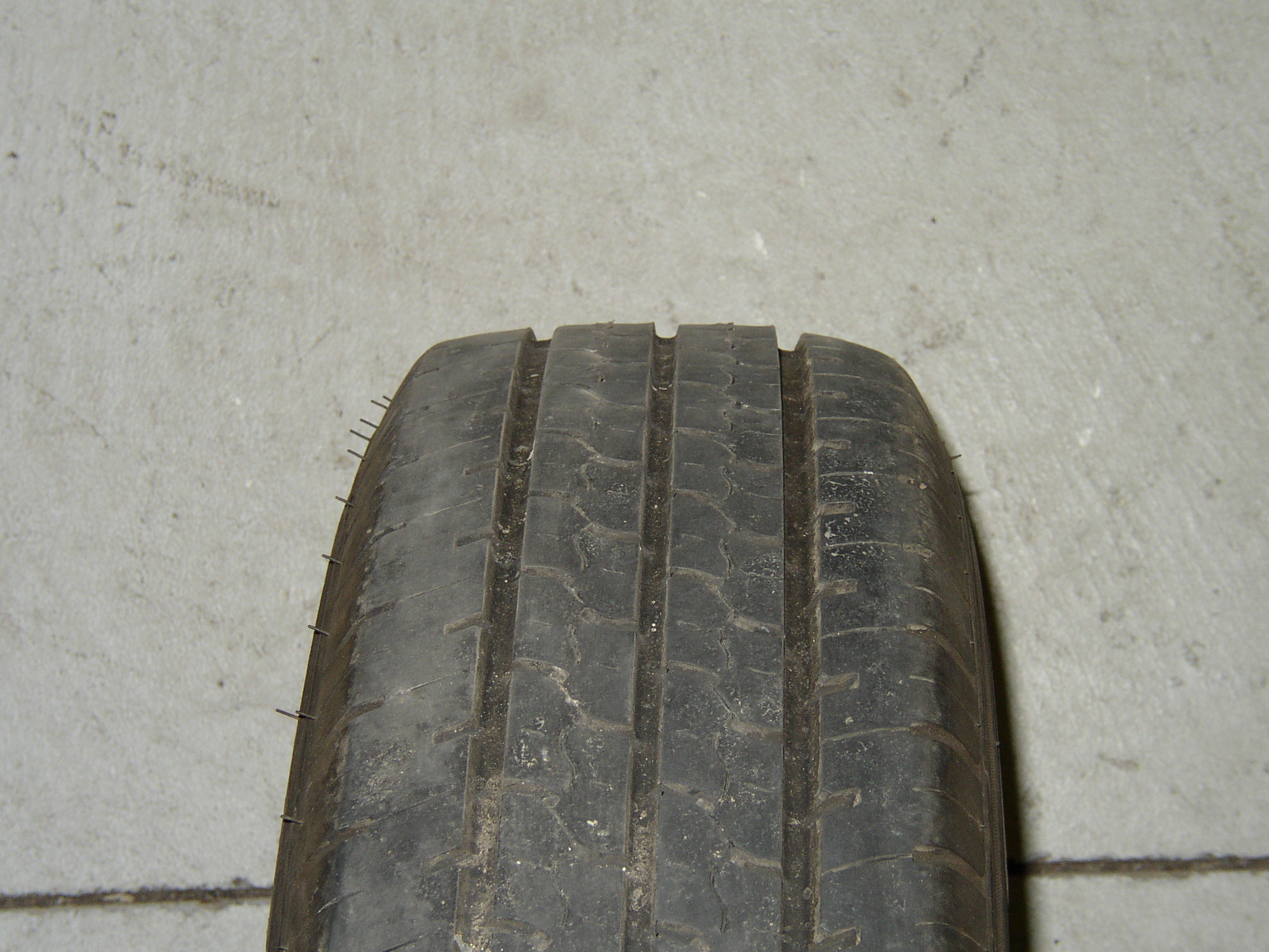

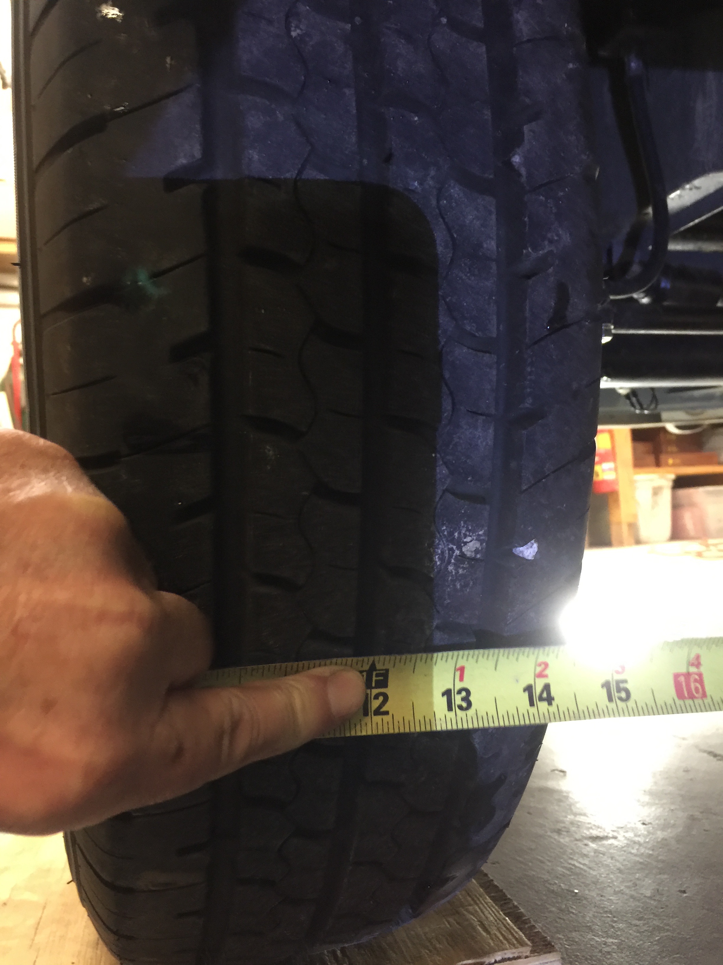

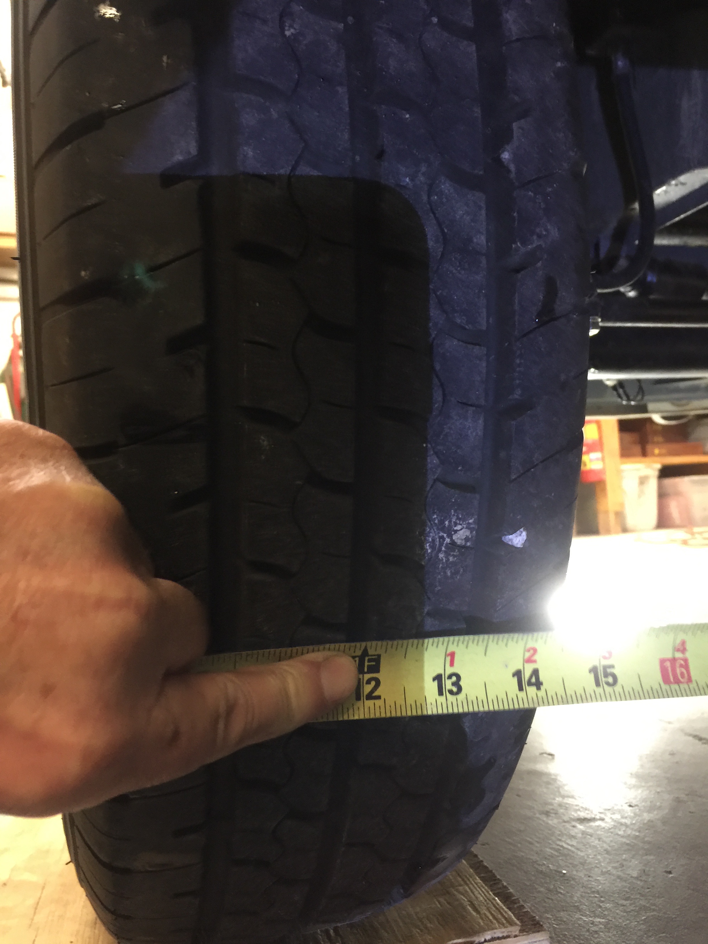

Severe inboard feathered tire wear after a thousand miles from way too much toe-out and negative camber on the front. Left side of the photo is inboard, we put these in the back to even out the wear.

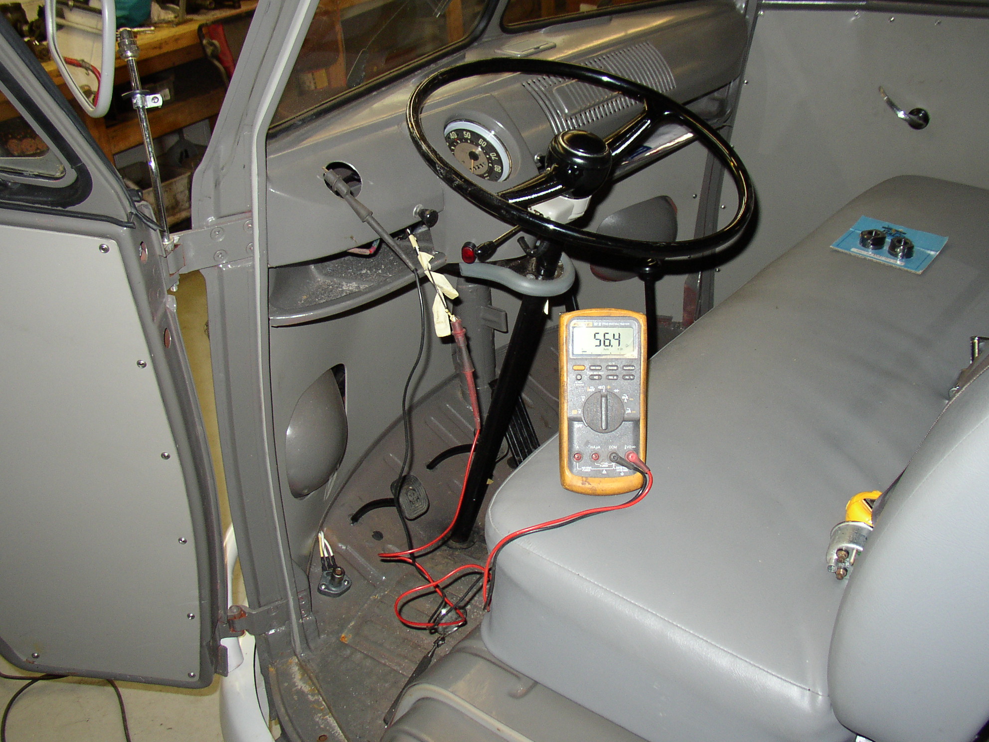

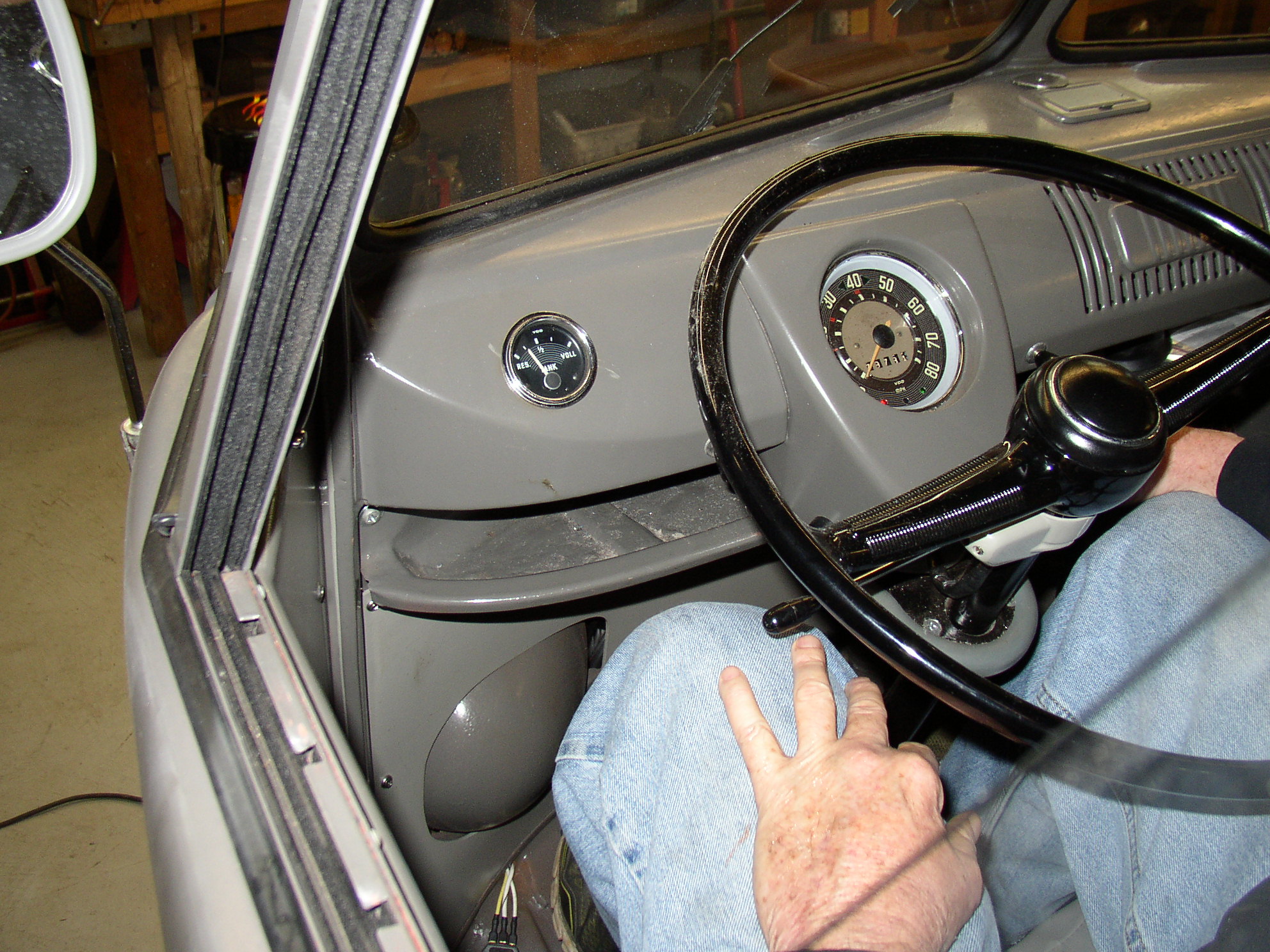

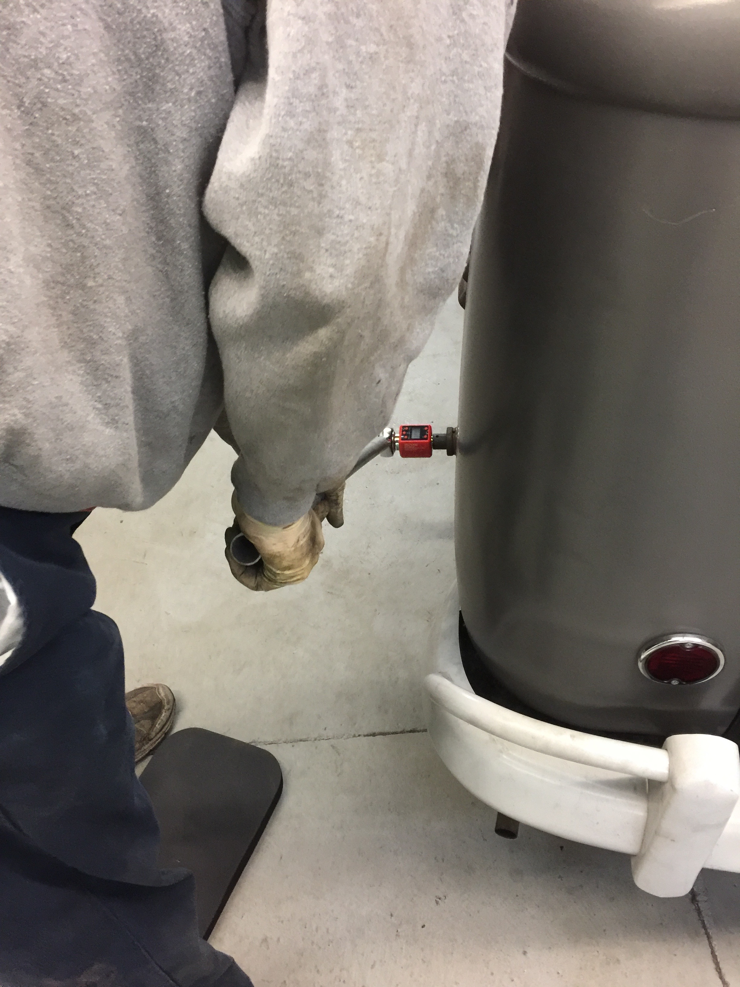

Sean wanted to be involved with this upgrade as a learning experience and he was an excellent student. At first I had him do all of the shit work cleaning parts while I watched, that was great for me. After working numerous days together he escalated to the point where he could torque lug nuts. Here's his best side. :mrgreen:

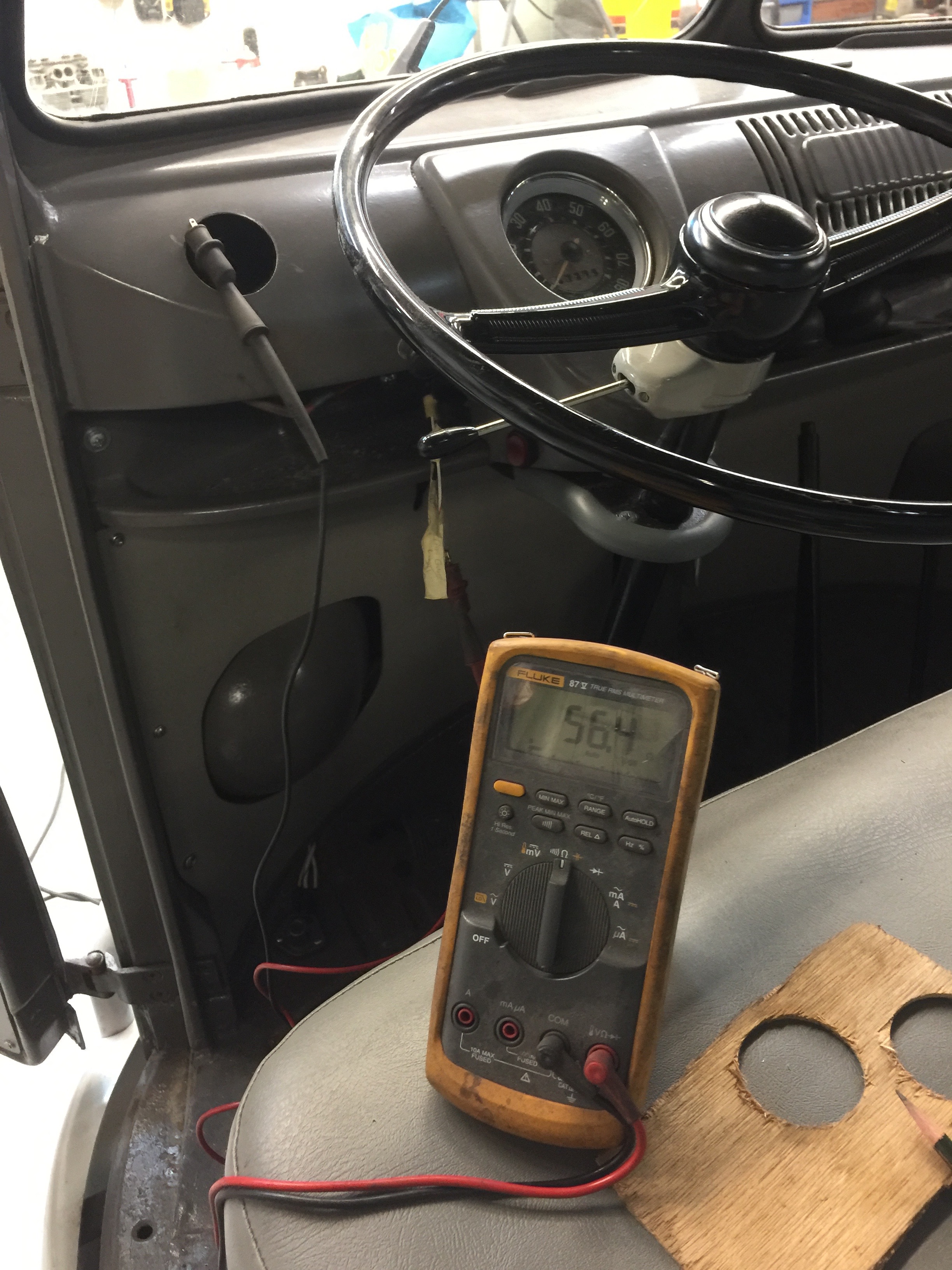

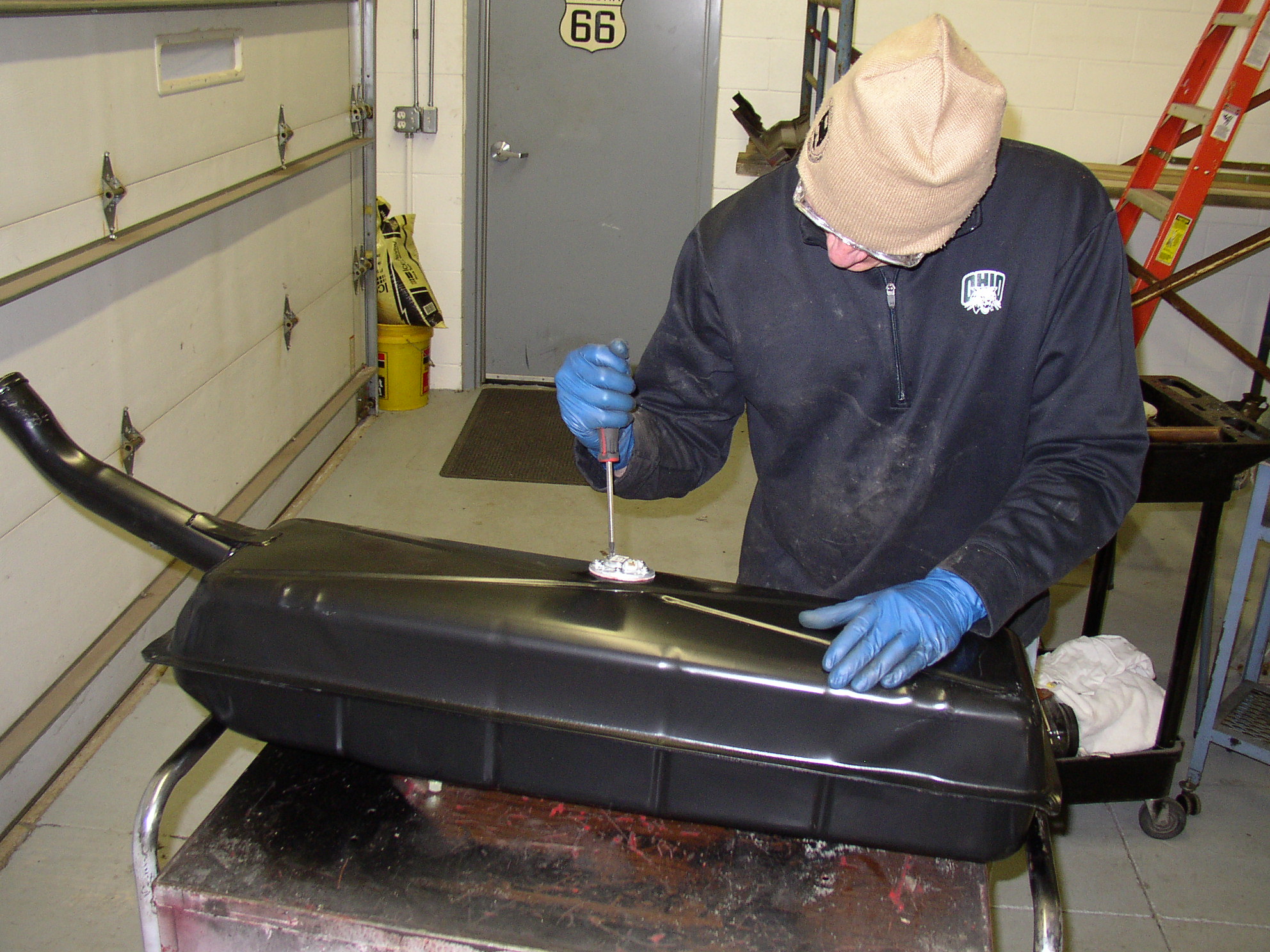

We drilled a hole for the gas gauge, installed it and I wanted to verify the sender was working correctly. I guessed 70-80 ohms with a couple of gallons, Sean guessed 60 making him smarter than me.
Voila! A working gas gauge!
