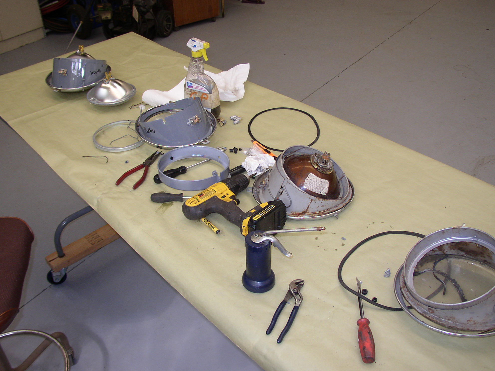

FNG assembling the headlight buckets. Pretty much all parts are dedicated left or right so make sure you keep them straight and mark them top and bottom to make it easier to assemble.

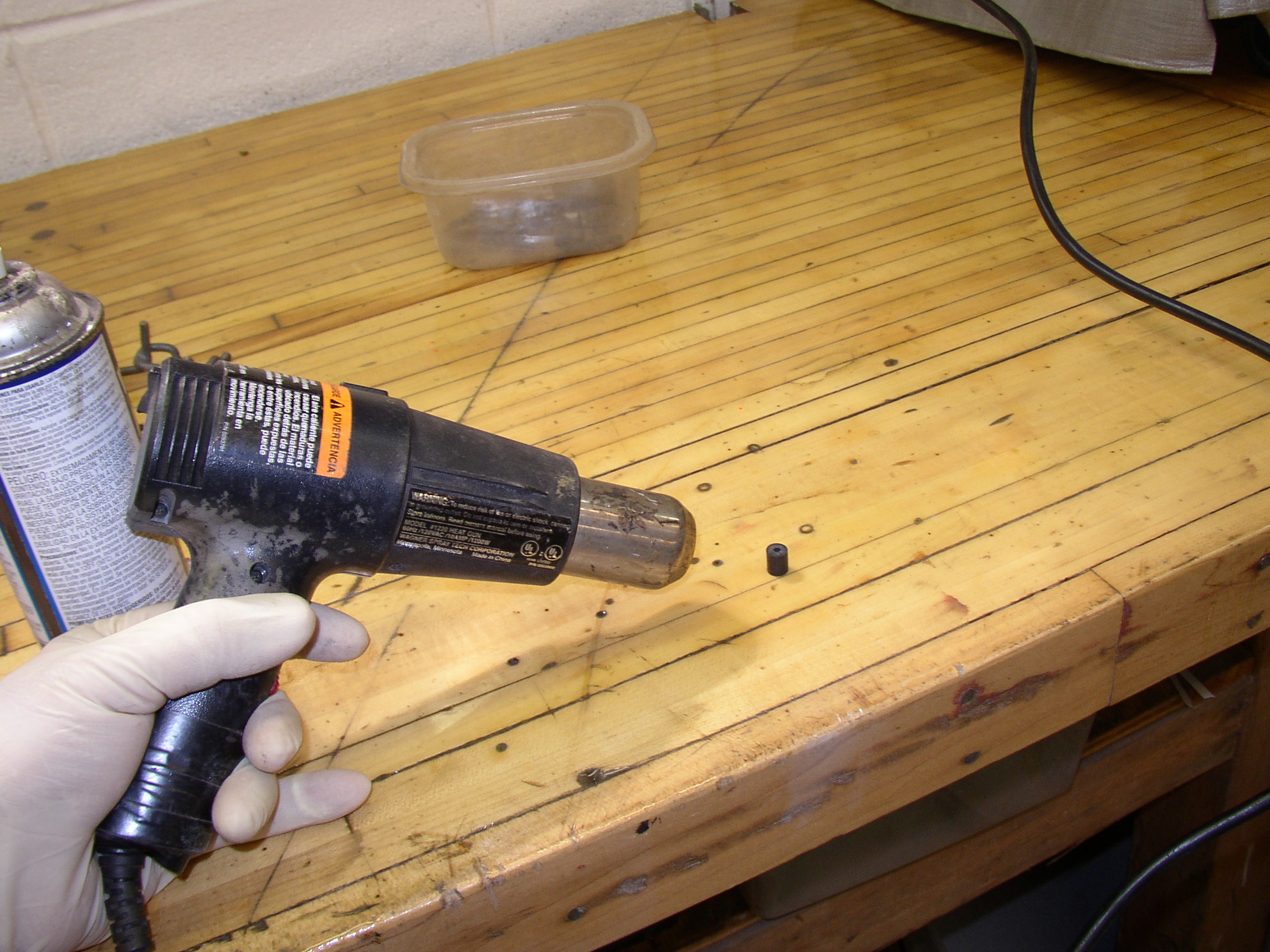

Heat any grommets to make them more pliable to install.

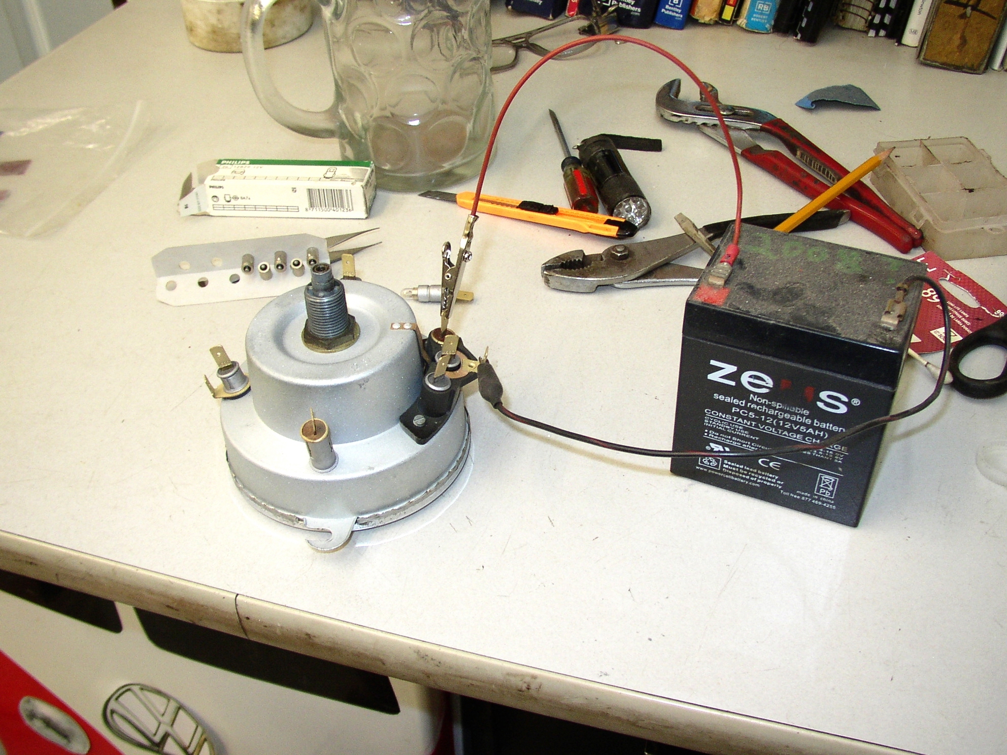

Meanwhile I was doing the speedo head, when I took it apart the colored gels fell out, which is pretty much normal. I bead blasted the can, buffed the chrome trim ring, cleaned things up and glued in new gels with weatherstrip adhesive.
I had the FNG bead blast all of the sockets and put in new 12v bulbs. I always test them for about 30 seconds each to make sure the bulbs are good and everything is super.
Here's a before and after picture.
After installation with the power on.

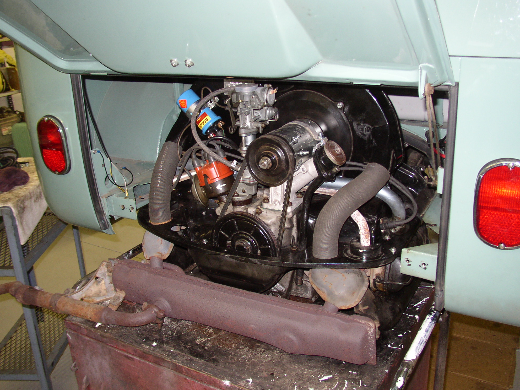

Here we're putting the bigger gen stand on, brand new 12v gen from Mick, replacing the flywheel, torqueing it. The flywheel was a used 12v so I blasted it and DA'd the friction surface with 120 grit. I checked end play before and after, it was the same.
Smile, Ken, it's not that bad. :D
I wire wheeled the lower engine studs so you can spin the nuts with your fingers when the motor goes in.
Test running the engine to make sure the gen charges, light works, fan doesn't rub, etc. Exhaust pipe goes to my exhaust fan in the wall.

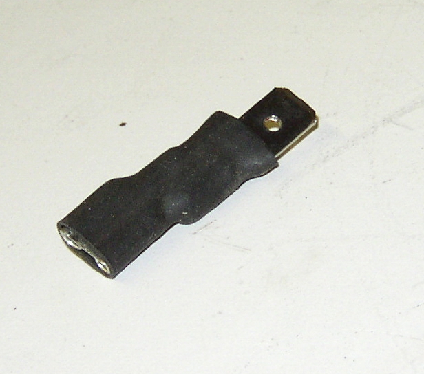

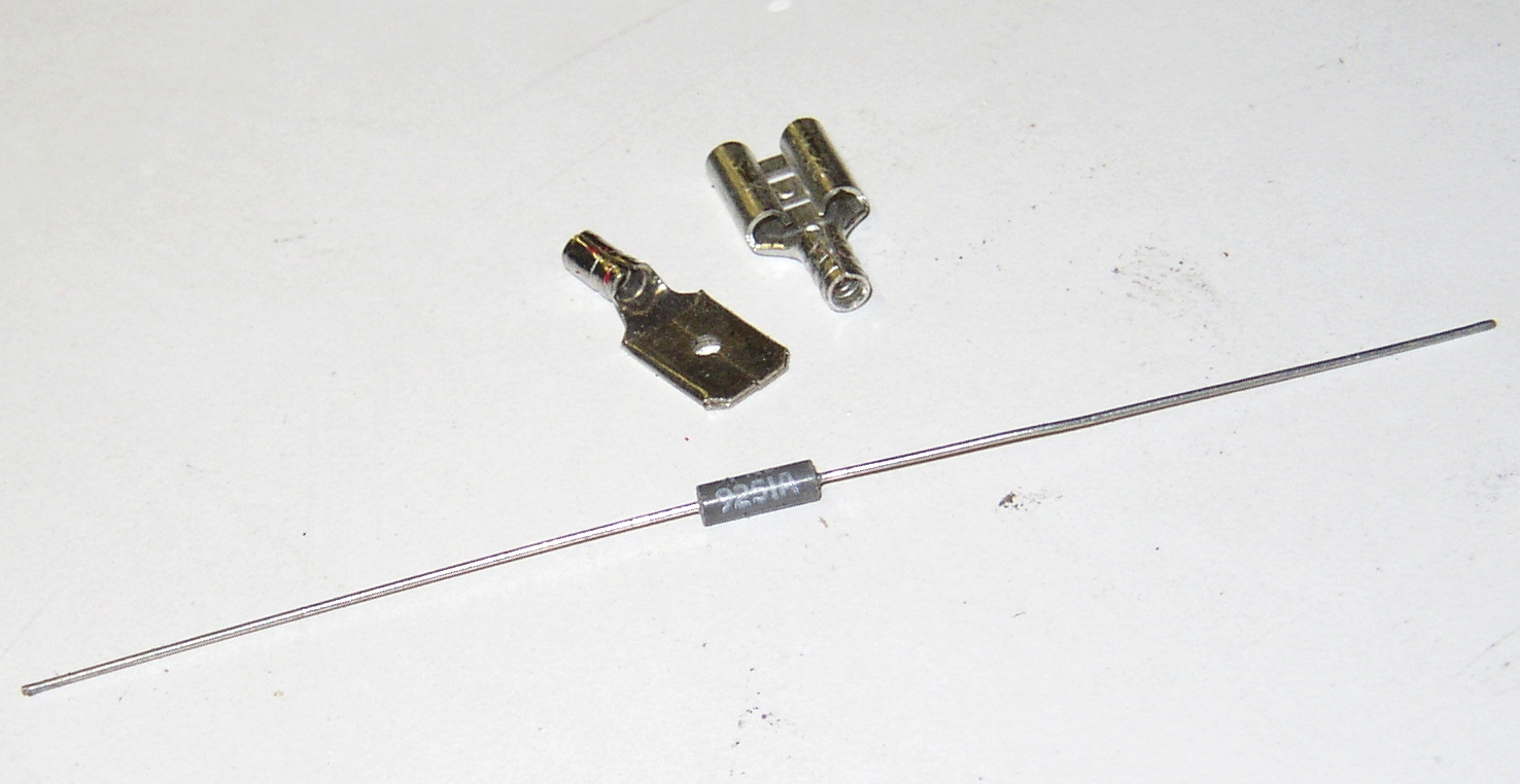

You've seen this before, the 162 ohm resistor in series with the fuel gauge power supply to cut the 12v down to 6 for the gauge.
Fold into a Z and more tubing, without it the resistor would likely break.
Installed in series with the power wire to the gauge.
Without it the gauge reads 1/2, with it it reads 1/3, just what I guessed when I read the sender with an ohmmeter.
