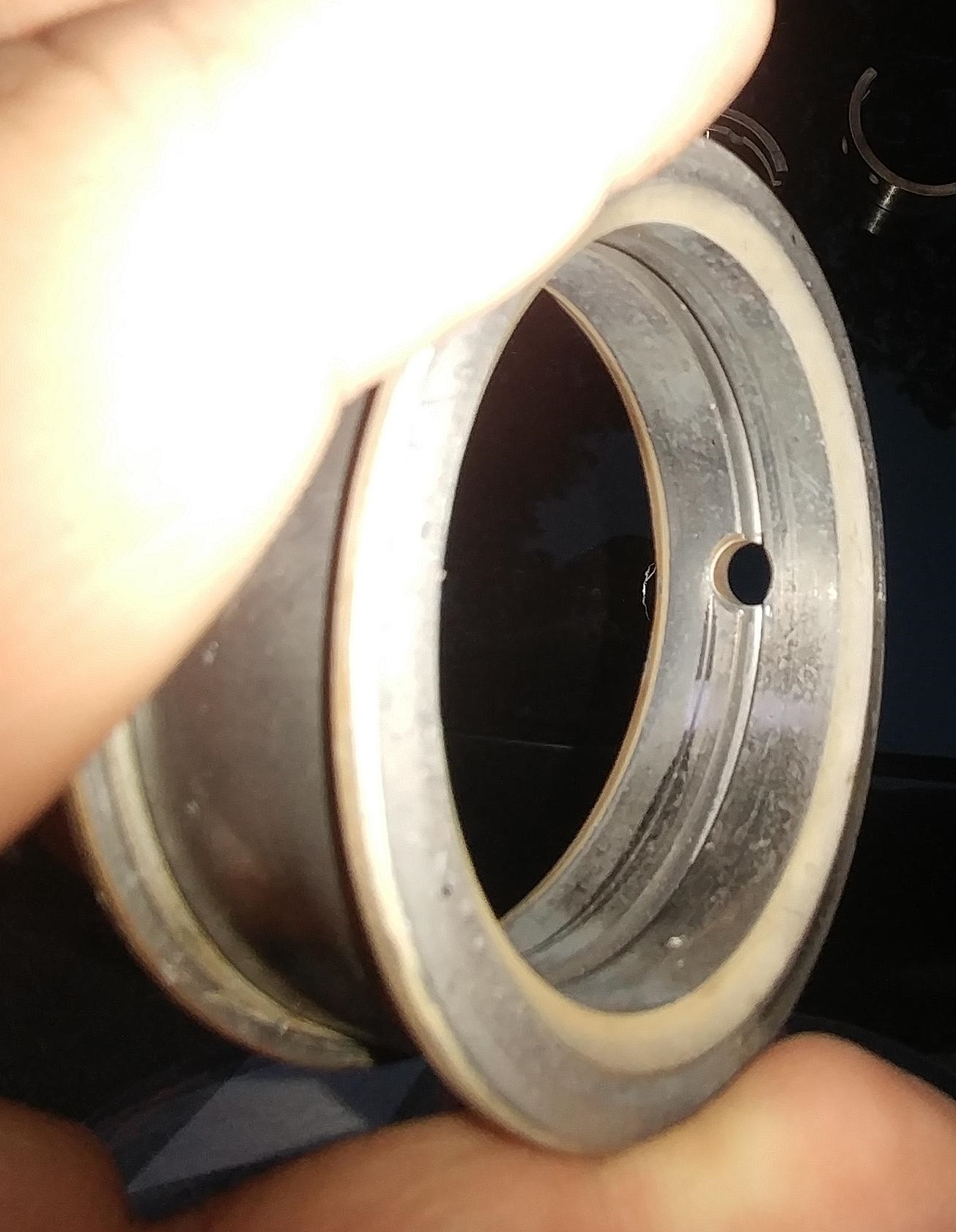

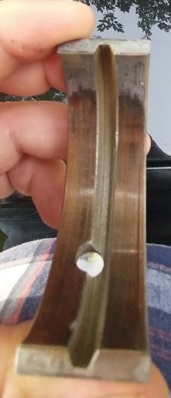

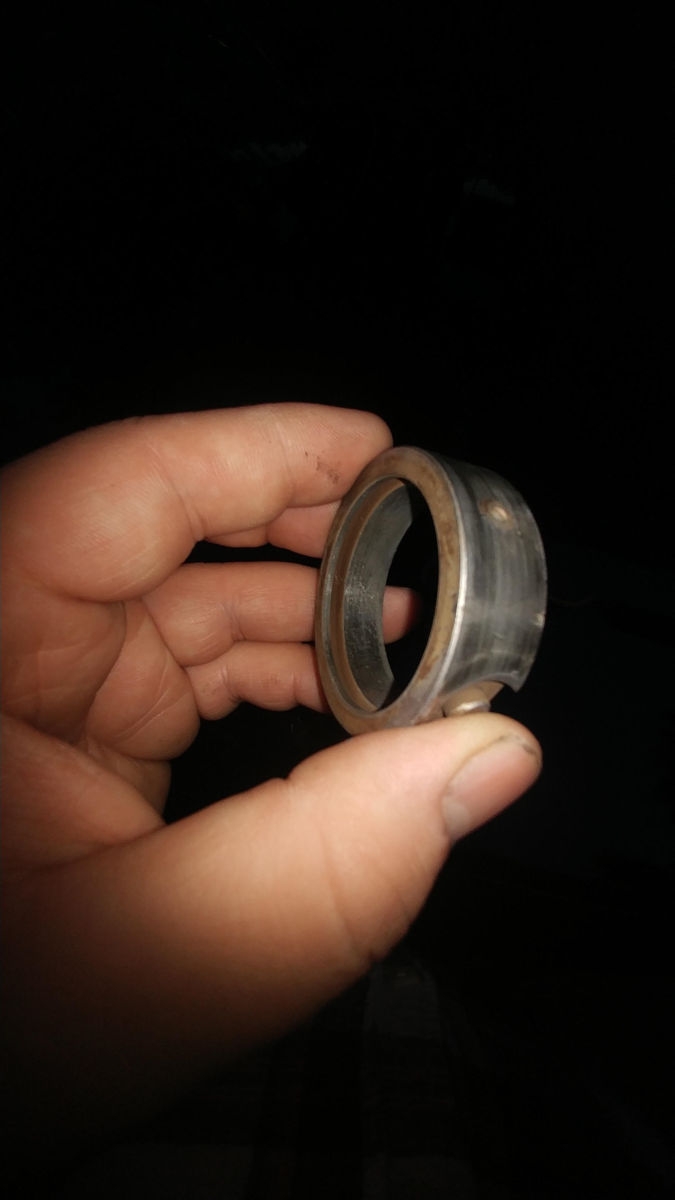

My rod bearings and main bearings have uneven wear patterns so I'm going to take everything to Gable's Machine Shop in Akron to be inspected. They did an excellent job rebuilding my Jetta heads a couple years ago.
Good move on the machine shop. while it's great to do as much as possible yourself, a professional machinist will know what he is doing. Maybe you can watch and learn. ;)

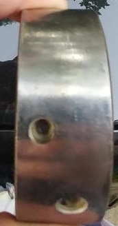

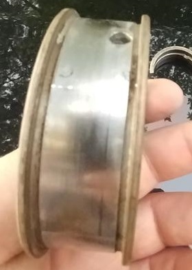

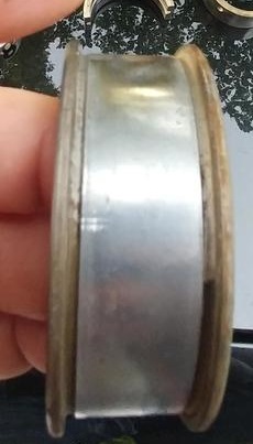

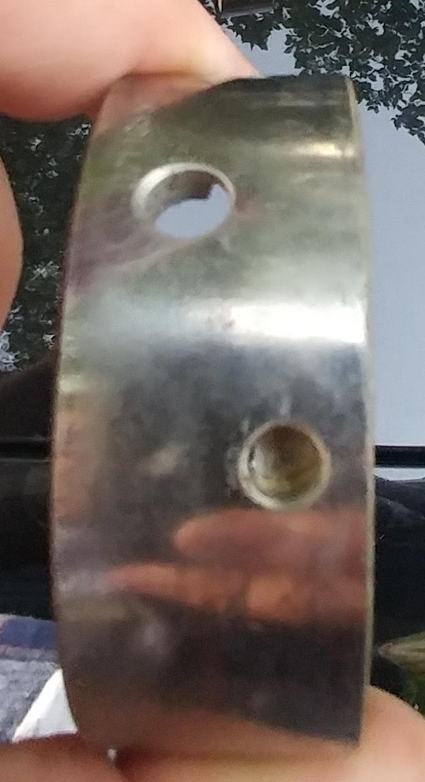

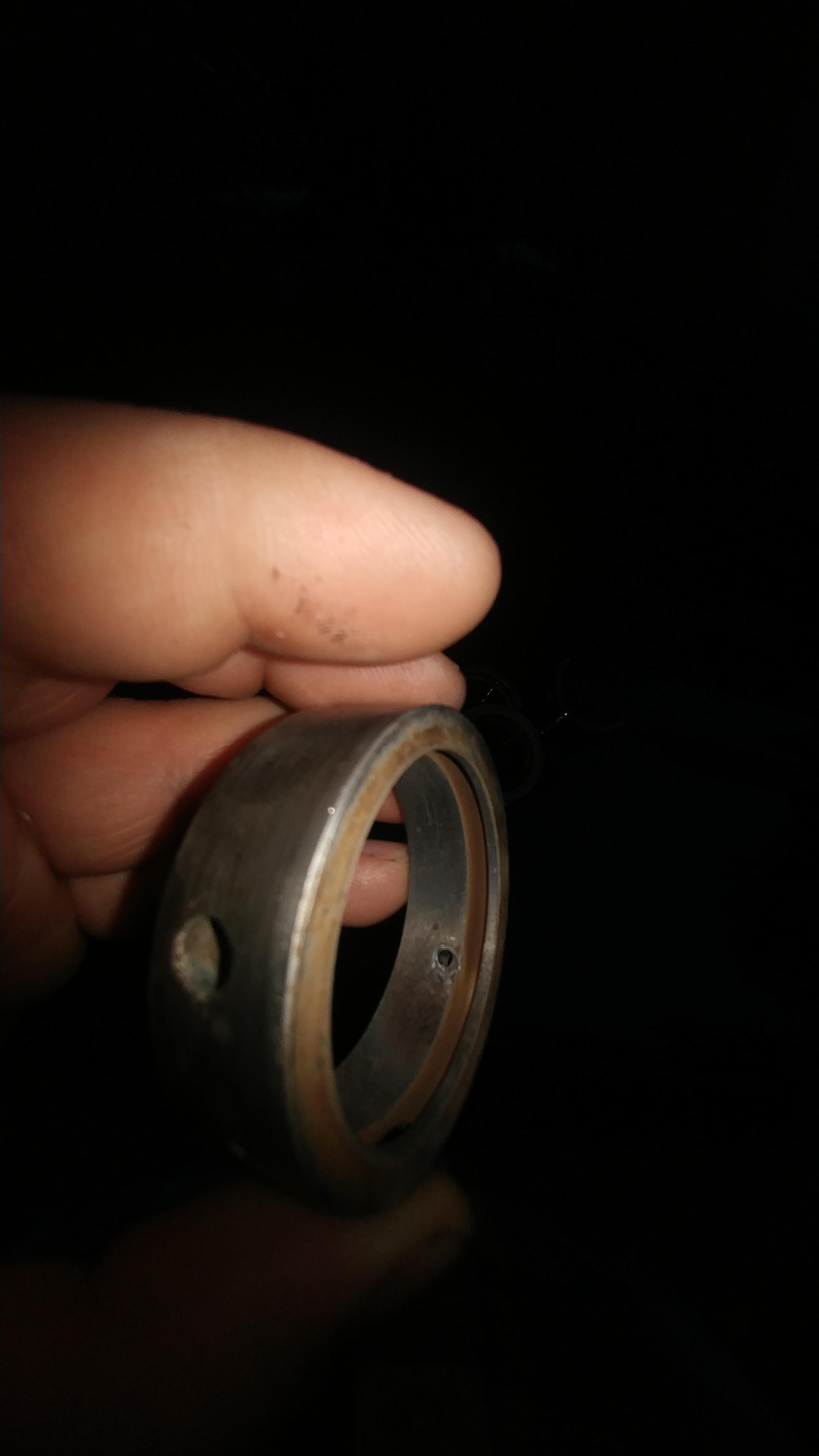

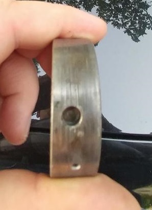

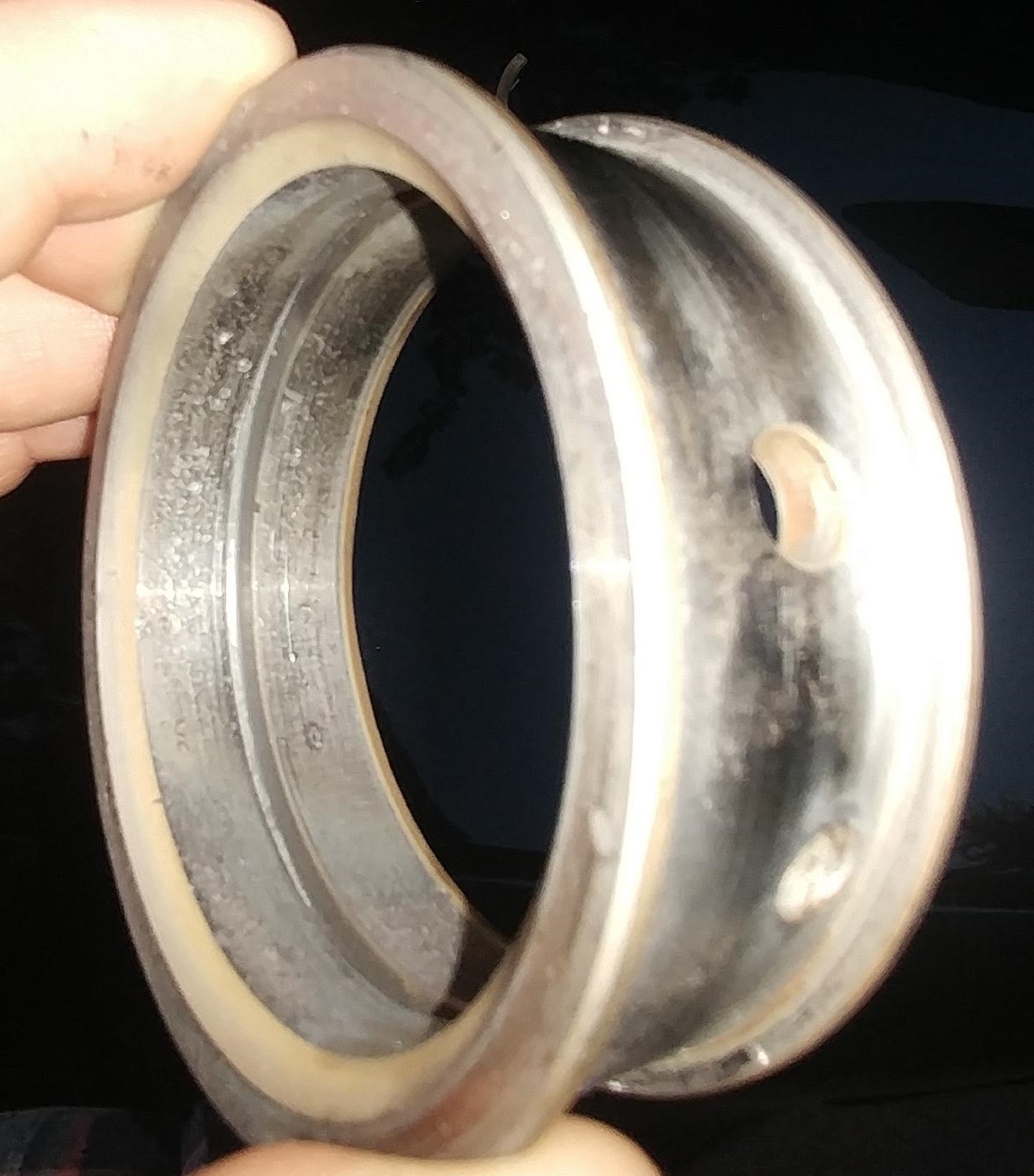

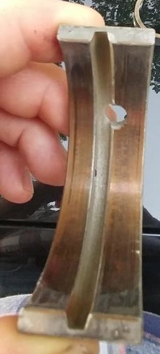

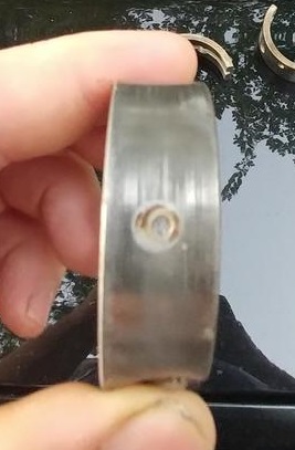

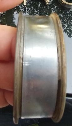

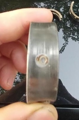

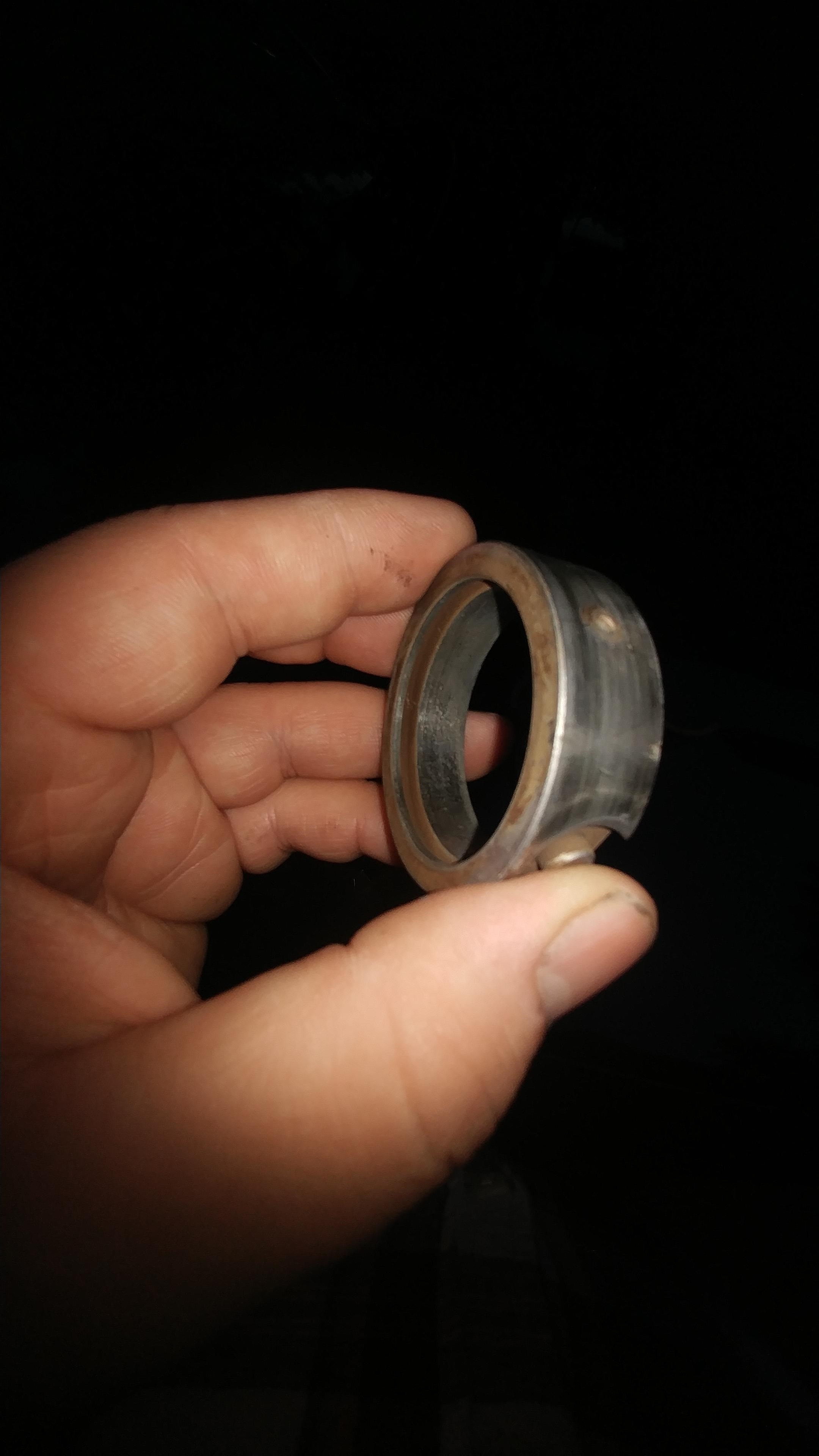

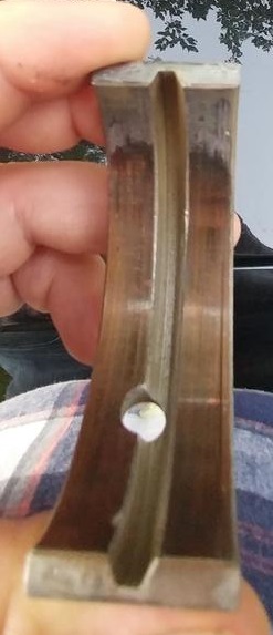

More bearing pictures. Also, LA Products in Akron looked at the case and said it didn't need align bored, but they never actually measured anything. Based on these bearing pictures, what do you think? Is there anywhere else to inspect it that you would recommend?
When I get off work, I'm going to head up to Kelly's Island.
If they did not measure anything, they can not make that assumption. go to a real machine shop.
