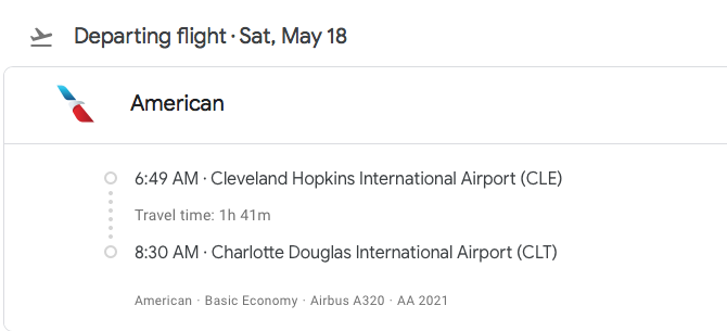

WideFive wrote: Tue Mar 26, 2019 1:59 pm Keep werking on it, we leave for CTS in 52 days!
Swing by and pick me up! :D
