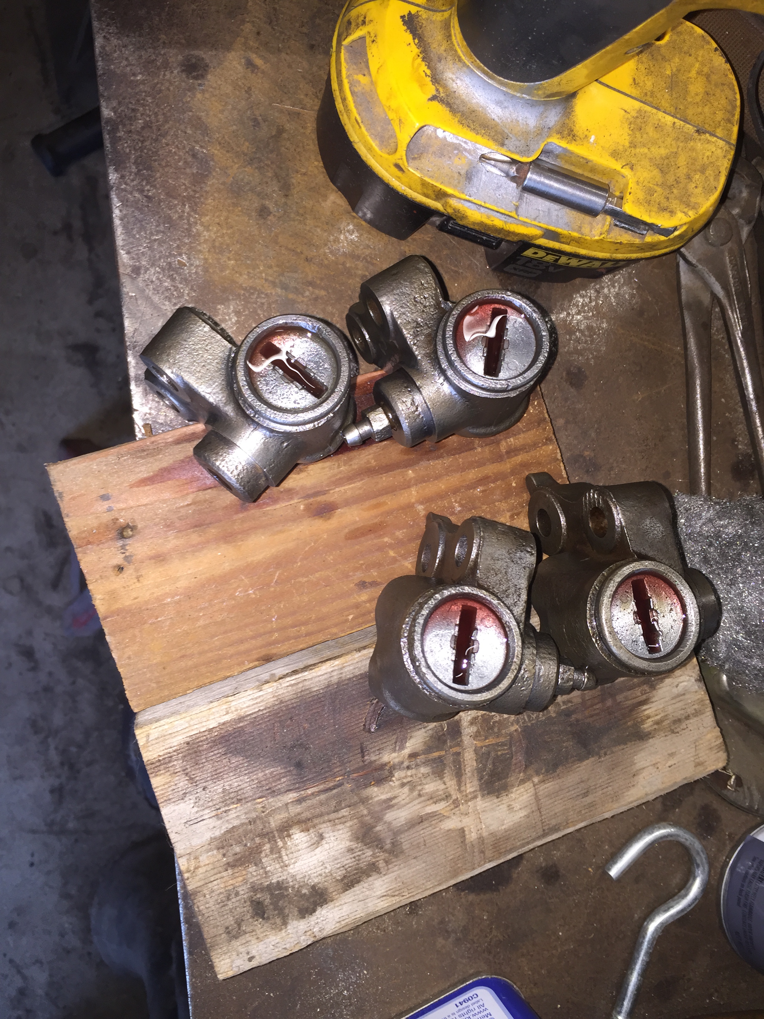

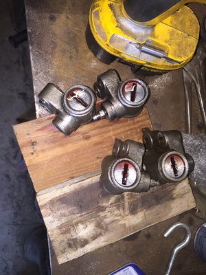

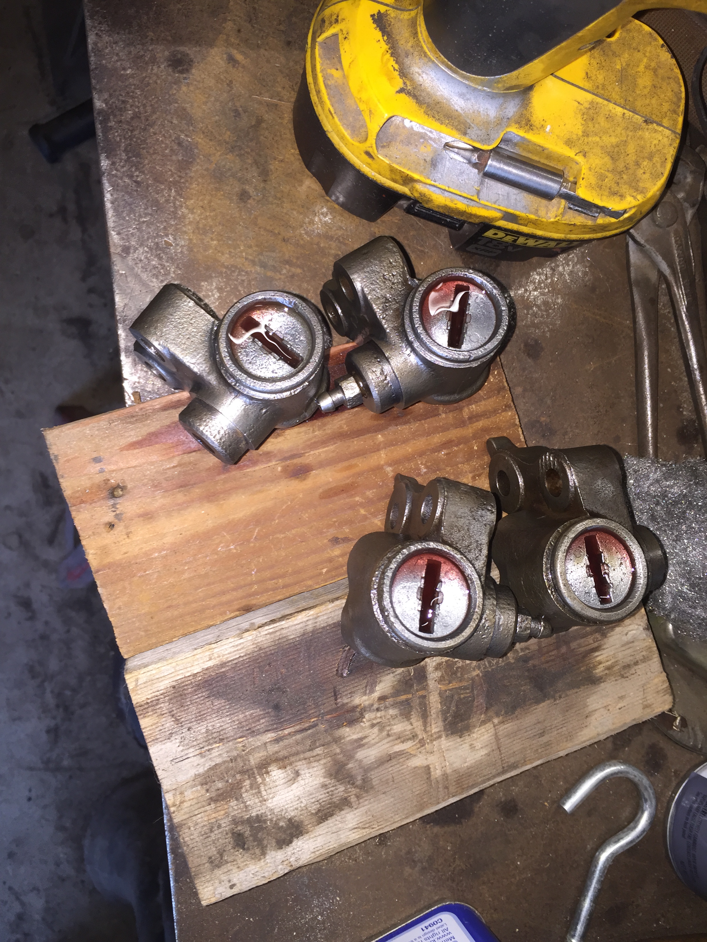

still need a brake wheel cylinder 1960 panel
Re: Monsters 59 panel project
I have a couple of rebuild kits for those 211-698 291 if your want to go that route their yours.
monsters59
Post by monsters59 »
that would be great how do i get ahold of you bill n if there is a good time ? please and thank you
monsters59
see i was going to rebuild um but ruined one of the pucks taking them apart ...this thing sat along time ...frozen solid ...after i soaked um in tranny fluid for 24 hours ..then soaked um in aircroil for another 3 days ...tough ....now that they are dissassembled they are cleaning up nice ...slight hone... clean no pitting ....goood old german steel :) :) :) :)

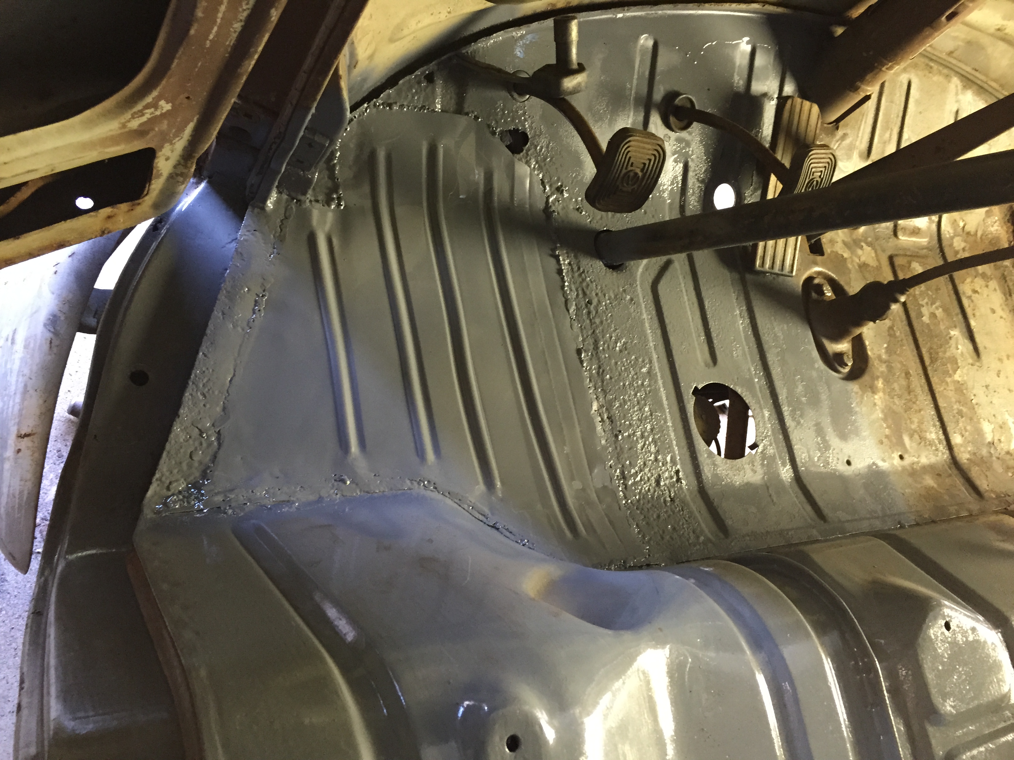

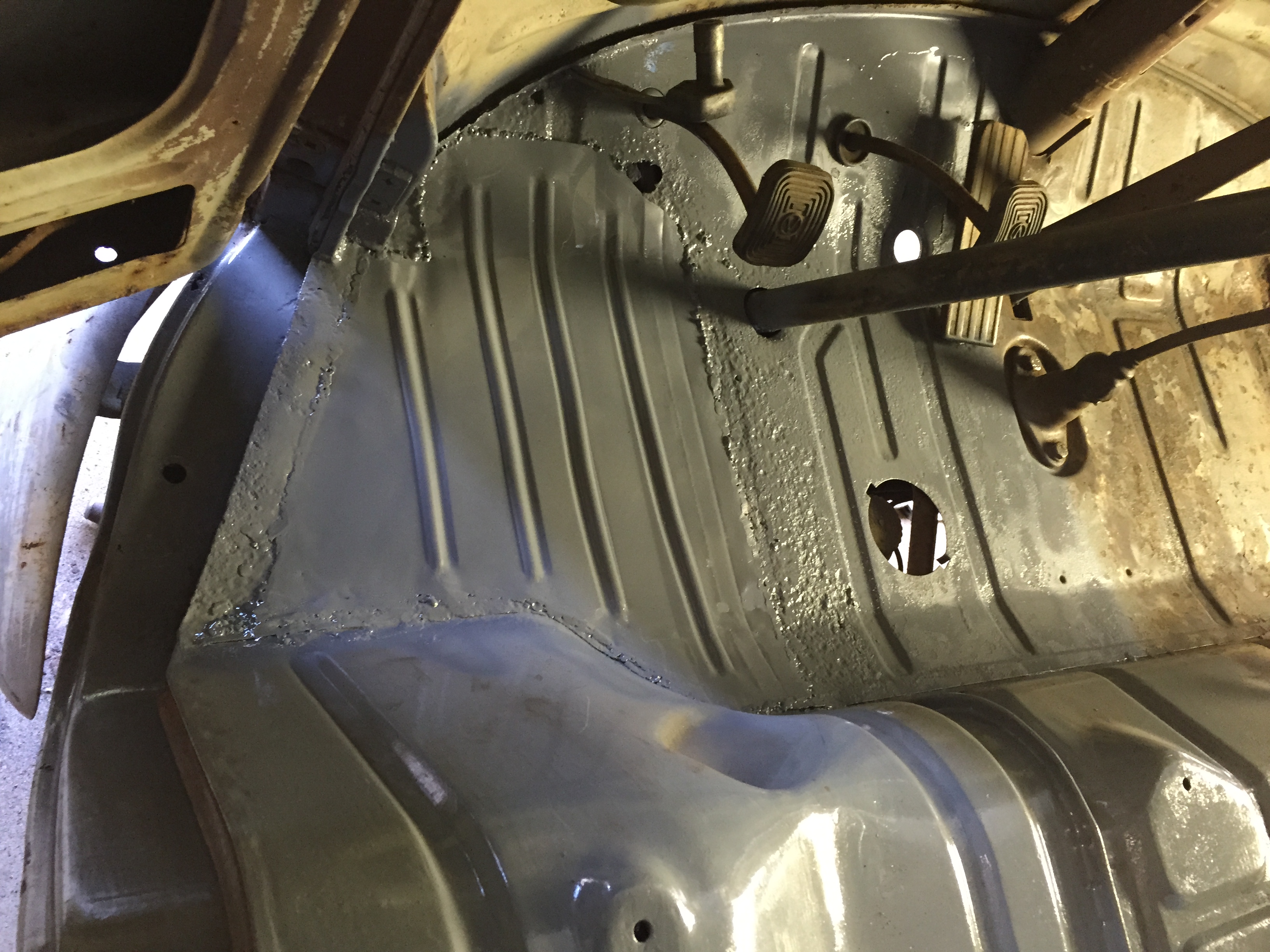

finished welding in driverside floor pan .....n paint ....home made repair panel .... ;)

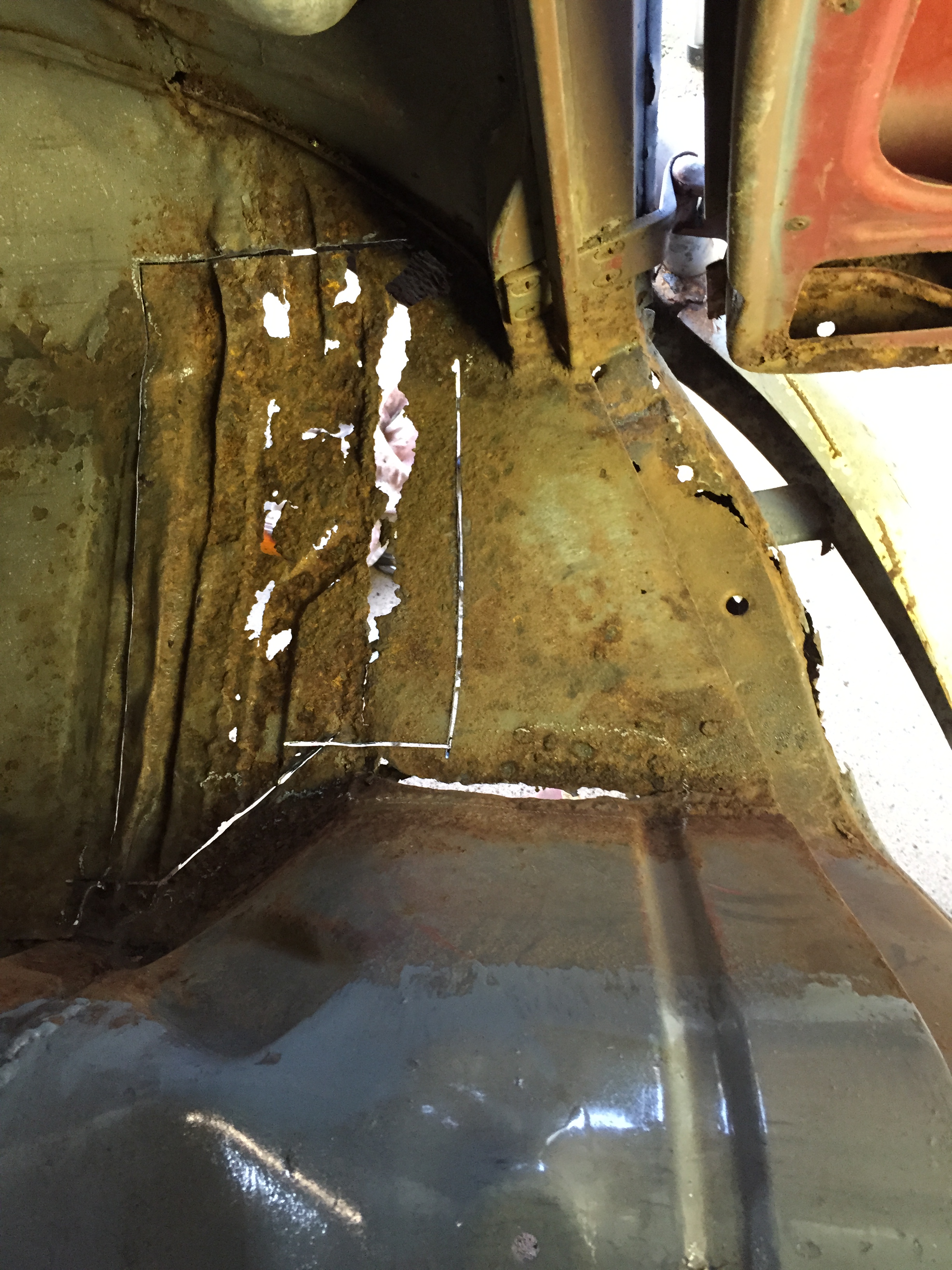

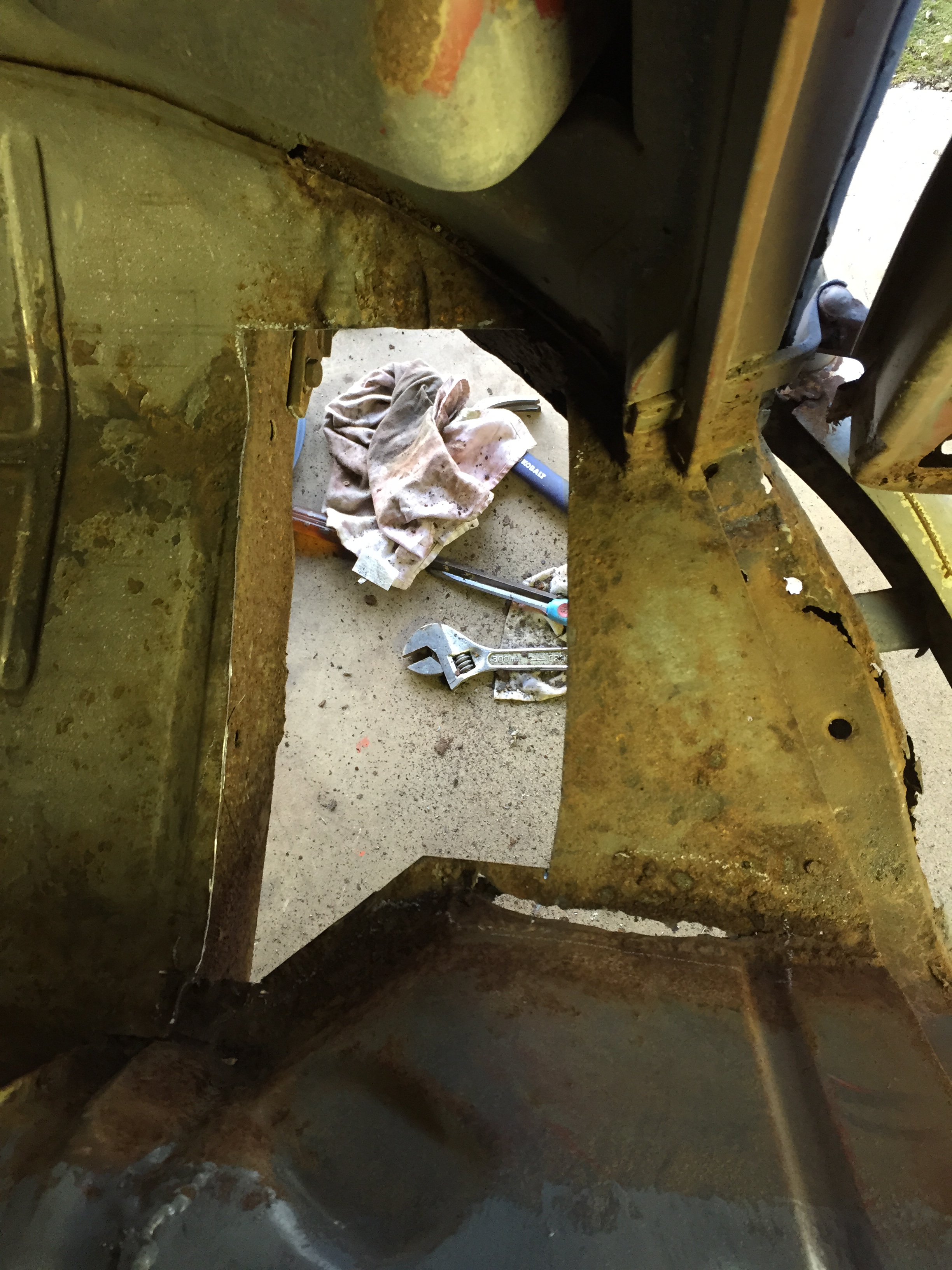

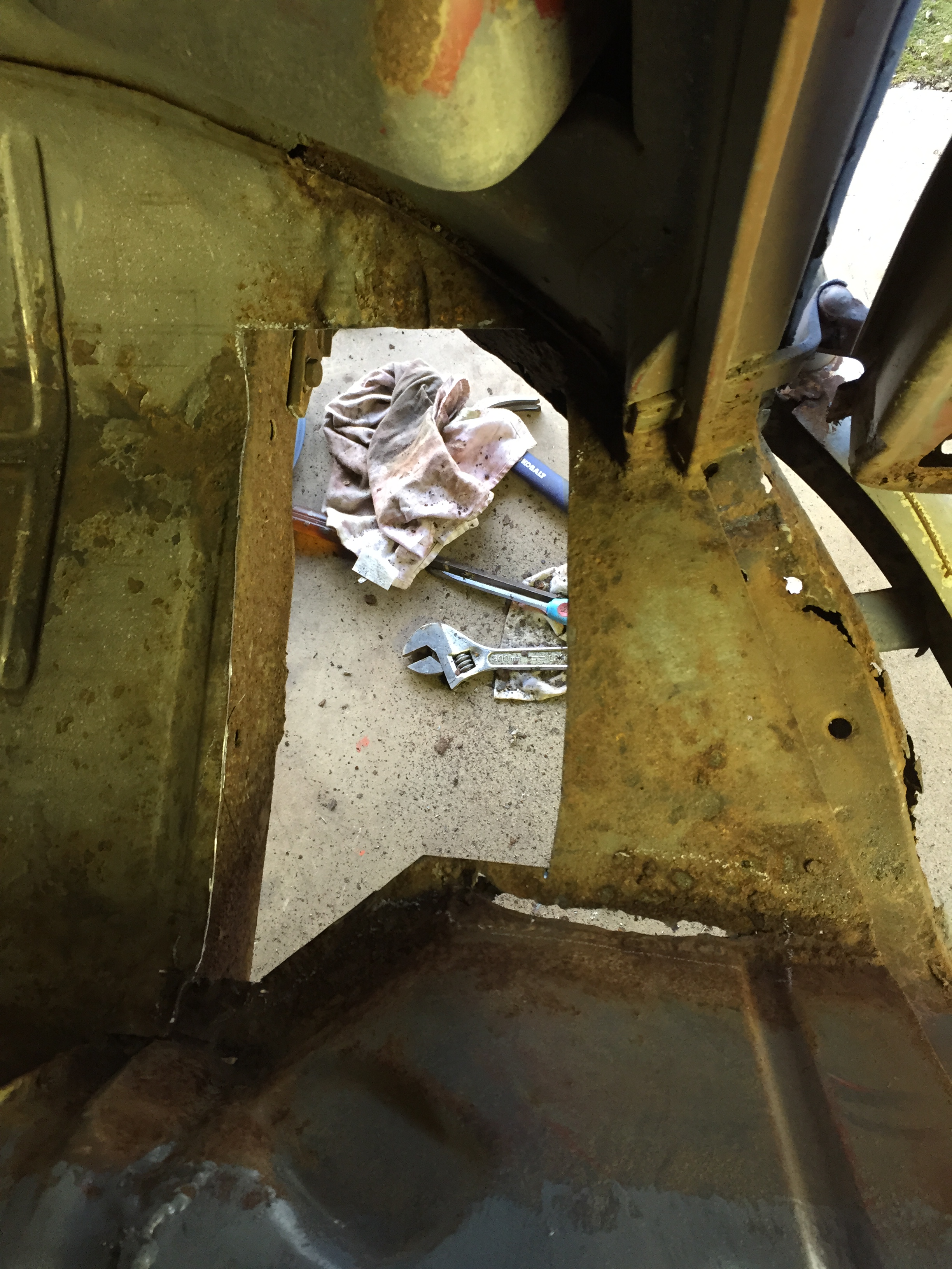

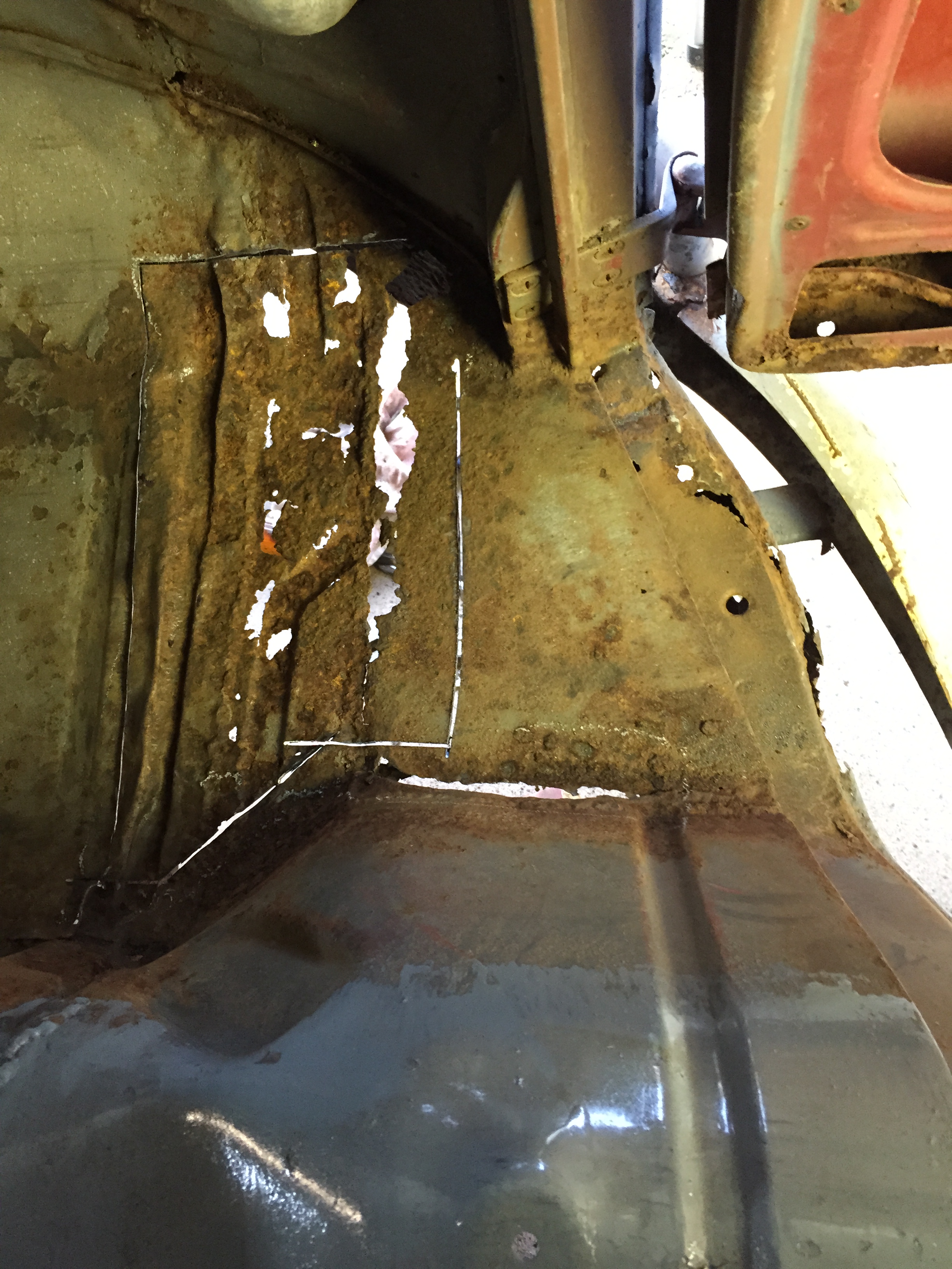

start on passenger side cut out rot make new panel
