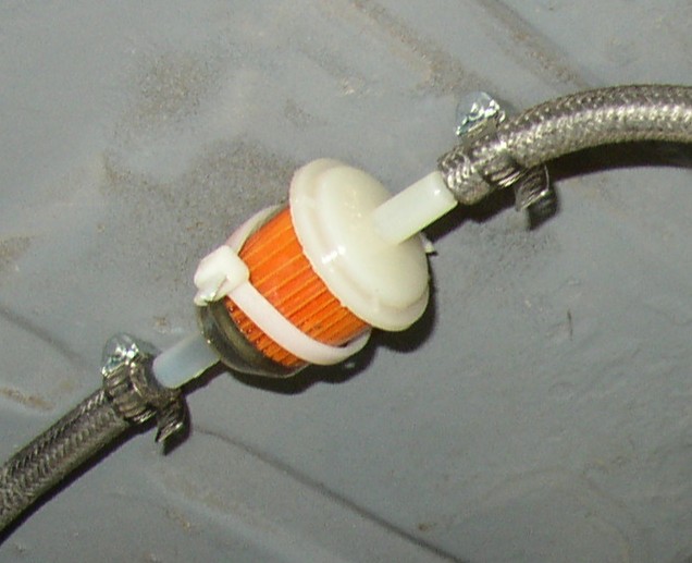

After all the shit you've given people about worm drive hose clamps....
I'm actually surprised you have clamps at all since it's not on the pressure side of the pump :lol:
Good job not forgetting to weld the clutch cable tube ;)

W5: Shit I've given? I don't remember that. :? I don't like people using 1/4" fuel hose and screw clamps, and yes, for a while I was using spring clamps on fuel lines because they look cleaner. I'd still be using spring clamps if I could find ones that fit the cloth braid fuel hose properly. The common ones available are just a few thou too small and you have to really fight them on. I think worm drive clamps look like shit.

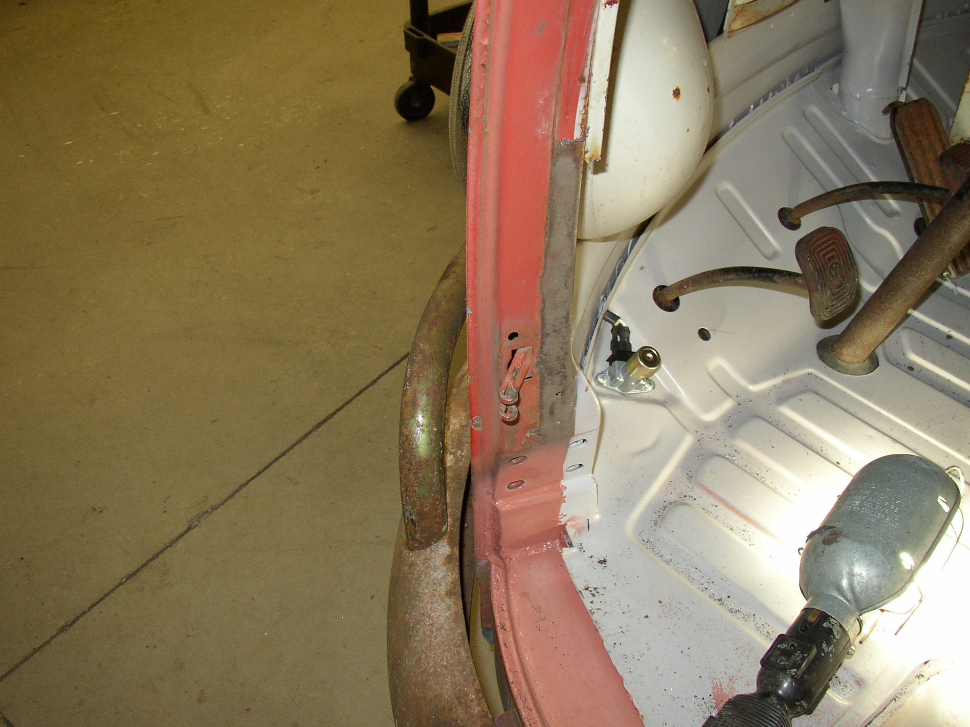

I went to install the front doors and realized I had forgotten/procrastinated to fix a weatherstrip channel. :oops:
This is pretty simple: Find some .033", grind the galvanize off of it so I don't get sick, cut to size.
Put it in the vise and bend the angles.
Fit it in place.
Drill holes for plug welds.
Clamp.
Plug weld.
Grind out welds.
