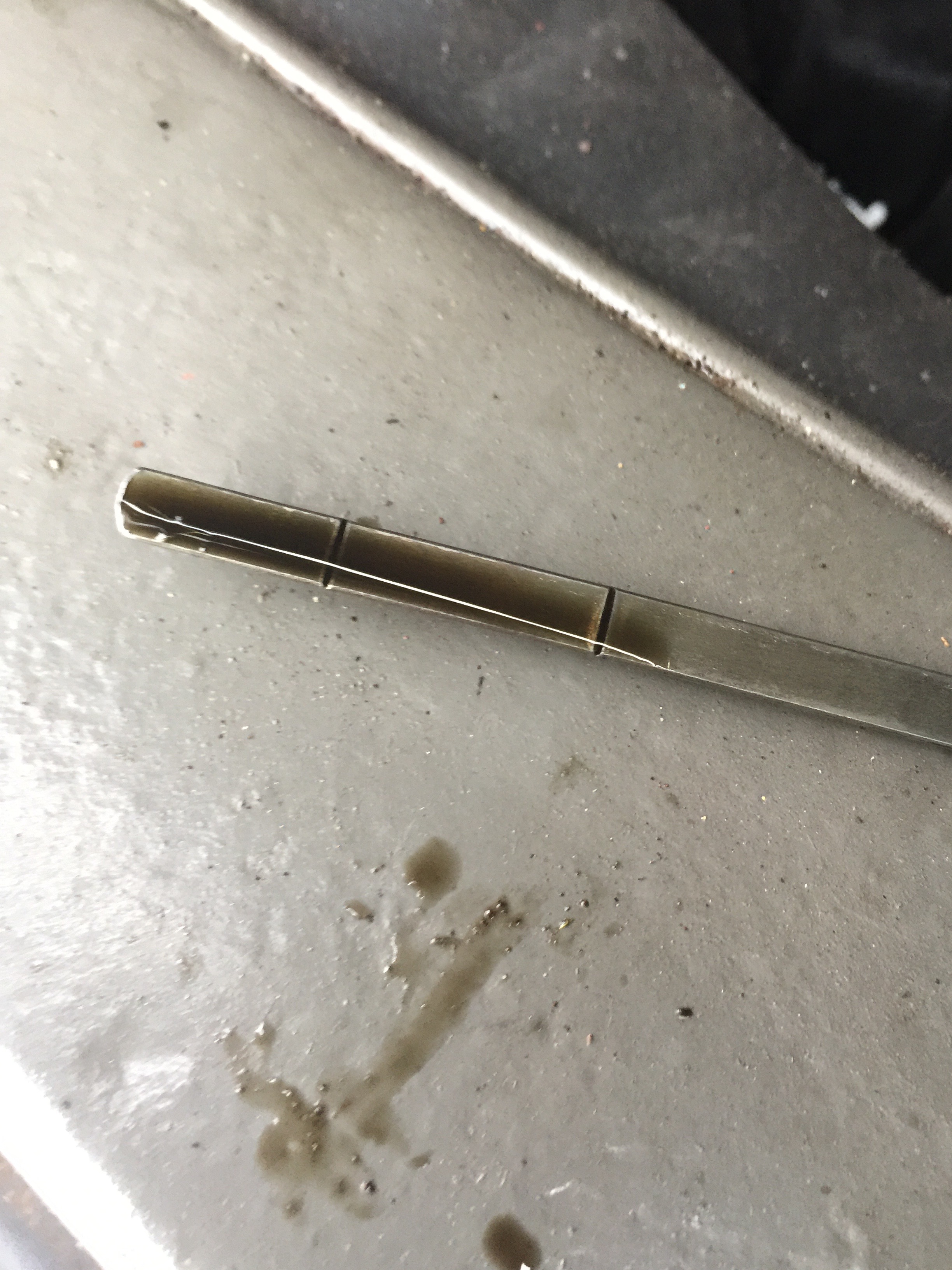

I know it doesn't effect pressure, but I did check the oil before departure and it was dead on. I get to Basil's and it doesn't look like it has any oil???
Then I check again and I'm wondering if I have gas in the oil.
It looks like there's more oil than there should be! My nose is horrible for smell, so I can't tell from the dipstick what I have going on. I start to think about too much fuel pressure and the pump forcing too much gas and some of it ending up in the crankcase. But I can't see any "shut down run off" that is common with that. (Ask me how I know!)
So I take it easy coming home and take the long route on 254. No performance issues or red light issues. I decide to run it again for a quick freeway stretch and on the exit ramp at idle the red light is back on. Out again under load.
When I get it home The dipstick is not too hot to touch. It's hot, but I can touch it and hold it.
Here are some shots of the dipstick.

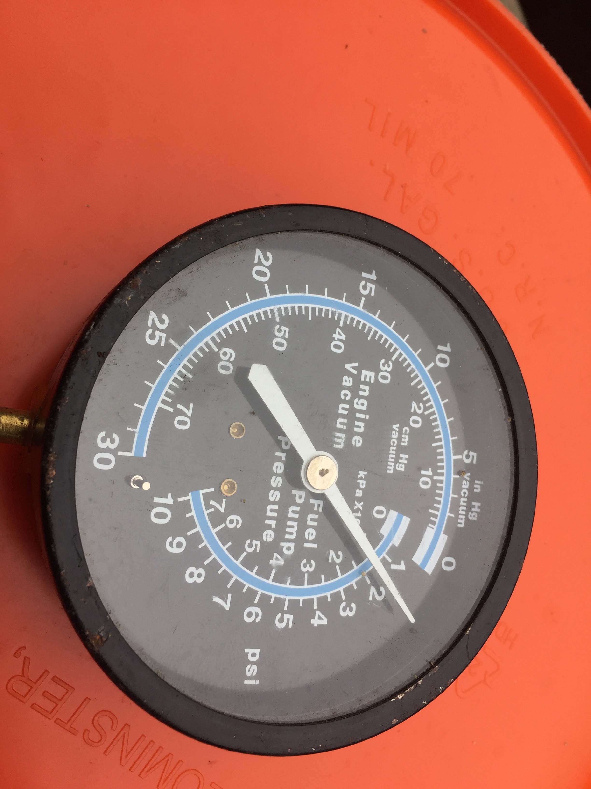

I have to work in Columbus tomorrow, but is there an easy test for oil pressure? Do I take out the oil pressure sender and insert a gauge there? Get a reading at idle and with some RPM's?
If I put a FP gauge on the line coming out of the fuel pump, how much can I tell if I rev the engine?
I actually think I have a FP gauge (It may be for a fuel injected bay, but I'll see) and I think I have a oil pressure gauge. I just need to learn how to use and read them.
