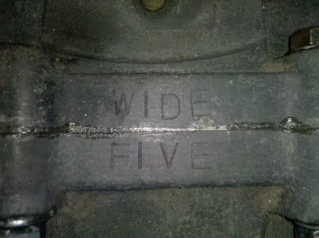

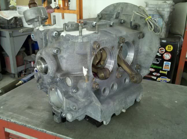

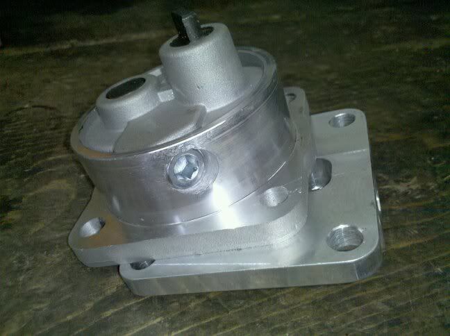

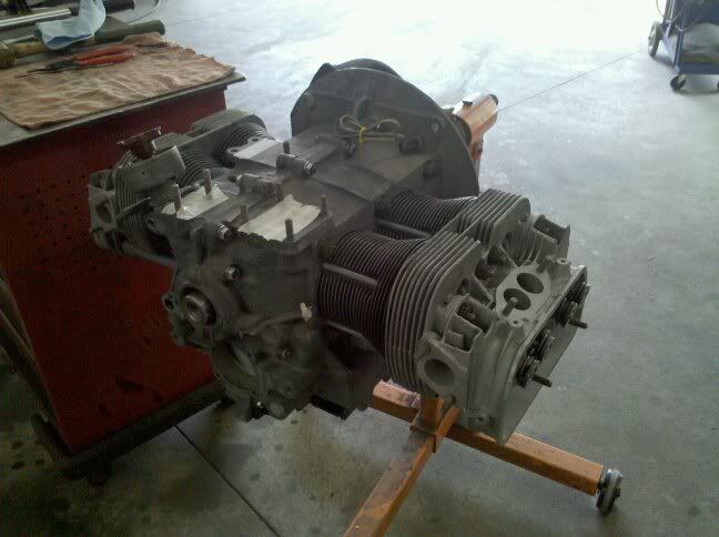

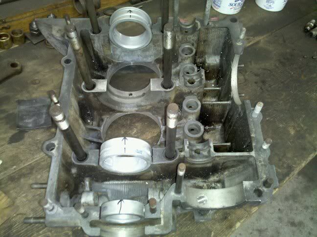

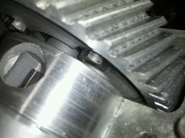

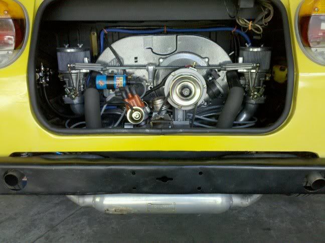

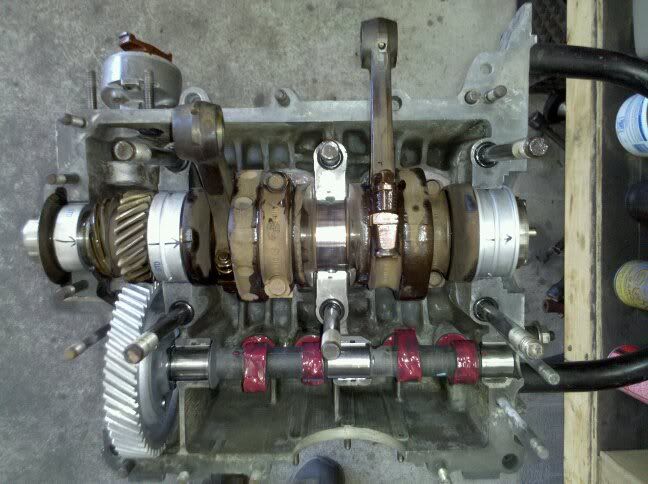

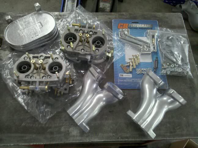

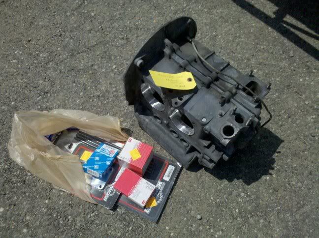

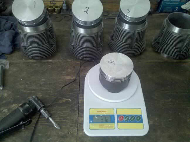

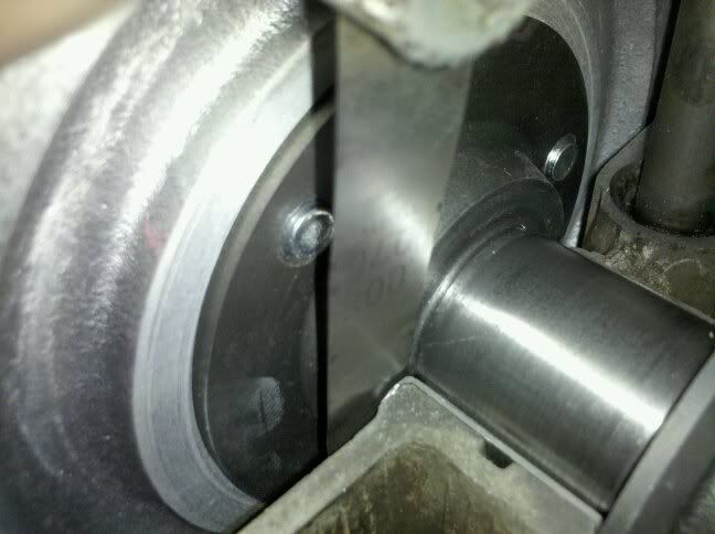

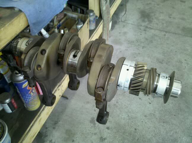

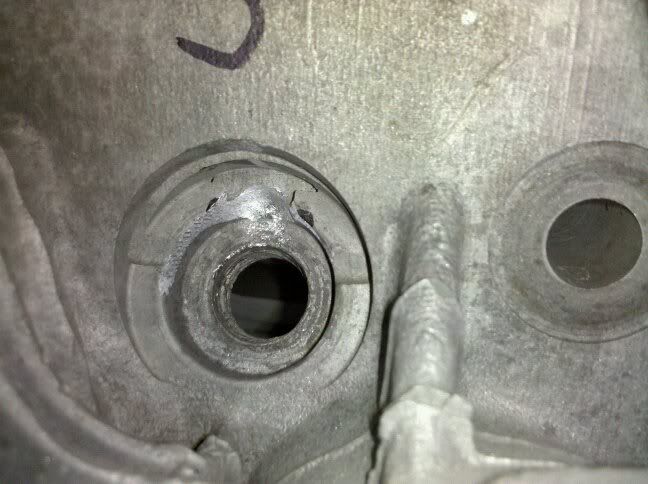

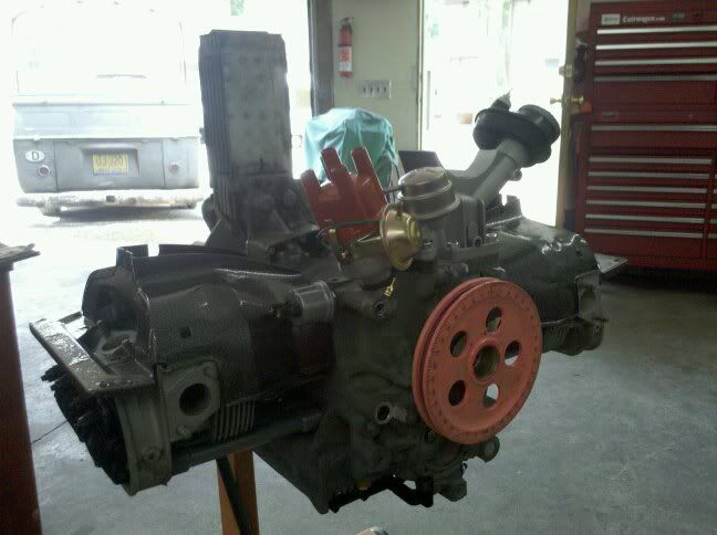

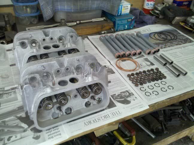

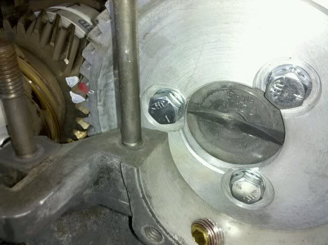

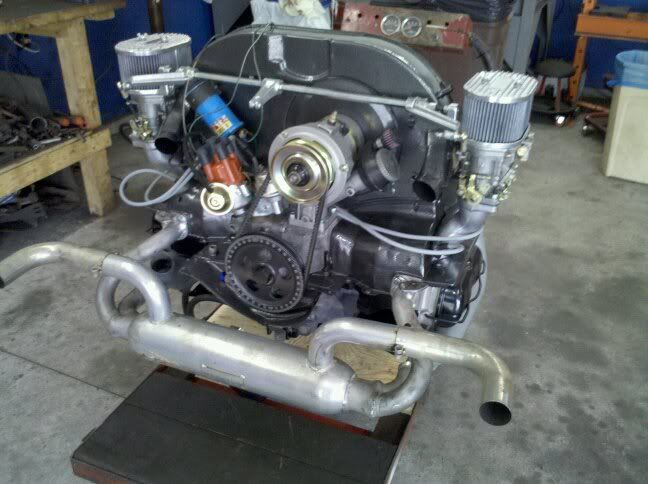

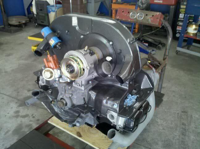

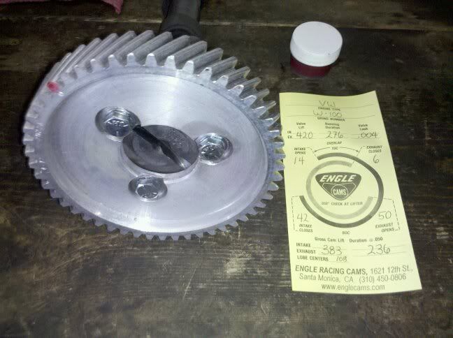

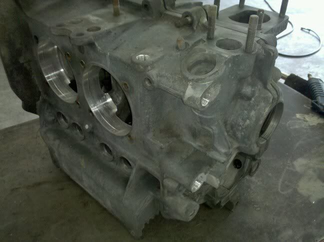

Some of you may or may not know that over the past few months Aaron (WideFive) has been rebuilding the engine to my Thing. Well, I picked it up yesterday evening and man is that Thing sweet now. Here are some photos that I stole from Aaron during the rebuild. He did a great job and I highly recommend him to anyone who needs VW service.
Some quick specs on the engine build:
Displacement: 1776cc
Stroke: 69mm
Bore: 90.5mm
Stock crank and rods
AA Pistons & Cylinders
-Pistons balanced to 372g
40x32 Heads
Engle 100 cam w/ Mahle lifters
Stock pushrods and rockers
8:1 compression
Weber 40 IDF's
