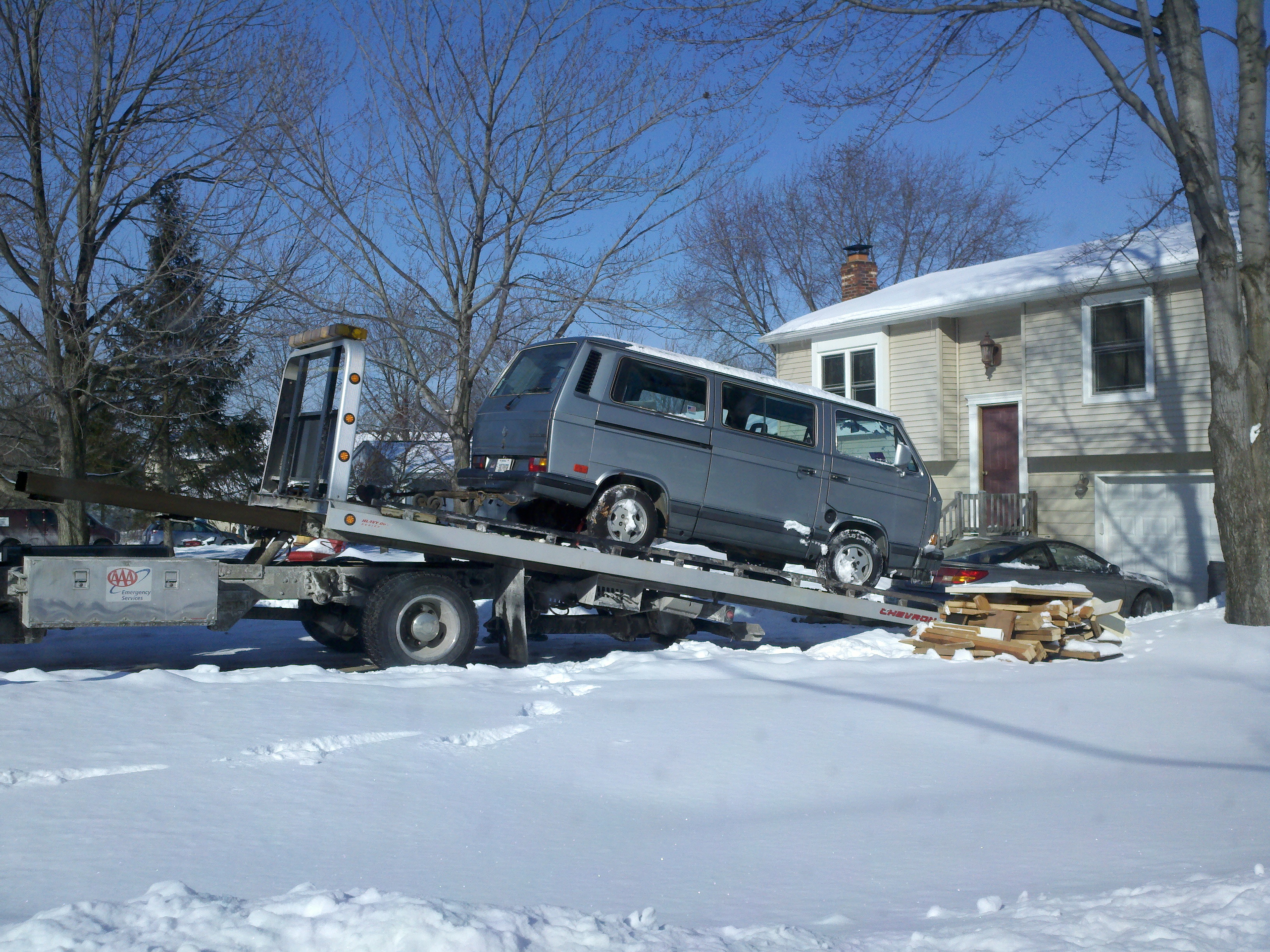

I just got a Vanagon and I'm trying to get it to pass an E-check which I failed..
Pat and I ghetto rigged a Gasket because I have a exhaust leak so could that of been the reason why I didn't pass the E-check?

What portion did it fail?
Too many variables without a better understanding of why it did not pass.
