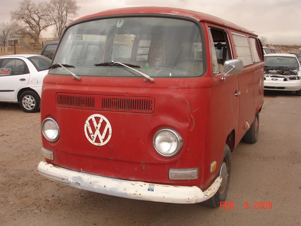

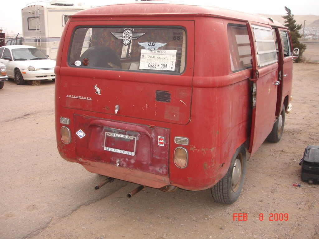

I don't know how she made it, but she did. I just got back from a 1700+mi road trip to pick up my new 71 bus. I flew into Albuquerque, New Mexico on Sunday @ 11:30am and met my dad (from Columbus) at around 1:00pm. We were picked up by Eddie Calhoun, junk car salesman extraordinaire in his early 80's diesel rabbit. He was everything I imagined he would be after talking to him on the phone for a month. Regardless... just as we rolled into the junkyard/residence of Eddie Calhoun we were greeted by a winter storm front bringing a nasty dust storm unlike anything I've ever seen. Now, Eddie stated in his Samba ad that this bus had a "new motor", and I could "drive anywhere" but I wasn't buying that so I made sure that I packed every tool and spare part I could think of and brought it with me. Thank God I did because I sure used every part/tool that I brought! Apparently, Fast Eddie thought that "drive anywhere" meant that the bus stalls and won't idle. He told me that "it runs good on the road" so he thought that "I should just hop in it and go!" I wasn't about to drive cross country in a bus that wouldn't idle. :(
I noticed that the fuel filter was filled with nasty black sediment. Looking around at the 60mph winds and dust, I figured that a new fuel filter was in need! I replaced the filter, pulled the jet on the side of the carb and couldn't blow through it, so I cleared it out with a staple that was straightened out( like MacGuyver). I didn't trust the 009 Distributor that was on there, so I installed my 034 SVDA distributor that I brought armed with new points/condenser. I checked and adjusted the valves/timing, and finally got the bus to idle. Although the 34Pict3 Bocar Carb was still unresponsive to any adjustments, I decided to hit the road.

This was when I first met the bus in Albuquerque
