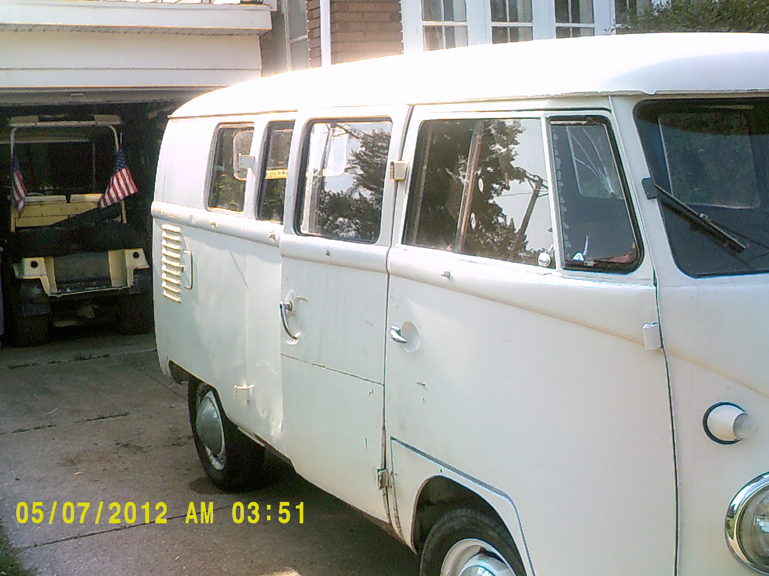

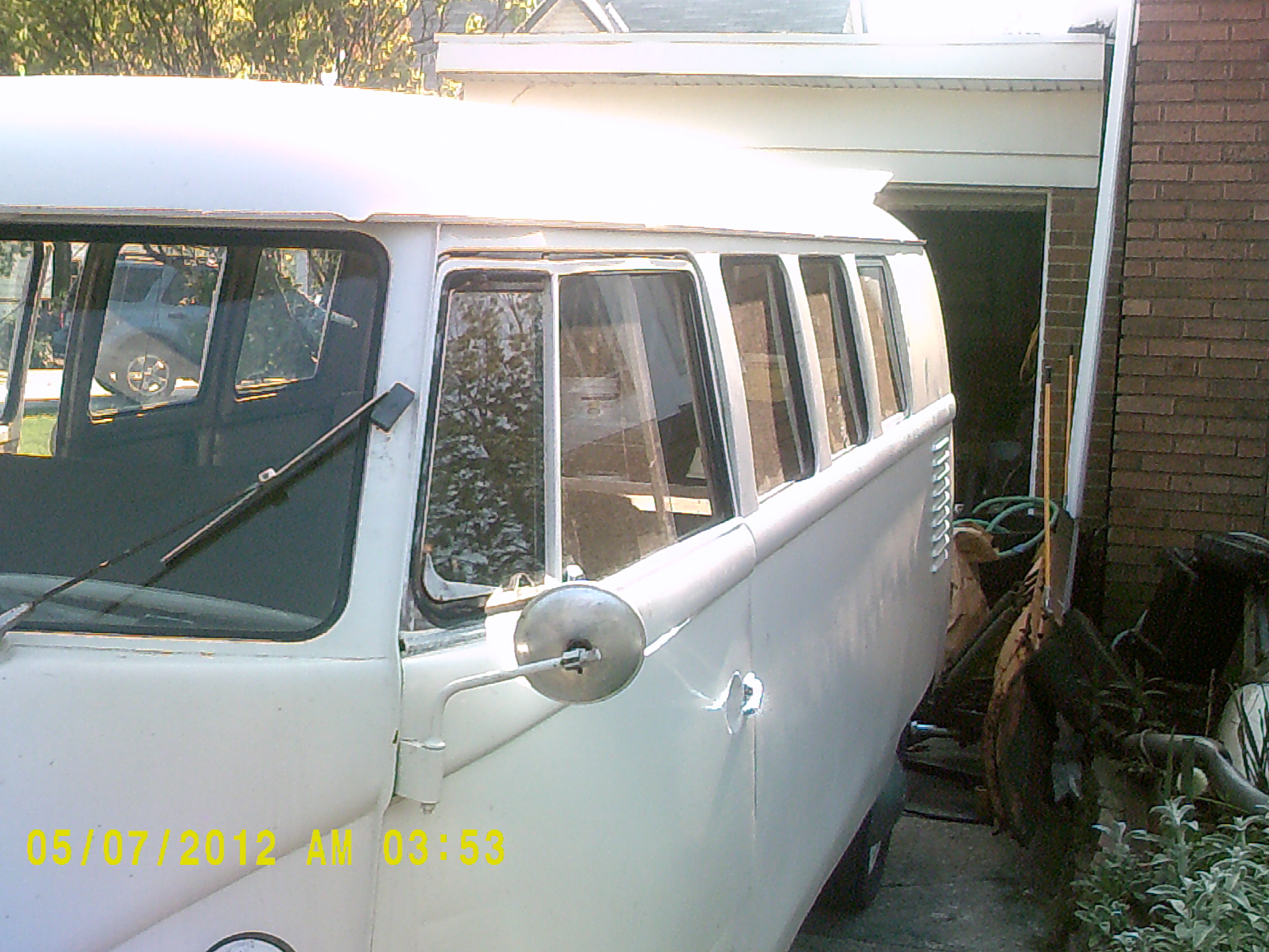

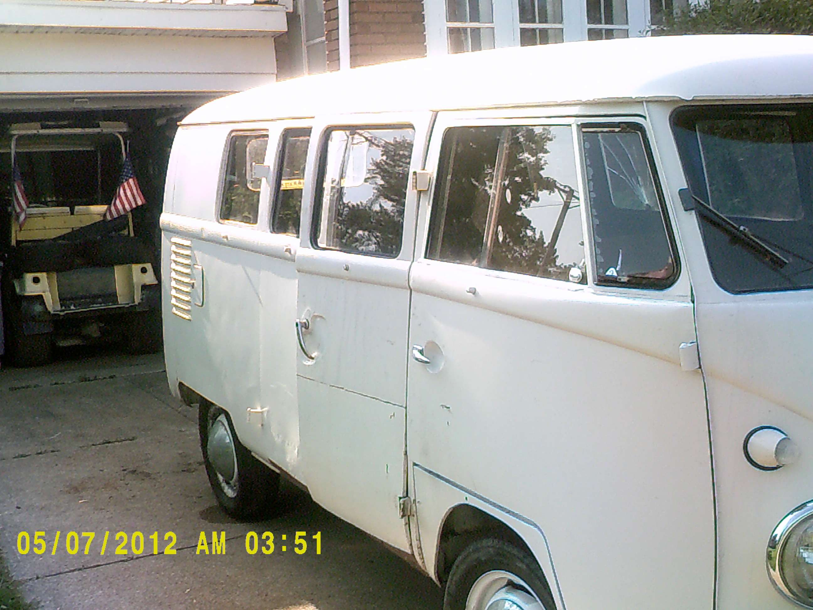

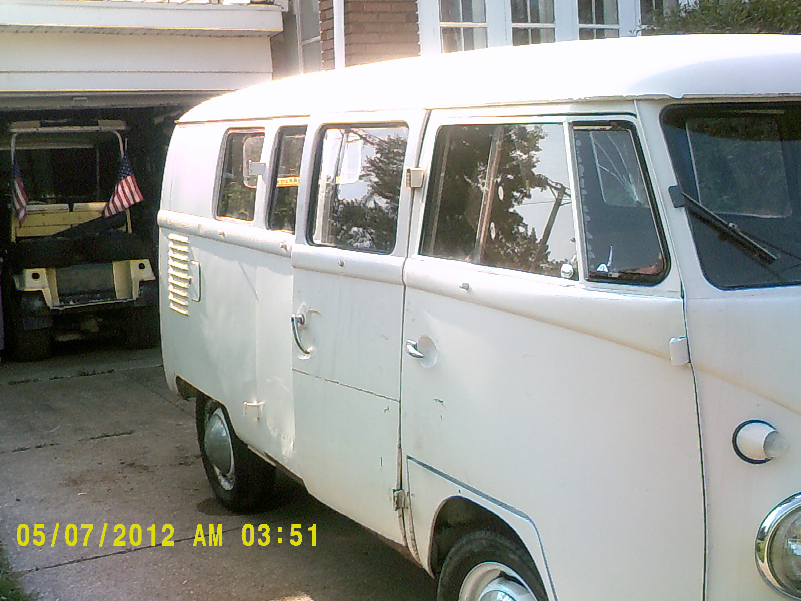

here is the van at time of purchase.
ignore the date stamps on the photos...they are wrong....technology scares me or I would change the settings on the camera.

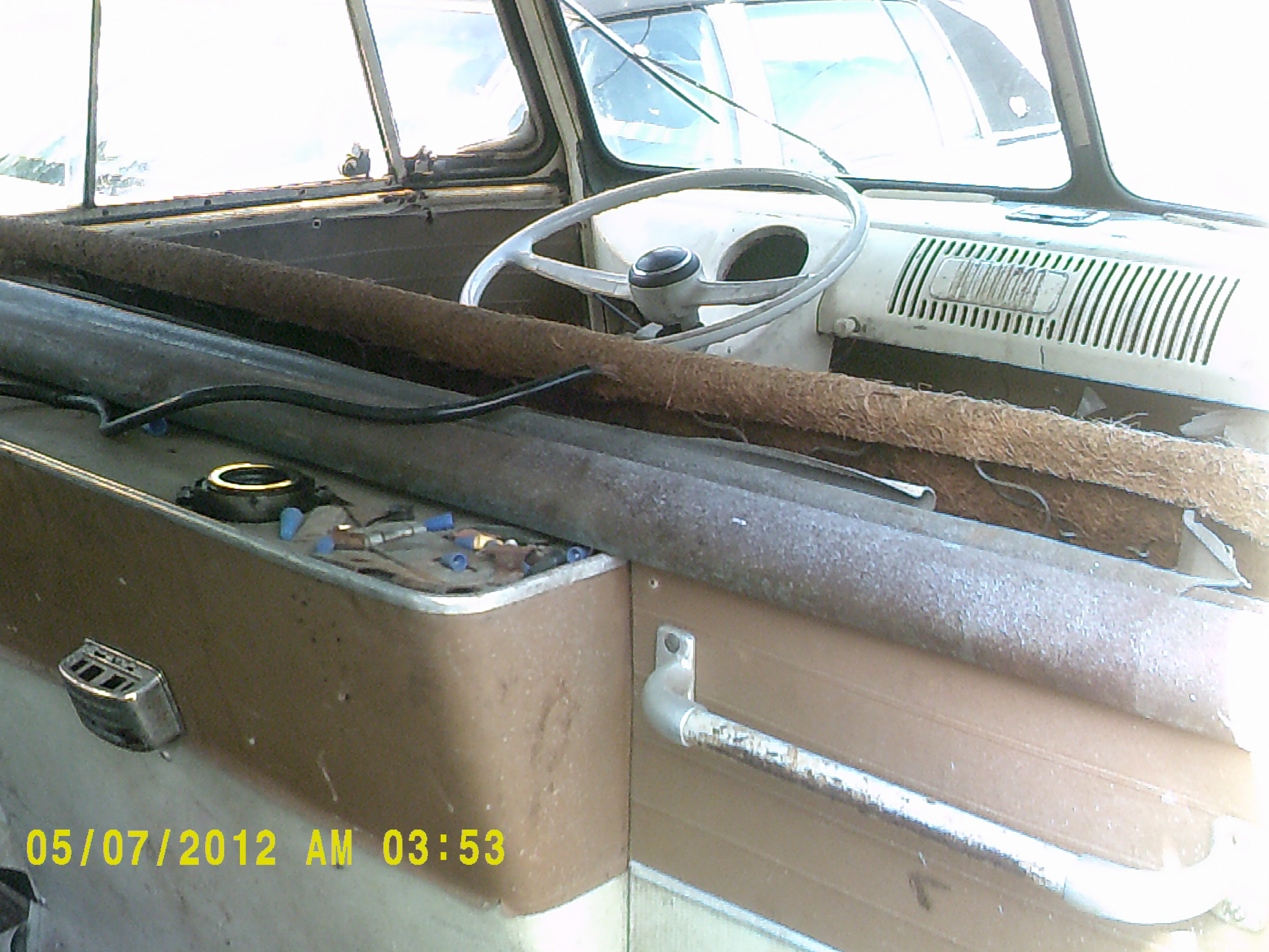

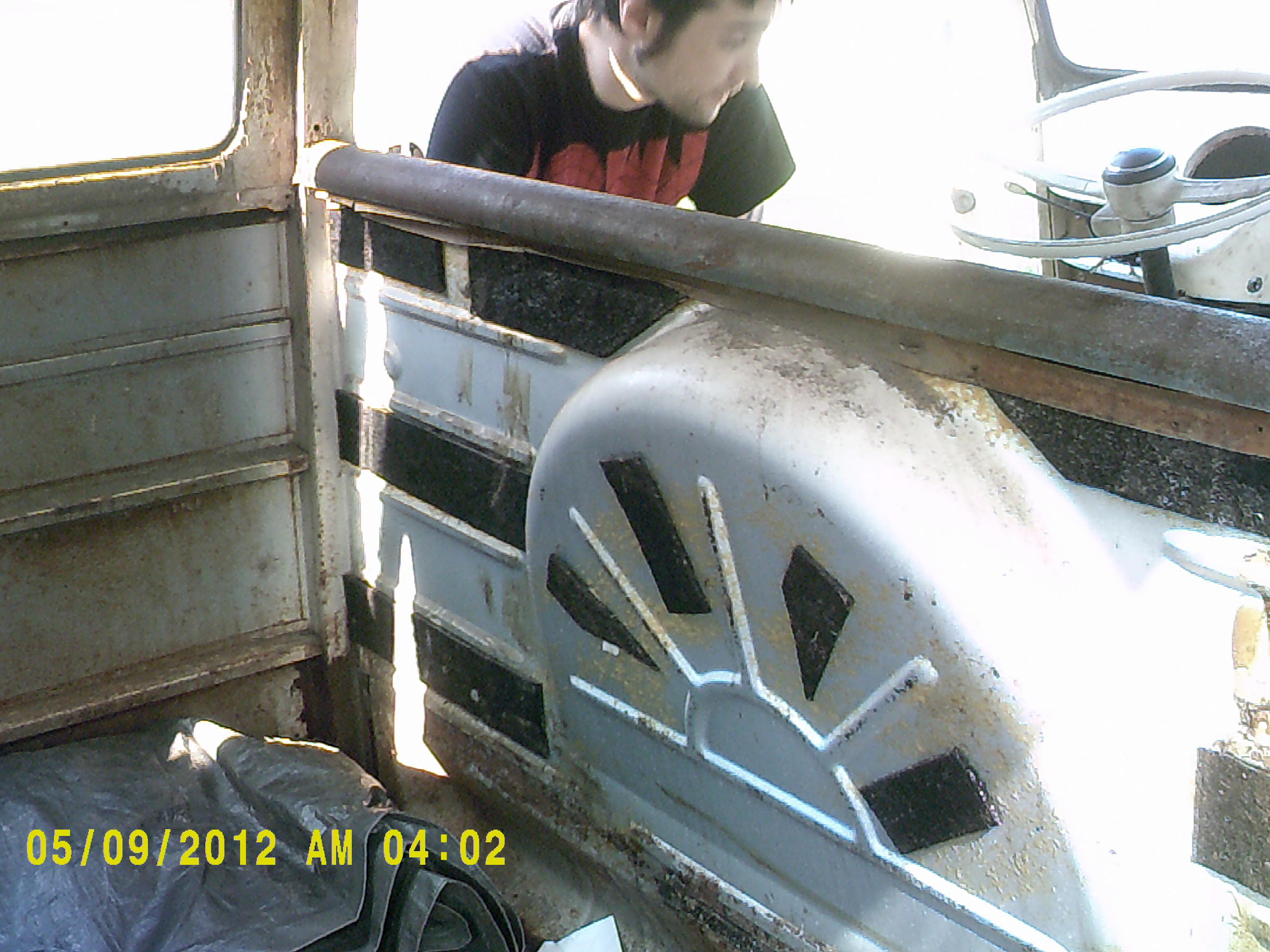

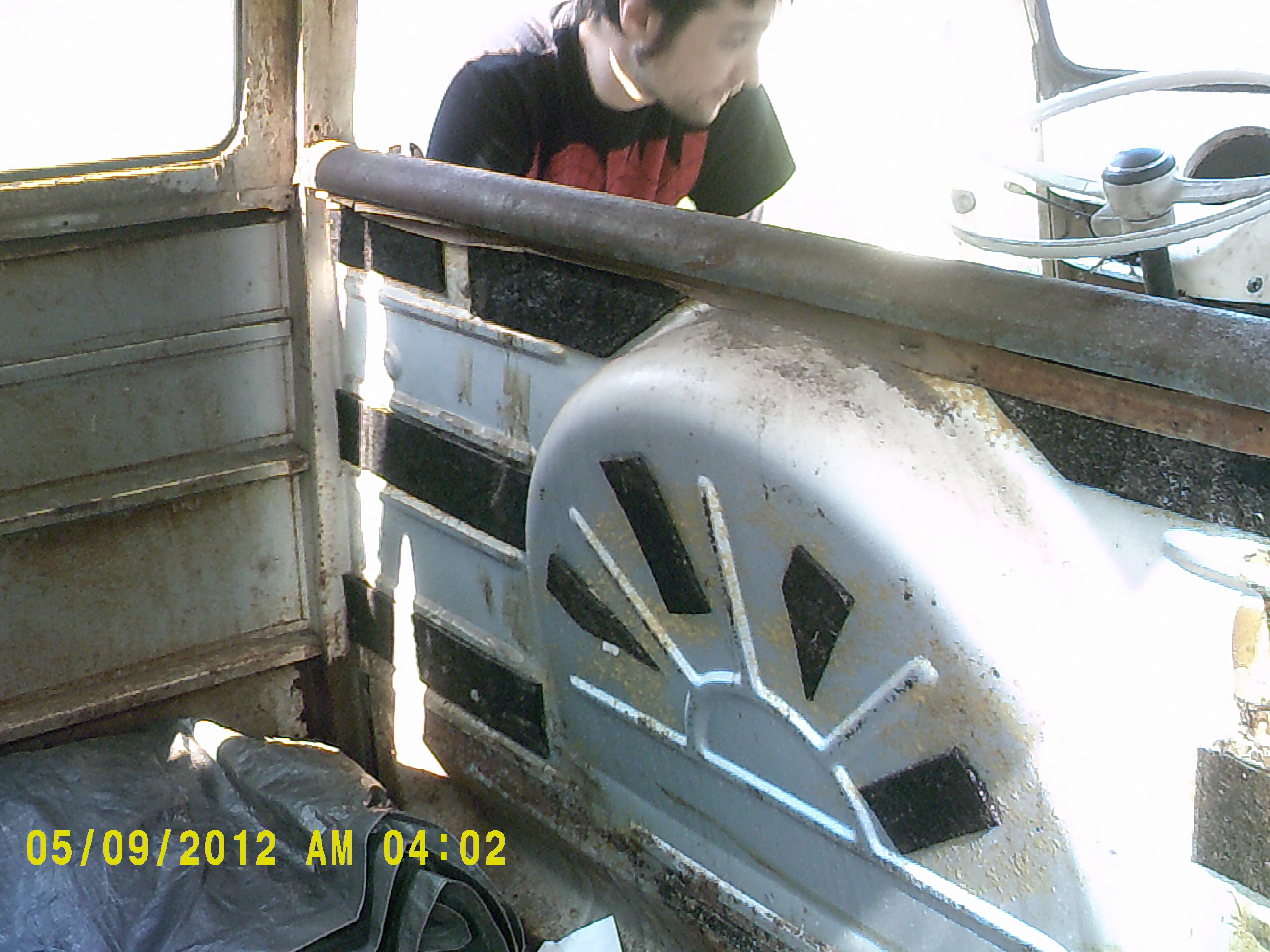

front interior There is a lot of sheet metal to do, then on to mechanicals

Caramel interior, that usually came with a Mango, not sure what else. You have a picture of the M-Code plate?
Re: 1961 Microbus
Looks like thin lip dog legs which didn't start until '63? High hinge too, which stopped in '60. Interesting Bus. Will be cool to see what you find once you dig into it.

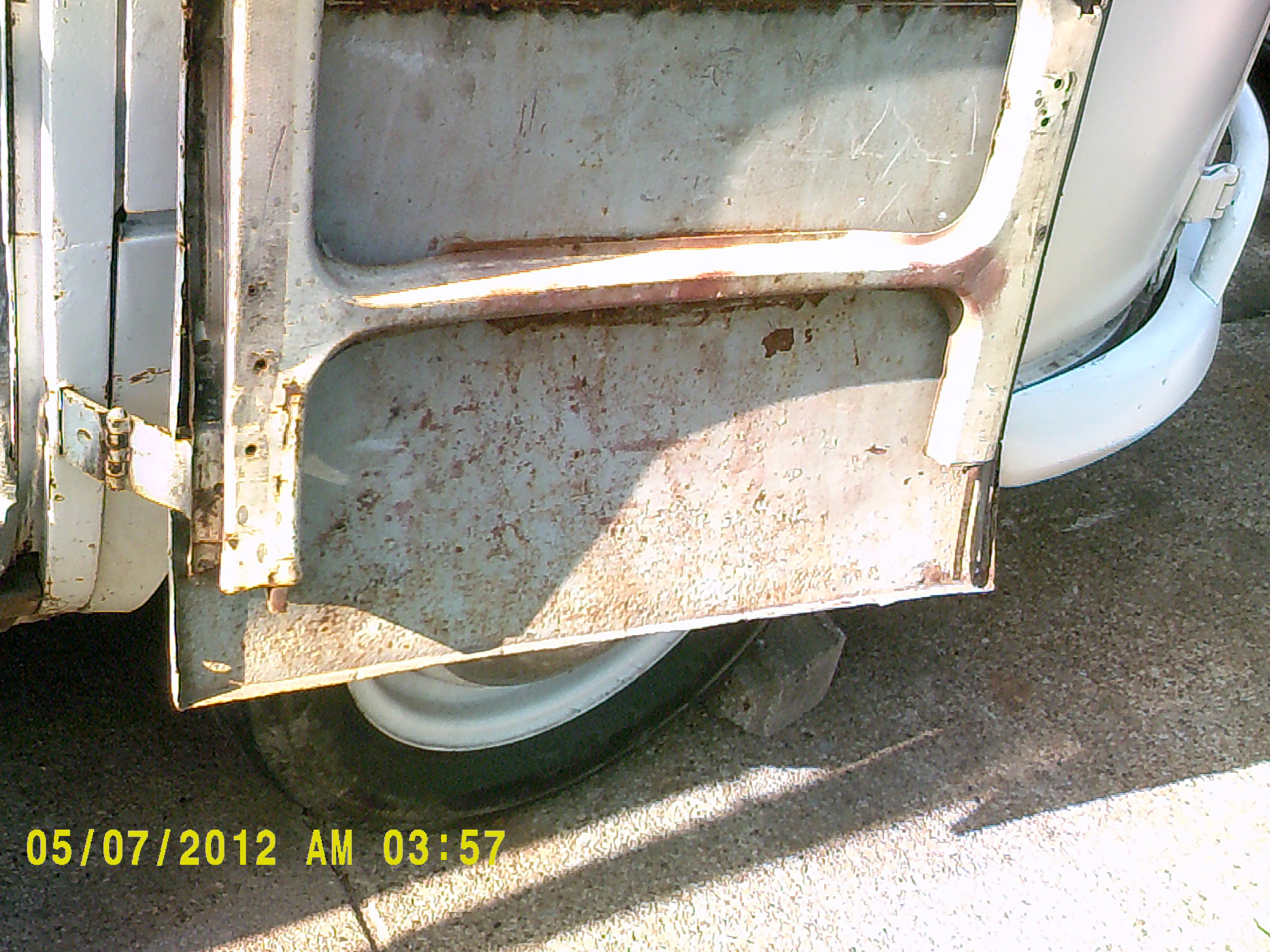

The dog leg on passenger side is a thin lip, and not installed very well, as the PO said "it was just tacked"
the dog legs will be replaced when I start on the front door and floor repairs.
right now my focus is on the cargo area. Long rocker, pillars, cargo doors and floor.

The Interior panels have been stripped out, bagged, tagged, and put into deep storage. I never throw away anything I find in the vehicles, no matter how crappy or garbage like it appears.

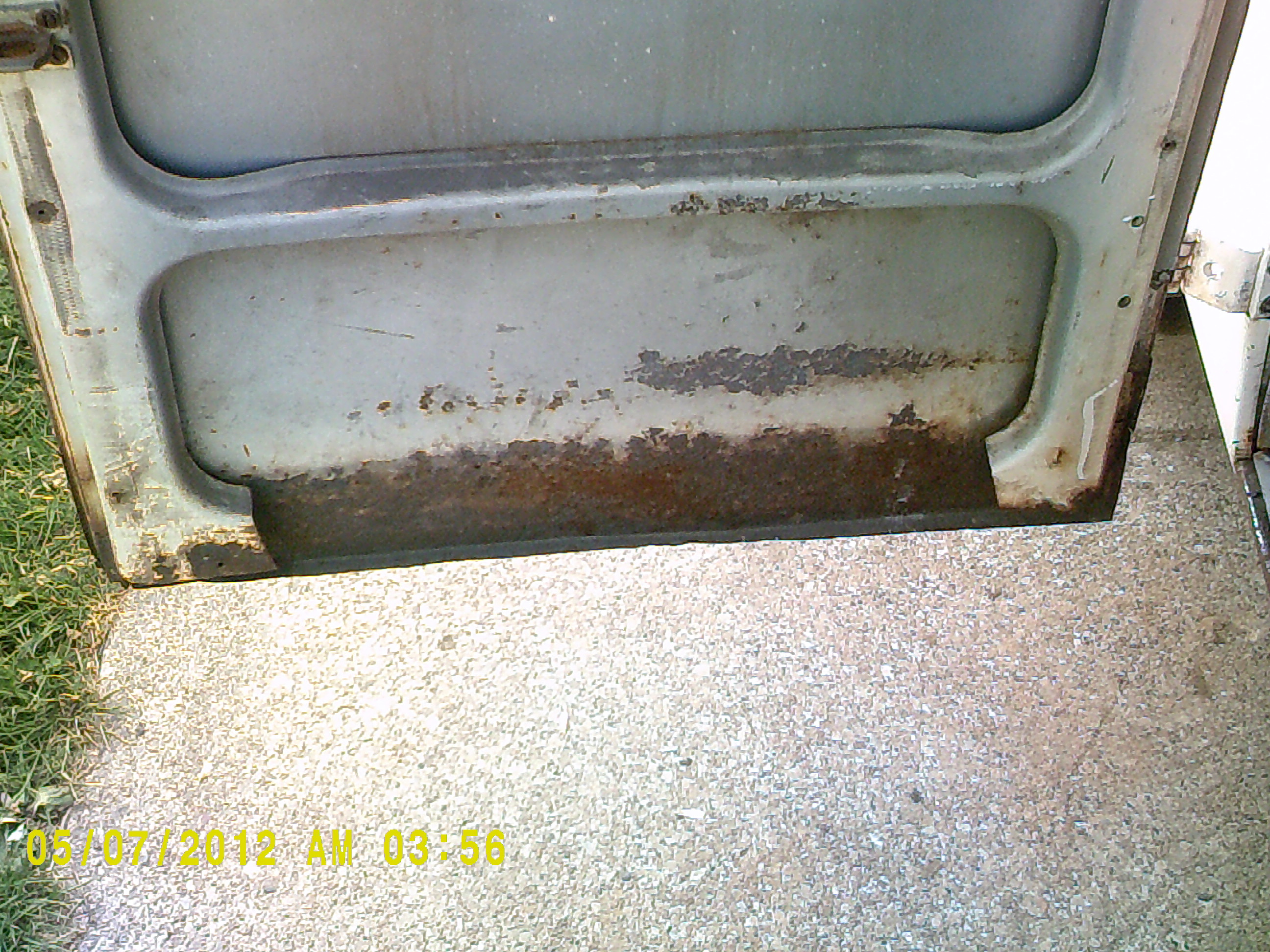

this weekend I plan on getting the rest of the top hat sections in, the out riggers on, the jack points on, the B pillar sorted out, and the bottom radius pillars on the long rocker side welded in. I would also like to get the long rocker and cargo does squared away if time permits. I will have to order a rear cargo door inner, but the other parts are already here. Then I can start on the cargo floor.

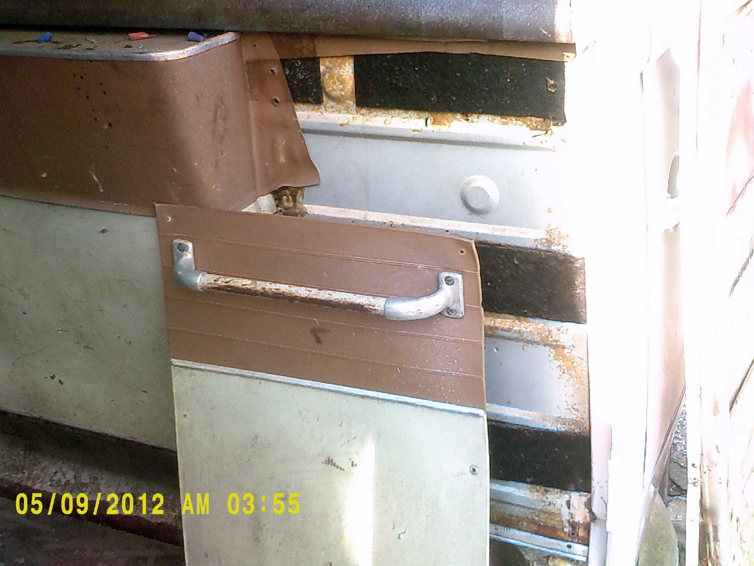

for those who like pictures, this is where we stand now.
rear cargo door. still need to order this piece Have this inner piece, B pillar needs some lovin' below the hinge Interior panels coming off, every last piece is catalogued, wrapped in plastic, and put in storage Panels gone, my brother in picture has been a big help with everything door skins off, forgot how hard these can be, definitely a 2 person and clean sock job

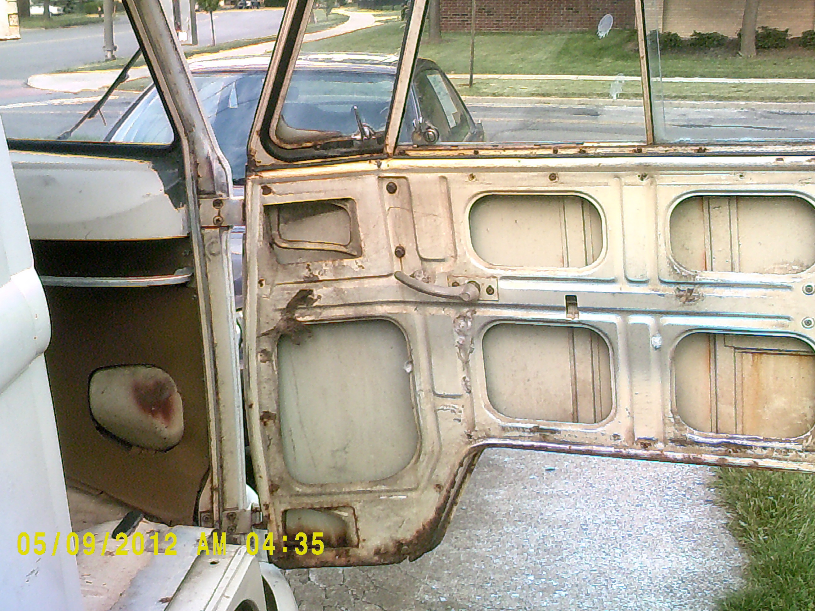

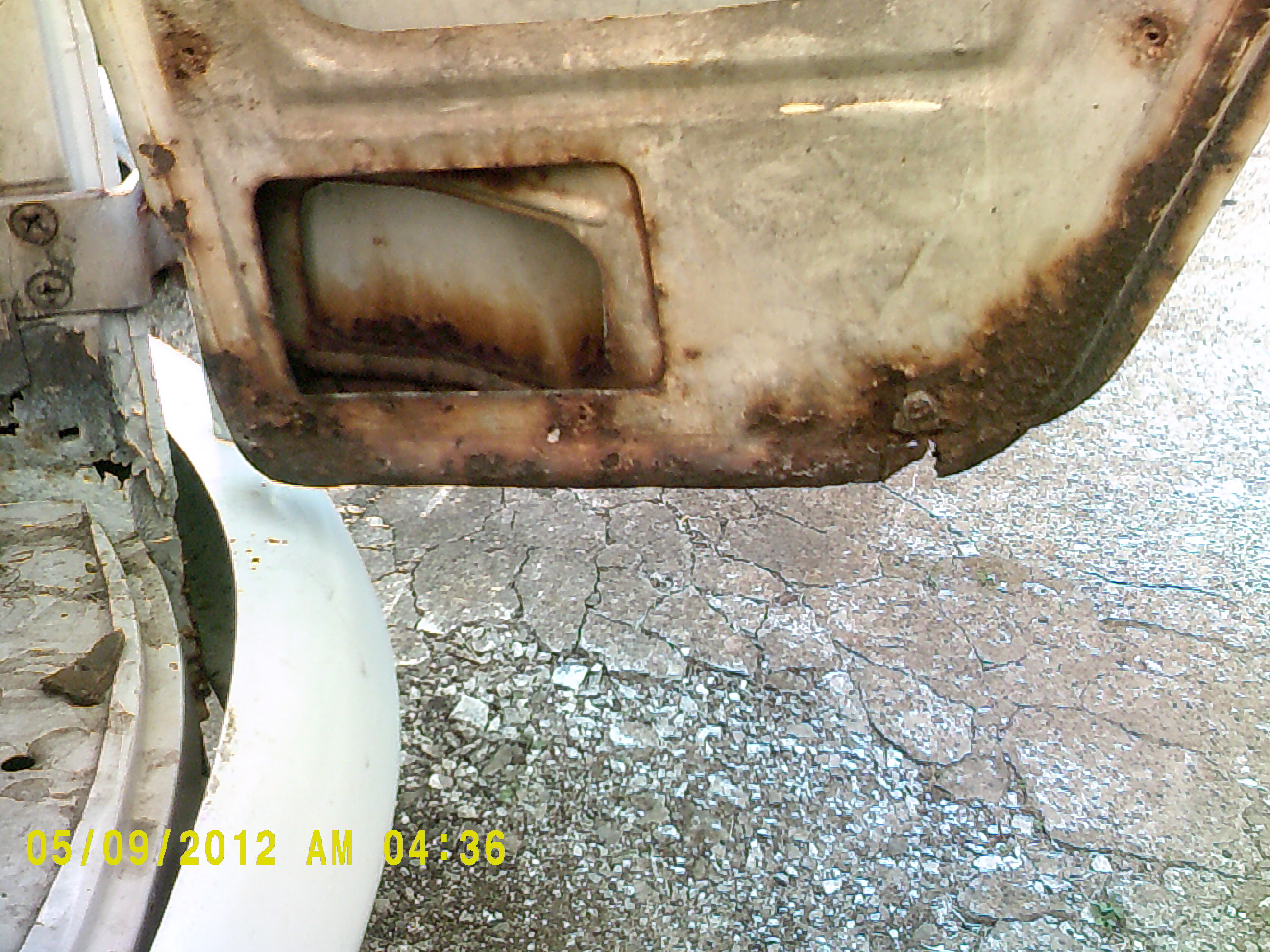

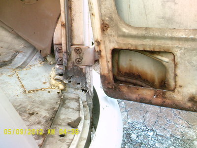

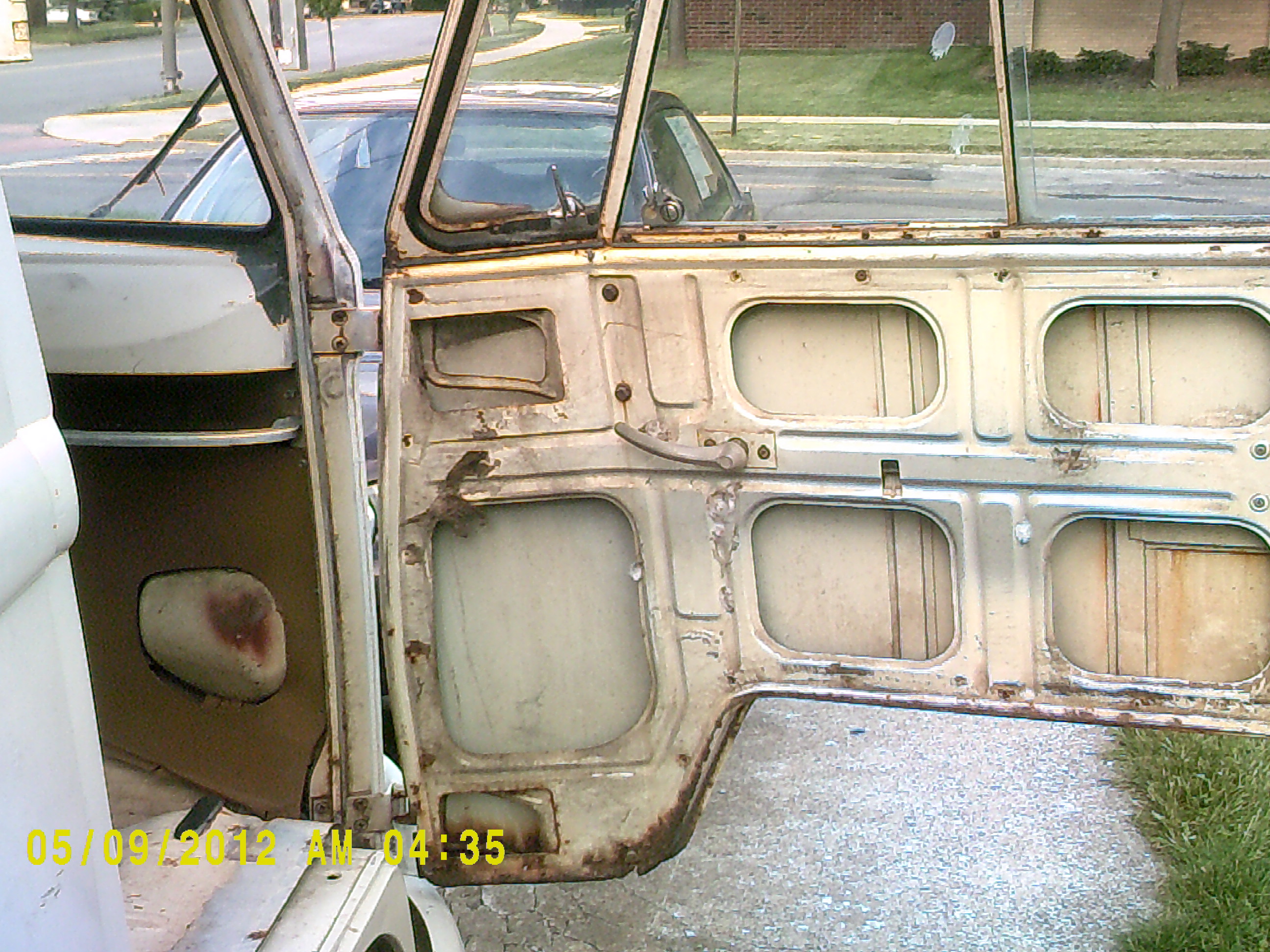

with the door skins off, you can see that I will need new lower inners and door skins on both doors, as well as A pillars below the hinge
also need to address the front floor, as the previous repair is not so much
The entire cargo floor is out also. I don't seam to have any pictures of that, just video, which I may post later. I will post pictures of the missing floor before I start work on it this weekend. I also have the seats out, and will work on getting those down to metal frames for paint before being upholstered. Most if not all the material is still there, just tattered and torn.
as for the original color of the van, I cannot say as the PO stripped it down to bare metal and sprayed it with Krylon. There are some warp and wave marks from the heat (sanding I am guessing) that hopefully will come out in body prep. that is still a ways off yet though. My wife wants to go with a 2 tone mango paint scheme. only she doesn't want "true" mango, she wants it a shade or 2 off......IDK yet....that is too far away
