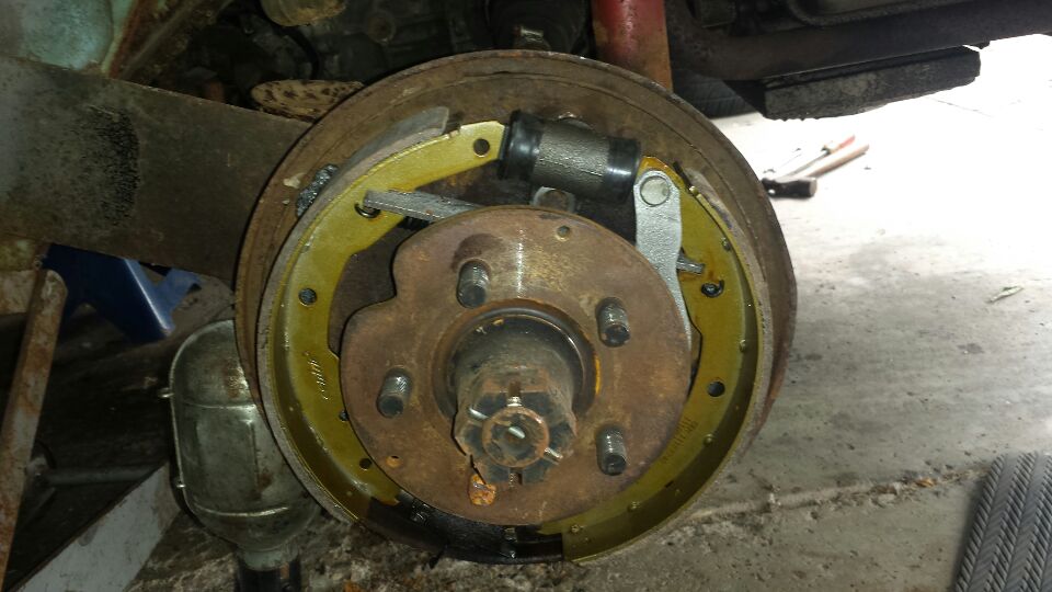

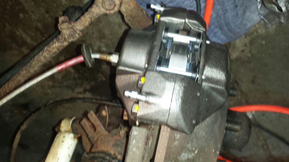

my brake parts showed up over the course of last week, and I was able to do the work on Saturday.
I replaced the hard lines, the rubber lines, the calipers, the wheel cylinder and the shoes/pads.
I recycled some MK1 Parts

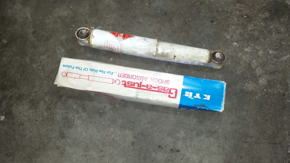

I found some new (but really old) shocks in a bin in the bus, I figured while I was under there, I might as well replace the old ones
I haven't worked on drum brakes in a LONG time!

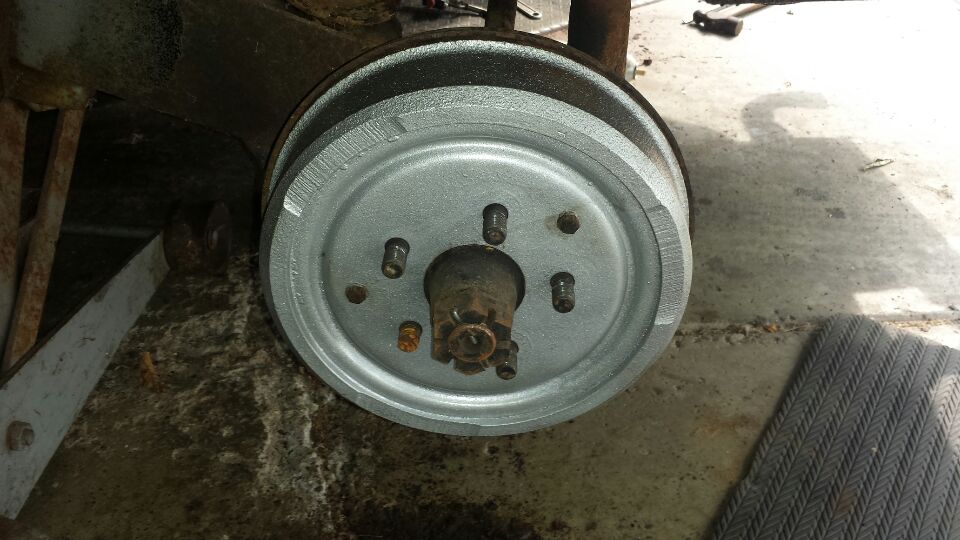

ooh, shiny (all I had was wheel paint!!)

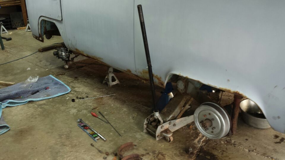

And the crusty driver side:

the frame is pretty solid, only one part of the C channel is rusted on the bottom, it looks like it might have been used to jack the bus up at one point, bent it/cracked paint and allowed rust to propagate.
Mike Kever Kombi wrote:Welcome. Looks like a fairly solid bus, especially if it is a good runner. Bring it to Kombis on Kelleys this year so we can see it in person.
Almost the whole floor is shot, front and rear, I can't open the slider or else it will fall off, and pretty much the bottom 8" of body is bondo or holes.
I'm not sure whats going to happen with this, but i want to see how I like it after I fix the front floor and slider.
