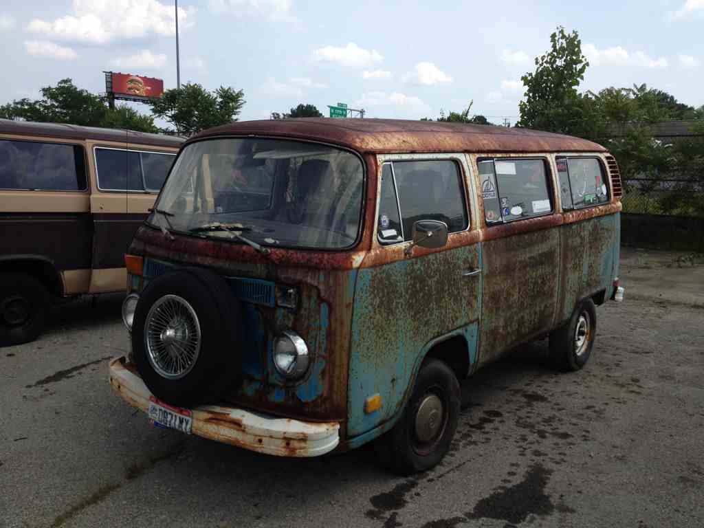

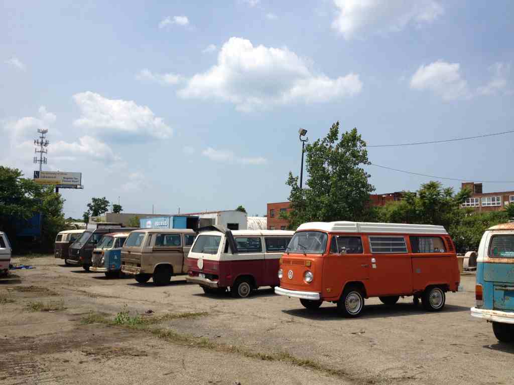

it all started a few years ago at the first Urban Jungle Kamp Out. I got drunk, lost a bet, and ended up with this.

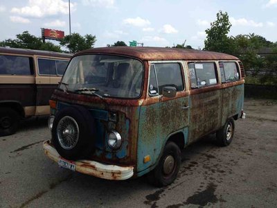

Chuck, feeling pretty bad for me decided to do me a solid, and sold me this too
It came with an unknown Type 4 engine. He had to charge me a little extra for the spoke hub cap, and the center mounted Weber progressive carb, but It was ok. Business is business. Chuck also threw in some departing words of wisdom, he said "you own 'em now, I don't ever want to see them again" Thanks Chuck! He really is a stand up guy! He didn't have any titles for them, so I plated the van as an 83 cavalier, I don't think anyone will notice. I now know why Bays and Vanagons go to Chuck's to die.
Once I got the vans to my place, I started the process of cleaning them up. The force was strong with the Orange Van. So was the stench of patchouli. Between the mouse turds and the hippie stank, I had my work cut out for me. getting the mouse turds out proved to be much easier than eradicating the hippie stank. That's 3 generations of burritos, granola, patchouli, incense, a green leafy substance, ball sweat and arm pit hair (from the hippie chicks). I needed a full tyvek suit, and some industrial cleaner.
