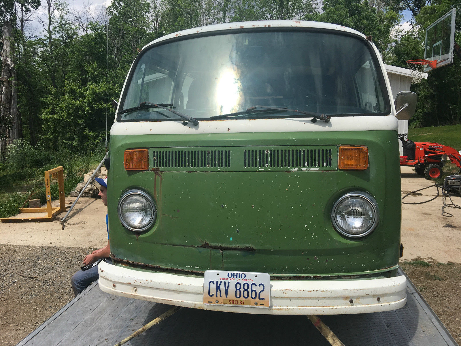

Hi all! My girlfriend and I purchased a 1977 Camper a couple of weeks ago. Boy, there is a lot of work to be done.
Pictures:
Pictures:

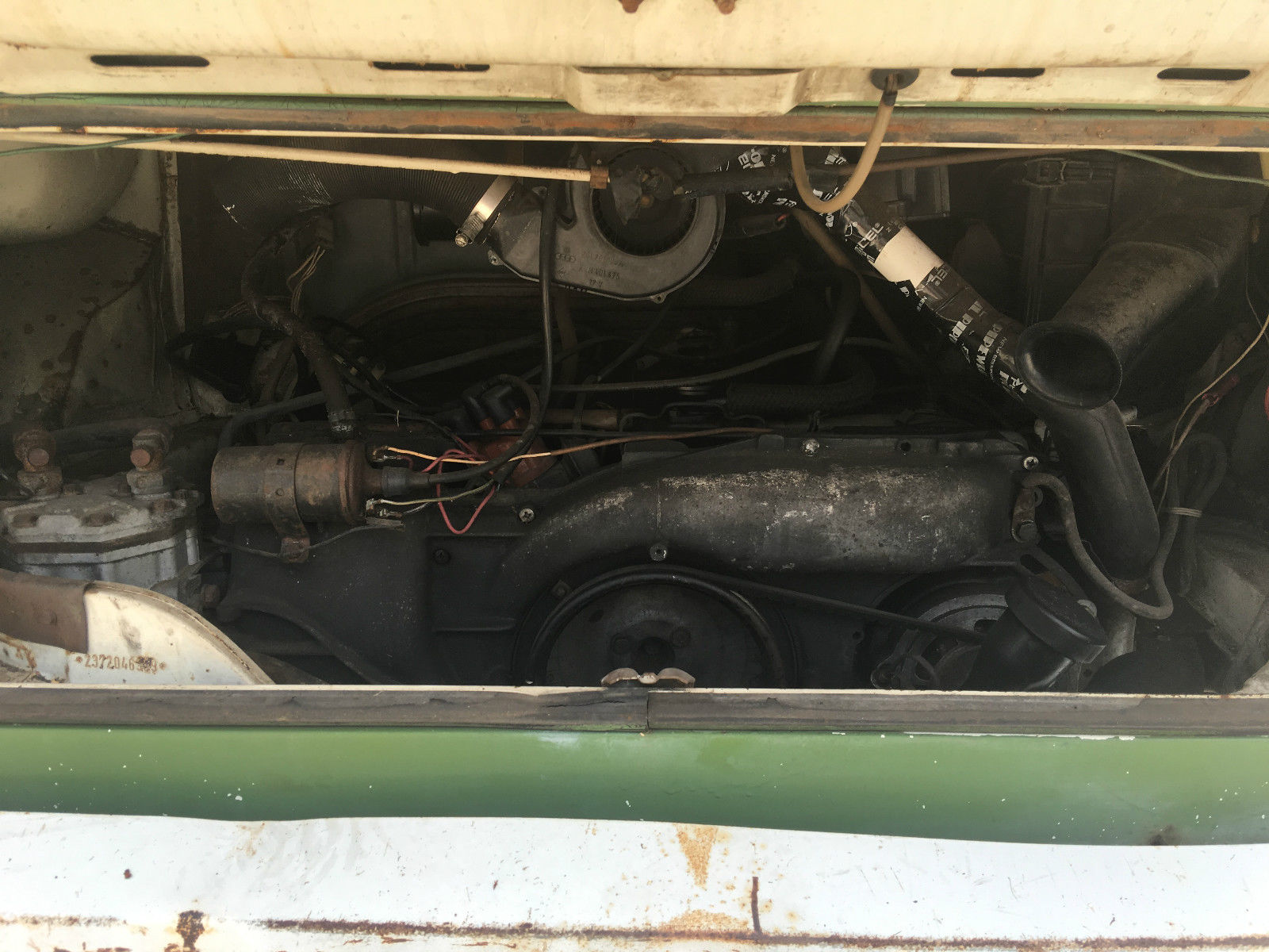

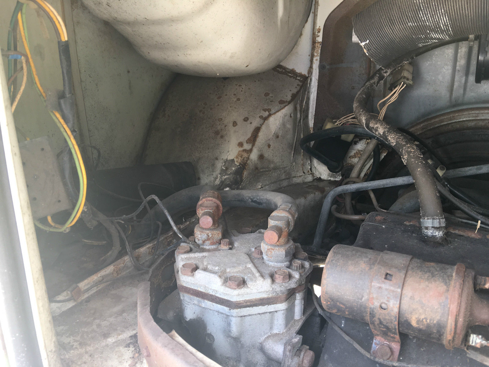

I'm going to start with what is currently on my mind, the engine rebuild.
Using this part list as a basis, is there anything else I should consider? Any guesses as to what machine shop fees would be? (Already have the heads figured out so no need to include them.)

Austin,
Definitely take Bill up on this offer, he and Chuck are the people to get with. You could always drop your old motor, some cash and your girlfriend off at Chuck's and in a week or so get a sweet running FI motor and possibly your girlfriend back.
I'll add to the list in a second, but first....
Slow down champ. You don't know what you are dealing with to even know if you need any, let all of those parts.
That list was generated only AFTER I had completely tore the top 1/2 of my engine down. A thorough inspection of parts is needed before you just blindly start buying parts for an engine that may not need to be rebuilt. Check to see if everything is within wear limits and tolerances, and if it is, and if the engine runs fine after freshening up, then why worry about rebuilding before driving.
I have ordered all the parts previously listed, and still have not redone my motor. I've probably put 5-10k miles on the bus since that post. I regularly put a couple few hundred miles a week on the bus during the summer (warm weather).
These motors can be extremely expensive to completely rebuild. If you do not have the stomach or wallet to take on the task, then a refresh may be the smarter course to take at first. All too often people come in guns blazing with pie eyed dreams, bite off more than they can chew, and never finish what they started, and never get to drive their vans. Do not fool yourself and say " that'll never happen to me", because they all said the same thing too.
Just to get the can up and running and stopping somewhat reliably you are looking at an outlay of $2000-$5000 most likely. Get it up and running, then decide on what kind of new engine you want, if any.
Of course your engine may me whooped, and well beyond its serviceable life, but until you get down to brass tacks and do the measurements and tests you will not know for certain. Just because it's old, dirty or because it sat doesn't automatically make it bad. More than a few of the more knowledgable folks on here will tell you that an old OE part is vastly superior to a repop. That goes for a large portion of components. Plus if it has been off the road for 15+ years, that's just that much less wear and tear it has seen.
Take the cost of new parts, and the intricacies of these engines, and the fact that you have 0 experience working on them into consideration before you jump of the deep end. Try to find someone who has experience and learn everything you can. Watching a YouTube video or reading a post does not a mechanic make. These cars are relatively easy to work on, once you know what you are doing. With the scarcity of certain parts, and the prices they can fetch, the learning curve can be both steep and costly.
Again welcome to the club, and don't be afraid to ask questions.
