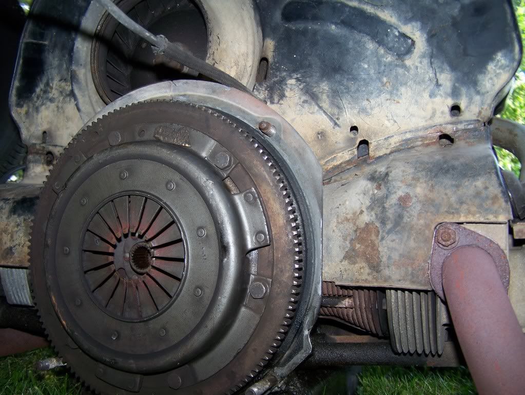

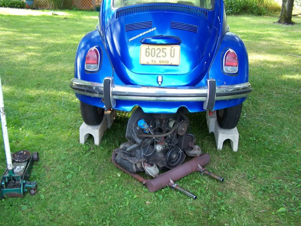

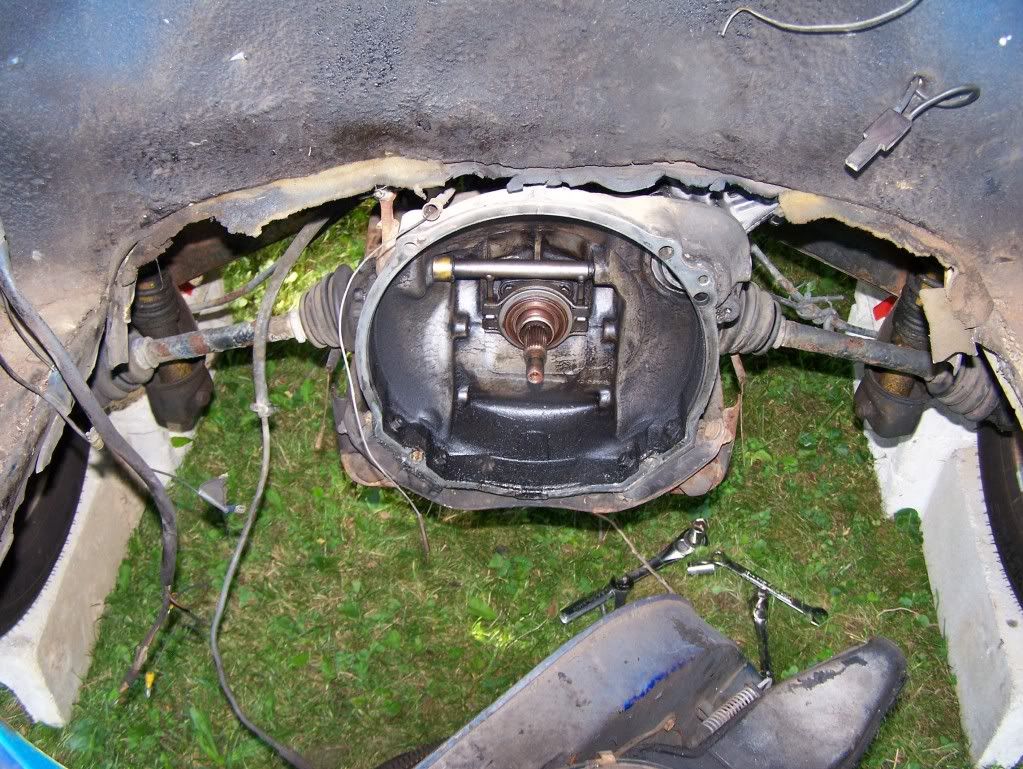

I decided to pull the engine from Hans, 71 bug, last night to see how everything was doing. It's never been out in the six or seven years I've had him. Lucky thing I did, the upper drive side engine to transmission bolt wasn't there :shock: Time to find one in my menagerie of stuff. Saw some surface rust starting where black paint was peeled, looks like steel brush and black paint will be on the to do list as well.
I'll probably also use him as a test bed to check out my spare engines since I can't seem to get a trashed transmission I have apart to make into a stand instead of a table like the other case I had. Anyway the bearing and plate/clutch look good so now it's time to wrestle a spare out of the barn to slip in. More than likely I'll start with the engine I was thinking of putting Webers on because I know it runs, at least a year and a half ago it did :|

It's out, well almost..
bellhousing
pressure plate
