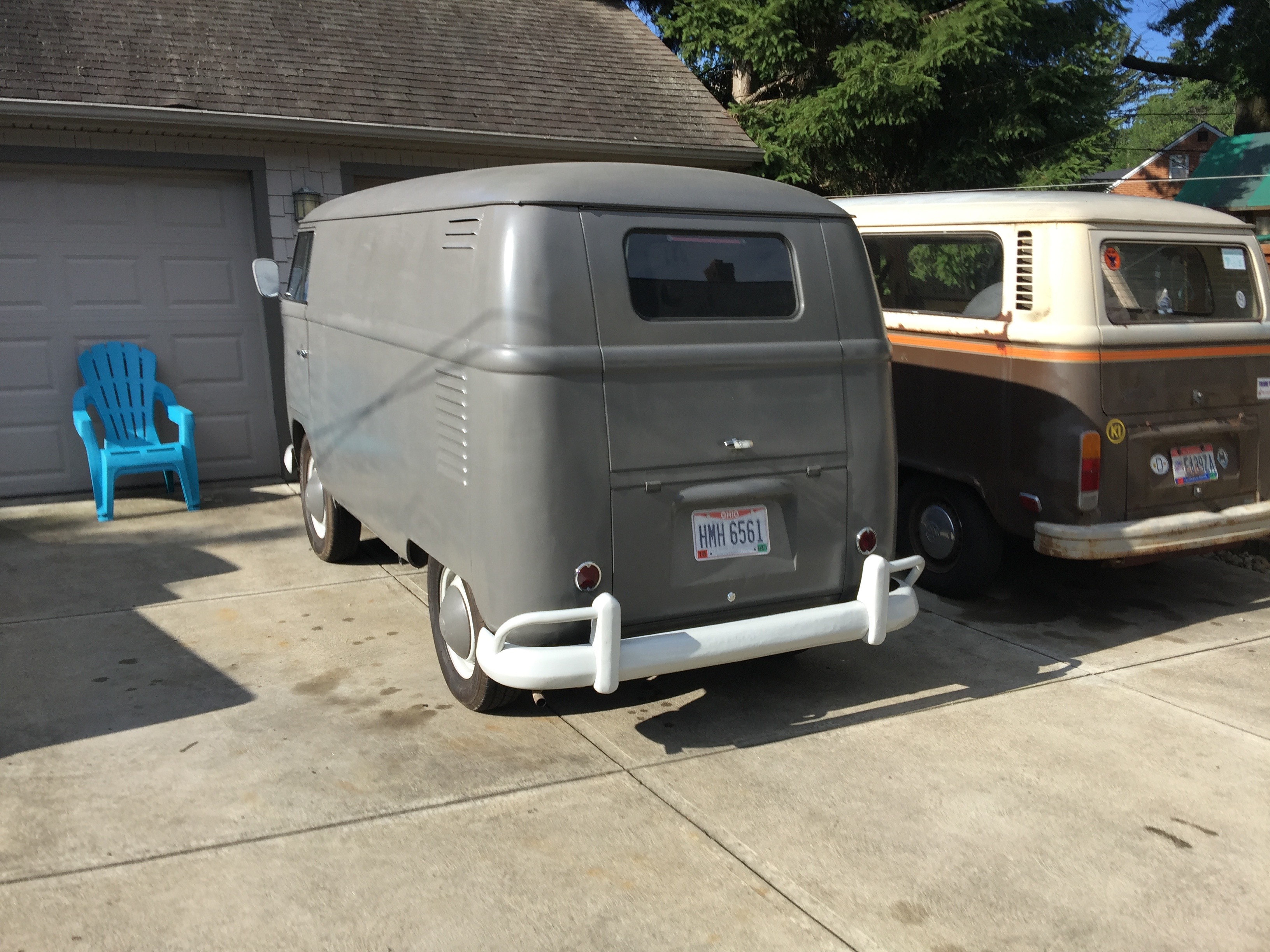

As most of you know, I'm back in the split world. Back in the summer of 2014, I sold my 1959 SO-23. I loved the bus, but it was undrivable in the modern world. Being (mostly) a stock guy, I didn't have the heart to rip out the original 36HP or the original small nut trans or even the 6 volt electrical system. It was no trailer queen (it contained plenty of mud) but since there aren't a whole lot of SO-23's out there, I figured rather than molest it, I'd sell it and move on. I felt if I lived long enough, another split would find me.
Well four years later I'm looking for a single cab. I could have kicked myself ten times over for passing on Cunningham's old '56 single when both Dave offered it and when Kirk later offered it to me again. Stupidly, I passed both times.
Then I came accross a '59 panel outside of Ann Arbor, Michigan. The owner got the bus from L.A. and seemed to be doing a very comprehensive rehab on it. He had a long thread on all the work he did on the samba. You can read the history of the bus here:
https://www.thesamba.com/vw/forum/viewt ... light=bens
Just as he was finishing the bus, he came accross his dream car (an old '68 Volvo) and his wife got pregnant. Just like that, the bus was for sale.

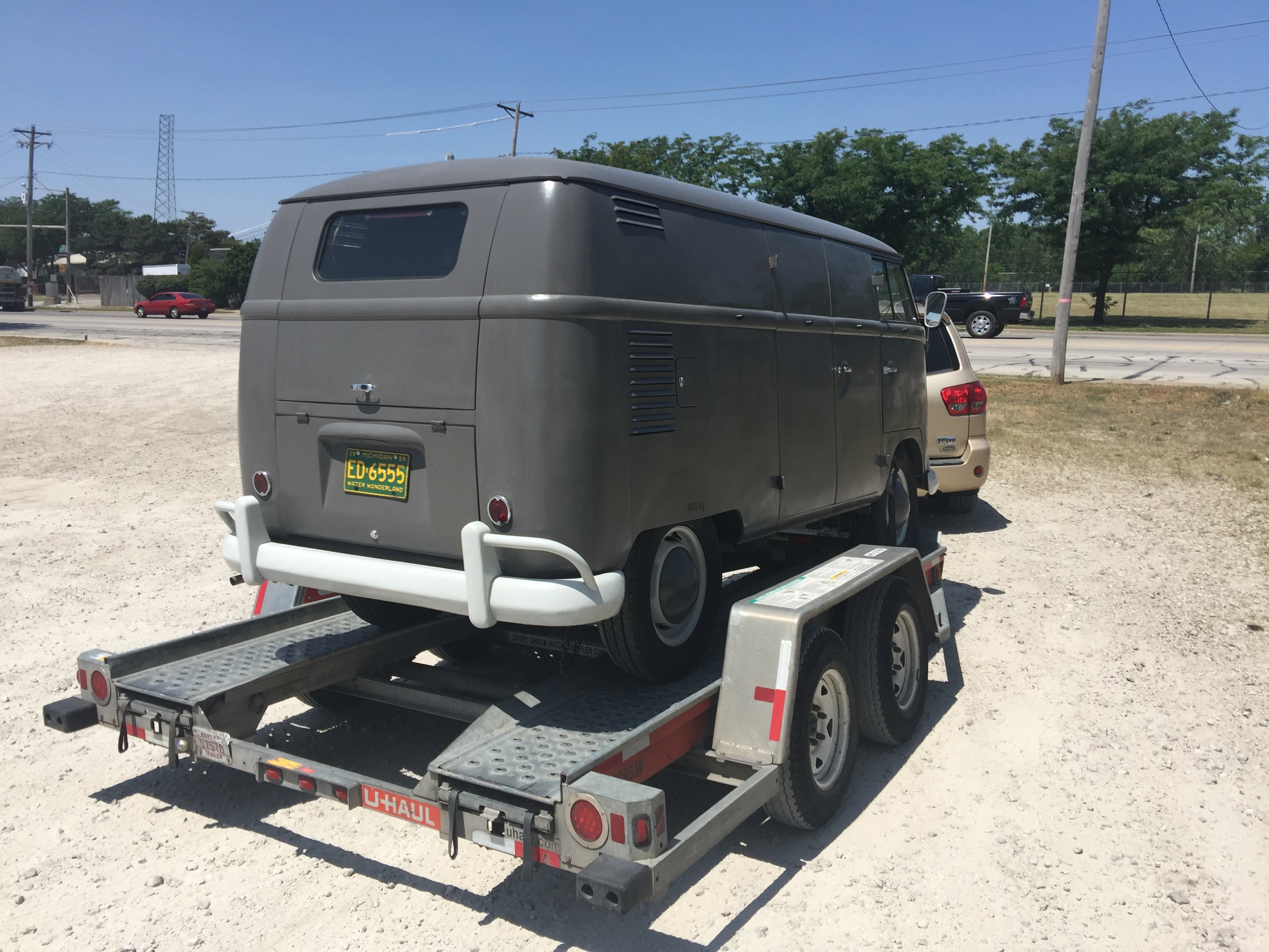

Dawn and I took a ride up to check it out on a Sunday and I bought it on the spot. It wasn't a single cab, but was the next best thing for me. Bruce really helped out by going up with me a couple days later and we landed it back in Cleveland with the required stop at Tony Packo's along the way!
The welding work on the bus was top notch, but the finishing work and paint looks like I did it. Seriously, it looks like I did it. Those of you that know me, know what that means. :lol:
In any event, the seller was a great guy who did his best given his finsihing limitations. His body man got sick and he had to finish it himself.

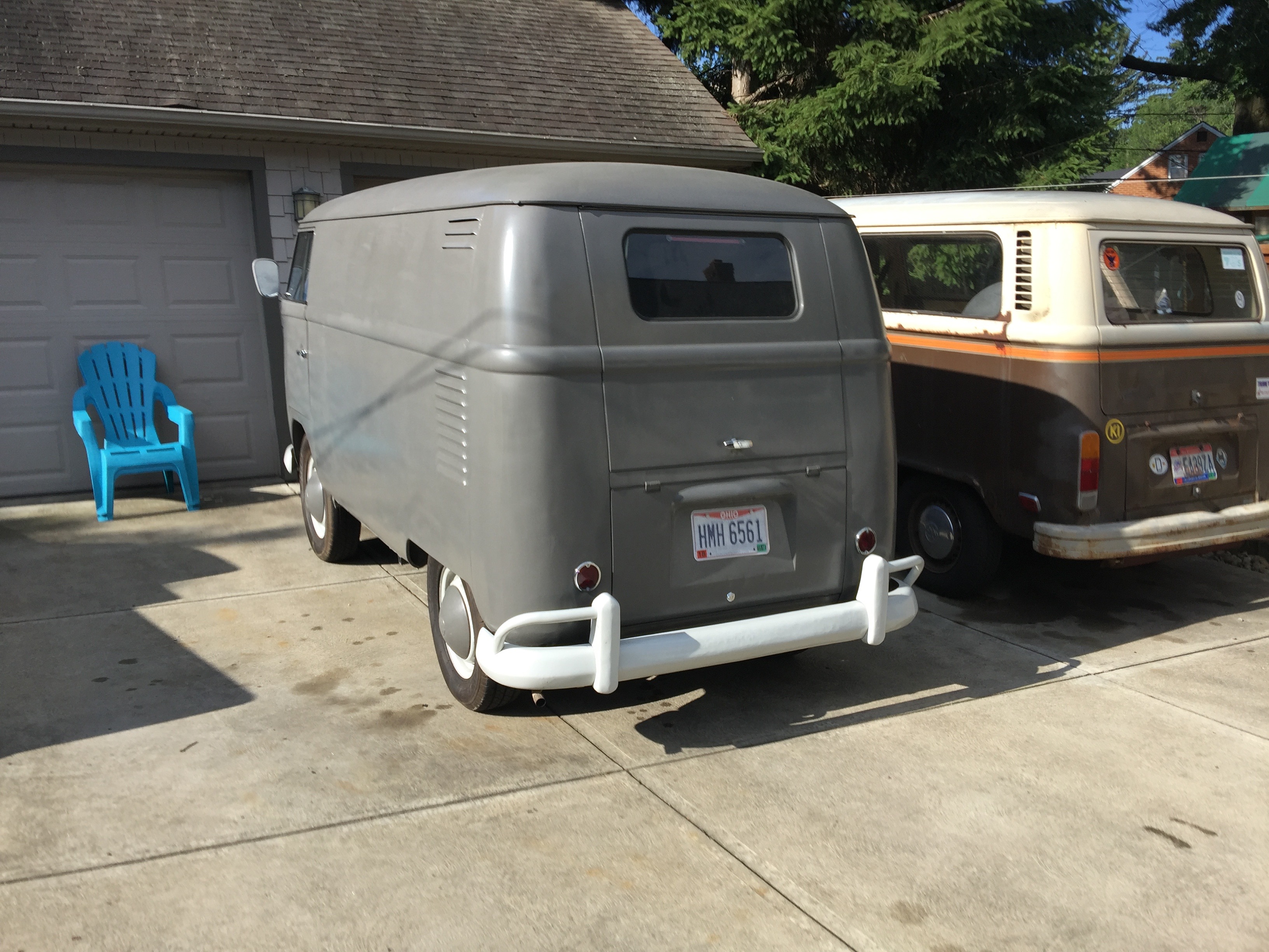

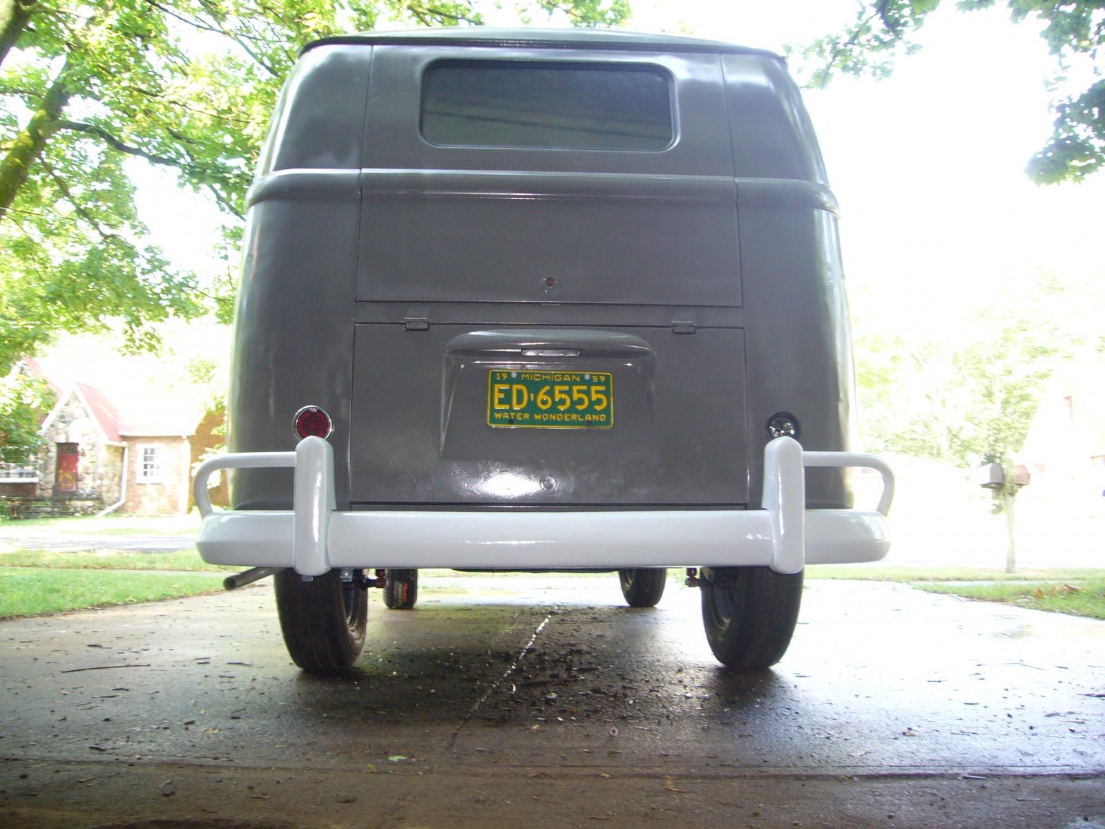

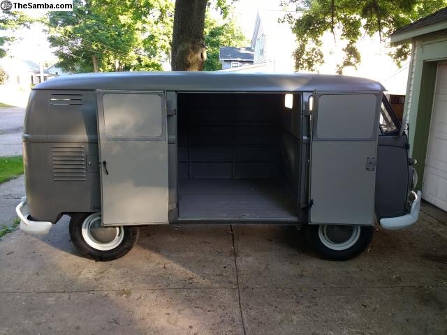

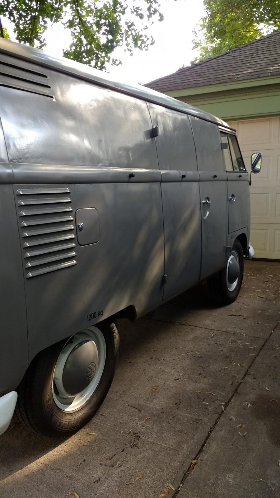

Anyway here are some pics of the bus and I'm sure Bruce will follow with some commentary on what he found after getting the bus back to his shop.

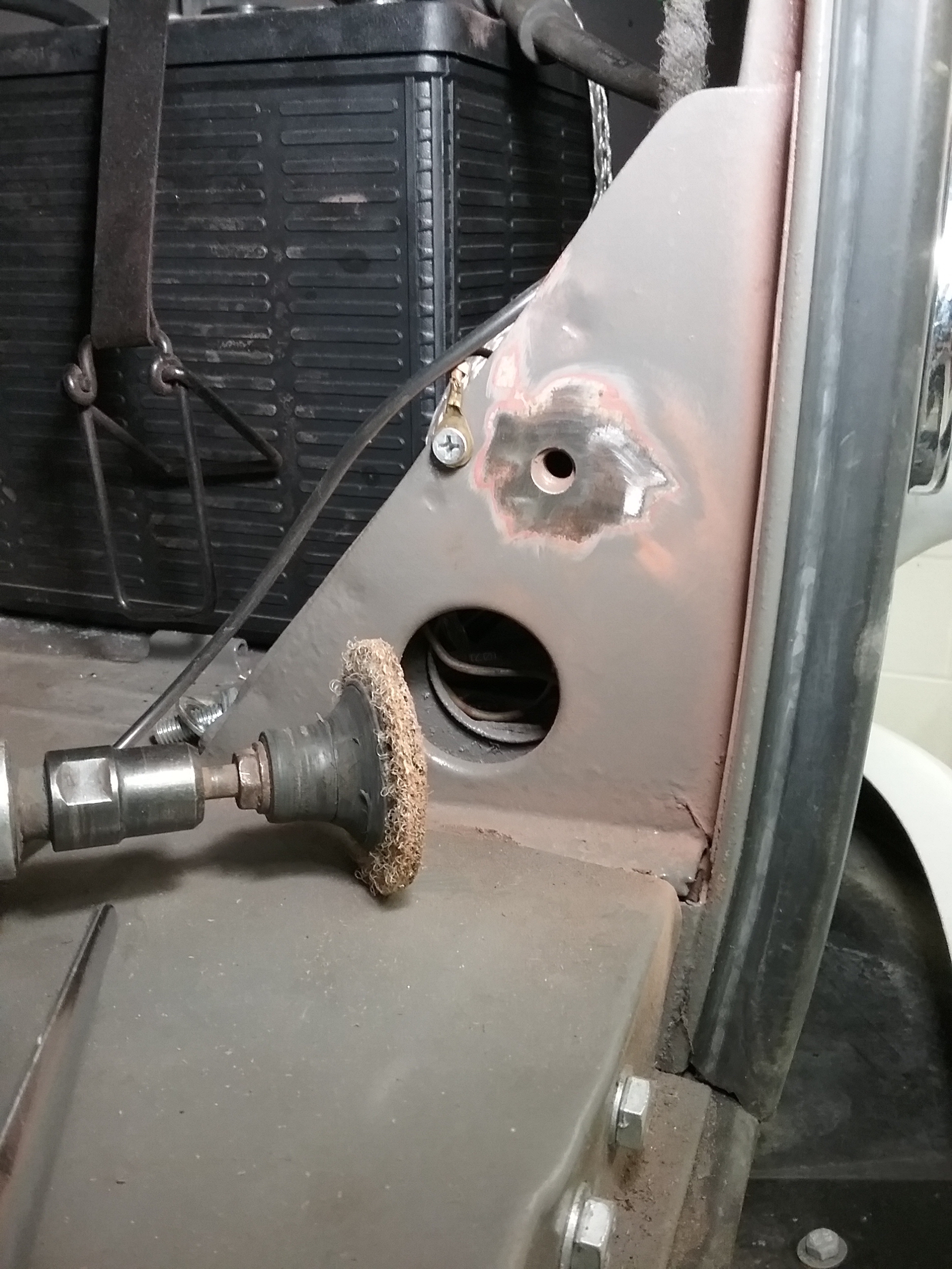

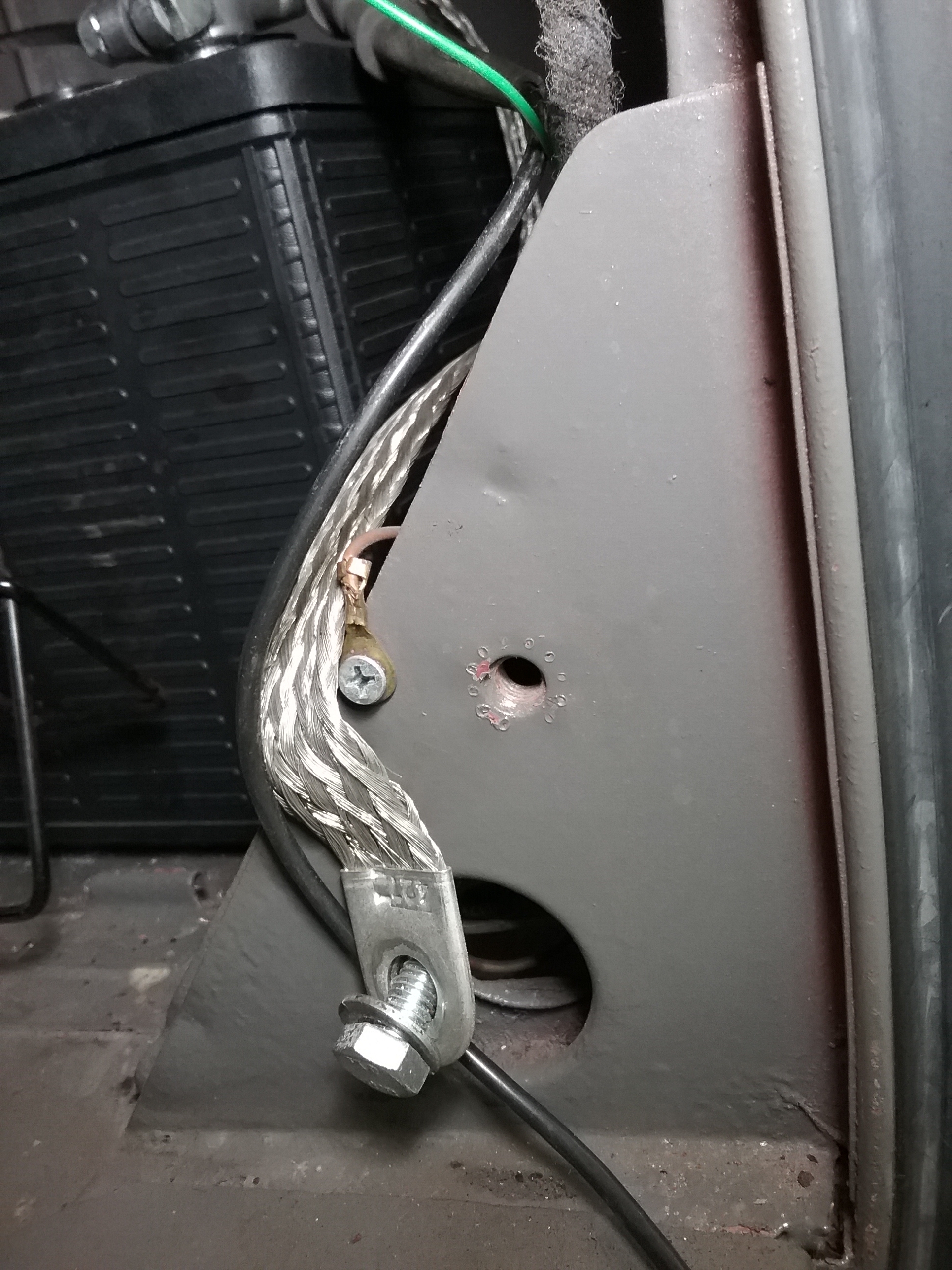

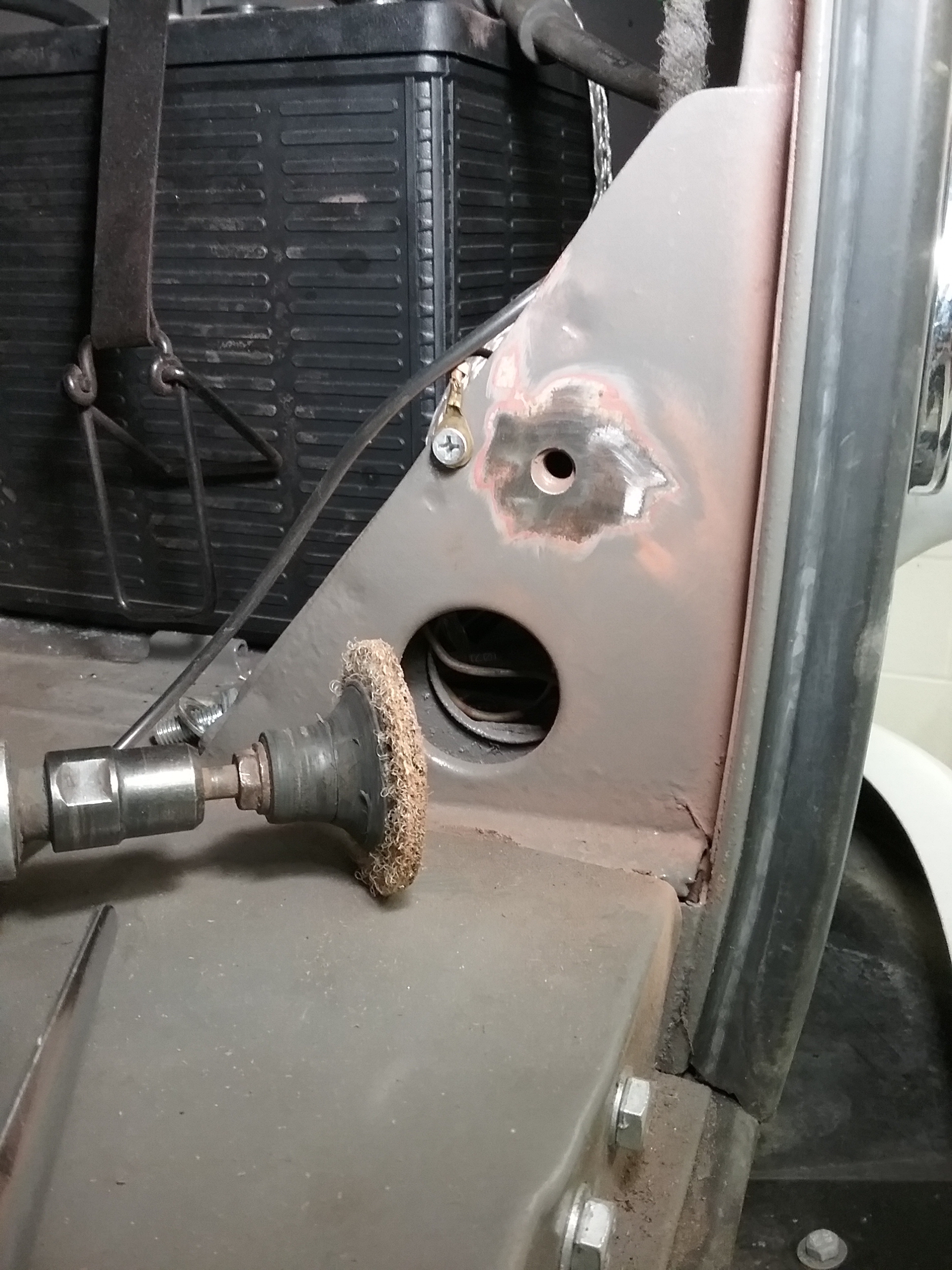

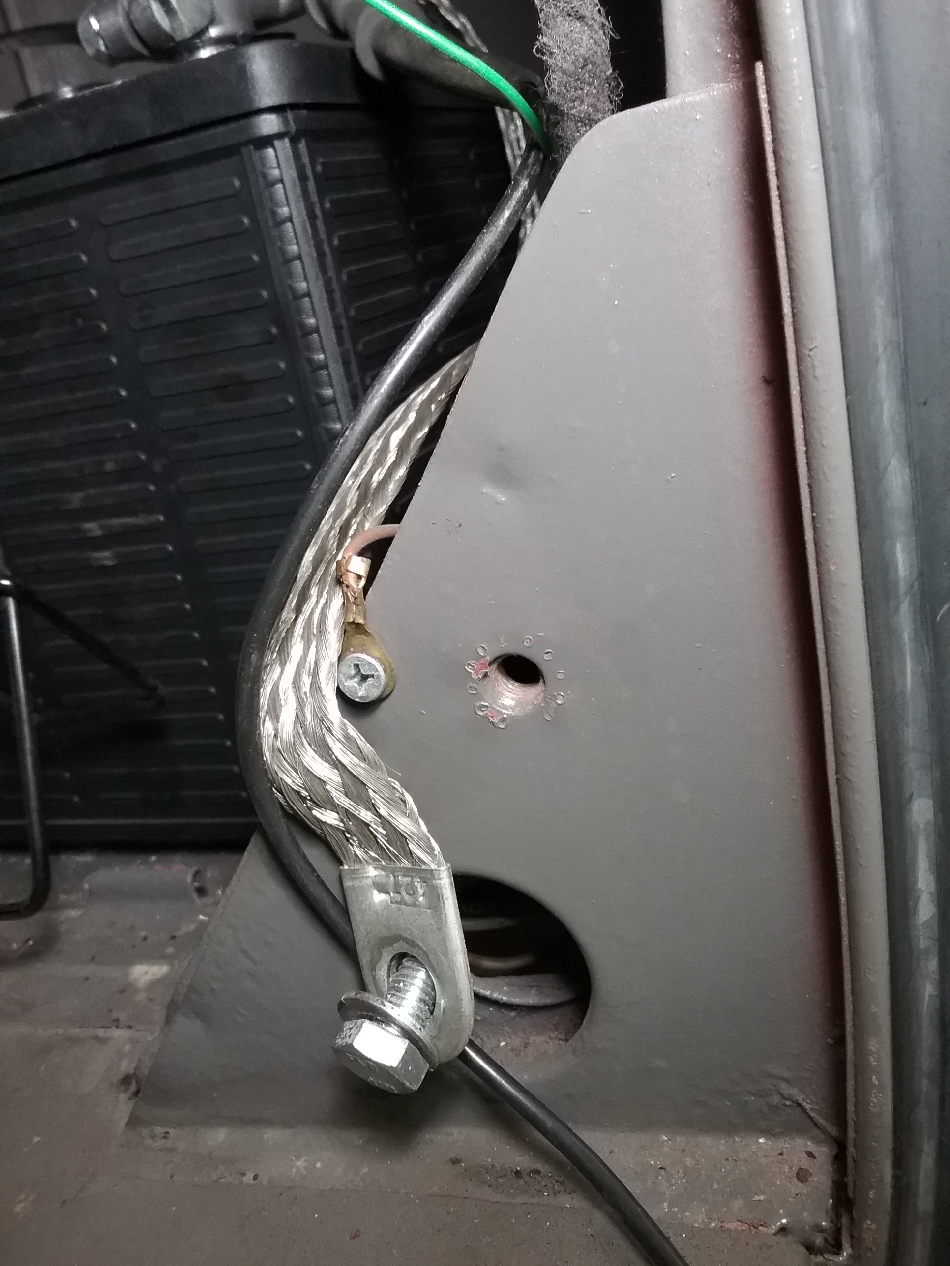

Yes, Sean's back in the split world. His first challenge was electrical- the 6v starter only worked one time out of 5, just clicking the rest of the time. It has a new starter, new battery, and new cables in it. :mrgreen: I started by doing voltage drop tests on the main high amperage circuit (battery cables, grounds, etc) and found this ground strap to have .15v drop on it, probably 10 times what it should. I unbolted it to find the PO did put a serrated washer between the strap and freshly painted body but it wasn't making a good connection.

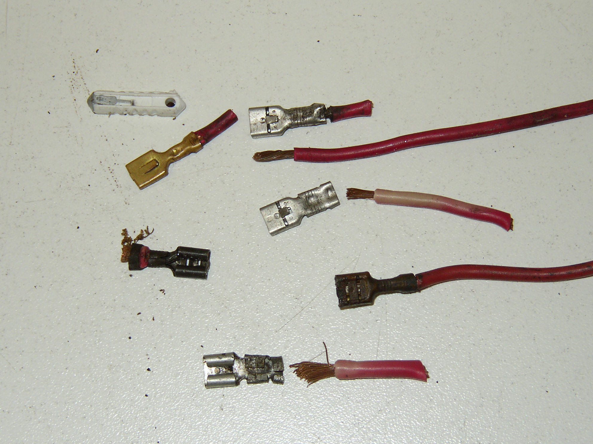

Now the starter sounds better/faster when it cranks, but still won't crank every time you turn the key. I measured Vdrop on the trigger wire to find almost a volt, so up to the iggy switch we go. I found many issues up front. :D The main power feed goes to the HL Sw before it goes to the ig sw, so I changed that by soldering 2 10 ga wires to the main feed and splitting them off individually to the ig sw and HL sw. Many of the crimp connectors were ugly- the female portion was loose where it would fall off with gravity, and the crimp portion was done "with improper tools". We fix 'em up. I didn't take a lot of pictures at that time as it was late on a Saturday and I was trying (unsuccessfully) to get Sean out of there and home, but here's some pictures of shit I picked up off the floor.

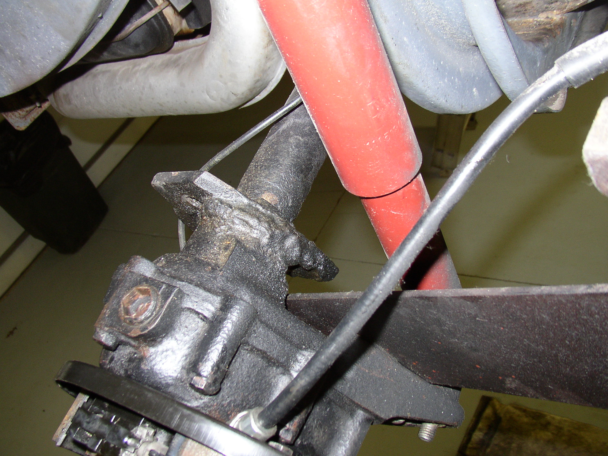

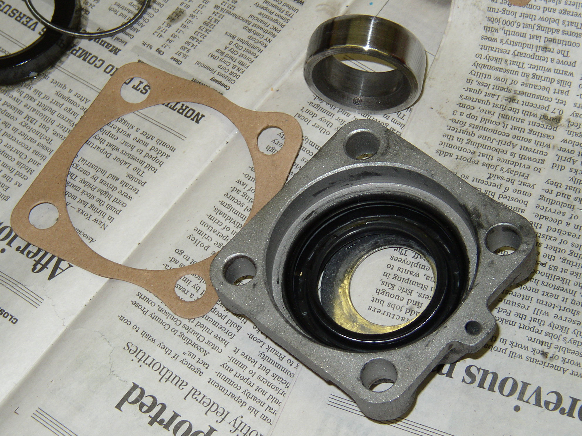

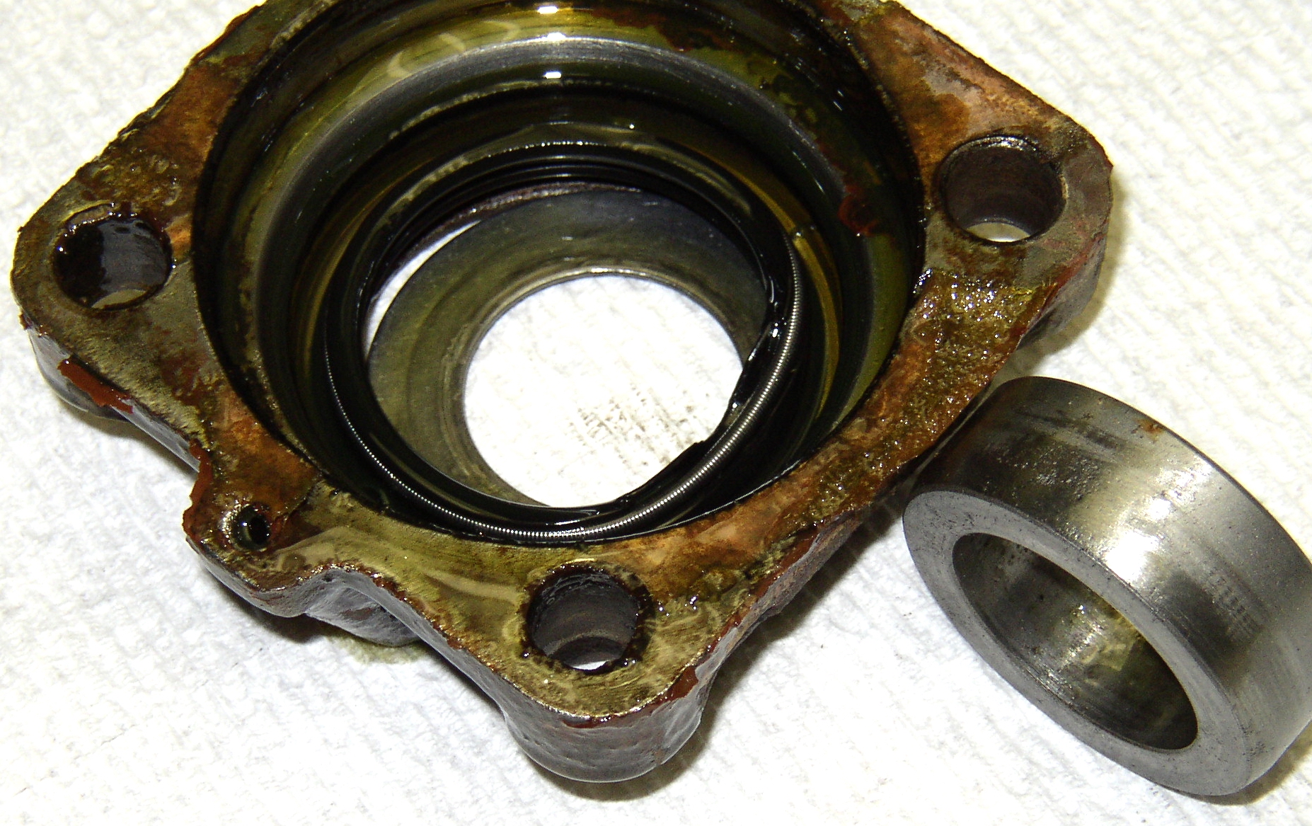

The RR axle seal was puking big time, big surprise to find the seal lip not only folded over but also cut.

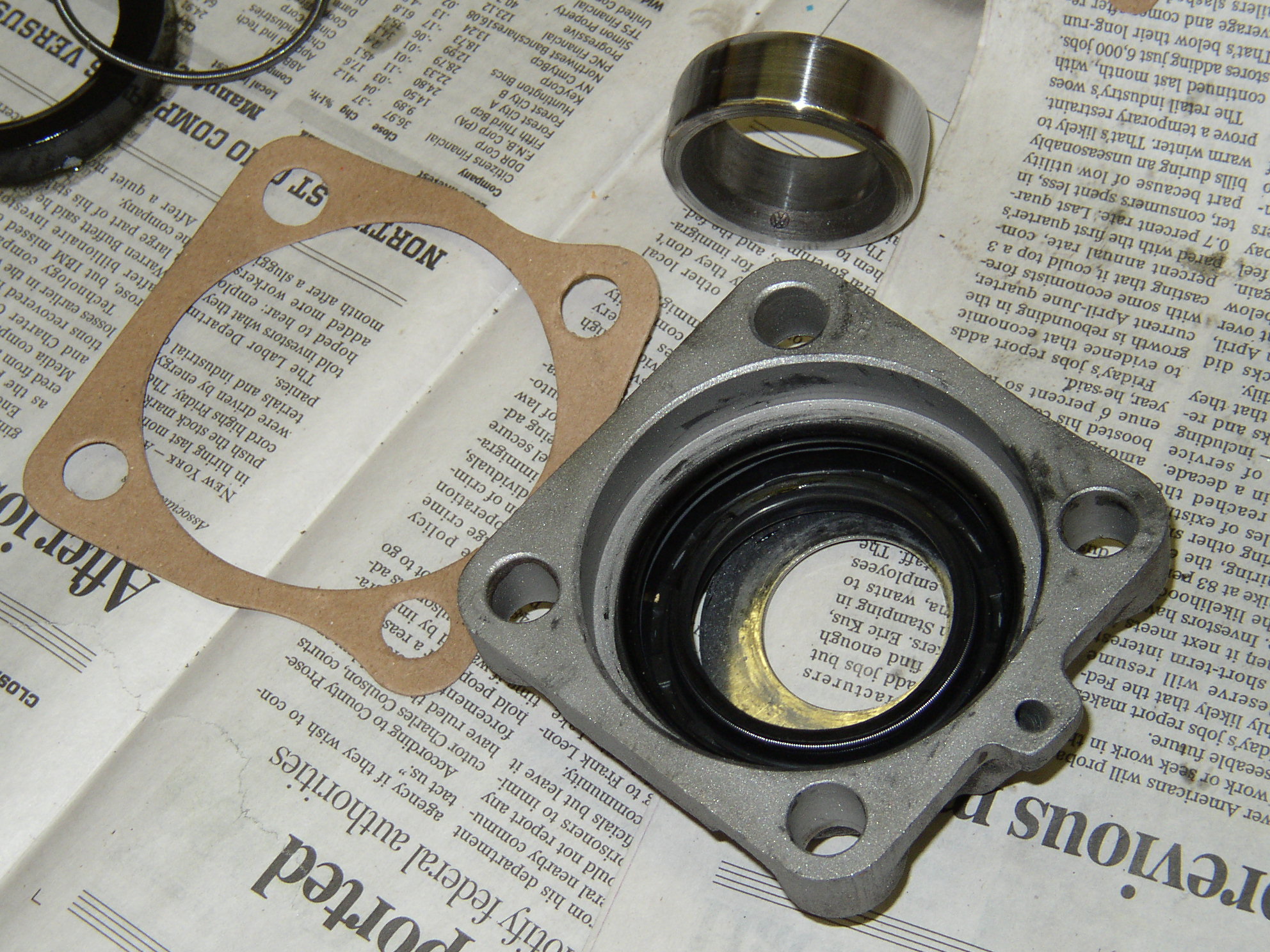

We fix 'em up. I polished the seal spacer starting at 220 and up to 1000 grit. The black stuff is a smear of RTV on the seal.

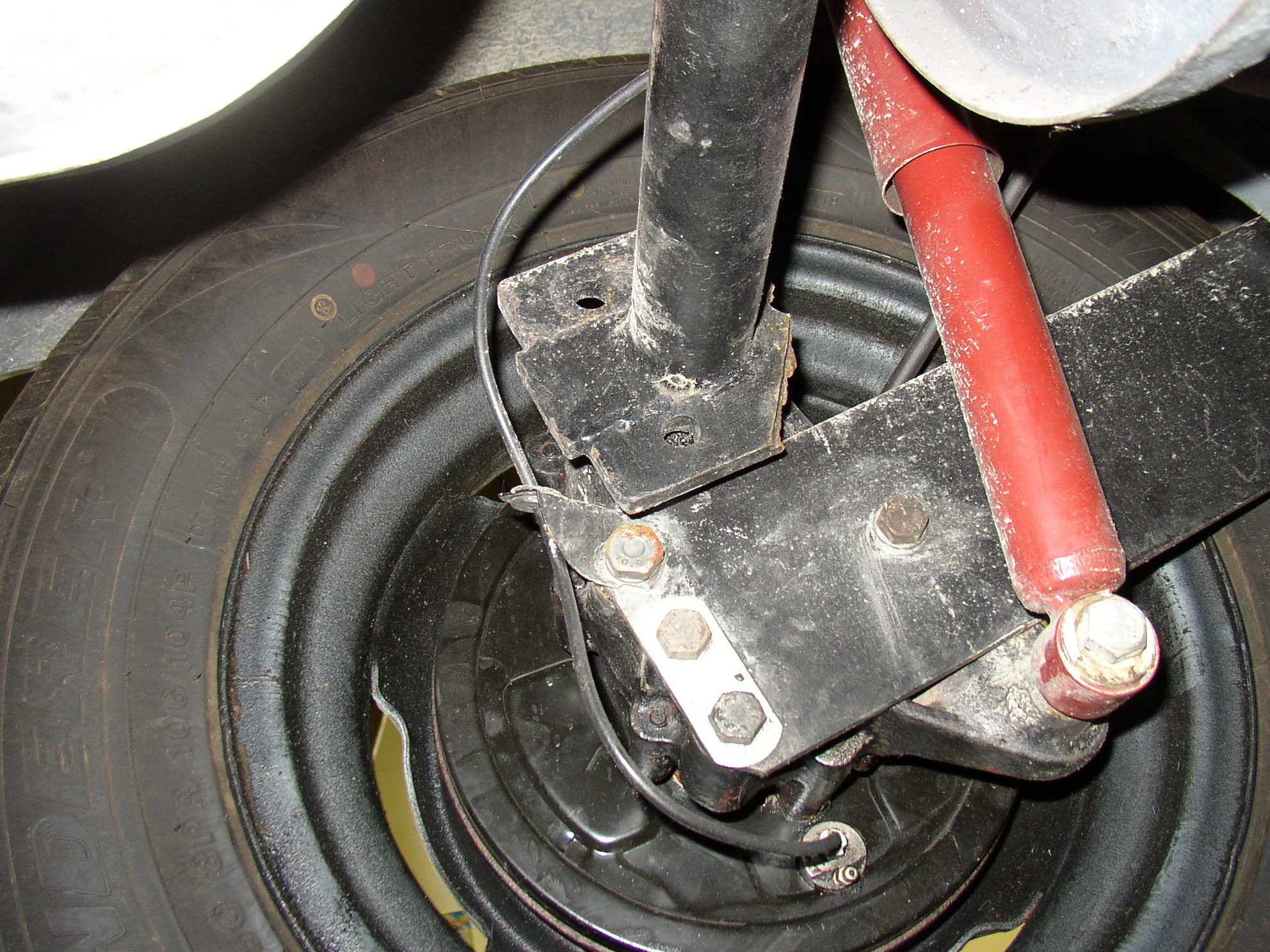

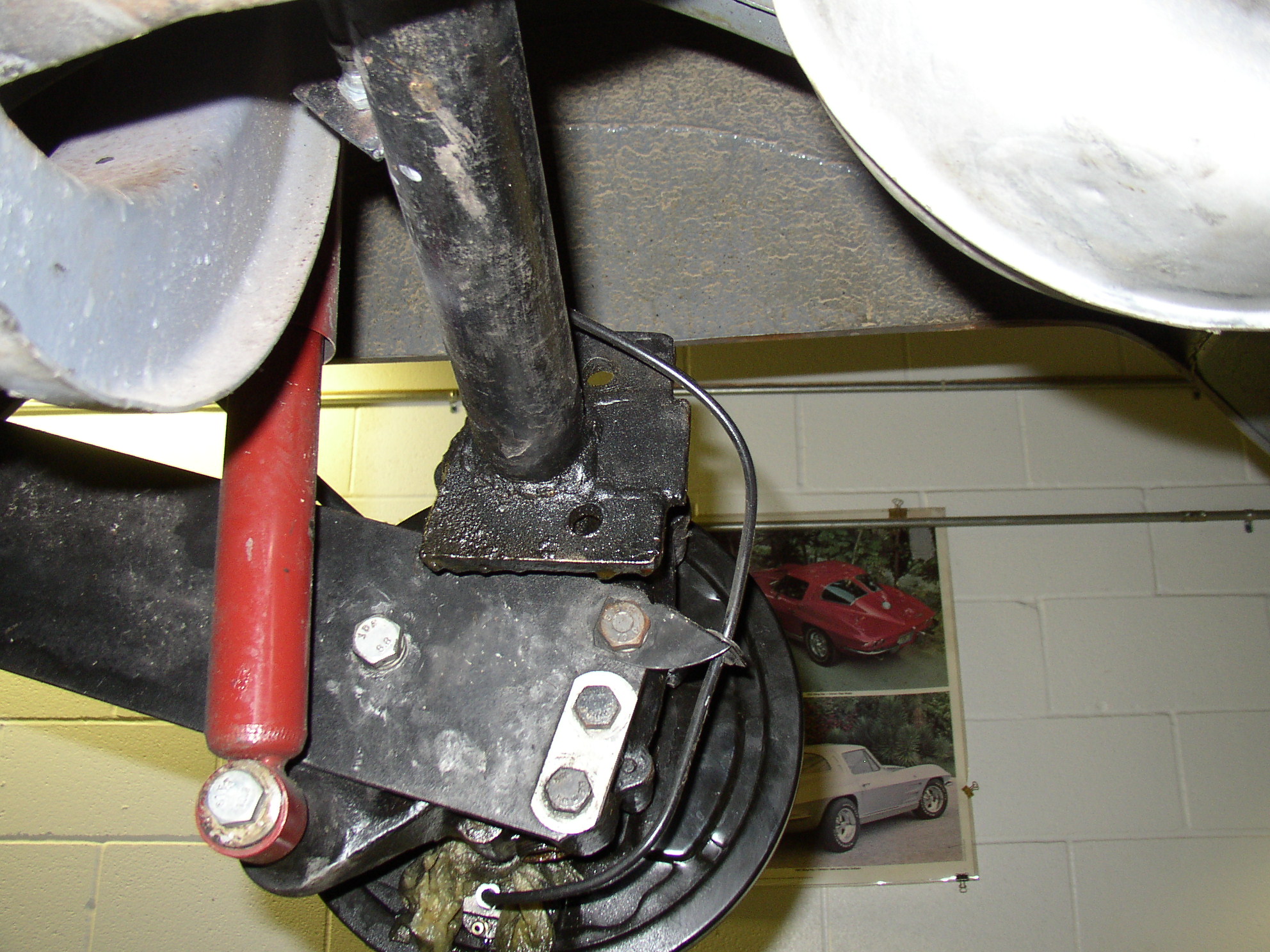

I don't know where this tranny was in a previous life, maybe youz guyz or W5 can help here- what do you think these brackets were from? Sandrail? Lowered or raised vehicle? It's a stock small nut that won't be in here for long......

The PO had a transmission that was part of the deal that apparently was from a '63. He couldn't get it to work because someone had done some Frankenstein like surgery on the drums and tried to install 1 ton brakes on the end of some funky '63 axles. I don't understand the details, but the PO discusses the problems in the samba thread referenced earlier. The PO gave up and bought a drum to drum period correct small nut w/RGB's that indeed came from a dune buggy.
