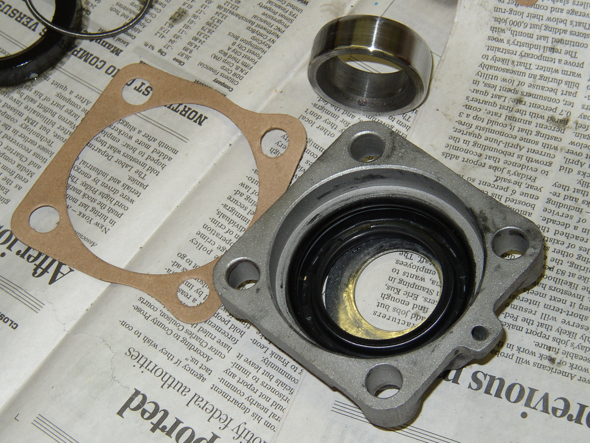

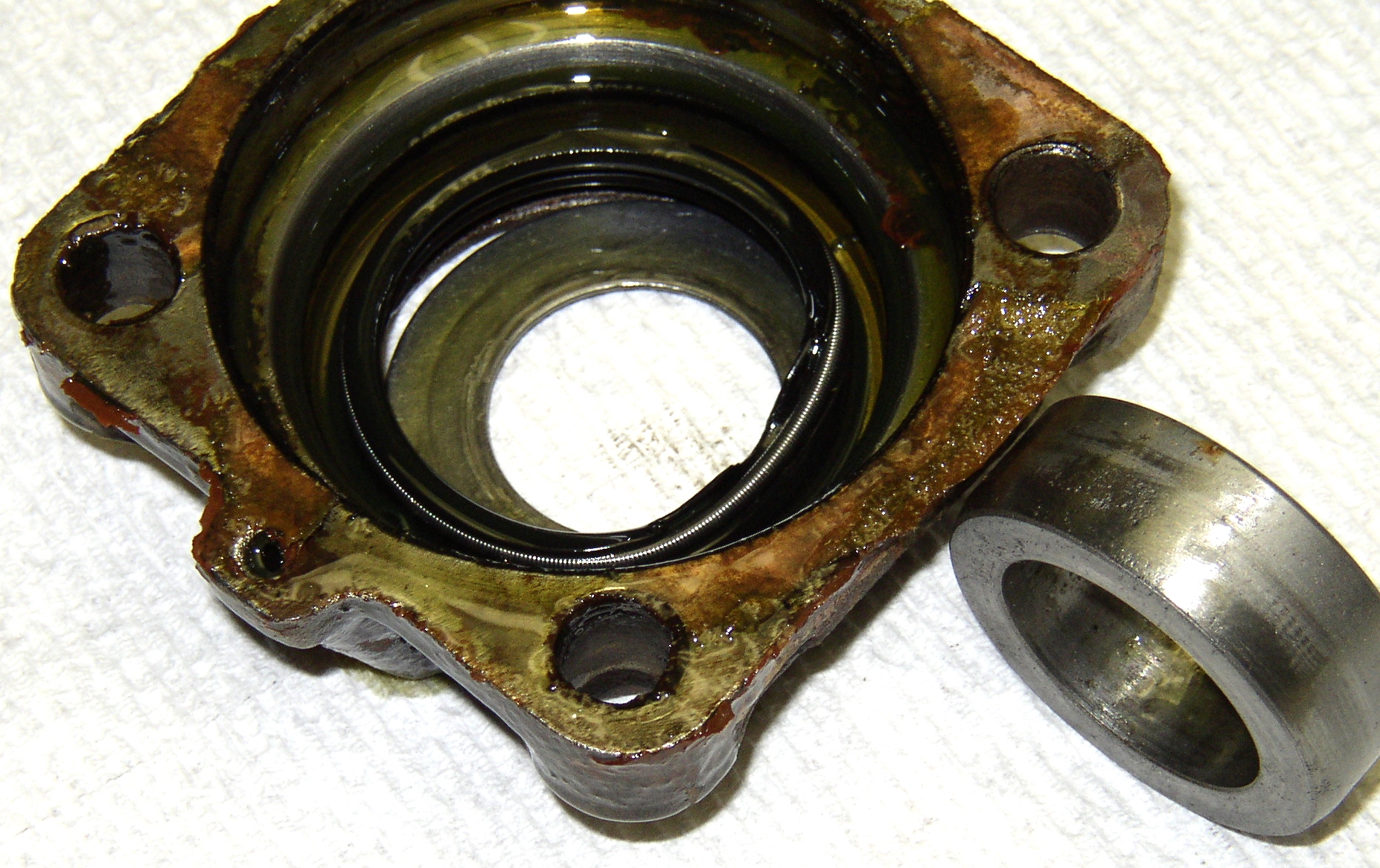

The RR axle seal was puking big time, big surprise to find the seal lip not only folded over but also cut.
We fix 'em up. I polished the seal spacer starting at 220 and up to 1000 grit. The black stuff is a smear of RTV on the seal.

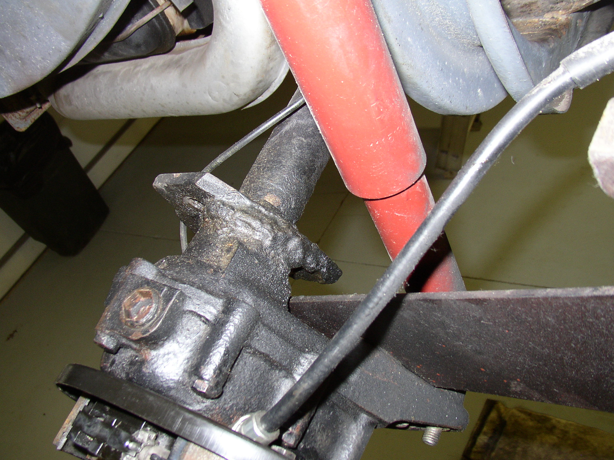

I don't know where this tranny was in a previous life, maybe youz guyz or W5 can help here- what do you think these brackets were from? Sandrail? Lowered or raised vehicle? It's a stock small nut that won't be in here for long......

The PO had a transmission that was part of the deal that apparently was from a '63. He couldn't get it to work because someone had done some Frankenstein like surgery on the drums and tried to install 1 ton brakes on the end of some funky '63 axles. I don't understand the details, but the PO discusses the problems in the samba thread referenced earlier. The PO gave up and bought a drum to drum period correct small nut w/RGB's that indeed came from a dune buggy.

Bruce’s detailed elbow grease will really make this thing a solid runner! The T1 springplate remains should be cut off those axle tubes and grinded down but a big nut trans is a better for the speed factor. Looking forward to see this bus on the road!
